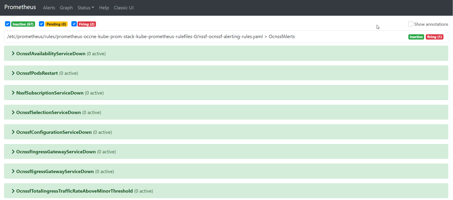

6.3 NSSF Alerts
This section includes information about alerts for Oracle Communications Network Slice Selection Function.
6.3.1 System Level Alerts
This section lists the system level alerts.
6.3.1.1 OcnssfNfStatusUnavailable
Table 6-161 OcnssfNfStatusUnavailable
Field Details
Description 'OCNSSF services unavailable'
Summary 'kubernetes_namespace: {{$labels.kubernetes_namespace}}, timestamp: {{ with query "time()" }}{{ . | first | value | humanizeTimestamp }}{{ end }} : All OCNSSF services are unavailable.'
Severity Critical
Condition All the NSSF services are unavailable, either because the NSSF is getting deployed or purged. These NSSF services considered are nssfselection, nssfsubscription, nssfavailability, nssfconfiguration, appinfo, ingressgateway and egressgateway.
OID 1.3.6.1.4.1.323.5.3.40.1.2.9001
Metric Used
'up'
Note: This is a Prometheus metric used for instance availability monitoring. If this metric is not available, use the similar metric as exposed by the monitoring system.
Recommended Actions The alert is cleared automatically when the NSSF services start becoming available.

  6. Log in to Prometheus GUI and verify the alerts section.
    The alert configuration file must be loaded as shown in the figure.Prometheus Alert Manager

  3. Log in to Prometheus GUI and verify the alerts section.
