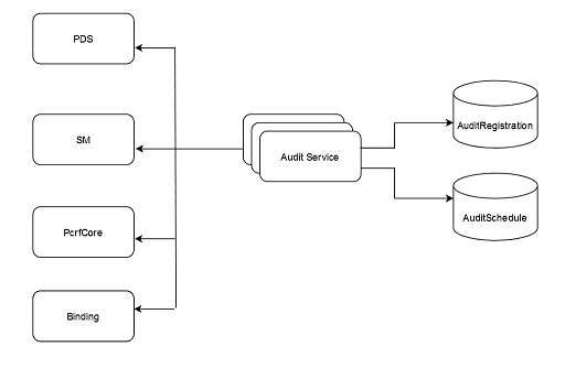

3.1 Audit Service
Policy signaling services like SM service, AM service, UE service, Binding Management service etc are stateless, thereby making the centralized DB tier to store the session states. The policy micorservices session processing and DB tier transactions happen over network. The transactions that fails due to varied reasons get stored in the database as stale records. These stale records grows indefinitely over a period of time. The Audit Service is responsible for auditing the database to monitor for stale records, and either notify or clean up these stale records. The service that needs to use the Audit service to audit its tables, must register with the Audit service.
Figure 3-1 Audit Service Registration
The Audit Service Single Pod design
Audit service is mainly responsible for:
  • allows core services to dynamically register or de-register the tables for auditing process
  • core services can change other attributes at run time by using the Audit service restful interface
  • notifying the context owners about the expired records in the registered table for auditing
  • provide flow control of notifications towards the context owners
  • perform forceful deletion of stale records, in case no corrective action is taken by context owners
  • publish total count of records in the registered table for auditing
Audit service is not only responsible for stale session cleanup but has increased scope in other signaling features as well e.g., notifying core service for binding retry attempts.
Audit service with single pod deployment makes it neither scalable nor highly available. Audit service supports multiple pods, by using Audit Schedule. Audit Schedule helps to effectively manage and plan the audit service on the registered services.
Figure 3-2 Multiple Pod Audit Service

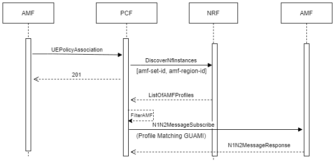

3.2 Access and Mobility Service
Policy implements Access and Mobility (AM) management service related policies over the N15 interface towards Access and Mobility Management Function (AMF).

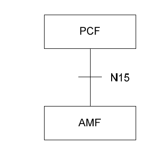

The following figure describes the communication between PCF and AMF over the N15 interface:
Figure 3-3 Communication between PCF and AMF over N15
PCF AMF interface

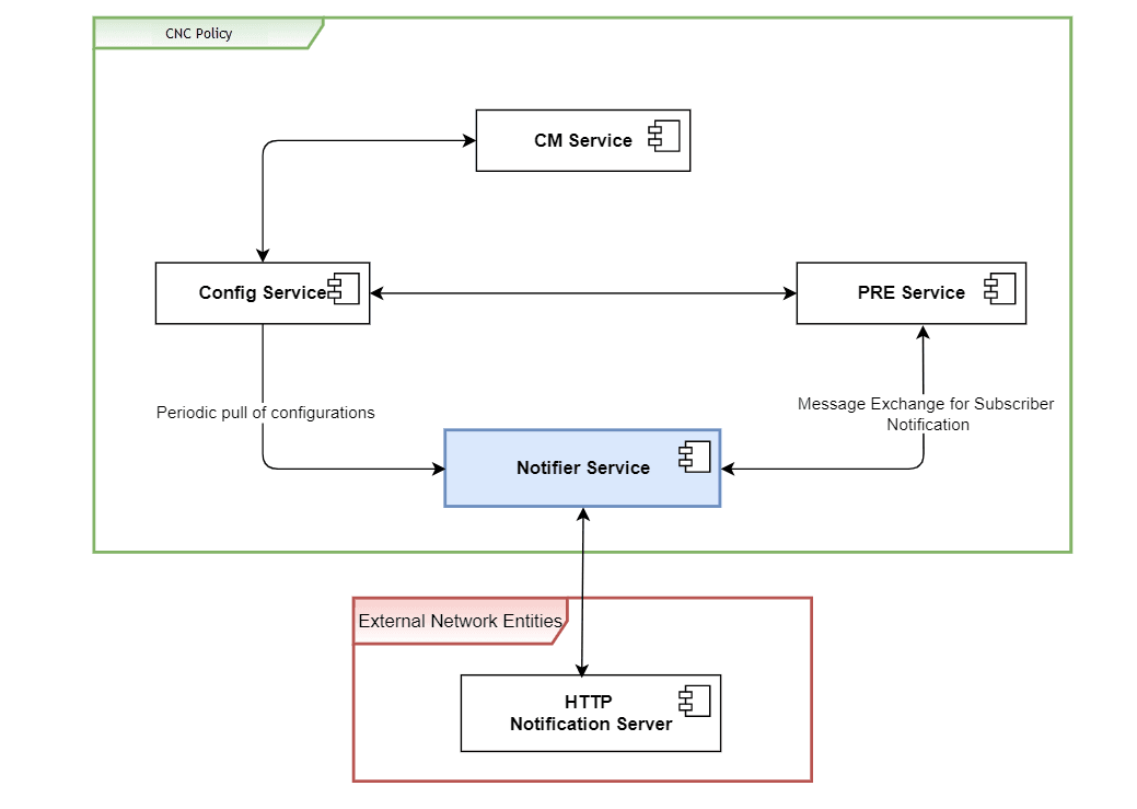

3.5 Notifier Service
Policy Notifier service is an optional service that allows Policy to send notifications to the subscribers about their current data usage. This service is independent of deployment mode and can be enabled in all the supported deployment modes.
As part of subscriber quota management and based on the defined policies, the user is notified about their current usage at various levels. For example, when a user consumes 80% of the granted quota, a notification must be sent to notify the user about its usage. Similarly, when they reach or exceed the threshold, a notification must be sent informing the user about reduced quality of service or even suspension of service. With the Notifier service, Policy can send either HTTP notification or short messages (SMS) using SMPP to subscribers, based on the policies configured by operators, through an external notification server.
In the current release, Policy supports subscriber notification only using HTTP and SMPP protocols.
This feature is supported only for PCRF-Core call flows.
The following diagram shows how Notifier Service fetches configurations from Config service and on receiving notification request from PRE, sends out the notification to the subscriber via external notification server:
Figure 3-4 High Level Notifier Service Diagram

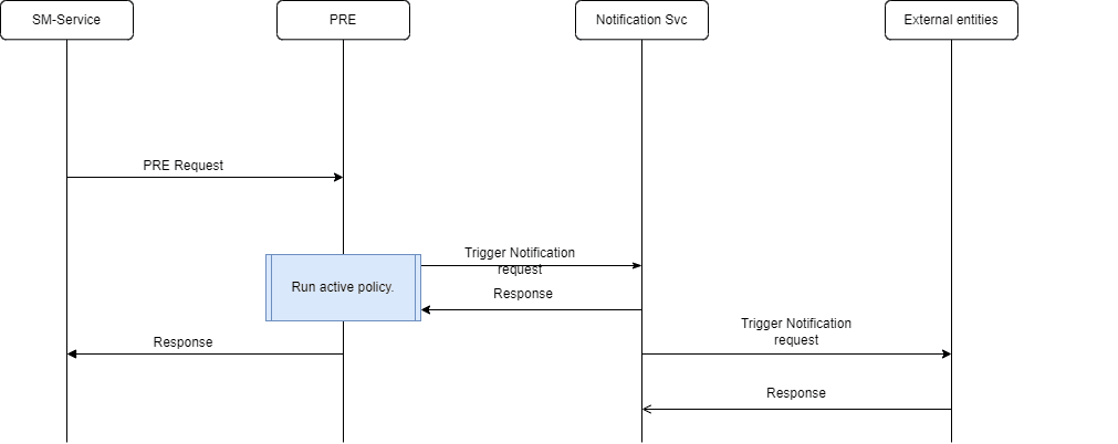

Call Flow
The following call flow diagram describes the notification call flow for SM service. As seen in the diagram, SM service sends a request to PRE that runs any given active policy and as a result triggers notification request to Notifier Service. Then, Notifier service sends a notification request towards the configured external server. On receiving success response, Notifier service sends the response to PRE, which in turn sends it to SM service.
Figure 3-5 Notifier Call Flow for SM Service

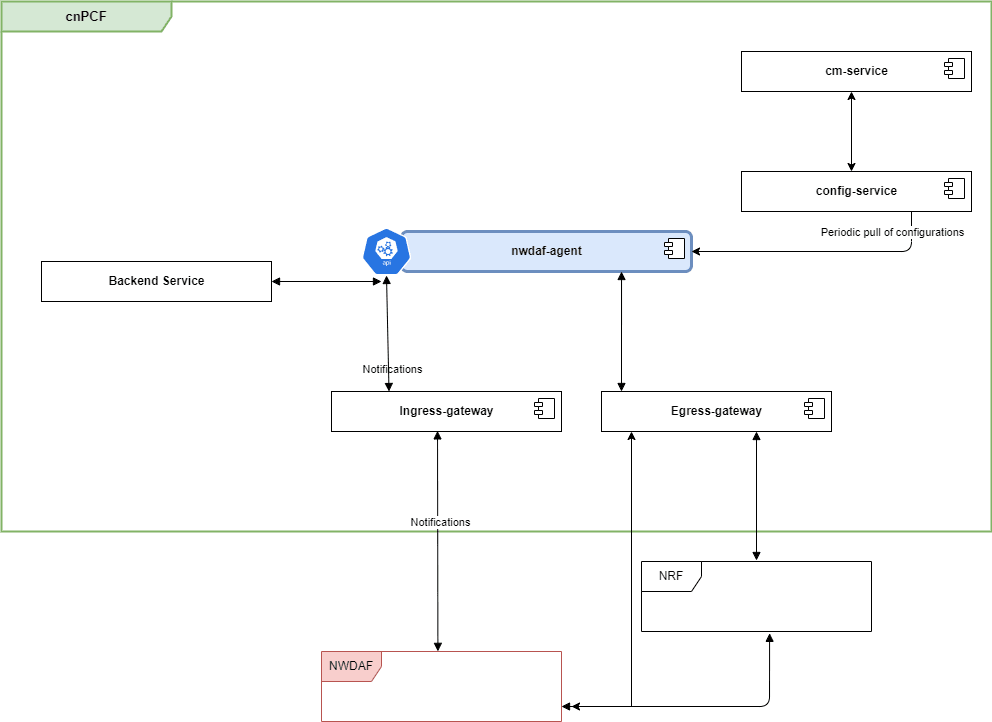

3.6 NWDAF Agent
Policy integrates with Network Data Analytics Function (NWDAF) service to get analytics information. NWDAF can provide various analytics data, which PCF can consume and use to make policy decisions. For more information analytics data, see Oracle Communications Networks Data Analytics Function User Guide.
Policy 22.4.0 includes phase one implementation of Policy integration with NWDAF for testing purposes.
It also queries Network Repository Function (NRF) client for fetching NWDAF information. For NWDAF, autonomous NRF discovery and static configuration is only supported, on-demand is not yet supported. For more information on autonomously discovered NF profiles for NWDAF, see Discovered NF Instances.
A 5G network contains a vast number of devices and sensors generating an enormous amount of data. The NWDAF Agent allows the Communications Service Providers (CSPs) to efficiently monitor, manage, automate, and optimize their network operations by the data collected and analytics generated across the network. It also also helps the CSPs in achieving the operational efficiency and provides an enhanced service experience. Currently, NWDAF Agent supports slice load level analytics as part of the analytics data that is provided from NWDAF.
The following diagram describes the interaction with NWDAF Agent and Policy:
Figure 3-6 Interaction between Policy and NWDAF Agent
Interaction between CNC Policy and NWDAF Agent

To enable the service, set the following parameter to true at the time of installing or upgrading Policy:
nwdafAgentServiceEnable
For information on how to set the parameter value, see Oracle Communications Cloud Native Core Policy Installation, Upgrade and Fault Recovery Guide.
Configure
Once the service is enabled, you should be able to see NWDAF Agent service menu under the Service Configurations on CNC Console for Policy.
For information on how to configure NWDAF Agent, see Configuring NWDAF Agent.
After the configuration you can use blockly to see the analytics data. For more information, see "Public Category" section in Oracle Communications Cloud Native Core, Converged Policy Design Guide.

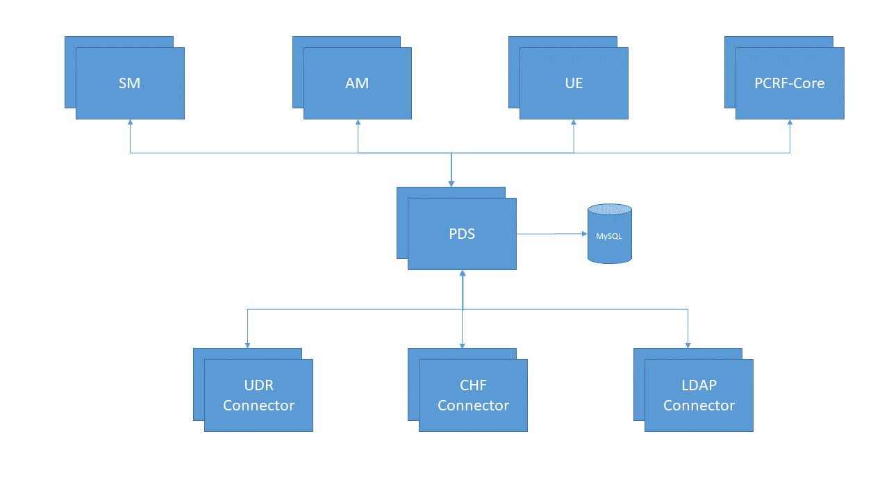

Policy Data Source (PDS) Service
Policy Datasource Service (PDS) is an intermediate layer which interfaces Core Services (SM/AM/UE/PCRF-Core) with the protocol specific connector layers (UDR/CHF/LDAP Connectors). PDS also holds the subscriber information in its database when a new session gets established for a given subscriber and cleans-up the information when the last session termination happens. PDS is also responsible for storing the Subscriber State Variables except session level in its database and provides these variable information across multiple core services which requests the information.
You could define the workflows for PDS and the workflow would define the flow of request processing. This workflow is internal to the PDS project and should consult with engineering team for any update.
The following figure depicts the PDS architecture:
PDS overview
For configuring PDS service, see PDS Settings.
Currently, PDS supports SUPI/GPSI as the search key. It does not support NAI as the search key.
UDR Connector- UDR Connector is a protocol specific layer which converts the request send by PDS to nUDR specific format and forwards to real UDR for subscription information. It also provides an ability to subscribe for profile change at UDR.
CHF Connector – CHF Connector is a protocol specific layer which converts the request send by PDS to nCHF specific format and forwards to actual CHF for fetching PolicyCounter Information. As per the standards, it automatically subscribes for profile change at CHF.
For configuring the UDR or CHF connector, see PCF User Connector.

3.10 UE Policy Service
Policy implements PCF UE Policy service to provision the UE policies, determined by PCF, to UE through AMF over the N15 interface.
Figure 3-8 PCF-AMF communication
PCF communicating to UE through AMF over N15 interface
PCF UE Policy service performs the following functions:
  • Transfering UE Route Selection Policies (URSP) rules to UE
  • Establishing the UE Policy Association requested by the NF service consumer
  • Deleting the UE Policy Association requested by the NF service consumer
  • Defining and delivering URSP message to UE via AMF using N1N2 message
Policy supports the following 3GPP defined service operations for the PCF UE Policy service:

Figure 3-9 Selecting Producer AMF using AMF SetID and AMF Region ID
This call flow shows how Policy selects the producer AMF for the next subscription request using AMF SetID and AMF RegionID extracted from GUAMI.
  1. Policy receives UEPolicyAssociationRequest from Consumer AMF.
  2. If AMF Discovery criteria is set to SetID and RegionID, Policy parses the GUAMI to fetch the AMF SetID and AMF RegionID.
    Figure 3-10 Parsing GUAMI
    This diagram depicts how Policy parses the GUAMI to extract the AMF SetId and AMF RegionID
    Sample GUAMI:
    "guami": {
            "plmnId": {
                "mcc": "450",
                "mnc": "05"
            "amfId": "010041"
    In the above example, Policy extracts the following details from GUAMI:
    amfid = 010041
    AMF RegionID (first 8 bits): 01
    AMF SetID (next 10 bits): 001
  3. Policy includes the extracted AMF SetID and AMF RegionID in a query parameter (amf-set-id, amf-region-id) and queries the NrfClientConnector through NRF discovery URI /nnrf-disc/v1/nf-instances.
  4. Policy receives a list of AMF Profiles as a response from NRF.
  5. Policy selects the target AMF from the list of AMF Profiles by matching GUAMI received in UEPolicyAssociationRequest with the GUAMI(s) present in the list of AMFProfiles returned from NRF.
    1. If the above match results in a single AMF instance, Policy uses that AMF for the Subscription Request required for UE Policy Transfer.
    2. If there is no match, Policy applies the filter for Priority/Capacity Load to all the GUAMI's received in AMFProfile to identify the relevant AMF.
    3. If there are more than one AMF profiles, Policy applies the filter for Priority/Capacity Load to select the relevant AMF.
  6. Policy sends a N1N2MessageSubscribe to the selected producer AMF and receives a response.
  7. Policy responds the consumer AMF with a 201 message.

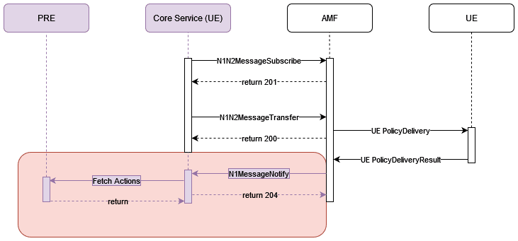

Support of policy evaluation on AMF Notification on N1Notify and N1N2NotifyFailure
Currently, PCF does not evaluate Policies after N1 message notify or N1N2Transfer failure notification flow in PCF UE service. Thus PCF does not allow the user to take action dynamically and allows only static action such as retransmit, skip the fragment, or ignore.
This feature enables the PCF user to write policies using Policy blockly. PCF evaluates the policies and takes actions after receiving N1Message Notify messages with MANAGE UE POLICY COMPLETE or MANAGE UE POLICY COMMAND REJECT messages from AMF , when UPSI's are installed. PCF UE service decodes the N1 Notify message that it receives from AMF during the rejection of URSP's by UE.
The subscription and transfer process are managed by the retry mechanism. In the notification flow, when the UE service receives a notification from AMF (N1MessageNotification), PRE is included both in the event of success or failure, allowing for subsequent installation attempts.
  • In case of MANAGE UE POLICY COMPLETE message, PCF UE does not send the list of rejected UPSIs or URSPs since the transaction was completed successfully.
  • In case of MANAGE UE POLICY COMMAND REJECT message, PCF UE sends the list of rejected UPSIs and URSPs to the PRE so that policy evaluation can be done using this information.
  • In case of N1N2MessageTransferFailure message, PCF UE does not send the list of rejected UPSIs or URSPs as this is the a HTTP error with AMF and there is no information about rejected UPSIs or URSPS. PCF UE sends the cause of the failure to PRE.
The blockly Policy created by considering the course of action that needs to be taken in the event of an error, supersedes any configurations set in N1 Message Retransmission Settings of the PCF UE Policy page in CNC Console.
Figure 3-11 UE and PRE interaction
The policy writer can check if the message is "MANAGE UE POLICY COMPLETE" and then take actions like:
  • Write successfully the installed UPSI as a string value in VSA and update it to UDR.
  • Define remote state variables, set values to variables and write in VSA and update it to UDR.
  • Write successfully the installed UPSIs and UEPolicySection in UDR using the 3GPP Attributes-Non Fragmented or Fragmented (at message level).
The policy writer can check if the message is "MANAGE UE POLICY COMMAND REJECT" and then take actions like:
    • Write successfully the installed UPSIs and UEPolicySection in UDR using the 3GPP Attributes.
    • Retransmit the failed UPSIs or new UPSIs, based on conditions like PLMN, SUPI, the failed UPSIs.
    • Skip the retransmit of UPSIs, based on conditions like PLMN, SUPI, the failed UPSIs.
    • Abort the transaction of transferring the UEPolicy in N1N2Message based on conditions like PLMN, SUPI, the failed UPSIs.
    • Define remote variables other than UPSI, set values to variables and write in VSA and update it to UDR.
