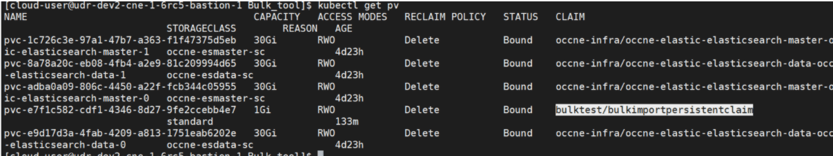

2.2.1.12 Creating Persistent Volume Claim
This step is optional and is required when the UDR 1.12.0 and lower bulk import tool is deployed. For newer version, this is not required.
The bulk import Persistent Volume Claim (PVC) and xmltocsv container PVC are created automatically using helm.- Use the following sample template for previous release versions and
save it as <file-name>.yaml file.
PersistentVolumeClaim Bulk Import Service
apiVersion: v1 kind: PersistentVolumeClaim metadata: name: bulkimportpersistentclaim spec: storageClassName: <Please Provide your StorageClass Name> accessModes: - ReadWriteOnce resources: requests: storage: 1Gi - Run the following command to create a PVC.
kubectl create -f <file-name>.yaml - Run the following command to verify whether a PVC is created or

- Run the following command to verify whether a Persistent Volume (PV)
is created and bound to the PVC volume.
kubectl get pvFigure 2-2 Verifying PV Creation
