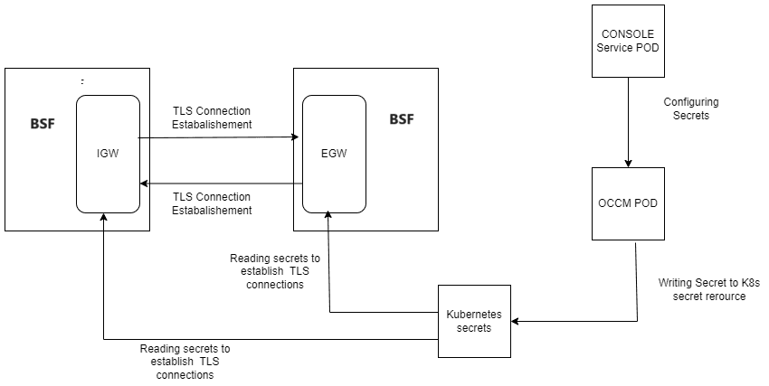

Figure 3-3 BSF Integration with OCCM
There is no direct communication between OCCM and BSF. All the communications are handled using Kubernetes Secrets.
All the required certificates are configured using OCCM.
After OCCM creates these Kubernetes Secrets, or monitors the already existing ones, the Ingress and Egress Gateways monitor these Secrets and keep track of their current status:

BSF supports monitoring and automatic renewal of its' TLS certificates in integration with OCCM.
It is validated that the renewed certificate and key are picked up for any new TLS connections.
Also, the existing TLS connections using the previous key and certificate are gracefully brought down.
Clean up of the certificates are also handled through OCCM.

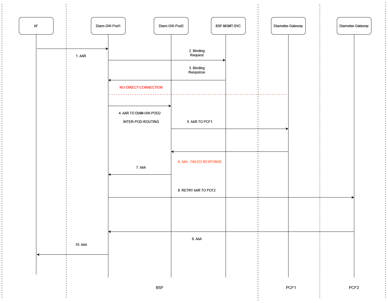

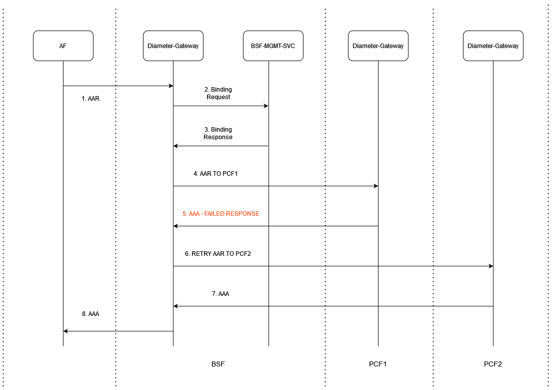

3.4 Diameter Session Retry
BSF Diameter gateway sends the Authorization-Authentication Request (AAR) messages to PCF Diameter gateway. PCF Diameter gateway acknowledges these requests by sending a successful or failed Authorization-Authentication Answer (AAA) messages to BSF.
If BSF Diameter gateway recevies Authorization-Authentication Answer (AAA) message with errors like 5065 (IP-CAN_SESSION_NOT_AVAILABLE), 5012 (DIAMETER_UNABLE_TO_COMPLY) or any other error code or a session timeout then the CNC console has configurations that can be used to resend this failed message to a different/alternate PCF Diameter gateway.
The BSF Diameter gateway on receving the failed message from Diameter Routing Agent (DRA) captures the failed error context and the error details. The error details are sent to the error handling framework implemented in diameter gateway. The error handling framework provides specific action (such as to try resending the message to an alternate route or peer) that needs to be carried out by the gateway to handle the error that has occurred. The error actions are configured in the CNC Console as Diameter gateway configurations from the user.
Diameter message retries for Rx AAR messages are enabled through the Error Mapping Framework feature in BSF. This framework resolves application errors and takes necessary action based on the error context. The error handler framework tries to find alternate solutions based on the configurations in the CNC Console. If the error is resolved, it sends back the success result to the caller, else it either retries based on the maximum number of resolution attempts configured in CNC Console or terminates the requests by forwarding the last known error.
The operator should have configured a host and realm in the diameter routing table to retry sending the failed diameter messages. Diameter gateway finds the alternate peer from the routing table. If the diameter routing table is not configured, then there is no retry behavior from Policy.
By default, the diameter message retry behavior is disabled for Rx interface. The operator can enable this feature through the CNC Console configurations.
Default number of retry attempts is 0, that is, there is no retry. The retry attempts ranges from 0-10.- 3xxx (Protocol Errors)
 - 4xxx (Transient Failures)
 - 5xxx (Permanent Failure)
Retry Attempts
The user configures the number of retries to be performed for Rx AAR diameter messages in the CNC Console. The retry attempt happens only when the alternate peers are available. If alternate peers are not available, then there is no retry attempt made. The value for number of retries ranges from 1 to 10 times.
The number of retries is set through the advance settings
                configurations, using the advance setting key
                    DIAMETER.ErrorHandler.MaxRetryCount.Rx.AAR.
Peer Cycle Back Retry
In case of the configured number of retry count is more than the total
                available alternate peers, the user can configure to cycle back the alternate peers.
                User configures this in CNC Console by setting retry peer cycle
                    back field to true. This field value is either true or false.
This peer cycle back retry configuration is set through the advance
                settings configurations using the advance setting keys
                    DIAMETER.ErrorHandler.CycleBackRetry.Rx.AAR. If advance
                settings configuration are not supported in the CNC Console, then the default peer
                cycle back retry is false.

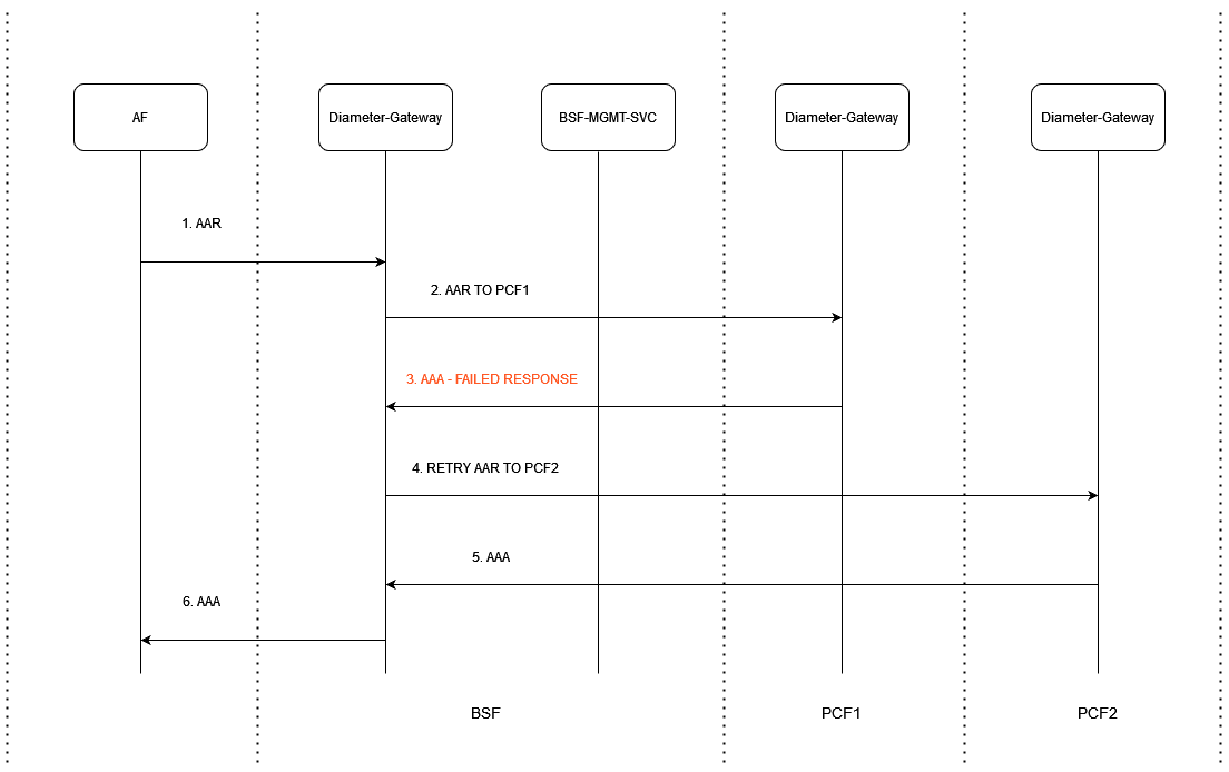

For Example: Number of configured retry = 2 and only 2 PCF (PCF1, PCF2) Diameter gateway are configured as alternate peers in BSF.
If Rx AAR message was sent BSF - PCF1 Diameter gateway and the response has failed error code such as 5065/timeout/3002/3004.
Then the first retry uses BSF - PCF2-Diam-Gateway and the response has failed error code such as timeout/3002/3004.
Then the second retry uses BSF - PCF1-Diam-Gateway and thus uses the peer cycle back retry mechanism.

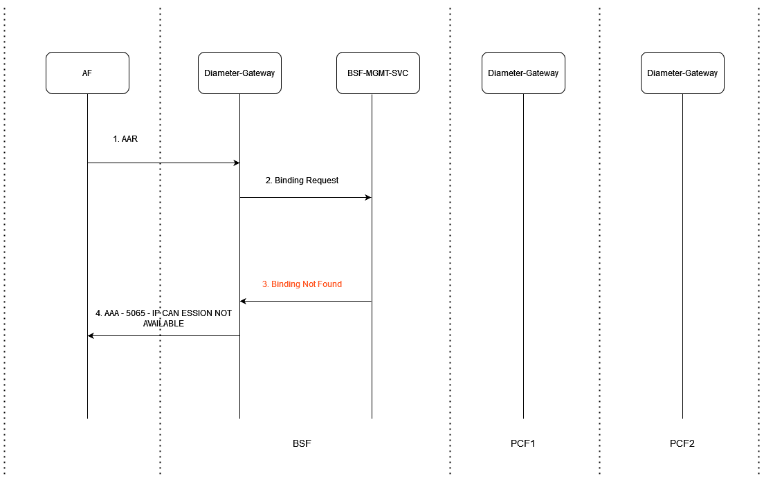

Call Flow of Rx AAR No Retry Case - When Binding is Not Found
Figure 3-5 Rx AAR No Retry Case - When Binding is Not Found
- Application Function (AF) sends AAR request to BSF Diameter Gateway.
 - BSF Diameter Gateway sends binding request to BSF Management Service.
 - BSF Management service sends "Binding not found" response.
 - BSF Diameter Gateway responds to AF with error code 5065 (IP-CAN_SESSION_NOT_AVAILABLE).
Call Flow of Rx AAR Retry Case - When Binding is Found
Figure 3-6 Rx AAR Retry Case - When Binding is Found
 - BSF Management service sends back binding response.
 - BSF Diameter Gateway sends AAR request to PCF1 Diameter Gateway.
 - PCF1 Diameter Gateway sends a failed AAA response to BSF Diameter Gateway.
 - BSF Diameter Gateway resends the failed AAA message to PCF2 Diameter Gateway.
 - PCF2 Diameter Gateway sends a successful AAA response to BSF Diameter Gateway.
 - BSF Diameter Gateway sends this AAA message to AF.
Call Flow of Rx AAR Retry Case - When Binding is Not Found
Figure 3-7 Rx AAR Retry Case - When Binding is Not Found
Call Flow of Rx AAR Retry Inter-Pod Routing Case - When Binding is Found
Figure 3-8 Rx AAR Retry Inter-Pod Routing Case - When Binding Found
- Application Function (AF) sends AAR request to BSF Diameter Gateway pod (Diam-GW-Pod1).
 - It sends binding request to BSF Management service.
 - BSF Management service sends binding response.
 - BSF Diameter Gateway pod1 on not finding any connection to PCF Diameter Gateway pods (PCF1, PCF2), it uses inter-pod routing and sends the AAR request to BSF Diameter Gateway pod2 (Diam-GW-Pod2).
 - BSF Diameter Gateway pod2 sends AAR request to PCF1 Diameter Gateway.

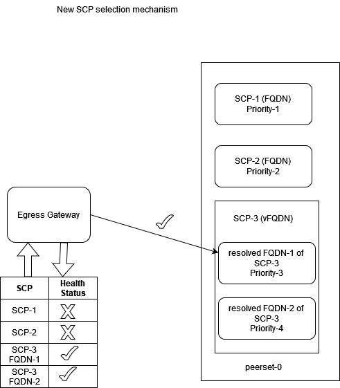

3.7 Monitoring the Availability of SCP using HTTP2 OPTIONS
BSF determines the availability and reachability status of all SCPs irrespective of the configuration types.
This feature is an enhancement to the existing SBI routing functionality. Egress Gateway microservice interacts with SCP on their health API endpoints using HTTP2 OPTIONS method. It monitors the health of configured SCP peers to ensure that the traffic is routed directly to the healthy peers. This enhancement avoids routing or rerouting towards unhealthy peers, thus minimizing the latency time.
Egress Gateway microservice maintains the health status of all available and unavailable SCPs. It maintains the latest health of SCPs by periodically monitoring and uses this data to route egress traffic to the most preferred healthy SCP.
Figure 3-9 New SCP Selection Mechanism
Once peerconfiguration, peersetconfiguration, routesconfiguration,
                and peermonitoringconfiguration parameters are configured at Egress Gateway
            microservice, and all SCPs (after Alternate Route Service (ARS) resolution, if any vFQDN
            is configured) are marked initially as healthy. The peers attached to the associated
            peerset are scheduled to run health API checks and update the health status
            continuously.
peermonitoringconfiguration is set to false by default. Since, this
            feature is an add-on to the existing SBI Routing feature and will be activated if the
                sbirouteconfig feature is enabled. To enable this feature, perform
            the following:
                     - configure
peerconfigurationwithhealthApiPath - configure
peersetconfiguration - configure
sbiroutingerroractionsets - configure
routesconfiguration - enable
peermonitoring
If SBI Routing feature is enabled before upgrading, the
                healthApi in peerconfiguration should be attached
            manually to existing configured peers. If the operator tries to enable
            peermonitoringconfiguration and the targeted peers do not have the
                healthApiPath then an appropriate error response is sent.
Managing Monitoring the Availability of SCP Using SCP Health APIs
This section explains the procedure to enable and configure the feature.
Configure
You can configure the Monitoring the Availability of SCP using the REST API.
- create or update peer
Peer Configurationwith health status endpoint details. - create or update the peerset
peersetconfigurationto assign these peers - enable the feature using the below peermonitoring configuration
peermonitoringconfiguration.
Health Monitoring of the peer will start only after the feature is enabled and the corresponding peerset is used insbirouteconfig.

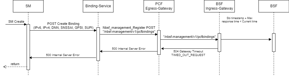

3.10 Detection and Handling of Late Arrival Requests
BSF receives requests from Ingress Gateway with the 3GPP headers. These requests help in detecting the response time for the BSF Management Service. The Ingress Gateway receives the following headers:
- 3gpp-Sbi-Origination-Timestamp- It contains the timestamp when the originating entity initiates the request
 - 3gpp-Sbi-Max-Rsp-Time- The header indicates the duration (expressed in milliseconds) during which the HTTP client waits for a response.
If the configuration for determining the late Arriving requests is enabled and BSF does not receive the required headers, the requests are valid and processed. The call flow will continue as normal.
BSF must be able to read the 3gpp-Sbi-Origination-Timestamp and 3gpp-Sbi-Max-Rsp-Time headers to respond to the request. Consider the following scenarios:
- If the sum of 3gpp-Sbi-Origination-Timestamp and 3gpp-Sbi-Max-Rsp-Time is less than the current time, the PCF service rejects the message with a 504 HTTP code and sends the message "TIMED_OUT_REQUEST".
 - If the request does not include either 3gpp-Sbi-Origination-Timestamp or 3gpp-Sbi-Sender-Timestamp, or 3gpp-Sbi-Max-Rsp-Time headers, then the request is accepted. There are no changes in the call flow with the inclusion of collision detection.
 - If 3gpp-Sbi-Max-Rsp-Time receives a negative value, the header is considered invalid. In this case, the service fallbacks to the default behavior and accepts the request irrespective of the 3gpp-Sbi-Origination-Timestamp or 3gpp-Sbi-Sender-Timestamp value.
Figure 3-10 Request Timeout in BSF
For handling and detection of Late Arrival and Collision Detection functionality in BSF, it is necessary that these headers and the new Custom header are transmitted from PCF to BSF.
Custom Header Enhancement adds the Time Stamp as a default value in the request and response custom headers with specific time formats and time zones. A valid function definition for timestamp in the configuration is: func: currentTime(time-format,time-zone).
Note: Here, only the GMT, IST, PST, and UTC time zones are to be considered for all 5G timestamps.
The only date format supported for the headers is RFC 7231: EEE, dd MMM yyyy HH:mm:ss.SSS zzz (Sun, 04 Aug 2019 08:49:37.845 GMT).
Any other format will result in a parse error which leads to not using the header for the feature (taking it as null value).

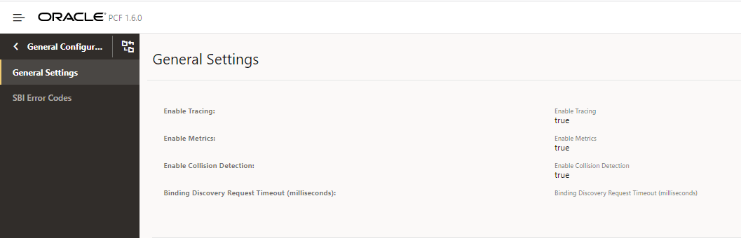

Figure 3-11 Enabling Collision Detection
You can enable or disable the collision detection feature using the REST API for BSF. Use the General Settings REST API to enable or disable this feature.
REST API Path: /oc-bsf-configuration/v1/general

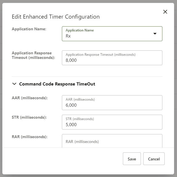

3.11 Support for Timer Configuration
BSF supports the configuration of Diameter interfaces or Rx interfaces timers for all the applicable Diameter messages. The timer configuration needs to be configured for AAR, RAR, STR, and ASR messages. The timer configuration is an option to configure the diameter response timeout value for diameter messages. If the timer value is not configured, then the BSF Diameter gateway works with the default value of 4000 milliseconds for AAR, RAR, STR, and ASR messages.
The Diameter response timeout or the timer value is configured per Diameter interface level. This value can also be configured per message level of the Diameter interface. The timer configuration needs to be configured for Authentication Request (AAR), Re-Auth-Request (RAR), Session-Termination-Request (STR), and Abort-Session-Request (ASR) messages.
For BSF, currently Diameter Rx interface is applicable. The response timeout value is configured using the Rx application level and its messages (AAR, RAR, STR, and ASR) level.

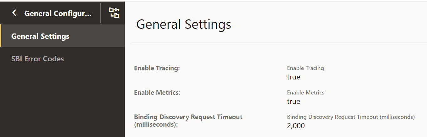

Enable
The timer configuration is a functionality supported by Binding Support Function configurations. You do not need to enable or disable this feature.
Configure
Figure 3-12 General Settings
Figure 3-13 Enhanced Timer Configuration
This configuration accepts interface level Diameter response timeout value. If the Diameter interface level timeout is configured, then the user is able to configure message level response timeout value for the corresponding Diameter interface.The response timeout value range for interface and message level is 3000 milliseconds to 2147483647 milliseconds.
Figure 3-14 Edit Enhanced Timer Configuration
- Configure using CNC Console: Perform the feature configurations on the General Configurations and Diameter Configurations page. For more information about the configurations, see General Settings and Diameter Configurations.
 - Configure using REST API: Perform the configurations using GET and PUT operations. For more information about REST API configuration, see Oracle Communications Cloud Native Core, Binding Support Function REST Specification Document.
Observe
To observe the timer configuration functionality, you can use metrics that are specific to BSF management service. For information, see Binding Support Function Metrics.

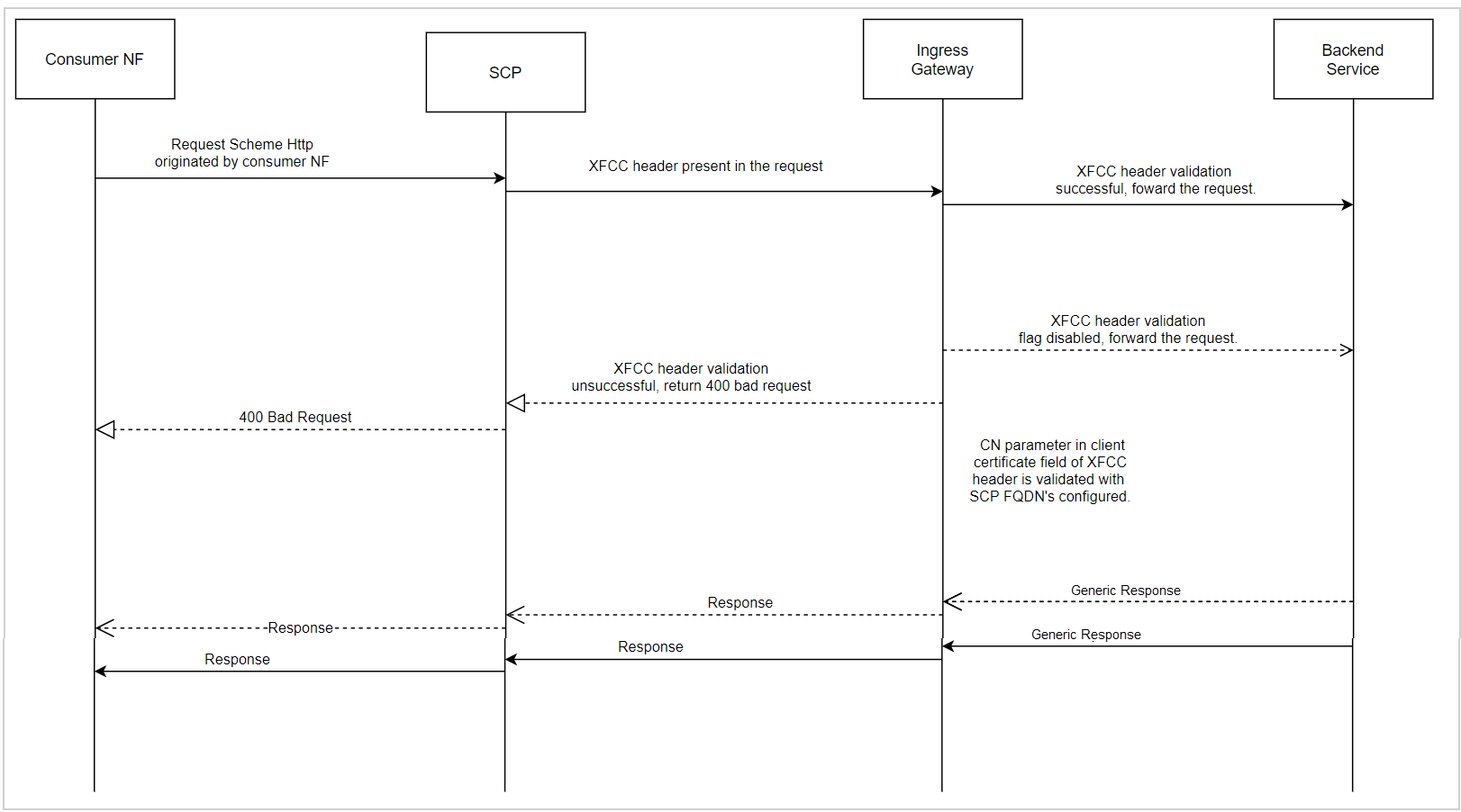

3.15 XFCC Header Validation
Overview
With XFCC Header Validation feature, Binding Support Function (BSF) as a producer, checks if the SCP that is sending the HTTP request is the same SCP that is configured in the BSF. BSF performs this check by comparing the FQDN of the SCP present in the “x-forwarded-client-cert” (XFCC) of http2 header with the list of FQDN of the SCPs configured in the PCF. This configured list contains all the host FQDNs resolved successfully via DNS-SRV as well as static SCPs. The header validation can be enabled at global as well as at the route level.
This feature is applicable only when SCP is deployed in the network topology.Configuring SCPs at BSF
To configure SCP, you need to customize custom.yaml
                at the time of deploying BSF.
xfccHeaderValidation:
    validation:
      enabled: false
      nfList:
        - scp.com
        - smf.com
        - amf.com
global:
      validation:
        enabled: false
        peerList:
          - name: scp.com
          - name: smf.com
          - name: amf.com
          - name: scp1.com
            enabled: true
          - name: scp2.com
          - name: scp3.com
            enabled: false
          - name: xyz.test.com
            enabled: true
            scheme: http
            type: virtual
          - name: abc.test.com
            enabled: true
            scheme: https
            type: virtual
          - name: xfcc.test.com
            enabled: false
            scheme: http
            type: virtualStatic SCP: To define an SCP instance statically, add the name and set enabled parameter to true in the peerList. If the enabled parameter is set to false for an instance, then it is not included in the list of configured FQDNs. If you do not specify enabled parameter then by default it is considered as true.
Virtual SCP: To define an SCP with virtual FQDN, add the name, scheme as http or https, type as virtual, and set enabled parameter to true. If the enabled parameter is set to false for an instance, then it is not included in the list of configured FQDNs.
Resolving FQDNs to find Authorized SCPs
dnsSrv:
    port: *svcAlternateRouteServiceHttp #Alternate-route port for scheme 'http'. Change is required if the scheme below changes.
    scheme: httpIf Alternate Route service is unable to resolve the configured virtual host, Ingress Gateway stores it in the list of failed FQDNs and reattempts the request at 300 s (default value configured for dnsResolutionInterval).
oc_ingressgateway_dns_resolution: This metric is pegged when DNS resolution for a given FQDN fails.oc_ingressgateway_dns_resolution_failure: This is a gauge metric that is triggered when DNS resolution for a given FQDN fails.
Handling Traffic Flow
- a single XFCC header present in the incoming request to IGW
 - multiple XFCC headers are present in the incoming request to IGW
The following figure describes the call flow for validation of a single XFCC header:
Figure 3-15 Call Flow Validation of Single XFCC Header
Table 3-5 Single XFCC Header Configuration
| Scenario | Condition | Action |
| Ensure that the XFCC Header validation parameter is enabled for the corresponding route match and the matchCerts count is configured correctly.Given XFCC Header validation parameter is enabled for the corresponding route match and matchCerts count correctly configured. | When the matchField parameter of the client certificate field in XFCC header matches with one of the configured NF FQDNs . | Forwards the request to a back-end microservice and receives a corresponding response. |
| Given XFCC header validation parameter is enabled for the corresponding route match and matchCerts count correctly configured. | When matchField parameter of client certificate field in XFCC header does not match with the configured NF FQDNs. | Return a 400 Bad Request response from
                                        Ingress Gateway.
                                           For more infirmation about error codes, see SBI Error Codes Configurations  |
| Given XFCC header validation parameter disabled for the corresponding route match. | NA | Forwards the request to the back-end microservice and receives a corresponding response. |
Example of a single XFCC header request:
 x-forwarded-client-cert:
                    By=http://router1.blr.com;Hash=468ed33be74eee6556d90c0149c1309e9ba61d6425303443c0748a02dd8de68;
                    Subject="/C=US/ST=CA/L=San Francisco/OU=Lyft/CN=Test Client";
                    URI=http://testenv1.blr.com;DNS=blr.com; DNS=www.blr.com
Figure 3-16 Call Flow Validation of Multiple XFCC Headers
Table 3-6 Multiple XFCC Headers Configuration
| Scenrio | Condition | Action |
| Given XFCC header validation parameter is enabled and matchCerts count correctly configured to validate across XFCC header certificates from the right most entry. | When matchField parameter of the corresponding client certificate field being validated against currently in the corresponding XFCC header matches with the NF FQDN's configured at Ingress Gateway. | Consider the request as a valid request and forward the request to the back-end micro-service and receive a corresponding response. |
| Given XFCC header validation parameter is enabled and matchCerts count correctly configured to validate across XFCC header certificates from the right most entry. | When matchField parameter of client certificate field in corresponding XFCC headers do not match with the NF FQDN's configured at Ingress Gateway for the corresponding matchCerts count. | Consider the request as an invalid request and
                                    return a 400 Bad Request response from IGW.
| Given XFCC header validation parameter is enabled and matchCerts count -1. | NA | Consider the request as valid request and match against the corresponding match field in all XFCC headers, if validation successful then forward the request else return 400 BAD Request. |
| Given XFCC header validation parameter is disabled. | NA | Forward the request to back-end microservice and receive a corresponding response. |
Example of multiple XFCC header request:
x-forwarded-client-cert:By=http://router1.blr.com;Hash=468ed33be74eee6556d90c0149c1309e9ba61d6425303443c0748a02dd8de68;
                        Subject="/C=US/ST=CA/L=San Francisco/OU=Lyft/CN=nf1.com";
                        URI=http://testenv1.blr.com; DNS=nf8.com; DNS=nf1.com; DNS=nf6.com,
                        Subject="/C=US/ST=CA/L=San Francisco/OU=Lyft/CN=nf10.com";
                        URI=http://testenv1.blr.com; DNS=nf10.com; DNS=nf8.com; DNS=nf9.com,
                        By=http://routexr1.blr.com;Hash=468ed33be74eee6556d90c0149c1309e9ba61d6425303443c0748a02dd8de68;
                        Subject="/C=US/ST=CA/L=San Francisco/OU=Lyft/CN=nf4.com";
                        URI=http://testenv1.blr.com; DNS=nf9.com;
                    DNS=nf4.com;DNS=nf1.com
Managing XFCC Header Validation
- Global Level: To enable or disable the XFCC header validation feature, set the value of the ingress-gateway.global.xfccHeaderValidation.validation.enabled to true or false respectively.
 - Route Level: To enable or disable the XFCC header validation
                    feature at route level, set the value of the xfccHeaderValidation.validationEnabled under routesConfig to
If the xfccHeaderValidation.validationEnabled parameter is defined at route level, then the configuration takes precedence over global configuration.For instance, if you want to enable XFCC header validation for selected routes, then set the global parameter as false and make route specific configuration to true.global: xfccHeaderValidation: validation: enabled: falseroutesConfig: - id: reverse_bsf_service uri: http://{{ template "service-prefix" . }}-bsf-management:{{ .Values.global.servicePorts.bsfManagementServiceHttp }} path: /nbsf-management/** order: 1 metadata: xfccHeaderValidation: validationEnabled: true
For more information about setting the parameter values, see section "XFCC Header Validation Configuration" in Oracle Communications Cloud Native Binding Support Function Installation Guide.
Configure
You can configure the parameter for XFCC Header Validation by updating the custom-values.yaml file for BSF. For more information about configuring the parameter value, see the "XFCC Header Validation Configuration" section in Oracle Communications Cloud Native Binding Support Function Installation Guide.
Observe
To observe the XFCC header validation functionality, you can use metrics that are specific to Ingress Gateway. For information, see Ingress Gateway Metrics.
Configuring Error Codes

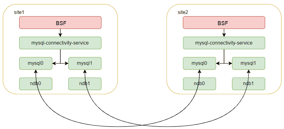

3.16 Georedundancy Support
The Cloud Native Core (CNC) architecture supports Geographically Redundant (Georedundant) BSF deployments to ensure high availability and redundancy. It offers a two or three sites georedundancy to ensure service availability when one of the BSF sites is down.
- All the georedundant sites must have Helm and REST based configurations except for NF InstanceId, BSF Endpoint, and port.
 - The georedundant BSF sites must be reachable from NFs or Peers on all the sites.
 - The same NFs or Peers must not communicate to other georedundant BSF sites simultaneously for the same session.
 - All the sites must register with NRF independently and work in an active state.
 - All BSF instances share the Session State data by using the DB Tier replication service. This enables service continuity during the failure of any of the sites.
 - The NFs in a given site can discover BSF instances through NRF. However, local configurations such as DNS SRV or static configuration are required to determine the primary and secondary or alternate BSF configuration. When the primary instance is available, the NFs send service requests to the primary instance.
 - NRF always reflects current functional status of a given BSF instance. Thus, during the failure of a given BSF instance, the value of NfStatus is updated to SUSPENDED by either NRF or BSF instance. Therefore, when NF detects failure of primary instance due to error response or status notification from NRF, the NF redirects its traffic to the secondary instance, until the primary instance becomes available again.
BSF supports the following types of georedundant deployment:
Two-Site Georedundancy Deployment
The following diagram depicts the topology for two-site georedundant BSF deployment:
Figure 3-17 Two-Site Georedundancy
After the second site instance of the cnDBTier is created, you can establish the two site georedundant connections that provide bi-directional data replication between both sites. Therefore, when the records are updated at one site, these changes are replicated to the other remote site in real-time. These updates can be creating, changing, or deleting a record.
Three-Site Georedundancy Deployment
The following diagram depicts the topology for three site georedundant BSF deployment:
Figure 3-18 Three-Site Georedundancy
In case of three site georedundancy, bi-directional replication is established from each site to the other two sites. The database updates from each site are replicated to the other two sites over the replication channel.
- In case of a single site failure, the remaining two sites keep establishing the bi-directional replication.
 - No action is required in case of a site failure.
 - Requires 4 SQL pods and 2 rep-svc pods at each site

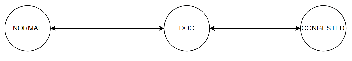

- Determine the pod congestion state
 - Trigger Congestion Control
Determining Pod Congestion State
- Normal
 - DOC (Danger of Congestion)
 - Congested
Figure 3-19 Congestion states
- Calculate the congestion state for the following resources:
- Queue: Compare the count of pending messages against the configured pending messages threshold for each congestion state (DOC, CONGESTED).
 - CPU - The congestion state for CPU usage is
                                calculated by comparing the CPU usage of the container (monitored
                                using cgroup parameter - cpuacct.usage that provides current cpu usage in
                                nano seconds) with the configured threshold. The following formula
                                is used to calculate CPU usage:
 - Memory - The congestion state for memory usage is
                                calculated by comparing the memory usage of the container with the
                                configured threshold. The following formula is used to calculate
                                memory usage:
where memory limit is monitored using memory.limit_in_bytes cgroup parameter and current memory usage is monitored using memory.usage_in_bytes cgroup parameter.
 - Based on the congestion state of resources, the congestion
                        state for the pod is set to the maximum of congested states. The following
                        table describes how the state of the pod is evaluated for various
                            scenarios:

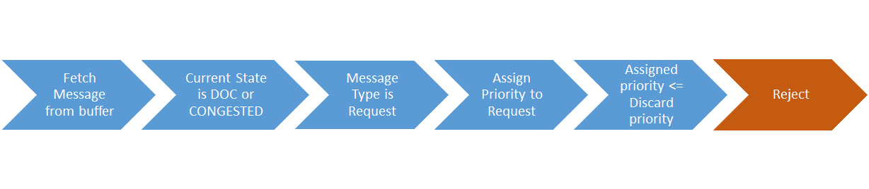

Triggering Congestion Control
Congestion control does not apply to response messages as they are always accepted.Figure 3-20 Process flow for triggering congestion control
For priority based load shedding to happen, the load rule configured for current congestion state is taken into consideration. If there is no rule configured for a congestion state, the request is accepted by default. While defining load rules, the user can customize the result to reject the request. However, to reject requests from backend peers, the result code is always DIAMETER_TOO_BUSY.
Call Flow
Table 3-9 Priority Rules
| Message | Priority |
| Default | 6 |
| RAR | 10 |
For this call flow, discard priority is set as 10 for DOC and Congested state. The resulting code for rejecting request messages is set as DIAMETER_UNABLE_TO_COMPLY, that is applicable only for external peers.
Figure 3-21 Call flow diagram for Diameter Congestion Control
- When the Diameter Gateway is in DOC or Congested state, receives a RAR request, the priority is compared against discard priority. Since both message priority and discard the priority values are the same, the message is rejected with the DIAMETER_UNABLE_TO_COMPLY result code.
 - When the Diameter Gateway is in DOC or Congested state, receives AAR request, the priority is compared against discard priority. Since no priority rule is configured for this message request, the message is accepted with the DIAMETER_SUCCESS result code.

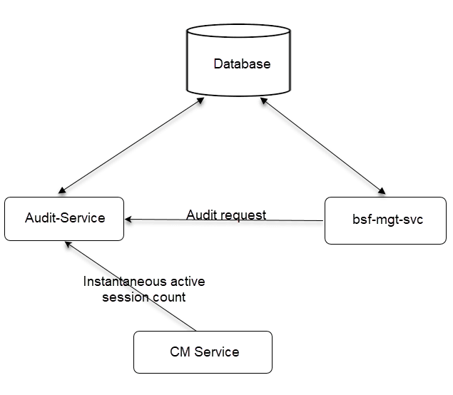

3.24 Handling Stale Session in BSF
Overview
A session binding on BSF is considered as stale when the PCF binding is successfully registered on BSF but has no corresponding session on PCF. When you enable stale session handling feature, the Audit service detects stale sessions automatically at regular intervals.
During the audit, if the audit service finds records with a binding age greater than the configured value (default value is 3600 minutes), it marks such records as suspected stale and initiates a request to notify the BSF management service. Depending on the feature configurations, BSF may query PCF to confirm if the pcfBinding records are stale. If PCF confirms the record as stale, then BSF removes it from its local database. However, if PCF sends 2xx in the response, then BSF updates the last access time for the associated pcfBinding record.
If the audit service finds a pcfBinding record with binding age greater than the maximum binding age (default value is 7200 minutes), it notifies the BSF Management service. On receiving the notification, BSF deletes the specified record from its database.
For georedundant BSF deployments, binding records are replicated to other redundant sites after the audit cycle is complete. Logs are published when audit service detects and removes stale sessions.

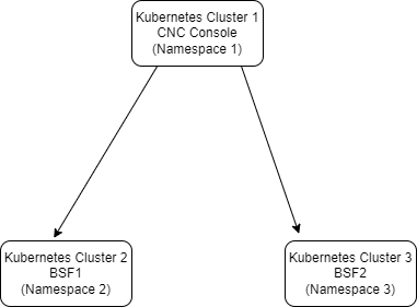

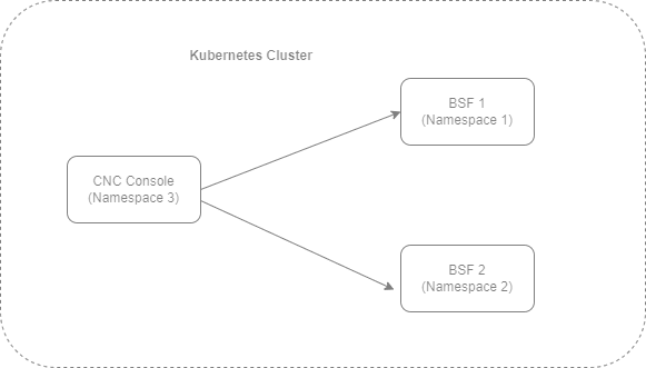

3.25 Support Multiple Cluster Deployment at CNC Console
The CNC Console supports both single and multiple cluster deployments.
In a single cluster deployment, the CNC Console can manage NFs and Oracle Communications Cloud Native Core, Cloud Native Environment (CNE) common services deployed in the local Kubernetes clusters.
In a multiple instances deployment, the CNC Console can manage multiple BSF instances and CNE common services deployed within a Kubernetes cluster. For more information about single and multiple cluster deployments, see Oracle Communications Cloud Native Core, Cloud Native Configuration Console Installation, Upgrade, and Fault Recovery Guide.
The following image represents a Kubernetes cluster with one instance of CNC Console and two instances of BSF. The single instance of the CNC Console is configuring two instances of BSF with different namespaces.
Figure 3-22 Support for Multiple Instance Deployment
With the support of multicluster deployment, BSF deployed in multiple Kubernetes clusters can be accessed using CNC Console. In a multicluster deployment, the CNC Console can manage BSF and OCCNE common services deployed in the remote Kubernetes clusters.
The following image represents multiple Kubernetes clusters with one CNC Console and two BSF deployments. The single instance of CNC Console is configuring two instances of BSF with different namespaces deployed in different clusters.
Figure 3-23 Support for Multicluster Deployment

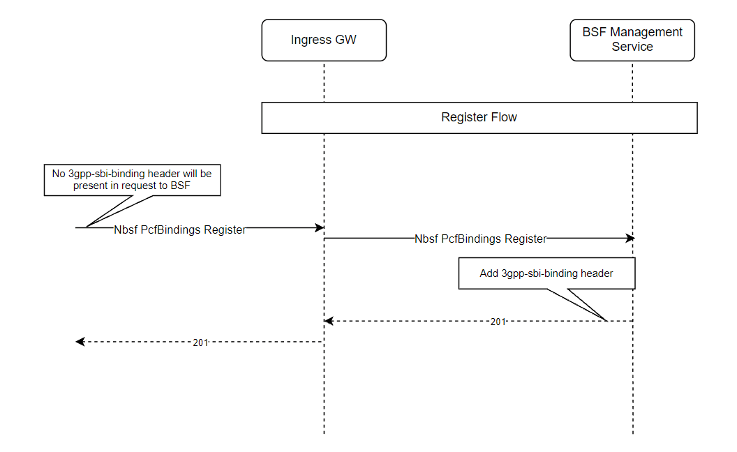

3.26 Support for 3GPP NF Sets and Binding Headers
Oracle Communications Cloud Native Core Binding Support Function supports the 3GPP NF Sets and Binding Headers in Model-B (Direct communication) and Model-C (Indirect communication). Using this feature, BSF can construct and send a binding header in the response messages to PCF for successful call processing.
Since BSF is a producer NF, it does not send any notifications to consumer NFs. BSF sends an HTTP request message only to NRF for management purpose.NF Set: NF set is a group of interchangeable NF instances supporting similar services and network slices. In an NF set, the NF instances can be geographically distributed, but have access to the same context data. The NF instances can be deployed in such a pattern so that several instances are present within an NF set to provide distribution, redundancy, and scalability as a set. The NF instances of an NF set are equivalent and share the same MCC, MNC, NID (for SNPN), NF type, and NF Set ID.
Binding Headers: The Binding headers indicate the suitable target NF producer instance for NF service instance selection, reselection, and routing of subsequent requests associated with a specific NF producer resource or context. It allows the NF producer to indicate that the NF consumer, for a particular context, should be bound to an NF service instance, or NF set depending on local policies. Binding can also be used by the NF consumer to indicate the suitable NF consumer instances for notification target instance reselection and routing of subsequent notification requests, associated with a specific notification subscription.
Table 3-14 Supported Headers
| Header Name | Description |
| 3gpp-Sbi-Binding |
                                     This header is used to communicate the binding information from an HTTP server for storage and subsequent use by an HTTP client. This header contains a comma-delimited list of Binding Indications from an HTTP server for storage and use of HTTP clients. The absence of this parameter in a Binding Indication in a service request is interpreted as "callback". Note: In the current release, the following
                                    are not supported:
Binding Support Function supports the NF Set and Binding Header functionality in all SBI interfaces.
Example
Figure 3-24 Example of NF Set and Binding Header in BSF
The above call flow diagram describes a scenario where PCF sends a request
            to register PcfBindings towards the BSF Management service through Ingress Gateway. The
            register request does not contain a 3gpp-sbi-binding header.
Once the request is received at BSF, the BSF Management service adds
                3gpp-sbi-binding to the response and sends it back to the PCF with
            HTTP status code 201.
If the user does not want to add a binding header to response messages, then it can be configured through CNC Console or REST APIs for BSF.

3.28 Support for Active Sessions Counter
Active sessions are the unique PCF binding sessions in every BSF instance.
The active sessions count also includes stale sessions until BSF removes it from its local database.
For more details on how stale sessions are handled, see Handling Stale Session in BSF.
Figure 3-25 Retrieving Active Sessions Count
The Audit-Service periodically counts the simultaneous unique active sessions, over a configurable period of time. The default value of the time period is set to 15 mins. The time period can be configured to any value between 1 to 60 minutes.
The bsf-mgt-svc requests the Audit-Service to count active
            sessions for configurable time period. The Audit-Service periodically finds active
            sessions count and publishes the count as a metric.
To get the instantaneous value of active sessions count, you can query the CM service, which internally calls Audit-Service to fetch the value.
Figure 3-26 Active Sessions Count
The audit registration process is used to register for audit registration as well as to enable active sessions counting.
The bsf-mgt-svc sends an audit registration request to the
            Audit-Service.
If the registration is successful, the Audit-Service responds with a 200 OK message.
If the registration fails due to any issue with the request, the Audit-Service responds with a Bad Request - 400 message.
If the registration fails due to any other internal reason while processing the request, the Audit-Service responds with an Internal Server Error - 500 message.
Audit registration is not required for CM Service to query the instantaneous active sessions count.
Once the registration is successful, the Audit-Service periodically finds active sessions count and publishes the count as a metric.
Figure 3-27 Get Instantaneous Active Sessions Count - Successful
The CM Service sends a Get maximum active sessions count
            request to Audit-Service.
If the CM Service call to Audit-Service is successful, it responds with a 200 OK message.
Figure 3-28 Get Instantaneous Active Sessions Count - Failure
If the CM Service call to Audit-Service fails, it responds with a 404 message.

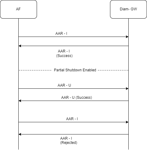

NORMAL State: If the Controlled shutdown operational state is NORMAL, then the Diameter Gateway processes the message as normal.

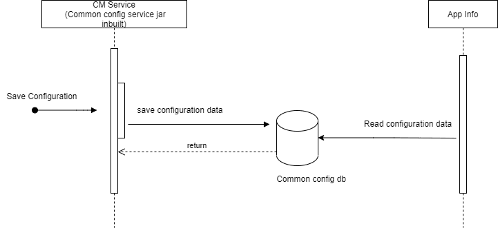

Figure 3-29 Call flow to Save Configuration Data
Figure 3-30 Call flow to Get the NF Score
The operator sends a request to CM service to get the score. CM service requests it to App-Info. App-Info queries and calculates NF-Score.
