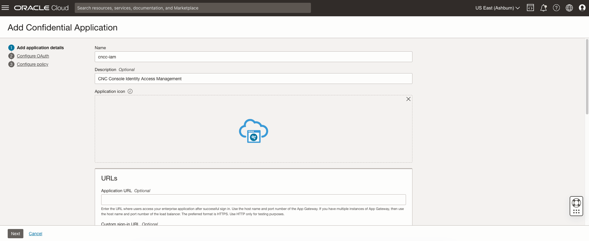

2.2.1.1.1 Create a Confidential Application Under OCI IAM
To create a confidential application under OCI IAM:
  1. Open the navigation menu and click Identity & Security. Under Identity, click Domains.
  2. Click the name of the identity domain that you want to work in. You might need to change the compartment to find the domain that you want. Then, click Integrated applications.
  3. Click Add application.
  4. In the Add application window, click Confidential Application, and then click Launch workflow.
  5. In the Add application details page, update the following fields:
    Figure 2-1 Add Application
    Add application
    1. Name: Enter a name for the confidential application. You can enter up to 125 characters. Ex: cncc-iam.
    2. Description: Enter a description for the confidential application. You can enter up to 250 characters.
  6. Click Next.

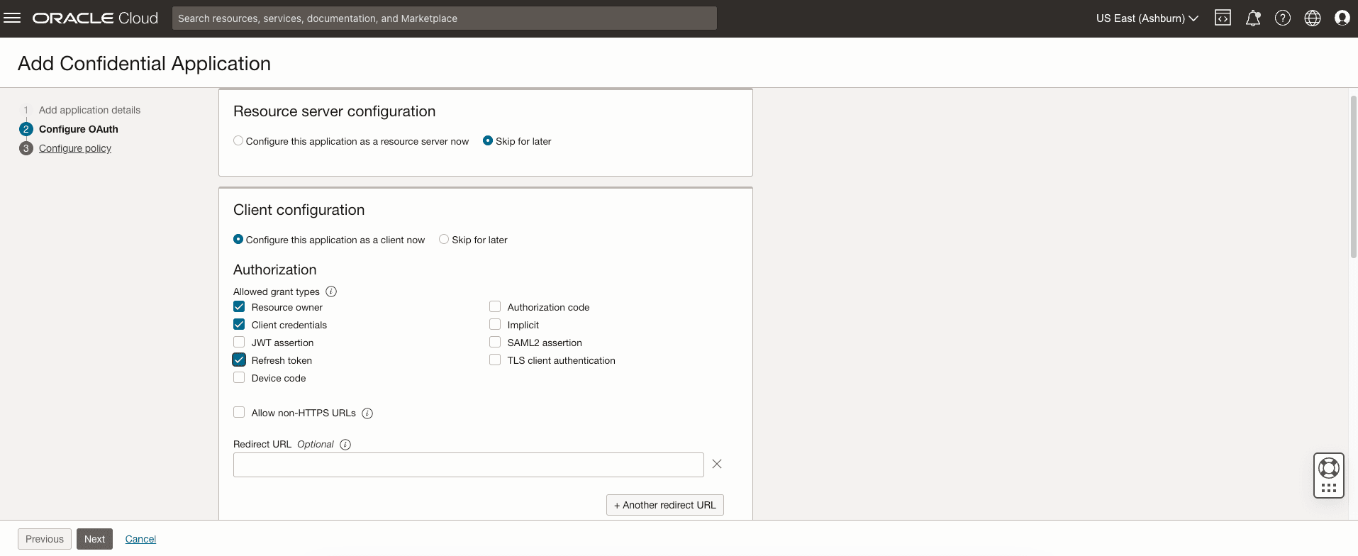

  7. On the Configure OAuth pane, click Configure this application as a client now. Update the following fields.
    1. Authorization Types: Within the configuration page, toggle on the Resource owner, Client Credentials and Refresh token.
      Figure 2-2 Authorization Types
      Authorization Types
    2. Client type: Select Confidential.
      Figure 2-3 Client Type
      Client Type
    3. Allowed Operations: Select Introspect.
    4. Bypass Consent: Enable it.
    5. Client IP address: Select Anywhere.
    6. Token Issuance Policy: From the available options, select All.

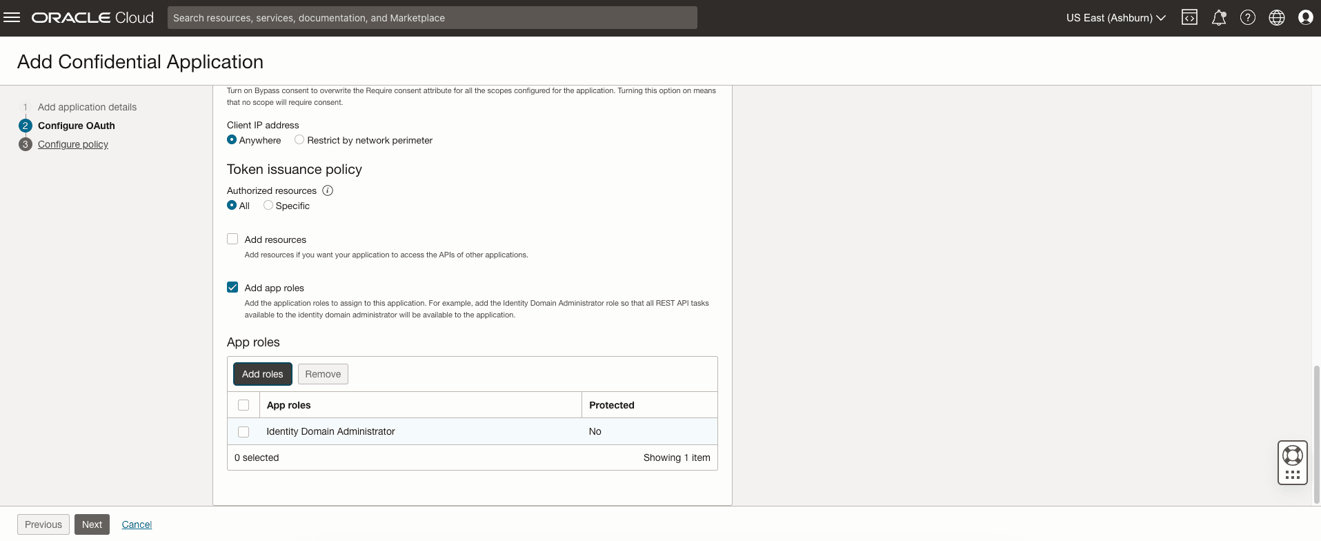

    7. Add App Role:
      Figure 2-4 Add App Roles
      Add App Roles
      • Click the Add roles button to open a side panel for additional configurations.
      • In this new panel, locate the role Identity Domain Administrator.
      • Confirm that the Identity Domain Administrator role is checked and added.
  8. Click Next.
  9. Click Finish.
    Figure 2-5 Finish
    Finish

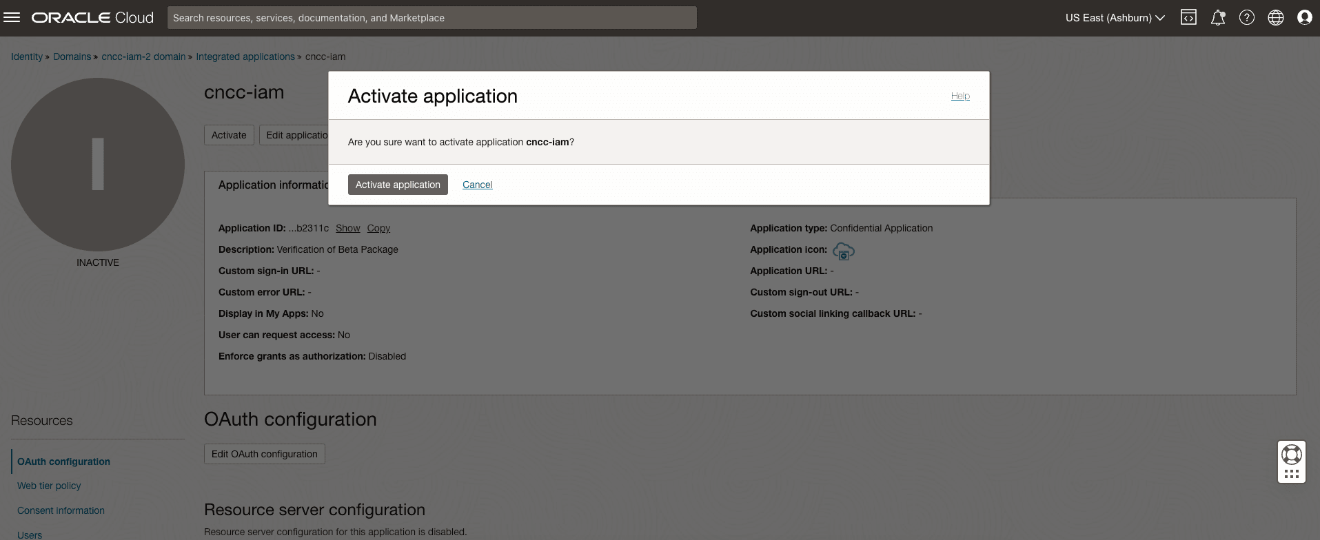

  10. At the top of the page, to the right of the application name, click Activate.
  11. In the Activate application dialog box, click Activate application.
    Figure 2-6 Activate Application

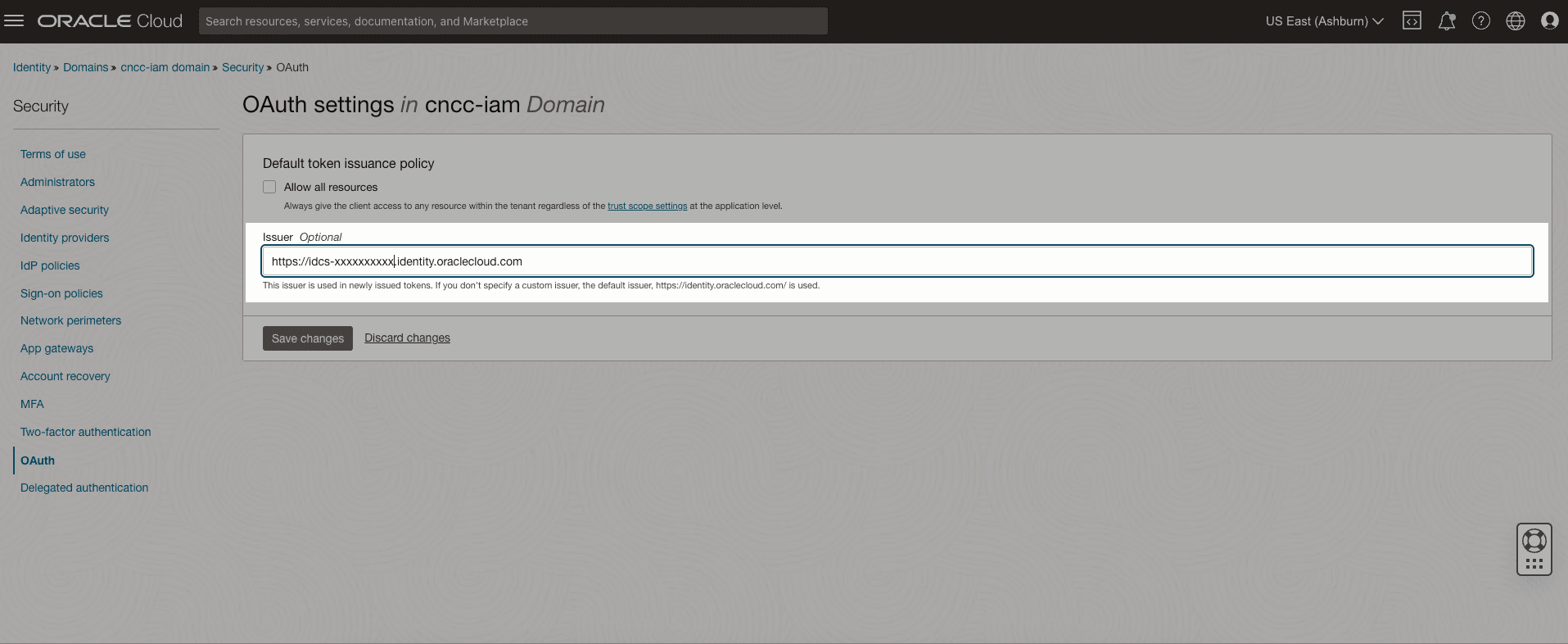

2.2.1.1.2 Update OCI IAM Issuer URL
To updated OCI IAM issuer url:
  3. On the domain details page, click Security.
  4. On the Security page, click OAuth.
  5. In the Issuer field, enter the domain URL. This issuer value is used in the newly issued tokens. For more information, see Accessing OCI IAM.
    Figure 2-7 Update Issuer
    Update Issuer
  • If the OCI IAM domain URL is with default ports 80 or 443, remove the port from the domain URL while updating the Issuer field. Please refer the attached screenshot.
  • The OCI IAM domain URL needs to be configured in mCnccIams while installing CNC Console.

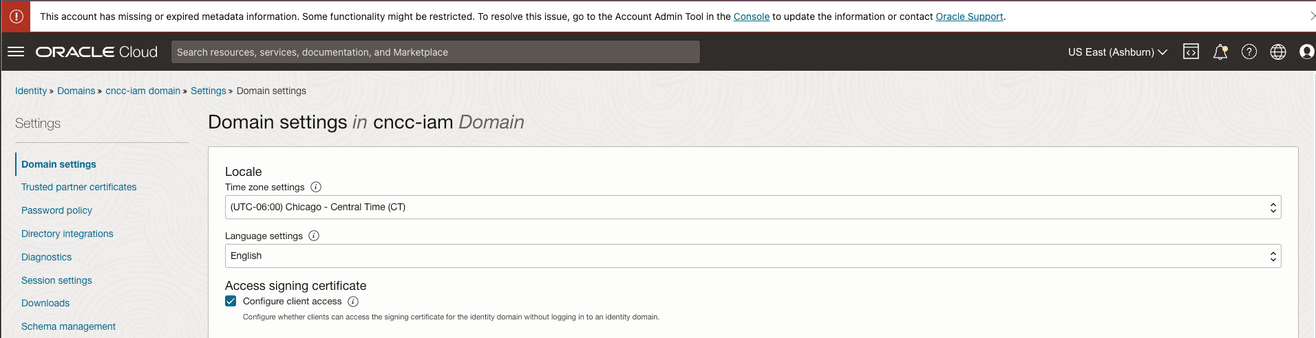

2.2.1.1.3 Enabling Access to the Signing Certificate
To allow CNC Console to access the signing certificate for the identity domain in IAM without logging in to an identity domain:
  3. Click Settings and then click Domain settings.
    Figure 2-8 Domain Settings
    Domain Settings
  4. Under Access signing certificate, select Configure client access to allow CNC Console to access the tenant signing certificate and the SAML metadata without logging in to the identity domain.
    If this option is cleared, CNC Console can access the tenant signing certificate and the SAML metadata only after they authenticate by logging in to the identity domain.
  5. Click Save changes.

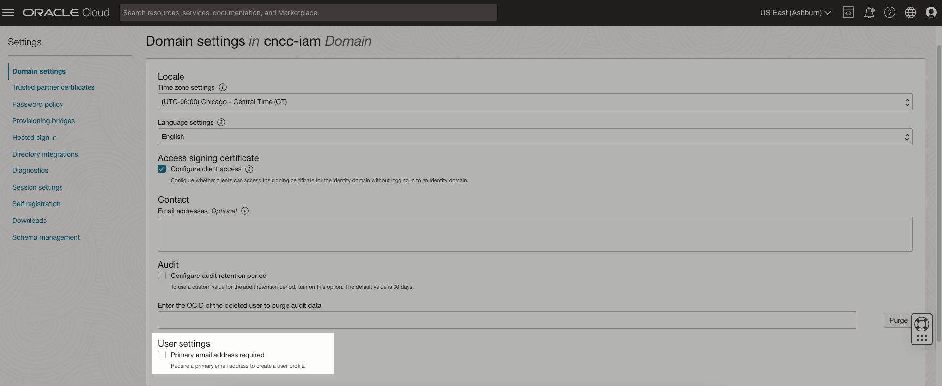

2.2.1.1.4 Disabling User's Email Address for Account Creation (Optional)
By default, Primary email address required is enabled for OCI IAM unless OCI IAM Admin disables it.
Set whether a primary email address is required to create user accounts in an identity domain in IAM.
  4. Under User settings, select or unselect Primary email address required.
Figure 2-9 User Settings
User Settings

    • The following annotations musr be used to assign Network Load Balancer IP to the CNC Console Services in OCI environment. <subnet-OCID> is the OCID of the public subnet (nf_lb_subnet).
      customExtension:
        lbServices:
          labels: {}
          annotations:
            oci.oraclecloud.com/load-balancer-type: "nlb"
            oci-network-load-balancer.oraclecloud.com/subnet: "<subnet-OCID>"
            oci-network-load-balancer.oraclecloud.com/security-list-management-mode: All
      For example:
      customExtension:
        lbServices:
          labels: {}
          annotations:
            oci-network-load-balancer.oraclecloud.com/subnet: "ocid1.subnet.oc1..aaaaaa....vdfw"
      For accessing subnet OCID, see the Getting Subnet's Details section in Oracle Cloud Infrastructure Documentation.
    • CNC Console must be deployed with HTTPs only in OCI. Non-HTTPs deployment of CNC Console is not supported in OCI.

For Non OCI postinstallation steps, see CNC Console IAM Postinstallation Steps.
For OCI postinstallation steps, see Postinstallation Steps for OCI IAM.

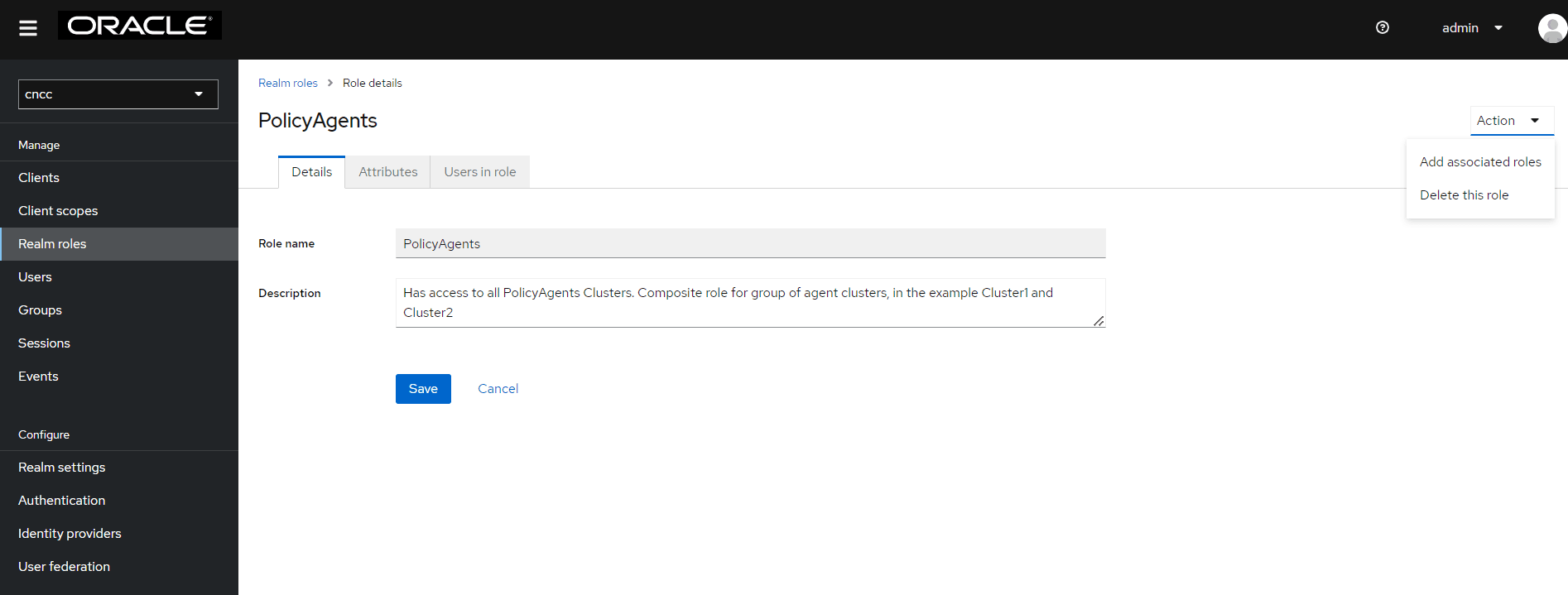

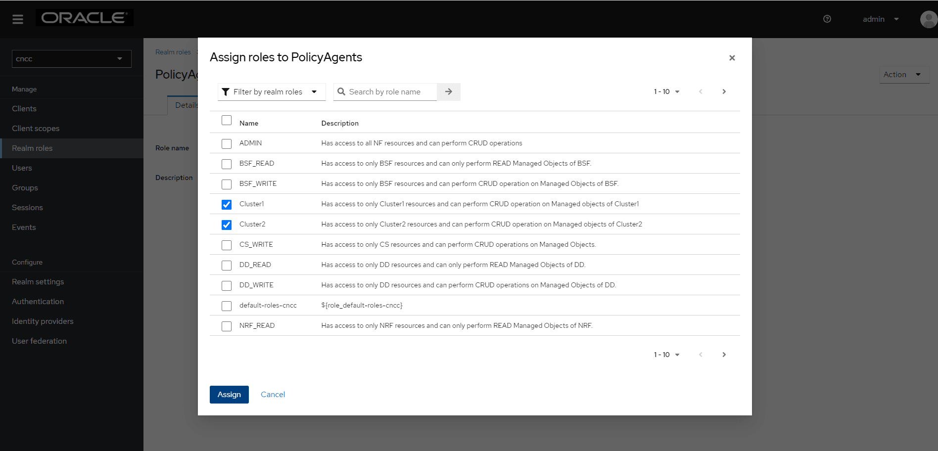

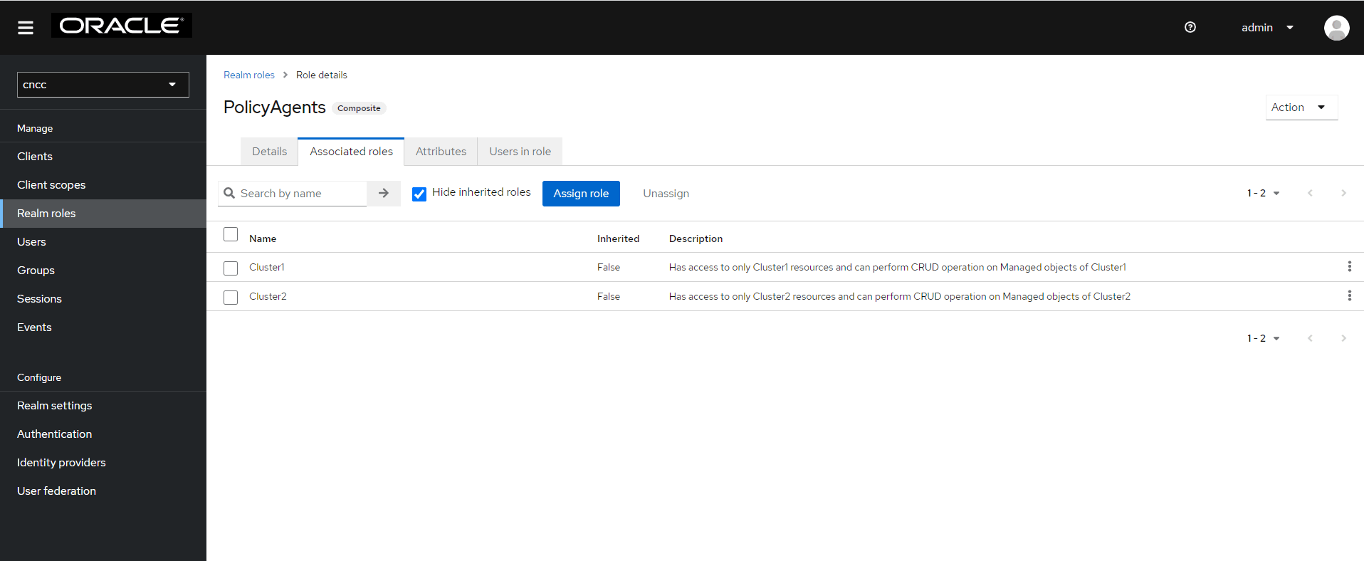

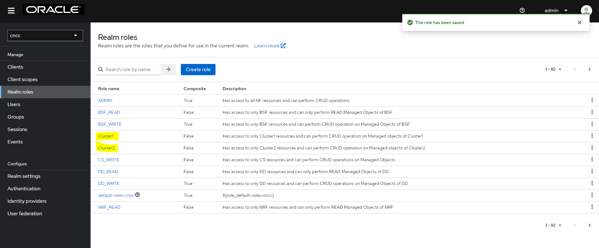

CNC Console multicluster deployment supports cluster specific roles. The user can create cluster roles in CNC Console IAM and assign cluster specific roles to the user similar to NF roles.
Operators must ensure that the cluster role name matches with the role name given in helm configuration.
  • For M-CNCC cluster role creation in M-CNCC IAM, the value of global.mCnccCores.id or global.mCnccCores.role name must be used.
  • For A-CNCC cluster role creation in M-CNCC IAM, the value of global.aCnccs.id or global.aCnccs.role name must be used.
    Cluster role names are case sensitive.

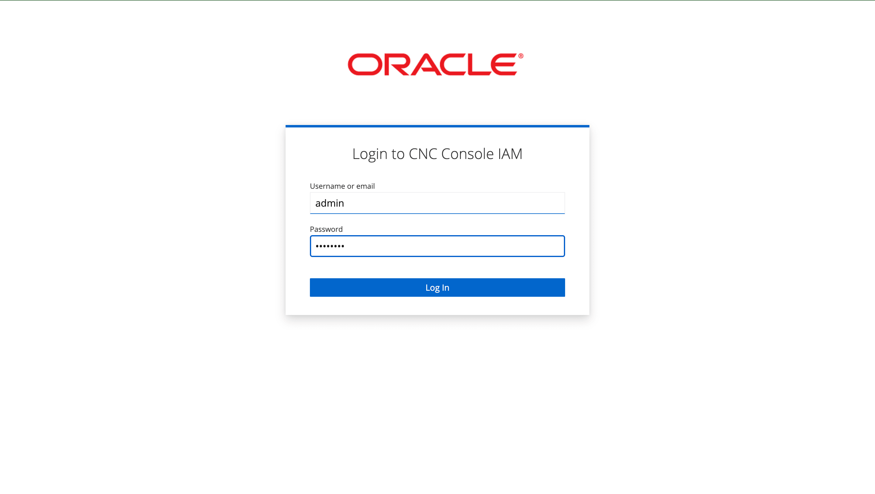

  1. Log in to CNC Console IAM Console using admin credentials provided during installation of CNC Console IAM.
    Format:
    <scheme>://<cncc-iam-ingress IP/FQDN>:<cncc-iam-ingress Port>
Node-IP and NodePort
Example:
http://10.75.xx.xx:30085/*
DNS Resolvable FQDN and NodePort
Example:
http://cncc-iam-ingress-gateway.cncc.svc.cluster.local:30085/*
External LB-IP and ServicePort
Example:
http://10.75.xx.xx:8080/*
DNS Resolvable FQDN and ServicePort
Example:
http://cncc-iam-ingress-gateway.cncc.svc.cluster.local:8080/*
Figure 2-10 Login

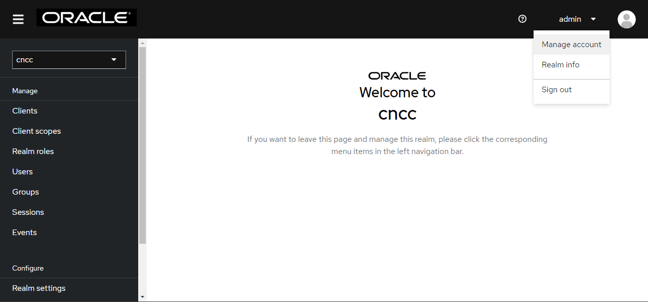

You must select CNCC from the Realm drop down on the left pane after logging in to CNC Console IAM.

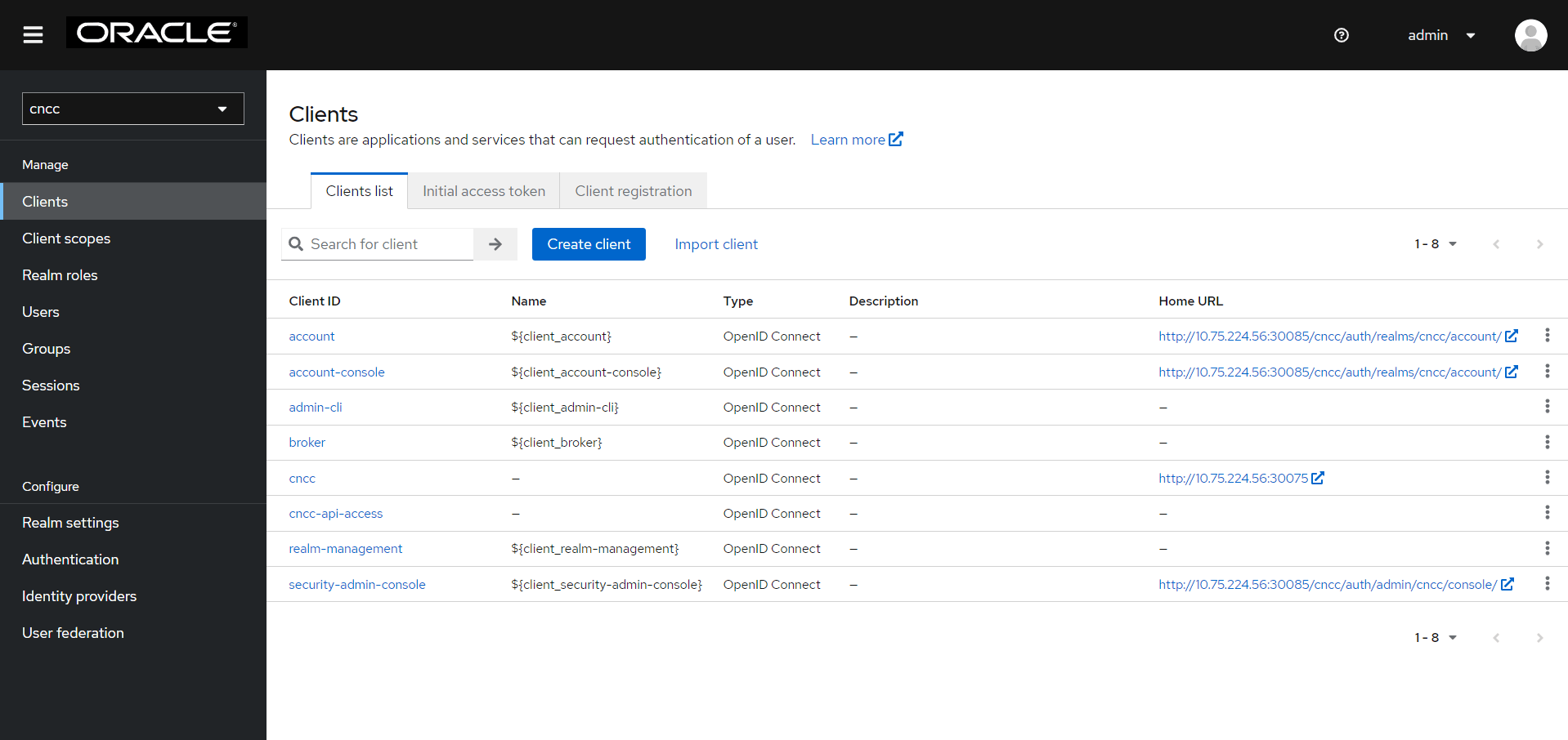

  1. Go to Clients option and click cncc.
    Figure 2-11 Clients Tab
    Clients Tab
  2. Enter CNC Console Core Ingress URI in the Root URIs field and Save.
    <scheme>://<cncc-mcore-ingress IP/FQDN>:<cncc-mcore-ingress Port>
    Redirection URL is prepopulated, only root URL needs to be configured as part of postinstallation procedure.

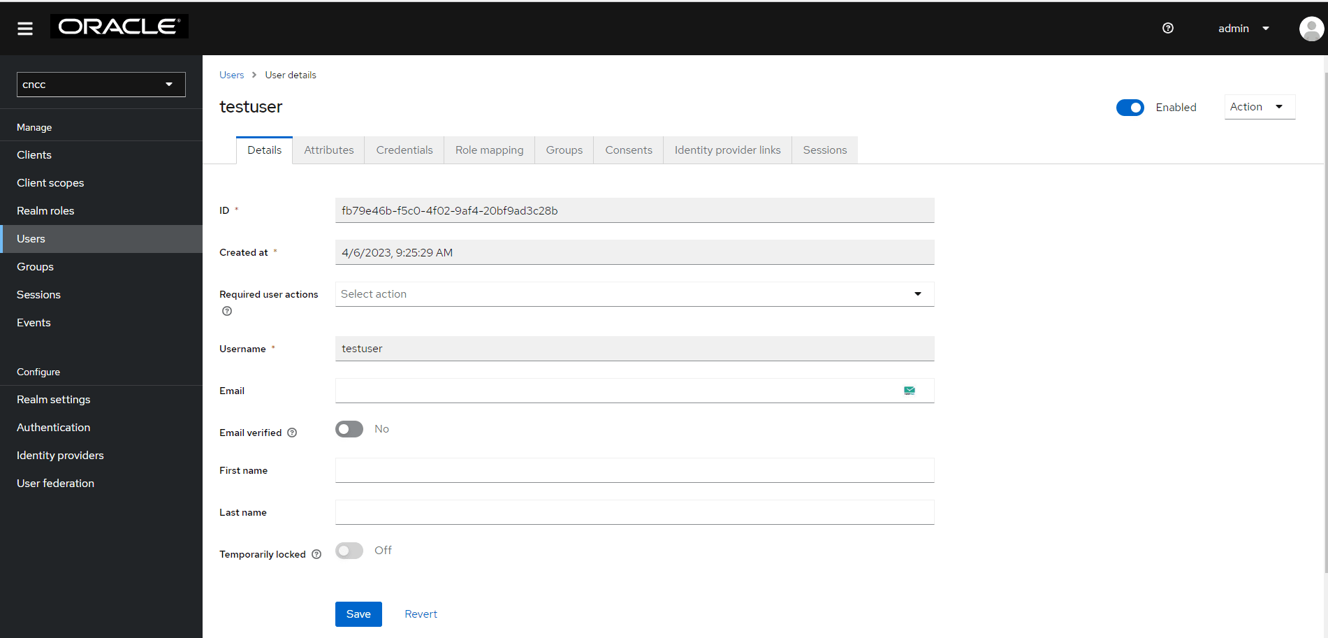

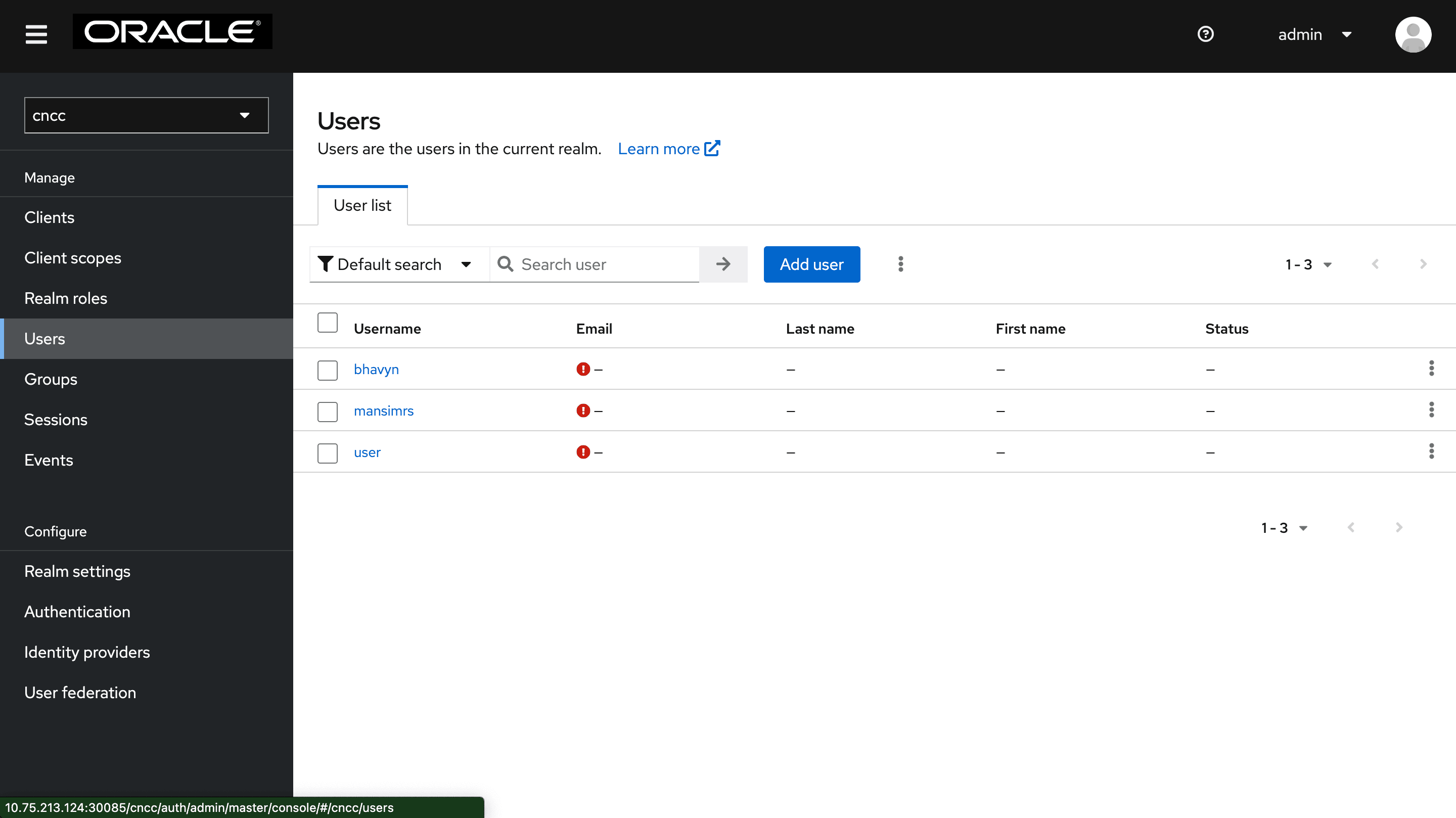

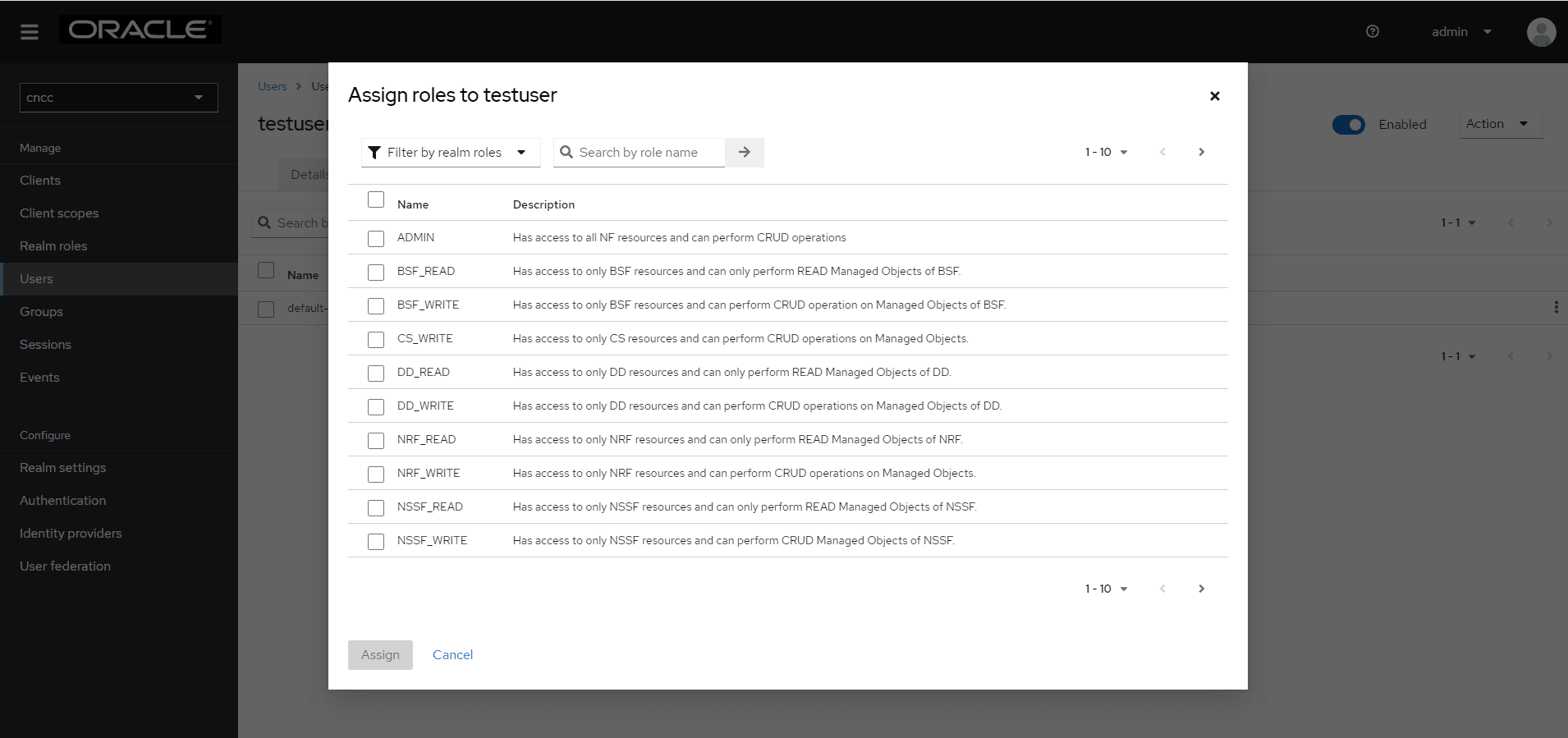

  3. Click Manage, click Users, and click Add user on the right pane.
    Figure 2-13 Add User
    Add User
  4. Add user screen appears. Add the user details and click Save.
    Figure 2-14 Save User
    Save User
  5. The user has been created and the user details screen appears.
    Figure 2-15 User Details
    User Details

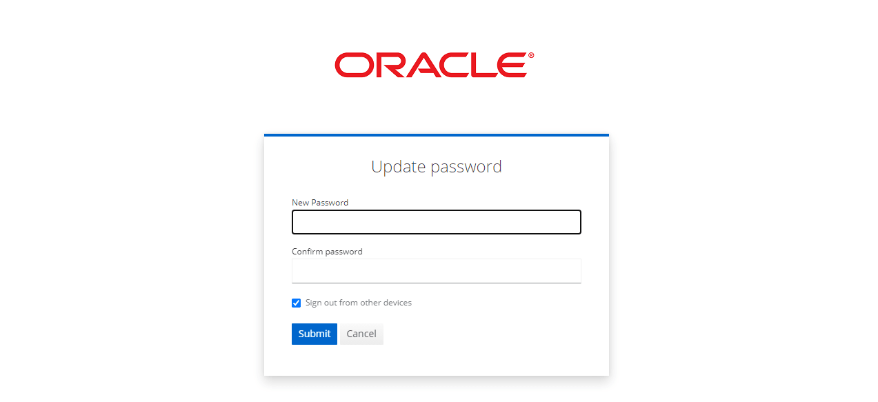

  6. For setting the password for the user, click the Credentials tab and set the password for that user.
    Setting Temporary flag to ON prompts the user to change the password when logging in to the CNC Console Core GUI for the first time.
    Figure 2-16 Set Password
    Set Password
  7. Navigate to the Role Mappings tab and assign roles to the user.
    Figure 2-17 Role Mappings
    Role Mappings

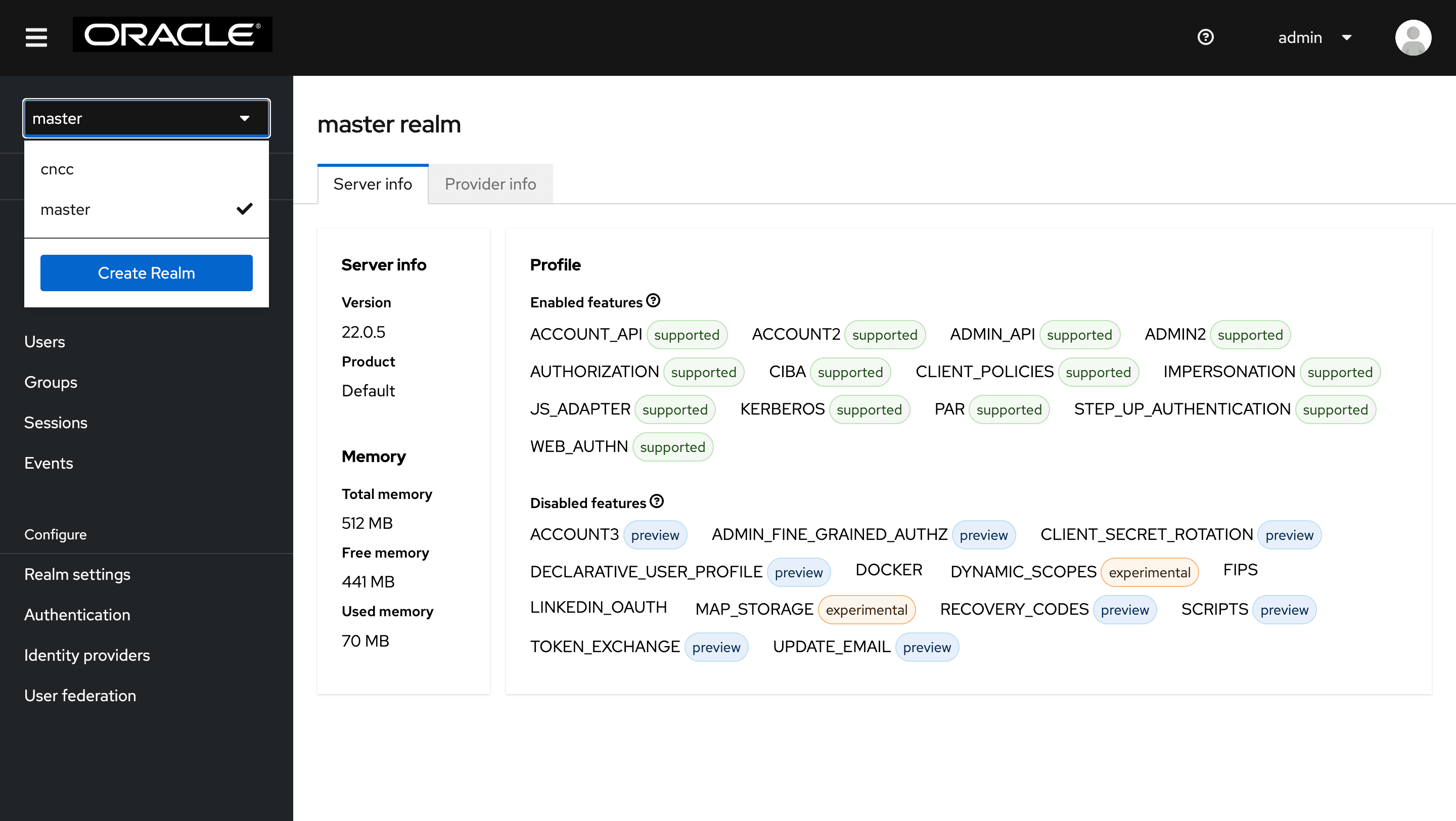

  8. Select Master Realm from the Realm drop down list.
    Figure 2-18 Master Realm
    Master Realm

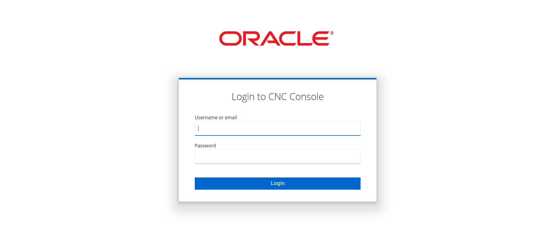

  10. Log in to CNC Console Core using the credentials of the user created earlier.
    Figure 2-20 CNC Console Core login
    img/cnc-console-core-1.9.0login.png

This section explains the steps to create the roles.
  1. Log in to M-CNCC IAM and click Realm Roles present on the left pane. The roles defined in the realm is displayed on the right pane.
    Figure 2-21 Realm Roles
    Realm Roles
  2. Click Create Role.The Create Role screen appears. Add the Role Name and click Save.
    Figure 2-22 Create Role
    Create Role
The user must ensure that the cluster role name matches the role name given in helm configuration.
  • For A-CNCC cluster role creation in M-CNCC IAM, value of global.aCnccs.id or global.aCnccs.role name must be used.
  • Cluster roles are case sensitive.
Composite Role Creation
CNC Console IAM provides an option to create composite (group) the roles. This section explains the steps to create the composite roles.
  1. Click Create Role. The Create Role screen appears. Add the Role Name and click Save.
    Figure 2-23 Add Role Name
    Add Role Name
  2. From the Action drop-down, select Add associated roles.
    Figure 2-24 Assign Role
    Assign Role
  3. This enables the Composite Roles functionality, and the Assign roles screen appears.
  4. Select the required roles from Realm Roles, and click Assign.
    Figure 2-25 Assign Roles
    Assign Roles
  5. The Associated roles tab appears in the Role details screen.
    Figure 2-26 Associates Roles
    Associated Roles
Here, the name "PolicyAgents" is used for composite role, that can be read as "PolicyAgentCnccs".
For more information about the Roles, see the Role Based Access Control in CNC Console section in Oracle Communications Cloud Native Configuration Console User Guide.

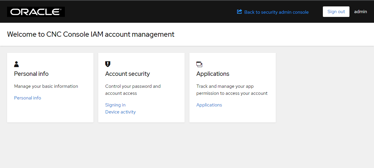

CNC Console provides support to change the password of CNC Console IAM:
  1. Log in to CNC Console IAM and click Admin present on the top right of the screen.
    Figure 2-27 Log in to CNC Console IAM
  2. Click Manage Account.
    Figure 2-28 Manage account
    Manage account

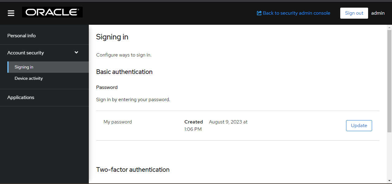

  3. Click Signing in Account security.
    Figure 2-29 Account Security
    Account Security
  4. Click Update.
    Figure 2-30 Update
    Update
  5. Update your password.
    Figure 2-31 Update Password
    Update Password
  6. Click Submit.
CNC Console User Password Reset
Only CNC Console admin can update the user password.

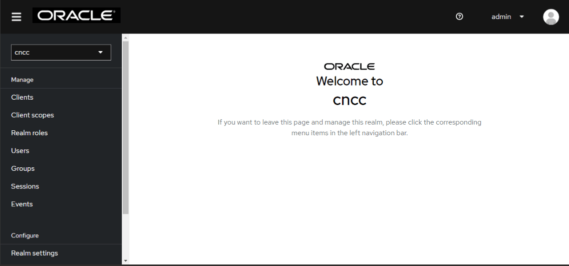

To reset CNC Console user password:
  1. Log in to CNC Console IAM.
    Figure 2-32 CNC Console IAM
    CNC Console IAM
  2. Select cncc realm.
    Figure 2-33 cncc Realm
    cncc Realm
  3. Select Users from menu on left.
    Figure 2-34 Users
    Users
  4. Click your desired user, and select credentials.
    Figure 2-35 Credentials
    Credentials
  5. Click reset password, enter your password, and then click Save.
    Figure 2-36 Reset Password
    Reset password
2.2.3.4 Postinstallation Steps for OCI IAM
2.2.3.4.1 Configure CNC Console Redirect URLs in OCI IAM
Once the CNC Console application is deployed in the OKE cluster you must configure the Redirect URL and Post-logout redirect URL in OCI IAM.
    Figure 2-37 Integrated Applications
    Intergrated Applications
  3. Click the application that you want to modify (for example: cncc-iam).
  4. Click Edit OAuth Configuration.
    Figure 2-38 Edit OAuth
    Edit Oauth
  5. Expand the Client configuration node.
  6. Update the following fields:
    Figure 2-39 Authorization
    Authorization
    1. Authorization Types: select thevResource owner, Client Credentials, Refresh token, and Authorization code checkboxes.
    2. Redirect URL: Application URL where the user is redirected after authentication. This field is mandatory.
      • Configure the following for CNC Console:
        /login/oauth2/code/cncc-iam
      • Template for redirect URL:
        For LoadBalancer IP and Port:
        https://<cncc-mcore-igw-lb-ip>:<port>/login/oauth2/code/cncc-iam
        For DNS resolvable FQDN and port:
        https://<cncc-mcore-igw-dns-resolvable-fqdn>:<port>/login/oauth2/code/cncc-iam
      • Example if port 80 or 443:
        For LoadBalancer IP and port:
        https://xxx.xxx.xx.xxx/login/oauth2/code/cncc-iam
        https://cncc-mcore-ingress-gateway.cncc.svc.cluster.local/login/oauth2/code/cncc-iam
      • Example if port is other than 80/443:
        https://xxx.xxx.xx.xxx:8443/login/oauth2/code/cncc-iam
        https://cncc-mcore-ingress-gateway.cncc.svc.cluster.local:8443/login/oauth2/code/cncc-iam

  8. If the application is not activated, , click Activate at the top of the page, to the right of the application name.
  9. In the Activate application dialog box, click Activate application.
