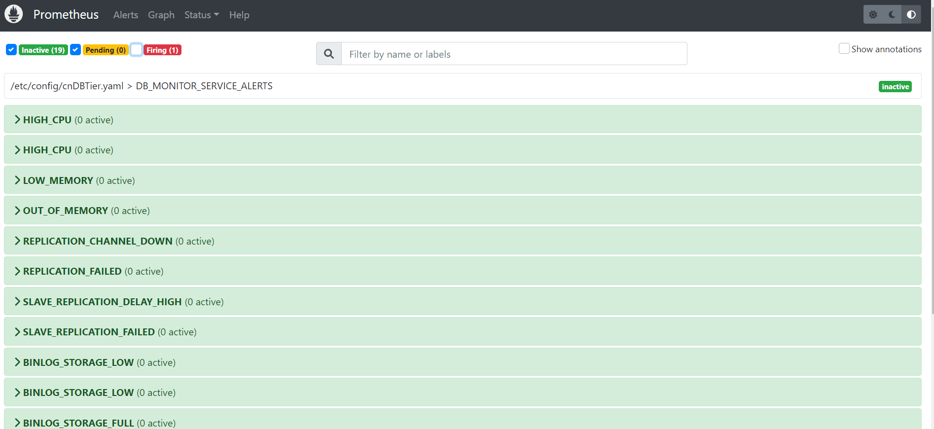

  5. On the Prometheus GUI, click Alerts to verify that all the alerts (NF Alerts) are visible.
    OSO Prometheus doesn't have any alerts of its own, therefore the GUI must appear empty initially. You can patch any NF alert rules in this section.
    The following image displays the alerts for cnDBTier:
    Figure 2-4 Prometheus GUI
    Prometheus GUI

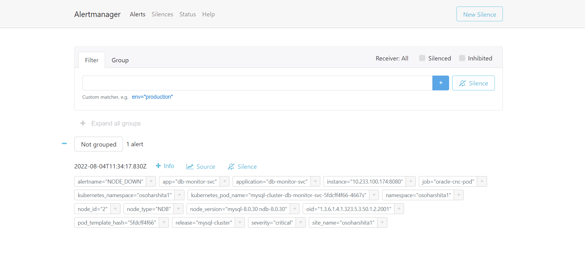

    After alerts are raised, the GUI must display the triggered alerts as shown in the following image:
    Figure 2-5 Prometheus GUI - Alerts

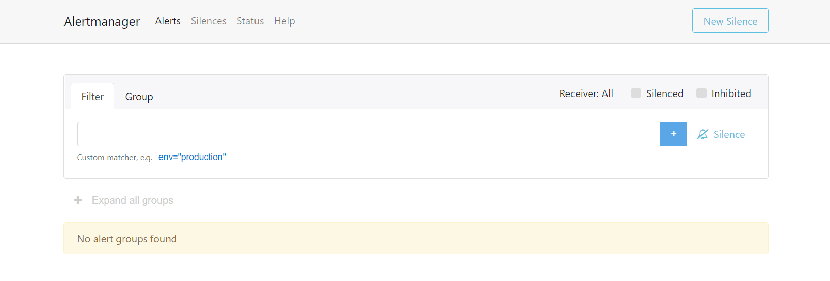

  6. Select Alerts tab on the Alertmanager GUI to view the triggered alerts as shown in the following image:
    Figure 2-6 Alertmanager - Alerts

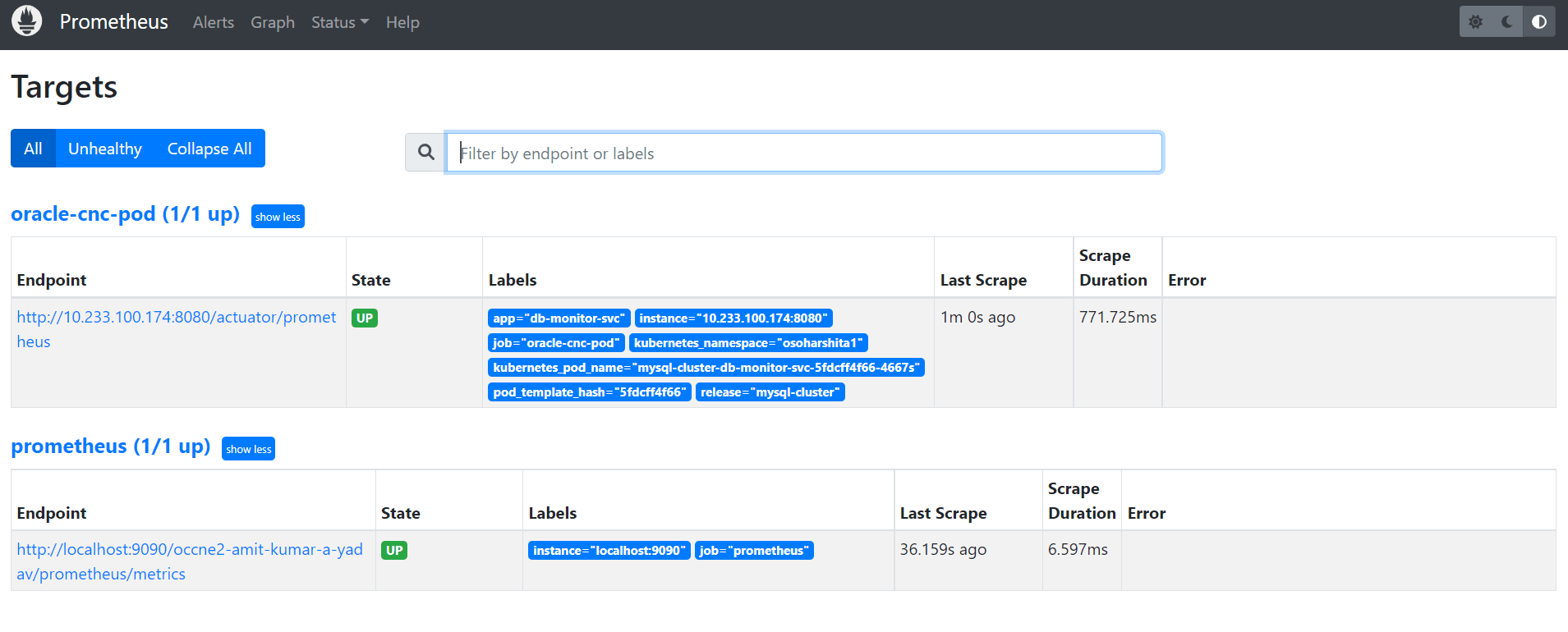

  8. On the Prometheus GUI, navigate to Status and then click Target to verify if the configured targets are displayed.
    The following image shows Prometheus targets that are being extracted:
    Figure 2-8 Prometheus Target
