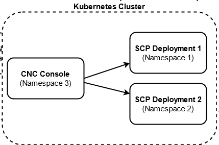

4.1 Support for Multicluster Deployment
The CNC Console supports both single and multiple cluster deployments.
In a single cluster deployment, the CNC Console can manage NFs and Oracle Communications Cloud Native Environment (OCCNE) common services deployed in the local Kubernetes clusters.
In a multicluster deployment, the CNC Console can manage NFs and OCCNE common services deployed in the remote Kubernetes clusters. For more information about single and multiple cluster deployments, see Oracle Communications Cloud Native Configuration Console Installation, Upgrade, and Fault Recovery Guide .
With the support of multicluster deployment, a single instance of the CNC Console can configure two or multiple instances of SCP deployments if both CNC Console and SCP instances are deployed in the same Kubernetes cluster with different namespaces.
The following image represents a Kubernetes cluster with one instance of CNC Console and two instances of SCP. The single instance of the CNC Console is configuring two instances of SCP with different namespaces.
Figure 4-1 Support for Multicluster Deployment

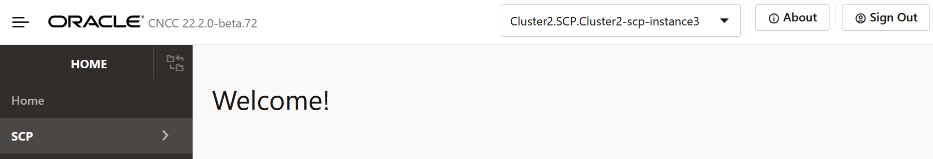

    The CNC Console Home page appears.
    Figure 4-2 CNC Console Welcome Screen
  5. In the upper pane, from the Please Select Instance drop-down list, select the required SCP instance.
    The SCP tab appears in the left navigation pane.
    Figure 4-3 Select NF Instance
    Select NF Instance
    The Please Select Instance drop-down list provides NF instances to configure corresponding NF features. You must select an appropriate SCP instance to configure SCP features. Alternatively, you can click one of the following interface elements on the Welcome screen:

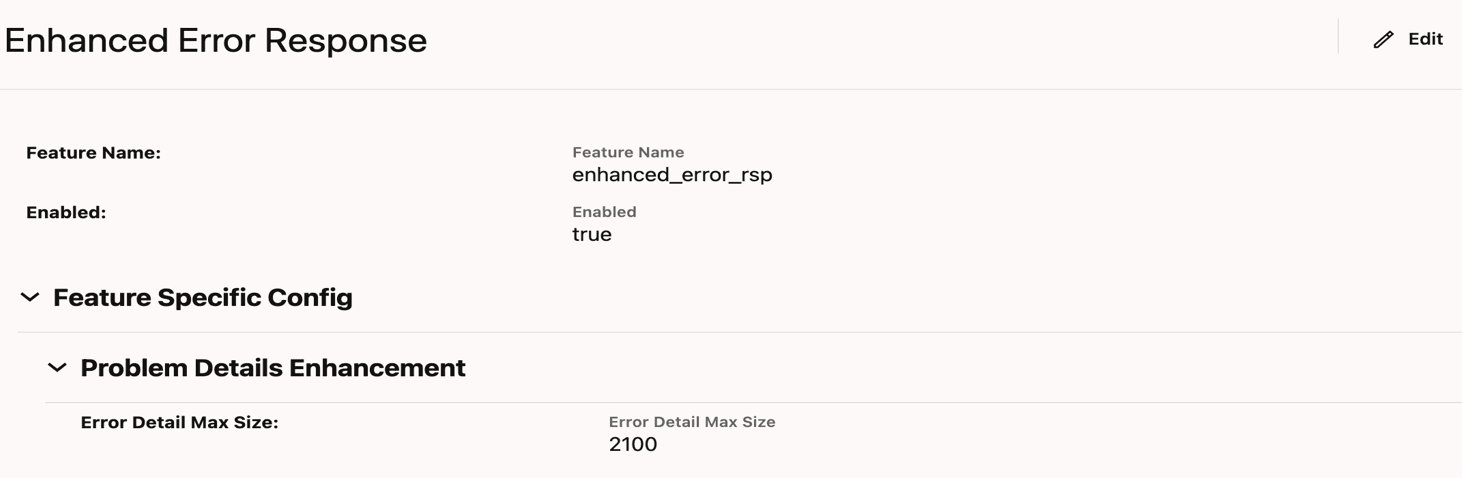

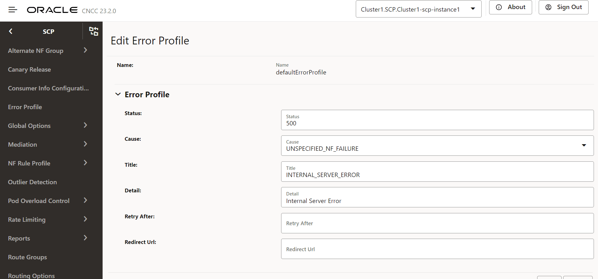

4.2.1.1 Configuring Error Response Enhancement
Perform the following procedure to enable or disable the Error Response Enhancement feature.
  1. From the left navigation pane, click the SCP tab, and then click the SCP Features tab.
  2. From the SCP Features list, click the Enhanced Error Response tab.
  3. On the Enhanced Error Response page, click the Edit icon.
    By default, the Enabled option is set to false for enhanced_error_rsp.
    Figure 4-4 Error Response Enhancement
  4. In the Error Detail Max Size, set the limit of the error string.
    This field manages the maximum length limit of the compiled error string in the detail parameter of problemDetails as described in "Configuring SCP Features" in Oracle Communications Cloud Native Core, Service Communication Proxy REST Specification Guide. SCP truncates the error string from end if the compiled string is greater than the maximum limit. The default value is 2100.
  5. Click Save.

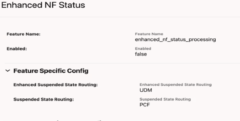

4.2.1.2 Configuring Enhanced NF Status Processing
Perform the following procedure to enable the support for creating or retaining SCP routing rules for NF Profiles with NF Status as SUSPENDED.
The Enhanced NF Status Processing feature is applicable only when nnrf-nfm (NRF Management) service is used as an audit service for SCP.
  1. In the left navigation pane, click the SCP tab, and then click the SCP Features tab.
  2. From the SCP Features list, click Enhanced Nf Status Processing.
  3. In the Enhanced NF Status section, click Edit.
    Figure 4-5 Editing Enhanced Nf Status Processing
  4. Set Enabled to true.
    By default, this option is set to false.
  5. In the Feature Specific Config section, configure the following fields as required:
    • Enhanced Suspended State Routing: Enter the list of valid NF types for Mode 3 routing.
    • Suspended State Routing: Enter the list of valid NF types for Mode 2 routing.
  6. Click Save.

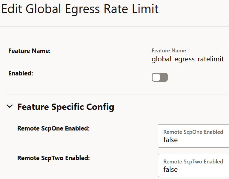

4.2.1.3 Configuring Global Egress Rate Limiting
Perform the following procedure to configure global egress rate limiting.
  1. In the left navigation pane, click the Global Egress Rate Limiting tab.
  2. In the Global Egress Rate Limit section, click Edit.
    The Edit Global Egress Rate Limit screen appears.
    Figure 4-6 Enabling the Global Egress Rate Limiting
  3. Set Enabled to true.
  4. In the Feature Specific Config section, configure the following fields:
    • Remote ScpOne Enabled: Set this field to true if you want to enable egress rate aggregation with the SCP instance as defined in the coherence.federation.remoteScpOne parameter of the ocscp-custom-values.yaml file. By default, this value is set to false.
    • Remote ScpTwo Enabled: Set this field to true if you want to enable egress rate aggregation with the SCP instance as defined in the coherence.federation.remoteScpTwo parameter of the ocscp-custom-values.yaml file. By default, this value is set to false.
  5. Click Save.

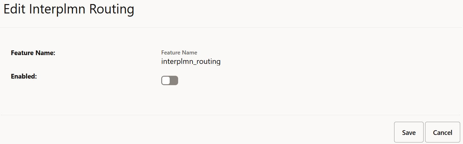

4.2.1.4 Configuring Support for 5G SBI Roaming
Perform the following procedure to configure support for 5G SBI roaming.
Ensure that one local and one remote PLMNs are configured before enabling this feature. To configure a remote PLMN, see Configuring SEPP Inter PLMN Routing. A local PLMN is configured at the time of SCP deployment or by editing the CUSTOM_ORACLE_SCP NF type as described in Configuring NF Rule Profile.
  1. In the left navigation pane, click the Interplmn Routing tab.
  2. In the Interplmn Routing section, click Edit.
    The Edit Interplmn Routing screen appears.
    Figure 4-7 Inter PLMN Routing
    Inter PLMN Routing
  4. Click Save.

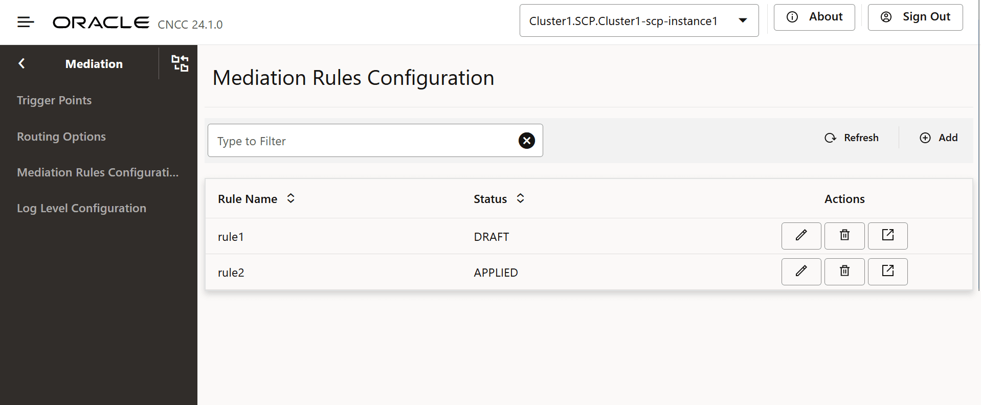

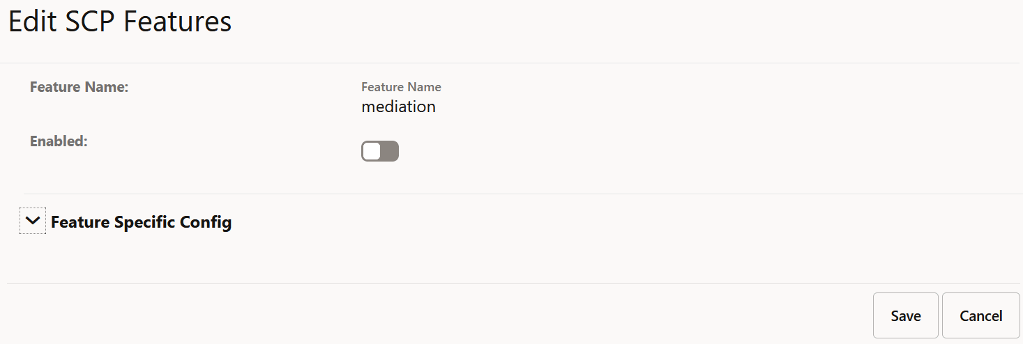

4.2.1.5 Configuring Mediation
Perform the following to configure mediation.
  1. In the left navigation pane, click the Mediation tab.
  2. In the Mediation section, click Edit.
    The Edit Mediation screen appears.
    Figure 4-8 Enable Mediation
    Enable Mediation
  4. Click Save.

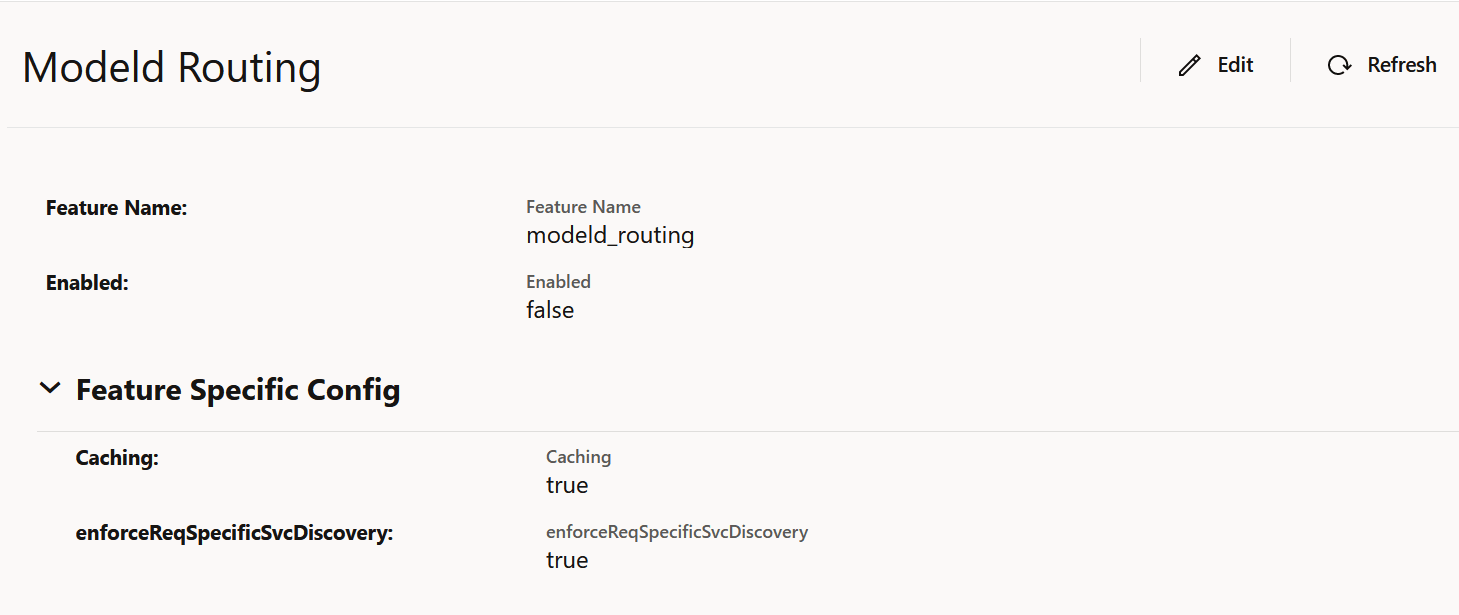

4.2.1.6 Configuring Model D Indirect 5G SBI Communication feature
Perform the following to configure Model D indirect 5G SBI communication feature.
  1. In the left navigation pane, click the Modeld Routing tab.
  2. In the Modeld Routing section, click Edit.
    Figure 4-9 Enabling ModelD Routing
    The Edit Modeld Routing screen appears.
  4. Set Caching to true or false to enable or disable caching to store discovery responses. By default, this option is set to true.
  5. Set enforceReqSpecificSvcDiscovery to true or false to to enable or disable NF Service specific Discovery Requests when possible. By default, this option is set to true.
  6. Click Save.

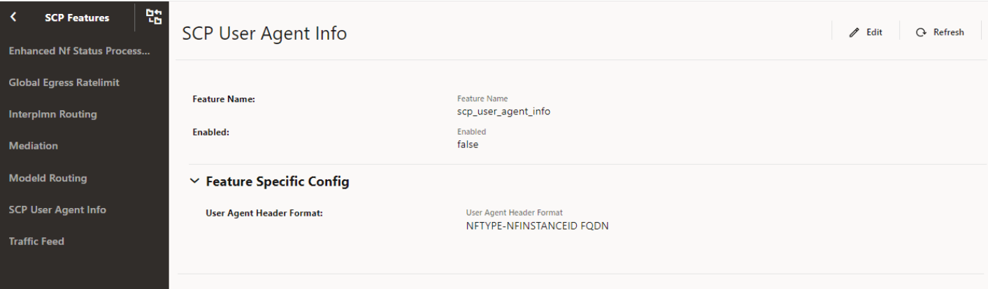

4.2.1.7 Configuring SCP User Agent Info
Perform the following to configure SCP User Agent Info.
  1. In the left navigation pane, click the SCP User Agent Info tab.
  2. In the SCP User Agent Info section, click Edit.
    The SCP User Agent Info screen appears.
    Figure 4-10 SCP User Agent Info
    SCP User Agent Info
  4. Expand the Feature Specific Config option, in the User Agent Header Format field, select the required format to set the "User-Agent" header format.
    For more information about the "User-Agent" header formats, see "Configuring SCP Features" in Oracle Communications Cloud Native Core, Service Communication Proxy REST Specification Guide.
  5. Click Save.

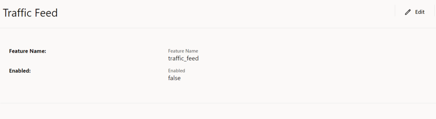

4.2.1.8 Configuring Message Feed
Perform the following to configure message feed.
  1. In the left navigation pane, click the Traffic Feed tab.
  2. In the Traffic Feed section, click Edit.
    The Traffic Feed screen appears.
    Figure 4-11 Message Feed
    Message Feed
  4. Click Save.

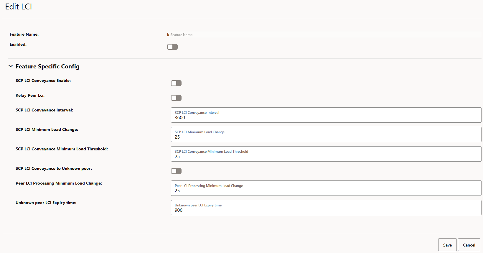

4.2.1.9 Configuring Load Control Information (LCI)
Perform the following procedure to enable configuring load control information (LCI).
  1. In the left navigation pane, click the LCI tab.
  2. In the LCI section, click Edit.
    Figure 4-12 Editing LCI
    Editing LCI
  4. In the Feature Specific Config section, complete the following configurations:
    All the parameters are mandatory to configure the LCI feature.
    • SCP LCI Conveyance Enable: Set to true to enable SCP to add its LCI in request and response.
    • Relay Peer Lci: Set to true to allow SCP to forward the received LCI header from producer NF.
    • SCP LCI Conveyance Interval: Enter a value from 100 milliseconds to 3600000 milliseconds to report the SCP LCI update interval.
    • SCP LCI Minimum Load Change: Enter a value from 0 to 25 to report the minimum delta value when reporting LCI based on load change.
    • SCP LCI Conveyance Minimum Load Threshold: Enter a value from 0 to 60 to set a minimum load change threshold to trigger the generation of an LCI header and its reporting to peers if allowed.
      If the SCP load value is less than the configured SCP LCI Conveyance Minimum Load Threshold value, SCP sends its load value as 0%.
    • SCP LCI Conveyance to Unknown peer: Set to true to allow SCP to send its LCI to an unknown peer NF, a peer NF that is not registered with SCP.
      • SCP sends its LCI in all the messages that go to peer NFs that are not registered with SCP.
      • If the SCP load value is less than the configured SCP LCI Conveyance Minimum Load Threshold value, SCP sends its load value as 0%.
    • Peer LCI Processing Minimum Load Change: Enter a value from 0 to 25 to define a minimum load change threshold in peer NF's load as indicated in LCI, which can trigger a re-evaluation of routing rules.
    • Unknown peer LCI Expiry time: Enter a value between 30 seconds to 900 second to set the minimum number of seconds required to remove an unknown peer's LCI from cache.
  5. Click Save.

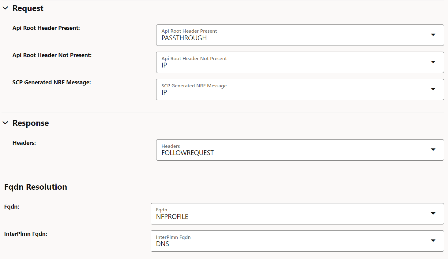

4.2.1.10 Configuring Host Preference for Egress Message Requests
Perform the following procedure to configure host preference for egress message requests.
  1. In the left navigation pane, click the Egress Host Preference tab.
  2. In the Egress Host Preference section, click Edit.
    Figure 4-13 Editing Egress Host Preference
  4. In the Feature Specific Config section, to configure the host preference, set the following fields as described in the following table:
    Table 4-1 Host Preference
    Field Name Description
    Api Root Header Present This parameter indicates the host preference (":authority" header) for egress message requests if the 3gpp-Sbi-Target-apiRoot header is present in the ingress message request.
    You can set this field to PASSTHROUGH to use the same type of host in egress message requests as received through ingress message requests.
    Default value: PASSTHROUGH
    Range: IP, FQDN, or PASSTHROUGH
    Api Root Header Not Present This parameter indicates the host preference (":authority" header) for egress message requests if the 3gpp-Sbi-Target-apiRoot header is absent in ingress message requests.
    Default value: IP
    Range: IP or FQDN
    SCP Generated NRF Message This parameter indicates the host preference (":authority" header) for SCP generated NRF messages.
    Default value: IP
    Range: IP or FQDN
    Fqdn This parameter indicates the resolution preference of egress message requests host FQDN if present.
    Default value: NFPROFILE
    Range: DNS or NFPROFILE
    InterPlmn Fqdn This parameter indicates the resolution preference of egress message requests inter-plmn FQDN if present.
    Default value: DNS
  5. Click Save.

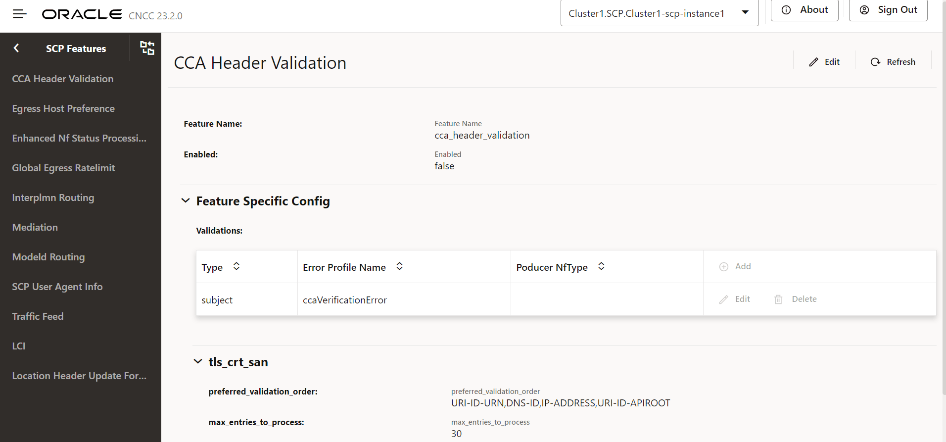

4.2.1.11 Configuring CCA Header Validation
Perform the following option to configure CCA Header validation.
  1. In the left navigation pane, click the CCA Header Validation tab.
  2. In the CCA Header Validation section, click Edit.
    Figure 4-14 Edit CCA Header Validation
  4. In the Feature Specific Config section, to configure the validations, set the following fields as described in the following table:
    Table 4-2 Validations
    Type Type of validation:
    • headerPresence: SCP checks the presence of the 3gpp-Sbi-Client-Credentials header in the ingress request.
      • Validation will pass if the header is present.
      • Validation will fail if the header is not present.
    • subject: SCP checks the NF instance ID from the "sub" parameter in the 3gpp-Sbi-Client-Credentials header with the NF instance ID from the list of SANs in the client's TLS certificate. SANs directly have the NF Instance Id or the client's other identity, like the FQDN or IP address, which will be used to get the NF Instance Id. If the 3gpp-Sbi-Client-Credentials header is not present, then this validation will not be performed.
      • Validation will pass if the NF instance ID from the "sub" parameter matches the NF instance ID from the SAN.
      • Validation will fail if the NF instance ID from the "sub" parameter doesn't match the NF instance ID from the SAN.
    Error Profile Name The error profile name is used to generate an error response if the corresponding validation fails. Error profiles can be configured using the REST API: /ocscp/scpc-configuration/{version}/errorProfileConfig.
    Product NF Type Default Value: Null
    preferred_validation_order An order format-wise from which the SCP picks SAN from the client's TLS certificate for verification of the "subject" type of validation.
    Note: Applicable only when validation type "subject" is selected.
    max_entries_to_process Maximum number of SANs from the client's TLS certificate that SCP picks for validation.

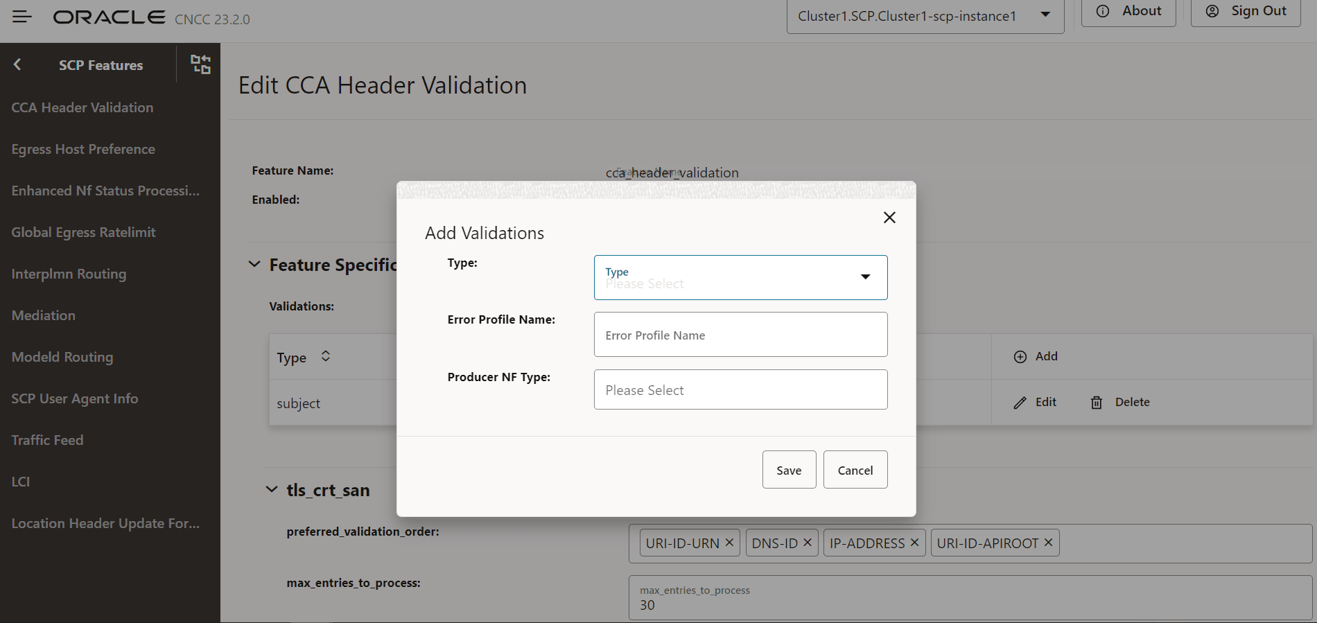

  5. Click Add to add validations:
    Figure 4-15 Add Validations
    Add Validations
  6. Click Save.

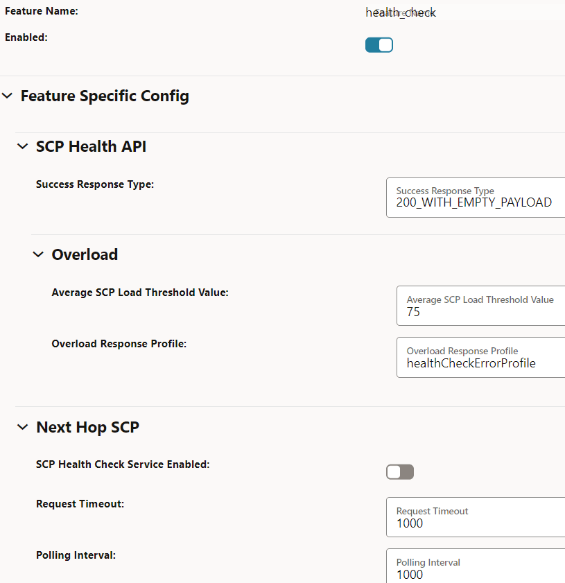

  1. In the left navigation pane, click the Health Check tab.
  2. In the Health Check section, click Edit.
    Figure 4-18 Health Check
    Health Check
  3. Ensure that Enabled is set to true.
    This is the default configuration.
  4. In the Feature Specific Config section, you can modify the following configurations:
    Table 4-4 Configure Health Check API
    Success Response Type This field indicates successful responses for a healthy SCP.
    • Default value: 200StatusCodeAndEmptyPayload
    • Range: 200WithPayLoad, 200WithEmptyPayload, and 204WithNoContent
    Average SCP Load Threshold Value This field provides the overall average SCP load threshold value.
    • Default value: 75%
    • Range: 75% - 90%
    Overload Response Profile This field indicates the error profile configuration for the health query response in the exception conditions.
    • Default value: healthCheckErrorProfile. For more information about this option, see "Configuring Error Profiles" in Oracle Communications Cloud Native Core, Service Communication Proxy REST Specification Guide.
    SCP Health Check Service Enabled This option enables or disables the SCP health check API feature in inter-scp scenarios.
    • Default value: false
    • Range: true or false
    Request Timeout This field indicates the timer to monitor the waiting time for health check response in inter-scp scenarios.
    • Default value: 1000ms
    • Range: 300ms -60000ms
    Polling Interval This field indicates the duration to control the periodicity of health check requests in inter-scp scenarios.
    Consecutive Error Response This field indicates the total number of consecutive failure responses that leads to failover in inter-scp scenarios.
    • Default value: 3
    • Range: 1 - 20
    Consecutive Success Response This field indicates the total number of consecutive successful responses that leads to fallback in inter-scp scenarios.
    • Default value: 3
    • Range: 1 - 20
  5. Click Save.

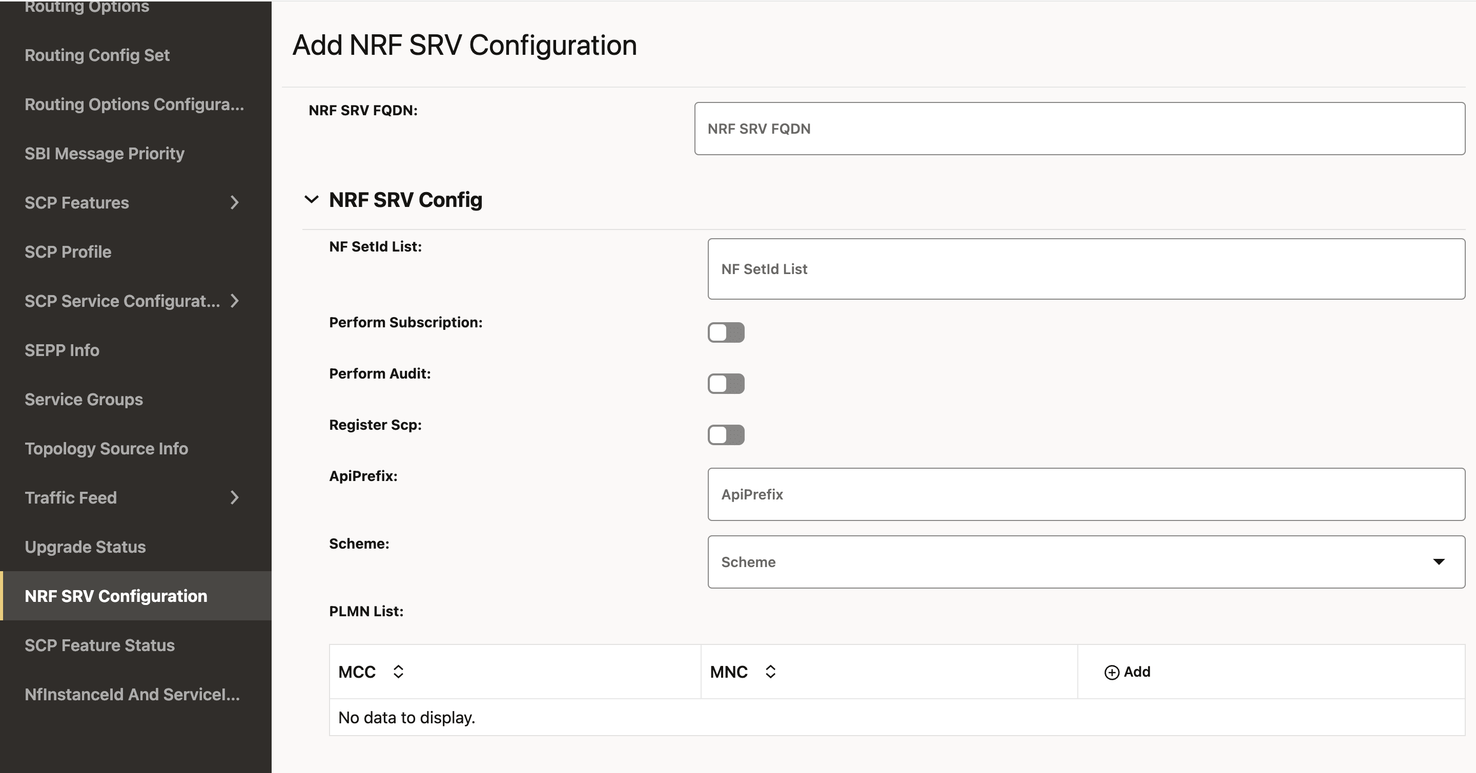

4.2.1.15 NRF Configuration using DNS SRV Resolution
Perform the following procedure to NRF configuration using DNS SRV resolution.
  1. In the left navigation pane, click the NRF Bootstrap Info tab.
  2. In the NRF Bootstrap Info section, click Edit.
    Figure 4-19 Edit NRF Bootstrap Info

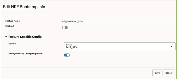

  4. In the Feature Specific Config section, enter the following input for the following configurations:
    Table 4-5 Configure NRF Source Configuration
    Source This field is used to select whether the NRF Configuration Using DNS SRV Resolution feature should be enabled or disabled. SCP will enable the feature if the source is DNS_SRV.
    The default value is DNS_SRV.
    deRegisterScpDuringMigration
    In the migration from static to DNS SRV task, if static and DNS SRV NRF configurations are the same, then this parameter will be used to deregister SCP with the old or static NRFset.
  5. Click Save.

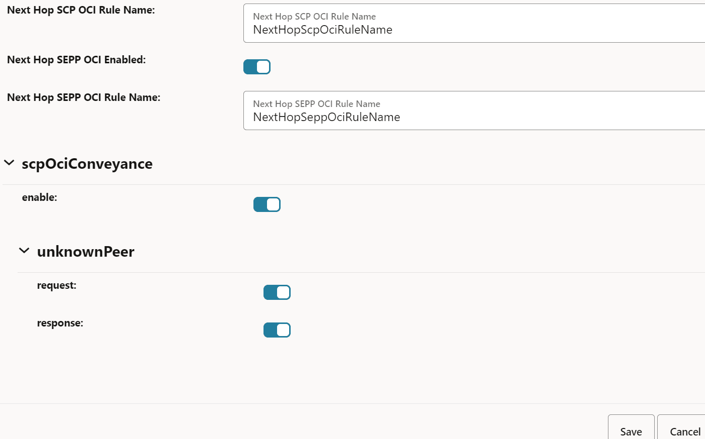

4.2.1.16 Configuring Overload Control Based on the Overload Control Information Header
Perform the following procedure to configure overload control based on the overload control information header.

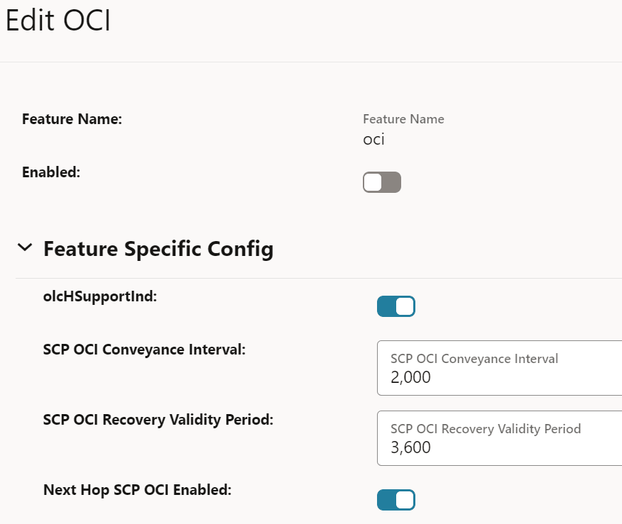

  1. From the SCP Features list, click the OCI tab.
  2. On the OCI page, click the Edit icon.
    Figure 4-20 Edit OCI
    Edit OCI
  3. In the Edit OCI section, set Enabled to true.
    Figure 4-21 Enabling OCI
    Enabling OCI
  4. To configure OCI, in the Feature Specific Config section, set the following fields:
    Table 4-6 Configure OCI
    olcHSupportInd This option indicates that SCP supports the Overload Control Information (OCI) feature based on the 3gpp-Sbi-Oci header.
    By default, this option is enabled.
    SCP OCI Conveyance Interval This field indicates the interval for reporting SCP OCI to peer NFs. For every interval until the validity period, the last sent OCI is reported to peer NF irrespective of any change to SCP OCI. Sending SCP OCI periodically ensures that the peer NF has not missed an earlier reported SCP OCI. The same OCI header as sent on the last OCI threshold change or validity period expiry is sent.
    • Default value: 2000 milliseconds
    • Range: 2000 to 3600000 milliseconds
    Note: OCI is sent to peer NFs only if there is a message for that NF.
    SCP OCI Recovery Validity Period This field indicates the validity period to send OCI headers to peers when SCP recovers from an overloaded state. SCP sends OCI to peers with reduction metric as 0.
    • Default value: 3600 seconds
    • Range: 5 to 3600 seconds
    Next Hop SCP OCI Enabled This option enables or disables the OCI feature between SCP instances and SCP scope OCI.
    Next Hop SCP OCI Rule Name If the Next Hop SCP OCI Enabled option is enabled, the OCI feature enforcement is done based on the ociConfigRule REST API configuration with the name provided as the value for this option.
    By default, this value is NextHopScpOciRuleName.
    Next Hop SEPP OCI Enabled This option enables or disables OCI enforcement between SCP and SEPP interfaces and SEPP scope OCI.
    Next Hop SEPP OCI Rule Name If the Next Hop SEPP OCI Rule Name option is enabled, the OCI feature enforcement is done based on the ociConfigRule REST API configuration with the name provided as the value for this option.
    By default, this value is NextHopSeppOciRuleName.
    scpOciConveyance If this option is set to true, SCP starts conveying the 3gpp-Sbi-Oci header based on self-overload information.
    unknownPeer
    • request
    If this field is set to true, SCP starts conveying the 3gpp-Sbi-Oci header based on self-overload information to requests to unknown peers. For unknown peers, identification of peer NFs is done based on the message request's FQDN.
    unknownPeer
    • response
    If this option is set to true, SCP starts conveying the 3gpp-Sbi-Oci header based on self-overload information to responses to unknown peers. If this parameter is set to true, SCP adds self-OCI header in every response message.
    By default, this option is disabled.
  5. Click Save.

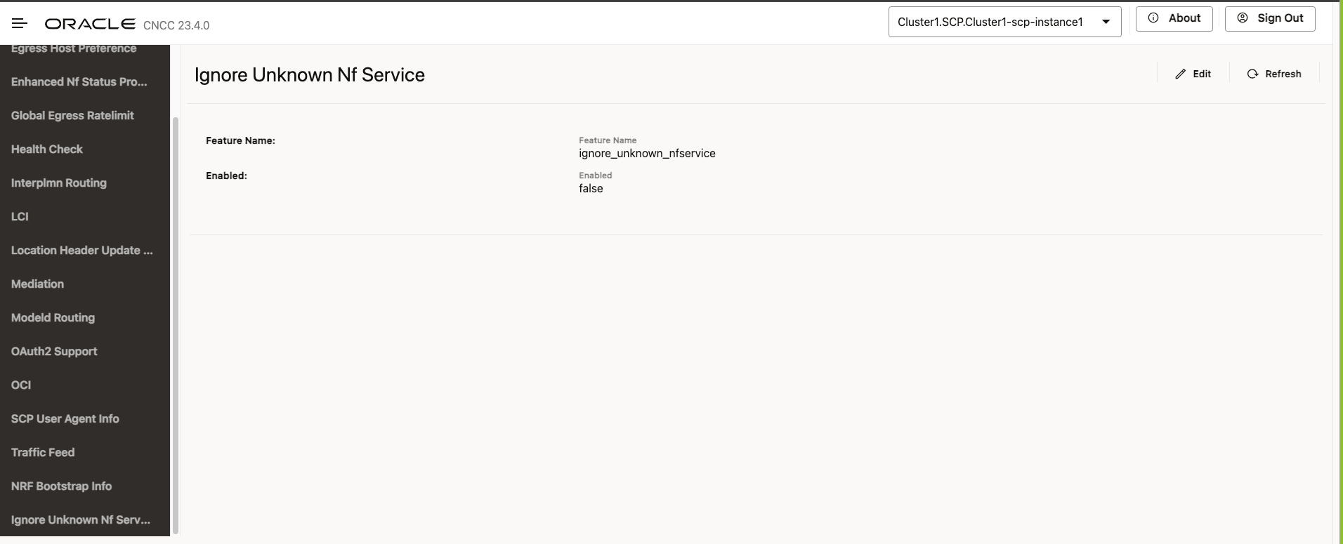

  1. In the left navigation pane, click the Ignore Unknown Nf Service tab.
    The Ignore Unknown Nf Service page appears.
    Figure 4-22 Ignore Unknown Nf Service
  2. On the Ignore Unknown Nf Service page, click the Edit icon.
  3. In the Edit Ignore Unknown Nf Service section, set Enabled to true.

4.2.5 Configuring NRF SRV
Perform the following procedure to configure NRF using DNS SRV Resolution.
  1. From the left navigation pane, navigate to SCP and click the NRF SRV Configuration tab.
  2. In the NRF SRV FQDN section, click the Add button to create the new NRF SRV configuration for the given NRF SRV FQDN.
    You can configure the NRF configurations at run time, and this NRF SRV FQDN shall be mapped to target NRF FQDNs. SCP uses this NRF SRV FQDN to query the DNS SRV server to get the actual target NRF FQDNs. NRF SRV FQDN
    Figure 4-25 Add NRF SRV Configuration
  3. To configure the NRF SRV, enter the input for the following fields:
    Table 4-23 NRF SRV Configuration
    NF SetId List This is the SetId list for this NRF SRV configuration.
    You can configure multiple nfSetIds, but the NRF profile and rule creation will only take into account the nfSetId from the 0th index.
    This setId must be unique for each NRF SRV configuration; that is, this setId must not be present in any other NRF SRV configuration.
    Perform Subscription This field allows to decide whether NRF from this NRF SRV should be used for a subscription or not.
    The possible values are true or false.
    Perform Audit This field allows to decide whether NRF from this NRF SRV should be used for a audit or not.
    Register SCP This field allows to decide whether to register SCP with the NRF from the NRF Set.
    Scheme This field is used for the URI Scheme. The supported value is http/https.

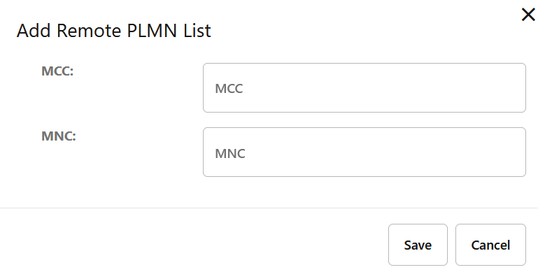

    PLMN List This field indicates the list of NRFs serving Public Land Mobile Network (PLMN).
    A PLMN has a unique PLMN code, which consists of a MCC (Mobile Country Code) and an MNC (Mobile Network Code).
    Click the Add button to add MCC and MNC, respectively.
    Versions This field lists the NFServiceVersion.
    Configuring multiple API versions is permissible, but at least one entry in the version list must have its apiVersionInUri set to "v1." This is because SCP currently utilizes "v1" for its self-generated requests towards NRF.
    • Click the Add button to add NFServiceVersion.
    • The supported value of apiVersionInUri is v1/v2.
    • The apiFullVersion should be in format x.y.z., for example, 1.0.0.
    apiPrefix This field is used in the URI while communicating with NRF.
    serviceNames
    Indicates the service name of the NRF SRV configuration.
    The nnrf-nfm and nnrf-disc are mandatory for NRF SRV configurations.
    The supported value is nnrf-nfm/nnrf-disc/nnrf-oauth2.
    isInterPlmnFqdn This field allows you to choose whether or not to map the NRF from this NRF SRV resolution to the InterPlmn Fqdn.
  4. In the NRF SRV FQDN section, click the Edit icon to update the existing NRF SRV configuration.
  5. Click Save.

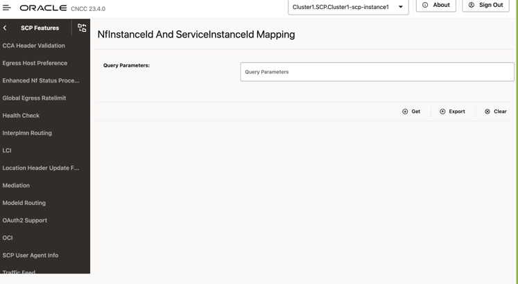

4.2.5.1 Mapping NFInstanceId and ServiceInstanceId
Perform the following procedure to map the NRF FQDN InstanceId.
  2. From the SCP Features list, click NFInstanceId And ServiceInstanceId Mapping.
  3. In the NFInstanceId And ServiceInstanceId Mapping section, click Get to retrieve the NRF FQDN and corresponding instanceId mapping details.
    Figure 4-26 NFInstanceId And ServiceInstanceId Mapping
  4. To retrieve, export, or clear the data, click the required buttons as described in the following table:
    Table 4-24 Buttons and Descriptions of Mapping NRF FQDN InstanceId
    Button and Field Names Description
    Query Parameters Allows to enter parameters to retrieve and update data required for mapping NRF FQDN InstanceId.
    Get Retrieves the NRF FQDN and corresponding instanceId mapping details. You can modify this data using the Edit button.
    Export Exports existing records in the JSON format.
    Clear Refreshes the existing screen by removing the data.

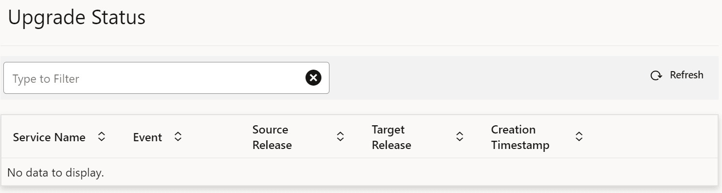

4.2.7 Configuring Upgrade and Rollback Event
Perform the following procedure to fetch upgrade and rollback event information.
  1. From the left navigation pane, click the SCP tab, and then click the Upgrade Status tab.
  2. On the Upgrade Status page, the following columns display upgrade and rollback events:
    Figure 4-28 Upgrade and Rollback Events
    Table 4-26 Upgrade and Rollback Events
    Column Name Description
    Service Name Displays the names of the services, such as SCPC-Audit, SCPC-Configuration, SCPC-Notification, and so on.
    Event Displays the names of the upgrade and rollback events, such as Pre_Upgrade_Started, Pre_Upgrade_Completed, Pre_Upgrade_Failed, and so on.
    Source Release Displays the source release version for performing upgrade and rollback.
    The convention to identify a release is as follows:
    • 1.12.0 is identified as 101200
    • 1.14.0 is identified as 101400
    Target Release Displays the target release version for performing upgrade and rollback.
    • 1.15.0 is identified as 101500
    • 22.1.0 is identified as 221000
    Creation Timestamp Displays the time of creation of the event, for example, creationTimestamp": "2021-05-26T01:17:15.000+00:00

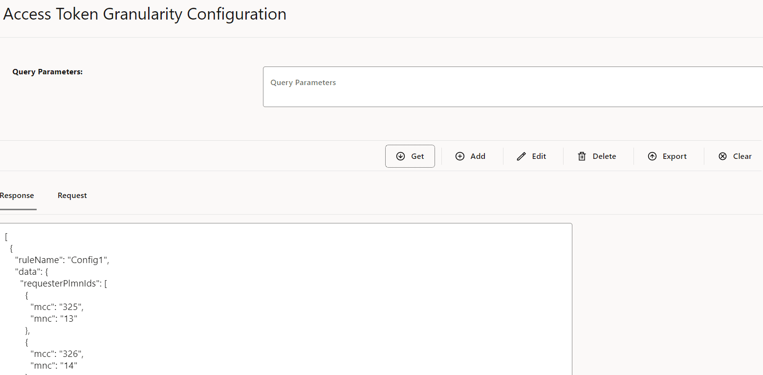

4.2.8.1 Configuring Access Token Granularity
Perform the following procedure to configure access token granularity and access token requests for NFType, specific NF, or NF instance ID.
  1. From the left navigation pane, click the SCP tab, and then click the OAuth Services tab.
  2. From the left navigation pane, click the Access Token Granularity Configurationtab.
  3. In the Access Token Granularity Configuration section, click Get to retrieve access token granularity configurations data based on the query parameters.
    Figure 4-29 Access Token Granularity
  4. To add a new request, click Add and enter the request body information in the Request field.
  5. Click Submit.
    The request body message appears in the Response field.
  6. To edit, export, delete, or clear the data, click the required buttons as described in the following table:
    Table 4-27 Button and Field Descriptions of Access Token Granularity
    Query Parameters Allows to enter parameters to retrieve, add, and update access token granularity configuration data based on the query parameters.
    Get Retrieves access token granularity configuration data. You can modify this data using the Edit button.
    Add Adds new message requests in the Request field.
    Edit Modifies any existing data by updating mandatory query parameters in the Query Parameters field.
    Delete Removes any message request.

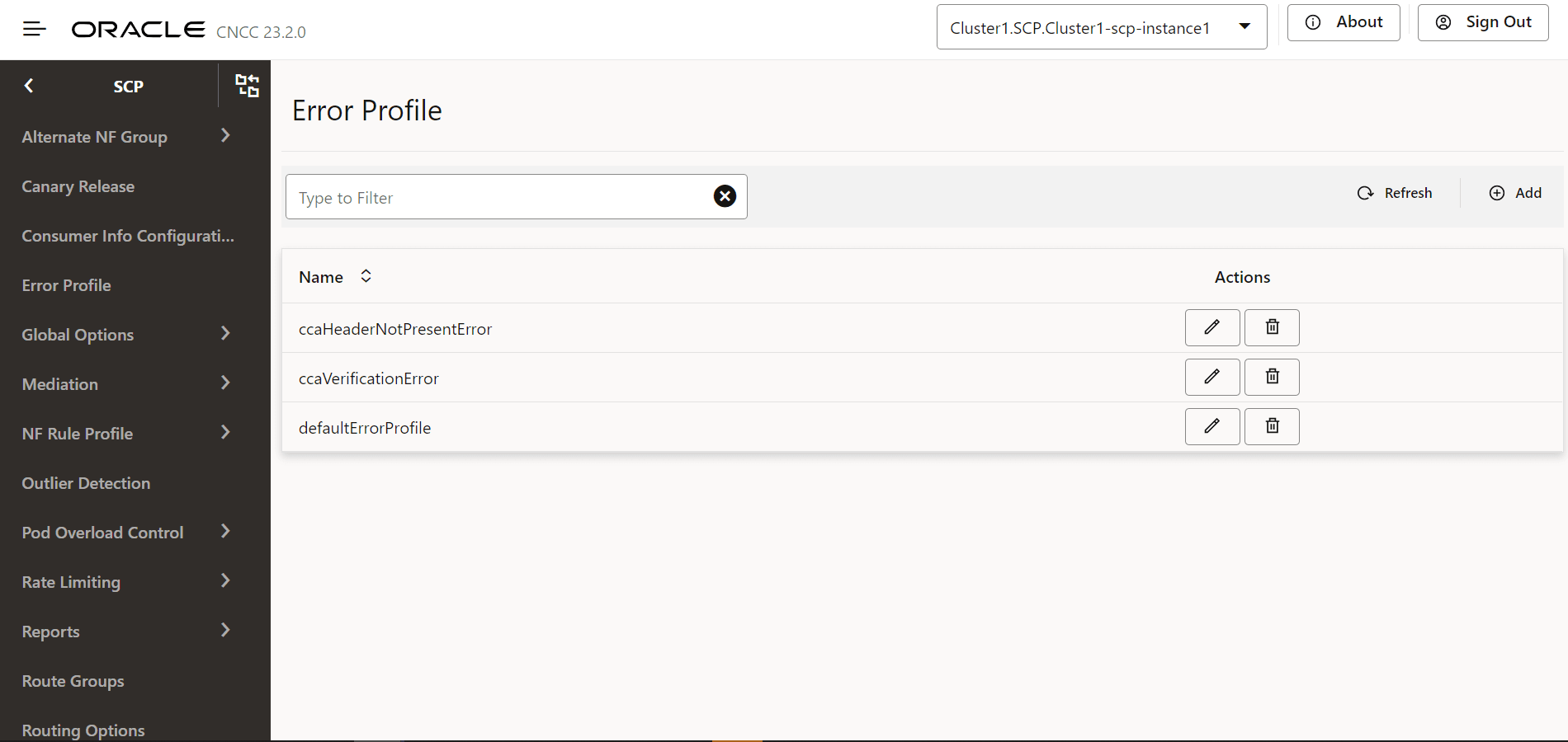

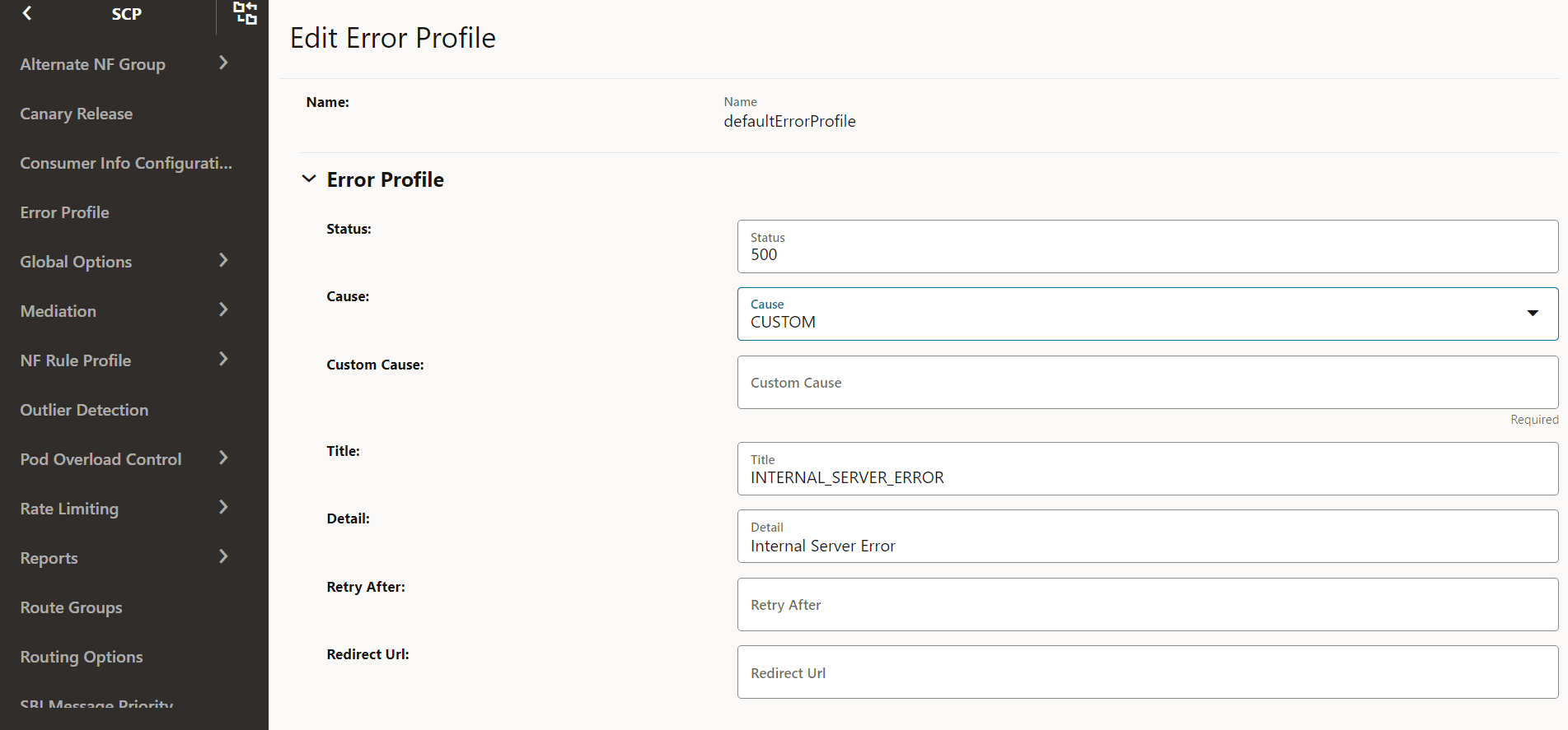

4.2.9 Configuring Error Profile
Perform the following procedure to configure different error profiles, which can be used to build "ProblemDetails" sent in the response body to the consumer.
  1. From the left navigation pane, click the SCP tab, and then click the Error Profile tab.
    Figure 4-31 Error Profile
    Edit Profile
  2. Click Edit icon from the Actions column for the error profiles that must be modified. The Edit Error Profile screen appears.
    Figure 4-32 Edit Error Profile
    Edit Error Profile
  3. If the required cause is not available in the Cause drop-down list, select CUSTOM to customize the cause:
    Figure 4-33 Customize the Cause
    Customize the Cause
  4. Make the required modifications for the following parameters:
    Table 4-29 Edit Error Profile
    Field Description
    Status HTTP Status Code
    Cause The list of error causes that are specific to the occurrence of the problem.
    Custom Cause User defined custom cause. This field will be used only if cause field value is set to "CUSTOM".
    Title If this field is null, a standard HTTP status code description is added.
    Detail If present, the same data is used; otherwise, the application can add it optionally.
    Retry After Indicates the number of seconds after client should retry.
    Redirect URL Indicates the AbsoluteURL of the resource to which the message is redirected to.
    For information about configuring error profiles, see "Configuring Error Profile" in Oracle Communications Cloud Native Core, Service Communication Proxy REST Specification Guide.
  5. Click Save.

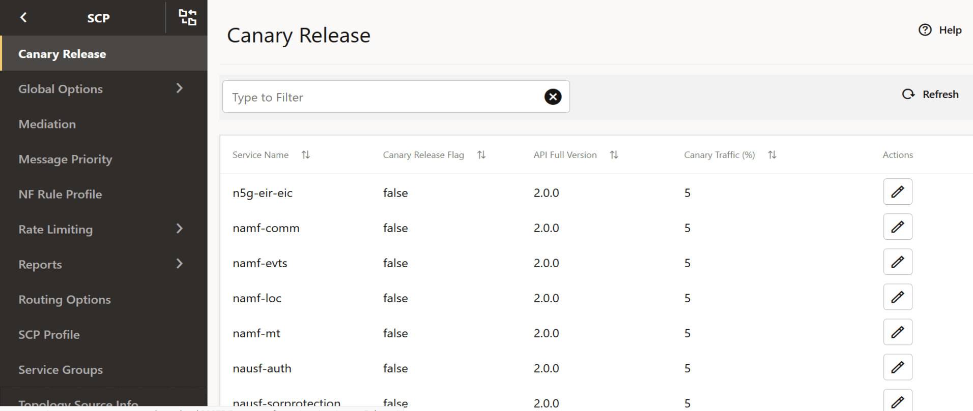

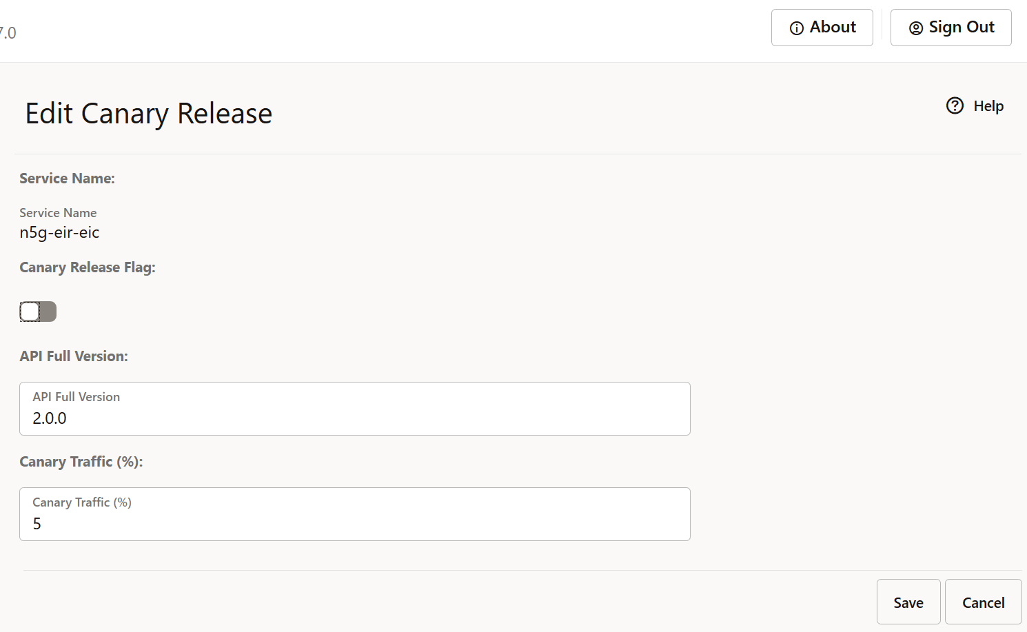

4.2.10 Configuring Canary Release
Following is the procedure to configure Canary Release parameters:
  1. From the left navigation menu, navigate to SCP and then select Canary Release.
  2. Click Edit from the Actions column for the required service that must be modified. The Edit Canary Release Screen appears.
    Figure 4-34 Canary Release
    Canary Release
  3. Make the required modifications for the following parameters:
    1. Canary Release Flag: Enable/Disable the flag using toggle.
    2. API Release Version: Provide the release version of the API.
    3. Canary Traffic: Set the value for the traffic that should be distributed to Canary Release.
    Figure 4-35 Edit Canary Release
    Edit Canary Release
    For more information about the configuration parameters, see Oracle Communications Cloud Native Core, Service Communication Proxy REST Specification Guide.
  4. Click Save.
  5. Click Refresh to view the updated values on the screen.

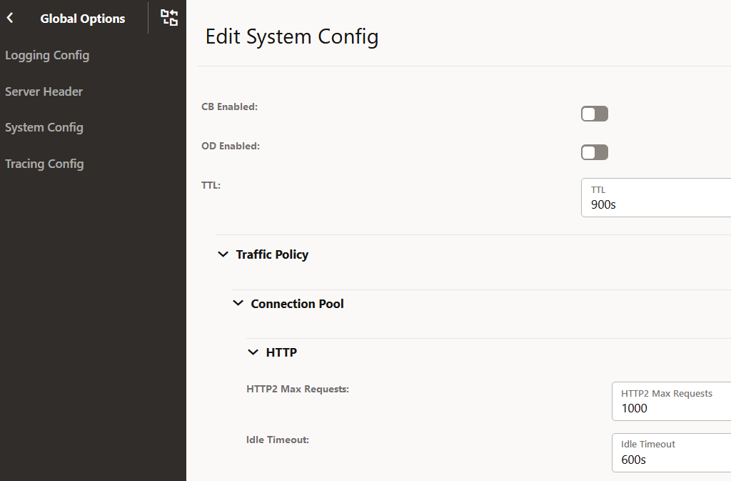

System Config
Perform the following procedure to edit the system config parameters.
  1. From the left navigation menu, navigate to SCP and select Global Options.
  2. Select System Config.
  3. Click Edit from the top right side to edit or update System Config parameters.

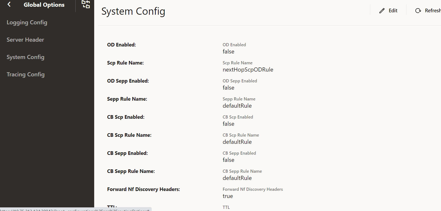

    Figure 4-37 System Config
    System Config
  4. Update the attributes as described in "Configuring SystemOptions" in Oracle Communications Cloud Native Core, Service Communication Proxy REST Specification Guide.
    Ensure that Forward Nf Discovery Headers is set to true to forward discovery headers to Nexthop SCP as part of the Model D Indirect 5G SBI Communication feature.
    The default value is true.
  5. Click Save after performing the modifications.

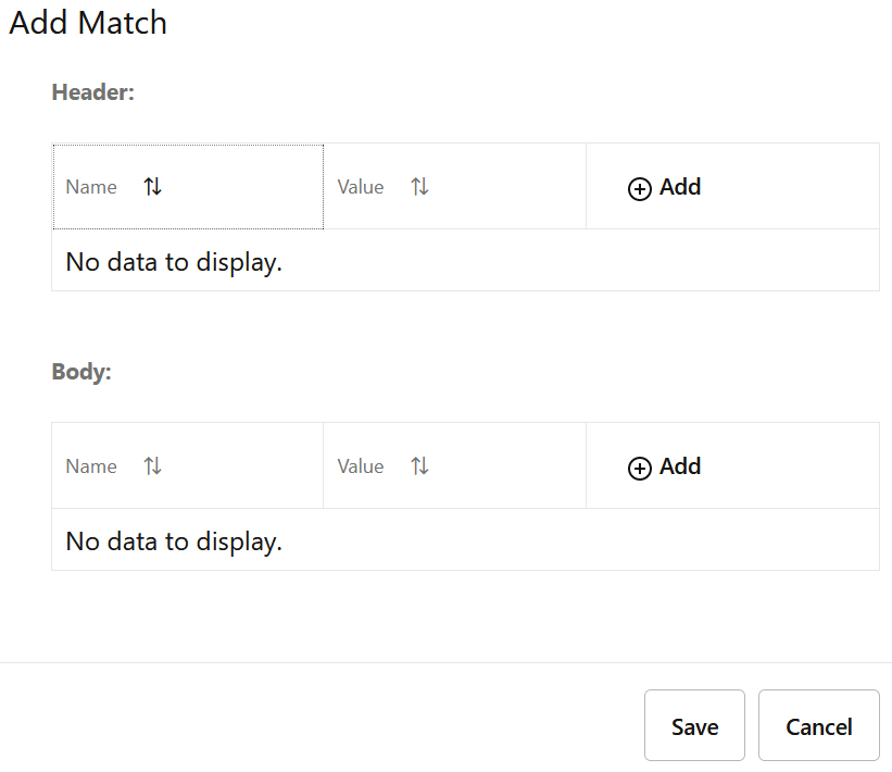

  4. In the Match section, click Add.
    The Add Match dialog box appears.
    Figure 4-39 Add Match
    Add Match
  5. In the Header section, click Add to set the header details as follows:
    • Name: Enter a name for the header.
    • Value: Enter a value of the header.
    • Match Type: Select a range type from the Match Type drop-down list.
  6. In the Range section, if the header type has a numeric value, enter the range of that value in Start and End fields.
  7. Click one of the following buttons:
    • Remove: To discard the changes made to the Range section.
    • Save: To save the changes.
  8. In the Body section, click Add Body to set the JSON body details as follows:
    • Name: Enter a name for the body.
    • Value: Enter a value for the header.
  9. In the Range section, if the header type has a numeric value, enter the range of that value in Start and End fields.
  10. Click one of the following buttons:
    • Cancel: To reset all the fields.

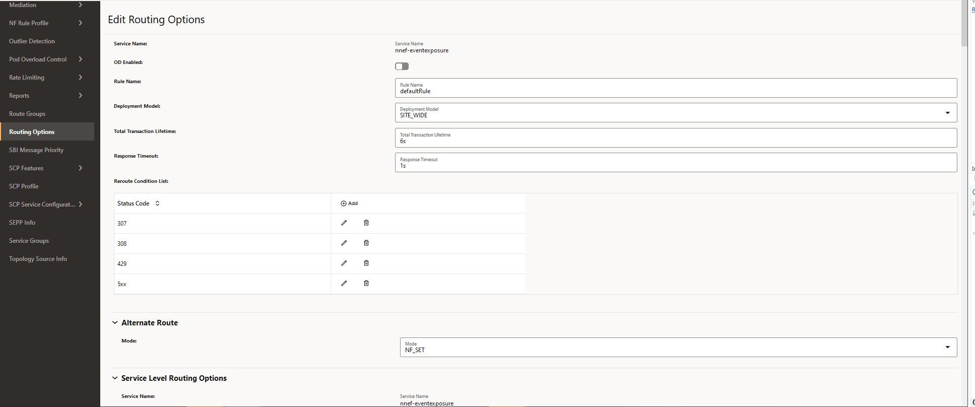

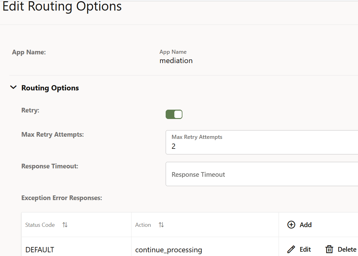

4.2.12.1 Configuring Routing Options for Mediation
Perform this procedure to configure routing options with Mediation.

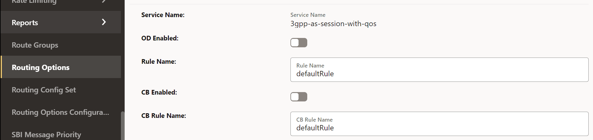

  1. From the left navigation pane, click the SCP tab, and then click the Routing Options tab.
  2. In the Routing Options section, click Edit.
    The Edit Routing Options screen appears.
    Figure 4-40 Edit Routing Options
  3. In the Routing Options section, set Retry to true to enable retry attempt.
  4. In the Max Retry Attempts field, enter a value to set the number of retry attempts.
  5. In the Response Timeout field, enter a time interval to respond to a message request.
  6. In the Exception Error Responses section, click Add to add exception error responses.
    This option enables you to send an error message to the consumer NF or process the message request to the producer NF when the Mediation service is unavailable. By default, this status code is DEFAULT.
  7. In the Add Exception Error Responses dialog box, configure the fields as described in the following table:
    Table 4-32 Add Exception Error Responses
    Field Description
    Status Code Indicates the list of status codes that matches with the status code received from the application, the required action specified by action field is taken.
    This value can be any HTTP Status Codes, HTTP Status with other defined custom status (RESPONSE_TIMEOUT and CONNECTION_FAILURE)
    Action Indicates the action to be taken when the above mentioned status code is received.
    It can have the following values:
    • send_error_response: Sends the error code to the consumer NF.
    • continue_processing: Continues processing the message in case of errors.
    Error Code Indicates configurable error codes to be sent by SCP to consumer NFs.
    It is a valid HTTP status code or allowed custom code.
    Error Cause Indicates the error cause that is specific to the occurrence of the problem.
    Error Title Indicates the title of the error.
    Error Description Indicates an explanation specific to the occurrence of the problem.
    Retry After Indicates the retry interval.
    Redirect Url Indicates the AbsoluteURL of the resource to which the message is redirected to.
  8. Click Save.
4.2.12.2 Configuring Mediation Rules
Perform this procedure to configure mediation rules.
  1. From the left navigation pane, click the SCP tab, and then click the Mediation tab.
  2. On Mediation tab, click the Mediation Rules Configuration subtab.
    The Mediation Rules Configuration screen with a list of rules saved in database appears.
    Figure 4-41 Mediation Rules Configuration
  3. Click the View icon to view the mediation rules.
  4. Click the Add to create a mediation rule.
    The Add Mediation Rule screen allows you to configure the fields to create new rules as described in the following table:

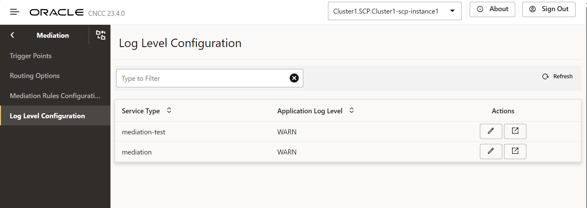

4.2.12.3 Configuring Mediation Log Levels
Perform this procedure to configure the log levels of mediation.
  2. On Mediation tab, click the Log Level Configuration subtab.
    The Log Level Configuration screen with a list of default log level type of mediation and mediation-test service assigned during deployment appears.
    Figure 4-42 Log Level Configuration
  3. Click the View icon to view the log level of mediation or mediation test service.
  4. Click the Edit icon to edit or update the log level of mediation or mediation test service.
    The Edit Log Level Configuration screen allows you to configure the fields as described in the following table:
    Table 4-35 Edit Log Level Configuration
    Field Description
    Service Type Indicates the name of the type of service. For examples, mediation and mediation-test
    Application Log Level Indicates the type of log level.
    The following are the supported log levels:
    • WARN: Designates potentially harmful situations.
    • INFO: Designates informational messages that highlight the progress of the application at coarse-grained level.
    • ERROR: Designates error events that might still allow the application to continue running.
    • DEBUG: Designates fine-grained informational events that are most useful to debug an application.
      The default value is WARN.
    Package Log Level
    Indicates the package level log information.
    Log Rate Control Indicates the log rate control information.
  5. Select the application log level from the Application Log Level drop-down list to collect the logs as per the requirement.
  6. Click Save to update the log level of service.

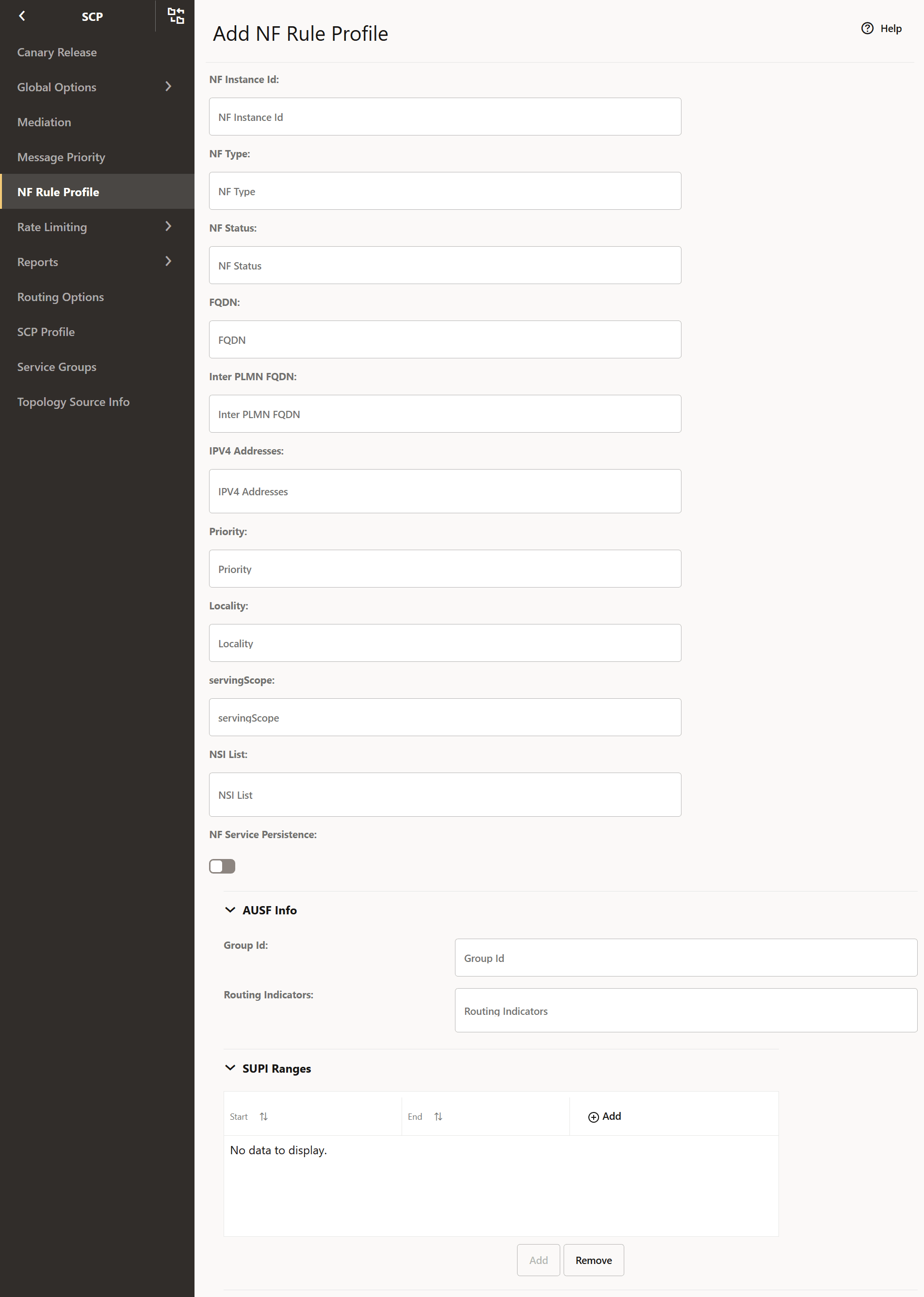

4.2.13 Configuring NF Rule Profile
Perform the following procedure to configure NF Rule Profile parameters.
  1. From the left navigation, navigate to SCP, and then click NF Rule Profile.
  2. In the NF Rule Profile section, click Add.
    Figure 4-43 Add NF Rule Profile
    Add NF Rule Profile
  3. Add the following parameters for all the NF Info:
    • Group Id: Identity of the NF info.
    • Routing Indicators: List of Routing Indicator information.
    • Click Add to add the SUPI Ranges.
    • Click Save to save the SUPI Ranges.
    • Click Remove if you want to remove the NF Info.
    • Click Add to add the NF info details.
  4. Click Save to save the NF Rule Info.
  6. To configure a local PLMN, in the PLMN List section, click Add and enter the required Mobile Country Code (MCC) and Mobile Network Code (MNC) values in the displayed fields.

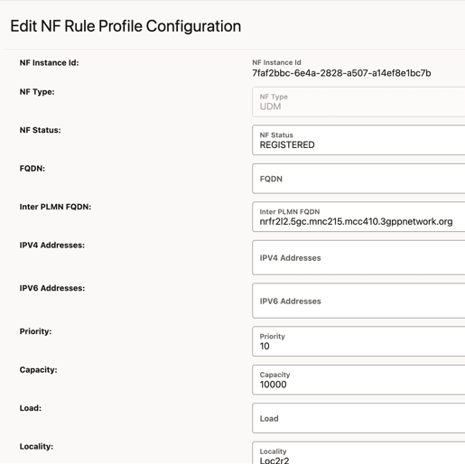

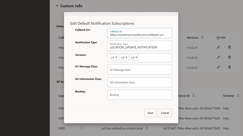

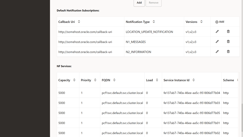

Viewing or Editing the Default Notification Subscriptions
Perform the following procedure to view or edit the default notification subscription which are present under NF service level or NF profile level:
  1. From the left navigation, navigate to SCP, and then click NF Rule Profile Configuration.
  2. In the NF Rule Profile Configuration section, click Edit from Actions. The Edit NF Rule Profile Configuration screen appears.
    Figure 4-44 Edit NF Rule Profile Configuration
  3. In the Default Notification Subscription section, click the Edit icon for the required callback URI that must be modified. The Edit Default Notification Subscription screen appears.
    Figure 4-45 Default Notification Subscription
  4. Make the required modifications for the following fields:
    Table 4-38 Default Notification Subscriptions
    Attribute name Description
    Callback Uri This attribute contains a default notification endpoint to be used by a NF service producer towards an NF service consumer that has not explicitly registered a callback URI with the NF service producer, for example, as a result of an implicit subscription.
    Notification Type Type of notification for which the corresponding callback URI is provided.
    Versions API versions, for example, v1, are supported for the default notification type.
    N1 Message Class If the notification type is N1_MESSAGES, this IE must be present to identify the class of N1 messages to be notified.
    N2 Information Class If the notification type is N2_INFORMATION, this IE must be present to identify the class of N2 information to be notified.
    Binding When present, this IE contains the value of the binding indication for the default subscription notification, which is the value part of the 3gpp-Sbi-Binding header. See the note for details.
    When delivering a notification for a default subscription to a specific NF consumer but the latter is not reachable, a NF service producer uses the binding indication for default subscription to reselect an alternative NF service consumer instance. For example, an AMF notifies corresponding uplink LPP or NRPPa messages through a default subscription to the LMF instance that previously sent downlink LPP or NRPPa messages during a location procedure. If the original LMF instance is not reachable, the AMF selects an alternative LMF instance using the binding indication and delivers the notification to the selected LMF instance.
    Figure 4-46 Edit Default Notification Subscriptions

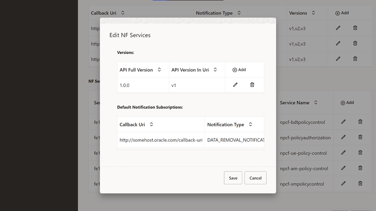

  5. In the NF Service section, to modify any NF service, click the corresponding Edit icon.

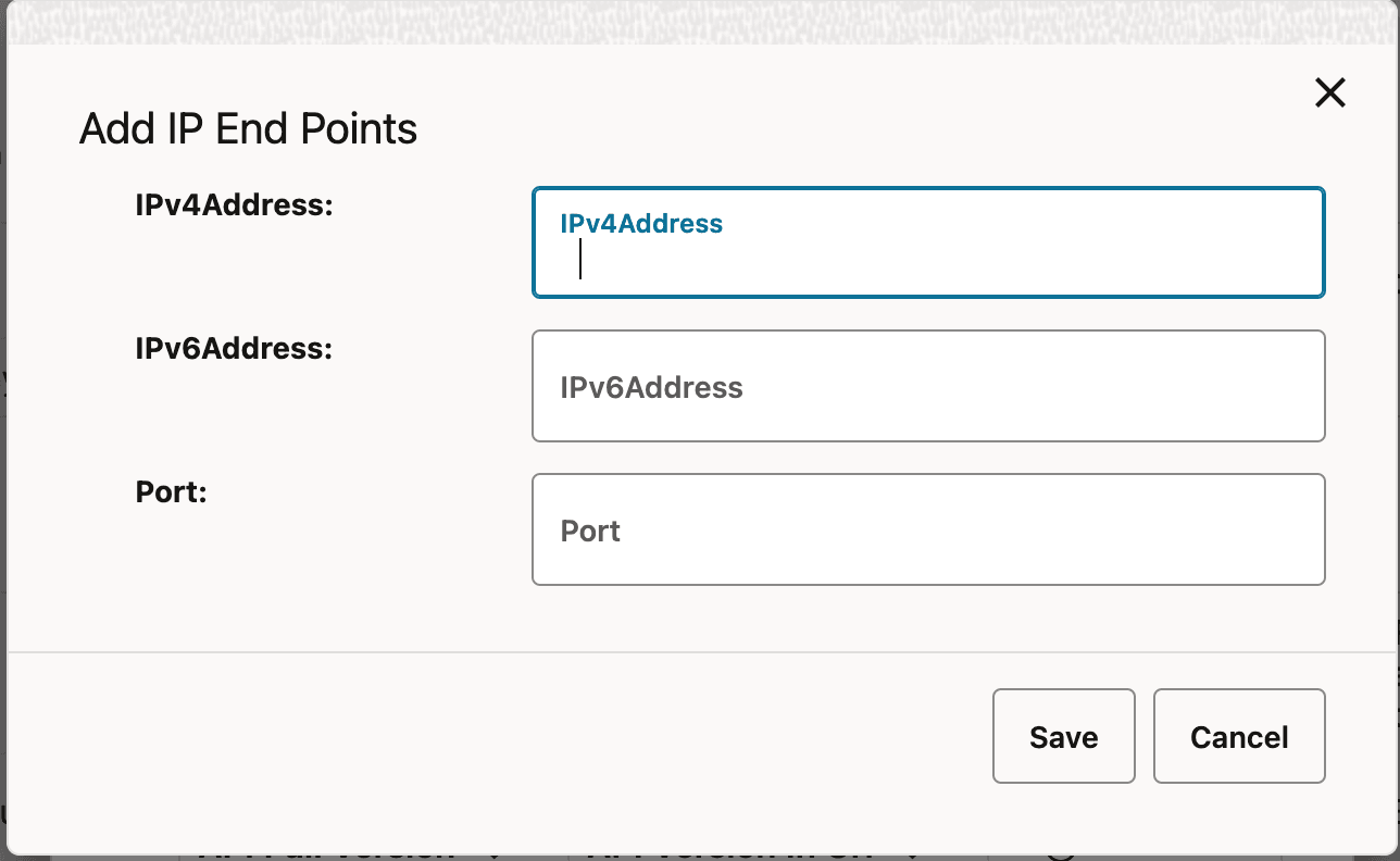

  6. In the IP End Points section, click Add to add IP end points.
    Figure 4-47 Adding IP End Points
  7. Enter IP address in one of the following fields:
    • IPv4Address
    • IPv6Address
      The system displays an error message if you enter IP address in both the above mentioned fields.
      For more information about IPv4Address and IPv6Address configurations, see "Configuring Route Groups" in Oracle Communications Cloud Native Core, Service Communication Proxy REST Specification Guide.
  8. In the Port field, enter the port number.
  9. Click the Edit icon to edit or add the API full versions.
    Figure 4-48 Edit NF Services
    Edit NF Services
  10. Click Save to save the NF Rule Info.
  11. Click Refresh to view the updated values on the screen.

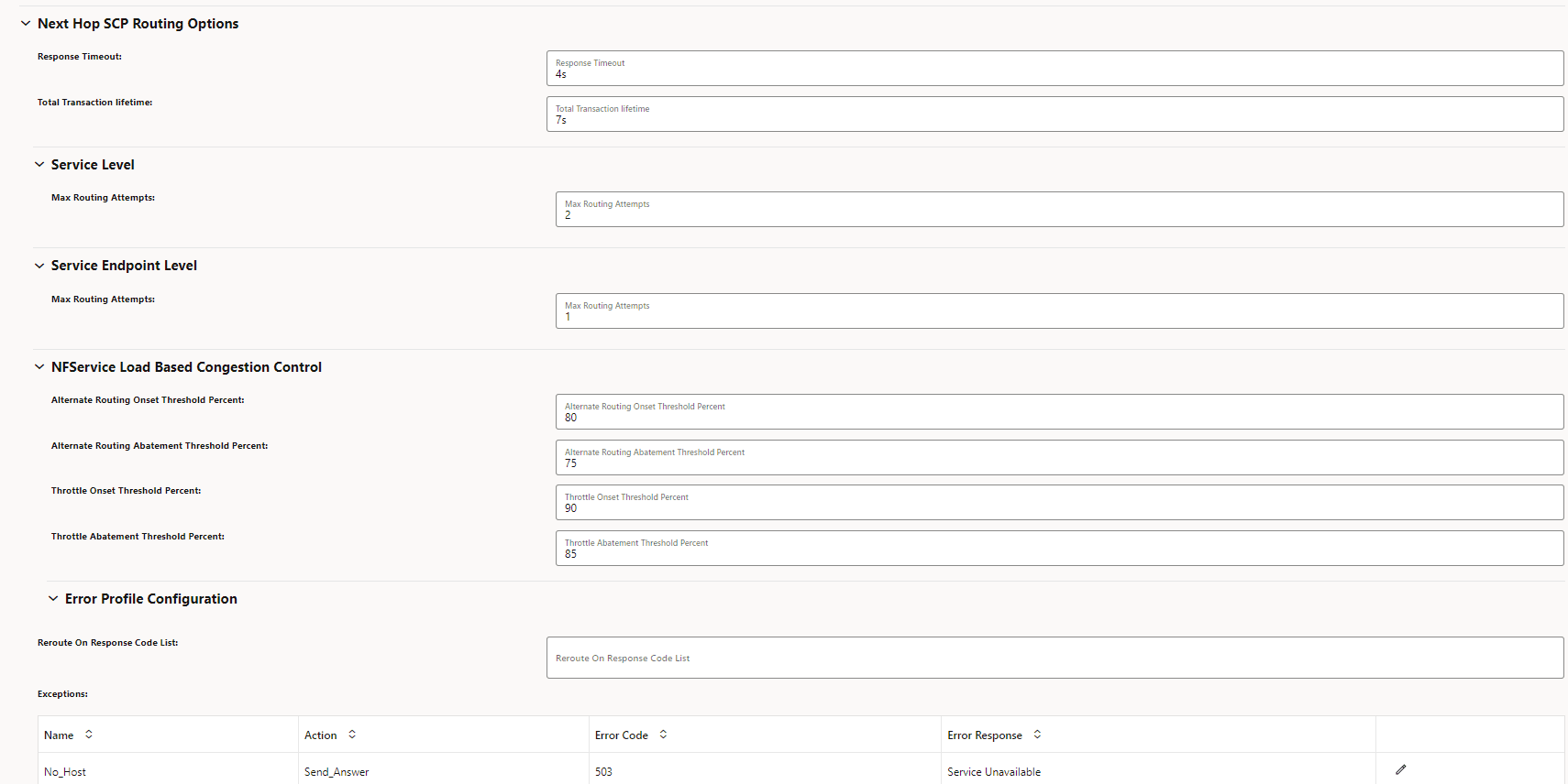

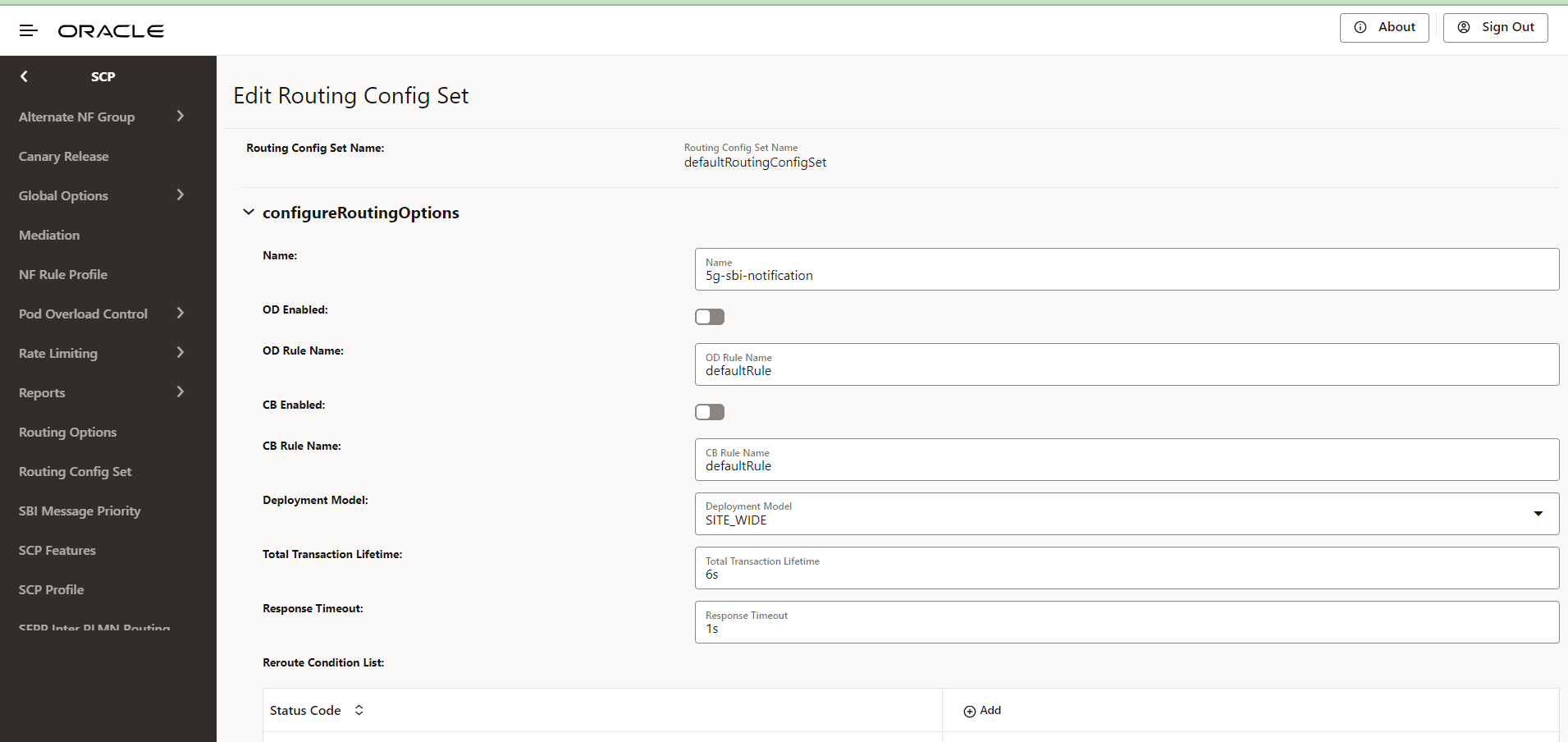

4.2.14 Configuring Routing Options
Perform the following procedure to configure Routing Options parameters.
  1. From the left navigation menu, navigate to SCP, and then click the Routing Options tab.
  2. In the Routing Options section, click Edit from the Actions column for the required service that must be modified.
    Figure 4-49 Edit Routing Options

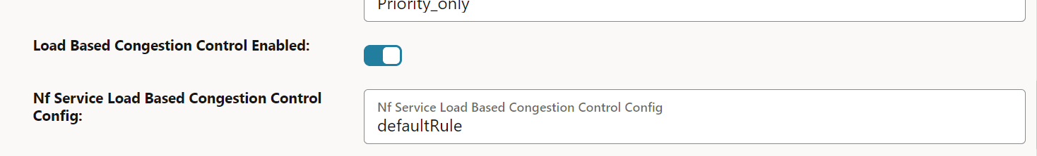

    Figure 4-50 Load based congestion control enabled
  3. Enter or modify the required values as described in "Configuring Routing Options" in Oracle Communications Cloud Native Core, Service Communication Proxy REST Specification Guide.
    Ensure that the following options are set as required to manage the "3gpp-Sbi-Discovery-preferred-locality" header as part of the Model D Indirect 5G SBI Communication feature:
    • Assign Preferred Locality
    • Override Preferred Locality
    • Forward Revised Preferred Locality
  4. In the Reroute Condition List, configure the list of error codes for rerouting:
    • Click Add to add new status code.
    • Click Edit or Delete icon to edit or remove any existing error code from the reroute condition list.
  5. In the Alternate Route section, set the Mode of the specific services as required:
    1. NF_SET: SCP performs alternate routing based on the Model C Indirect 5G SBI Communication format. This is the default mode.
    2. DNS_SRV: SCP performs alternate routing based on the DNS SRV query.
    3. NF_SET_FOLLOWED_BY_DNSSRV: SCP performs alternate routing based on the NF Set, followed by DNS SRV.
    4. STATIC_CONFIG: SCP performs alternate routing based on the static configuration.
    5. NF_SET_FOLLOWED_BY_STATIC_CONFIG: SCP performs alternate routing based on NF Set, and then using static configuration.
  6. Click Save.
  7. Click Refresh to view the updated values on the screen.

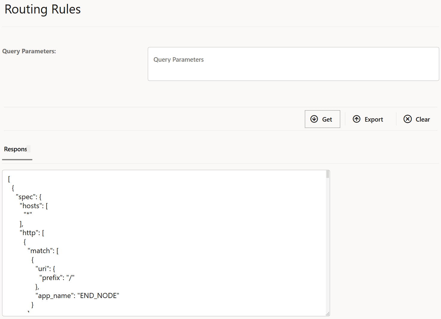

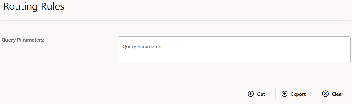

4.2.18 Fetching Routing Rules
Following is the procedure to retrieve a collection of routing rules configured at SCP:
  1. From the left navigation menu, navigate to SCP and then select Reports.
  2. Select Routing Rules. The Routing Rules screen is displayed as follows:
    Figure 4-55 Routing Rules
    Routing Rules
  3. Enter the Query Parameters in the field.
  4. Click Get to fetch the response data. The data is displayed in the Response pane.

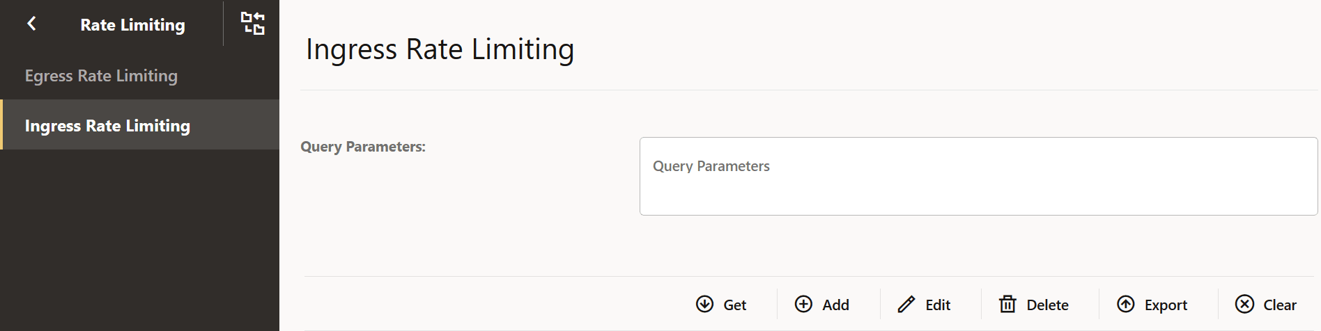

4.2.19 Configuring Ingress Rate Limiting
Following is the procedure to configure ingress rate limiting parameters:
  1. From the left navigation menu, navigate to SCP and then select Rate Limiting.
  2. Select Ingress Rate Limiting. The screen is displayed.
    Figure 4-57 Ingress Rate Limiting
    In case the response data is above the configured display limit, a message is displayed stating "Response data has crossed the configured display limit (5 MB), please click on Export to download it as a file.". Currently, the display limit cannot be modified, it is set to 5 MB.
  5. Click Add to add the ingress rate limiting configuration using the Request Body.
  6. Click Edit to edit the Request Body of the ingress rate limiting configuration.
  7. Click Delete to delete the ingress rate limiting configuration based on the query parameters.

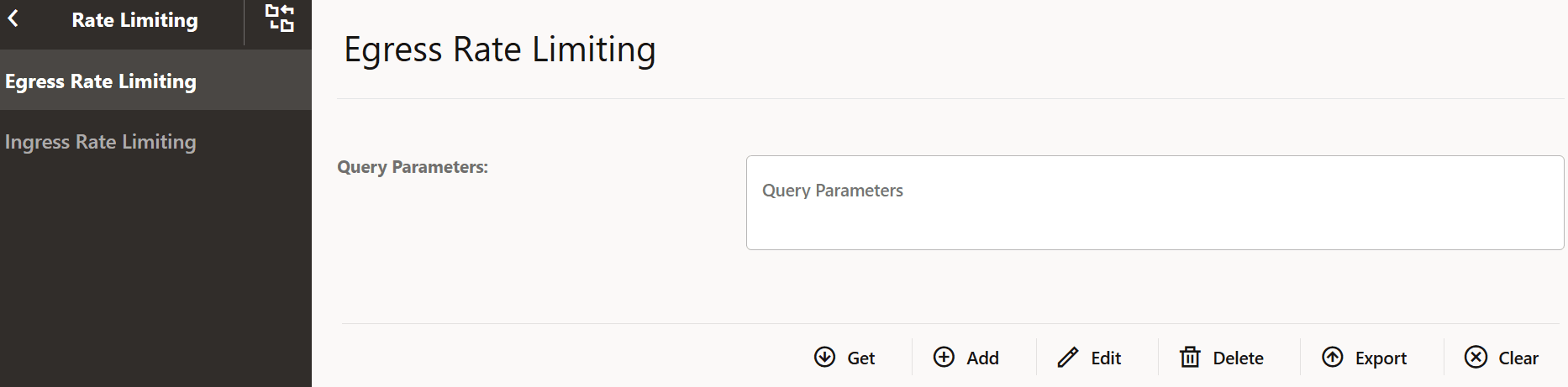

4.2.20 Configuring Egress Rate Limiting
Following is the procedure to configure egress rate limiting parameters:
  2. Select Egress Rate Limiting. The screen is displayed.
    Figure 4-58 Egress Rate Limiting
  5. Click Add to add the egress rate limiting configuration using the Request Body.
  6. Click Edit to edit the Request Body of the egress rate limiting configuration.
  7. Click Delete to delete the egress rate limiting configuration based on the query parameters.

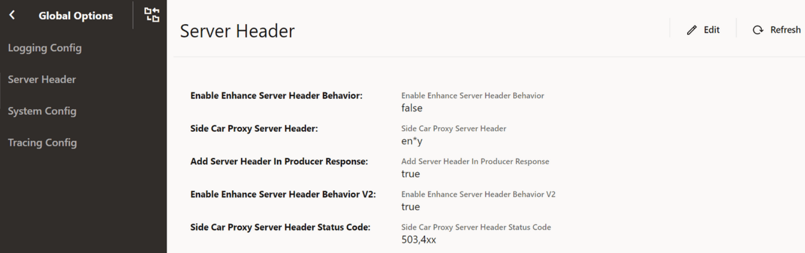

4.2.21 Configuring Server Header
Perform the following procedure to configure server header parameters to include server header in the producer NF error responses.
  1. From the left navigation pane, click the SCP tab, and then click the Global Options tab.
  2. Click the Server Header tab.
  3. In the Server Header section, click Edit.
    The Edit Server Header screen appears.
    Figure 4-59 Edit Server Header
    Edit Server Header
  4. To enable the enhanced server header behavior introduced in SCP 1.15.0, set Enable Enhance Server Header Behavior to true.
    By default, this option is disabled. For information about server header configurations, see "Configuring Server Header" in Oracle Communications Cloud Native Core, Service Communication Proxy REST Specification Guide.
  5. In the Side Car Proxy Server Header field, enter the strings to identify server header values if error response is generated by side car proxy.
    A sample value is envoy.
  6. To enable addition of server header in producer NF generated error responses, set Enable Enhance Server Header Behavior to true.
  7. To enable the enhanced server header behavior introduced in SCP 23.1.0, set Enable Enhance Server Header Behavior V2 to true.
  8. Enter status codes in the Side Car Proxy Server Header Status Code field.
  9. Click Save.

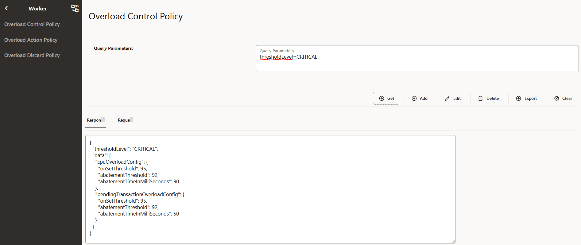

4.2.22 Configuring Pod Overload Control Policies
Perform the following procedure to configure pod overload policies to control and discard request messages sent to scp-worker.
For more information about pod overload policies, see Oracle Communications Cloud Native Core, Service Communication Proxy REST Specification Guide.
  1. From the left navigation pane, navigate to SCP and click Pod Overload Control, and then click Worker.
  2. To configure Pod Overload Control Policy, in the left navigation pane, click the Overload Control Policy tab.
    1. In the Overload Control Policy section, click Get to retrieve the scp-worker Pod Overload Control Policy data configured based on the threshold level.
      Figure 4-60 Overload Control Policy
    2. To add a new request, click Add and enter the request body information in the Request field.
    3. Click Submit.
    4. To edit, export, delete, or clear the data, click the required buttons as described in the following table:
      Table 4-39 Buttons and Field Descriptions on Overload Control Policy page
      Query Parameters Allows to enter parameters to retrieve, add, and update different pod overload policies data.
      Get Retrieve the scp-worker Pod Overload Policy data configured based on the threshold level. You can modify this data using the Edit button.
  3. To configure Pod Overload Action Policy, in the left navigation pane, click the Overload Action Policy tab.
    1. In the Overload Action Policy section, click Get to retrieve the scp-worker Pod Overload Action Policy data configured based on the threshold level.
    3. Click Submit.
    4. To edit, export, delete, or clear the data, click the required buttons as described in Table 4-39.
  4. To configure Pod Overload Discard Policy, in the left navigation pane, click the Overload Discard Policy tab.
    1. In the Overload Discard Policy section, click Get to retrieve the scp-worker Pod Overload Discard Policy data configured based on the threshold level.
    3. Click Submit.

4.2.24.2 Configuring the Default TTL Value
Perform the following procedure to configure the default Time To Live (TTL) value.
  1. From the left navigation pane, navigate to SCP and click the Global Options tab.
  2. To configure the TTL value, click the System Config tab.
  3. In the System Config section, click the Edit icon and set the TTL value as required.
    By default, this value is set to 900s. The range is between 30s to 86400s.
    Figure 4-63 Setting TTL Value
    Setting TTL Value
  4. Click Submit.

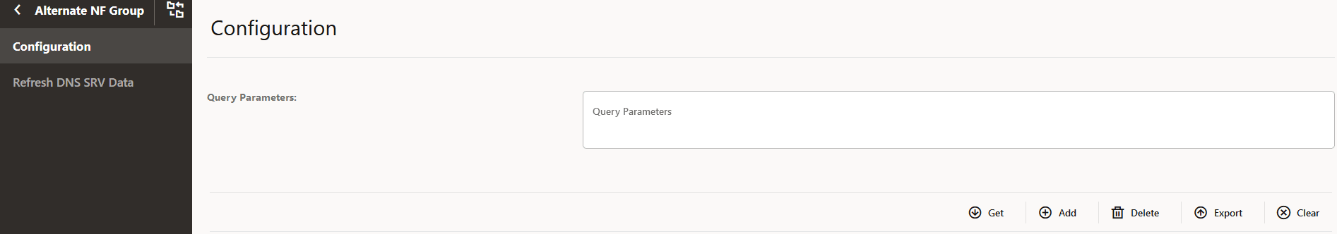

4.2.24.3 Configuring Alternate NF Group
Perform the following procedure to add and fetch DNS SRV records from DB.
  1. From the left navigation pane, navigate to SCP and click the Alternate NF Group tab.
  2. To configure DNS records using query parameters, click the Configuration tab.
  3. In the Configuration section, click Add to add query parameters in the Request field.
    Figure 4-64 Alternate NF Group Options
  4. Click Submit.
    Query parameters automatically appear in the Response field.
  5. Click Get to view all the records of the query parameter in the Response field.
  6. To export, delete, or clear the data, click the required buttons as described in the following table:

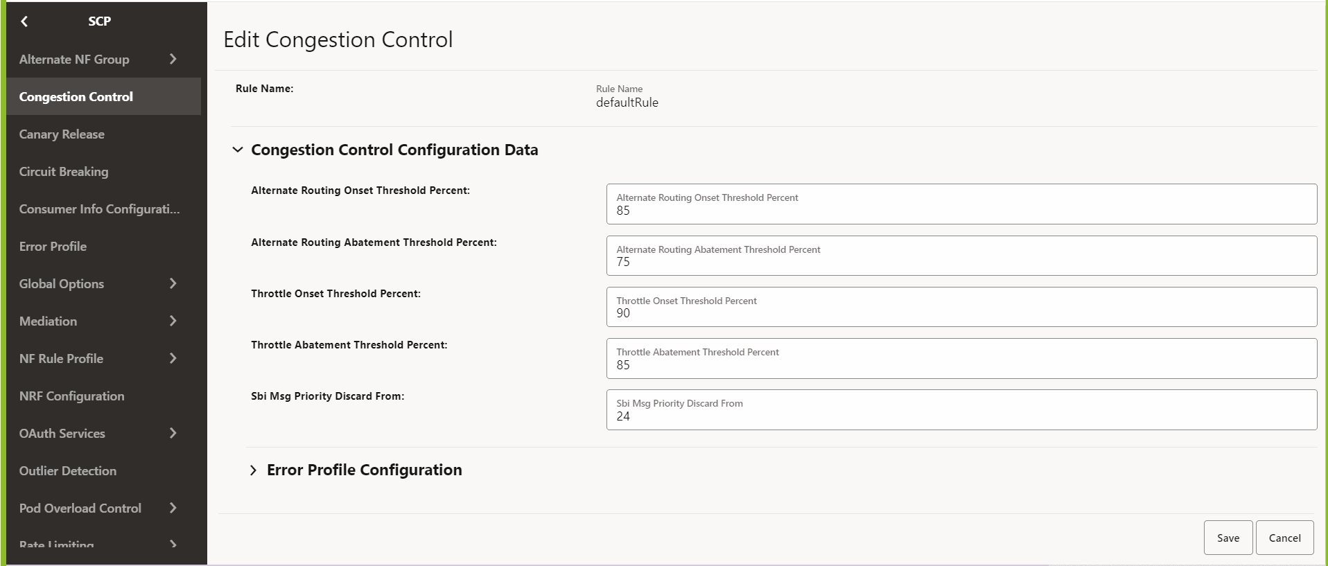

4.2.25 Configuring SBI Message Priority and Error Profiles
Perform the following procedure to configure values for determining the priority of ingress messages and create error profiles.
  1. From the left navigation pane, navigate to SCP and click the Routing Options tab.
  2. In the Routing Options section, select a service name from the Service Name column and click the corresponding edit icon.
  3. In the NFService Load Based Congestion Control section, in the SBI Message Priority Discard From field, enter a value to determine the priority of the ingress message.
    • The value of the SBI Message Priority Discard From field is compared with the "3gpp-Sbi-Message-Priority" header to categorize an ingress message request as high or low priority. By default, SCP considers 24 as the priority for the ingress message request if the message does not have the "3gpp-Sbi-Message-Priority" header. If the priority of the ingress message request is less than the value of SBI Message Priority Discard From, then the message is considered as high priority message.
    • SCP discards all the 5G SBI messages whose "3gpp-Sbi-Message-Priority" header value is equal to or greater than this configuration.
    Figure 4-65 Configuring SBI Message Priority and Error Profiles
  4. To configure the error profiles, complete the following fields:
    Table 4-43 Error Profile Configuration
    Error Code Indicates configurable error codes to be sent by SCP to consumer NFs when the producer NF is congested or throttled in case of a low priority message.
    The default value is 503, which indicates: Service Unavailable.
    The default value is NF_CONGESTION.
    Error Title Indicates the title of the error type.
    The default value is NF service is overloaded or congested.
    Retry After Indicates the time during which the service is unavailable. It is applicable when the error code is 503.
    When the error code is 3xx, where x indicates any numeric value, it specifies the minimum time that the user must wait before issuing the redirected request.
    The default value is 5. The unit of this value can be HTTP-date or delta-seconds. For example:
    • Fri, 31 Dec 2001 23:59:59 GMT
    • 120
      In the latter example, the delay is 2 minutes.
    Redirect Url Retries the request towards the directed resource referred in the Location header using the same request method.
    Example:
    https://udm1.udmsvc.domain/USEast/nudm-sdm/v1/path2
  5. Click Save.
4.2.26 Configuring the nextHopSCP Routing Option
Perform the following procedure to configure the nextHopSCP routing options.
    The Routing Options screen appears with the list of services.
  2. To edit the Next Hop SCP section, click the Edit icon for the corresponding service name.
  3. Expand the Next Hop SCP Routing Options option.
    Figure 4-66 NextHopSCP
    NextHopSCP
  4. Configure the following fields as required:
    Table 4-44 Configuring Next Hop SCP Routing Options
    Response Timeout
    Indicates the allotted time to respond to a message request. When the response timeout expires, SCP performs alternate rerouting to the available alternate NF or pod.
    If no alternate NFs or pods are available, SCP sends an error message.
    The default value is 4 seconds.
    Total Transaction lifetime
    Indicates the total time allowed to forward a request, including initial and all subsequent routing attempts.
    Note: The total time consumed in processing all retries must not exceed the total transaction lifetime.
    The default value is 7 seconds.
    Max Routing Attempts
    (Service Level)
    Indicates the maximum number of forward routing attempts made at a service level.
    • Maximum number of times SCP is allowed to forward a request message. If the Max Routing attempts value is set to 1 for both service and pod level, the total transaction lifetime field value is not required. If the Max Routing attempts value is set to greater than 1 for both service and pod level, then the total transaction lifetime field value is considered for rerouting processing.
    • Rerouting of request messages is always considered as Max Routing attempts value minus one (-1), that is, Rerouting of request messages = (Max Routing attempts value) -1
    The default routing attempt is 2.
    (Service Endpoint Level)
    Indicates the maximum number of forward routing attempts at NF or pod level.
    The default routing attempt is 1.
    Alternate Routing Onset Threshold Percent
    (NFService Load Based Congestion Control Level)
    Indicates the percentage of Alternate Routing Onset Threshold Percent.
    The default value is 80%.
    Alternate Routing Abatement Threshold Percent
    Indicates the percentage of Alternate Routing Abatement Threshold Percent.
    The default value is 75%.
    Throttle Onset Threshold Percent
    Indicates the percentage of Throttle Onset Threshold Percent.
    The default value is 90%.
    Throttle Abatement Threshold Percent
    Indicates the percentage of Throttle Abatement Threshold Percent.
    The default value is 85%.
  5. Click Save.

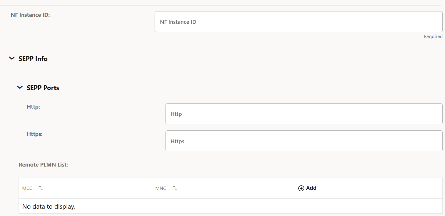

    Figure 4-67 Adding a New NF Instance ID
  4. In the NF Instance ID field, enter an instance ID, for example, 8faf1bbc-6e4a-4454-a507-aef01a101a06.
  5. Expand the SEPP Info option to configure SEPP ports as follows:
    1. In the Http field, enter a value between 0 and 65535.
      This field is applicable for the HTTP connection.
    2. In the Https field, enter a value between 0 and 65535.
      This field is applicable for the HTTPS connection.
      If both the fields are configured, then the HTTPS connection is preferred.
  6. To configure PLMN IDs supported by SEPP, in the Remote PLMN List section, click Add.
    Figure 4-68 Supported PLMN by SEPP
    1. In the MCC field, enter the required mobile country code.
      Mobile Country Code (MCC) is a three digit number ranging from 0 to 9.
    2. In the MNC field, enter the required mobile network code.
      Mobile Network Code (MNC) can be of two or three digits ranging from 0 to 9.
    3. Click Save.
  7. Click Save.

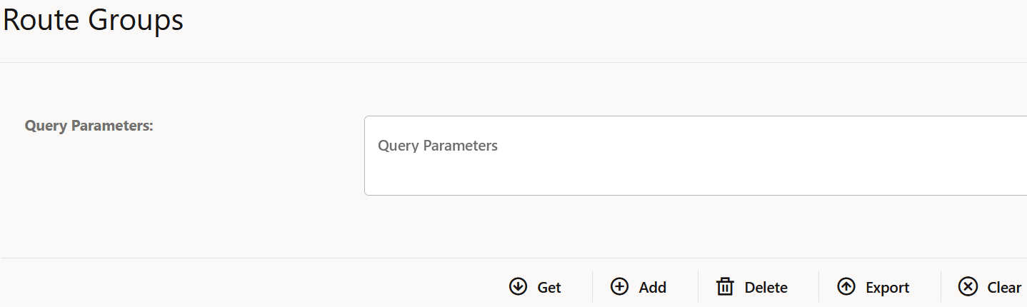

4.2.28 Configuring Route Groups
Perform the following procedure to configure Route Groups parameters.
  1. From the left navigation pane, click the SCP tab, and then click the Route Groups tab.
    The Route Groups screen appears.
    Figure 4-69 Route Groups
    Route Groups
  2. In the Route Groups section, click Add to add request body in the Request field.
    Query parameters are applicable only for DELETE and GET resource types.
  3. Click Submit.
    Response body automatically appears in the Response field.
  4. Click Get to view all the records of the response body in the Response field.
  5. To export, delete, or clear the data, click the required buttons as described in the following table, and then click Submit.
    Table 4-46 Route Groups Buttons and Field Descriptions
    Button and Field Name Description
    Response Displays the required Route Groups records.
    Request Allows you to add a query parameter when you click the Add button.
    Query Parameters Processes routeGroupId, routeGroupType, or primaryRoute parameters.
    Get Retrieves configured route groups based on the supplied query parameters as filtering criteria.
    Export Exports Route Groups records in the JSON format.
    Delete Removes the configuration of an existing route group.
    Clear Resets all the fields in this screen.
    Add Configures a new route group or replaces an existing route group by providing a route group configuration in the request body.
4.2.29 Configuring Ingress Rate Limiter Consumer Info
Perform the following procedure to configure consumer information for ingress rate limiting.

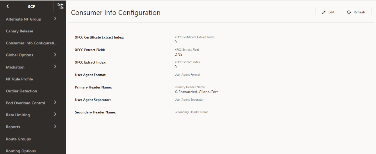

  1. From the left navigation pane, click the SCP tab, and then click the Ingress Rate Limiter Consumer Info tab.
    The Ingress Rate Limiter Consumer Info screen appears:
    Figure 4-70 Ingress Rate Limiter Consumer Info
  2. In the Ingress Rate Limiter Consumer Info section, click Edit, and then configure the fields as described in the following table:
    Table 4-47 Configuring Consumer Information
    XFCC Certificate Extract Index
    The certificate extract index contains certificate information in the XFCC header.
    This parameter is used to decode "X-Forwarded-Client-Cert" for the FQDN.
    The default value is 0.
    XFCC Extract Field
    This is the name of the field that has to be retrieved from the XFCC header.
    The default value is DNS.
    XFCC Extract Index
    Index where the field configured in 'extractField' is present in the XFCC header for extraction.
    User Agent Format
    The header format to identify the consumer NF according to the ingress rate limiting configurations.
    It supports the following formats:
    • Format1: NFTYPE-NFINSTANCEID FQDN or NFTYPE-NFINSTANCEID-FQDN
    • Format2: NFTYPE-FQDN NFINSTANCEID or NFTYPE-FQDN-NFINSTANCEID
    • Format3: NFTYPE-NFINSTANCEID
    • Format4: NFTYPE-FQDN
    • Format5: NFTYPE
    Where,
    • NFTYPE indicates the type of consumer NF.
    • NFINSTANCEID indicates the instance ID of the consumer NF.
    • FQDN indicates the FQDN of the consumer NF.
    In the aforementioned example, "-" is a separator and NFInstanceID, FQDN, and Hostname are supported IDs.
    Primary Header Name
    The header name to identify the consumer NF according to the ingress rate limiting configurations.
    This is a mandatory parameter. This parameter is given priority over the secondaryHeaderName parameter.
    The default value is "X-Forwarded-Client-Cert".
    It can use the following values:
    • "User-Agent"
    • "X-Forwarded-Client-Cert"
    User Agent Separator
    This is the separator that the User-Agent header uses to separate NFINSTANCEID and FQDN.
    The default value is "SPACE".
    • "SPACE"
    • "HYPHEN"
    Secondary Header Name
    This is an optional parameter.
    The default value is "".
    • "User-Agent"
  3. Click Save.

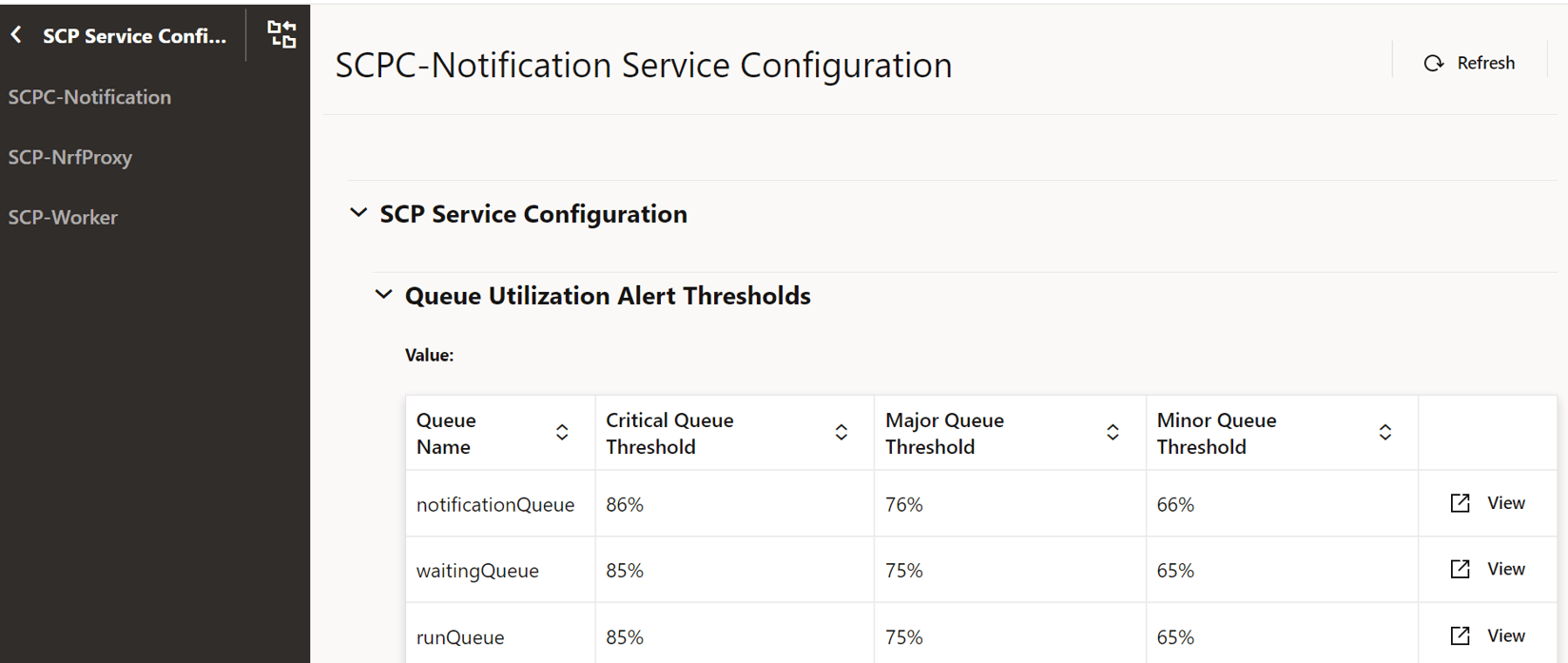

    2. To view the threshold values of different queues, expand the Queue Utilization Alert Thresholds option.
      The SCPC-Notification Service Configuration screen displays the queue values for critical, major, and minor threshold.
      Figure 4-71 SCPC-Notification Service Configuration
      The following table describes the significance of each column to determine the values of critical, major, and minor threshold.
      The critical, major, and minor threshold values are automatically populated in the CNC Console and cannot be modified. These values are configured using REST APIs as described in "Configuring SCP Services" in Oracle Communications Cloud Native Core, Service Communication Proxy REST Specification Guide.
      Table 4-48 Queue Utilization Alert Thresholds
      Queue Name Indicates the name of the queue for which these configurations are applicable.
      Critical Queue Threshold Indicates the percentage (%) value for queue usage threshold upon reaching which a "critical" alert is raised.
      Major Queue Threshold Indicates the percentage (%) value for queue usage threshold upon reaching which a "major" alert is raised.
      Minor Queue Threshold Indicates the percentage (%) value for queue usage threshold upon reaching which a "minor" alert is raised.

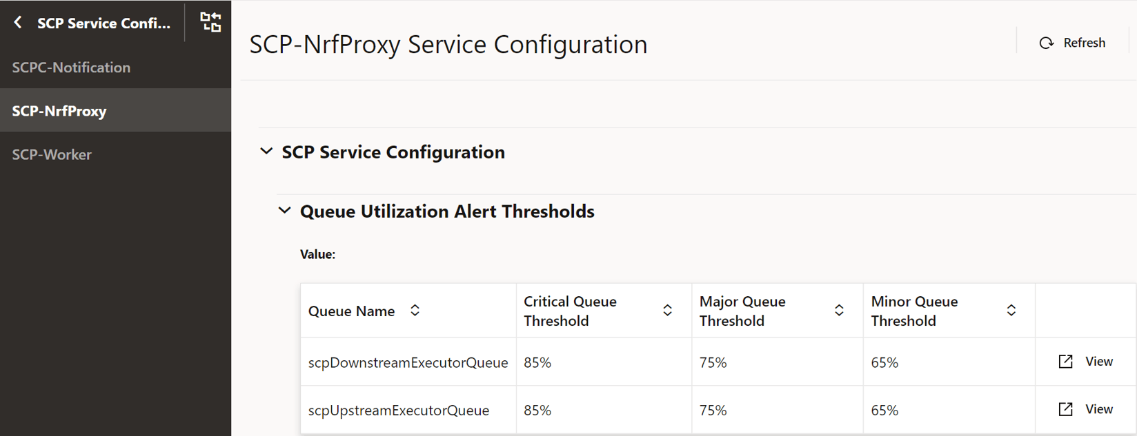

  8. In the left navigation pane, click the SCP-NrfProxy tab and do the following:
    1. In the SCP-NrfProxy Service Configuration section, expand the SCP Service Configuration option.
      The SCP-NrfProxy Service Configuration screen displays the queue values for critical, major, and minor threshold.
      Figure 4-72 SCP-NrfProxy Service Configuration
      The queue utilization alerts threshold values are automatically populated in the CNC Console as described in Table 4-48.

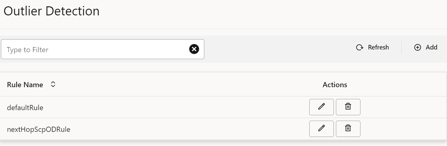

4.2.31 Configuring Outlier Detection
Perform the following procedure to add, edit, or remove any existing rule name for outlier detection.
  1. From the left navigation pane, click the SCP tab, and then click the Outlier Detection tab.
    The Outlier Detection screen appears.
    Figure 4-74 Outlier Detection
    Outlier Detection
  2. If you want to edit or remove any existing rule name from the Rule Name column, click Edit or Delete icon in the Actions column.
  3. To add new rule names, click Add.
  4. In the Add Outlier Detection section, configure the following fields:
    • Rule Name: Enter a unique rule name that is available in the outlier detection table.
    • Consecutive Errors: Enter a value between from 5 to 500 to define the number of consecutive errors after which an endpoint is considered unhealthy.
    • Interval: Enter a value from 30 seconds to 86400 seconds to set the interval after which stale records are removed from the outlier data cache.

4.2.34 Routing Options Configurations
Perform the following procedure to view or edit Routing Options Configuration parameters.
  1. From the left navigation menu, navigate to SCP, and then click the Routing Options Configuration tab.
  2. In the Routing Options Configuration section, click Edit from the Actions column for the required service that must be modified.
    The Edit Routing Options Configuration screen appears.
    Figure 4-76 Routing Options Configuration
  3. In the Routing Options Config Name, configure the following:
    • NF Type: Set the NF type for which routing options are to be configured.
    • Service Name: Set the NF service name for the routing options to be configured.
    • Message Type List: Set the routing options for notification or SBI messages.
    • Routing Options Config SetName: Enter the name of the routing configuration used to retrieve routing options.
  4. Enter or modify the required values as described in "Routing Options Configuration"and "Routing Config Set" in Oracle Communications Cloud Native Core, Service Communication Proxy REST Specification Guide.
  5. Click Save.
