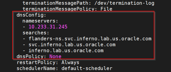

      Change the deployment file to add following content in alternate service to query DNS stub.
      kubectl edit deployment ocbsf-occnp-alternate-route -n ocbsf
      • Add the nameservers IPaddress.
      • Add all the search information.
      • Set dnsPolicy to None.
        dnsConfig:
          nameservers:
           - <dns_stub_cluster_ip_address>
           searches:
           - dns-bind search
           - dns-bind search
           - dns-bind search
           dnsPolicy: None
        Figure 4-3 dnsConfig
        dnsConfig

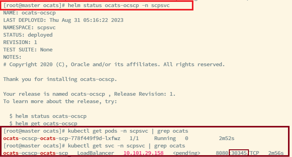

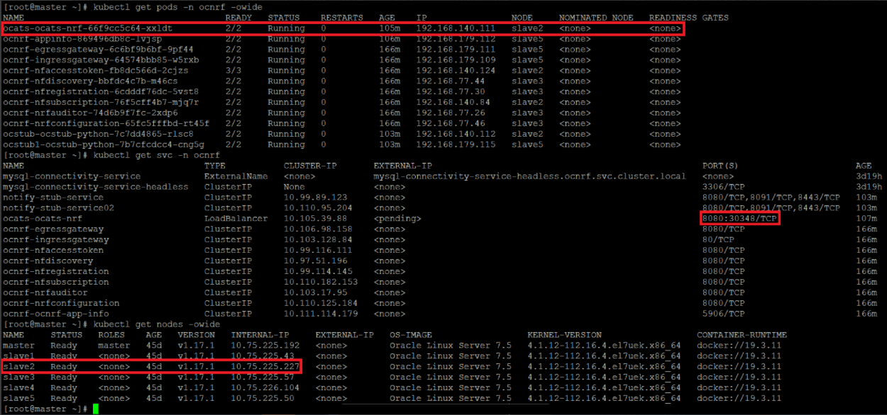

Before logging into ATS GUI, it is important to get the worker node external IP and node port of the service, 'ocats-bsf'.
Run the following command to get the external IP for the worker node:
Example:
kubectl get nodes -owide
The output of the command is:
ocbsf-k8s-node-1        Ready    <none>   111d   v1.16.7   192.168.200.26   10.75.152.111   Oracle Linux Server 7.8   4.14.35-1902.303.5.3.el7uek.x86_64   containerd://1.2.10
Run the following command to get the nodeport:
kubectl get svc -n <BSF_namespace>
Example:
kubectl get svc -n ocbsf
ocbsf-ocats-ocats-bsf     LoadBalancer   10.233.53.144   10.75.225.49     8080:31944/TCP      19h

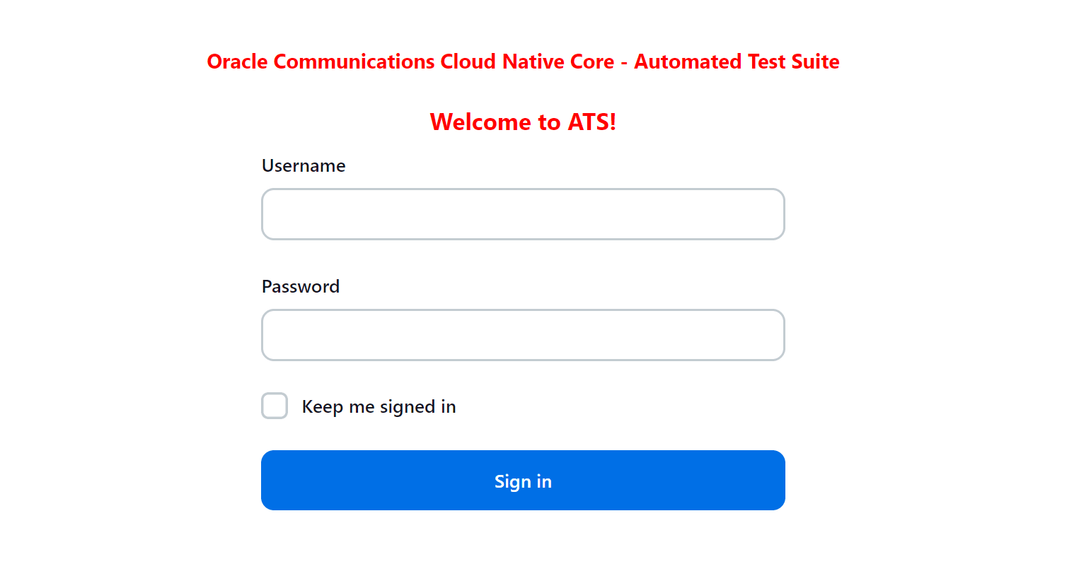

To log in to ATS, open the web browser and type the following URL:
http://<Worker-Node-IP>:<Node-Port-of-ATS>
If the 'ocats-bsf' Service has an external IP available, <SVC external IP> can also be used to log in to ATS.
http://<External IP of ATS Service>:8080
Example:
http://10.75.225.49:8080
Running ATS
To run ATS test cases, perform the following steps:

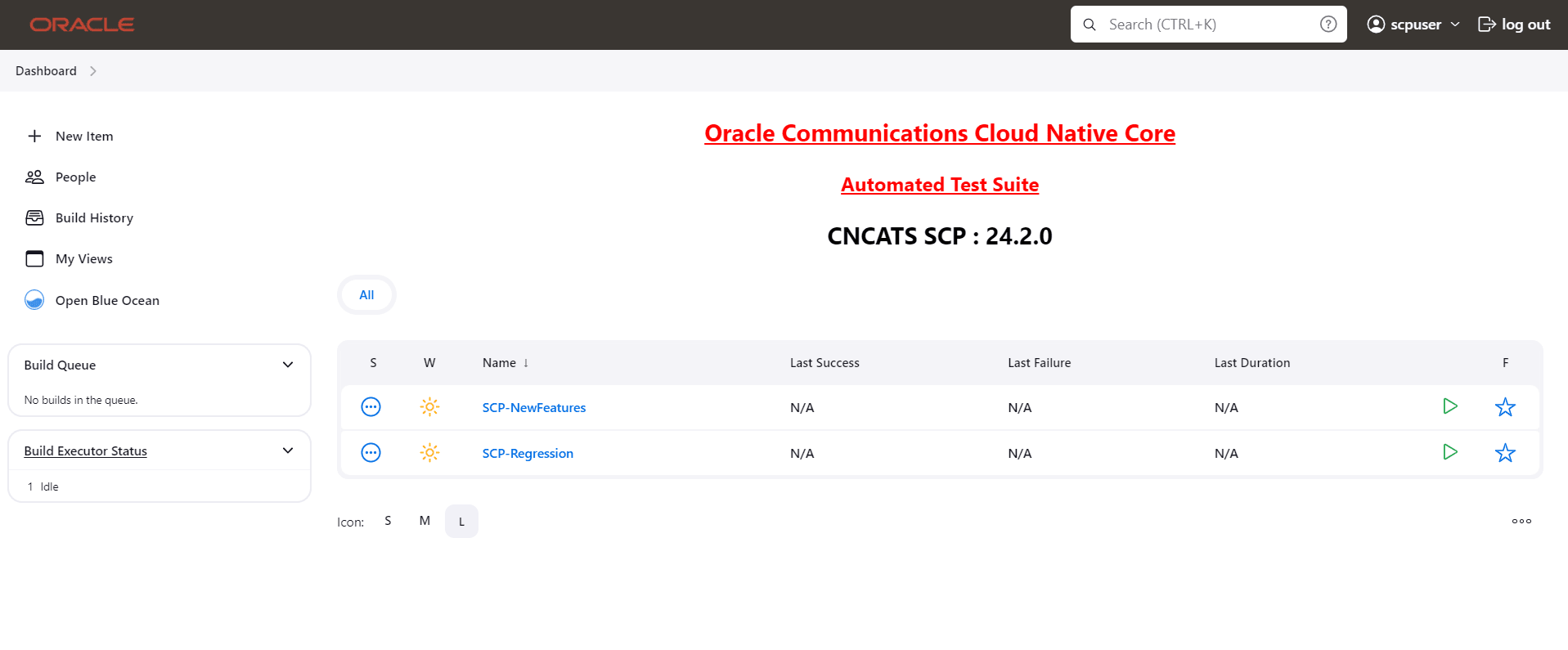

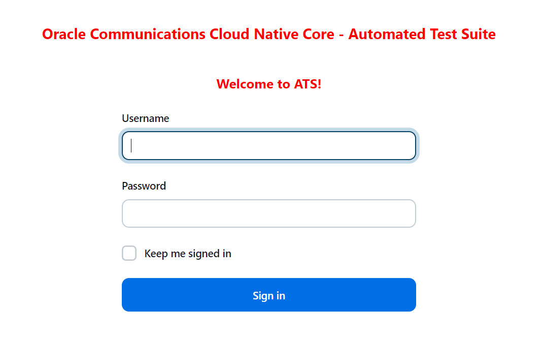

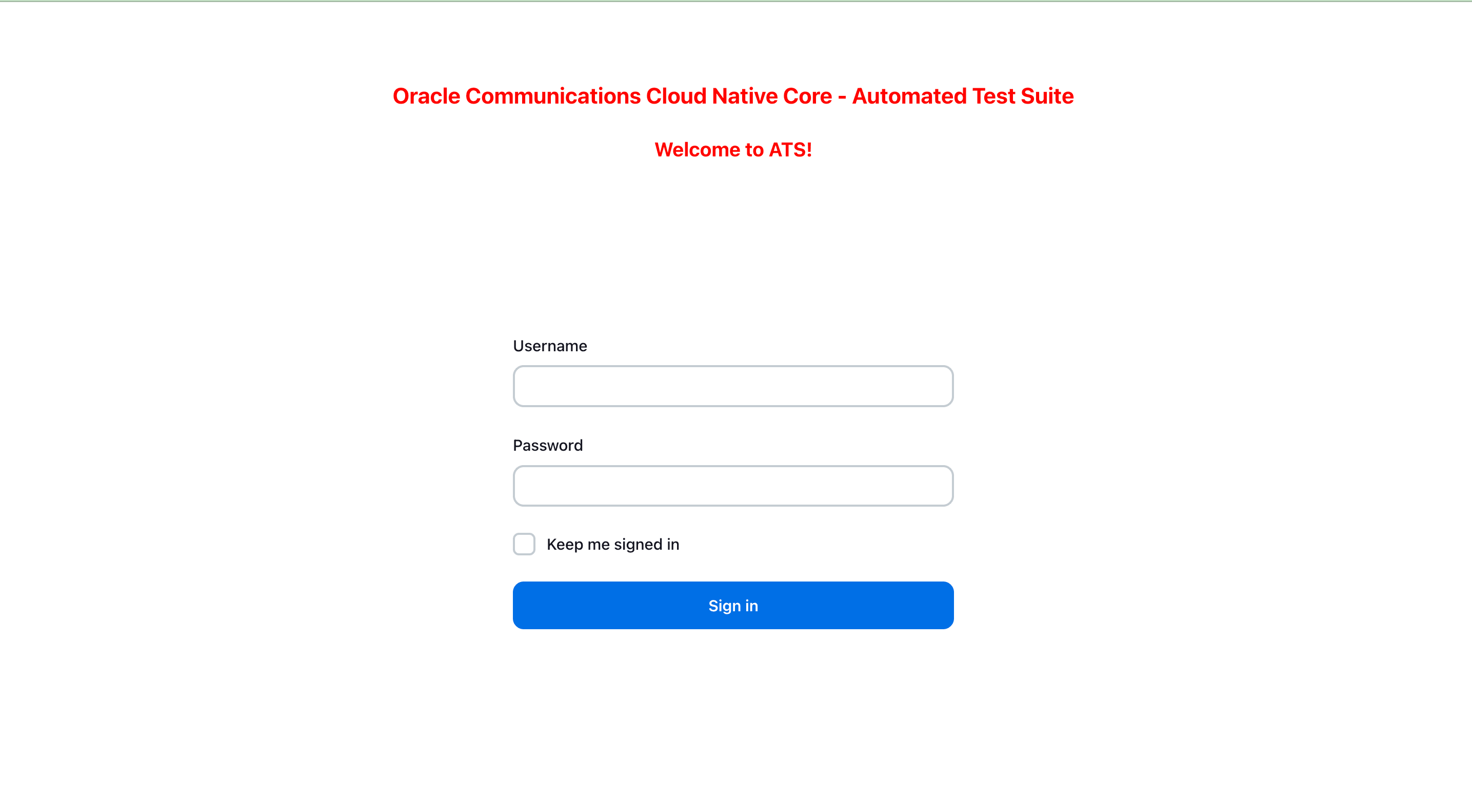

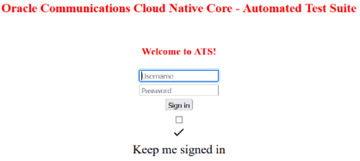

  1. Enter the username as bsfuser and password as bsfpasswd.
  2. Click Sign in.
    To modify default login password, see Modifying Login Password.

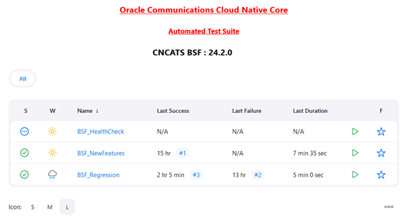

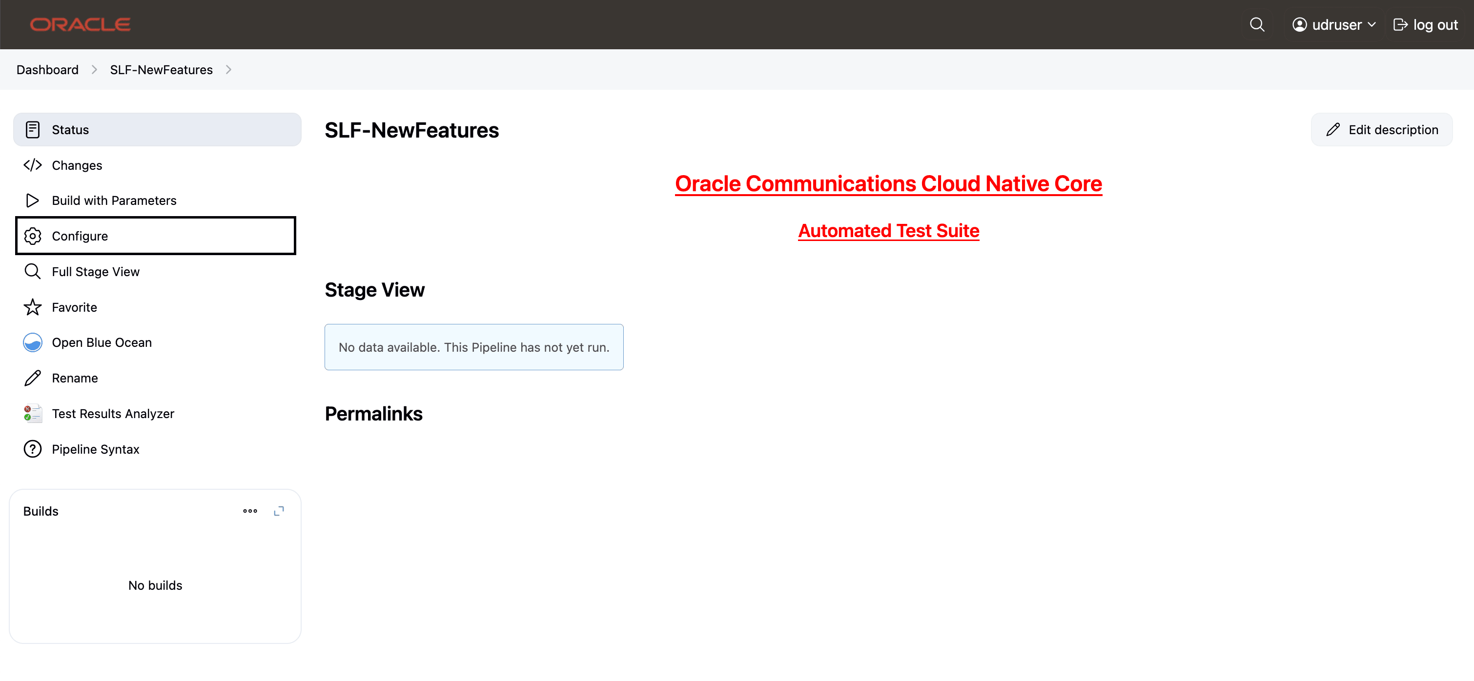

    Figure 4-4 Pre-configured Pipelines
    On succesful log in, users should see the following pipelines:
    • BSF-NewFeatures: This pipeline has all the new test cases delivered for BSF 24.2.4.
    • BSF-Performance: This pipeline is not operational as of now. It is reserved for future releases of ATS.
    • BSF-HealthCheck: This pipeline checks if BSF and ATS are deployed correctly. This shows only when the user has enabled this feature at the time of installing BSF ATS.
    • BSF-Regression: This pipeline has all the test cases delivered in BSF ATS - 24.1.0

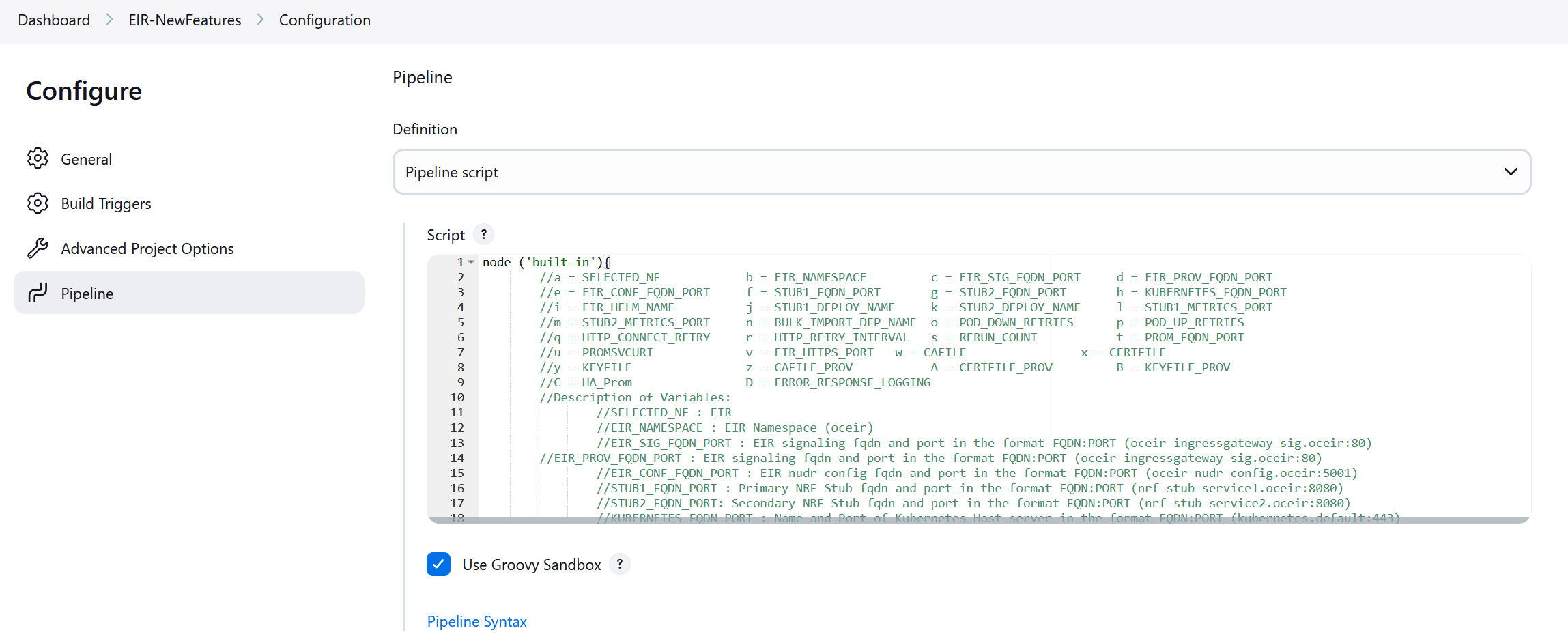

4.1.3 Running BSF_NewFeatures Pipeline

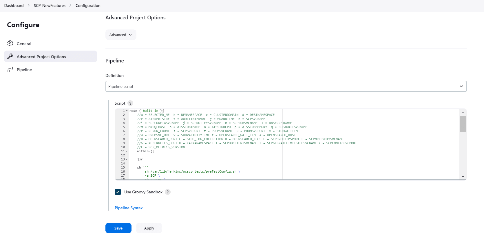

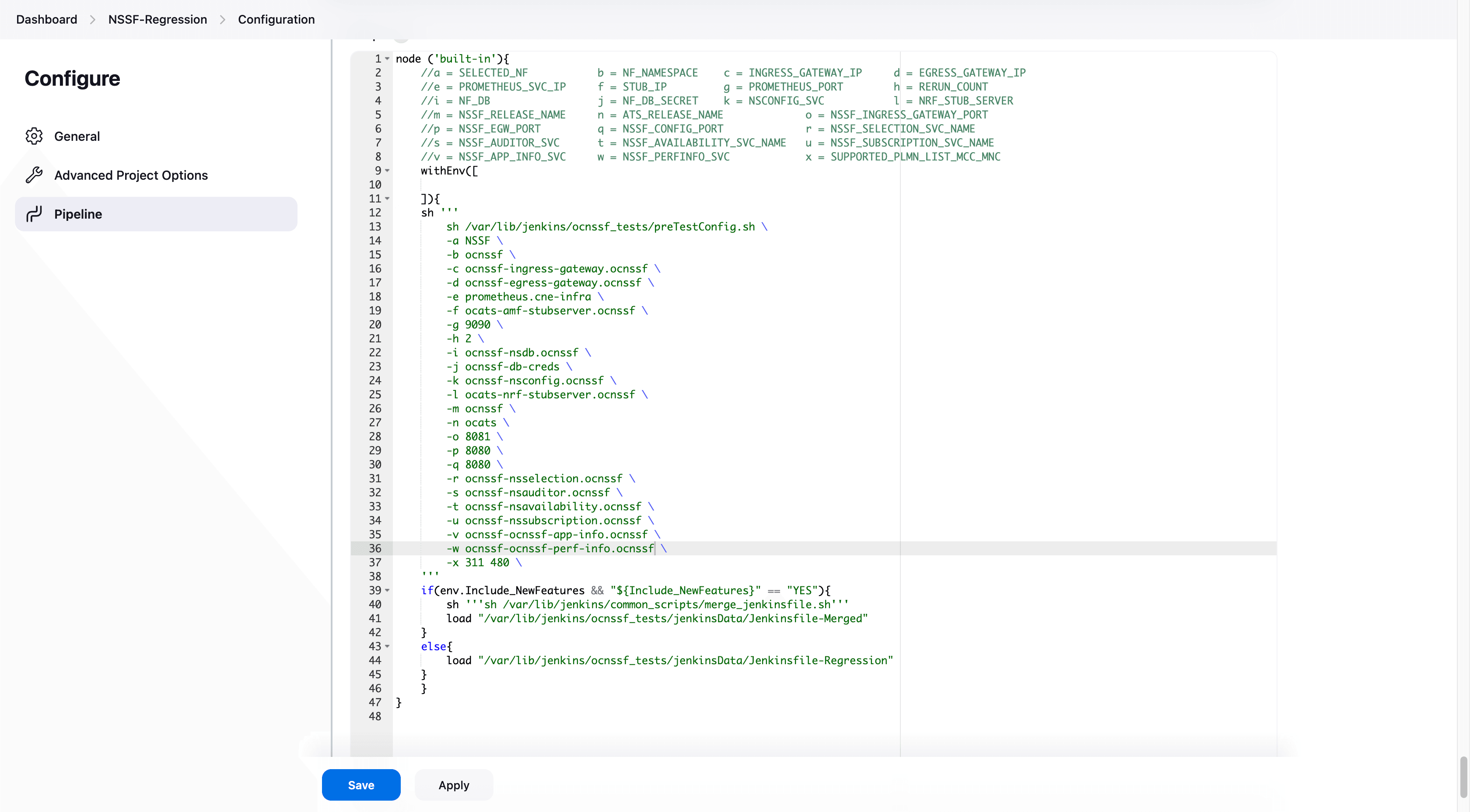

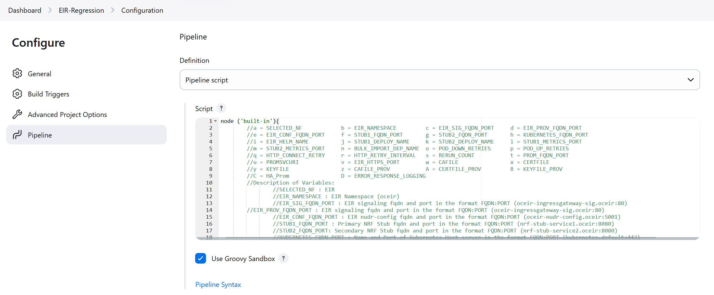

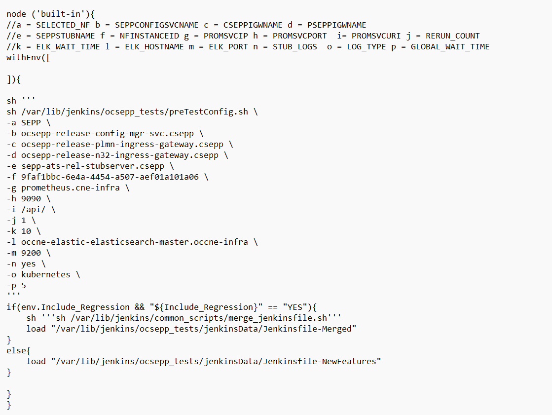

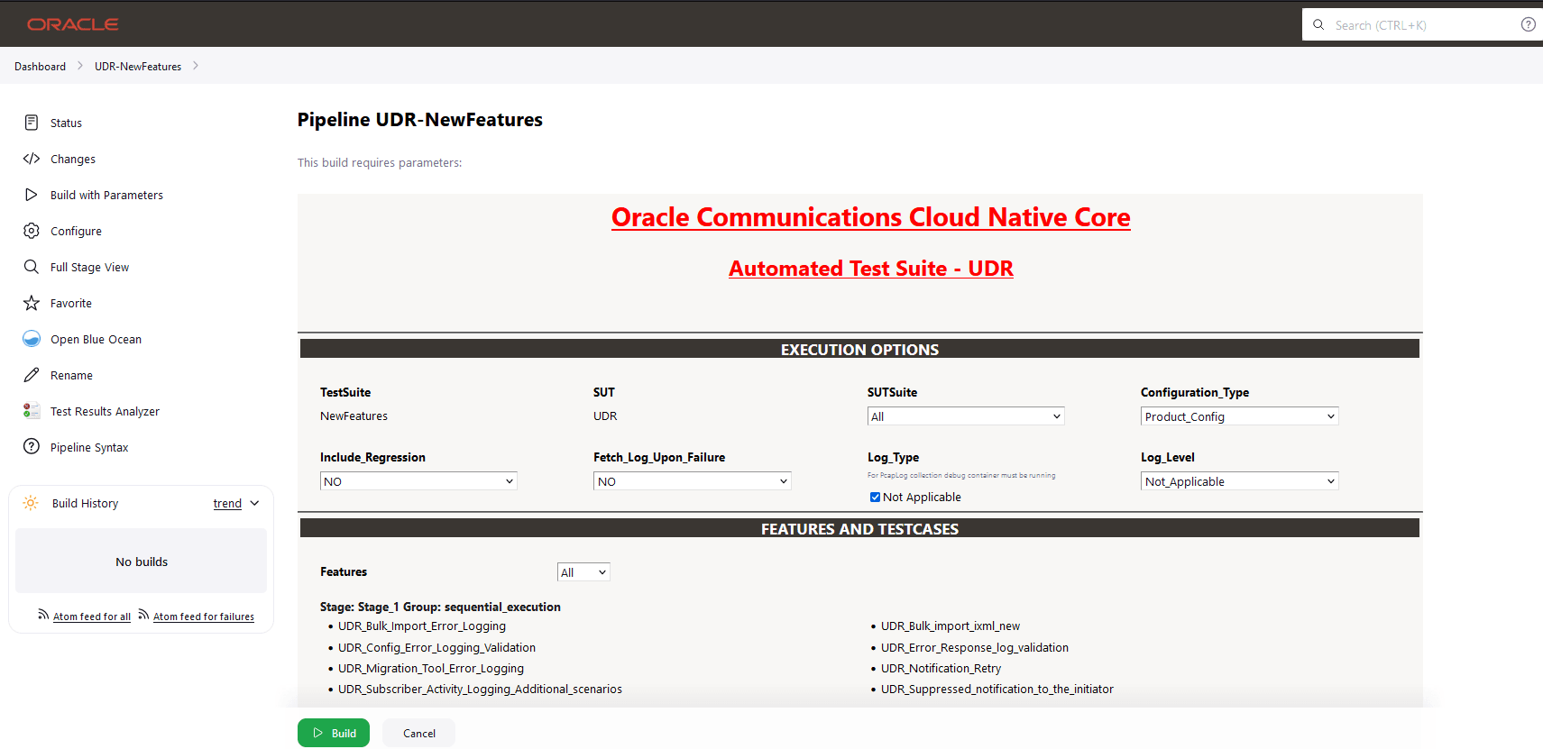

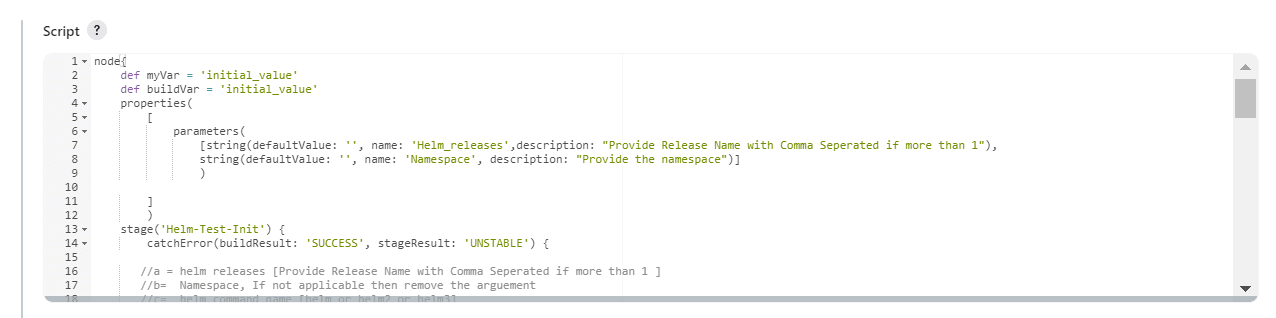

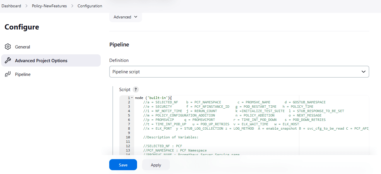

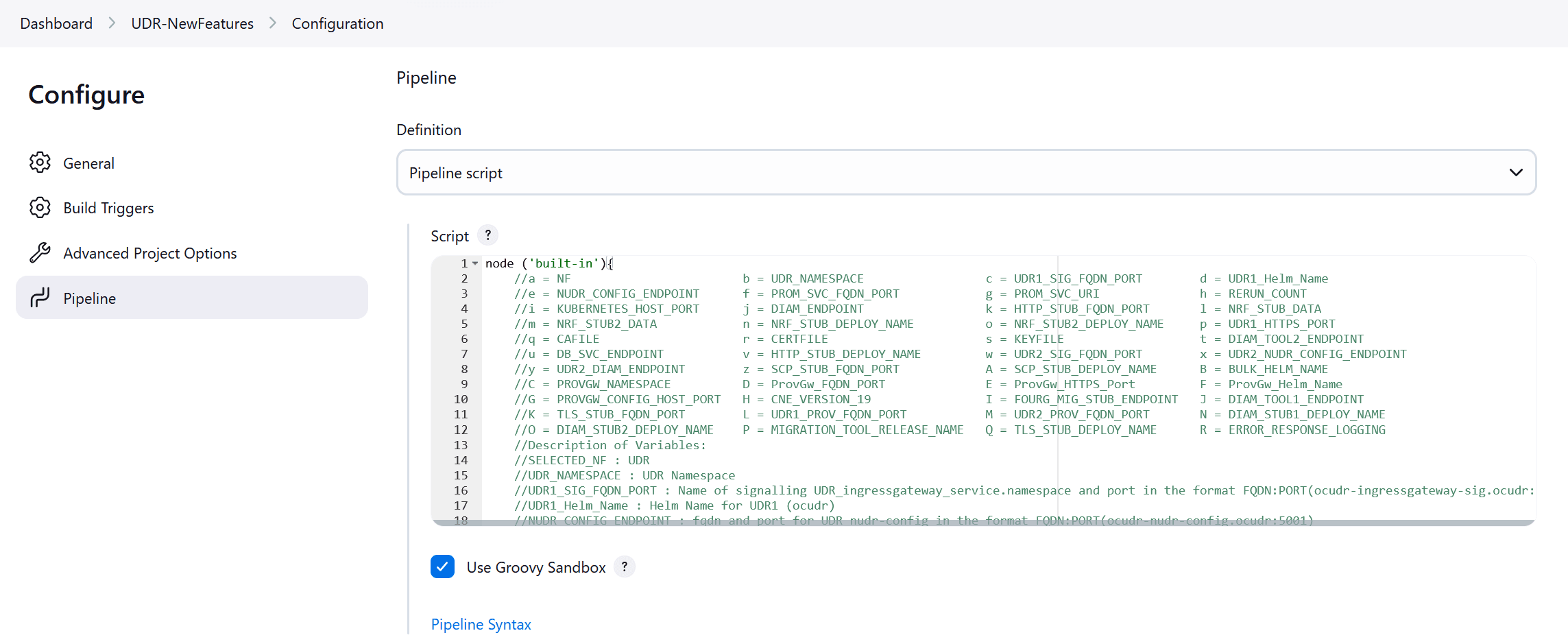

This is a pre-configured pipeline where users can run all the BSF new test cases. To configure its parameters, which is a one time activity, perform the following steps:

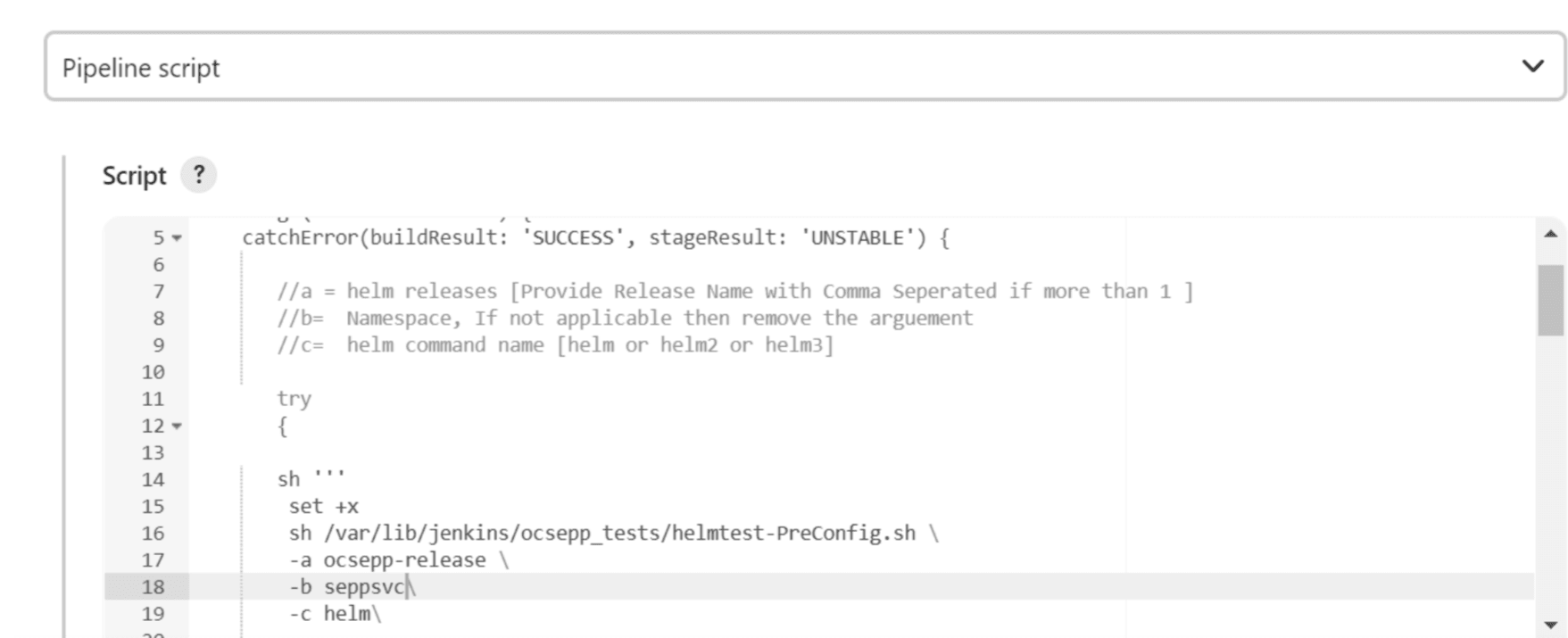

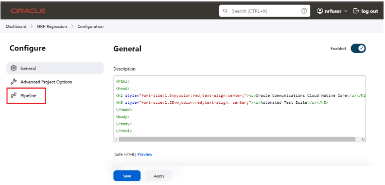

  1. Click BSF_NewFeatures in the Name column and then, click Configure in the left navigation pane as shown below:
    Figure 4-5 BSF New Feature Pipeline

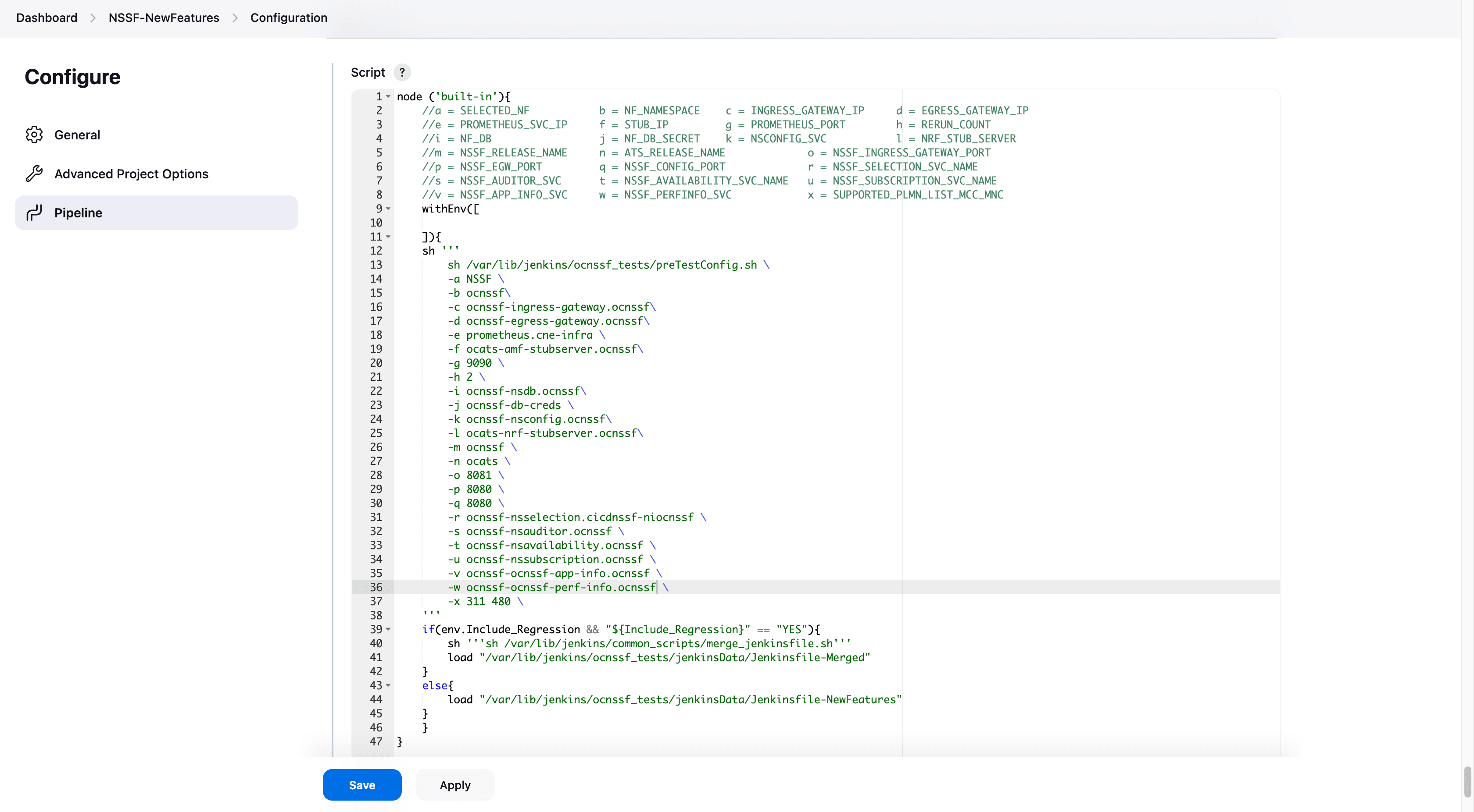

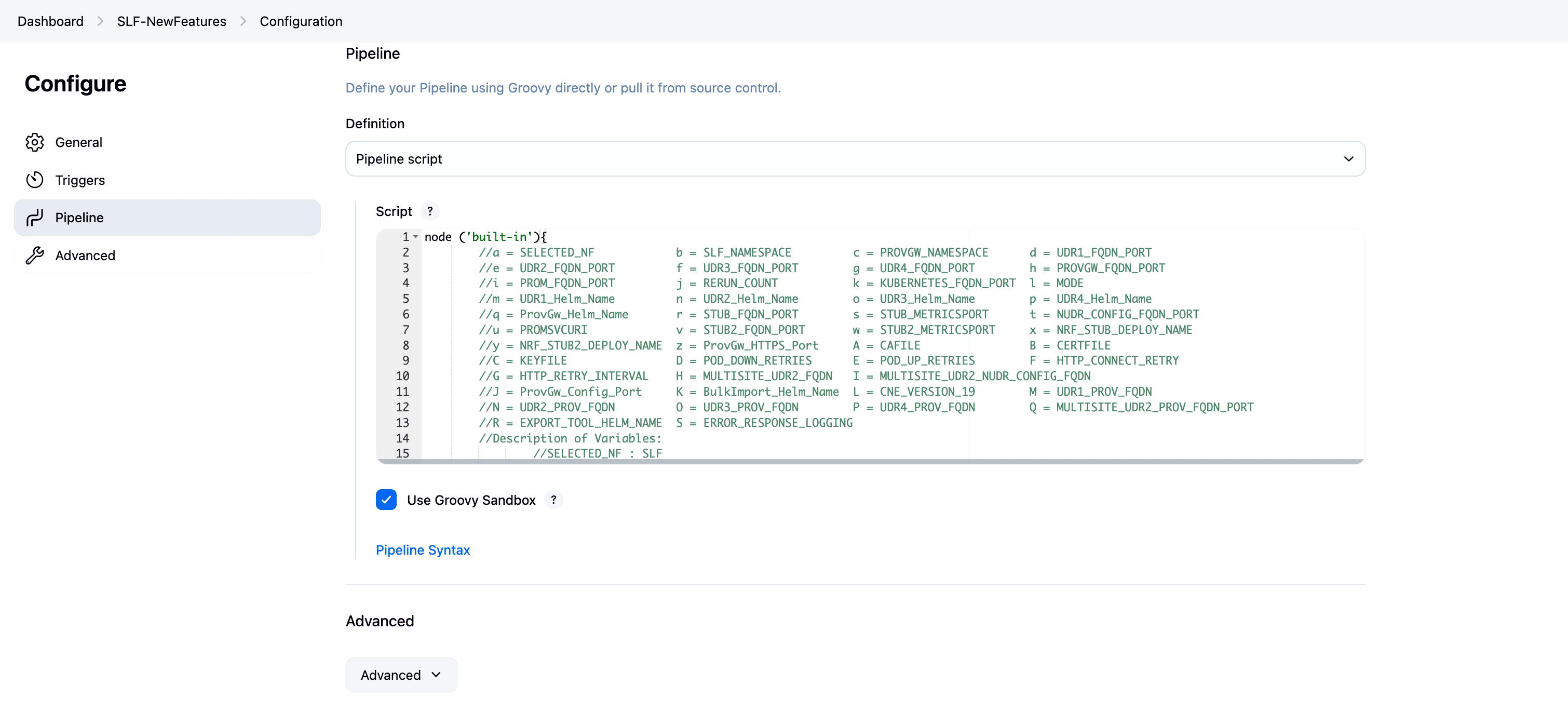

  2. The BSF_NewFeatures, General tab appears. Make sure that the screen loads completely.

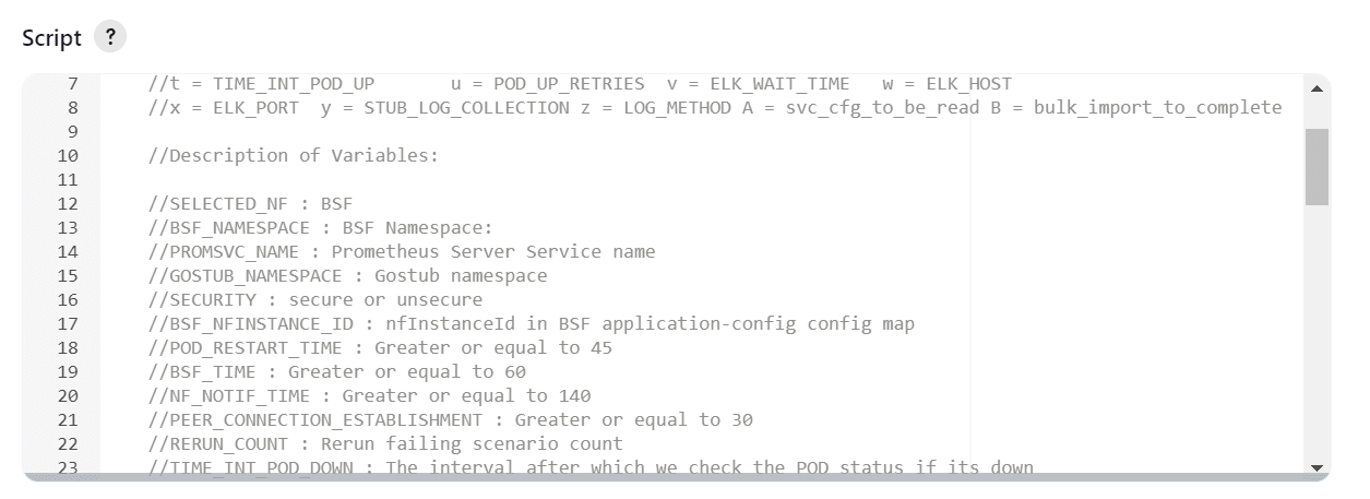

  3. Scroll-down to the end. The control moves from General tab to the Pipeline tab as shown below:
    BSF New Features Pipeline
    You can change the parameter values from "a" - to - "x" as per user requirement. The parameter details are available as comments from line number 2 - to - 7. In the Script area of the Pipeline section, you can change the values of the following parameters:
    • b: Change this parameter to update the namespace where BSF was deployed in your bastion.
    • d: Change this parameter to update the namespace where your gostubs are deployed in your bastion.
    • e: Set this parameter as 'unsecure', if you intend to run ATS in TLS disabled mode. Else, set this parameter as 'secure'.
    • f: Configure this parameter to set BSF_NFINSTANCE_ID.
    • g: Set a value more than 45 seconds for this parameter. The default wait time for the pod to come up is 45 seconds. Every TC requires restart of the nrf-client-management pod.
    • h: Set a value more than 60 seconds for this parameter. The default wait time to add a configurations to the database is 60 secs.
    • i: Set this parameter to more than 140 secs. The default wait time for Nf_Notification Test Cases is given as 140 secs.
    • k: Use this parameter to set the waiting time to initialize Test Suite.
    • l: Use this parameter to set the waiting time to get response from Stub.
    • m: Use this parameter to set the waiting time after adding BSF Configuration.
    • n: Use this parameter to set the waiting time for Peer connection establishment.
    • o: Use this parameter to set the waiting time before sending next message.
    • p: Use this parameter to set Prometheus Server IP.
    • q: Use this parameter to set Prometheus Server Port.
    • r: Use this parameter to set the interval after which the POD status is checked when it is down.
    • s: Use this parameter to set number of retry attempt in which will check the pod down status
    • t: Use this parameter to set the interval after which we check the POD status if its UP.
    • u: Use this parameter to set number of retry attempt in which will check the pod up status.
    • v: Use this parameter to set Wait time to connect to Elastic Search.
    • w: Use this parameter to set Elastic Search HostName.
    • x: Use this parameter to set Elastic Search Port.
    • y: Use this parameter to set To Enable/Disable Stub logs collection.
    • z: Use this parameter to set Log collection endpoint either Elasticsearch or Kubernetes.
    • A: Use this parameter to set Timer to wait for importing service configurations.
    • B: Use bulk_import_to_complete to add custom time in Jenkins post bulk imports.
    • C: Use this parameter to set TLS version (1.2 or 1.3). The default value is 1.2.

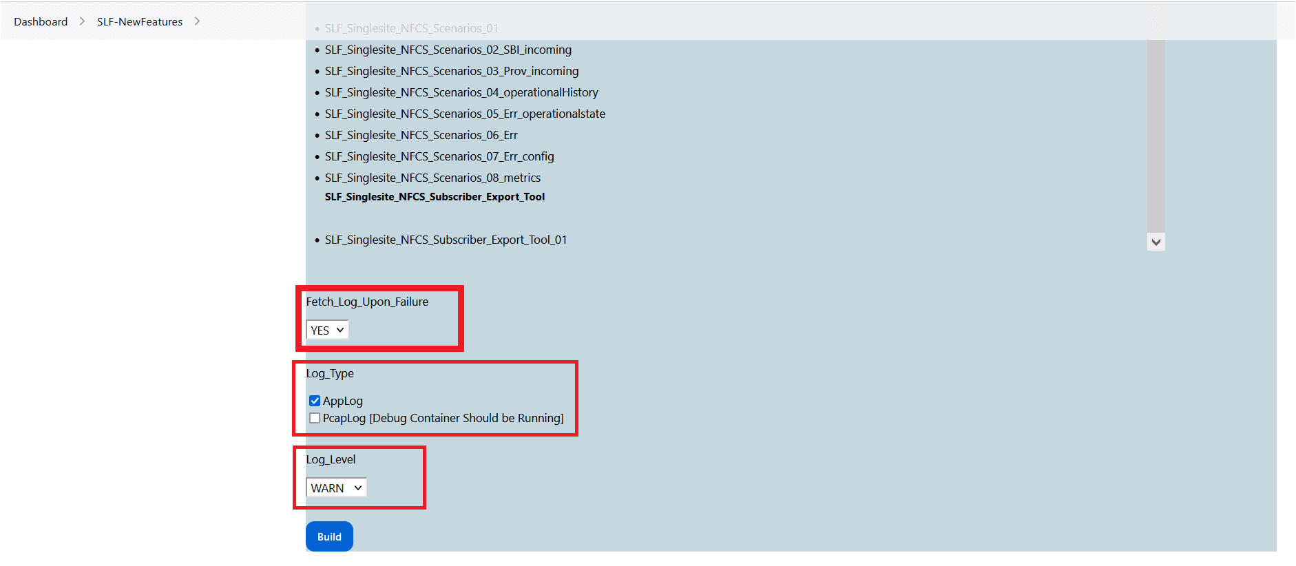

    (Optional)To collect application logs per failed scenario, user can configure the values for the following parameter:
    • z: If you want log collection to happen through Elastic search, set the value for this parameter as Elasticsearch. If not, specify the value as Kubernetes.
      If you want to collect logs through Elastic search, it is required to configure the values for the following parameters:
      • v: Specifies the wait time to connect to Elastic search (ELK_WAIT_TIME).
      • w: Specifies the host name of Elastic search (ELK_HOST). For example, occne-elastic-elasticsearch-master.occne-infra/
      • x: Specifies the port for Elastic search (ELK_PORT). For example, 9200.
    • y: If you want to collect stub logs, set the value for this parameter as yes. If not, specify the value as no.
  4. Click Save after updating the parameter values. The BSF_NewFeatures Pipeline page appears.

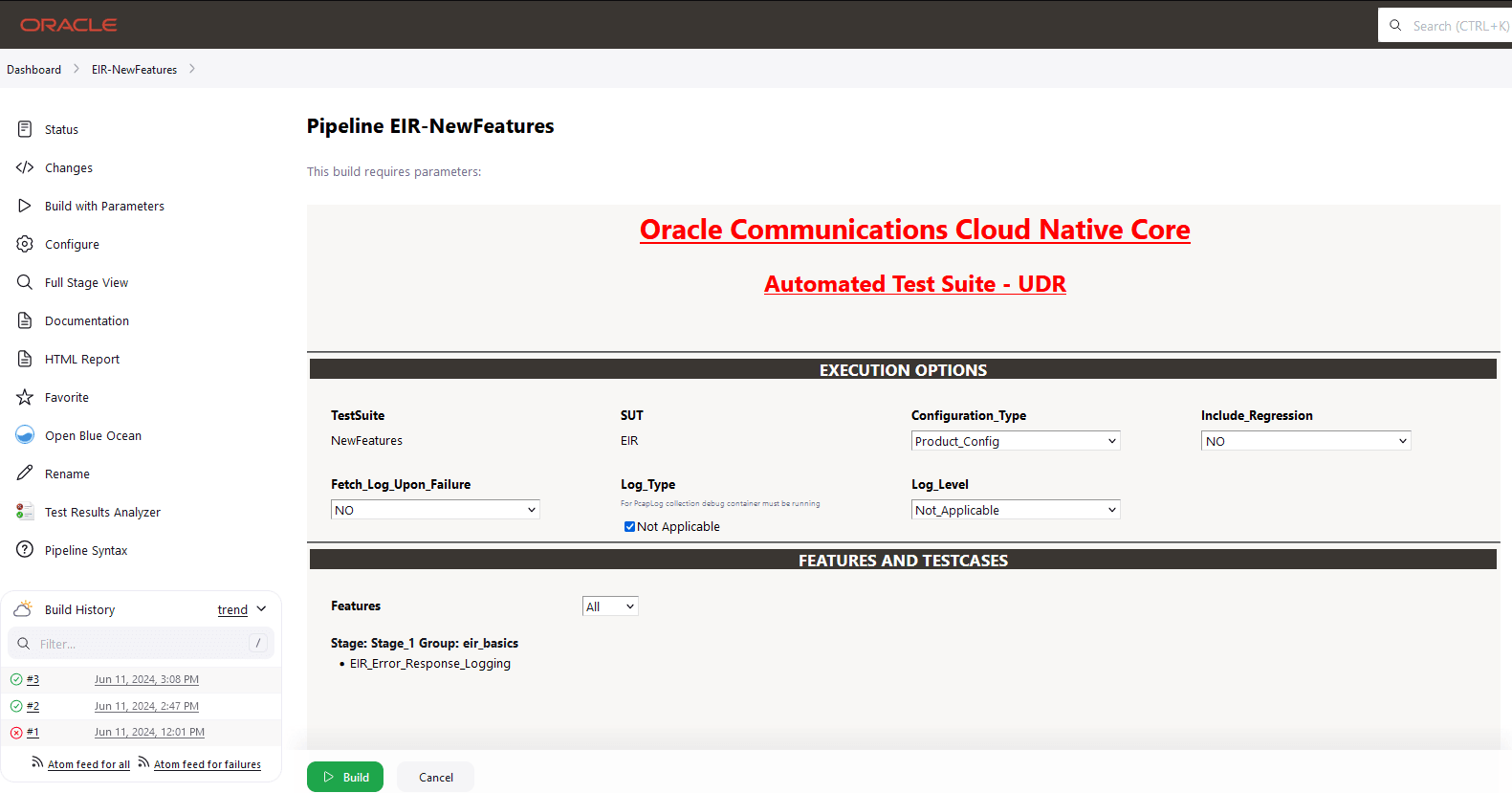

  1. Click the Build with Parameters link available in the left navigation pane of the BSF_NewFeatures Pipeline screen. The following page appears.
    Figure 4-6 BSF New Features Build with Parameters
    BSF New Features Builde with Parameters

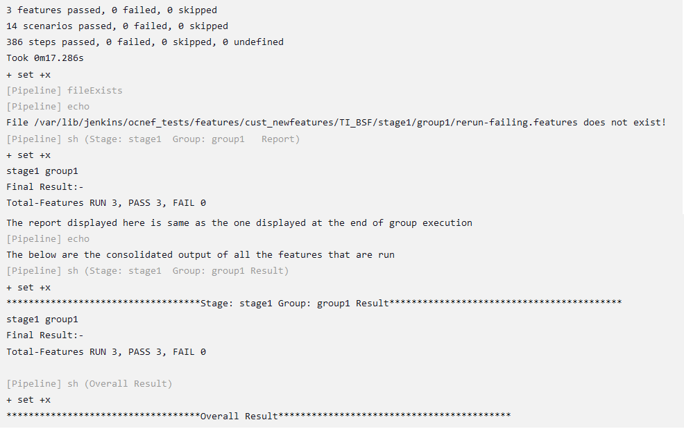

    Make sure that the value of FilterWithTags and Include_NewFeatures is selected as NO.

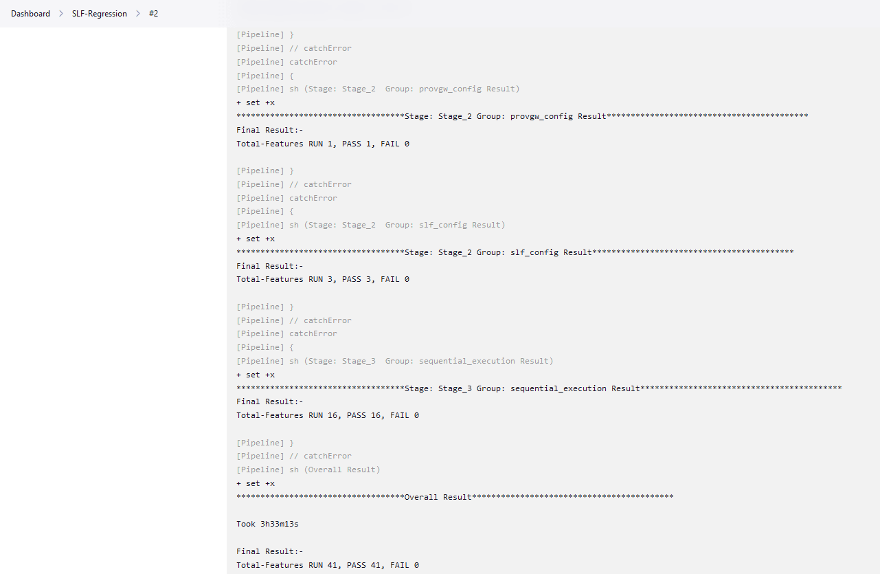

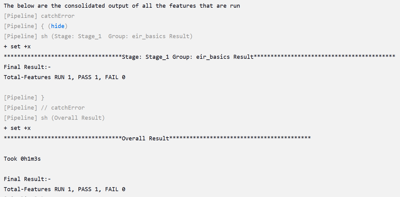

  2. If you want to collect logs for any given build, select YES from the drop-down menu of Fetch_Log_Upon_Failure.

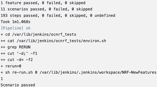

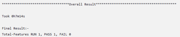

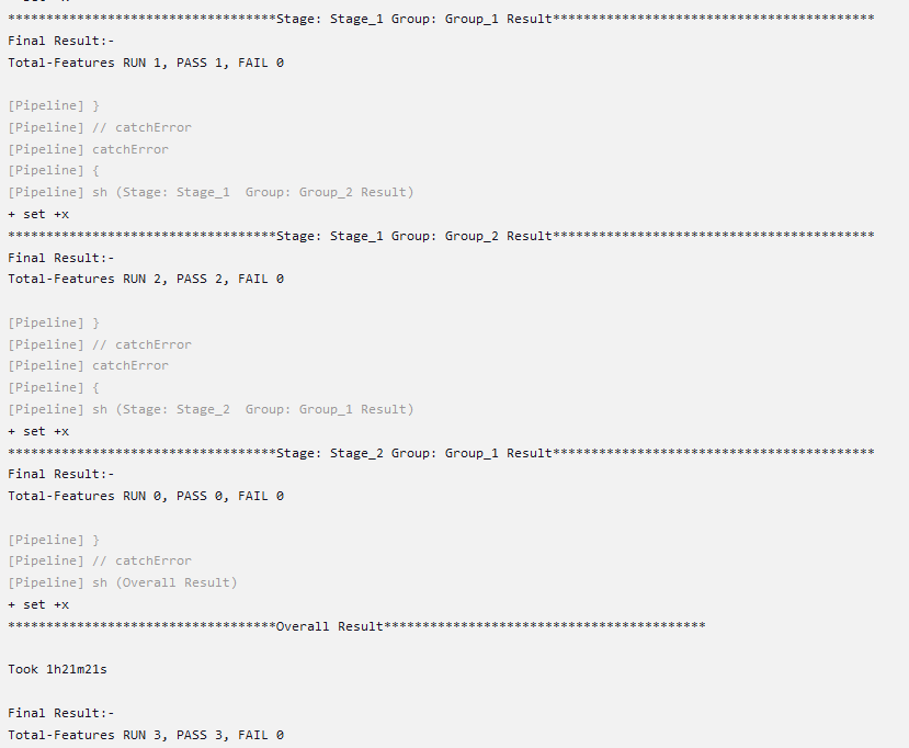

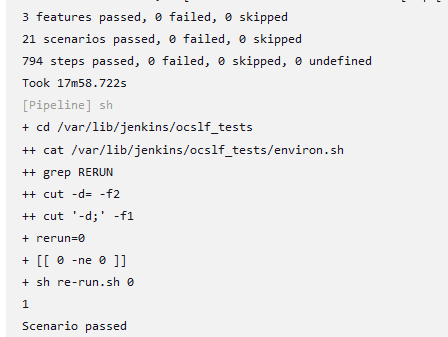

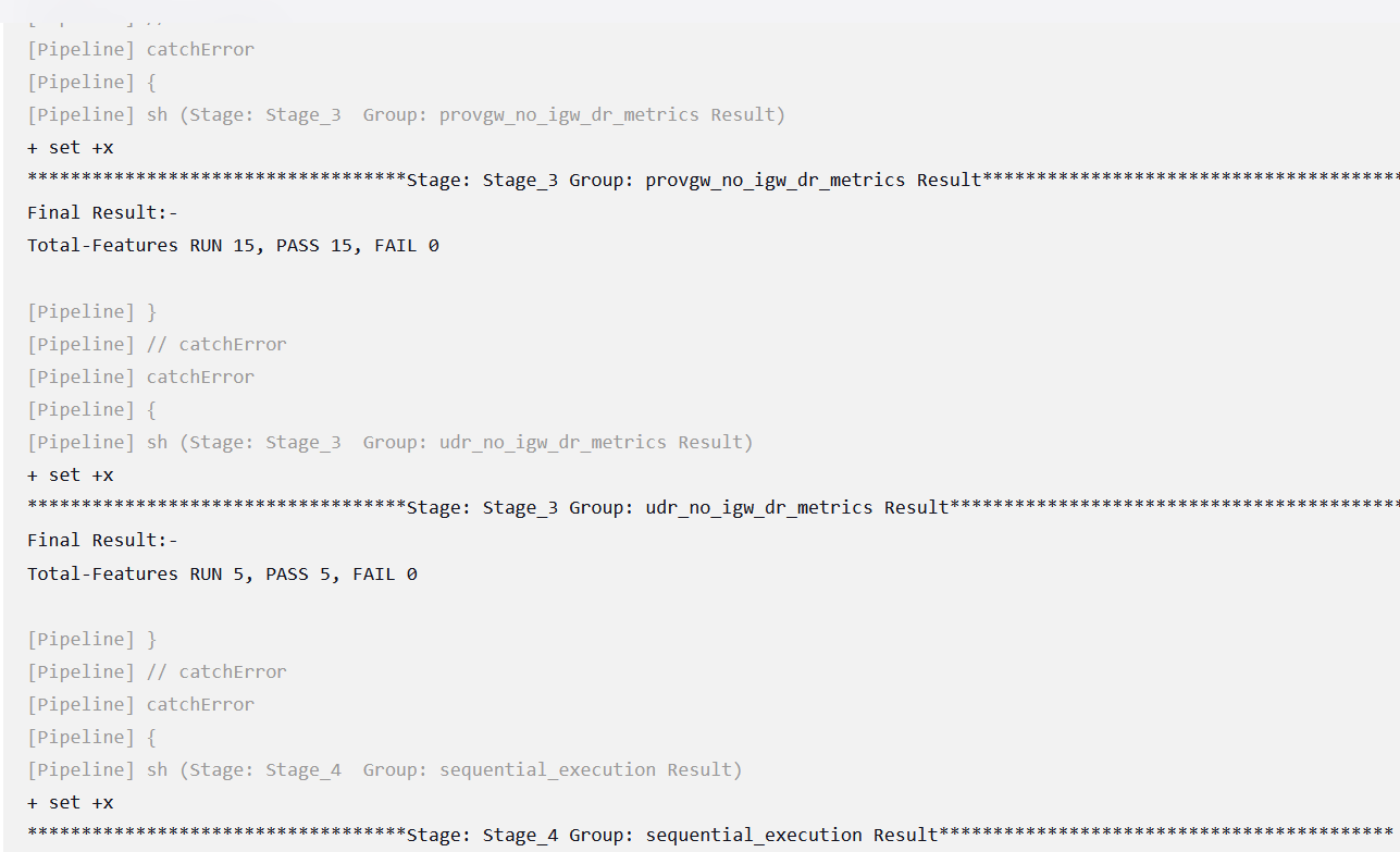

  3. Click Build and select Console Output to view the test results. The following is a sample test result ouput:
    Figure 4-7 Sample: Test Result Output in Console
For more details on consolidated test report, see Managing Final Summary Report, Build Color, and Application Log.

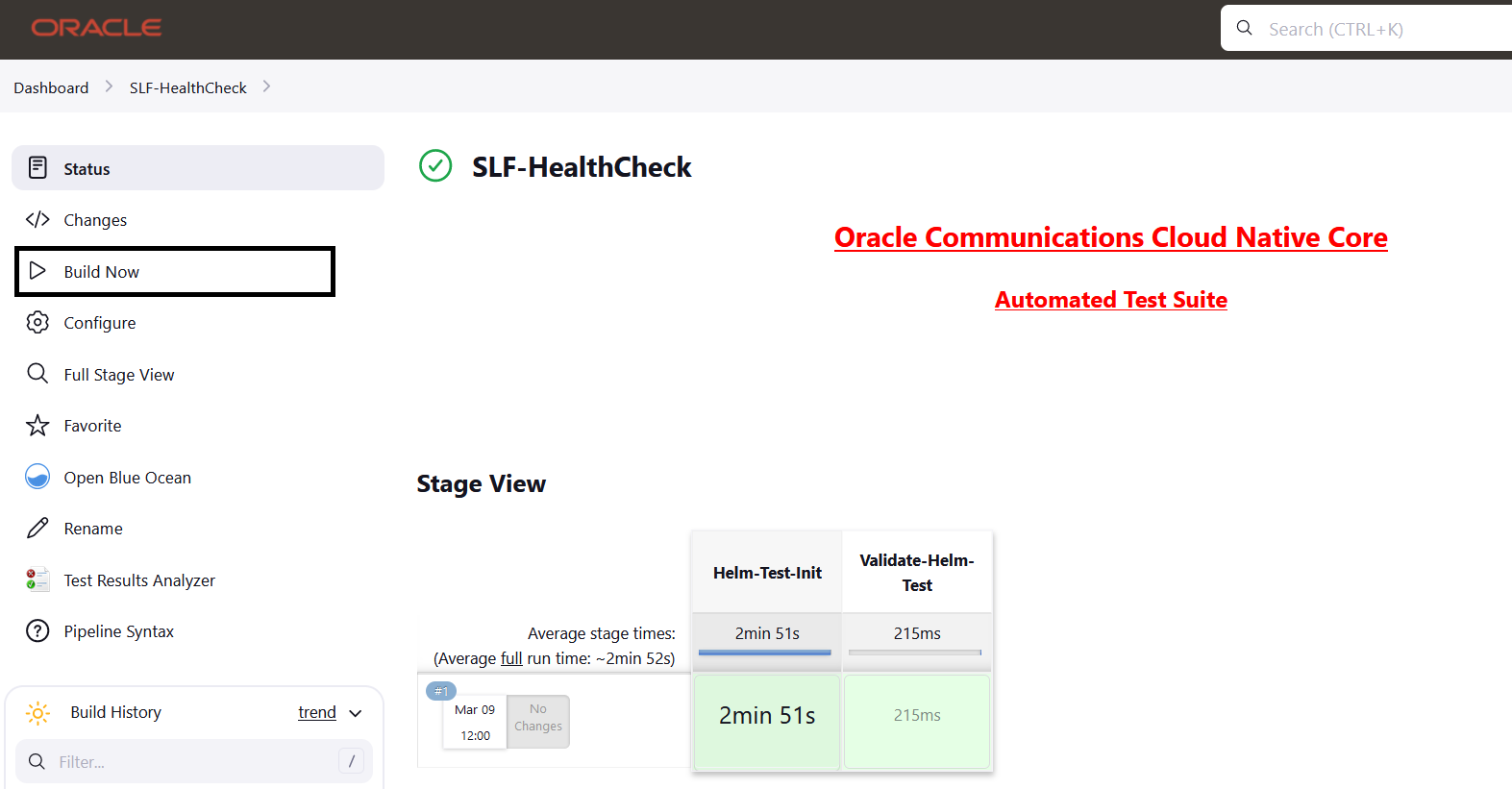

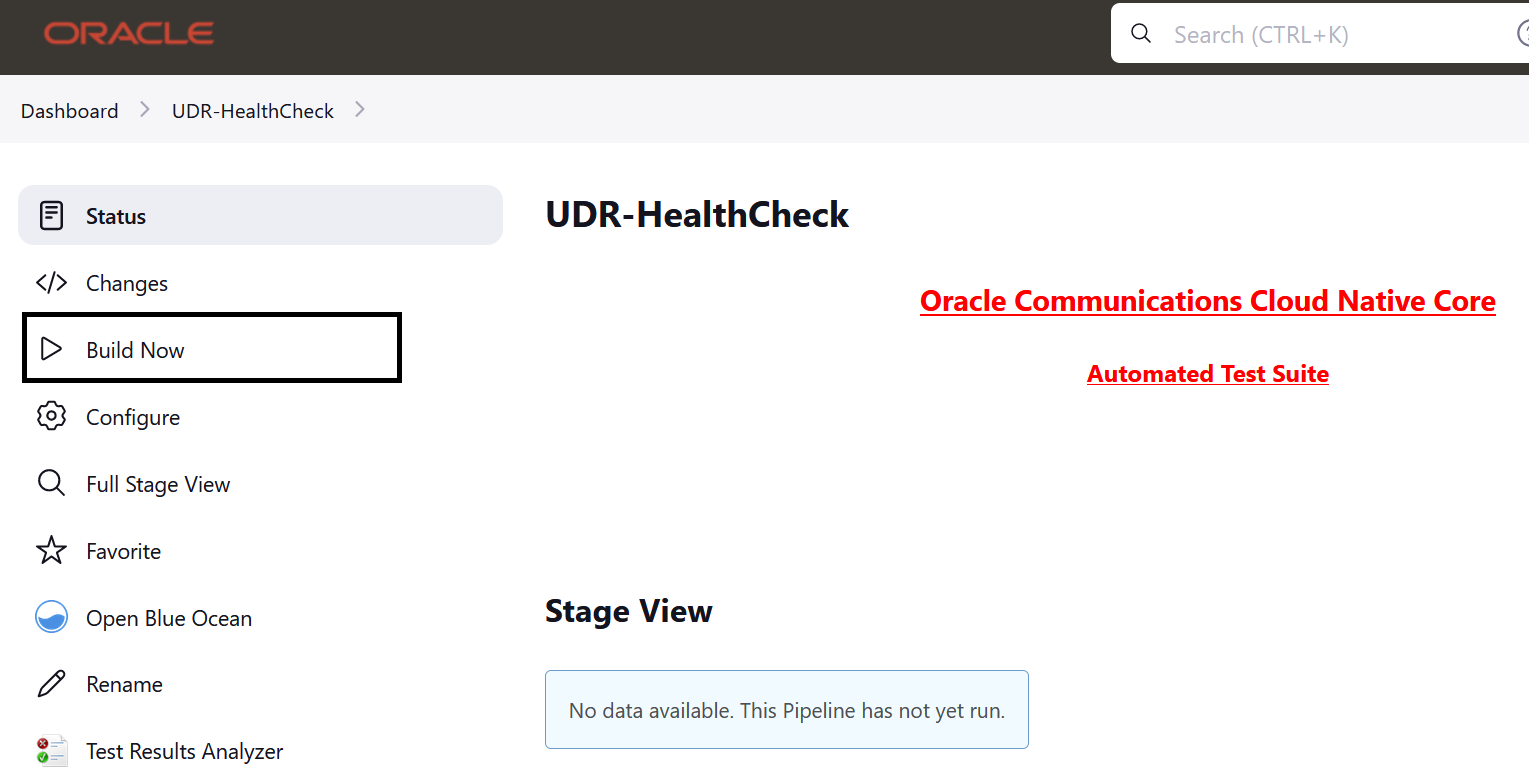

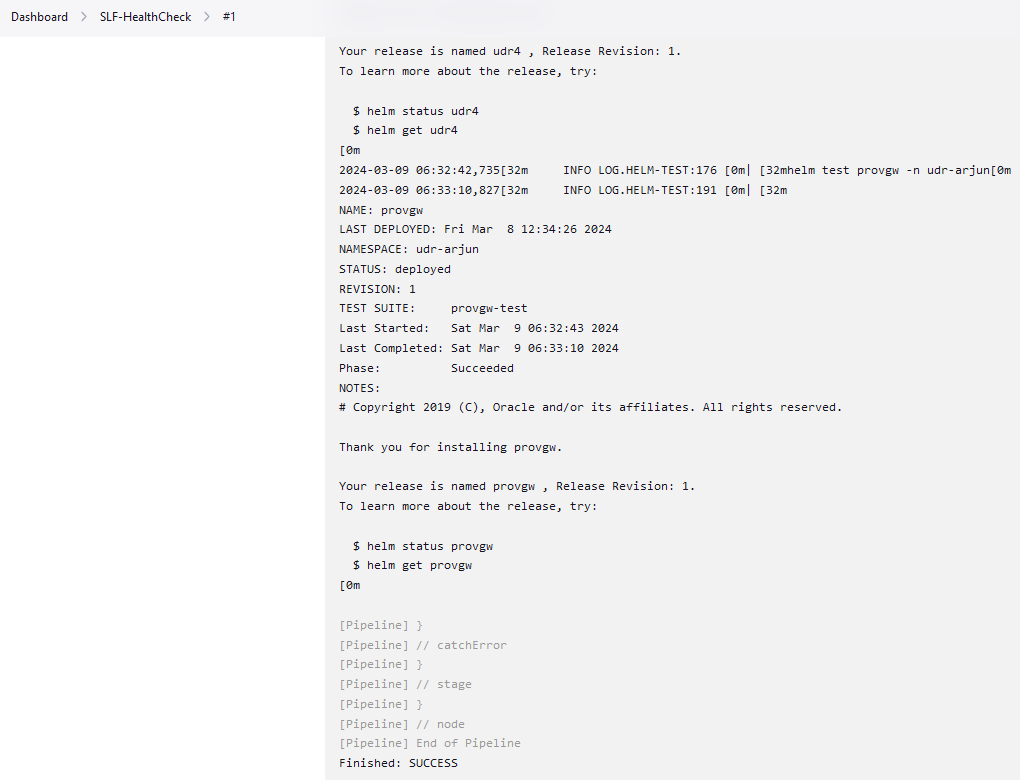

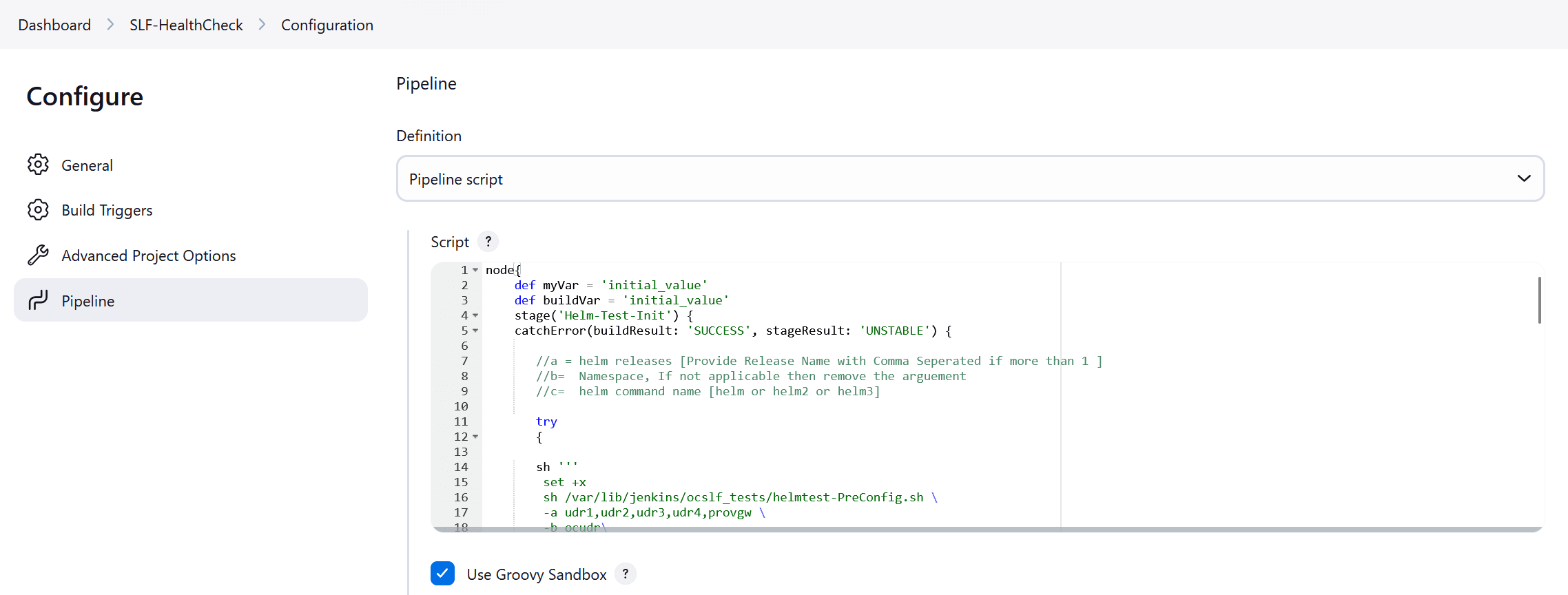

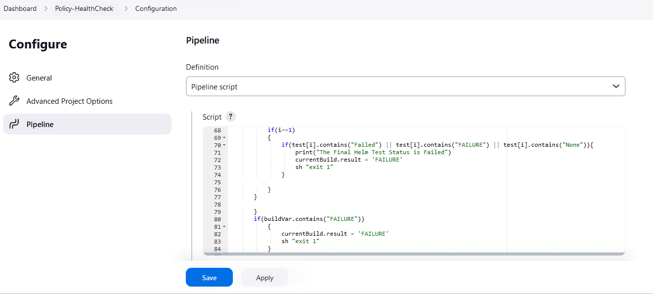

4.1.4 Running BSF_HealthCheck Pipeline
This is a pre-configured pipeline where ATS performs a test probe with SUT. It triggers helm test & provides the results in Jenkins Console Logs.
You can run BSF_HealthCheck pipeline to check if all BSF pods are up and running. If yes, it provides the status as successful. If any pod is down due to any reason, then the pipeline fails.

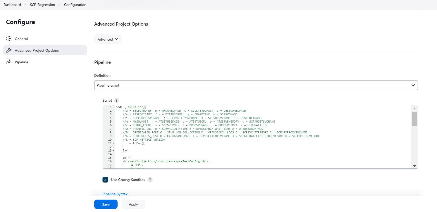

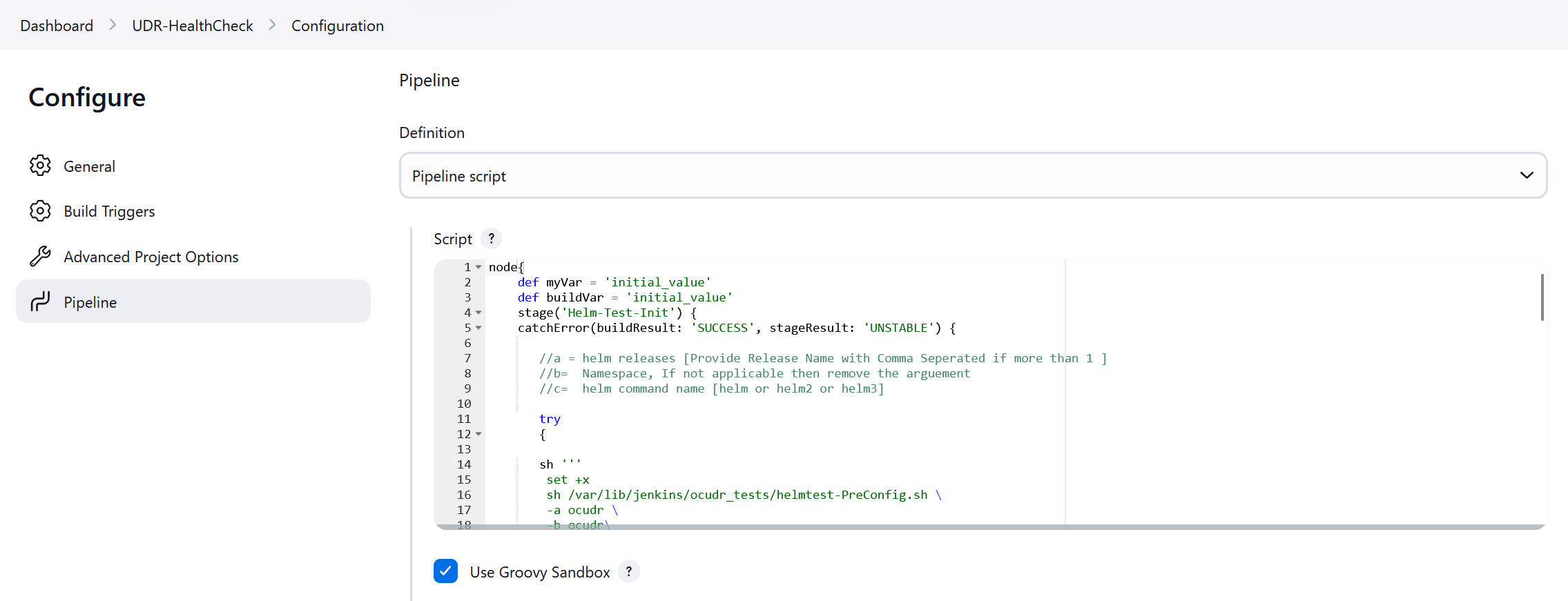

To configure the parameters for BSF_HealthCheck pipeline, perform the following steps:
  1. Click BSF_HealthCheck in the Name column.
  2. Click Configure in the left navigation pane.
  3. When you scroll-down, the General tab becomes active. Be sure that the screen loads completely.
  4. Continue scrolling down until the Pipeline tab becomes active. The following is a screen capture that shows the Pipeline script:
    Figure 4-8 Helm Test Script
    Helm Test Script
  5. In the Script area under the Pipeline section, users may customize the values for the following parameters:
    Attention:
    Do not modify values of parameters other than the ones described in this section.
    • a: Change this parameter to update the helm release name where BSF is deployed in your bastion.
    • b: Change this parameter to update the namespace where BSF is deployed in your bastion.
  6. Click Save to update the values.
Running Helm Test
To run BSF test cases, click Build Now.

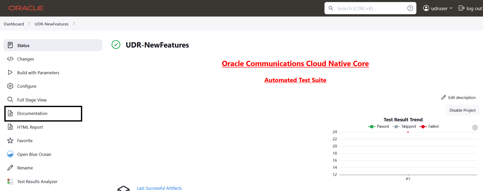

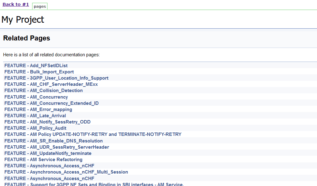

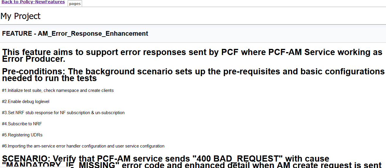

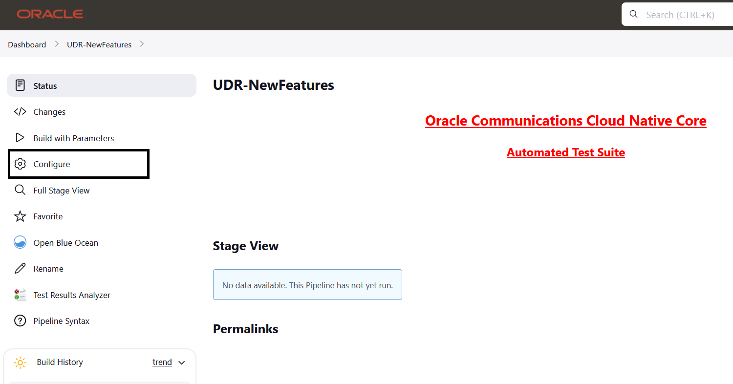

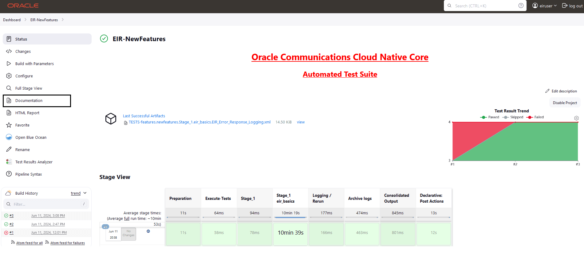

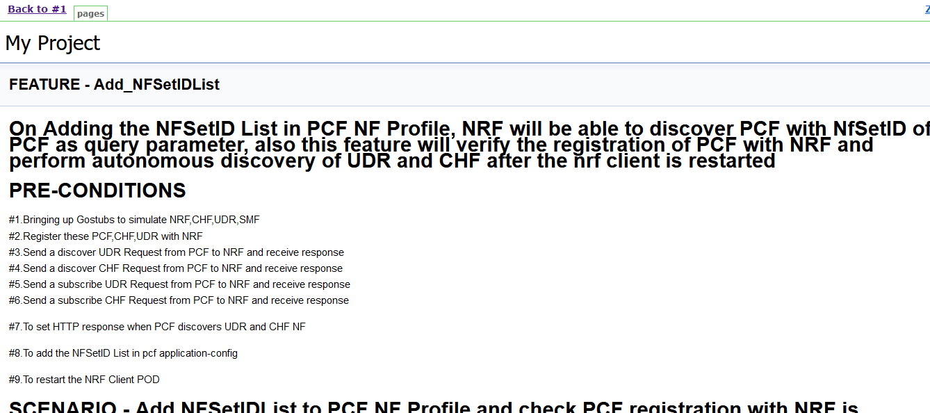

4.1.5 BSF_NewFeatures Documentation

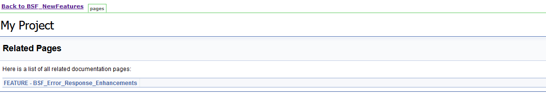

To view BSF functionalities, go to BSF_NewFeatures pipeline. and click Documentation link in the left navigation pane.
Figure 4-9 BSF_NewFeatures Feature List Documentation
Click any functionality to view its test cases and scenarios of each test case. For example, when you click FEATURE - BSF_Error_Response_Enhancements, the following test description appears:
Figure 4-10 Test Cases and Scenarios of Feature - BSF_Error_Response_Enhancements
Based on the functionalities covered under Documentation, the Build Requires Parameters screen displays test cases. To navigate back to the pipeline BSF-NewFeatures screen, click Back to BSF_NewFeatures link available on top left corner of the screen.

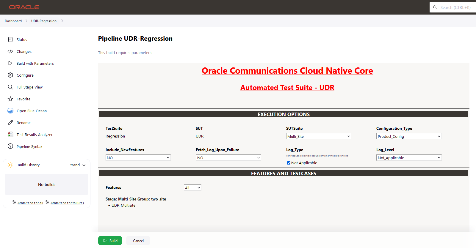

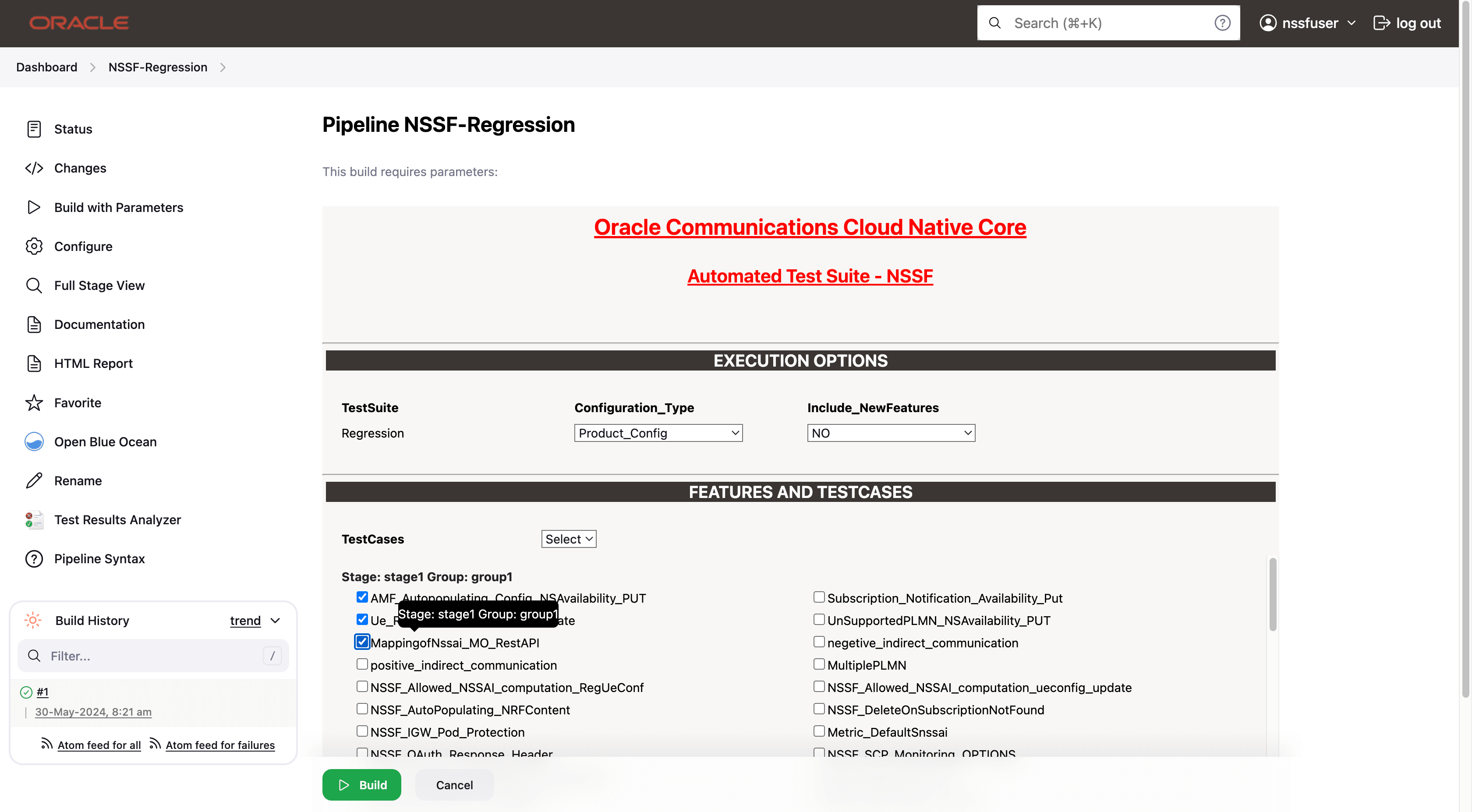

4.1.6 Running BSF Regression Pipeline
This section describes how to run test cases for Binding Support Function (BSF) Regression pipeline.
The BSF_Regression pipeline is a pre-configured pipeline where all the test cases of previous releases are available. For example, for BSF 24.2.3, this pipeline has all the test cases released till BSF 24.1.0.
To view BSF_Regression pipeline details, perform the following steps:
  1. Click BSF_Regression in the Name column.

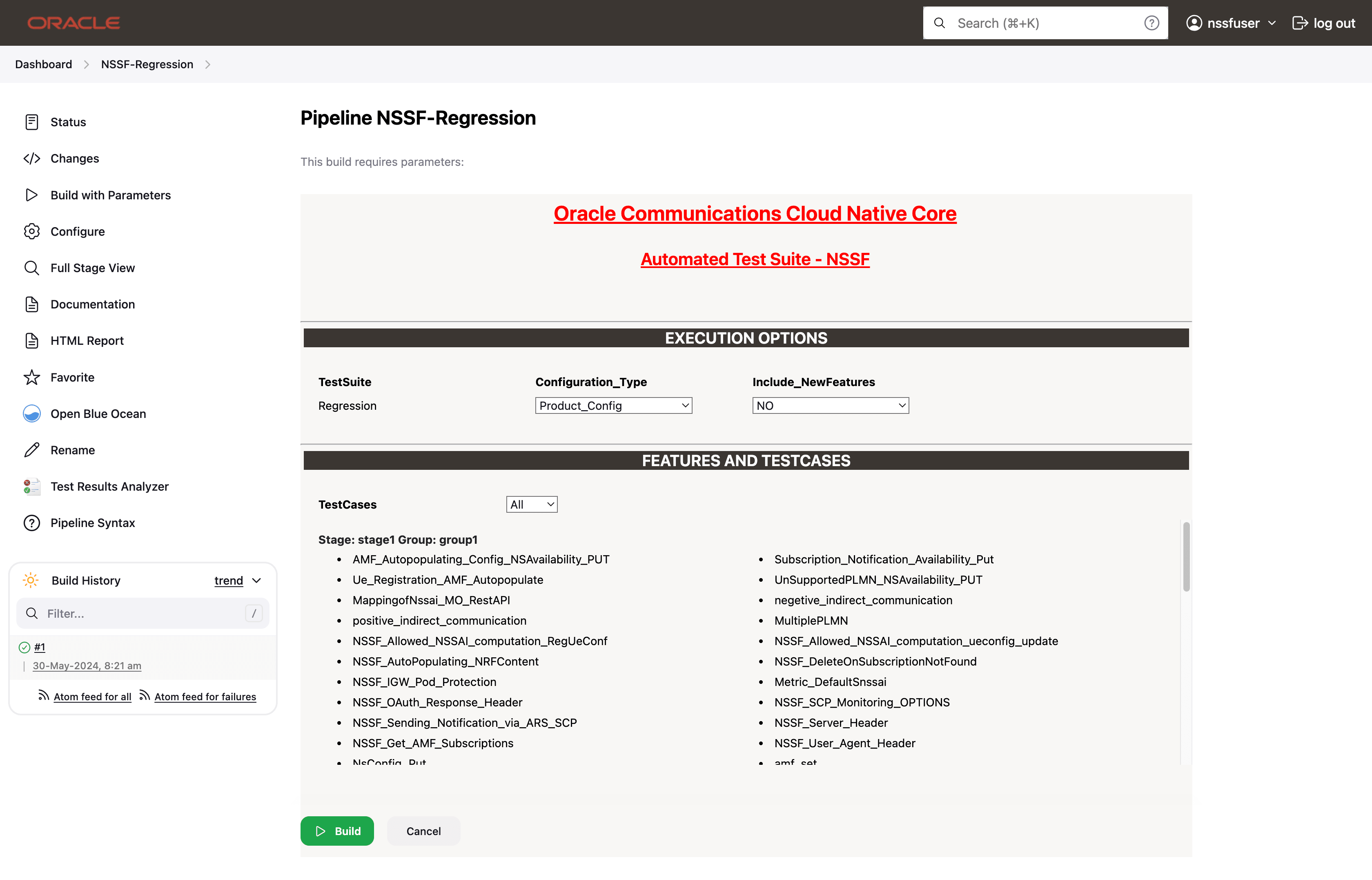

  2. Click Build with Parameters in the left navigation pane.
Copy the required test cases that are available in the BSF folder and place them appropriately within the custom folder for BSF_Regression. Reload the page to view the test cases available in the custom Regression folder.
Click Build.
Figure 4-11 BSF_Regression Pipeline
Regression Pipeline
The Regression pipeline does not have any sanity option. However, users must perform all the steps performed in the BSF_NewFeatures pipeline. Ensure that the pipeline script is configured according to the environment variables.

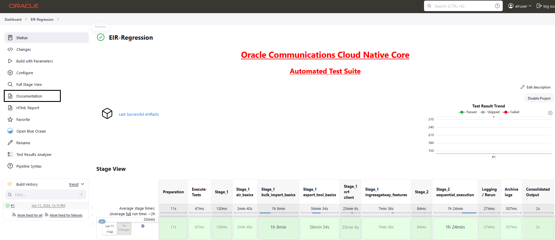

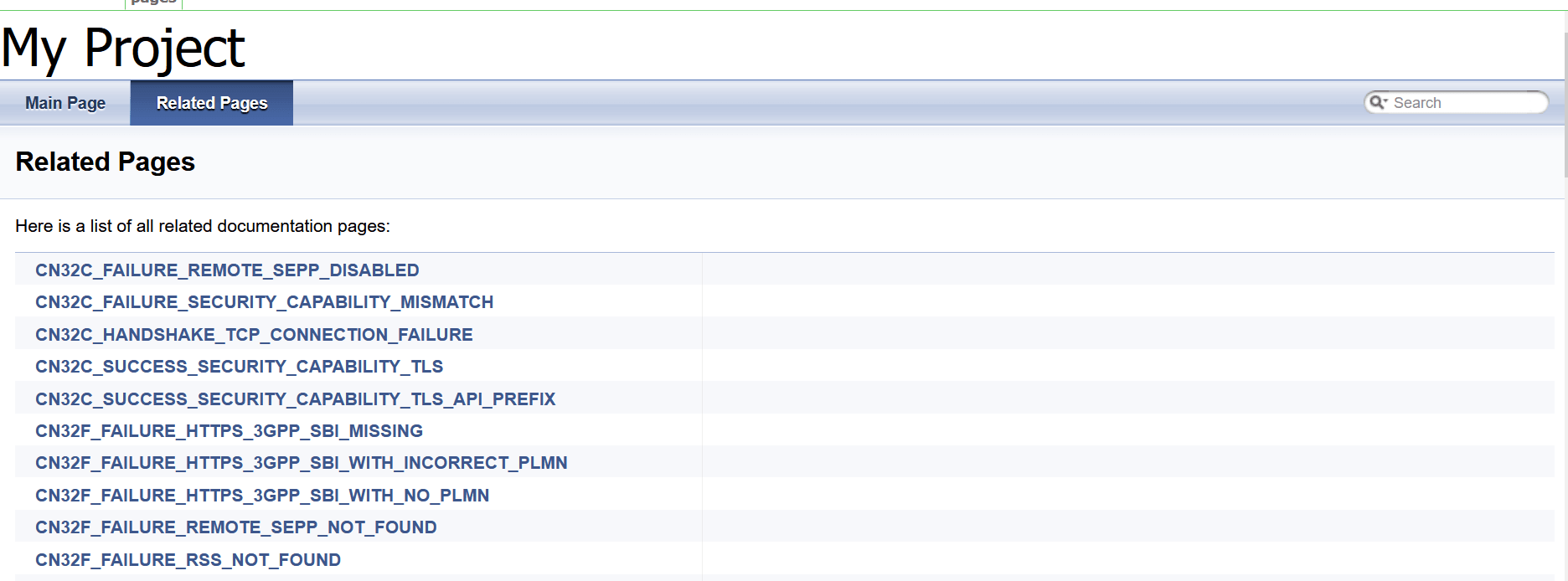

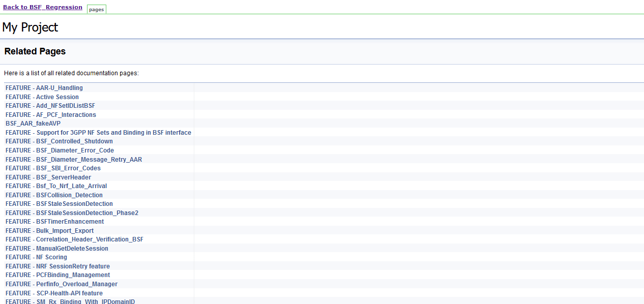

4.1.7 BSF_Regression Documentation
This section describes the documentation for BSF_Regression pipeline.
To view the documentation for any of the BSF features, on the ATS home page, click BSF_Regression. Then, click Documentation in the left navigation pane.
This page shows features of only those test cases that are released in previous releases.
Figure 4-12 BSF_Regression Features Documentation

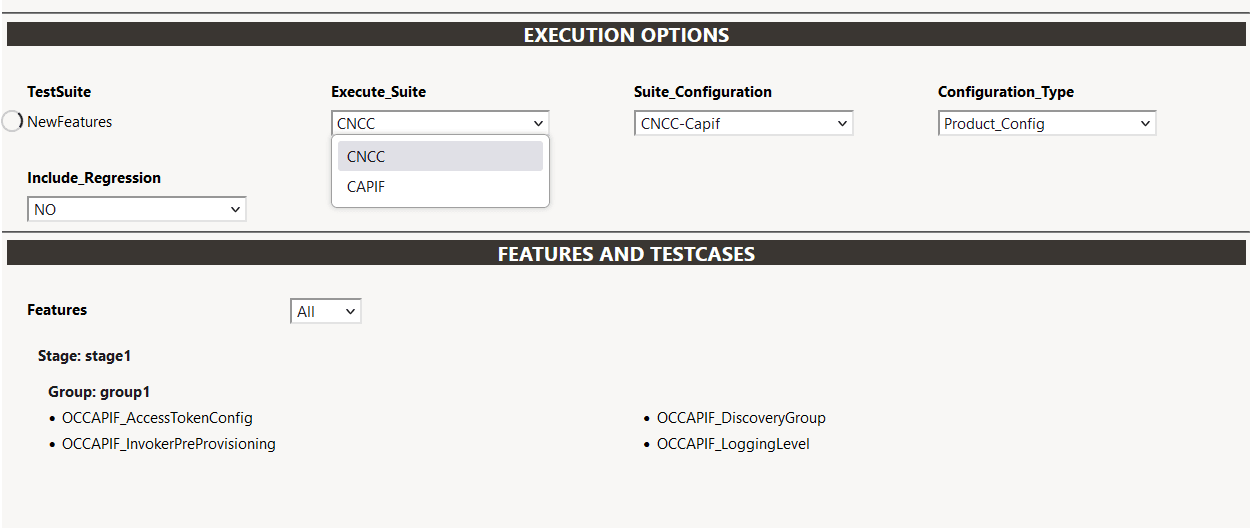

    The following feature is added in NEF-NewFeaturesPipeline for the release 24.2.0:
    • CAPIF Integration with the CNC Console
    • Wrapper APIs to Support CAPIF Functionality in CNC Console
    NEF provides a set of nineteen custom value files that can be used to customize the NEF deployment for ATS. The following table describes the mapping between the combination of the selected communication model and feature configurations for running NEF testcases and the custom value file to be used for NEF deployment for ATS:

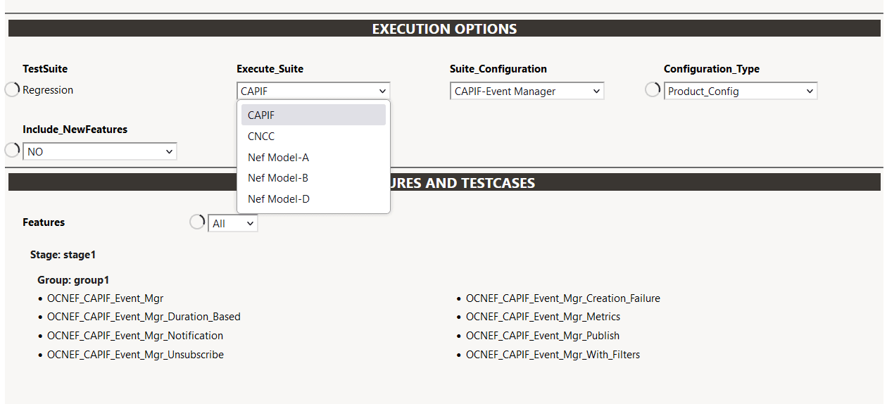

    Supported Communication Model NEF Suite Configuration Custom Values File to be used for NEF Deployment
    CAPIF CAPIF-Event Manager oc-capif-custom-values-ats.yaml
    CAPIF-Functionality oc-capif-custom-values-ats.yaml
    CNCC CNCC-NEF oc-nef-custom-values-ats-cncc.yaml

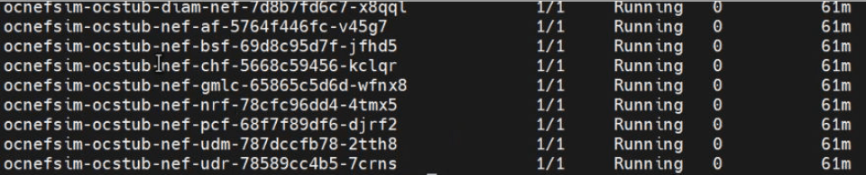

    In oc-nef-custom-values-ats-udm-udr-modelA.yaml file update the parameter as below:
    convergedScefNef: &diamGatewayEnable true
    convergedME: &convergedME true
    Simulator update:
    In ocstub-nef-custom-values.yaml file, update the parameter as below:
    ocstub-diam-nef:
    enabled: true
    ME - PDU Session oc-nef-custom-values-ats-udm-udr-modelA.yaml

To log in to ATS, open a browser and provide the IP Address and port details as <Worker-Node-IP>:<Node-Port-of-ATS>.
Figure 4-15 ATS Login
ATS Login
To run ATS:
  1. Enter the login credentials. Click Sign in. The following screen appears.

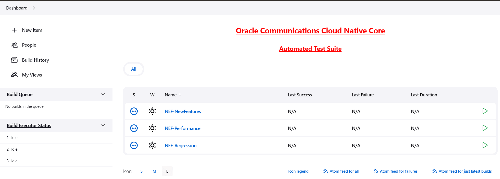

    NEF ATS has three pre-configured pipelines.
    • NEF-NewFeatures: This pipeline has all the test cases delivered as part of NEF ATS - 24.2.0.
    • NEF-Performance: This pipeline is not operational as of now. It is reserved for future releases of ATS.
    • NEF-Regression: This pipeline has all the test cases delivered so far in the previous releases, along with Monitoring Event support for update operation added under UDM functionality.

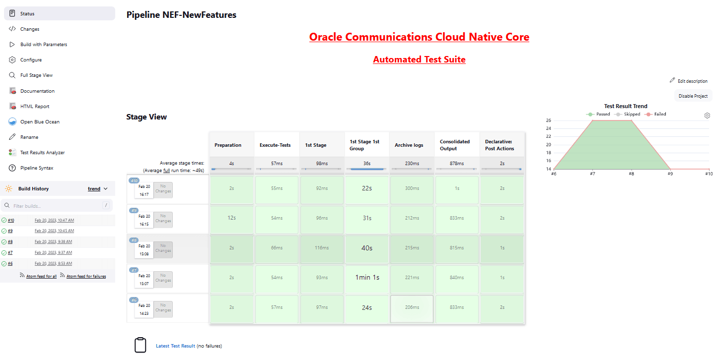

4.2.3 NEF-NewFeatures Pipeline
This is a pre-configured pipeline where users can run all the NEF new test cases. To configure its parameters, which is a one time activity, perform the following steps:
  1. Click NEF-NewFeatures in the Name column. The following screen appears:
    Figure 4-17 Configuring NEF-New Features
    In the above screen:
    • Click Configure to configure NEF-New Features.
    • Click Documentation to view the documented test cases, which are part of this NEF release.
    • Click the blue dots inside Build History box to view the success console logs of the "Sanity", "All-NewFeatures" respectively.
    • The Stage View represents the already deployed pipeline for the customer reference.
  2. Click Configure. User must wait for the page to load completely. Once the page loads completely, click the Pipeline tab:
    Make sure that the following page loads completely before you perform any action on it. Also, do not modify any configuration other than shown below.
    Figure 4-18 Pipeline Tab
    Pipeline Tab

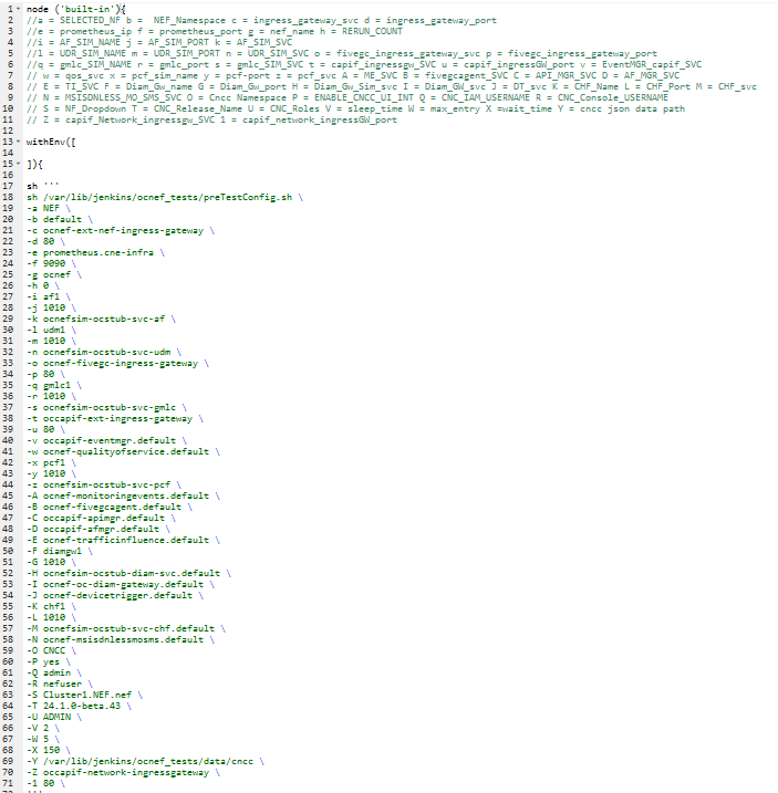

    The Pipeline section of the configuration page appears as follows:
    The content of the pipeline script is as follows:
    Figure 4-19 Pipeline Script
    Pipeline Script
    As required by the setup details, the user can change any value except line number 18.
    You can change the parameter values from "a" - to - "z", "A" - to - "Z", and "1" as per user requirement. The parameter details are available as comments from line number 2 - to - 11.
    • a: Name of the NF to be tested in capital (NEF).
    • b: Namespace in which the NEF is deployed.
    • c: endPointIP (NEF ingress gateway service )value used while deploying NEF with the help of helm chart.
    • d: endPointPort (NEF ingress gateway port) value used while deploying NEF with the help of helm chart.
    • e: Name_of_Prometheus_service.namespace (ocnef-prometheus-server.ocnef-infra).
    • f: Port of Prometheus service (80).
    • g: Helm_release_name used to deploy NEF (ocnef).
    • h: Number of times the re-run of failed case is allowed (default as 2).
    • i: AF Simulator Name used to install simulator (Af1)
    • j: AF Simulator Port(1010).
    • k: AF Simulator service used to install.
    • l: UDM Simulator Name used to install simulator (udm1)
    • m: UDM Simulator Port(1010).
    • n: UDM Simulator service used to install.
    • o: fivegc endPointIP (NEF fivegc ingress gateway service )value used while deploying NEF with the help of helm chart.
    • p: five gc endPointPort (NEF fivegc ingress gateway port) value used while deploying NEF with the help of helm chart.
    • q: GMLC Simulator Name used to install simulator (udm1)
    • r: GMLC Simulator Port(1010).
    • s: GMLC Simulator service used to install.
    • t: OCCAPIF External Gateway
    • u: endPointPort (OCCAPIF ingress gateway port) value used while deploying occapif with the help of helm chart.
    • v: OCCAPIF Event manager service
    • w: QoS service
    • x: PCF simulator
    • y:PCF simulator port
    • z: PCF Simulator service used to install.
    • A: OCNEF ME Service
    • B: OCNEF FiveGCAgent Service
    • C: OCCAPIF API Manager service
    • D: OCCAPIF AF Manager service
    • E: OCNEF Traffic Influence service
    • F: Diameter Gateway name
    • G: Diameter Gateway port number
    • H: Diameter Gateway Simulator service
    • I: Diameter Gateway service
    • J: Device Trigger service
    • K: Charging Function Name
    • L: Charging Function SIM Port
    • M: Charging Function SIM service
    • N: MSISDNLess MO SMS service
    • O: CNC Console Namespace
    • P: Enable CNC Console UI
    • Q: CNC User name
    • R: CNC Console User
    • S: NF Dropdown
    • T: CNC Release version
    • U: CNC Roles
    • V: Sleep Time
    • W: Maximum Entry
    • X: Wait Time
    • Y: CNCC JSON Data Path
    • Z: CAPIF Network Ingress Gateway service
    • 1: CAPIF Network Ingress Gateway Port
    • If user is using OCCNE1.6/OSO-1.6.1 or earlier, change the Prometheus service URI (-n) to "/api/" and Prometheus service name and port to appropriate values. For OCCNE 1.7.0/OSO 1.6.2 or later, retain the default value "/prometheus/api/"
    • When CNC functionalities are required to be used, enable CNC Console by setting the CNC Console UI to "Yes".
  3. Click Save after making necessary changes. The NEF-NewFeatures screen appears. Click the Build with Parameters link available in the left navigation pane of the NEF-NewFeatures Pipeline screen. The following screen appears.
    Figure 4-20 Pipeline NEF_NewFeatures
  4. Select an option from the Execute_Suite section:
    Based on the option selected in this section, the values under Suite_Configuration sections get populated.
  5. Select the applicable configuration under the Suite_Configuration section based on the selected value for Execute_Suite and the custom configuration file used for NEF deployment for ATS. For more information about the NEF custom_values.yaml files for ATS, see "Download NEF Package" in the Oracle Communications Cloud Native Core, Network Exposure Function Installation, Upgrade, and Fault Recovery Guide.
    Important:
    Ensure that the ATS configurations match with the custom_values.yaml file used for NEF deployment. A mismatch between the NEF for ATS deployment configurations and the selected Suite configurations results in build failure.
    The following table describes the mapping between the options selected for Execute_Suite and Suite_Configuration and the respective feature test cases that can be run:
    Table 4-4 Execution Suite Configuration Mapping
    Execute_Suite Suite_Configuration Supported NEF Custom yaml file Features
    CNCC CNCC-Capif oc-nef-custom-values-ats-cncc.yaml OCCAPIF_AccessTokenConfig
    OCCAPIF_DiscoveryGroup
    OCCAPIF_InvokerPreProvisioning
    OCCAPIF_LoggingLevel
    CAPIF CAPIF-API oc-capif-custom-values-ats.yaml OCNEF_CAPIF_Discovery_Group_Wrapper_Api

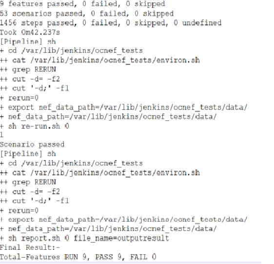

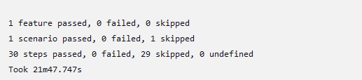

  8. After selecting the test cases, click Build and select Console Output to view the test results. The following is a sample test result output:
    Figure 4-21 Sample Test Cases Result - New Feature

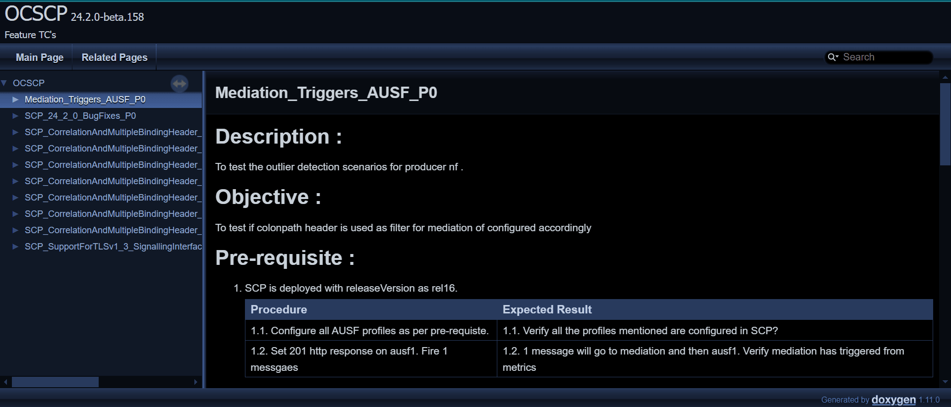

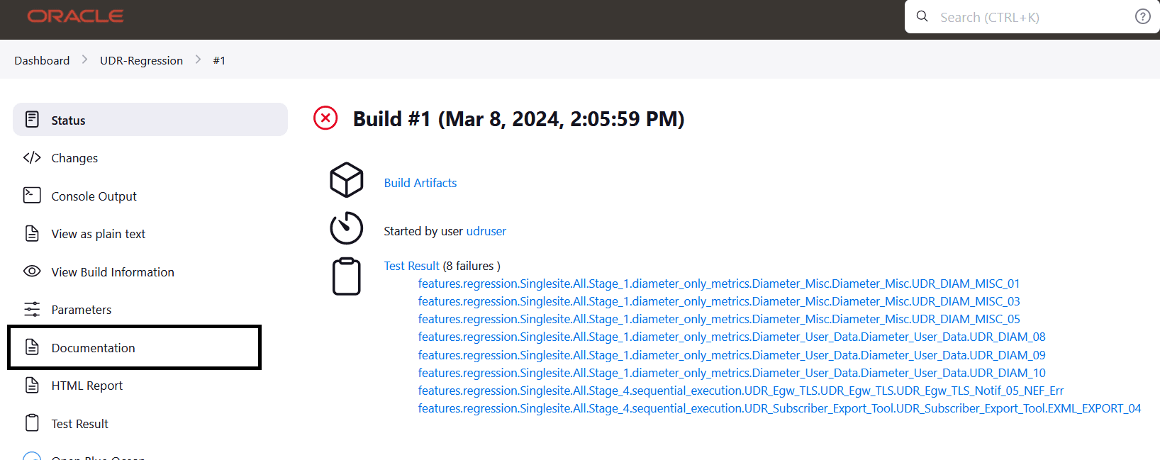

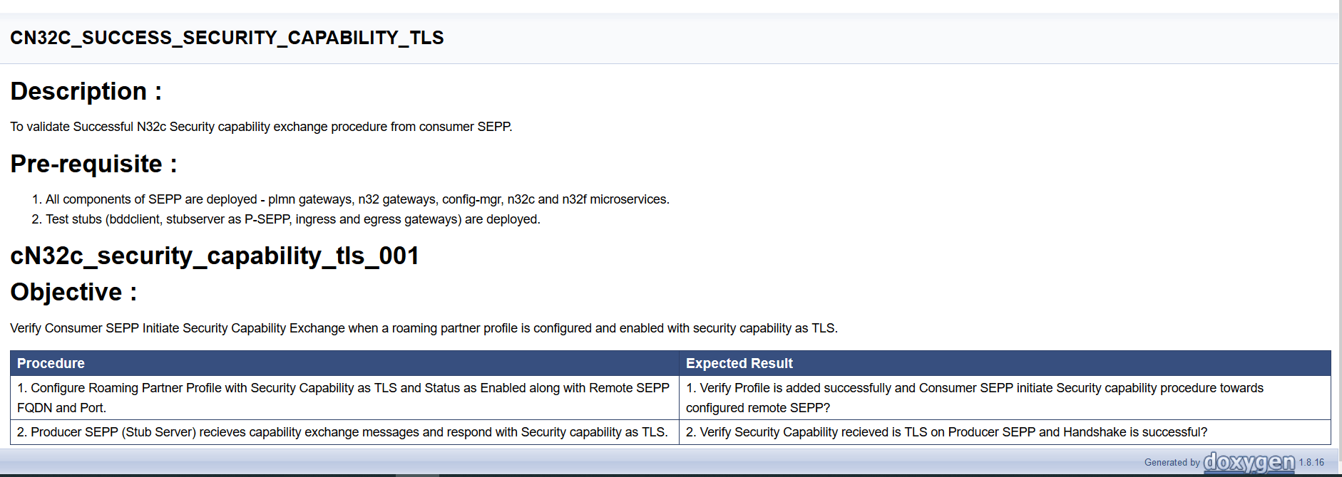

4.2.4 NEF-NewFeatures Documentation
To view NEF test cases, go to NEF-NewFeatures pipeline and click the Documentation link in the left navigation pane. The following feature is added for the release 24.2.0:

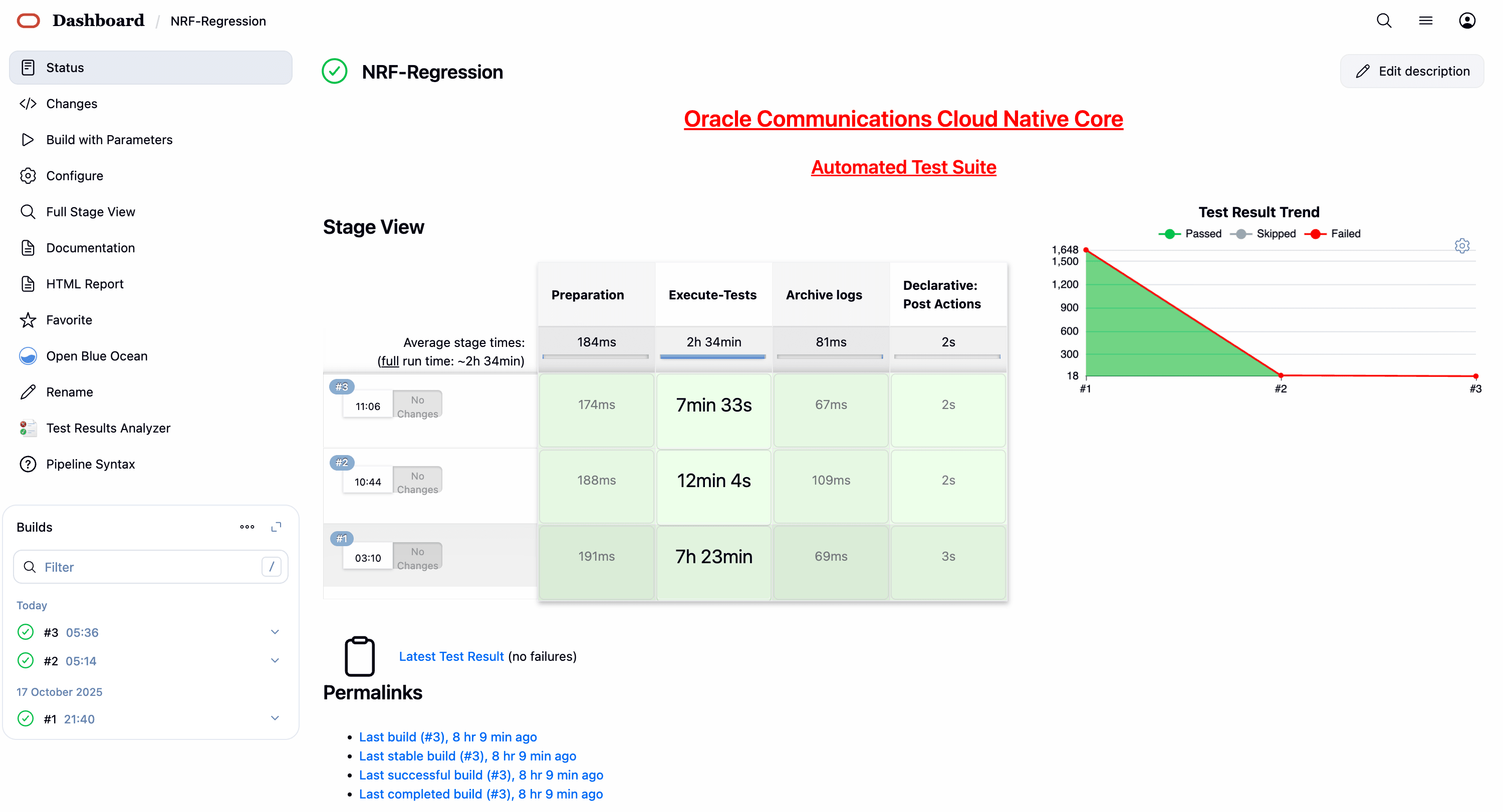

4.2.5 NEF-Regression Pipeline
This section describes how to run test cases for Network Exposure Function (NEF) Regression pipeline.
The NEF-Regression pipeline is a pre-configured pipeline where all the test cases of previous releases are available. For example, for NEF 24.2.0, this pipeline has all the test cases released till NEF 24.2.x.
To view NEF-Regression pipeline details, perform the following steps:
  1. Click NEF-Regression in the Name column.
  2. Click the Build with Parameters link available in the left navigation pane of the NEF-Regression Pipeline screen.
The Regression pipeline does not have any sanity option. However, you must perform all the steps performed in the NEF-Regression pipeline. Ensure that the pipeline script is configured according to the environment variables.
Running Regression Test Cases
To run NEF test cases, perform the following steps:
  1. Click the Build with Parameters link available in the left navigation pane of the NEF-Regression Pipeline screen. The following page appears.
    Figure 4-22 Pipeline NEF_Regression
  2. Select an option from the Execute_Suite section:
  3. Select the applicable configuration under the Suite_Configuration section based on the selected value for Execute_Suite and the custom configuration file used for NEF deployment for ATS. For more information about the NEF custom_values.yaml files for ATS, see "Download NEF Package" in the Oracle Communications Cloud Native Core, Network Exposure Function Installation, Upgrade, and Fault Recovery Guide.
    Important:
    Table 4-5 Execution Suite Configuration Mapping
    Execute_Suite Suite_Configuration Features
    CAPIF CAPIF-Event Manager OCNEF_CAPIF_Event_Mgr

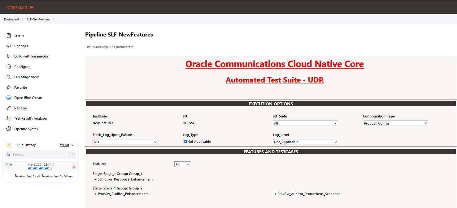

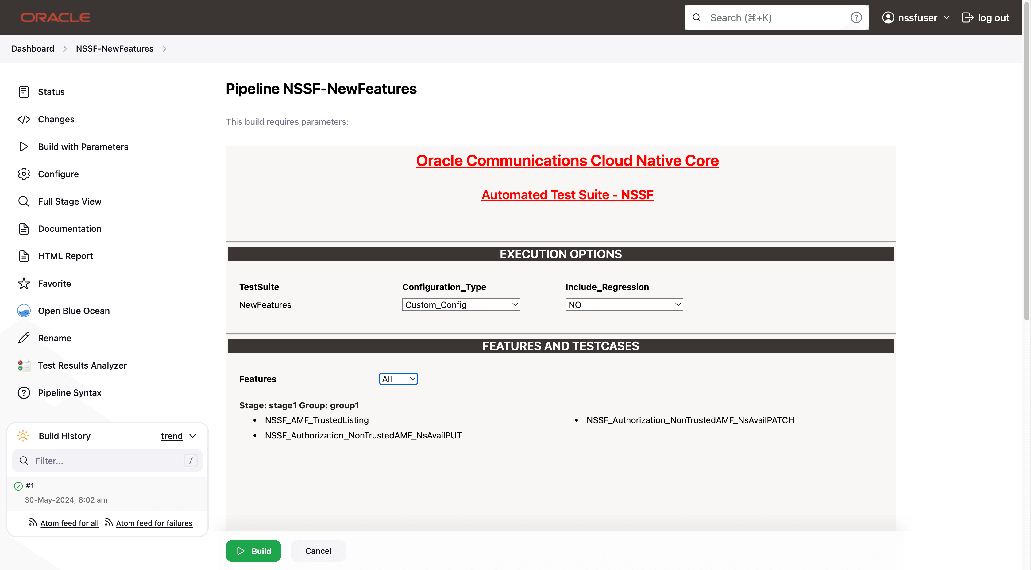

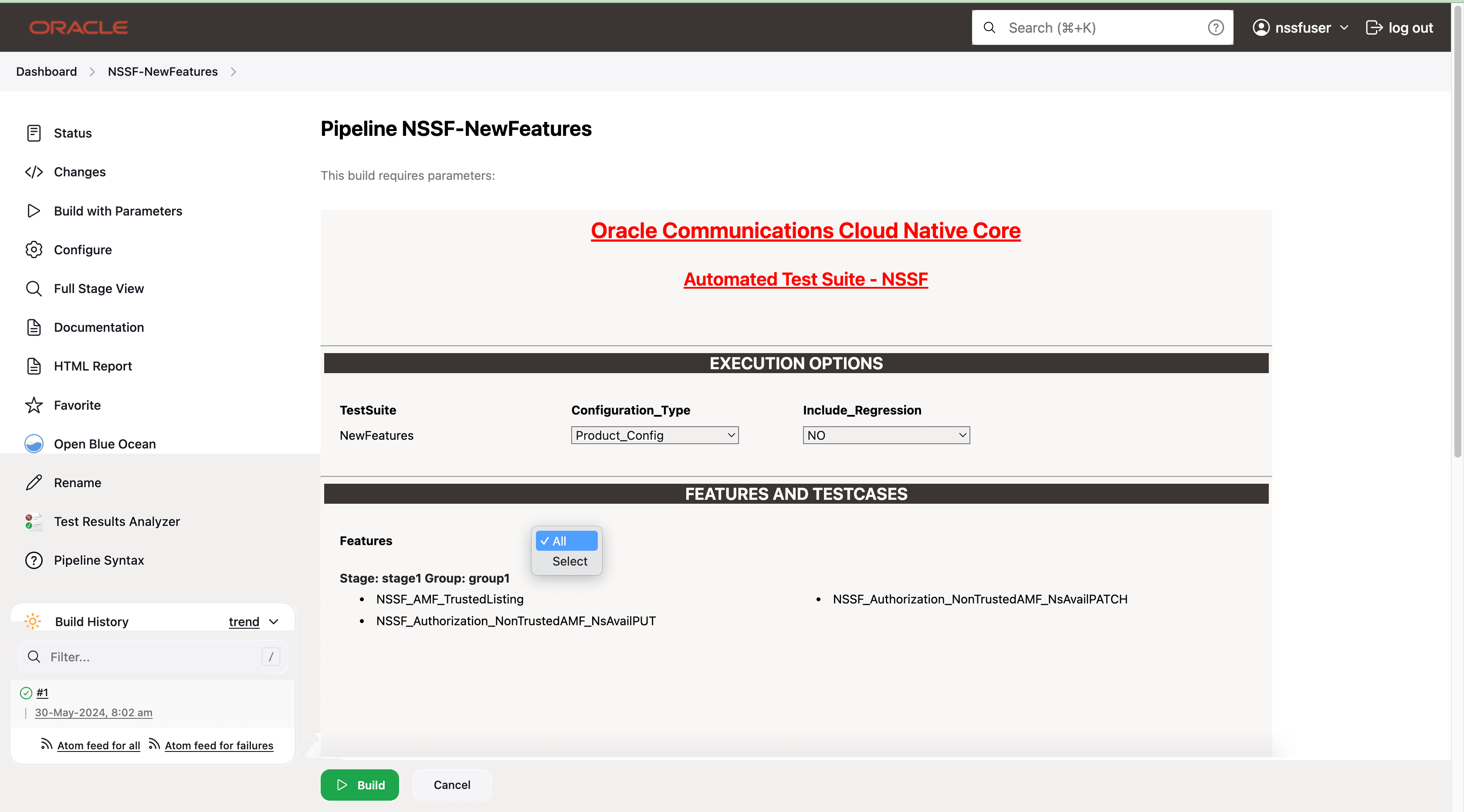

  4. Select any of following valid values from Configuration_Type:
    • Product_Config: On selecting this option, test cases from product folders are populated on ATS UI and product configuration is applied to them via the key-value pair and yaml files defined or present in the "Product Config" folder.
    • Custom_Config: On selecting this option, test cases from custom folders are populated on ATS UI and custom configuration is applied to them via the key-value pair and yaml files defined or present in the "Custom Config" folder.
  5. Select any of the following options under the Select_Option section:
    • All: This is the default option. It runs all the NEF test cases. Scroll down and click Build to execute all the test cases.
    • Single/MultipleFeatures: This option allows you to select any number of test cases that you want to run from the list of total test cases available for execution.
  6. After selecting the test cases, click Build and select Console Output to view the test results. The following is a sample test result output:
    Figure 4-23 Sample Test Cases Result - All-Regression
4.2.6 NEF-Regression Documentation
This section describes the documentation for NEF-Regression pipeline.

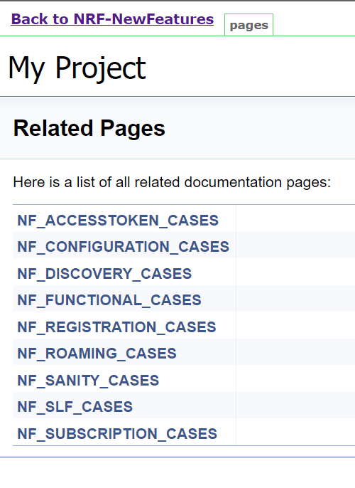

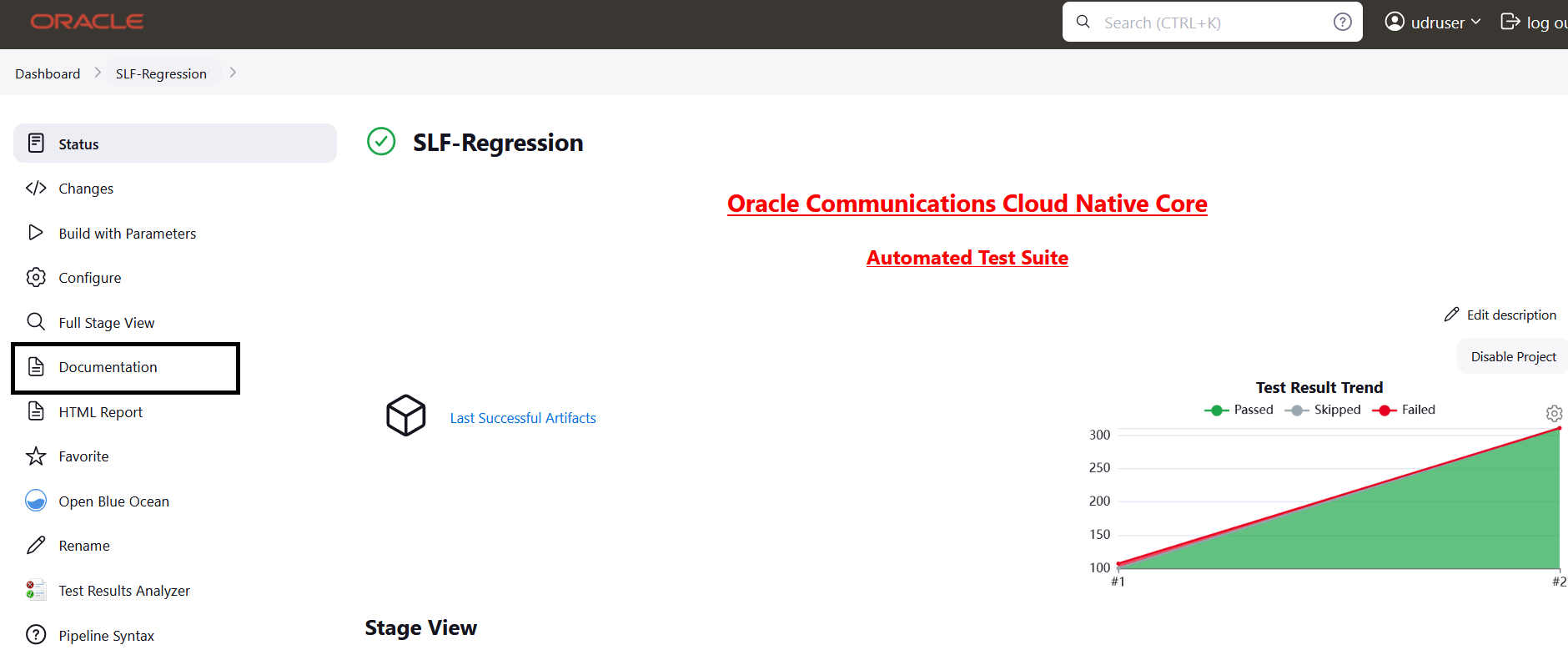

To view the documentation for any of the NEF features, click NEF-Regression on the ATS home page. Then, click Documentation in the left navigation pane.
The NEF-Regression test cases are divided into multiple groups based on the functionality.

  2. The pipeline configuration has to be set to the below before running the pipeline. The values of options "u" to "x" have to be set to 0.1.
    node ('master'){
        //a = SELECTED_NF    b = NF_NAMESPACE        c = FT_ENDPOINT      d = GATEWAY_IP        e = GATEWAY_PORT
        //f = CONFIG_IP      g = CONFIG_PORT         h = STUB_IP          i = STUB_PORT         j = NFINSTANCEID
        //k = PROMETHEUS_IP  l = PROMETHEUS_PORT     m = RERUN_COUNT      n = PROMETHEUS_URI    o = HELM_RELEASE_NAME
        //p = MYSQL_HOST     q = PRIVILEGED_USER_SECRET_NAME              r = DISCOVERY_WAIT_TIME
        //s = REPLICATION_STATUS_URI                 t = CLUSTER_DOMAIN   u = REGISTER_WRITE_WAIT_TIME
