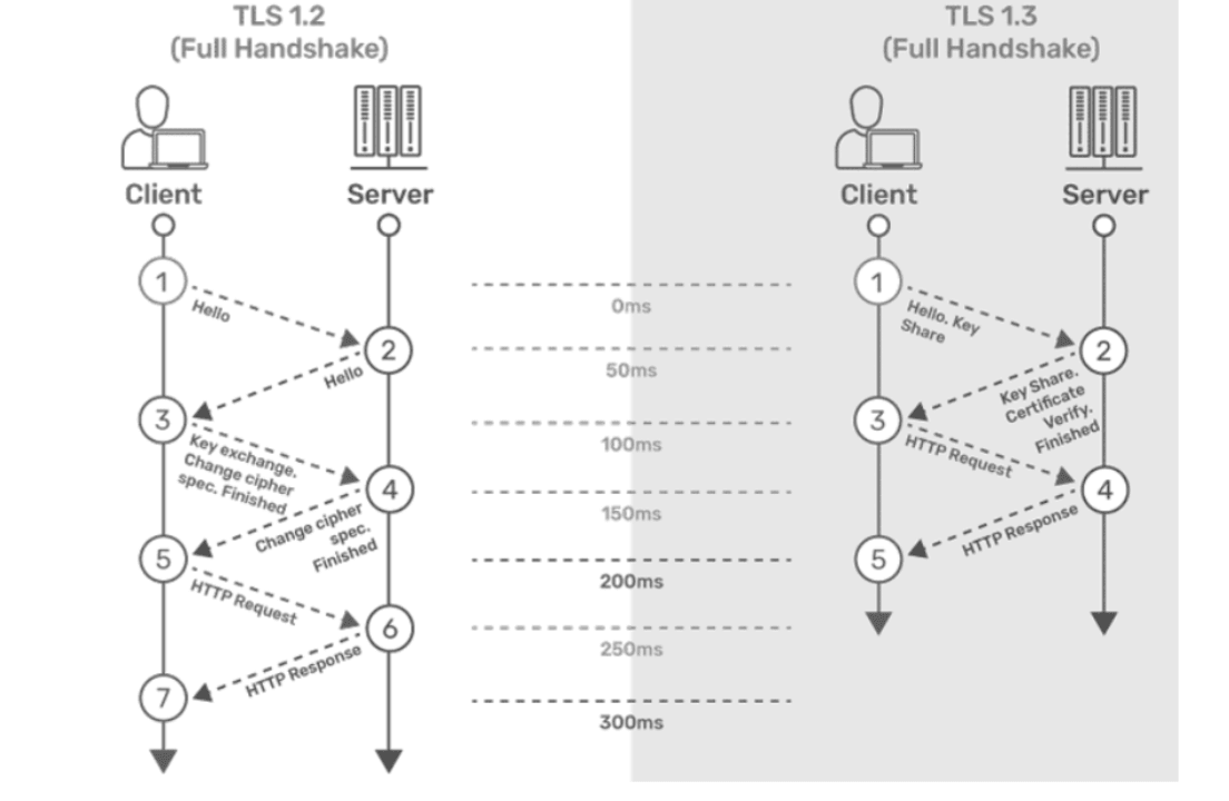

TLS 1.2 and TLS 1.3 Handshake
This section describes the differences between TLS 1.3 and TLS 1.2, as well as the advantages of TLS 1.3 over TLS 1.2 and earlier versions.
Figure 3-1 TLS 1.2 and TLS 1.3 Handshake
TLS 1.2
Step 1: The connection or handshake starts when the client sends a "client hello" message to the server. This message consists of cryptographic information such as supported protocols and cipher suites. It also contains a random value or random byte string.
Step 2: To respond to the "client hello" message, the server sends a 'server hello' message. This message contains the CipherSuite that the server has selected from the options provided by the client. The server also sends its certificate, along with the session ID and another random value.
Step 3: The client verifies the certificate sent by the server. When the verification is complete, it sends a byte string encrypted using the public key of the server's certificate.
Step 4: When the server receives the secret, both the client and server generate a master key along with session keys (ephemeral keys). These session keys are used for symmetrically encrypting the data.
Step 5: The client sends an "HTTP Request" message to the server to enable the server to transition to symmetric encryption using the session keys.
Step 6: To respond to the client’s "HTTP Request" message, the server does the same and switches its security state to symmetric encryption. The server concludes the handshake by sending an HTTP response.
Step 7: The client-server handshake is completed in two round trips.
TLS 1.3
Step 1: The connection or handshake begins when the client sends a "client hello" message to the server, which includes the list of supported cipher suites and the client's key share for the specific key agreement protocol.
Step 2: To respond to the "client hello" message, the server sends the key agreement protocol that it has chosen. The "Server Hello" message includes the server key share, server certificate, and the "Server Finished" message.
Step 3: The client verifies the server certificate, generates keys since it has the server's key share, and then sends the "Client Finished" message along with an HTTP request.
Step 4: The server completes the handshake by sending an HTTP response.

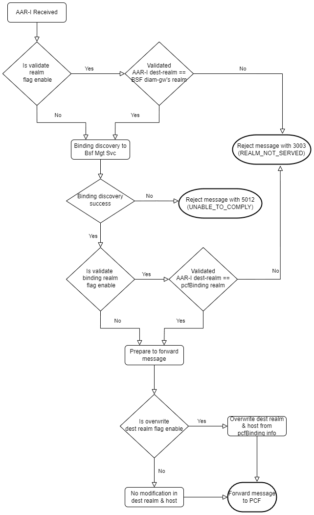

3.3 Validating Destination-Realm Attribute-Value Pair (AVP) Received in AAR-I Message
The destination-realm Attribute-Value Pair (AVP) received in the AAR-I message from an AF must be validated at the BSF Diameter Gateway before processing and forwarding the AAR-I message to a corresponding PCF instance.
This validation applies exclusively to the AAR-I message within the BSF. For subsequent AAR-U and STR messages, it is assumed that the AF will send the correct Destination-Host and the destination-realm Attribute-Value Pair (AVP) values based on the AAA response received.
Figure 3-2 Diameter Gateway for BSF
Diameter Gateway for BSF: Architecture
Figure 3-3 destination-realm Validation Process
  1. When Diameter Gateway receives an AAR-I message from an AF, it checks if the validation realm flag is enabled.
  2. If the validation realm flag is enabled, it validates the destination-realm AVP received in the AAR-I message against the BSF Diameter Gateway realm.
    If the validation is successful, it proceeds with the message processing and the Diameter Gateway sends a Binding Discovery message to BSF Management Service.
    If the validation fails, the Diameter Gateway rejects the AAR-I message with error code 3003 (REALM_NOT_SERVED).
    The Diameter Gateway error code configuration for BSF is applicable and the default result code 3003 can be modified to any other error codes.
  3. If the validation realm flag is disabled, the Diameter Gateway sends a Binding Discovery message to BSF Management Service without validating the destination-realm AVP.
  4. After receiving a successful response to Binding Discovery request from BSF Management service, the Diameter Gateway checks if the validate binding realm flag is enabled.
    If the validate binding realm flag is enabled, the Diameter Gateway validates the destination-realm against the pcfBinding realm.
    If the validation is successful, the Diameter Gateway forwards the message for further processing.
    If the validate binding flag is disabled, the Diameter Gateway forwards the message for further processing without validating the destination-realm against the pcfBinding info.
  5. If the Binding Discovery request fails, the Diamter Gateway rejects the AAR-I message with error code 5012 (UNABLE_TO_COMPLY).
  6. After the successful validation of the destination-realm against pcfBinding info, the Diameter Gateway checks if overwrite diam-realm flag is enabled. If this flag is enabled, it overwrites the destination-realm received in the AAR-I message with the pcfBinding info received in the binding discovery response.
    If Overwrite Realm configuration is enabled, the diam_response_network metric for AAA message will show the new realm that was overwritten as the 'reqDestRealm', and not the original realm that was sent in the AAR message.
  7. If overwrite diam-realm flag is disabled, there is no modification made to the destination-realm.
  8. The message is forwarded to PCF.
Fake AVP validation will not be performed if routing table is configured. That is, if the above mentioned fake AVP parameters are configured and the routing tables are also configured, AVP validation will not be performed. The call will be processed as per the routing table configuration.

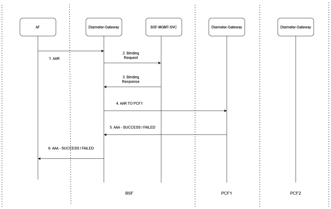

Call Flow of Rx AAR Existing Success or Failed Case - When Binding is Found
The call flow describes the scenario where BSF Diameter Gateway sends AAR request toward PCF1 Diameter Gateway on receiving the binding response from BSF Management service. On receiving the AAR request the PCF1 Diameter Gateway may send a successful or a failed AAA response toward BSF Diameter Gateway. The failed response is not handled by the BSF Diameter Gateway.
Figure 3-5 Rx AAR Existing Success/Failed Case - When Binding is Found
RX-AAR Existing Success / Failed Case - When Binding Found
  1. Application Function (AF) sends AAR request to BSF Diameter Gateway.
  2. BSF Diameter Gateway sends binding request to BSF Management Service.
  3. BSF Management service sends back binding response.
  4. BSF Diameter Gateway sends AAR request to PCF1 Diameter Gateway.
  5. PCF1 Diameter Gateway may send either a successful or failed AAA response and BSF Diameter Gateway do not handle the failed response.

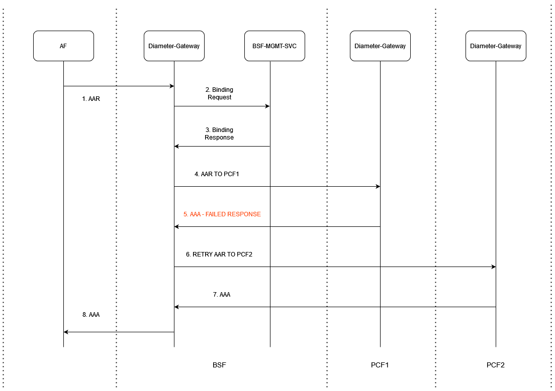

Call Flow of Rx AAR Retry Case - When Binding is Found
The call flow describes the scenario where BSF Diameter Gateway sends AAR request toward PCF1 Diameter Gateway on receiving the binding response from BSF Management service. On receiving the AAR request, the PCF1 Diameter Gateway may send a successful or a failed AAA response toward BSF Diameter Gateway. The failed response is handled by the BSF Diameter Gateway.
Figure 3-7 Rx AAR Retry Case - When Binding is Found
RX-AAR Retry Case - When Binding Found
  5. PCF1 Diameter Gateway sends a failed AAA response to BSF Diameter Gateway.
  6. BSF Diameter Gateway resends the failed AAA message to PCF2 Diameter Gateway.
  7. PCF2 Diameter Gateway sends a successful AAA response to BSF Diameter Gateway.
  8. BSF Diameter Gateway sends this AAA message to AF.

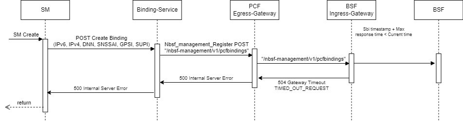

3.12 Detection and Handling of Late Arrival Requests
BSF receives requests from Ingress Gateway with the 3GPP headers. These requests help in detecting the response time for the BSF Management Service. The Ingress Gateway receives the following headers:
  • 3gpp-Sbi-Origination-Timestamp- It contains the timestamp when the originating entity initiates the request
  • 3gpp-Sbi-Max-Rsp-Time- The header indicates the duration (expressed in milliseconds) during which the HTTP client waits for a response.
If the configuration for determining the late Arriving requests is enabled and BSF does not receive the required headers, the requests are valid and processed. The call flow will continue as normal.
BSF must be able to read the 3gpp-Sbi-Origination-Timestamp and 3gpp-Sbi-Max-Rsp-Time headers to respond to the request. Consider the following scenarios:
  • If the sum of 3gpp-Sbi-Origination-Timestamp and 3gpp-Sbi-Max-Rsp-Time is less than the current time, the PCF service rejects the message with a 504 HTTP code and sends the message "TIMED_OUT_REQUEST".
  • If the request does not include either 3gpp-Sbi-Origination-Timestamp or 3gpp-Sbi-Sender-Timestamp, or 3gpp-Sbi-Max-Rsp-Time headers, then the request is accepted. There are no changes in the call flow with the inclusion of collision detection.
  • If 3gpp-Sbi-Max-Rsp-Time receives a negative value, the header is considered invalid. In this case, the service fallbacks to the default behavior and accepts the request irrespective of the 3gpp-Sbi-Origination-Timestamp or 3gpp-Sbi-Sender-Timestamp value.
The following diagram illustrates the request timeout in BSF:
Figure 3-11 Request Timeout in BSF
For handling and detection of Late Arrival and Collision Detection functionality in BSF, it is necessary that these headers and the new Custom header are transmitted from PCF to BSF.
Custom Header Enhancement adds the Time Stamp as a default value in the request and response custom headers with specific time formats and time zones. A valid function definition for timestamp in the configuration is: func: currentTime(time-format,time-zone).
Note: Here, only the GMT, IST, PST, and UTC time zones are to be considered for all 5G timestamps.
The only date format supported for the headers is RFC 7231: EEE, dd MMM yyyy HH:mm:ss.SSS zzz (Sun, 04 Aug 2019 08:49:37.845 GMT).
Any other format will result in a parse error which leads to not using the header for the feature (taking it as null value).

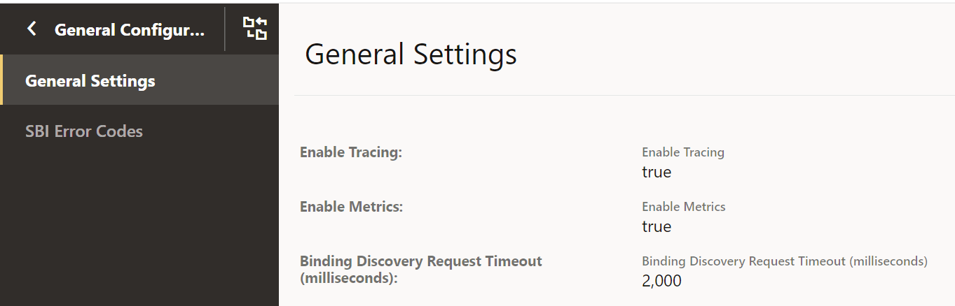

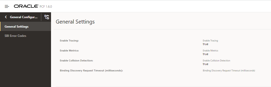

Enable
You can enable or disable the collision detection in the General Settings of the General Configuration window of the CNC Console.
Figure 3-12 Enabling Collision Detection
You can enable or disable the collision detection feature using the REST API for BSF. Use the General Settings REST API to enable or disable this feature.
REST API Path: /oc-bsf-configuration/v1/general
For more information, see the Oracle Communications Cloud Native Core Binding Support Function User Guide.

The Binding discovery request timeout configuration parameter is used for request timeout value for the discovery request sent by the BSF Diameter Gateway towards the BSF Management Service.
Figure 3-13 General Settings
General Settings

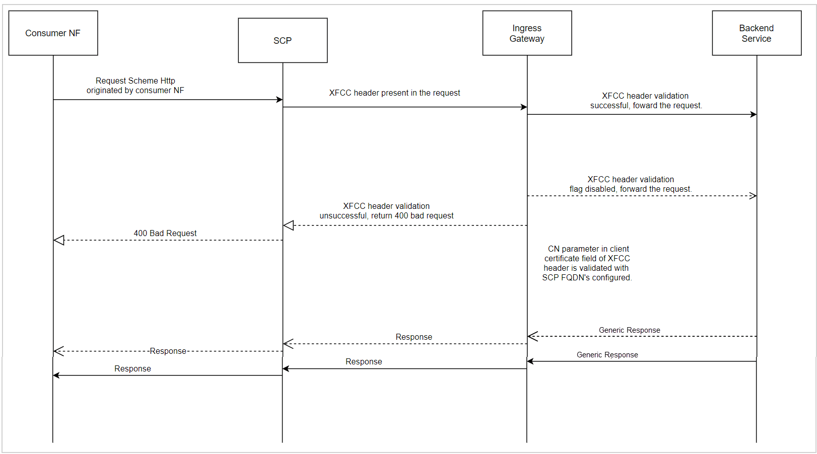

Validating single XFCC Header
The following figure describes the call flow for validation of a single XFCC header:
Figure 3-16 Call Flow Validation of Single XFCC Header
Single XFCC Header call flow
Table 3-7 Single XFCC Header Configuration
Scenario Condition Action
Ensure that the XFCC Header validation parameter is enabled for the corresponding route match and the matchCerts count is configured correctly.Given XFCC Header validation parameter is enabled for the corresponding route match and matchCerts count correctly configured. When the matchField parameter of the client certificate field in XFCC header matches with one of the configured NF FQDNs . Forwards the request to a back-end microservice and receives a corresponding response.
Given XFCC header validation parameter is enabled for the corresponding route match and matchCerts count correctly configured. When matchField parameter of client certificate field in XFCC header does not match with the configured NF FQDNs. Return a 400 Bad Request response from Ingress Gateway.
For more infirmation about error codes, see SBI Error Codes Configurations
Given XFCC header validation parameter disabled for the corresponding route match. NA Forwards the request to the back-end microservice and receives a corresponding response.
Example of a single XFCC header request:
x-forwarded-client-cert: By=http://router1.blr.com;Hash=468ed33be74eee6556d90c0149c1309e9ba61d6425303443c0748a02dd8de68; Subject="/C=US/ST=CA/L=San Francisco/OU=Lyft/CN=Test Client"; URI=http://testenv1.blr.com;DNS=blr.com; DNS=www.blr.com

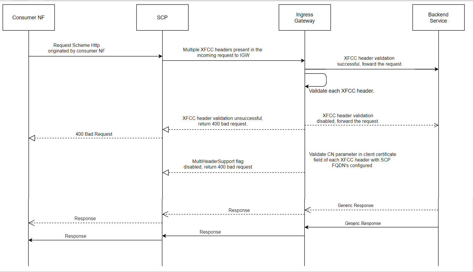

Validating multiple XFCC Headers
The following figure describes the call flow for validation of multiple XFCC headers for the following scenarios:
Figure 3-17 Call Flow Validation of Multiple XFCC Headers
Multiple XFCC Header call flow
Table 3-8 Multiple XFCC Headers Configuration
Scenrio Condition Action
Given XFCC header validation parameter is enabled and matchCerts count correctly configured to validate across XFCC header certificates from the right most entry. When matchField parameter of the corresponding client certificate field being validated against currently in the corresponding XFCC header matches with the NF FQDN's configured at Ingress Gateway. Consider the request as a valid request and forward the request to the back-end micro-service and receive a corresponding response.
Given XFCC header validation parameter is enabled and matchCerts count correctly configured to validate across XFCC header certificates from the right most entry. When matchField parameter of client certificate field in corresponding XFCC headers do not match with the NF FQDN's configured at Ingress Gateway for the corresponding matchCerts count. Consider the request as an invalid request and return a 400 Bad Request response from IGW.
Given XFCC header validation parameter is enabled and matchCerts count -1. NA Consider the request as valid request and match against the corresponding match field in all XFCC headers, if validation successful then forward the request else return 400 BAD Request.
Given XFCC header validation parameter is disabled. NA Forward the request to back-end microservice and receive a corresponding response.
Example of multiple XFCC header request:
x-forwarded-client-cert:By=http://router1.blr.com;Hash=468ed33be74eee6556d90c0149c1309e9ba61d6425303443c0748a02dd8de68; Subject="/C=US/ST=CA/L=San Francisco/OU=Lyft/CN=nf1.com"; URI=http://testenv1.blr.com; DNS=nf8.com; DNS=nf1.com; DNS=nf6.com, By=http://router1.blr.com;Hash=468ed33be74eee6556d90c0149c1309e9ba61d6425303443c0748a02dd8de68; Subject="/C=US/ST=CA/L=San Francisco/OU=Lyft/CN=nf10.com"; URI=http://testenv1.blr.com; DNS=nf10.com; DNS=nf8.com; DNS=nf9.com, By=http://routexr1.blr.com;Hash=468ed33be74eee6556d90c0149c1309e9ba61d6425303443c0748a02dd8de68; Subject="/C=US/ST=CA/L=San Francisco/OU=Lyft/CN=nf4.com"; URI=http://testenv1.blr.com; DNS=nf9.com; DNS=nf4.com;DNS=nf1.com

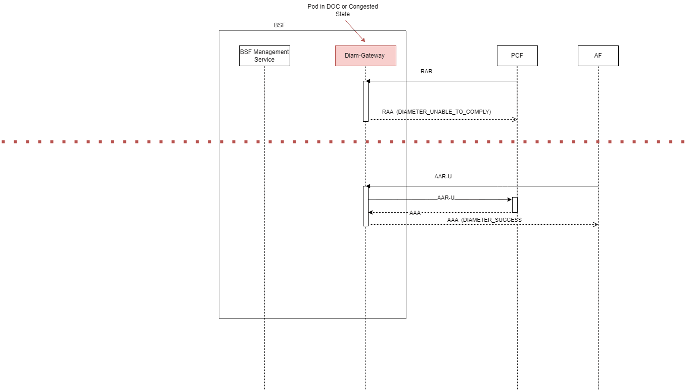

For priority based load shedding to happen, the load rule configured for current congestion state is taken into consideration. If there is no rule configured for a congestion state, the request is accepted by default. While defining load rules, the user can customize the result to reject the request. However, to reject requests from backend peers, the result code is always DIAMETER_TOO_BUSY.
Call Flow
To understand how the diameter congestion control feature works, consider a scenario where the priority rules are configured as described in the following table:
Table 3-11 Priority Rules
Message Priority
Default 6
RAR 10
For this call flow, discard priority is set as 10 for DOC and Congested state. The resulting code for rejecting request messages is set as DIAMETER_UNABLE_TO_COMPLY, that is applicable only for external peers.
Figure 3-22 Call flow diagram for Diameter Congestion Control
  • When the Diameter Gateway is in DOC or Congested state, receives a RAR request, the priority is compared against discard priority. Since both message priority and discard the priority values are the same, the message is rejected with the DIAMETER_UNABLE_TO_COMPLY result code.
  • When the Diameter Gateway is in DOC or Congested state, receives AAR request, the priority is compared against discard priority. Since no priority rule is configured for this message request, the message is accepted with the DIAMETER_SUCCESS result code.

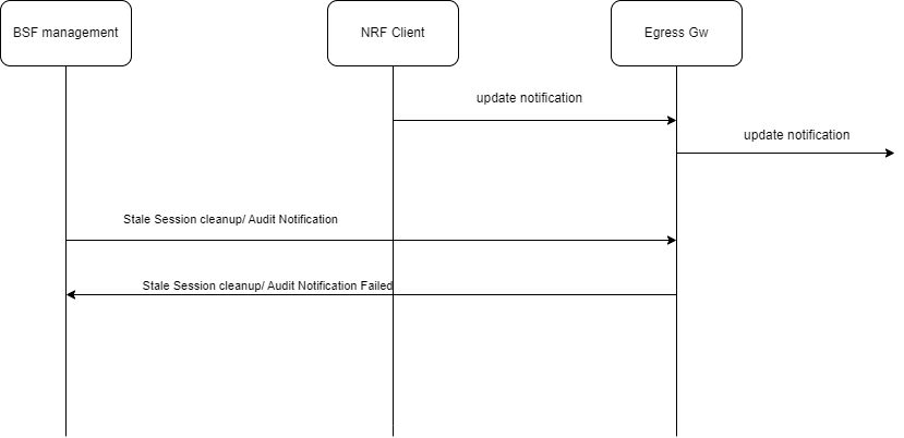

3.26 Handling Stale Session in BSF
Overview
A session binding on BSF is considered as stale when the PCF binding is successfully registered on BSF but has no corresponding session on PCF. When you enable stale session handling feature, the Audit service detects stale sessions automatically at regular intervals.
During the audit, if the audit service finds records with a binding age greater than the configured value (default value is 3600 minutes), it marks such records as suspected stale and initiates a request to notify the BSF management service. Depending on the feature configurations, BSF may query PCF to confirm if the pcfBinding records are stale. If PCF confirms the record as stale, then BSF removes it from its local database. However, if PCF sends 2xx in the response, then BSF updates the last access time for the associated pcfBinding record.
If the audit service finds a pcfBinding record with binding age greater than the maximum binding age (default value is 7200 minutes), it notifies the BSF Management service. On receiving the notification, BSF deletes the specified record from its database.
For georedundant BSF deployments, binding records are replicated to other redundant sites after the audit cycle is complete. Logs are published when audit service detects and removes stale sessions.
Query PCF to confirm a record as stale

BSF generates logs when audit service detects and removes stale sessions automatically. In addition, logs are printed for query requests towards PCF and the associated responses.

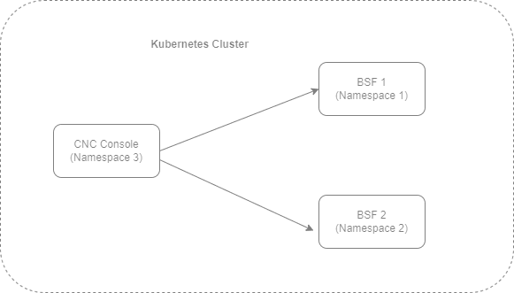

In a single cluster deployment, the CNC Console can manage NFs and Oracle Communications Cloud Native Core, Cloud Native Environment (CNE) common services deployed in the local Kubernetes clusters.
In a multiple instances deployment, the CNC Console can manage multiple BSF instances and CNE common services deployed within a Kubernetes cluster. For more information about single and multiple cluster deployments, see Oracle Communications Cloud Native Core, Cloud Native Configuration Console Installation, Upgrade, and Fault Recovery Guide.
The following image represents a Kubernetes cluster with one instance of CNC Console and two instances of BSF. The single instance of the CNC Console is configuring two instances of BSF with different namespaces.
Figure 3-23 Support for Multiple Instance Deployment

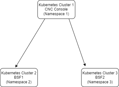

With the support of multicluster deployment, BSF deployed in multiple Kubernetes clusters can be accessed using CNC Console. In a multicluster deployment, the CNC Console can manage BSF and OCCNE common services deployed in the remote Kubernetes clusters.
The following image represents multiple Kubernetes clusters with one CNC Console and two BSF deployments. The single instance of CNC Console is configuring two instances of BSF with different namespaces deployed in different clusters.
Figure 3-24 Support for Multicluster Deployment

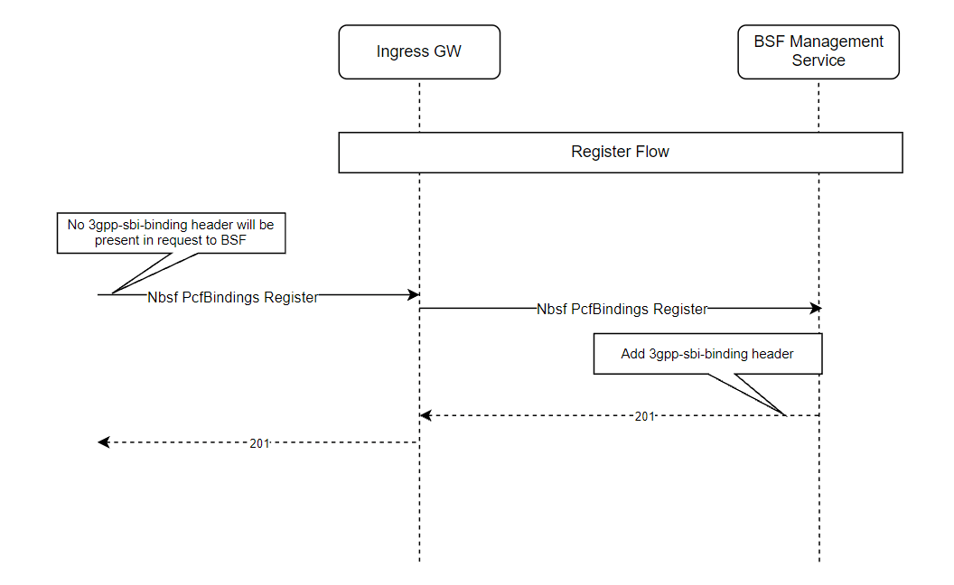

The above call flow diagram describes a scenario where PCF sends a request to register PcfBindings towards the BSF Management service through Ingress Gateway. The register request does not contain a 3gpp-sbi-binding header.
Once the request is received at BSF, the BSF Management service adds 3gpp-sbi-binding to the response and sends it back to the PCF with HTTP status code 201.
If the user does not want to add a binding header to response messages, then it can be configured through CNC Console or REST APIs for BSF.

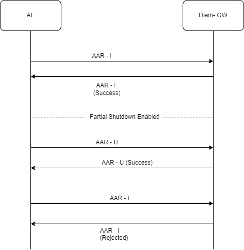

Gateways enforce load control when the system is in a PARTIAL or COMPLETE shutdown state. The level of load control varies based on the shutdown state. When in a PARTIAL shutdown state, no new session establishments are allowed so session creation messages will be rejected (with configured error code) in this state. When in complete shutdown, no messages are allowed.
When the system is in COMPLETE SHUTDOWN state, audit service triggered notification or diameter messages will be rejected at respective gateways.
Call Flow for Daimeter Gateway
NORMAL State: If the Controlled shutdown operational state is NORMAL, then the Diameter Gateway processes the message as normal.
PARTIAL SHUTDOWN: If the controlled shutdown operational state is PARTIAL SHUTDOWN, then the Diameter Gateway accepts only in-session messages and rejects all CCR-I and AAR-I messages.
Diameter Gateway Partial Shutdown
COMPLETE SHUTDOWN: If the controlled shutdown operational state is COMPLETE SHUTDOWN, then the Diameter Gateway accepts only in-session messages and rejects all messages.
Diameter Gateway Complete Shutdown

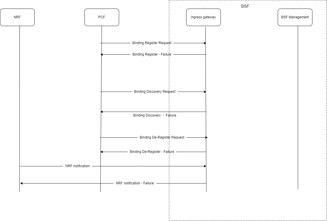

Call Flow for Ingress Gateway
NORMAL State: If the Controlled shutdown operational state is NORMAL, then the Ingress Gateway processes the message as normal.
PARTIAL SHUTDOWN: If the controlled shutdown operational state is PARTIAL SHUTDOWN, then the Ingress Gateway accepts only in-session messages and rejects all SM-Create requests.
Ingress Gateway Partial Shutdown
COMPLETE SHUTDOWN: If the controlled shutdown operational state is COMPLETE SHUTDOWN, then the Ingress Gateway rejects all incoming requests.
Ingress Gateway Complete Shutdown
