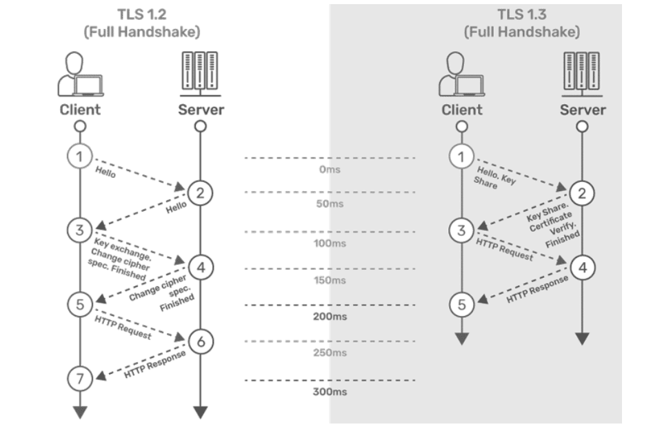

TLS 1.2
Step 1: The connection or handshake starts when the client sends a “client hello” message to the server. This message consists of cryptographic information such as supported protocols and supported cipher suites. It also contains a random value or random byte string.
Step 2: To respond to the “client hello” message, the server sends the “server hello” message. This message contains the CipherSuite that the server has selected from the options provided by the client. The server also sends its certificate along with the session ID and another random value.
Step 3: The client verifies the certificate sent by the server. When the verification is complete, it sends a byte string and encrypts it using the public key of the server certificate.
Step 4: When the server receives the secret, both the client and server generate a master key along with session keys (ephemeral keys). These session keys are used to symmetrically encrypt the data.
Step 5: The client sends an “HTTP Request” message to the server to enable the server to switch to symmetric encryption using the session keys.
Step 6: To respond to the client’s “HTTP Request” message, the server does the same and switches its security state to symmetric encryption. The server concludes the handshake by sending an HTTP response.
Step 7: The client-server handshake is completed in two round-trips.
TLS 1.3
Step 1: The connection or handshake starts when the client sends a “client hello” message to the server. The client sends the list of supported cipher suites. The client also sends its key share for that particular key agreement protocol.
Step 2: To respond to the “client hello” message, the server sends the key agreement protocol that it has chosen. The “Server Hello” message comprises the server key share, server certificate, and the “Server Finished” message.
Step 3: The client verifies the server certificate, generates keys as it has the key share of the server, and sends the “Client Finished” message along with an HTTP request.
Step 4: The server completes the handshake by sending an HTTP response.

Table 4-2 Comparison of TLS 1.2 and TLS 1.3
Feature TLS 1.2 TLS 1.3
TLS Handshake
  • The initial handshake was carried out in clear text.
  • A typical handshake in TLS 1.2 involves the exchange of 5 to 7 packets.
  • The initial handshake is carried out along with the key share.
  • A typical handshake IN TLS 1.3 involves the exchange of up to 3 packets.

Round-Trip Time (RTT) This has a high RTT during the TLS handshake. This has low RTT during the TLS handshake.
Perfect Forward Secrecy (PFS) This doesn't support PFS. TLS 1.3 supports PFS. PFS ensures that each session key is completely independent of long-term private keys, which are keys that are used for an extended period to decrypt encrypted data.
Privacy This is less secure, as the ciphers used are weak. This is more secure, as the ciphers used are strong.
Performance This has high latency and a less responsive connection. This has low latency and a more responsive connection.

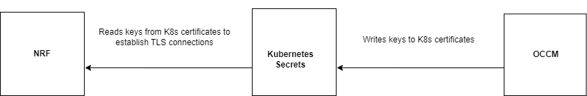

Managing Support for TLS 1.2 and TLS 1.3
Enable
This feature can be enabled or disabled at the time of NRF deployment using the following Helm Parameters:
  • enableIncomingHttps - This flag is used for enabling/disabling HTTPS/2.0 (secured TLS) in the Ingress Gateway. If the value is set to false, NRF will not accept any HTTPS/2.0 (secured) traffic. If the value is set to true, NRF will accept HTTPS/2.0 (secured) Traffic.
    Note: Do not change &enableIncomingHttpsRef reference variable.
    For more information on enabling this flag, see the "Enabling HTTPS at Ingress Gateway" section in Oracle Communications Cloud Native Core, Network Repository Function Installation, Upgrade, and Fault Recovery Guide.
  • enableOutgoingHttps -This flag is used for enabling/disabling HTTPS/2.0 (secured TLS) in the Egress Gateway. If the value is set to false, NRF will not accept any HTTPS/2.0 (secured) traffic. If the value is set to true, NRF will accept HTTPS/2.0 (secured) traffic.
    For more information on enabling this flag, see the "Enabling HTTPS at Egress Gateway" section in Oracle Communications Cloud Native Core, Network Repository Function Installation, Upgrade, and Fault Recovery Guide.
Configure
You can configure this feature using Helm parameters.
The following parameters in the Ingress Gateway and Egress Gateway microservices must be customized to support TLS 1.2 or TLS 1.3.
  1. Generate HTTPS certificates for both the Ingress and Egress Gateways. Ensure that the certificates are correctly configured for secure communication. After generating the certificates, create a Kubernetes secret for each Gateway (Ingress and Egress). Then, configure these secrets to be used by the respective Gateways. For more information about HTTPS configuration, generating certificates, and creating secrets, see the "Configuring Secrets for Enabling HTTPS" section in the Oracle Communications Cloud Native Core, Network Repository Function Installation, Upgrade, and Fault Recovery Guide.

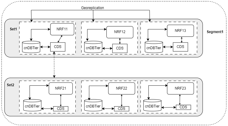

4.6 Enhanced NRF Set Based Deployment (NRF Growth)
NRF was supporting the deployment of two segments of NRF in a network. In the case of capacity expansion of the network to support increased traffic, a single NRF set cannot be scaled beyond a certain capacity.
With the implementation of this feature, NRF supports the deployment of multiple NRF set on the network instead of scaling the capacity of each NRF instance. Each segment in this network can have a single georedundant set and each set can have up to four georedundant NRFs. The georedundant NRFs in the set share the state data with each other.
Figure 4-3 NRF Segments
NRF Segments

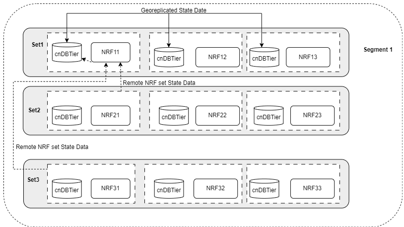

A dedicated cnDBTier instance is deployed for each NRF that is georeplicated within the specific NRF set. Each NRF in the set synchronizes with its most preferred NRFs in the other sets within the segment to retrieve the state data of that set. Thus, every NRF has the complete segment-level view of all the sets in a specific segment.
The state data in each NRF comprises of:
  • local data
  • georeplicated data of the specific set
  • remote data from the other sets.
Figure 4-4 State Data in NRF
State Data in NRF
The Cache Data Service (CDS), which is multipod deployment, builds and maintains the state data of the local NRF set and the remote NRF sets in the in-memory cache. Each pod of CDS maintains its cache independently. CDS maintains the segment-level view of the state data. This segment-level view is not pushed to cnDBTier. For more information about CDS, see NRF Architecture.
The cache of local NRF set data:
  • is built or updated by querying the cnDBTier periodically
  • uses the last known information about the NFs when CDS is not updated due to a database error
The cache of remote set data:
  • is built or updated by synchronizing the state data of remote NRF sets periodically.
    The periodicity at which the remote NRF set data is synchronized with CDS in-memory cache is 2 seconds. Remote NRF set data synchronization is not performed for each request as it is performed over the WAN network. This may cause higher latency as it involves retries also.
  • uses the last known information about the NFs in case remote NRF set sync is failed.

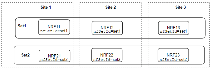

  2. Configure a unique nfSetId for each NRF set using the /nrf-configuration/v1/nrfGrowth/featureOptions. Ensure that the same nfSetId must be configured for all the NRFs in the set.
    For example: Consider a case of three NRF instances in a set and the nfSetId is set1. Set1 has NRF11, NRF12, and NRF13. Configure set1 as nfSetId for NRF11, NRF12, and NRF13. See Figure 4-6 for more details.
  3. Install new NRF set(s) or upgrade an existing NRF set(s) to the NRF 24.1.0 version or above.
    For example: Consider the new NRF set as Set2 with three NRF instances, NRF21, NRF 22, and NRF23. See Figure 4-6 for more details.
  4. Using the following state data API, retrieve the nf-instances and subscription details in each NRF of each set. Save the output for validation later.
    1. Use /nrf-state-data/v1/nf-details to retrieve the nf-instances details.
    2. Use /nrf-state-data/v1/subscription-details to retrieve the subscription details.
    For more information about the query parameters, see the REST Based NRF State Data Retrieval section.
  5. Configure the nfSetId of the new NRF set by setting the attribute nfSetId using the API /nrf-configuration/v1/nrfGrowth/featureOptions. Ensure that the same nfSetId must be configured for all the NRFs in the set.
    For example: nfSetId of Set2 is set2. Configure set2 as nfSetId for NRF21, NRF 22, and NRF23. See Figure 4-6 for more details.
  6. Load the NRF Growth feature specific alerts in both the sets. For more information about the alert configuration, see the NRF Alert Configuration section.
  7. Configure the NRFs of the remote NRF sets in each NRF by setting the attribute nrfHostConfigList using the API /nrf-configuration/v1/nrfGrowth/featureOptions.
    • Once configured, the NRFs will start syncing with the remote NRF sets. The remote set data will not be used for service operations until the feature is enabled.
    • One of the entries in the staticNrfConfigList attribute must contain the details of the local NRF set.
    For example: Configure the host details of NRFs in Set2 as the remote NRF sets in each NRFs of Set1. For instance, configure the nrfHostConfigList attribute in NRF11 of Set1 as remote NRFs host details of NRF21, NRF 22, and NRF23. Similarly, configure each NRFs in Set1 and Set2.
  8. Ensure that the following alerts are not present in any of the sets in the network:
    1. OcnrfRemoteSetNrfSyncFailed
    2. OcnrfSyncFailureFromAllNrfsOfAllRemoteSets
    3. OcnrfSyncFailureFromAllNrfsOfAnyRemoteSet
      If present, wait for 30 seconds to 1 minute and retry till the alerts are cleared. If the alerts are not cleared, see alerts for resolution steps.
  9. Use the state data API to validate the nf-instances and subscriptions as below to ensure that the remote synching is successful, and all the NFs and subscriptions are synced.
    1. Use /nrf-state-data/v1/nf-details?testSegmentData=true to validate the nf-instances.
    2. Use /nrf-state-data/v1/subscription-details?testSegmentData=true to validate the subscriptions.
    Where, testSegmentData query is used to validate the state data of the segment before enabling the NRF Growth feature.
    Ensure that the state data of the NRFs in Set1 is available in the NRFs of Set2. In case you are upgrading the existing set, then ensure that the state data of the NRFs in Set2 is available in the NRFs of Set1.
  10. Enable NRF Growth Forwarding feature, if forwarding is applicable.
    When NRF Growth feature is enabled, the existing forwarding options will not be used.
  11. Enable the NRF Growth feature in all the NRFs. Enable the feature using the API /nrf-configuration/v1/nrfGrowth/featureOptions.
  12. Ensure that the following alerts are not present in any of the sets in the network:
    4. OcnrfDatabaseFallbackUsed
  13. After the above configurations are complete, all service operations consider complete segment data for processing the request.
    You can migrate the NFs from Set1 to Set2 or vice-versa. For more information about the steps to migrate NFs, see the Migration of NFs section.

4.6.1 Impacted Service Operations
This section explains the change in the functionality of the service operation when multiple NRF sets are deployed.
nfRegistration Service Operation
NFRegister, NFUpdate, or NFDeregister
The NF registers and heartbeats to the Primary NRF. When the nfRegistration service receives an NFRegister, NFUpdate, or NFDeregister request, it processes the request and if successful, it creates, updates, or deletes the nf-instances records from the cnDBTier. The nf-instances is made available and used by the service operation in the remote set as well.
The nfRegistration service does not query the Cache Data Service (CDS) for these service operations. It directly updates or saves the data in the local cnDBTier.
NFProfileRetrieval
When the nfRegistration service receives the NFProfileRetrieval request, it queries the CDS to fetch the NFProfile.
The CDS provides the NFProfile of the local NRF set by querying the cnDBTier. The CDS queries the remote NRF sets periodically and caches the data in the in-memory cache. If the growth feature is enabled, the CDS provides the NFProfile registered at the remote NRF sets by querying the in-memory cache.
The response contains the matching NFProfile either from the local NRF set or from the remote NRF set. The NFProfileRetrieval response is created by the nfRegistration service with the nf-instances provided by the CDS.

4.7 Support for Automated Certificate Lifecycle Management
In NRF 23.3.x and earlier, X.509 and Transport Layer Security (TLS) certificates were managed manually. When multiple instances of NRF were deployed in a 5G network, certificate management, such as certificate creation, renewal, removal, and so on, became tedious and error-prone.
Starting with NRF 23.4.x, you can integrate NRF with Oracle Communications Cloud Native Core, Certificate Management (OCCM) to support automation of certificate lifecycle management. OCCM manages TLS certificates stored in Kubernetes secrets by integrating with Certificate Authority (CA) using the Certificate Management Protocol Version 2 (CMPv2) protocol in the Kubernetes secret. OCCM obtains and signs TLS certificates within the NRF namespace. For more information about OCCM, see Oracle Communications Cloud Native Core, Certificate Management User Guide.
Figure 4-8 Support for OCCM
Support for OCCM
The above diagram indicates that OCCM writes the keys to the certificates and NRF reads these keys to establish a TLS connection with other NFs.
OCCM can automatically manage the following TLS certificates:
  • 5G Service Based Architecture (SBA) client TLS certificates
  • 5G SBA server TLS certificates
  • Message Feed TLS certificates
This feature enables NRF to monitor, create, recreate, and renew TLS certificates using OCCM, based on their validity. For information about enabling HTTPS, see "Configuring Secrets for Enabling HTTPS" in Oracle Communications Cloud Native Core, Network Repository Function Installation, Upgrade, and Fault Recovery Guide.

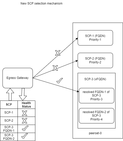

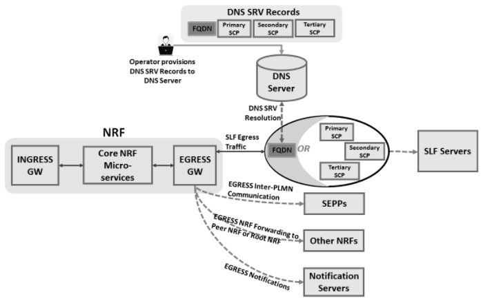

4.9 Routing Egress Messages through SCP
NRF allows routing of following Egress messages through SCP or directly with an option to configure each Egress request type independently:
  • SLF requests
  • Notification requests
  • NRF Forwarding requests
  • Roaming requests
The above requests are routed through SCP based on the configuration in the Egress Gateway. For more information about the routes configuration, see the "Routes Configuration" section in Oracle Communications Cloud Native Core, Network Repository Function REST Specification Guide.
NRF supports routing of the Egress requests through SCP configured with FQDN and virtual FQDN as peer instances.
Alternate route service is used for the resolution of virtual FQDN using DNS-SRV. Egress Gateway uses the virtual FQDN of peer instances to query the Alternate Route Service to get the list of alternate FQDNs, each of which has a priority assigned to them. The Egress Gateway selects the peer instances based on the priority value.
Figure 4-9 Routing Egress Messages through SCP

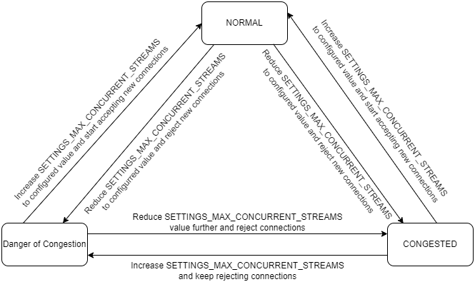

Ingress Gateway Pod States
Following are the various states to detect overload conditions. This will protect and mitigate the pod entering into an unstable condition, and to take necessary actions to recover from this condition.
Figure 4-11 Pod Protection State Transition
The transition can occur between any states. The threshold for these congestion parameters are preconfigured and must not be changed.
  • Congested State: This is the upper bound state where the pod is congested. This means one or more congestion parameters are above the configured thresholds for the congested state. For more information about the configuration, see Oracle Communications Cloud Native Core, Network Repository Function REST Specification Guide. The pod can be transitioned to the Congested state either from the Normal State or the DoC state. When the pod reaches this state, the following actions are performed:
    • new incoming HTTP2 connection requests are not accepted.
    • the pod gradually decrements the number of concurrent streams by updating SETTINGS_MAX_CONCURRENT_STREAMS parameter in a SETTINGS frame to the configured maxConcurrentStreamsPerCon value at a regular interval. The number of concurrent streams are decremented based on the value configured in decrementBy parameter. And, the regular interval is configured in the decrementSamplingPeriod parameter.
  • Danger of Congestion (DoC) State: This is the intermediate state where the pod is approaching a congested state. This means if one or more congestion parameters are above the configured thresholds for the DoC state. For more information about the configuration, see Oracle Communications Cloud Native Core, Network Repository Function REST Specification Guide.
    • any new incoming HTTP2 connection requests are not accepted.
    • if the pod is transitioning from the Normal state to the DoC state, the pod gradually decrements the number of concurrent streams by updating SETTINGS_MAX_CONCURRENT_STREAMS parameter in a SETTINGS frame to the configured maxConcurrentStreamsPerCon value at a regular interval. The number of concurrent streams are decremented based on the value configured in decrementBy parameter. And, the regular interval is configured in the decrementSamplingPeriod parameter.
    • if the pod is transitioning from the Congested state to the DoC state, the pod gradually increments the number of concurrent streams by updating SETTINGS_MAX_CONCURRENT_STREAMS parameter in a SETTINGS frame to the configured maxConcurrentStreamsPerCon value at a regular interval. The number of concurrent streams are incremented based on the value configured in incrementBy parameter. And, the regular interval is configured in the incrementSamplingPeriod parameter.
  • Normal State: This is the lower bound state where the CPU usage is below the configured thresholds for DoC and Congested states. For more information about the configuration, see Oracle Communications Cloud Native Core, Network Repository Function REST Specification Guide.
    • the pod will continue accepting new incoming HTTP2 connection requests.
    • in case the pod is transitioning from the Congested or DoC state to Normal state, the pod gradually increments the number of concurrent streams by updating SETTINGS_MAX_CONCURRENT_STREAMS parameter in a SETTINGS frame to the configured maxConcurrentStreamsPerCon value at a regular interval. The number of concurrent streams are incremented based on the value configured in incrementBy parameter. And, the regular interval is configured in the incrementSamplingPeriod parameter.
To avoid toggling between these states due to traffic pattern, it is required for the pod to satisfy the condition of the target state for a given period before transitioning it to target state. For example, if the pod is transitioning from DoC to Congested state, then the pod must satisfy the threshold parameters of Congested state for a given period, before moving to Congested state.

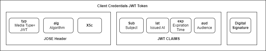

4.12 CCA Header Validation in NRF for Access Token Service Operation
Client Credentials assertion (CCA) is a token signed by the Consumer NF. It enables NRF to authenticate the Consumer NF which includes the signed token in Access Token service request. CCA header contains the Consumer NF's NfInstanceId that gets checked against the certificate by the NRF. The CCA also includes a timestamp as the basis for the restriction of its lifetime.
Consumer NF sends the 3gpp-Sbi-Client-Credentials header containing the CCA in the HTTP request and NRF performs the CCA validation. The CCA header validation is a JWT-based validation at NRF where the Consumer NF sends a JWT token as part of the header to NRF in Access Token request. The JWT token has an X5c certificate and other NF-specific information that is validated against the configuration values defined in NRF. The signature of the JWT token is validated against the CA root certificate configured at NRF.
Figure 4-12 Client Credentials JWT Token
Table 4-12 JOSE header
Attribute name Data type P Cardinality Description
typ String M 1 The "typ" (type) Header Parameter is used to declare the media type of the JWS. Default value: JWT
alg String M 1 The "alg" (algorithm) Header Parameter is used to secure the JWS. Supported Algorithm types: RSA/ECDSA.
X5c Array M 1 The "X5c" (X.509 certificate) Header Parameter contains the X.509 public key certificate corresponding to the key used to digitally sign the JWT.
Table 4-13 JWT claims
sub NfInstanceId M 1 This IE contains the NF instance ID of the NF service consumer, corresponding to the standard "Subject" claim.
iat integer M 1 This IE indicates the time at which the JWT was issued, corresponding to the standard "Issued At" claim. This claim may be used to determine the age of the JWT.
exp integer M 1 This IE contains the expiration time after which the client credentials assertion is considered to be expired, corresponding to the standard "Expiration Time" claim.
aud array(NFType) M 1..N This IE contains the NF type of NRF, for which the claim is applicable, corresponding to the standard "Audience" claim.
The digitally signed client credentials assertion is further converted to the JWS compact serialization encoding as a string.
If the validation is successful, the Access Token request is processed further.
If CCA header validation fails, the Access Token request is rejected by NRF with "403 Forbidden" with the cause attribute set to "CCA_VERIFICATION_FAILURE".

4.13 Monitoring the Availability of SCP Using SCP Health APIs
NRF determines the availability and reachability status of all SCPs irrespective of the configuration types.
This feature is an enhancement to the existing SBI routing functionality. Egress Gateway microservice interacts with SCP on their health API endpoints using HTTP2 OPTIONS method. It monitors the health of configured SCP peers to ensure that the traffic is routed directly to the healthy peers. This enhancement avoids routing or rerouting towards unhealthy peers, thus minimizing the latency time.
Egress Gateway microservice maintains the health status of all available and unavailable SCPs. It maintains the latest health of SCPs by periodically monitoring and uses this data to route egress traffic to the most preferred healthy SCP.
Figure 4-13 SCP Selection Mechanism
Once peerconfiguration, peersetconfiguration, routesconfiguration, and peermonitoringconfiguration parameters are configured at Egress Gateway microservice, and all SCPs (after Alternate Route Service (ARS) resolution, if any vFQDN is configured) are marked initially as healthy. The peers attached to the associated peerset are scheduled to run health API checks and update the health status continuously.
During the installation, the value of the parameter peermonitoringconfiguration is set to false by default. Since, this feature is an add-on to the existing SBI Routing feature and will be activated if the sbirouteconfig feature is enabled. To enable this feature, perform the following:
  • configure peerconfiguration with healthApiPath as /{scpApiRoot}/{apiVersion}/status
  • configure peersetconfiguration
  • configure routesconfiguration
  • configure sbiroutingerrorcriteriasets
  • configure sbiroutingerroractionsets
  • enable peermonitoringconfiguration
If SBI Routing feature is enabled before upgrading, the healthApi in peerconfiguration should be attached manually to existing configured peers. If the operator tries to enable peermonitoringconfiguration and the targeted peers do not have the healthApiPath then an appropriate error response is sent.

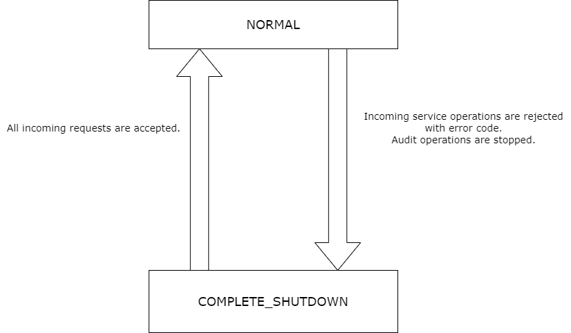

4.14 Controlled Shutdown of NRF
NRF supports controlled shutdown feature to isolate NRF from the current network at a particular site. This isolation helps to perform any maintenance activities or recovery procedures as required without uninstalling the NRF at the particular site. During this time the operations of the Ingress Gateway, Egress Gateway, and NrfAuditor microservices are paused. These services read the operational state from the database periodically. The operational state of NRF can be changed by using REST API or CNC Console at any time.
The two operational states defined for NRF are as follows:
  • NORMAL
  • COMPLETE_SHUTDOWN
  • Ensure that the database is up and the NRF services must be able to connect and communicate with the database to change the operational state.
  • In either state, if the database goes down, the back-end pods go to the NOT_READY state, but the Ingress Gateway microservice will continue to be in the last known operational state. When the Controlled Shutdown feature is enabled and the database is not available, all the incoming messages will be rejected with the Service Unavailable messages if the operational state is "NORMAL", or with a configurable error code if the operational state is COMPLETE_SHUTDOWN". However, the operators will not be able to see the operational state in CNC Console due to database unavailability.
If the controlled shutdown operational state is NORMAL, then NRF processes the message as normal.
If the controlled shutdown operational state is COMPLETE_SHUTDOWN, then NRF rejects all incoming requests with a configurable error code.
Figure 4-14 Operational State changes
The following behavior changes occur when the operational state changes:
From NORMAL to COMPLETE_SHUTDOWN
  • The Ingress Gateway microservice rejects all new requests towards the services that have been configured for controlled shutdown with a configurable error code. In this case, all the inflight transactions will be gracefully handled. The controlled shutdown applies to the following services:
    • nfregistration
    • nfdiscovery
    • nfsubscription
    • nfaccesstoken
    The error codes are configured using controlledshutdownerrormapping and errorcodeprofiles APIs.
  • The NrfAuditor microservice pauses all its audit procedures, hence no notifications are generated. OcnrfAuditOperationsPaused alert is raised to indicate that the audit is paused.
  • The Egress Gateway microservice handles all the inflight requests gracefully. Since the Ingress Gateway and NrfAuditor microservices are in a COMPLETE_SHUTDOWN operational state, there would be no requests from the backend services.
    No specific configuration for controlled shutdown needs to be applied on the routes for the Egress Gateway microservice.
  • The NrfConfiguration microservice continues to process any configuration requests in the COMPLETE_SHUTDOWN state.
  • OcnrfOperationalStateCompleteShutdown alert is raised to indicate the operational state of NRF is COMPLETE_SHUTDOWN.
  • The operational state change is recorded and can be viewed using the controlledShutdownOptions REST API. Additionally, the history of operational state changes can be viewed using the operationalStateHistory REST API.
From COMPLETE_SHUTDOWN to NORMAL
  • The Ingress Gateway microservice resumes processing all incoming requests.
  • The Egress Gateway microservice resumes processing all outgoing requests.
  • The NrfAuditor pod waits for a preconfigured waiting period before resuming its audit procedures to allow the NFs to move back to this NRF after the NRF has changed to the NORMAL operational state. Once the waiting period has expired, the audit procedures resume, and the OcnrfAuditOperationsPaused alert is cleared. The waiting period is defined as
    (defaultHbTimer * nfHeartBeatMissAllowed) + maxReplicationLatency(s) + replicationLatencyThreshold * latencyMultiplier
    Where,
    • defaultHbTimer - defaultHbTimer configured in nfManagementOptions.nfHeartBeatTimers where the nfType is "ALL_NF_TYPE". For more information about the parameter, see "NF Management Options" in Oracle Communications Cloud Native Core, Network Repository Function REST Specification Guide.
    • nfHeartBeatMissAllowed - nfHeartBeatMissAllowed configured in nfManagementOptions.nfHeartBeatTimers where the nfType is "ALL_NF_TYPE". For more information about the parameter, see "NF Management Options" in Oracle Communications Cloud Native Core, Network Repository Function REST Specification Guide.
    • maxReplicationLatency - The maximum replication latency detected across all the sites. This parameter supports dynamic value.
    • replicationLatencyThreshold - The replicationLatencyThreshold configured in geoRedundancyOptions. For more information about the parameter, see "Georedundancy Options" in Oracle Communications Cloud Native Core, Network Repository Function REST Specification Guide.
    • latencyMultiplier - A preconfigured fixed offset value set as 3.
  • OcnrfOperationalStateCompleteShutdown alert is cleared to indicate that the operational state of NRF is NORMAL.

Subscription Microservice Load States
Following are the different overload states to detect overload conditions. This will protect and mitigate the pod entering into an overload condition, and to take necessary actions to recover from overload.
Figure 4-16 Pod Protection State Transition
The transition can occur between any states based on the congestion parameters. These congestion parameters are preconfigured and cannot be changed.
  • Congested State: This is the upper bound state where the pod is congested. This means one or more congestion parameters is above the configured thresholds for the congested state. For more information about the configuration using CNC Console, see Pod Protection Options. The pod can be transitioned to the Congested State either from the Normal State or the DoC state.
    When pod reaches this state, the following actions are performed:
    • the pod gradually decrements the number of concurrent streams by updating SETTINGS_MAX_CONCURRENT_STREAMS parameter in a SETTINGS frame to the configured maxConcurrentStreamsPerCon value at a regular interval. The concurrent streams are decremented based on the value configured in decrementBy parameter. And, the regular interval is configured in the decrementSamplingPeriod parameter.
    Alerts are raised when any of the subscription pods go into this state. For more information about alerts, see NRF Alerts.
  • Danger of Congestion (DoC) State: This is the intermediate state where the pod is approaching a congested state. This means one or more congestion parameters, CPU or Pending Message Count, is above the configured thresholds for the DoC state. For more information about the configuration using CNC Console, see Pod Protection Options.
    • When pod reaches this state, the following actions are performed:
      • if the pod is transitioning from the Normal State to the DoC state, the pod gradually decrements the number of concurrent streams by updating SETTINGS_MAX_CONCURRENT_STREAMS parameter in a SETTINGS frame to the configured maxConcurrentStreamsPerCon value at a regular interval. The concurrent streams are decremented based on the value configured in decrementBy parameter. And, the regular interval is configured in the decrementSamplingPeriod parameter.
      • if the pod is transitioning from the Congested State to the DoC state, the pod gradually increments the number of concurrent streams by updating SETTINGS_MAX_CONCURRENT_STREAMS parameter in a SETTINGS frame to the configured maxConcurrentStreamsPerCon value at a regular interval. The concurrent streams are incremented based on the value configured in incrementBy parameter. And, the regular interval is configured in the incrementSamplingPeriod parameter.
  • Normal State: This is the lower bound state where all the congestion parameters for the pod are below the configured thresholds for DoC and Congested states. For more information about the configuration using CNC Console, see Pod Protection Options.
    • in case the pod is transitioning from the Congested or DoC state to Normal state, the pod gradually increments the number of concurrent streams by updating SETTINGS_MAX_CONCURRENT_STREAMS parameter in a SETTINGS frame to the configured maxConcurrentStreamsPerCon value at a regular interval. The concurrent streams are incremented based on the value configured in incrementBy parameter. And, the regular interval is configured in the incrementSamplingPeriod parameter.
To avoid toggling between these states due to traffic pattern, it is required for the pod to be in a particular state for a given period before transitioning to another state. The below configurations are used to define the period till which the pod has to be in a particular state:
  • stateChangeSampleCount
  • monitoringInterval
Formula for calculating the period is: (stateChangeSampleCount * monitoringInterval)

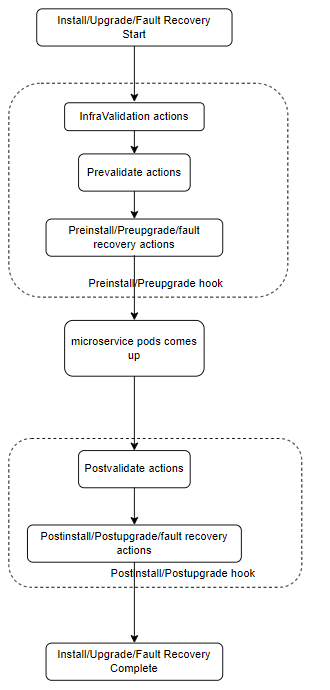

4.18 Pre and Post Install/Upgrade Validations
This feature applies validation checks on the infrastructure, application, databases, and its related tables before and after the installation, upgrade, or fault recovery.
When NRF is deployed, there could be inconsistencies and unexpected results if the required NRF tables or the site-specific configurations are not available. This could happen due to network issues, system issues, human error, race conditions. The feature aims to detect any inconsistency early in the system state and report the same. The validations are done during the preinstallation, postinstallation, preupgrade, and postupgrade. The infrastructure validations are performed as part of the preinstallation and preupgrade validations.
Validation of database and tables during rollback procedures is not supported.
The below diagram depicts the flow where the validations occur:
Figure 4-17 Pre and Post Install/Upgrade Validations
Database and its Related Tables Validation
Each microservice is responsible for validating the database and the tables that it creates and manages.

4.18.2 NRF Preinstallation Validation
The following sections describe the preinstallation validation performed when NRF is installed for fresh installation mode and fault recovery mode.
4.18.2.1 For Fresh Installation
The preinstallation validation is performed as part of the preinstallation hooks of each NRF microservice. It is the first set of actions performed. For more information about the list of microservices that perform validation, see NRF Microservice Table Validation.
This validation is configured by setting global.appValidate.preValidateEnabled parameter to true in the ocnrf_custom_values_24.2.5.yaml. The following checks are performed as part of the preinstallation validation:
  • Validate the presence of the database. If not present, the installation will not proceed. The database is expected to be present, before proceeding with installation.
  • Validate the ReleaseConfig table does not have release information about the site being installed. If present, the installation will not proceed, as it will not be a fresh installation.
  • Validate the presence of the required tables. Each microservice validates the tables that it is responsible for. If all the required tables are present, then the table schema is validated against the schema expected as per the release version. If the tables are partially present or if the schema validation fails, installation will not proceed. The tables are expected to be present when multisite georedundant NRF is deployed.
4.18.2.2 For Fault Recovery
NRF can be installed in fault recovery mode by setting global.appValidate.faultRecoveryMode parameter to true in the ocnrf_custom_values_24.2.5.yaml. When NRF is deployed in the fault recovery mode, with a database backup in place, the following checks are performed as part of the preinstallation validation:
  • Validate if the ReleaseConfig table contains release information about the site. If not present, the installation will not proceed as the table is expected to contain information from the database backup.
  • Validate the presence of the required tables. Each microservice validates the tables that it is responsible for. If the tables are present, then the table schema is validated against the schema expected as per the release version. If the tables are partially present or if the schema validation fails, installation will not proceed.
  • Validate the configType in the NrfSystemOptions table against the configTypes expected as per the releaseVersion of the specific site. If validation fails, installation will not proceed.
  • Validate the nfScreeningRulesListType in the NfScreening table against the nfScreeningRulesListType expected as per the releaseVersion of the specific site.
It is recommended that after the installation is completed in fault recovery mode, this flag has to be set to false. This can be done while performing future upgrades.
In case preinstallation fails, the error reason is logged in the preinstallation hook job of the particular microservice.

4.20.2 TLS SNI Header Validation
Oracle Communications Cloud Native Core, Network Repository Function (NRF) supports Server Name Identification (SNI) when acting as a client and sending TLS handshake message. The FQDN in SNI is used to identify the server for which the TLS connection is needed. When the same server is supporting multiple services, the SNI identifies which service is to be used for the TLS connection. As a part of the TLS handshake initiation process, SNI is populated in the client handshake sent by Egress Gateway depending on the routing type. There are two routing options:
  • Direct Routing – Egress Gateway adds the target server's FQDN in the SNI. If the target server has only IP address, then the SNI header will not be populated in the outgoing TLS requests.
  • Indirect Routing – Egress Gateways uses the FQDN of the selected Peer (For example, host of the SCP or SEPP) for populating the SNI header. If the selected peer has an IP address, SNI header is not populated in the outgoing TLS requests.
WARNING:
This feature should be enabled only for non-servicemesh-based deployments.
When the feature is enabled, SNI header is populated at Egress Gateway only when an FQDN is available.

NRF supports direct routing or dynamic routing of SLF queries:

  • Atleast one of the attributes fqdn, ipv4Address, or ipv6Address must be included by the registered UDR.
  • For routing, the NfService level attributes are considered first. If none of the attributes are present at NfService level, then the NfProfile level attributes are considered, not in a mix mode where some of the attributes are from NfService and some from NfProfile.
    However, with Support for Configurable Port and Routing Parameter Selection feature, routing selection parameter can be picked either from NfService or NfProfile in a mix mode as per the availability.
  • Of the three attributes, the endpoint is selected in the following order:
    • ipv4Address
    • ipv6Address
    • fqdn
    However with the Support for Configurable Port and Routing Parameter Selection feature, the order of the attributes can be configured.
  • For the cases where ports are not present, (example: ipv4Address and ipv6Address in NfProfile or FQDN from NfService/NfProfile or ipEndpoints with no port in NfService), scheme configured in the NfService is used to determine the port.
    • If NfService.scheme is set to http, port 80 is used.
    • If NfService.scheme is set to https, port 443 is used.
    However with Support for Configurable Port and Routing Parameter Selection feature, the port selection can be configured.

4.21.4 Rerouting SLF Requests Using Alternate SCP and Alternate SLF
NRF supports routing SLF requests through SCP as per the configuration in the Egress Gateway SBI routing configuration. SLFs are selected based on Static or Dynamic SLF feature configuration.
In case an error response is received from SLF, NRF reroutes the SLF request to an alternate SLF. However, in this case, the same SCP that was used in the previous route is always used. It is possible that SCP had rerouted the SLF request to the alternate SLF in the first attempt and it failed. In the subsequent attempt if the same SCP is used, there is a possibility that this reroute might also fail. Also, NRF doesn't consider the number of SLFs that are already been attempted by SCP.
With the implementation of this feature, NRF allows you to configure maximum number of SLF attempts or an alternate SCP route to enhance the routing strategy and minimize the number of reroutes. When an error response is received, the subsequent reroutes to SLF are through alternate SCP and SLF path, improving resilience and service continuity.
NRF discovery microservice sends the Nudr_GroupIDmap request to SLF through SCP based on the Egress Gateway routes configuration.
This feature allows you to configure the maximum number of SLF attempts or an alternate SCP route to process the subsequent attempts.
This can be achieved by:
  • Limiting number of SLF attempts: This is performed by configuring the number of SLF attempts in the maxSLFattempts parameter. For more information, see Maximum SLF Attempts.
  • Choosing an alternate SCP: This is performed by enabling the useAlternateScp parameter. For more information, see Use Alternate SCP.
If the Egress Gateway is down, then no reroute is performed and an error response is sent to the producer NF.

Use Alternate SCP
In a routing using SCP deployment, when the discovery service receives a non-2xx response, NRF checks the useAlternateScp parameter value.
If useAlternateScp parameter is set to true, then NRF chooses an alternate SCP, if available, to reroute the in a round-robin format to reroute the request. If there is only one SCP instance, NRF reroutes the request using the same SCP irrespective of the useAlternateScp configuration.
If all the available SCPs are tired and attempts are left, then NRF revolves back to the first SCP and repeat the SCP selection based on the round-robin.
  • When useAlternateScp is set to true, alternate SCP selection will not guaranteed if SCP Health APIs feature is enabled. Hence, it is recommended to disable SCP Health APIs feature when useAlternateScp is set to true. For more information about the SCP Health APIs feature, see the Monitoring the Availability of SCP Using SCP Health APIs section.
  • When useAlternateScp is set to true, customPeerSelectorEnabled parameter in {apiRoot}/nrf/nf-common-component/v1/egw/routesconfiguration must also be set to true.

4.29 NRF Access Token Service Usage Details
NRF implements Nnrf_AccessToken service (used for OAuth2 authorization), along with the "Client Credentials" authorization grant. It exposes a "Token Endpoint" where the Access Token Request service can be requested by NF service consumers.
The Nnrf_AccessToken service operation is defined as follows:
  • Access Token Request (Nnrf_AccessToken_Get)
This procedure is specific to the NRF Access Token service operation. NRF general configurations, database, and database-specific secret creation are not part of this procedure.
Procedure to use NRF Access Token Service Operation
This procedure provides step-by-step details to use 3GPP defined access token service operation supported by NRF.
  1. Create NRF private key and public certificate
    This step explains the need to create the NRF private keys and public certificates.
    Private keys are used by NRF to sign the Access Token generated. It is available only with NRF.
    Public certificates are used by producer NFs to validate the access token generated by NRF. So, public certificates are available with producer network functions. NRF does not need the public certificate while signing the access token.
    The expiry time of the certificate is required to set appropriate validity time in the AccessTokenClaim.
    For more details about the validity time of AccessTokenClaim, see "oauthTokenExpiryTime".
    Two types of signing algorithms are supported by NRF. For both types different keys and certificates required to be generated:
    • ES256: ECDSA digital signature with SHA-256 hash algorithm
    • RS256: RSA digital signature with SHA-256 hash algorithm

  2. Namespace creation for Secrets
    This step explains the need to create Kubernetes namespace in which Kubernetes secrets are created for NRF private keys and public certificates. For creating namespace, see the "Verifying and Creating NRF Namespace" section in Oracle Communications Cloud Native Core, Network Repository Function Installation, Upgrade, and Fault Recovery Guide.
    • Different namespaces or the same namespace can be used for NRF private keys and public certificates.
    • It can be the same namespace as for NRF deployment.
    • Appropriate RBAC permission needs to be associated with the ServiceAccount, if the namespace is other than NRF's namespace.
  3. Secret creation for NRF private keys and public certificates
    This step explains commands to create the Kubernetes secret(s) in which NRF private keys and public certificates can be kept safely. For configuring secrets, see the "Configuring Secret for Enabling Access Token Service" section in Oracle Communications Cloud Native Core, Network Repository Function Installation, Upgrade, and Fault Recovery Guide.
    The same secret can be used which is already there for NRF private keys.
    A sample command is provided in the "Configuring Kubernetes Secret for Accessing NRF Database" section in Oracle Communications Cloud Native Core, Network Repository Function Installation, Upgrade, and Fault Recovery Guide to create or update the secret. In case, there is a need to create or update multiple secrets for each entity, then the same section can be followed.
  4. Perform NRF REST based configuration with outcome details of Steps 1 to 3
    This step explains the NRF REST based configuration to use the NRF private keys, public certificates, secret(s), and secret namespace(s).
    NRF REST based configuration provides options to configure different key-ids and corresponding NRF private keys and public certificates along with corresponding oauth signing algorithms. One of the configured key-ids, can be set as the current key-id.
    While generating the oauth access token, NRF uses the keys, algorithm, and certificates corresponding to the current key-id.
    For more information on NF Access Token options configuration using REST APIs, see Oracle Communications Cloud Native Core, Network Repository Function REST Specification Guide.

4.31.2.3 Limiting the Number of Producers Based on NF Set Ids
"Limiting the Number of Producers Based on NF Set Ids" feature is a supplement to the "Extended Preferred Locality" feature.
In the Extended Preferred Locality feature, if there are more number of producers that are matching in each location (primary, secondary, tertiary), then NRF potentially returns all the matching producer NFs. For Example, If each location is having 10 matching producer, NRF ends up in sending 30 producers in discovery response. This results in returning all the 30 producers in a message being too long which ends up in not using the network resources efficiently.
To enhance the producer selection, NRF supports to limit the number of producers by using nfSetIdList as follows:
  • After NF profile selection is done based on the extended preferred locality logic, from the first matching location, only a limited number of NF profile will get selected based on the configuration attribute "Maximum number of NF Profiles from First Matching Location." The first matching location is the location where the first set of matching producers are found from the Preferred Locality Triplet.
  • From the remaining locations, only those producers will be shortlisted whose nfSetIdList matches with the NF Set Ids of the first matching location's producers (after limiting feature is applied). As these producers can be used as alternate producers during failover scenarios.
In case of the following scenarios, NRF fallbacks to the "Extended Preferred Locality" feature from the "Limiting the Number of Producers Based on NF Set Ids" feature.
  • if the value of the Maximum number of NF Profiles from First Matching Location attribute is configured as 0.
  • if any one of the NF profiles from the first matching location after limiting the profiles, does not have the nfSetIdList attribute (that is the profiles are registered without NF Set Ids).
  • It is recommended to enable this feature only if NFs are registered with the nfSetIdList attribute.
  • In upgrade scenarios, if an extended preferred locality is configured, then for each preferred locality attribute the value of Maximum number of NF Profiles from First Matching Location attribute will become 0, which disables the feature by default.
