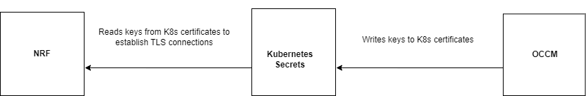

4.7 Support for Automated Certificate Lifecycle Management
In NRF 23.3.x and earlier, X.509 and Transport Layer Security (TLS) certificates were managed manually. When multiple instances of NRF were deployed in a 5G network, certificate management, such as certificate creation, renewal, removal, and so on, became tedious and error-prone.
Starting with NRF 23.4.x, you can integrate NRF with Oracle Communications Cloud Native Core, Certificate Management (OCCM) to support automation of certificate lifecycle management. OCCM manages TLS certificates stored in Kubernetes secrets by integrating with Certificate Authority (CA) using the Certificate Management Protocol Version 2 (CMPv2) protocol in the Kubernetes secret. OCCM obtains and signs TLS certificates within the NRF namespace. For more information about OCCM, see Oracle Communications Cloud Native Core, Certificate Management User Guide.
Figure 4-8 Support for OCCM
Support for OCCM
The above diagram indicates that OCCM writes the keys to the certificates and NRF reads these keys to establish a TLS connection with other NFs.
OCCM can automatically manage the following TLS certificates:
  • 5G Service Based Architecture (SBA) client TLS certificates
  • 5G SBA server TLS certificates
  • Message Feed TLS certificates
This feature enables NRF to monitor, create, recreate, and renew TLS certificates using OCCM, based on their validity. For information about enabling HTTPS, see "Configuring Secrets for Enabling HTTPS" in Oracle Communications Cloud Native Core, Network Repository Function Installation, Upgrade, and Fault Recovery Guide.
Install Guide Considerations
  • Upgrade: When NRF is deployed with OCCM, follow the specific upgrade procedure. For information about the upgrade strategy, see "Upgrade Strategy" in Oracle Communications Cloud Native Core, Network Repository Function Installation, Upgrade, and Fault Recovery Guide.
  • Rollback: For more information on migrating the secrets from NRF to OCCM and removal of Kubernetes secrets from the yaml file, see "Postupgrade Task" in Oracle Communications Cloud Native Core, Network Repository Function Installation, Upgrade, and Fault Recovery Guide.
Configure
There are no additional configuration changes required at NRF.

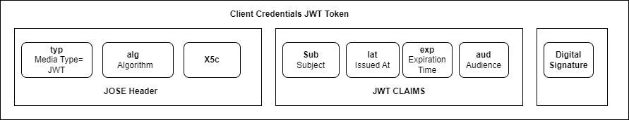

Client Credentials assertion (CCA) is a token signed by the Consumer NF. It enables NRF to authenticate the Consumer NF which includes the signed token in Access Token service request. CCA header contains the Consumer NF's NfInstanceId that gets checked against the certificate by the NRF. The CCA also includes a timestamp as the basis for the restriction of its lifetime.
Consumer NF sends the 3gpp-Sbi-Client-Credentials header containing the CCA in the HTTP request and NRF performs the CCA validation. The CCA header validation is a JWT-based validation at NRF where the Consumer NF sends a JWT token as part of the header to NRF in Access Token request. The JWT token has an X5c certificate and other NF-specific information that is validated against the configuration values defined in NRF. The signature of the JWT token is validated against the CA root certificate configured at NRF.
Figure 4-12 Client Credentials JWT Token
Table 4-12 JOSE header
Attribute name Data type P Cardinality Description
typ String M 1 The "typ" (type) Header Parameter is used to declare the media type of the JWS. Default value: JWT
alg String M 1 The "alg" (algorithm) Header Parameter is used to secure the JWS. Supported Algorithm types: RSA/ECDSA.
X5c Array M 1 The "X5c" (X.509 certificate) Header Parameter contains the X.509 public key certificate corresponding to the key used to digitally sign the JWT.
Table 4-13 JWT claims
sub NfInstanceId M 1 This IE contains the NF instance ID of the NF service consumer, corresponding to the standard "Subject" claim.
iat integer M 1 This IE indicates the time at which the JWT was issued, corresponding to the standard "Issued At" claim. This claim may be used to determine the age of the JWT.
exp integer M 1 This IE contains the expiration time after which the client credentials assertion is considered to be expired, corresponding to the standard "Expiration Time" claim.
aud array(NFType) M 1..N This IE contains the NF type of NRF, for which the claim is applicable, corresponding to the standard "Audience" claim.
The digitally signed client credentials assertion is further converted to the JWS compact serialization encoding as a string.

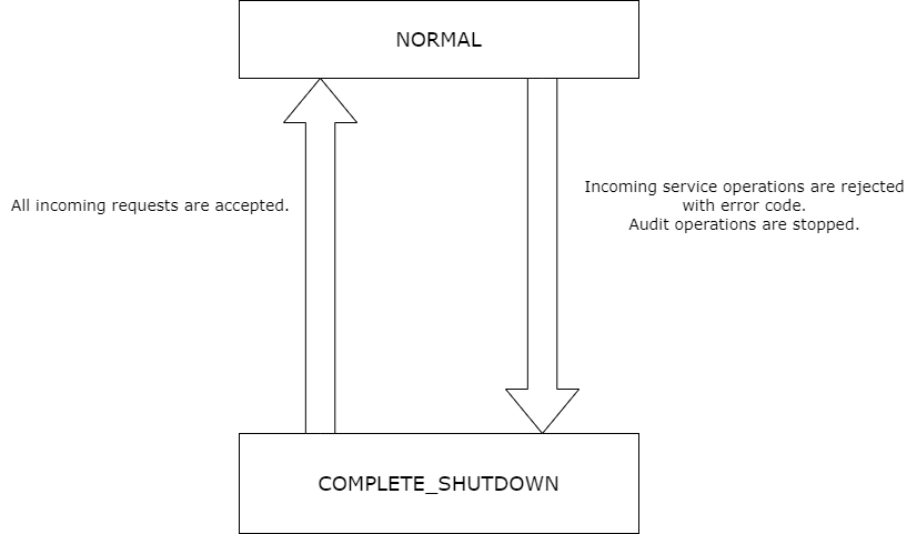

NRF supports controlled shutdown feature to isolate NRF from the current network at a particular site. This isolation helps to perform any maintenance activities or recovery procedures as required without uninstalling the NRF at the particular site. During this time the operations of the Ingress Gateway, Egress Gateway, and NrfAuditor microservices are paused. These services read the operational state from the database periodically. The operational state of NRF can be changed by using REST API or CNC Console at any time.
The two operational states defined for NRF are as follows:
  • NORMAL
  • COMPLETE_SHUTDOWN
  • Ensure that the database is up and the NRF services must be able to connect and communicate with the database to change the operational state.
  • In either state, if the database goes down, the back-end pods go to the NOT_READY state, but the Ingress Gateway microservice will continue to be in the last known operational state. When the Controlled Shutdown feature is enabled and the database is not available, all the incoming messages will be rejected with the Service Unavailable messages if the operational state is "NORMAL", or with a configurable error code if the operational state is COMPLETE_SHUTDOWN". However, the operators will not be able to see the operational state in CNC Console due to database unavailability.
If the controlled shutdown operational state is NORMAL, then NRF processes the message as normal.
If the controlled shutdown operational state is COMPLETE_SHUTDOWN, then NRF rejects all incoming requests with a configurable error code.
Figure 4-14 Operational State changes
The following behavior changes occur when the operational state changes:
From NORMAL to COMPLETE_SHUTDOWN
  • The Ingress Gateway microservice rejects all new requests towards the services that have been configured for controlled shutdown with a configurable error code. In this case, all the inflight transactions will be gracefully handled. The controlled shutdown applies to the following services:
    • nfregistration
    • nfdiscovery
    • nfsubscription
    • nfaccesstoken
    The error codes are configured using controlledshutdownerrormapping and errorcodeprofiles APIs.
  • The NrfAuditor microservice pauses all its audit procedures, hence no notifications are generated. OcnrfAuditOperationsPaused alert is raised to indicate that the audit is paused.
  • The Egress Gateway microservice handles all the inflight requests gracefully. Since the Ingress Gateway and NrfAuditor microservices are in a COMPLETE_SHUTDOWN operational state, there would be no requests from the backend services.
    No specific configuration for controlled shutdown needs to be applied on the routes for the Egress Gateway microservice.
  • The NrfConfiguration microservice continues to process any configuration requests in the COMPLETE_SHUTDOWN state.
  • OcnrfOperationalStateCompleteShutdown alert is raised to indicate the operational state of NRF is COMPLETE_SHUTDOWN.
  • The operational state change is recorded and can be viewed using the controlledShutdownOptions REST API. Additionally, the history of operational state changes can be viewed using the operationalStateHistory REST API.
From COMPLETE_SHUTDOWN to NORMAL
  • The Ingress Gateway microservice resumes processing all incoming requests.
  • The Egress Gateway microservice resumes processing all outgoing requests.
  • The NrfAuditor pod waits for a preconfigured waiting period before resuming its audit procedures to allow the NFs to move back to this NRF after the NRF has changed to the NORMAL operational state. Once the waiting period has expired, the audit procedures resume, and the OcnrfAuditOperationsPaused alert is cleared. The waiting period is defined as
    (defaultHbTimer * nfHeartBeatMissAllowed) + maxReplicationLatency(s) + replicationLatencyThreshold * latencyMultiplier
    Where,
    • defaultHbTimer - defaultHbTimer configured in nfManagementOptions.nfHeartBeatTimers where the nfType is "ALL_NF_TYPE". For more information about the parameter, see "NF Management Options" in Oracle Communications Cloud Native Core, Network Repository Function REST Specification Guide.
    • nfHeartBeatMissAllowed - nfHeartBeatMissAllowed configured in nfManagementOptions.nfHeartBeatTimers where the nfType is "ALL_NF_TYPE". For more information about the parameter, see "NF Management Options" in Oracle Communications Cloud Native Core, Network Repository Function REST Specification Guide.
    • maxReplicationLatency - The maximum replication latency detected across all the sites. This parameter supports dynamic value.
    • replicationLatencyThreshold - The replicationLatencyThreshold configured in geoRedundancyOptions. For more information about the parameter, see "Georedundancy Options" in Oracle Communications Cloud Native Core, Network Repository Function REST Specification Guide.
    • latencyMultiplier - A preconfigured fixed offset value set as 3.
  • OcnrfOperationalStateCompleteShutdown alert is cleared to indicate that the operational state of NRF is NORMAL.
NRF Behavior Post Fault Recovery
During the database restore procedure, along with the configuration data, the NFProfile data/subscription data also gets restored which may not always be the latest state data at that moment. In this state, the NrfAuditor microservice may act upon the NFProfiles/NFsubscriptions which are not up-to-date yet. Also, the NFs is in process of moving to the current NRF which is available now. In this state, if the audit procedure is performed, NRF suspends those NFs and send out notifications to the consumer NFs. The same is applicable for NfSubscriptions, where the subscriptions may get deleted due to an older lastUpdatedTimestamp in the backup data.
To avoid this problem, NrfAuditor microservice waits for a waiting period before resuming the auditing of NFProfiles and subscriptions as soon as it comes to Ready state from NotReady state. An alert ("OcnrfAuditOperationsPaused") is raised to indicate that the audit processes have paused, see NRF Alerts section. Once the waiting period is elapsed, the audit processes resume and the alert is cleared.
To know about the computation of the waiting period, see Controlled Shutdown of NRF .
