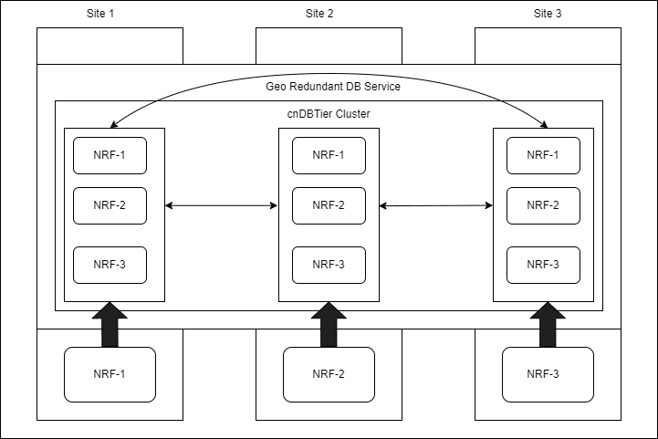

Figure 7-1 NRF Database Model
The above image shows the database model of a three site geo replicated NRF and represents how each NRF instance is using it's dedicated database. The data is getting replicated to all other sites of the cnDBTier cluster so that the data is available on all the cnDBTier cluster sites in case of a cnDBTier instance failure. The cnDBTier instance of each site has the data of its own site and the replicated data of the other two sites. All the three cnDBTier instances are replicated with each other.
To recover cnDBTier through automated backup file or on-demand backup from mate site, see the restore procedure in Oracle Communications Cloud Native Core, cnDBTier Installation, Upgrade, and Fault Recovery Guide.7.3 Impacted Area
