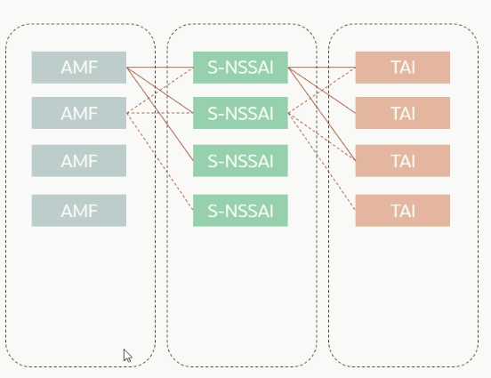

4.4 Enhanced Computation of AllowedNSSAI in NSSF
As per 3GPP specification, NSSF utilizes AMF (Access and Mobility Management Function) to manage the slice selection criteria. Here, if a newly configured NSSAI is not supported by the Radio Access Network (RAN), the AMF designates it as the Rejected-NSSAI. To allow the newly configured NSSAI, UE needs to request for a re-registration. It allows the AMF to disregard a UE's Requested NSSAI and formulate the AllowedNSSAI based on subscription details and support from the RAN
The objective of this feature is to maintain a consistent approach to handling slice subscription changes between AMF and NSSF. Recognizing the need for adaptive and subscriber centric configurations of NSSAI, this feature allows NSSF to generate AllowedNSSAI based on individual user equipment (UE) subscriptions and Tracking Area characteristics.
When this feature is enabled, NSSF generates AllowedNSSAI based on User Equipment (UE) subscription details and the supported configuration within the Tracking Area. Conversely, when the feature is disabled, the NSSF adheres to the 3GPP specification 29.531, constructing AllowedNSSAI based on the intersection of Requested and Subscribed NSSAI and also operator policy.
NSSAI Configuration (When the feature is enabled):
  • Subscriber-Driven Configuration: The NSSF will dynamically build AllowedNSSAI based on the UE subscription information. This ensures that network slices are aligned with the specific requirements and preferences of individual subscribers.
  • Tracking Area Considerations: The NSSF takes into account the supported configuration within the Tracking Area, optimizing the network slice selection based on the geographical location and network capabilities in real time.
Static NSSAI Configuration (When the feature is disabled):
  • Compliance with 3GPP Specification 29.531: When the feature is disabled, the NSSF follows the guidelines outlined in the 3GPP specification 29.531. This involves creating AllowedNSSAI based on the intersection of Requested and Subscribed NSSAI, providing a standardized approach to network slice configuration.
  • Maintaining Compatibility: Disabling the dynamic NSSAI configuration ensures compatibility with industry standards and facilitates interoperability across different network elements and vendors.

4.17 Auto-Population of Configuration Based on NSAvailability Update
This feature simplifies the configuration of authorized S-NSSAIs per TAI in the NSSF by dynamically deriving them from the NssaiAvailabilityData received from the AMF
When the Feature is Enabled
  • No need to configure SupportedSNSSAIs per TAI manually.
  • Operators must configure:
    • ConfiguredSNSSAIs (allowed S-NSSAIs)
    • BarredSNSSAIs (optional) at the PLMN portfolio level.
NSSF considers an S-NSSAI authorized in a TAI if:
  • It is present in the NssaiAvailabilityData from AMF (i.e., AMF supports it in that TAI).
  • It is part of the ConfiguredSNSSAIs at the PLMN level.
  • It is not barred in that TAI or PLMN.
Additional Rule
  • NSSF treats all configured S-NSSAIs as applicable to all TAIs unless explicitly restricted.
Operational Benefit
  • No per-TAI support configuration is required, which simplifies setup and reduces operational errors.
When the Feature is Disabled
  • Operators must manually configure:
    • ConfiguredSNSSAIs at PLMN level
    • SupportedSNSSAIs per TAI using the Supported in TAI managed object
    • Optional BarredSNSSAIs per TAI
NSSF considers an S-NSSAI authorized in a TAI only if:
  • It is present in the NssaiAvailabilityData from AMF for that TAI.
  • It is explicitly listed as a SupportedSNSSAI for that TAI in the configuration.
  • It is not barred.
Operational Overhead
  • Manual per-TAI mapping is required, which increases complexity and maintenance effort.
Walkthrough – Step-by-Step Flow (Feature Enabled)
  1. Operator configures ConfiguredSNSSAIs at the PLMN level.
  2. AMF sends NssaiAvailabilityData for each TAI.
  3. NSSF matches the configured S-NSSAIs with the data received from AMF.
  4. Any S-NSSAI found in both the ConfiguredSNSSAIs and AMF data, and not barred, is authorized for the TAI. No TAI-level SupportedSNSSAIs configuration is needed.
Examples
Example 1 – Feature Enabled
  • ConfiguredSNSSAIs at PLMN: S1, S2
  • NssaiAvailabilityData from AMF:
    • TAI-1: S1
    • TAI-2: S2
Result:
  • TAI-1: Authorized S-NSSAIs = S1
  • TAI-2: Authorized S-NSSAIs = S2
  • No per-TAI support configuration is needed.
Walkthrough – Step-by-Step Flow (Feature Disabled)
  1. The operator configures ConfiguredSNSSAIs at the PLMN level.
  2. The AMF sends NssaiAvailabilityData for each TAI.
  3. The NSSF matches the configured S-NSSAIs with the data received from the AMF.

AMF Sends Availability Update
  • AMF sends NssaiAvailabilityData indicating the S-NSSAIs it supports in each TAI.

  • Configured at PLMN: S1, S2, S3, S4
  • Barred at PLMN: S4
  • Barred in TAI-1: S3
  • Supported in TAI-1: S1 (only if feature disabled)
  • AMF reports S1, S2, S3, S4 as supported in TAI-1

For Example:
Consider a case with PLMN 100,101, which constitutes of 1000000 TACs; (1,10,00,000).
If the AMF Supports 300000 TACs, for TAC (1 - 300000):
  • Supported SNSSAIs in TAC (1 -100000) are SNSSAI-1,SNSSAI-2,SNSSAI-3,
  • supported SNSSAIs in TAC (100001 - 200000) are SNSSAI-2,SNSSAI-3,SNSSAI-4, and
  • supported SNSSAIs in TAC (200001 - 300000) are SNSSAI-3, SNSSAI-4, SNSSAI-5.
Each AMF supports multiple TAIs and S-NSSAIs, as shown in the diagram below:
Figure 4-1 Association of AMF and TAI with S-NSSAI
The list of supported TAIs will be almost the same, but for different S-NSSAIs, NSSF requires huge storage space for the redundant data. This results in a substantial increase in the size of the notifications and hassles for managing such a huge configuration, as explained below:
Case 1: nssaiAvailabilityInfo without ONSSAI
Here, the list size of supportedNssaiAvailabilityData would be 300,000 with 3 unique and 299997 repeated SNSSAI list, here is a sample snippet:
