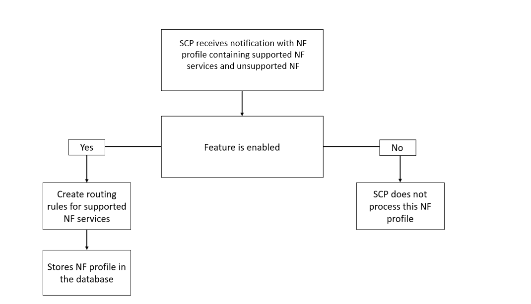

Figure 3-1 Call Flow of NFProfile Processing
  1. SCP receives a notification with an NF profile including 3GPP-defined supported NF services, custom, unknown, or unsupported NF services.
  2. If the feature is enabled, then SCP creates routing rules for the 3GPP-defined supported NF services and ignores the custom, unknown, or unsupported NF services present in the NF profile.
  3. SCP stores the NF profile in the database.
  4. If the feature is disabled, then SCP does not process that NF profile and no routing rules will be created for that NF profile.
    This call flow ensures that SCP appropriately handles notifications and routing rules procedures with supported NF services while disregarding unsupported services.

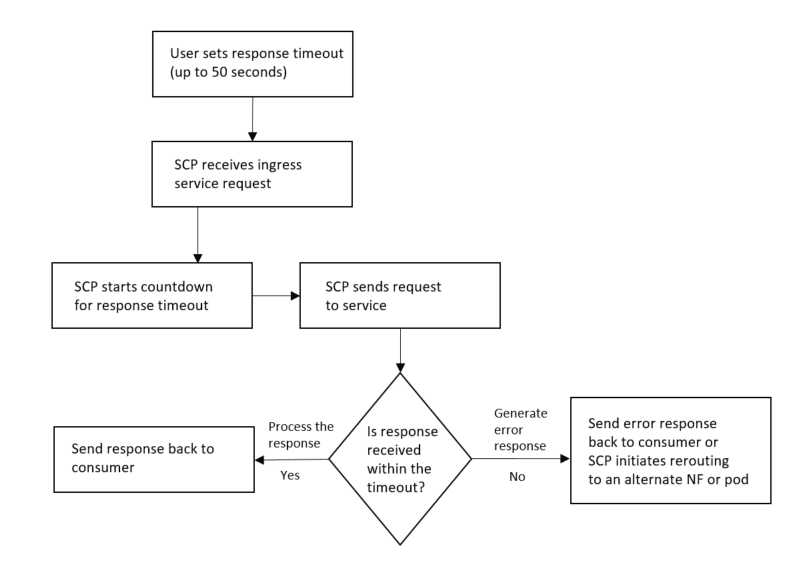

3.8 SCP Response Timeout Extension
Previously, users could configure a response timeout interval of up to 15 seconds for receiving a response from SCP.
The SCP Response Timeout Extension feature enhances the SCP's capability to manage network requests more effectively, ensuring consistent service even when Producer NFs require additional processing time.
The enhanced feature allows users to extend the maximum response timeout to 50 seconds. This improvement provides configuration options to handle response timeouts for NFs that require more time to serve a request.
The SCP allows users to configure a maximum timeout of up to 50 seconds for receiving responses from the Producer NF. If the response is not received within this timeframe, the SCP will automatically initiate rerouting to an available alternate NF or pod.
The SCP monitors the total forwarded request rate, specifically targeting requests with response times exceeding 50 seconds. The SCP supports up to 200 messages per second (MPS) for all NF Service-Based Interface (SBI) traffic through the Namf interface. An alert is raised when the traffic exceeds 200 MPS and the response delay from the Producer NF takes more than 50 seconds.
Call Flow
The following call flow diagram illustrates the scenario:
Figure 3-2 Call Flow for SCP Response Timeout Extension
  1. The user sets the response timeout with a maximum limit of up to 50 seconds for a service.
  2. SCP receives the ingress service request for the same service and starts the countdown for the response timeout before sending the request out.
  3. SCP checks if the response is received within the timeout period:
    1. If the response is received within the timeout, SCP will process the response and send it back to the Consumer NF.
    2. If not, SCP will generate its own error response and send it back to the Consumer NF.
  4. If SCP receives more than 200 responses with a response time of 50 seconds or greater from the Producer NF, SCP will generate an alert.

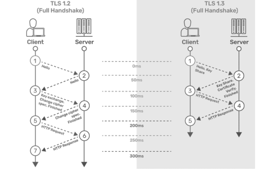

3.11.1 TLS Certificate Configuration Enhancement
SCP uses Hypertext Transfer Protocol Secure (HTTPS) to establish secured ingress and egress connections with consumer NFs and producer NFs, respectively. These communication protocols are encrypted using Transport Layer Security (TLS).
In SCP 23.2.0, SCP used to support a single TLS certificate configuration to enable HTTPS.
From 23.3.0, this enhancement enables SCP to configure different Transport Layer Security (TLS) certificates on ingress and egress interfaces. It also allows users to provide primary and secondary certificates for each interface.
Multiple TLS certificates can be configured across the following communication interfaces:
  • Egress connections on 5G Service Based Architecture (SBA): SCP acts as a client while sending message requests to producer NFs, producer SCP-P, or NRF. For example:
    • A consumer SCP-C sends health check request to a producer SCP-P.
    • SCP forwards notifications to consumer NFs.
    • SCP forwards Service, Discovery, or Access Token requests to NRF or producer NFs.
  • Ingress connections on 5G SBA: SCP acts as a server to process message requests received from consumer NFs, SCP-C, or NRF. For example:
    • SCP-P receives health check request from SCP-C.
    • SCP receives notifications from NRF or NF producer.
    • SCP receives service or health check requests from consumer NFs.
  • Oracle Communications Network Analytics Data Director (OCNADD) connection on message feed: SCP acts as a client toward OCNADD on message feed interfaces, for example, SCP sends message feed data to OCNADD.

TLS 1.2 and TLS 1.3 Handshake
This section describes the differences between TLS 1.3 and TLS 1.2, as well as the advantages of TLS 1.3 over TLS 1.2 and earlier versions.
Figure 3-3 TLS 1.2 and TLS 1.3 Handshake
TLS 1.2
Step 1: The connection or handshake starts when the client sends a "client hello" message to the server. This message consists of cryptographic information such as supported protocols and cipher suites. It also contains a random value or random byte string.
Step 2: To respond to the "client hello" message, the server sends a 'server hello' message. This message contains the CipherSuite that the server has selected from the options provided by the client. The server also sends its certificate, along with the session ID and another random value.
Step 3: The client verifies the certificate sent by the server. When the verification is complete, it sends a byte string encrypted using the public key of the server's certificate.
Step 4: When the server receives the secret, both the client and server generate a master key along with session keys (ephemeral keys). These session keys are used for symmetrically encrypting the data.
Step 5: The client sends an "HTTP Request" message to the server to enable the server to transition to symmetric encryption using the session keys.
Step 6: To respond to the client’s "HTTP Request" message, the server does the same and switches its security state to symmetric encryption. The server concludes the handshake by sending an HTTP response.
Step 7: The client-server handshake is completed in two round trips.
TLS 1.3
Step 1: The connection or handshake begins when the client sends a "client hello" message to the server, which includes the list of supported cipher suites and the client's key share for the specific key agreement protocol.
Step 2: To respond to the "client hello" message, the server sends the key agreement protocol that it has chosen. The "Server Hello" message includes the server key share, server certificate, and the "Server Finished" message.
Step 3: The client verifies the server certificate, generates keys since it has the server's key share, and then sends the "Client Finished" message along with an HTTP request.
Step 4: The server completes the handshake by sending an HTTP response.
Comparison Between TLS 1.3 and TLS 1.2
The following table provides the comparison of TLS 1.3 and TLS 1.2:
Table 3-7 Comparison of TLS 1.3 and TLS 1.2
Feature TLS 1.3 TLS 1.2
TLS Handshake
  • The initial handshake involves the exchange of key shares, ensuring cryptographic security.
  • A typical handshake in TLS 1.3 involves the exchange of up to 3 packets, thereby facilitating quicker and more responsive connections.
  • The initial handshake occurs in clear text.
  • A typical handshake in TLS 1.2 involves a more extended process, typically requiring 5-7 packets for completion, resulting in slower connection establishment times.
Cipher Suites and Privacy
  • Improving security by narrowing the selection of cipher suites, which streamlines configuration and reduces errors. Supported algorithms are free from known vulnerabilities, thus making the cipher suites more secure.
    • TLS_AES_128_GCM_SHA256
    • TLS_AES_256_GCM_SHA384
    • TLS_CHACHA20_POLY1305_SHA256
  • Supporting a wide range of cipher suites that are vulnerable to attacks results in less secure cipher suites.
    • TLS_ECDHE_ECDSA_WITH_AES_256_GCM_SHA384
    • TLS_ECDHE_RSA_WITH_AES_256_GCM_SHA384
    • TLS_ECDHE_RSA_WITH_CHACHA20_POLY1305_SHA256
    • TLS_ECDHE_ECDSA_WITH_AES_128_GCM_SHA256
    • TLS_ECDHE_RSA_WITH_AES_128_GCM_SHA256
    • TLS_ECDHE_ECDSA_WITH_CHACHA20_POLY1305_SHA256
Round-Trip Time Efficient session resumption modes, such as Zero Round Trip Time (0-RTT), enable clients to resume sessions without additional round trips.
Data can be transmitted in the initial message using Pre-Shared Keys (PSK), further enhancing the efficiency of the communication process.
TLS 1.2 does not support a 0-RTT mode for resuming sessions with reduced round-trip time.
Perfect Forward Secrecy (PFS) TLS 1.3 supports Provide Forward Secrecy (PFS). PFS ensures that each session key is entirely independent of long-term private keys, which are used over an extended period for decrypting encrypted data. TLS 1.2 does not provide PFS.
Performance The handshake process is optimized to reduce latency by minimizing the number of required round trips, resulting in a more responsive connection. The handshake process involves multiple round trips between the client and server, may result in increased latency and a less responsive connection.
TLS 1.3 handshake offers the following improvements over earlier versions:
  • The symmetric encryption algorithms are removed and Authenticated Encryption with Associated Data (AEAD) algorithms are supported.
  • In TLS 1.3, all handshake messages after the ServerHello are encrypted.
  • A zero round-trip time (0-RTT) mode is added in the handshake process, enabling fewer round trips compared to TLS 1.2. Additionally, it utilizes cryptographic algorithms that are faster.
  • Static Rivest-Shamir-Adleman (RSA) and Diffie-Hellman cipher suites are removed, ensuring that all public-key-based key exchange mechanisms now Provide Forward Secrecy (PFS).
  • TLS 1.3 has better security than TLS 1.2, addressing known vulnerabilities in the handshake process.
  • TLS 1.3 eliminates data compression.
  • Version Downgrade Protection in TLS 1.3 is a security mechanism that prevents attackers from using an older, potentially less secure version of the TLS protocol. This protection is achieved through the exchange of a "Finished" message between the client and server, which includes a Message Authentication Code (MAC) covering all preceding handshake messages. This mutual verification process ensures that negotiated parameters remain unaltered by potential attackers. This helps ensure that connections are established using the latest, most secure version of TLS available, reducing the risk of vulnerabilities associated with older protocol versions.

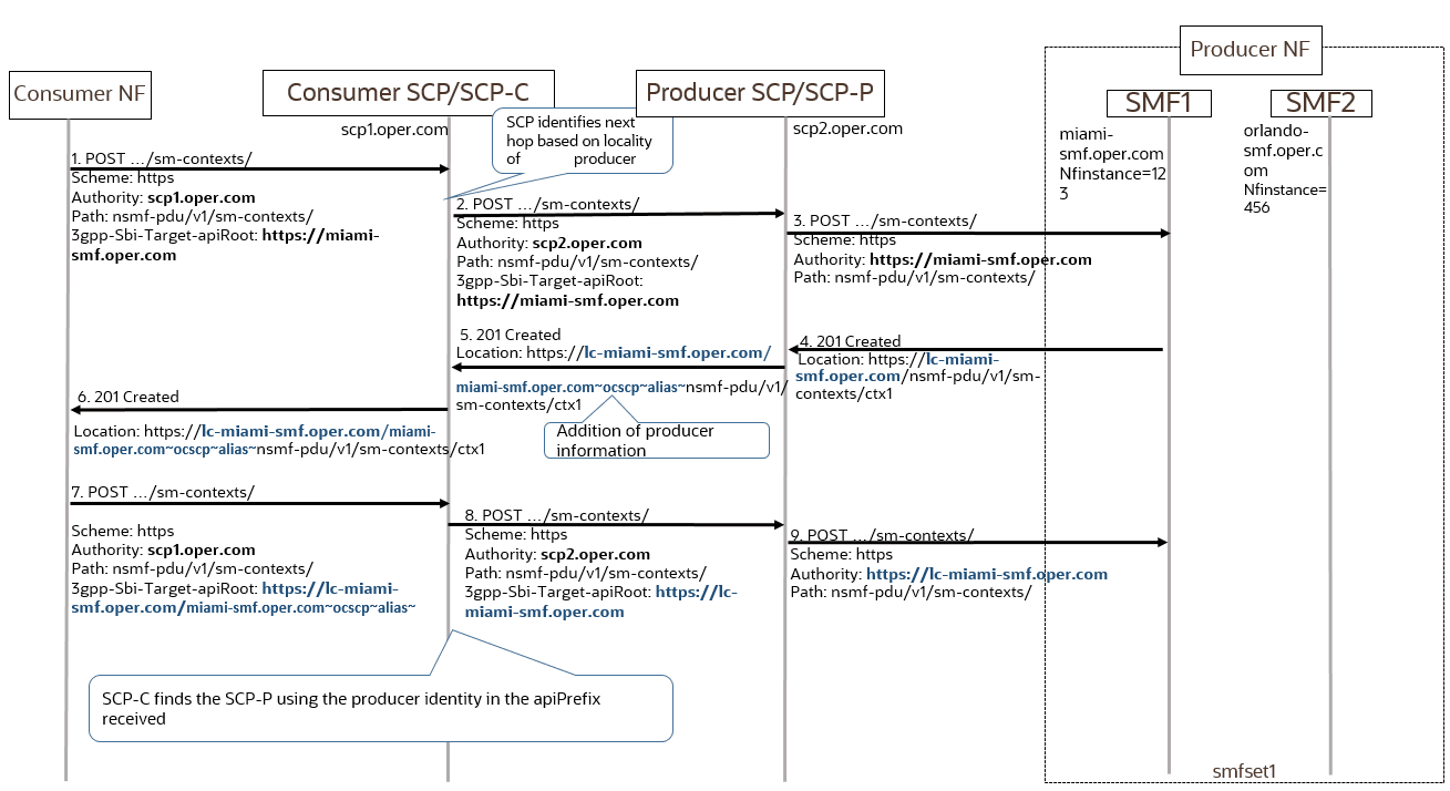

3.15 Location Header for Host Mismatch
According to 3GPP, a consumer NF is expected to use the received "Location" header content while sending subsequent message requests. After receiving a subsequent request, consumer SCP extracts the producer NF details from the API prefix in the "3gpp-Sbi-Target-Apiroot" header and selects an appropriate inter-SCP path to route the request.
SCP matches the authority (FQDN or IP) in "Location" header of the "201 Created" response with the producer's authority (FQDN or IP) where the message request was sent. If the FQDN or IP in the response is different, producer SCP provides the producer's NF details as an API prefix in the "Location" header of the "201 Created" response. If the FQDN or IP is the same, the "Location" header does not perform any modification.
This feature has been introduced to correct inter-SCP routing in the above scenario.
Figure 3-4 Initial and Subsequent Request Routing Supported at SCP
Managing Location Header for Host Mismatch

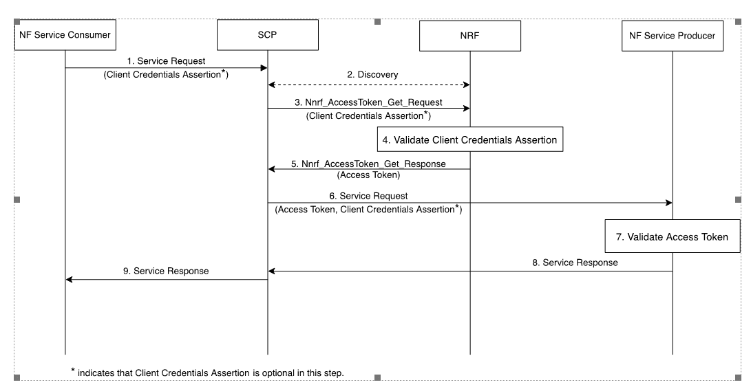

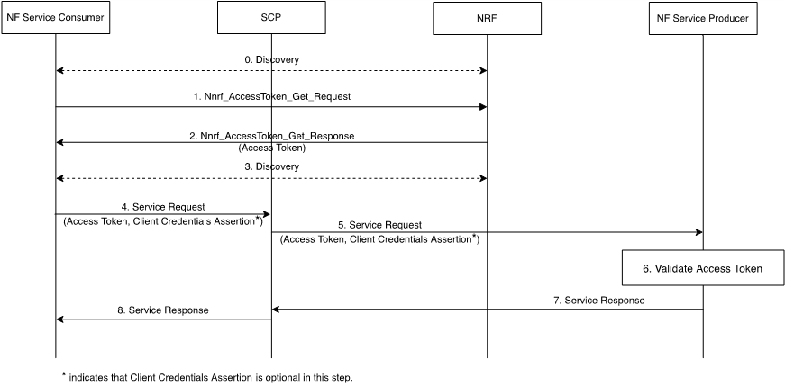

3.16 Support for the Client Credentials Assertion Header
The 3GPP introduced Client Credentials Assertion (CCA) enables the NRF or the producer NF to authenticate the consumer NF when using indirect communication through SCP. The CCAs are JSON web tokens and are secured with digital signatures based on JSON Web Signature (JWS). The consumer NF adds the 3gpp-Sbi-Client-Credentials header containing the CCA. The CCA contains the following:
  • The NF instance ID of the consumer NF (subject)
  • A timestamp (iat) and an expiration time (exp)
  • The NF type of the expected audience, such as the NRF type or the NF type of the producer NF
The consumer NF digitally signs the generated CCA based on its private key. The signed CCA contains one of the following fields:
  • The X.509 URL (x5u) to refer to a resource for the X.509 public key certificate or certificate chain used for signing the client authentication assertion
  • The X.509 Certificate Chain (x5c) includes the X.509 public key certificate or certificate chain used for signing the client authentication assertion
Table 3-9 CCA Contents
Claim Description
audience (aud) NF type of the producer NF whose services are requested and/or NRF
expiration time (exp) Timestamp of CCA expirarion
subject (sub) NF instance ID of consumer NF
timestamp (iat) Timestamp of CCA generation
Security details used for signing CCA
  • x5u - X.509 URL that refers to a resource for the X.509 public key certificate or certificate chain
  • x5c - X.509 Certificate Chain includes the X.509 public key certificate or certificate chain
The NRF, or producer NF, performs the CCA verification. It verifies that the public key certificate used to sign the CCA contains the same NF instance ID as the consumer's NF instance ID in the CCA. If the verification of the CCA fails at the receiving entity, a "403" response is returned with the cause attribute set to CCA_VERIFICATION_FAILURE.
If some rouge consumer NF acquires a valid CCA from some other consumer NF and uses it as its own CCA, then the CCA validation by the NRF or producer NF creates a security gap. Therefore, additional CCA validations on SCP are needed to mitigate this security impact. The NF instance ID of the NFs in the CCA must match the NF instance ID in the certificate used in the TLS connection by the consumer NF as part of the SCP validations.

3.20 Support for OAuth2.0
Access tokens are credentials used by consumer NFs to access protected resources provided by producer NFs. These credentials are issued by NRF. These tokens represent specific scope and duration of access. SCP supports OAuth2.0 (Open Authorization) access tokens in 5G indirect communication models such as Model C and Model D.
In the 5G SBI Model D indirect communication (with delegated discovery) mode, SCP obtains access tokens from NRF for 5G SBI message requests except notification or callback messages. SCP uses the acquired access tokens to forward SBI message requests to the selected producer NFs.
The following call flow represents how SCP obtains access tokens from NRF:
Figure 3-5 SCP Obtains Access Tokens from NRF
The above mentioned call flow describes the process to use the Discovery parameter to send a request to NRF for obtaining the access token:
  1. NF Service Consumer sends a service request to SCP.
  2. If SCP does not get an access token in the service request, it uses the Discovery parameter to send the access token request to NRF.
  3. SCP sends Nnrf_AccessToken_Get_Request to NRF.
  4. NRF validates the access token request using Client Credential Assertion (CCA).
  5. NRF sends Nnrf_AccessToken_Get_Response to SCP.
  6. SCP forwards the service request, along with CCA and access token, to NF Service Producer.
  7. NF Service Producer validates the access token.
  8. NF Service Producer sends the service response to SCP.
  9. SCP relays the service response to NF Service Consumer.
In the 5G SBI Model C indirect communication (without delegated discovery) mode, consumer NFs obtain access tokens from NRF except notification or callback messages. SCP uses the access tokens received from consumer NFs and forward SBI message requests to the selected producer NFs.
The following call flow represents how NF Service Consumer obtains access tokens from NRF:
Figure 3-6 NF Consumer Obtains Access Tokens from NRF
The above mentioned call flow describes the process that NF Service Consumer uses to obtain access token from NRF and how SCP uses this access token to forward the service request.
  1. When there is no mutual authentication between NF Service Consumer and NRF, NF Service Consumer sends Nnrf_AccessToken_Get_Request to NRF.
  2. NRF sends Nnrf_AccessToken_Get_Response to NF Service Consumer.
  3. NF Service Consumer sends Discovery service requests to NRF.
  4. After receiving the discovery response with NF profiles, NF Service Consumer sends the service request to SCP.
  5. SCP uses the access token received from NF Service Consumer and forwards the service request, along with CCA and access token, to NF Service Producer.
  6. NF Service Producer validates the access token.
  7. NF Service Producer sends the service response to SCP.
  8. SCP relays the service response to NF Service Consumer.

3.26.1 5G SBI Notification Requests processing
The ApiPrefix usage in notification messages at SCP are as follows:
Table 3-17 5G SBI Notification Requests Processing
Notification Message Received at SCP Forwarded Notification Message to NextHop SCP (SCP-P) Forwarded Notification Message to Target NF Description
3gpp-sbi-target-apiRoot Header :authority header :path header 3gpp-sbi-target-apiRoot Header :authority header :path header Routing Attempt :authority header :path header
scheme://NF-C1.com:port/NF-C1ApiPrefix scp.com:port scpApiPrefix/notificationUri scheme://NF-C1.com:port/NF-C1ApiPrefix nextHopScp.com:port {nextHopscpApiPrefix}/notificationUri
  • If next hop SCP has published ApiPrefix in SCP Profile.
Primary routing
NF-C1ApiPrefix/notificationUri
While registering with NRF, the notification handling service published apiPrefix in NFProfile.
Alternate routing
scheme://NF-C2.com:port
{NF-C2ApiPrefix}/notificationUri
NF-C2ApiPrefix is used as per deployment and the apiPrefix value in the NFProfile for the service.
scheme://NF-C1.com:port/ scp.com:port scpApiPrefix/notificationUri scheme://NF-C1.com:port/ nextHopScp.com:port {nextHopscpApiPrefix}/notificationUri
Primary routing
/notificationUri NF-C2ApiPrefix is used as per deployment and the apiPrefix value in the NFProfile for the service.
Alternate routing
{NF-C2ApiPrefix}/notificationUri NF-C2ApiPrefix is used as per deployment and the apiPrefix value in the NFProfile for the service.
scheme://NF-C1.com:port/NF-C1ApiPrefix scp.com:port /notificationUri scheme://NF-C1.com:port/ nextHopScp.com:port {nextHopscpApiPrefix}/notificationUri
Primary routing
NF-C1ApiPrefix/notificationUri SCP is deployed without apiPrefix in SCP profile.
Alternate routing
scheme://NF-C1.com:port/ scp.com:port /notificationUri scheme://NF-C1.com:port/ nextHopScp.com:port {nextHopscpApiPrefix}/notificationUri
Primary routing
/notificationUri
SCP and the notification handling service are deployed without an apiPrefix in the NFProfile.
Alternate routing
Delegated Discovery notification request scp.com:port {scpApiPrefix}/
scp-default-sub-notify-uri
  • Selected target notification URI
Primary routing scheme://NF-C1.com:port {NF-C1ApiPrefix}/notificationUri Notification URI is used according to the published NFProfile based on discovery responses.
Alternate routing scheme://NF-C2.com:port {NF-C2ApiPrefix}/notificationUri Notification URI is used according to the published NFProfile based on discovery responses.
Delegated Discovery notification request scp.com:port /scp-default-sub-notify-uri scheme://NF-C1.com:port/
3.26.2 5G SBI Service Requests Processing
The ApiPrefix usage in service request messages at SCP are as follows:
Table 3-18 5G SBI Service Requests Processing
5G SBI request message received at SCP SBI Service Request to NextHop SCP Forwarded SBI Service Request Message to Target NF Description
scheme://NF-P1.com:port/NF-P1ApiPrefix scp.com:port scpApiPrefix/<apiName>/<apiVersion>apiSpecificResourceURI scheme://NF-P1.com:port/NF-P1ApiPrefix nextHopScp.com:port {nextHopscpApiPrefix}/<apiName>/<apiVersion>/apiSpecificResourceURI
Primary routing
NF-P1ApiPrefix/<apiName>/<apiVersion>/apiSpecificResourceURI
While registering with NRF, the NF service published apiPrefix in NFProfile.
Alternate routing
scheme://NF-P2.com:port
{NF-P2ApiPrefix}/<apiName>/<apiVersion>/apiSpecificResourceURI
NF-P2ApiPrefix is used according to deployment and the apiPrefix value in the NFProfile for the service.
scheme://NF-P1.com:port/ scp.com:port scpApiPrefix/<apiName>/<apiVersion>/apiSpecificResourceURI scheme://NF-P1.com:port/ nextHopScp.com:port {nextHopscpApiPrefix}/<apiName>/<apiVersion>/apiSpecificResourceURI
Primary routing
/<apiName>/<apiVersion>/apiSpecificResourceURI NF service is not supporting apiPrefix and not published in NF Profile.
Alternate routing
{NF-P2ApiPrefix}/<apiName>/<apiVersion>/apiSpecificResourceURI NF-P2ApiPrefix is used according to deployment and the apiPrefix value in the NFProfile for the service.
scheme://NF-P1.com:port/NF-P1ApiPrefix scp.com:port /<apiName>/<apiVersion>/apiSpecificResourceURI scheme://NF-P1.com:port/ nextHopScp.com:port {nextHopscpApiPrefix}/<apiName>/<apiVersion>/apiSpecificResourceURI
Primary routing
NF-P1ApiPrefix/<apiName>/<apiVersion>/apiSpecificResourceURI SCP is deployed without apiPrefix in SCP profile.
Alternate routing
scheme://NF-P1.com:port/ scp.com:port /<apiName>/<apiVersion>/apiSpecificResourceURI scheme://NF-P1.com:port/ nextHopScp.com:port {nextHopscpApiPrefix}/<apiName>/<apiVersion>/apiSpecificResourceURI
Primary routing
SCP and NF service are deployed without an api prefix in the NFProfile.
Alternate routing
Delegated Discovery 5G SBI request (Not Present) scp.com:port {scpApiPrefix}//<apiName>/<apiVersion>/apiSpecificResourceURI scheme://NF-P1.com:port/
Primary routing scheme://NF-P1.com:port {NF-P1ApiPrefix}/<apiName>/<apiVersion>/apiSpecificResourceURI apiRoot is created according to the published NFProfile based on discovery responses.
Alternate routing scheme://NF-P2.com:port {NF-P2ApiPrefix}/<apiName>/<apiVersion>/apiSpecificResourceURI apiRoot is created according to the published NFProfile based on discovery responses.
Delegated Discovery 5G SBI request (Not Present) scp.com:port /scp-default-sub-notify-uri scheme://NF-P1.com:port/

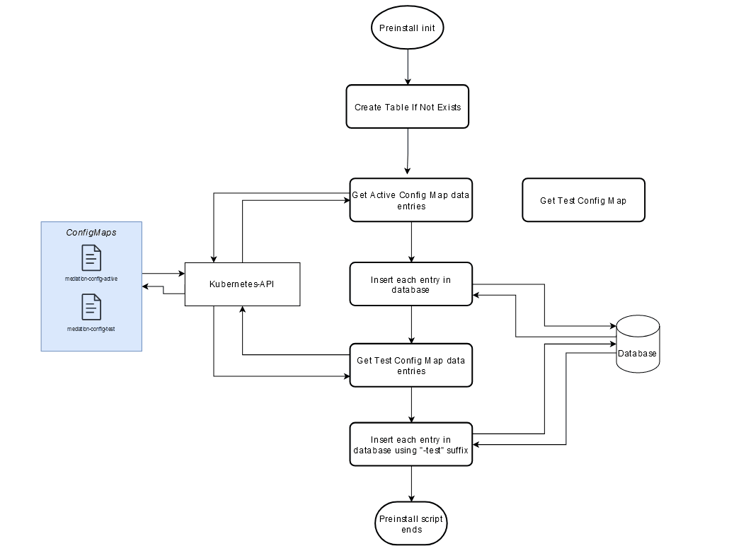

3.27.1 Mediation Rules Configuration
Mediation rules stored in the database can be retrieved, new rules can be added, and existing rules can be modified using the CCNC GUI and RESTful API. In addition, the storage capacity has improved.
Figure 3-7 Rule Status Flow
Rule Status Flow
The following table lists the state of rules and its description
Table 3-19 Types of State
State Description
Clone To create a new rule, the values of the rule already created and stored in the database are used. This newly created rule has a name followed by a term draft. A new name must be provided as a rule.
Compile This state precompiles, takes the rule source, and builds an executable rule base.
Draft This state moves a rule from APPLIED status to DRAFT status.
Apply This state moves a rule from DRAFT status to APPLY status.
Save This state saves the changes in database.

3.27.1.1 Mediation Rule Migration Process
Previously, rules were used from the Kubernetes config map. Currently, the rules present in the config map are migrated to the database table (mediation_rule table).
This section describes the procedure to execute the migration of rules from the existing config-map based implementation into the new REST API.
The following are the config-map related to mediation:
  • ocscp-nf-mediation-config-boot: It contains all the configuration related to the spring boot application and is used in both modes (test and active).
  • ocscp-nf-mediation-config-active: It contains rule entries and is only applicable to active mode.
  • ocscp-nf-mediation-config-test: It contains rule entries and is only applicable to test mode.
  • The following image illustrates the migration process:
    Figure 3-8 Migration to Database table
To successfully migrate to database table, all the rules in the Config map must be valid.
Generate Rule Entries
  1. Read ocscp-nf-mediation-config-active configuration map.
  2. For each entry in key-value map structure, create entry in Rule table with the following:
    1. Rule.name: entry.key removing .drl extension
    2. Rule.code: entry.value
    3. Rule.status: APPLIED
    4. Rule.mode: MEDIATION_ACTIVE
  3. Read ocscp-nf-mediation-config-test configuration map.
  4. Create entry in Rule table with the following:
    1. Rule.name: entry.key removing .drl extension adding "-test" as sufix to avoid name conflicts with active configmap
    4. Rule.mode: MEDIATION_TEST
Migration of Rule Entries

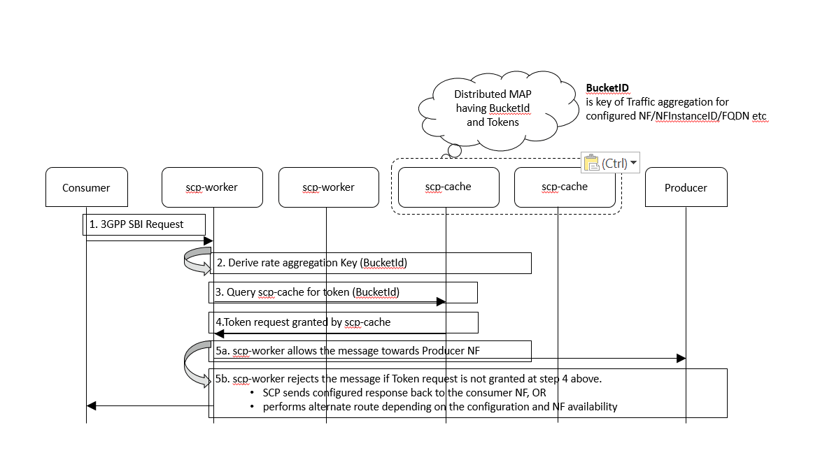

3.34.1 Local Rate Limit Feature
SCP uses the token bucket algorithm in the Rate Limit feature functionality to track the allowed and consumed tokens in a given time period as per rate limit configuration.
In the following ways SCP uses the distributed cache to aggregate the token consumption across scp-worker pods of an SCP instance:
  1. Over a 1 second time period, the rate limit framework divides the configured rate into smaller slots of 100milliseconds each.
  2. SCP monitors the difference between the actual request message rate received and the total request messages, i.e., allowed to send in the 100 milliseconds window as calculated.
  3. Each SCP worker pod also calculates its own share of the total request message sent and accordingly decides on a batch of tokens to be preconsumed.
  4. If at any time the scp-worker POD is not able to get a token, the request message is treated with rate limit treatment as per rate limit configuration.
  • The prediction of token batch count depends on the traffic rate detected in scp-worker PODs; hence, irregular traffic may lead to more token consumption by scp-workers. This may result in a difference between the overall message rate allowed and the configured rate.
  • The rate limit framework expects a uniform traffic pattern over a second period for a configured rate.
Figure 3-9 Local Rate Limit Feature Functional View

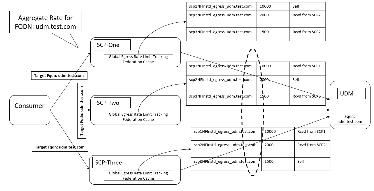

3.34.2 Global Rate Limit Feature
The global rate limit feature aggregates traffic rate data across multiple SCP instances and applies traffic rate control based on the configured aggregated rate.
The aggregated rate is configured at each SCP instance in the following way:
  1. Each SCP instance monitors its own traffic routed count against the configured NF, NFInstanceID, FQDN, and so on, and reports the same to all other SCP instances.
  2. Each SCP instance aggregates the total traffic routed against the configured NF, NFInstanceID, and FQDN from all SCP instances.
  3. Each SCP also calculates its own share of routed traffic in the aggregated total routed traffic count, as well as the status of the difference between total routed traffic and the configured aggregated rate.
  4. Global Rate Limit Control actions such as allowing or disallowing traffic are decided based on the data collected in the steps above.
Convergence of global rate data aggregation depends on network latency among the SCP instances, and higher latency can impact rate-limiting performance.
Global Rate Working Principle
The working principle are as follows:
  1. Each SCP instance has an aggregation cache, which syncs its own traffic route count with other SCP instances.
  2. In this aggregation cache, a routed traffic rate count is maintained for each SCP instance.
  3. Each SCP instance calculates the total traffic routed towards the configured NF, NFInstanceID, FQDN, and so on.
  4. For example, the diagram depicts the aggregated routed traffic count for a FQDN, "udm.test.com," across all 3 SCP instances.
    • Sample configuration 1: A global rate limit is configured in 3 SCP instances for FQDN "udm.test.com" with a rate of 15000 per sec.
    • Sample configuration 2: A global rate limit is configured in 3 SCP instances for FQDN "udm.test.com" with a rate of 13000 per sec.
  5. The global rate limit control action, such as allowing or disallowing the traffic, is decided based on the aggregated routed traffic count collected.
    • Action for configuration 1: Traffic is allowed since the total traffic routed rate is less than 15000 per sec.
    • Action for configuration 2: Traffic is throttled since the total traffic routed rate is greater than 13000 per sec.
Figure 3-10 Global Rate Limit Working Principle

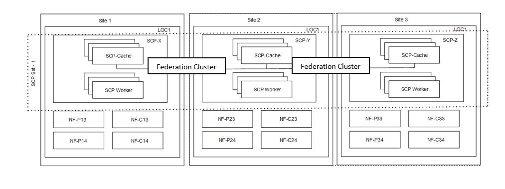

3.34.4.1 Global Egress Rate Limiting
The existing egress rate limiting functionality aggregates traffic rate for a target producer NF within one SCP instance across multiple pods of SCP-worker service. It does not aggregate the overall traffic rate towards the producer NF across multiple SCP instances. Therefore, the Global Rate Limiting feature is implemented so that a group of SCP instances coordinates among each other to ensure traffic rates for common destinations, that is, producer NFs, are aggregated and the egress rate limit is applied to the overall traffic rate.
The Global Egress Rate Limiting feature synchronizes and aggregates the egress rate data for multiple producer NFs among multiple SCP instances (up to three SCP instances). Based on the aggregated rate data, each SCP controls its traffic to ensure the global configured egress rate is achieved.
The SCP-cache microservice synchronizes egress rate data among multiple SCP instances. The participating SCP instances for the egress rate limiting aggregation details are configured using Helm as described in Oracle Communications Cloud Native Core, Service Communication Proxy Installation, Upgrade, and Fault Recovery Guide. SCP uses an Oracle product called Oracle Coherence which offers federated caching to link multiple clusters so that cache data is automatically synchronized between clusters.
Figure 3-11 Role of SCP-Cache
Role of SCP-Cache
By default, the egress rate aggregation is disabled. After enabling the Global Egress Limiting feature using the global_egress_ratelimit parameter on the CNC Console, the egress rate aggregation uses remoteScpOneEnabled and remoteScpTwoEnabled parameters to enable rate data synchronization and aggregation with the corresponding remote instances of SCP. If the rate aggregation and synchronization are disabled or the communication fails with a remote SCP instance, the Global Egress Rate Limiting feature does not consider that remote SCP as part of the Global Federation cluster. Therefore, Global Rate Limit Algorithm does not consider any message rate related updates from that remote SCP while applying the rate limit.

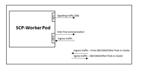

3.35 Support for Multus Container Network Interface
Multus Container Network Interface (CNI) is a plug-in that allows you to connect multiple network interfaces to pods in Kubernetes.
Each Kubernetes pod contains only one network interface. After integrating Multus CNI with SCP, you can create multiple interfaces in a pod and perform the following tasks:
  • Create multiple signaling interfaces for routing the signaling traffic
  • Create different interfaces for Operations, Administration, and Maintenance (OAM) and Signaling (SIG) traffic to enable traffic segregation
This feature configures the pods to use different network interfaces for different types of traffic. These interface IPs and routing information, such as range of IPs and gateways, are provided by Network Attachment Definition (NAD) Kubernetes custom resource. Multus CNI configures the IP routing rules based on this routing information.
For more information about Multus CNI, see https://github.com/k8snetworkplumbingwg/multus-cni.
Default Pod IPs assigned by Kubernetes are used for establishing pod-to-pod and egress communication. When Multus CNI adds other network interfaces to pods, these interface IPs can be used for egress communication.
Figure 3-12 Networking-Multus Support
The diagram shows how support for Multus helps SCP to support multiple interfaces on egress traffic from the scp-worker pod.
The Multus requirement is not applicable for SCP Control Pods.
The scp-worker pod is handling the following types of traffic:
  • 5G SBI traffic
  • Inter-pod communication traffic
  • OAM traffic is communication traffic between observability components and scp-worker
The directions of this traffic are to and fro via SCP, and hence they are present in ingress and egress directions. There is no segregated ingress traffic. Only egress traffic is separated over multiple interfaces by dedicating Virtual network interface controllers (vNICs) to manage each type of traffic:
  • Eth0 vNIC manages Egress (inter-pod communication traffic).
  • Eth1 vNIC manages Egress 5G SBI traffic.
It is not required to separate OAM traffic from signaling traffic.

3.36 Support for Model C Indirect 5G SBI Communication
5G Service Based Interface (SBI) communication models are used to establish connections among NFs and NF services. These communication models facilitate consumer NFs to route service requests to producer NFs either directly or indirectly through Service Communication Proxy (SCP). For more information about different communication models, such as Model A, Model B, Model C, and Model D, see 3GPP TS 23.501 version 16.6.0 Release 16.
With the introduction of the Model C Indirect 5G SBI Communication format in SCP, the consumer NF sends NF discovery service requests to NRF. After receiving the discovery response with NF profiles, the consumer NF does the following:
  • Selects an NF Set or a specific NF instance from the NF Set
  • Sends a service request to SCP with the address of the selected service producer NF
  • Creates multiple network interfaces for different subnet IPs
Where,
  • NF Set is a group of interchangeable NF instances of the same type that supports the same services and the same Network Slices. NF instances in the same NF Set may be geographically distributed but have access to the same context data.
  • NF instance is an instance of the NF that can be identified.
  • NF Set Identifier (NF Set ID) is a globally unique identifier of a set of equivalent and interchangeable CP NFs from a given network that provides distribution, redundancy, and scalability.
Then, SCP selects an NF service instance and routes the service requests to the selected producer NF. In case of failure if reselection is required, SCP selects the producer NF instance based on the NF Set. The reselection is based on the binding header, if available.
Support for Binding Headers in Model C Indirect 5G SBI Communication
SCP supports the following 5G SBI custom headers in Model C Indirect 5G SBI Communication:
  • 3gpp-Sbi-Binding: This header contains a comma-delimited list of Binding Indications from an HTTP server for storage and use of HTTP clients. The absence of this parameter in a Binding Indication in a service request is interpreted as "callback".
  • 3gpp-Sbi-Routing-Binding: This header contains a Routing Binding Indication to direct service request to an HTTP server which has the targeted NF service resource context.
SCP does not update the value of the "3gpp-Sbi-Binding" header in the HTTP/2 request or response. It supports reading value of the "3gpp-Sbi-Routing-Binding" header in the service request and uses the binding level in the "3gpp-Sbi-Routing-Binding" header to perform routing.
Binding level NF service Set and NF service instance are not supported.
Support for Load Balancing and Alternate Routing in Model C Indirect 5G SBI Communication
When the target producer NF is unavailable, then SCP determines the NF Set ID of the target producer NF and performs alternate routing on the NF ID set instances in a sequence until SCP completes all the configured routing attempts.
SCP uses the NF set or NF instance for load balancing and alternate routing.
Support for Reverse Lookup in Model C Indirect 5G SBI Communication
When forward routing fails due to unavailability of the producer NF or the message does not have the NF Set ID, SCP performs reverse lookup in learned NF profiles. It performs alternate routing by obtaining destination information from the Set IDs. Reverse Lookup occurs when "3gpp-Sbi-Discovery-Target-Nfset" and "3gpp-Sbi-Routing-Binding" headers are absent in the message.
Model C Indirect 5G SBI Communication Response Headers
Additional response headers supported by Model C Indirect 5G SBI Communication in case of alternate routing are as follows:
  • "3gpp-Sbi-Producer-Id"
  • Either "3gpp-Sbi-Target-apiRoot" or Location header
Load Balancing or Forward Routing from routing options can not be configured with Release 16 of Model C Indirect 5G SBI Communication because forward routing occurs based on the "3gpp-Sbi-Target-apiRoot" header. If the "3gpp-Sbi-Target-apiRoot" header is unavailable, then only load balancing occurs based on NF Set ID in the binding header.

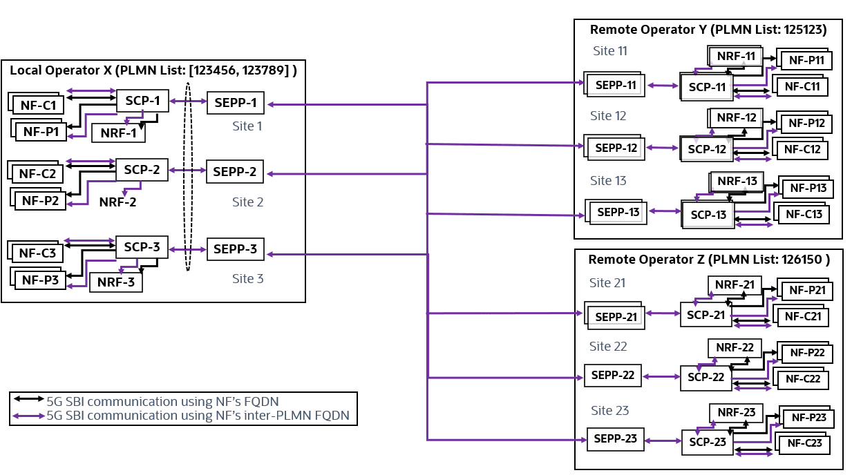

3.43 Support for 5G SBI Roaming
3GPP specifies Local Breakout (LBO) and Home Routing (HR) roaming architectures. SCP can be used for indirect communications such as Model C or Model D between NFs within Visited Public Land Mobile Network (VPLMN) or Home Public Land Mobile Network (HPLMN) or within both VPLMN and HPLMN.
The following image depicts the 5G system roaming architecture in the case of a home routed scenario with service-based interfaces within the Control Plane. For more information, see 3GPP TS 23.501 v16.6.0.
Figure 3-13 Local and Remote Routing
Local PLMN consumer NFs can be V-SMF, V-AMF, or V-PCF, and so on. Remote PLMN producer NFs can be H-SMF, H-UDM, or H-PCF, and so on.
This feature enables 5G SBI indirect communication for 5G SBI roaming signaling traffic, which includes roaming ingress traffic to local operator's network and egress traffic to remote operator’s network.
The PLMN network ID for a mobile network identifies the roaming location uniquely. The ID contains Mobile Country Code (MCC) and Mobile Network Code (MNC) to identify a mobile network operator.
If an NF wants to be discovered by other NFs in a different PLMN, it registers inter PLMN FQDN in NRF. The format of inter PLMN FQDN is as follows:
<labels separated by dots>.5gc.mnc<MNC>.mcc<MCC>.3gppnetwork.org
Example of of Inter PLMN FQDN UDM belonging to PLMN MNC 12 and MCC 345:
udm.5gc.mnc012.mcc345.3gppnetwork.org
Telescopic FQDN is not supported in this release.
Intra-PLMN (non-roaming) traffic is routed based on 5G NF topology determined from NRF using FQDN (local) present in NFs. 5G SBI roaming traffic received from SEPP, that is, ingress to local operator network site and with inter-PLMN or self constructed FQDN, is routed using inter-PLMN FQDN present in NFs.
If SCP receives a "3gpp-Sbi-Target-apiRoot" HTTP header in the ingress service request, it determines the target PLMN from the inter PLMN FQDN specified in this header. If the "3gpp-Sbi-Target-apiRoot" HTTP header is not present, SCP performs delegated discovery for NF selection based on the received "3gpp-Sbi-Discovery" headers.
To support the 5G SBI roaming subscriber inter-PLMN traffic routing for different remote PLMNs, SCP identifies whether the ingress 5G SBI service request is for local PLMN IDs or remote PLMN IDs. To differentiate between intra-PLMN and inter-PLMN service requests, SCP uses local supported PLMN IDs.
For a network, local supported PLMN IDs include SCP supported PLMN IDs. Other than locally supported PLMN IDs, all PLMN IDs are considered as remote PLMN IDs by SCP. A network consists of multiple PLMN IDs, and network deployment is based on PLMN IDs.
SCP determines the SEPP topology from NRF or locally configured SEPP profile at SCP. SCP selects a SEPP instance based on PLMN serving the target NF. SCP performs load balancing and alternate routing between SEPP instances based on priority and capacity available in the SEPP profile.
To use InterPLMN routing with Oracle NRF, you must:
  • deploy NRF with the following attribute in its deployment file: whiteListNFForSendingInterPlmnFQDN: "SCP*".
