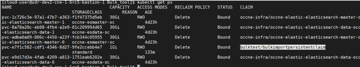

2.2.1.12 Creating Persistent Volume Claim
The bulk import Persistent Volume Claim (PVC) and xmltocsv container PVC are created automatically using helm.- Use the following sample template for previous release versions and
save it as <file-name>.yaml file.
PersistentVolumeClaim Bulk Import Service
apiVersion: v1 kind: PersistentVolumeClaim metadata: name: bulkimportpersistentclaim spec: storageClassName: <Please Provide your StorageClass Name> accessModes: - ReadWriteOnce resources: requests: storage: 1Gi - Run the following command to create a PVC.
kubectl create -f <file-name>.yaml - Run the following command to verify whether a PVC is created or
not.
kubectl get pvc -n <namespace>Figure 2-1 Verifying PVC Creation
- Run the following command to verify whether a Persistent Volume (PV)
is created and bound to the PVC volume.
kubectl get pvFigure 2-2 Verifying PV Creation
For more information about Bulk Import Provisioning, see Oracle Communications Cloud Native Core, Unified Data Repository User Guide.
