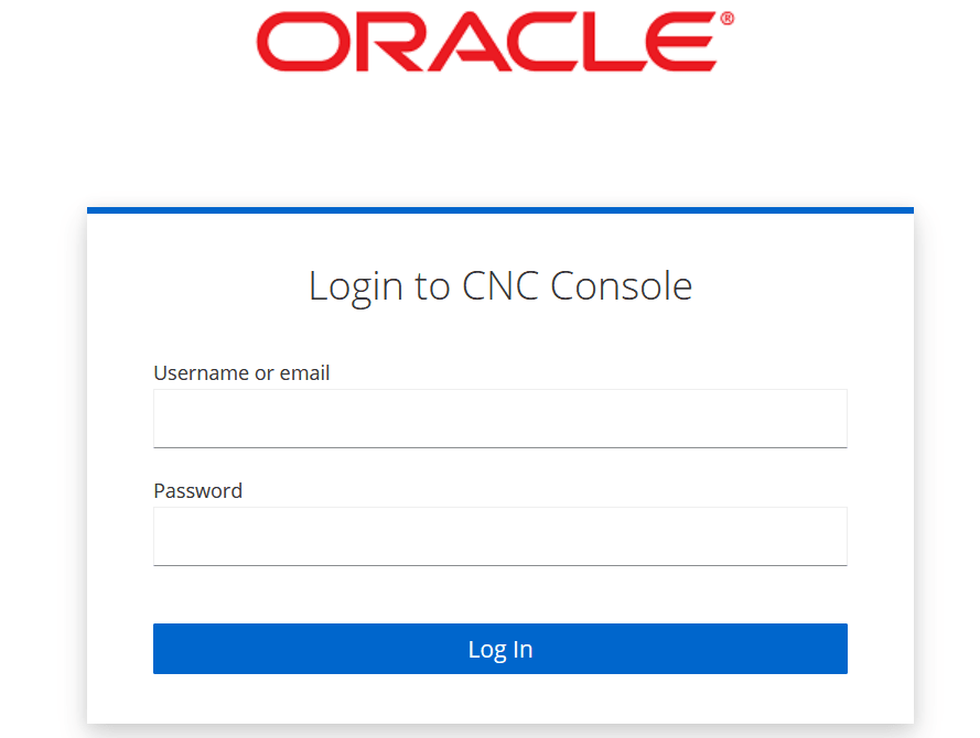

To log in to CNC Console:
  1. Type http://cncc-core-ingress-gateway.cncc.svc.cluster.local:<PortNumber>/ in the web browser and press Enter. The login page appears:
    Figure 3-1 CNC Console Login Page

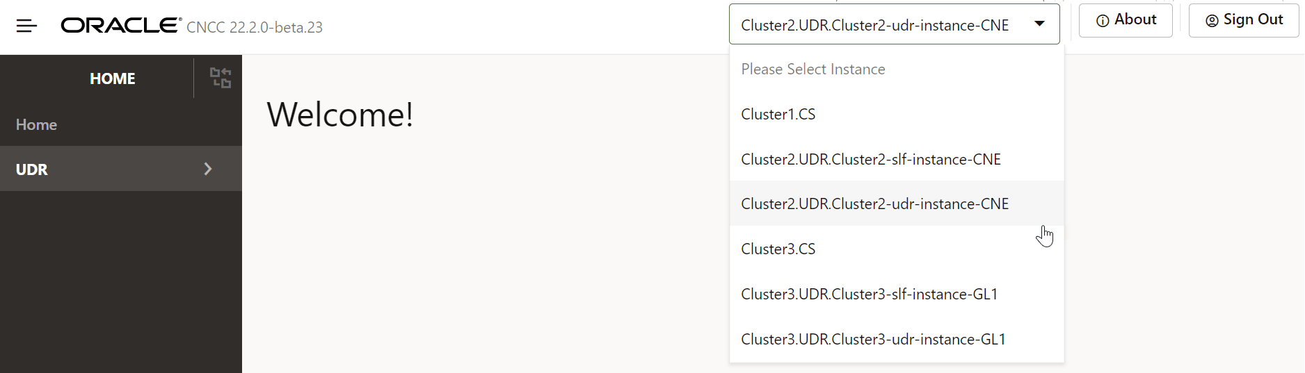

  2. Enter the Username and Password and click Log In. The CNC Console Home page appears from where a user can select different instances in the drop down, for example, the EIR, SLF, or the UDR instance.
    Figure 3-2 CNC Console Home Page

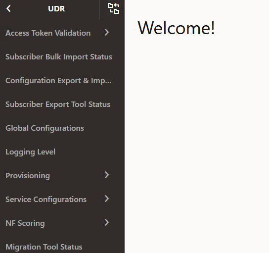

    The following NF services appear in the left navigation pane for the selected instance:
    • Access Token Validation
    • Bulk Import Status
    • Configuration Export & Import
    • Global Configurations

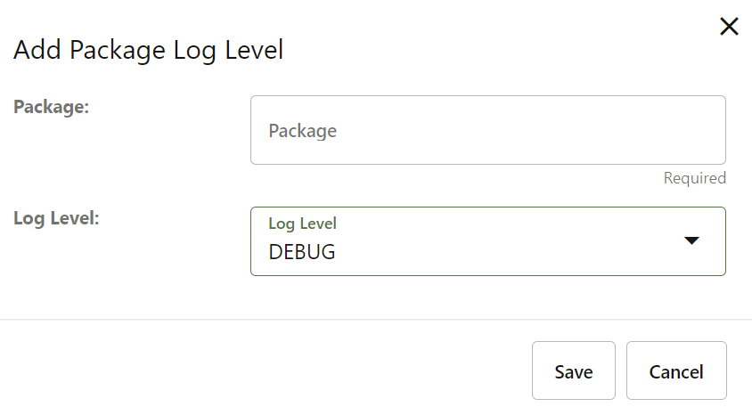

    • Logging Level
    • Provisioning
    • Service Configurations
    • NF Scoring

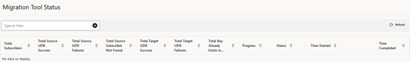

    • Migration Tool Status
  3. Select the service to be used from the left navigation pane:
    Figure 3-3 CNC Console Home Page with Services

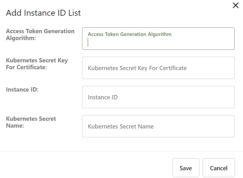

    1. Key ID List: Click Add in the Key ID List section and configure the following fields in Add Key ID List window:
      • Key ID: Enter the Key-ID.
      • Kubernetes Secret Name: Enter Kubernetes Secret Name.
      • Kubernetes Secret Key For Certificate: Enter Kubernetes Secret Key for the certificate.
      • Access Token Generation Algorithm: Enter the Access Token Generation Algorithm.
    2. Click Save on the Add Key ID List page to save the details. Click Cancel to discard your progress, close the window, and go back to Edit OAuth Signaling or Provisioning page.
    3. Instance ID List: Click Add in the Instance ID List section and configure the following fields in Add Instance ID List window:
      • Instance ID: Enter the NRF Instance ID.
      • Kubernetes Secret Name: Enter the Kubernetes Secret Name.
  6. Click Save on the Add Instance ID List page to save the details. Click Cancel to discard your progress, close the window, and go back to Edit OAuth Signaling or Provisioning page.

  2. To add the instance ID, click Add.
    1. The Add Instance ID List dialog box appears.
      Figure 3-4 Add Instance ID List
    2. Fill in the required details and click Save to add the instance ID.
    3. Click Cancel to exit the Add Instance ID List dialog box.
    Similarly, you can add the Key ID List details.

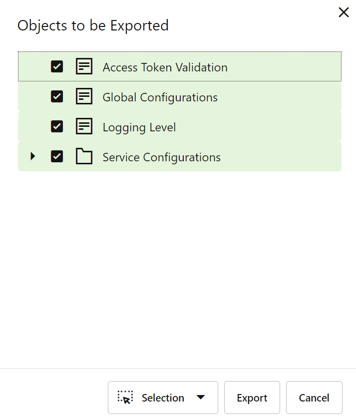

Exporting Configuration Data
To export the configuration data:
  1. Click the Bulk Export button in the Export tab. The Objects to be Exported dialog box appears.
    Figure 3-7 Objects to be Exported Dialog Box
  2. Select the objects that you want to export. Click the Selection button to either 'Select All' or 'Deselect All' the objects.
  3. Click Export to export the selected objects data. The data in the Configuration Export & Import page is updated.
  4. Click Cancel to exit the dialog box.

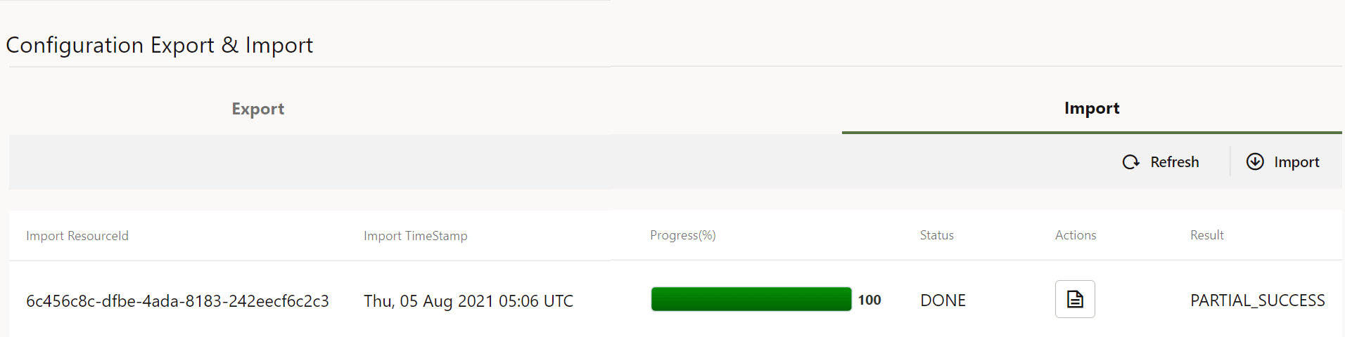

Importing Configuration Data
To import the configuration data:
  1. Navigate to the Import tab. The Configuration Export & Import page appears as follows:
    Figure 3-8 Importing Configuration Data

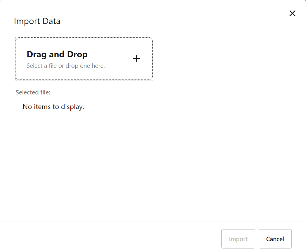

  2. Click the Import button. The Import Data dialog box appears.
    Figure 3-9 Import Data Dialog Box
  3. Select the file that has configuration data and click Import.
    You can only import the configuration data that you had exported earlier.
  4. The data in the Configuration Export & Import page is updated.
  5. Click Cancel to exit the dialog box.
Downloading Imported Configuration Data Report
To download the imported configuration data report:
  1. Click the Import Report Download icon available under Actions column of the Import tab.
  2. The "Import status report downloaded successfully" message appears and the import report in the .txt file format is saved to your system. For example: importReport_1.12.41_20210807134056.txt

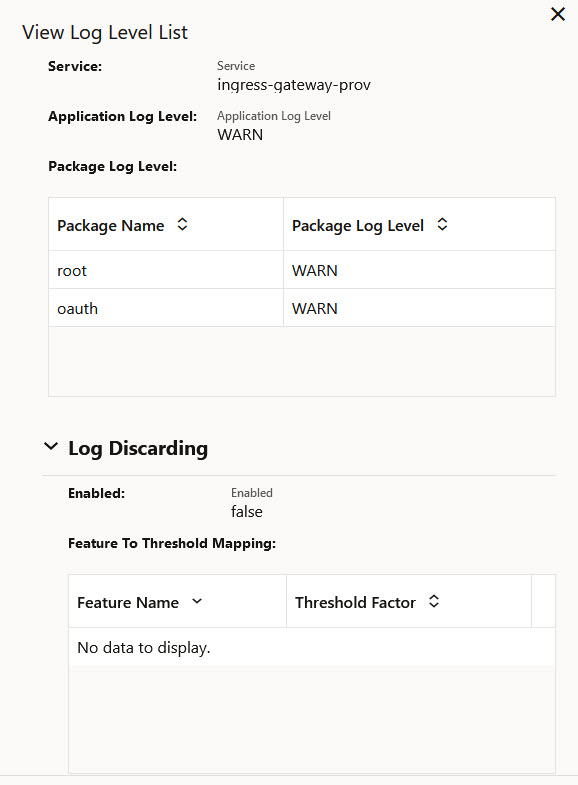

  • View: Click View corresponding to each microservice. The View Log Level List page appears.
    Figure 3-12 Sample: View Log Level List

  6. To add the Package Log Level details:
    1. Click the Add button available in the Package Log Level section. The Add Package Log Level dialog box appears:
      Figure 3-13 Add Package Log Level
    2. Enter the Package name and select the Log Level from the list. The Log Level options are:
      • DEBUG
      • ERROR
      • INFO
      • TRACE
      • WARN
    3. Click Save to add the package log level details. [OR] Click Cancel to exit the Add Package Log Level dialog box.

To configure UDR services using CNC Console, you can use Provisioning. In the left navigation pane of the CNC Console application, click UDR and then Provisioning.
Using Provisioning, SLF users can configure following services:
Using Provisioning, EIR users can configure following services:

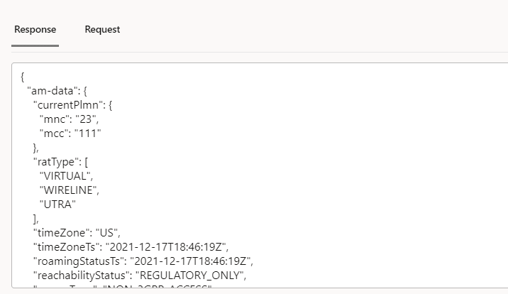

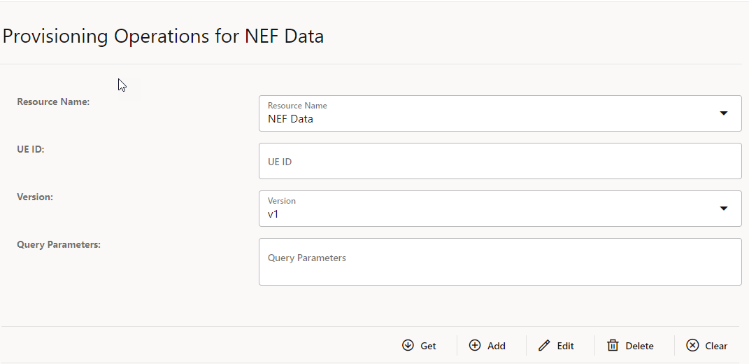

3.12.1 Provisioning - NEF Data
This section describes how to provision operations for NEF Data.
In the CNC Console application, click UDR and then Provisioning. From the Provisioning menu, select NEF Data in the left navigation pane. The Provisioning Operations for NEF Data page appears:
Figure 3-15 Provisioning Operations for NEF Data
Provisioning GUI for NEF Data
In the Provisioning Operations for NEF Data page, users can:
  • Extract NEF data from UDR database based on the UE ID entered
  • Add new NEF data to the UDR database
  • Modify an existing NEF data on the based on a UE ID
  • Delete existing NEF data that is not needed in the UDR database
Extracting Profile Data
To extract profile data:
  1. Ensure Resource Name is set to 'NEF Data'
  2. Type an appropriate UE ID. For example: msisdn-1111111114

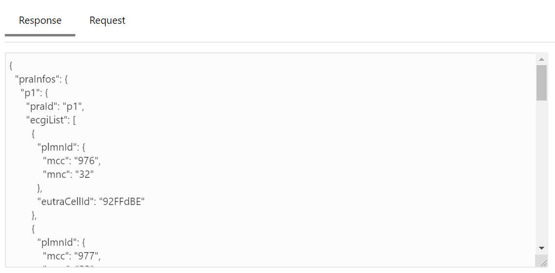

  3. Click Get. A confirmation message, 'Fetched Successfully' appears for a second, and the result appears in the Response text area as follows:
    Figure 3-16 Sample Page: Get - NEF Data - Response
    GET-NEF Data
  4. An Error message summary appears in case of incorrect UE ID entered.

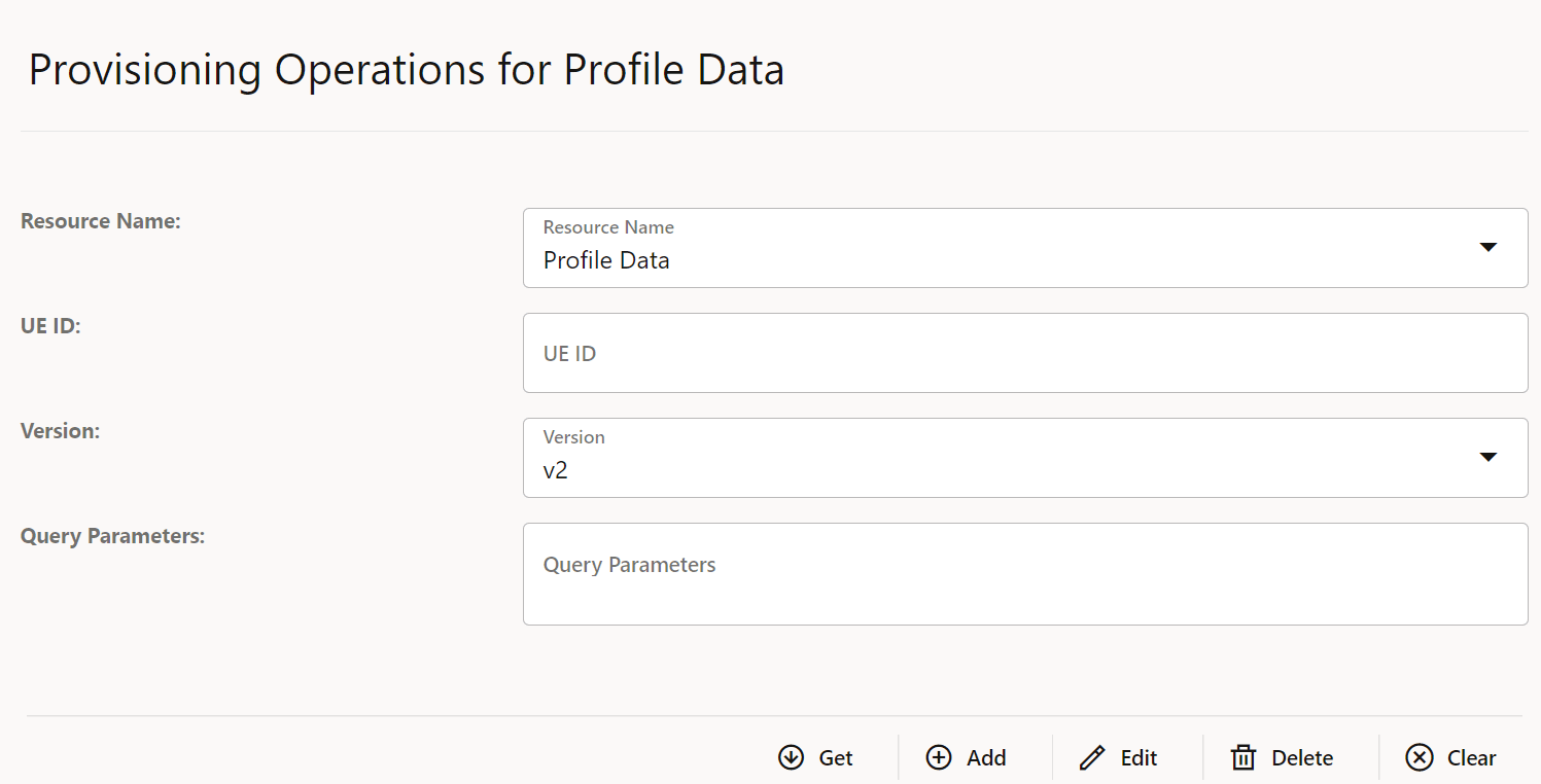

In the CNC Console application, click UDR and then Provisioning. From the Provisioning menu, select Profile Data in the left navigation pane. The Provisioning Operations for Profile Data page appears:
Figure 3-17 Provisioning Operations for Profile Data
In the Provisioning Operations for Profile Data page, user can:
  • Extract profile data from UDR database on the basis of UE ID entered
  • Add new profile data to the UDR database
  • Modify an existing profile data on the basis of UE ID
  • Delete an existing profile data that is no more needed in the UDR database

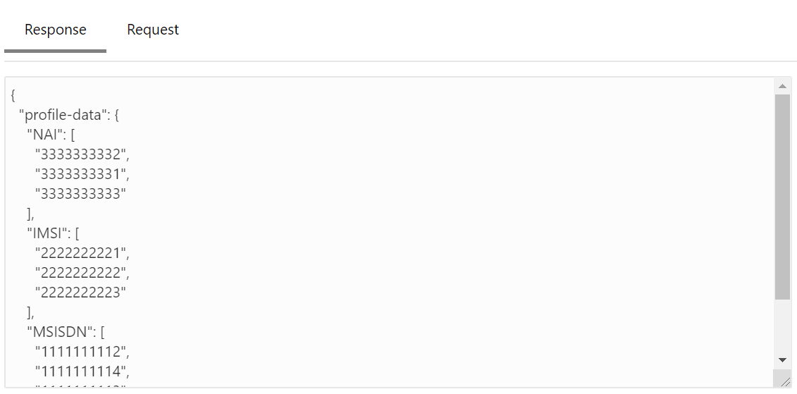

To extract a profile data:
  1. Ensure Resource Name is set to 'Profile Data'.
  3. Click Get. A confirmation message, 'Fetched Successfully' appears for a second and the result appears in the Response text area as follows:
    Figure 3-18 Sample Page: Get - Profile Data - Response

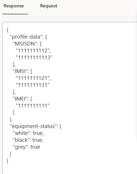

3.12.3 Provisioning - EIR Data
This section describes provisioning operations for EIR Data.
In the CNC Console application, click UDR and then Provisioning. From the Provisioning menu, select EIR Data in the left navigation pane. The Provisioning Operations for EIR Data page appears:
Figure 3-19 Provisioning GUI for EIR Data
In the Provisioning Operations for EIR Data page, users can:
  • Extract EIR data from UDR database based on the UE ID entered
  • Add new EIR data to the UDR database
  • Modify an existing EIR data on the based on a UE ID
  • Delete existing EIR data that is not needed in the UDR database
  1. Ensure Resource Name is set to 'EIR Data'
  2. Type an appropriate UE ID. For example: UE ID - imei-1111111111
    Figure 3-20 Sample Page: Get - EIR Data - Response
    GET-EIR Data

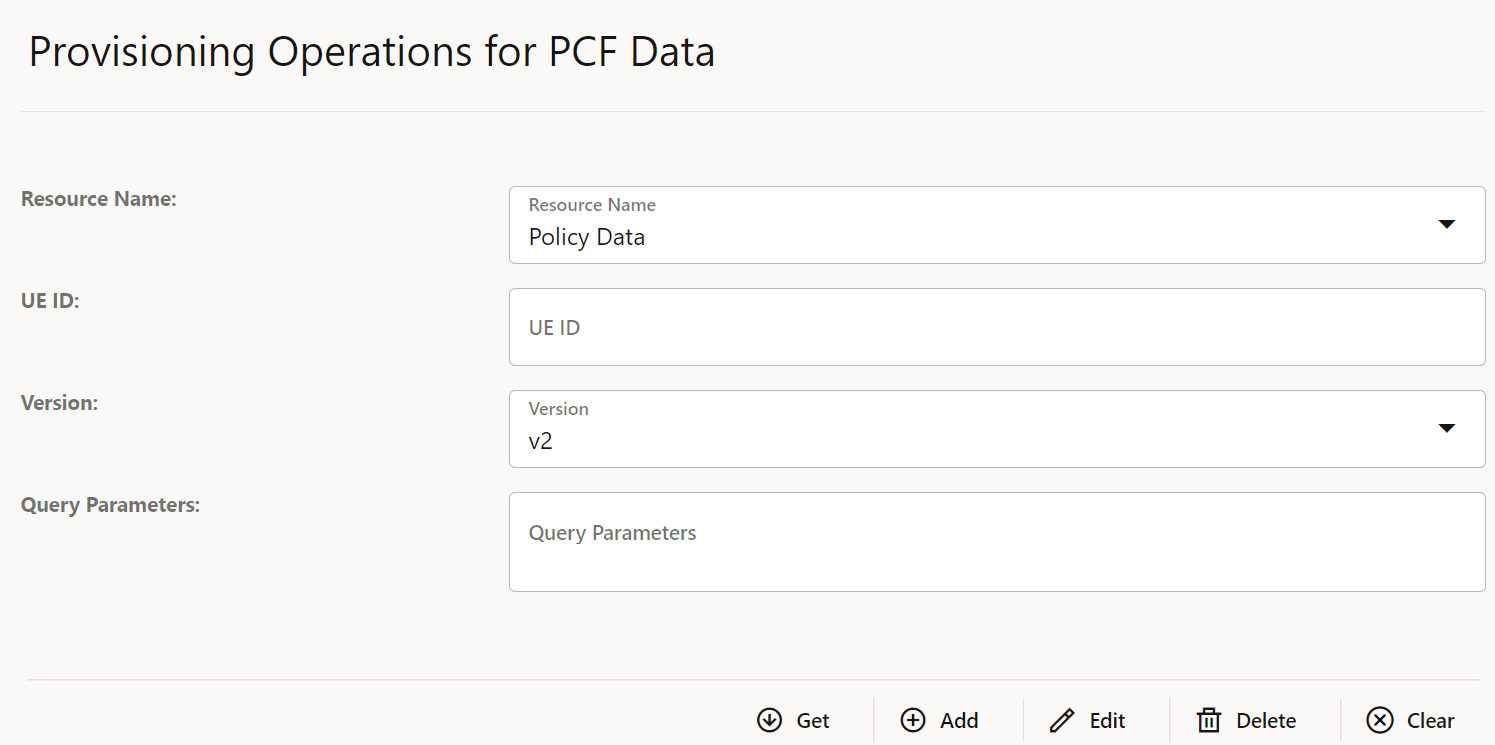

In the CNC Console application, click UDR and then Provisioning. From the Provisioning menu, select PCF Data in the left navigation pane. The Provisioning Operations for PCF Data page appears:
Figure 3-21 Provisioning Operations for PCF Data
img/provisioning-operations-pcf-data.png
In the Provisioning Operations for PCF Data page, a user can:
  • Select the Resource Name from the drop-down list.
  • Extract PCF data from UDR database on the basis of UE ID entered.
  • Add PCF Data on the basis of payload.
  • Modify the existing PCF data on the basis of UE ID.
  • Delete the existing PCF data that is no more needed in the UDR database.

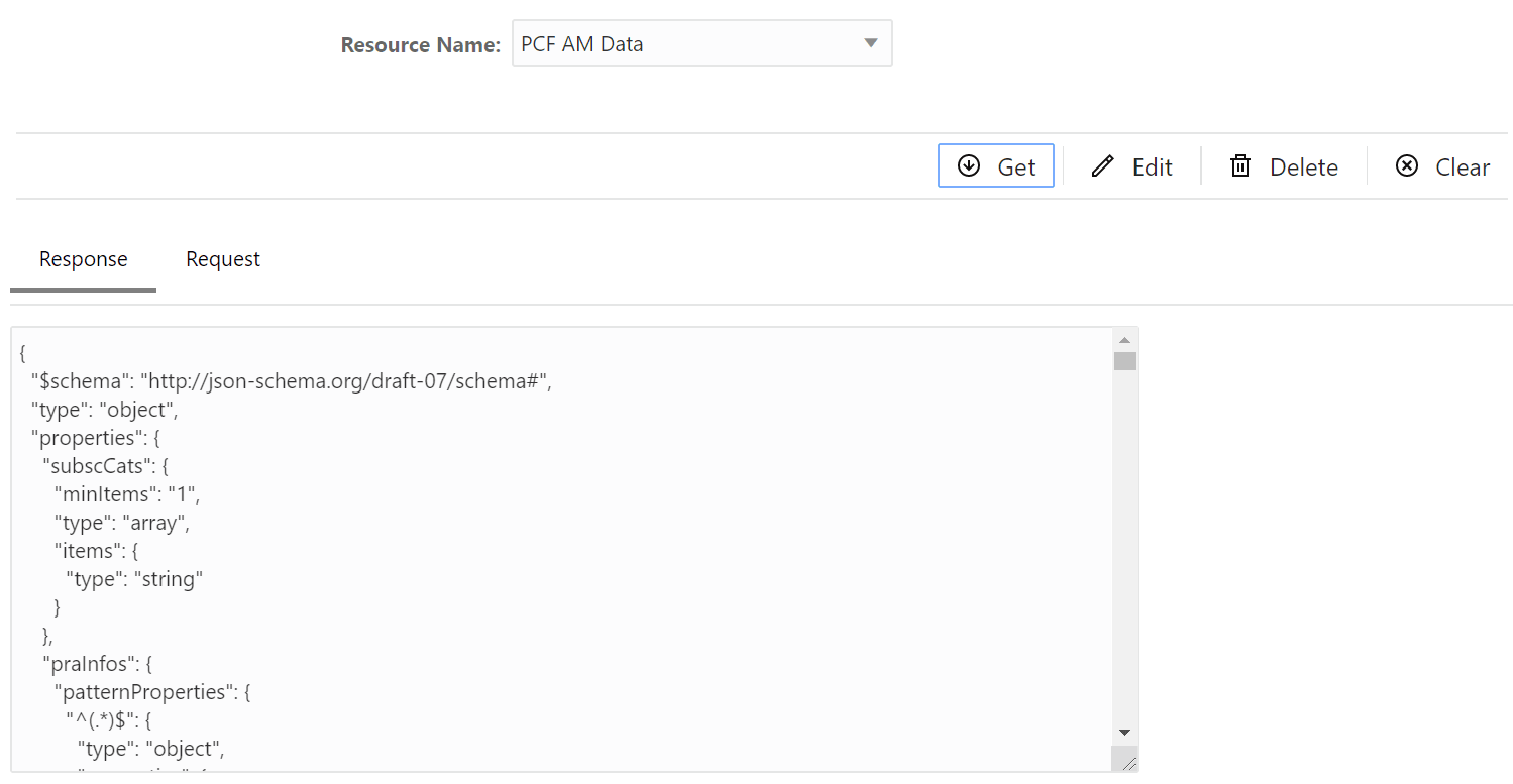

Extracting PCF Data
To extract the PCF data:
  1. Select the Resource Name from the drop-down list.
  2. Type an appropriate UE ID. For example: msisdn-9111111112.
  3. Click Get. A confirmation message, 'Fetched Successfully.' appears and the result appears in the Response text area as follows:
    Figure 3-22 Provisioning PCF Get Response

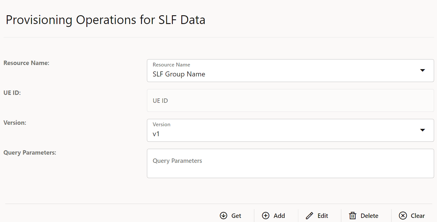

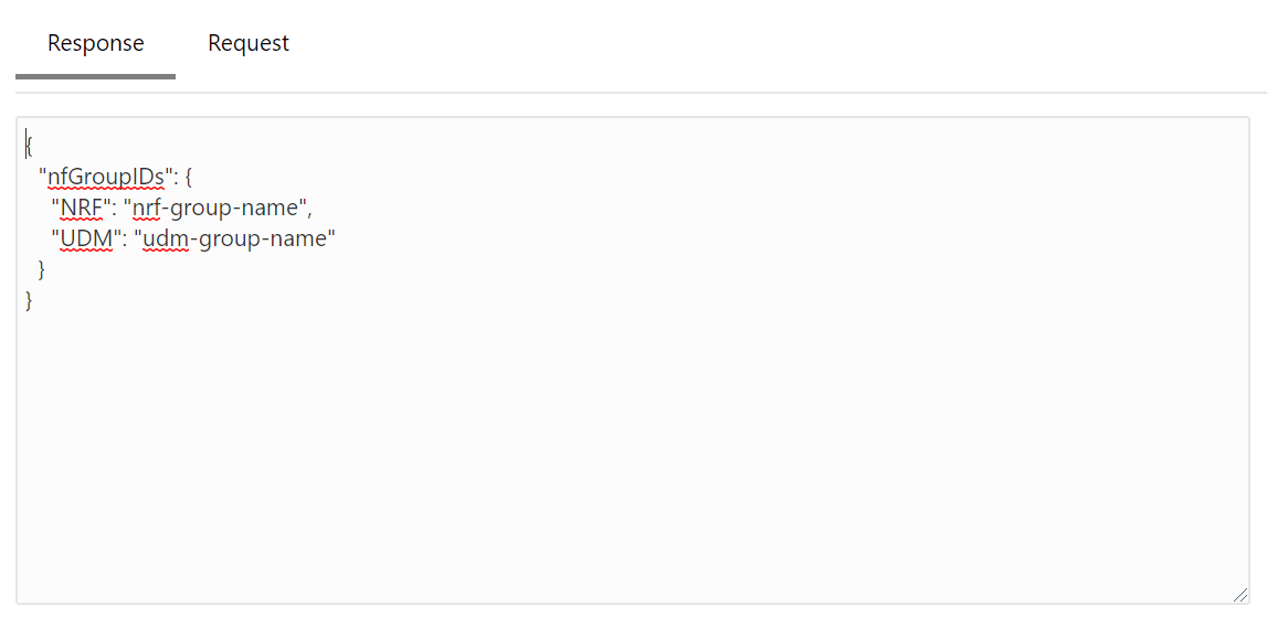

3.12.5 Provisioning - SLF Data
In this section, you will learn to operate provisioning operations for SLF (Subscriber Location Function) Data.
In the CNC Console application, click UDR and then Provisioning. From the Provisioning menu, select SLF Data in the left navigation pane. The Provisioning Operations for SLF Data page appears:
Figure 3-23 Provisioning Operations for SLF Data
img/provisioning-operations-slf-data.png
SLF Group Name must be provisioned before SLF Subscriber is provisioned.
In the Provisioning Operations for SLF Data page, user can:
  • Extract SLF data from UDR database on the basis SLF Group Name (Query Parameter) or SLF Subscriber (UEID).
  • Add or edit an existing SLF data on basis of SLF Group Name (Query Parameter) or SLF Subscriber (UEID).
  • Delete an existing SLF data that is no more needed in the UDR database.
Extracting SLF Data on the basis of SLF Group Name
To extract the SLF data on the basis of SLF Group Name:
  1. Select the Resource Name as SLF Group Name.
  2. Enter the Query Parameters.
    Figure 3-24 Provisioning SLF Get Response
Extracting SLF Data on the basis of SLF Subscriber
To extract the SLF data on the basis of SLF Subscriber:
  1. Select the Resource Name as SLF Subscriber.
  2. Type an appropriate UE ID. For example: msisdn-1111111112
    Figure 3-25 Provisioning SLF Get Response
  4. An Error message summary appears in case you enter an incorrect UE ID.
Adding SLF Data on the basis of SLF Group Name or SLF Subscriber
To add the SLF data:
  1. Select the Resource Name as either SLF Group Name or SLF Subscriber.
  2. If you have selected the Resource Name as SLF Group Name then,
    1. Enter the Query Parameters.
    2. Click Add. The Request text area appears.
    3. Type the SLF data.
    4. Click Submit. The 'Saved Successfully.' message appears.
    [OR]
  3. If you have selected the Resource Name as SLF Subscriber then,
    1. Type an appropriate UE ID. For example: msisdn-1111111112.
    3. Type-in the SLF data.
If a user enters any incorrect input, an Error message summary appears.

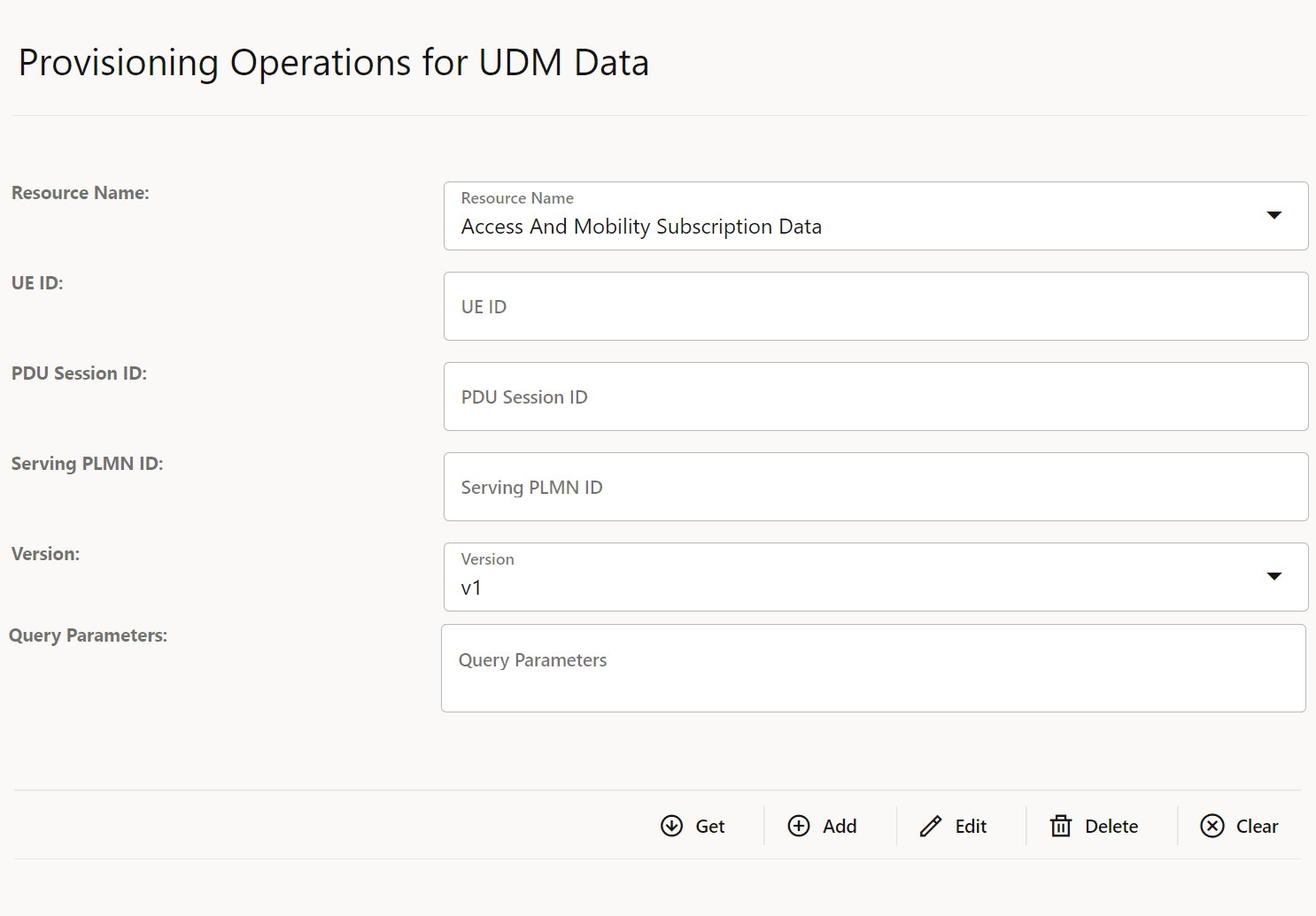

3.12.6 Provisioning - UDM Data
This section describes how to operate provisioning operations for UDM (Unified Data Management) Data.
In the CNC Console application, click UDR and then Provisioning. From the Provisioning menu, select UDM Data in the left navigation pane. The Provisioning Operations for UDM Data page appears:
Figure 3-26 Provisioning Operations for UDM Data
img/provisioning-operations-udm-data.png
In the Provisioning Operations for UDM Data page, user can extract, modify and delete UDM data on the basis of Resource Name, UE ID, PDU Session ID, Serving PLMN ID, Version and Query Parameters entered.
Extracting UDM Data
To extract the UDM data:
  2. Type an appropriate UE ID, PDU Session ID and Serving PLMN ID in their respective fields.
  3. Select an appropriate Version and enter Query Parameters.
  4. Click Get. A confirmation message, 'Fetched Successfully.' appears and the result appears in the Response text area.
  5. An Error message summary appears in case of incorrect UE ID entered.
Adding a UDM Data
To add a UDM data:
  1. Select the Resource Name.
  4. Click Edit. The Request text area appears.
  5. Enter details and click Submit. The 'Saved Successfully.' message appears.
Editing a UDM Data
To edit a UDM data:
  4. Click Edit. The Request text area displays an existing UDM data.
  5. Edit as required and click Submit. The 'Saved Successfully.' message appears.
Deleting a UDM Data
To delete a UDM Data:
  1. Enter the Resource Name.
  4. Click Delete.
  5. The 'Deleted Successfully.' message appears.
Clearing a UDM Data

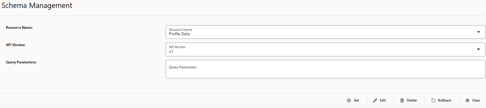

3.12.7 Provisioning - Schema Management Data
This section describes how to operate provisioning operations for schema.
In the CNC Console application, click UDR and then Provisioning. From the Provisioning menu, select Schema Management Data in the left navigation pane. The Schema Management page appears:
Figure 3-27 Schema Management
Schema Management
In the Schema Management page, user can extract, modify, and delete a schema on the basis of Resource Name and Query Parameters.
Extracting a Schema
To extract a schema:
    Figure 3-28 Schema - Get - PCF AM Data
    Schema Management - Get Response
Adding or Editing a Schema
To add or edit a schema:
  3. Click Edit. The Request text area displays the selected schema.
  4. Edit as required and click Submit. The 'Saved Successfully.' message appears.
    If a user edits the schema inappropriately, an Error message summary appears.
Deleting a Schema
To delete a schema:
  3. Click Delete.
  4. The 'Deleted Successfully.' message appears.
    If a user selects a schema that does not exists, an Error message summary appears.
Clearing a Schema Management Data
Click the Clear option to clear the text fields and text areas of the Schema Management page.
3.13 Service Configurations
To configure UDR services using CNC Console, you can use Service Configurations. In the left navigation pane of the CNC Console application, click UDR and then Service Configurations.
3.13.1 Subscriber Bulk Import Configurations
Click UDR and then Service Configurations. From the Service Configurations menu, select Subscriber Bulk Import Configurations. The Subscriber Bulk Import Configurations page appears:

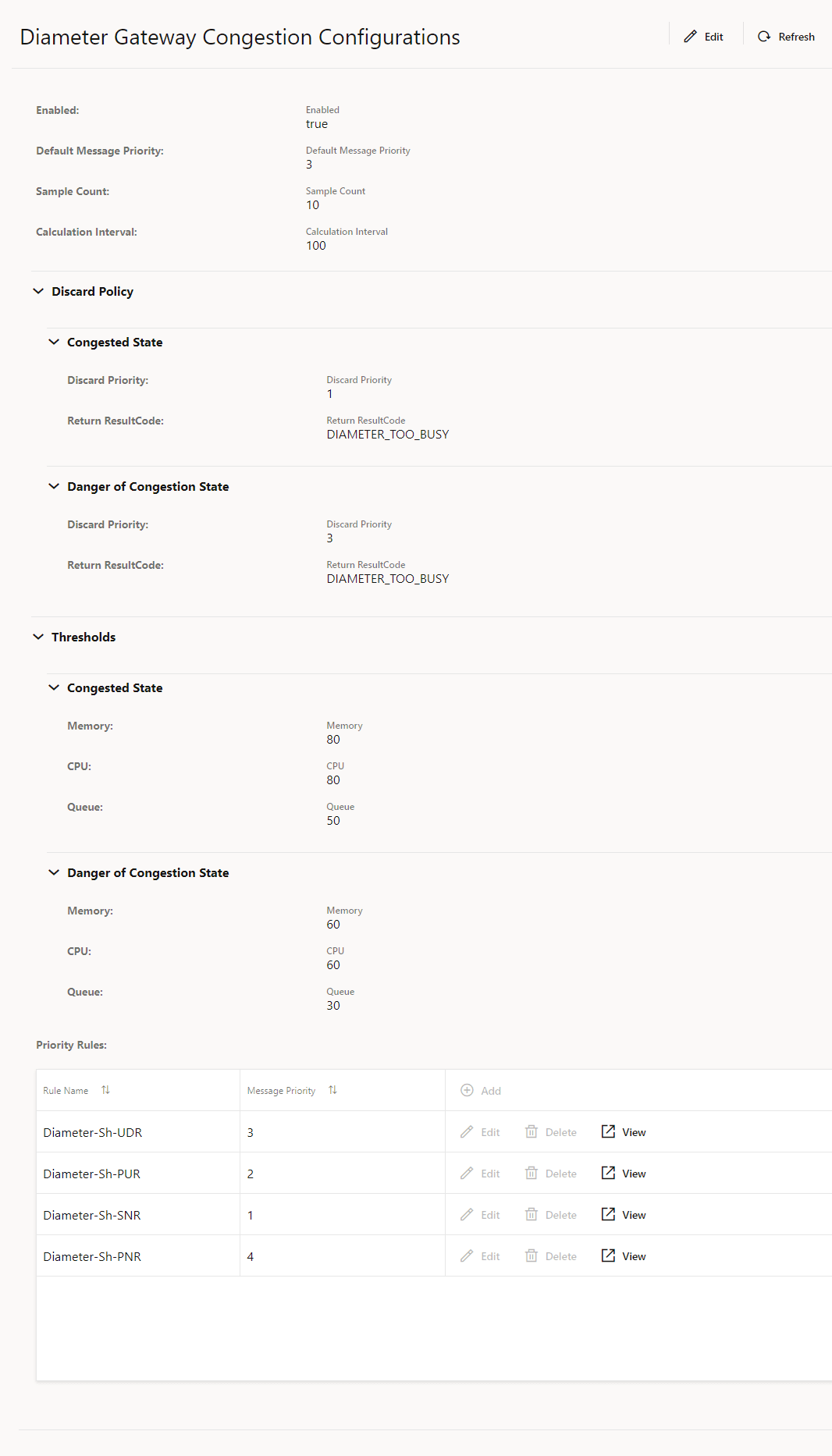

3.13.4 Diameter Gateway Congestion
Click UDR and then Service Configurations. From the Service Configurations menu, select Diameter Gateway Congestion. The Diameter Gateway Congestion Configurations page appears:
Figure 3-31 Diameter Gateway Congestion
Diameter Gateway Congestion configurations
The following table explains the parameters in the Diameter Gateway Congestion Configurations page in detail:
Table 3-32 Diameter Gateway Congestion Configurable Parameters
Field Name Default Value Attribute Description
enabled true Editable Flag to enable or disable the Diameter Gateway Pod Congestion feature
defaultMessagePriority 2 Editable Default diameter message priority which is not specifically assigned any priority
sampleCount 10 Editable Sample request count for deciding pod state
calculationInterval 100 Editable Congestion state calculation every configured time (in ms)
loadSheddingRulesMap NA
            "CONGESTED": {
               "state": "CONGESTED",
               "discardPriority": 3,
               "ansWithResultCode": "DIAMETER_TOO_BUSY"
            "DOC": {
               "state": "DOC",
               "discardPriority": 6,
Editable
Indicates the decision for the pod in a particular state
loadSheddingRulesMap.<CONGESTED/DOC> NA Editable Indicates the pod congestion state.
loadSheddingRulesMap.<CONGESTED/DOC>.state NA Editable Indicates the name of the state.
loadSheddingRulesMap.<CONGESTED/DOC>.discardPriority NA Editable Indicates the diameter message discard priority.
loadSheddingRulesMap.<CONGESTED/DOC>.ansWithResultCode NA Editable Indicates the diameter return string result code when the message get discarded.
priorityRules NA
            "ruleName": "SH-UDR",
            "messagePriority": 5,
            "conditions": {
               "requestType": "UDR",
               "application": "Sh"
Editable NA
Priority Rules.Rule Name NA Editable Specifies the unique name of the message priority rule.
Priority Rules.Message Priority NA Editable Specifies the priority assigned to the message. It can be a number from 0 to 15.
PriorityRules.Conditions.Request Type NA enum Specifies the type of message for the selected application. The supported request values for the application type are as follow:
  • CER
  • SNR
  • UDR
  • PUR
  • PNR
  • UDR_MIGRATION
Priority Rules.Conditions.Application NA enum
Specifies the type of application. Users can select any of the following values from the drop-down list:
  • Sh
Thresholds NA
            "CONGESTED": {
               "memory": 80,
               "cpu": 80,
               "queue": 50
            "DOC": {
               "memory": 60,
               "cpu": 60,
               "queue": 30
Editable NA
Thresholds.Congested State.Memory NA Editable Memory percentage of pod state
Thresholds.Congested State.CPU NA Editable CPU percentage of pod state
Thresholds.Congested State.Queue NA Editable Queue percentage of pod state
Thresholds.Danger of Congested State.Memory NA Editable Memory percentage of pod state
Thresholds.Danger of Congested State.CPU NA Editable CPU percentage of pod state
Thresholds.Danger of Congested State.Queue NA Editable Queue percentage of pod state
Discard Policy.Congested State.Discard Priority NA Editable Specifies the discard priority for the load shedding rule. The discard priority value can be a number from 0 to 15. Any request message with equal or lower priority is rejected.
Discard Policy.Congested State.Return ResultCode NA enum Specifies the result code, returned in the answer response, when request message is rejected as part of congestion control. Users can select any of the following values from the drop-down list: DIAMETER_UNABLE_TO_COMPLY, DIAMETER_TOO_BUSY
Discard Policy.Danger of Congested State.Discard Priority NA Editable Specifies the discard priority for the load shedding rule. The discard priority value can be a number from 0 to 15. Any request message with equal or lower priority is rejected.
Discard Policy.Danger of Congested State.Return ResultCode NA enum Specifies the result code, returned in the answer response, when request message is rejected as part of congestion control. Users can select any of the following values from the drop-down list: DIAMETER_UNABLE_TO_COMPLY, DIAMETER_TOO_BUSY
Editing Diameter Gateway Congestion Configurations
To update or modify any configuration information related to diameter gateway congestion:
  1. Click Edit. The Edit Diameter Gateway Congestion Configurations page appears:
  2. Update the configuration details as required and click Save. A confirmation message, "Save successfully." appears.
  3. If you do not want to modify any configuration, click Cancel. The Diameter Gateway Congestion Configurations page appears.
  4. Click Refresh to reload the Diameter Gateway Congestion Configurations page.

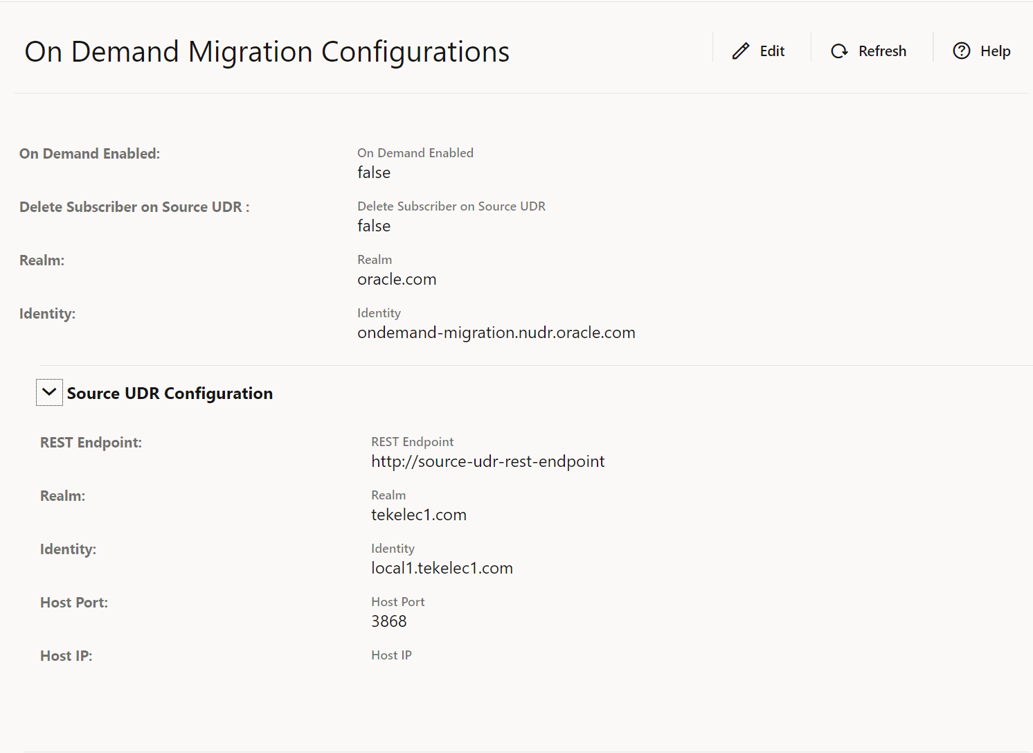

3.13.7 On Demand Migration
Click UDR and then Service Configurations. From the Service Configurations menu, select On Demand Migration. The On Demand Migration page appears:
Figure 3-34 On Demand Migration Configurations
The following table explains the On Demand Migration Configurations page in detail:
Table 3-35 On Demand Migration Configuration Parameters
On Demand Enabled false Read-only Flag to enable on-demand migration for migrating subscriber from 4G UDR
Delete Subscriber on Source UDR False Editable Flag to delete subscriber data when it is successfully migrated from target UDR to 5G UDR
Realm NA Editable Diameter realm of the target UDR
Identity ondemand-migration.udr.oracle.com Read-only Diameter client identity in ondemand-migration tool
Source UDR Configuration:
REST Endpoint
NA Editable Target UDR rest endpoint for deleting subscriber when the deleteSubcriber flag is enabled
Realm udr.oracle.com Read-only Diameter client realm in ondemand-migration tool
Host Port NA Editable Port number of target UDR where diameter service is running
Host IP NA Editable IP address of target UDR
Editing On Demand Migration Configurations
To update or modify any configuration information related to on demand migration:
  1. Click Edit. The On Demand Migration Configurations page appears.
  3. If you do not want to modify any configuration, click Cancel. You navigate back to the On Demand Migration Configurations page.
  4. Click Refresh to reload the On Demand Migration Configurations page.

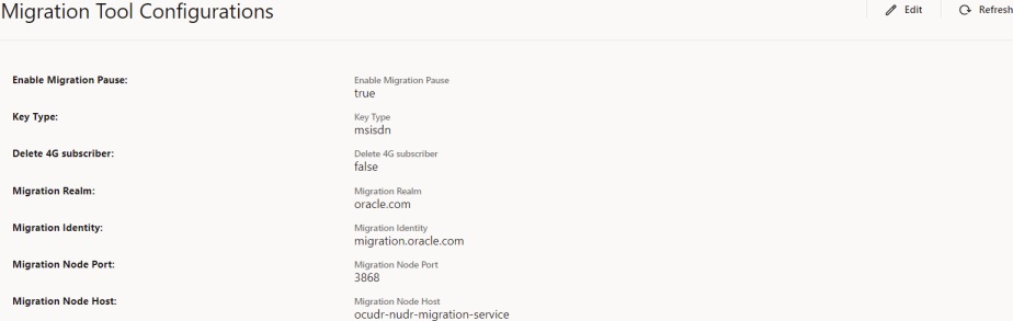

3.13.9 Migration Tool Configurations
Click UDR and then Service Configurations. From the Service Configurations menu, select Migration Tool Configurations. The Migration Tool Configurations page appears:
Figure 3-36 Migration Tool Configurations
The following table explains the parameters in the Migration Tool Configurations page in detail:
Table 3-37 Migration Tool Configurations Parameters
Field Name Description
Enable Migration Pause If it is set to true the migration process is temporarily paused.
Default Value: false
Attribute: Editable
Key Type Specifies the type of key used in the migration process. The two key types are IMSI and MSISDN.
Default Value: MSISDN
Attribute: Read-only
Delete 4G subscriber Boolean field that determines whether 4G data should be deleted.
Migration Realm Represents the migration tool realm.
Default Value: oracle.com
Migration Identity Represents the migration tool identity.
Default Value: migration.oracle.com
Migration Node Port Represents the port number used for the migration node.
Default Value: 3868
Migration Node Host Specifies the host name or network address of the migration node.
Default Value: ocudr-nudr-migration-service
Editing Migration Tool Configurations
To update or modify configuration information related to data repository:
  1. Click Edit. The Edit Migration Tool Configurations page appears.
  3. If you do not want to modify any configuration, click Cancel. You can navigate back to the Migration Tool Configurations page.
  4. Click Refresh to reload the Migration Tool Configurations page.

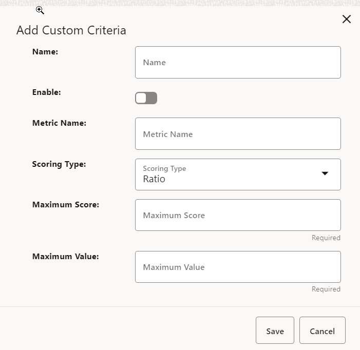

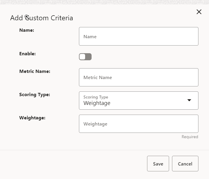

To update or modify the configuration information related to Settings:
  1. Click Edit. The Edit Settings page appears.
  2. To add the Custom Criteria, click Add.
    1. The Add Custom Criteria dialog box appears.
      Add Custom Criteria
      Add Custom Criteria
    2. Note:
      If the scoring type is selected as weightage then maximum score and minimum score fields are disabled.
      Fill in the required details and click Save to add the custom criteria.
    3. Click Cancel to exit the Add Custom Criteria dialog box.
  3. Update the configuration details as required in the settings page and click Save. A confirmation message, "Save successfully." appears.
  4. If you do not want to modify any configuration, click Cancel.
  5. Click Refresh to reload the Settings page.

3.15 Migration Tool Status
The Migration Tool Status page is a monitoring page, which is read-only. This page allows the operator to monitor the Migration Tool Status, which initiates on running the Migration Tool. For more information, see Migration Tool.
To access the Migration Tool Status page, click UDR and then, Migration Tool Status in the left navigation pane of the CNC Console application. The following page appears:
Figure 3-38 Migration Tool Status Page
The Migration Tool Status page shows following transaction details:
  • Total Subscribers: The total number of subscribers included in the migration process.
  • Total Source UDR Success: The total number of records successfully migrated from 4G UDR.
  • Total Source UDR Failure: The total number of records failed during the migration from 4G UDR.
  • Total Source Subscriber Not Found: The total number of subscribers not found for migration from 4G UDR.
  • Total Target UDR Success: The total number of records successfully migrated to 5G UDR.
  • Total Target UDR Failure: The total number of record failed during the migration in 5G UDR
  • Total Key Already Exists in the Target UDR: The total number of keys that already exist in 5G UDR.
  • Progress: Shows migration progress completion in percentage.
  • Status: The overall status of the migration process. For example, STARTED, IN PROGRESS, PAUSED, or COMPLETED.
  • Time Started: Shows the migration process start time.
  • Time Completed: Shows the migration process completion time.
Using Filter option, you can filter the records you are interested in and using Refresh option, you can refresh the Subscriber Bulk Import Status page.
