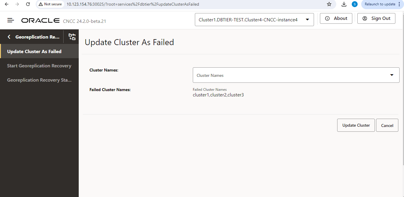

  2. Perform the following steps to update the cluster status as FAILED:
    1. Log in to CNC Console GUI of the active cluster.
    2. Expand cnDBTier under the NF menu and select Georeplication Recovery.
    3. Select Update Cluster As Failed.
    4. From the Cluster Names drop-down, select the cluster that you want to mark as failed and click Update Cluster.
      The drop-down displays the clusters that are part of the replication setup (cluster1 and cluster2). When you select a cluster and click Update Cluster, the selected cluster name is updated in the Failed Cluster Names field.
      For example, if you selected cluster1 to be marked as failed, then on clicking Update Cluster, cluster1 is updated in the Failed Cluster Names field.
      The following image shows a sample Update Cluster As Failed page where cluster1 is marked as a failed cluster:
      Figure 7-1 Update Cluster As Failed

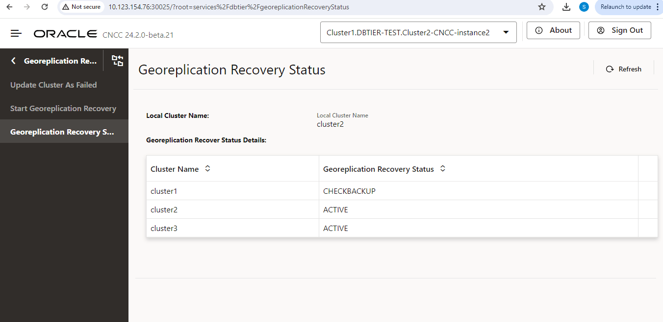

  4. Wait until the georeplication recovery is complete.
    The backup-manager-service pod may restart a couple of times during the georeplication recovery. You can ignore these restarts, however, ensure that the backup-manager-service pod is up at the end of the georeplication recovery.
    You can verify and monitor the cluster status by performing the following steps:
    1. Perform the Verifying cnDBTier Cluster Status Using CNC Console procedure to check the cluster status.
    2. When the cnDBTier cluster is UP, continue monitoring the georeplication recovery status by performing the Monitoring Georeplication Recovery Status Using CNC Console procedure.
      The drop-down displays the clusters that are part of the replication setup (cluster1, cluster2, cluster3, and cluster4). The selected cluster name is updated in the Failed Cluster Names field. For example, if you selected cluster1 to be marked as failed, then on clicking Update Cluster, cluster1 is updated in the Failed Cluster Names field.
      Figure 7-8 Update Cluster As Failed
      The Cluster Names drop-down displays all the clusters that are part of the replication setup (cluster1, cluster2, cluster3, and cluster4). When you select a cluster and click Update Cluster, the selected cluster name gets updated in the Failed Cluster Names field.
      For example, if you want to mark cluster1, cluster2, and cluster 3 as failed, then perform the following steps:
      1. Select cluster1 from the Cluster Names drop-down and click Update Cluster. The system displays cluster1 in the Failed Cluster Names field.
      2. Select cluster2 from the Cluster Names drop-down and click Update Cluster. The system displays cluster1 and cluster2 in the Failed Cluster Names field.
      3. Select cluster3 from the Cluster Names drop-down and click Update Cluster. The system displays cluster1, cluster2, and cluster3 in the Failed Cluster Names field.
      You can use the similar steps to update the status in the other combinations of clusters as well. The following image shows a sample Update Cluster As Failed page where cluster1, cluster2, and cluster3 are marked as failed clusters:
      Figure 7-11 Update Cluster1, Cluster2, and Cluster3 As Failed

    2023-10-13T09:12:24Z INFO - Setting STATE to FAILED in all sites...
    2023-10-13T09:12:25Z INFO - lfg-site-1 (1000): STATE set to FAILED
    site_name   site_id  dr_state   dr_backup_site_name  backup_id
    lfg-site-1  1        FAILED     NULL                 NULL
    lfg-site-2  2        COMPLETED  NULL                 NULL
    2023-10-13T09:12:26Z INFO - lfg-site-2 (2000): STATE set to FAILED
    lfg-site-2  2        COMPLETED  lfg-site-1           1013230837
    2023-10-13T09:12:26Z INFO - STATE set to FAILED

    2023-10-13T09:12:48Z INFO - Monitoring status...
    2023-10-13T09:12:48Z INFO - STATE = STARTDRRESTORE
    2023-10-13T09:12:49Z INFO -
    lfg-site-1  1        STARTDRRESTORE  NULL                 NULL
    2023-10-13T09:12:54Z INFO - STATE = REINSTALLED
    lfg-site-1  1        REINSTALLED  NULL                 NULL
    2023-10-13T09:13:00Z INFO - STATE = INITIATEBACKUP
    lfg-site-1  1        INITIATEBACKUP  NULL                 NULL
    2023-10-13T09:13:05Z INFO - STATE = CHECKBACKUP
    2023-10-13T09:13:06Z INFO -
    lfg-site-1  1        CHECKBACKUP  lfg-site-2           1013230913
    2023-10-13T09:13:07Z INFO - Droping databases with '-' (dash) in their name (10.121.27.163)...
    2023-10-13T09:13:08Z INFO - Disabling error loging while deleting databases...
    2023-10-13T09:13:08Z INFO - Re-enabling error loging...
    2023-10-13T09:13:08Z INFO - Dropped databases
    2023-10-13T09:13:59Z INFO - STATE = COPY_BACKUP
    2023-10-13T09:14:00Z INFO -
    lfg-site-1  1        COPY_BACKUP  lfg-site-2           1013230913
    2023-10-13T09:14:05Z INFO - STATE = CHECK_BACKUP_COPY
    lfg-site-1  1        CHECK_BACKUP_COPY  lfg-site-2           1013230913
    2023-10-13T09:15:01Z INFO - STATE = BACKUPCOPIED
    lfg-site-1  1        BACKUPCOPIED  lfg-site-2           1013230913
    2023-10-13T09:15:15Z INFO - STATE = BACKUPEXTRACTED
    lfg-site-1  1        BACKUPEXTRACTED  lfg-site-2           1013230913
    2023-10-13T09:15:16Z INFO - Disabling error loging on lfg-site-1...
    2023-10-13T09:15:16Z INFO - Disabling printing FAILED or "" (empty) STATEs...
    2023-10-13T09:15:27Z INFO - Waiting for pods to restart...
    2023-10-13T09:16:10Z INFO - STATE = RECONNECTSQLNODES
    lfg-site-1  1        RECONNECTSQLNODES  lfg-site-2           1013230913
    2023-10-13T09:16:12Z INFO - Waiting for pods to restart...
    2023-10-13T09:16:21Z INFO - Re-enabling printing FAILED or "" (empty) STATEs again if they occur
    2023-10-13T09:16:21Z INFO - Re-enabling error loging...
    2023-10-13T09:16:21Z INFO - STATE = BACKUPRESTORE
    2023-10-13T09:16:22Z INFO -
    lfg-site-1  1        BACKUPRESTORE  lfg-site-2           1013230913
    2023-10-13T09:16:43Z INFO - STATE = RESTORED
    lfg-site-1  1        RESTORED   lfg-site-2           1013230913
    2023-10-13T09:16:59Z INFO - STATE = BINLOGINITIALIZED
    2023-10-13T09:17:00Z INFO -
    lfg-site-1  1        BINLOGINITIALIZED  lfg-site-2           1013230913
    2023-10-13T09:17:13Z INFO - STATE = RECONFIGURE
    lfg-site-1  1        RECONFIGURE  lfg-site-2           1013230913
    2023-10-13T09:17:59Z INFO - STATE = COMPLETED
    2023-10-13T09:18:00Z INFO -
    lfg-site-1  1        COMPLETED  lfg-site-2           1013230913

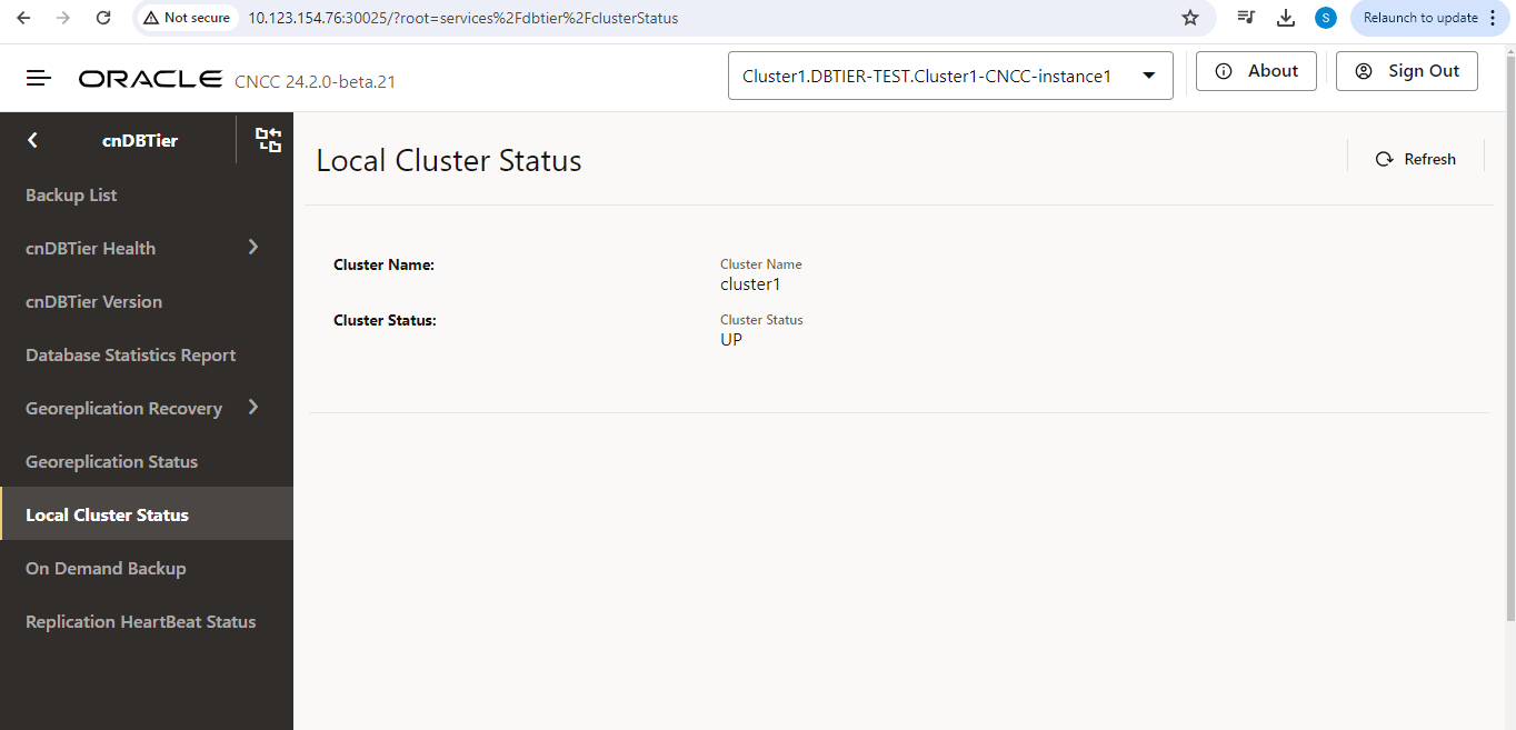

7.4.4 Verifying cnDBTier Cluster Status
This section provides the procedures to verify cnDBTier cluster status using cnDBTier or CNC Console.
7.4.4.1 Verifying Cluster Status Using cnDBTier
This section provides the steps to verify the cluster status using cnDBTier.
db-backup-manager-svc is designed to automatically restart in case of errors. Therefore, when the backup-manager-svc encounters a temporary error during the georeplication recovery process, it may undergo several restarts. When cnDBTier reaches a stable state, the db-backup-manager-svc pod operates normally without any further restarts.
  1. Run the following command to check the status of the pods in cnDBTier clusters:
    $ kubectl -n <namespace of cnDBTier Cluster> get pods
