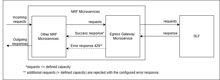

Egress Gateway Pod Throttling Mechanism
The following image describes the pod throttling mechanism when the requests received from NRF microservices like NFDiscovery, NFRegistration, NFSubscription, and NFAccessToken exceeds the defined capacity in Egress Gateway microservice.
Figure 4-1 Egress Gateway Pod Throttling Mechanism
- NRF microservice sends the requests to the Egress Gateway microservice.
- Egress Gateway microservice evaluates the number of requests received
from the other NRF microservices:
- If the number of incoming requests are 2500 and the maximum defined limit is 2700, then Egress Gateway microservice processes all the 2500 requests.
- If the number of incoming requests are 3000 and the maximum defined limit is 2700, then Egress Gateway microservice processes only 2700 requests, and rejects the additional 300 requests with response code 429 to the NRF microservice.
Note: When NRF Discovery microservice receives an overload response from Egress Gateway microservice, it does not retry or re-reroute this request. An error response will be generated based on the specific feature configurations like NRF Forwarding, Subscriber Location Function, and Roaming.

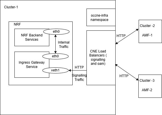

Ingress Traffic Segregation
Figure 4-2 Ingress Traffic Segregation
Here AMF-1 and AMF-2 send messages to the Ingress Gateway of the NRF. Internal traffic between NRF Backend and the Ingress Gateway travels through the default interface, eth0, which is connected to the pods. The signaling traffic between AMF-1 and NRF, as well as between AMF-2 and NRF, travels through a new interface, veth1, created using the Multus plugin. The Ingress service IPs and ports will be set up in Cloud Native Load Balancers (CNLBs), which will direct traffic to the Ingress Gateway. This gateway will then handle the requests and route them to the NRF.

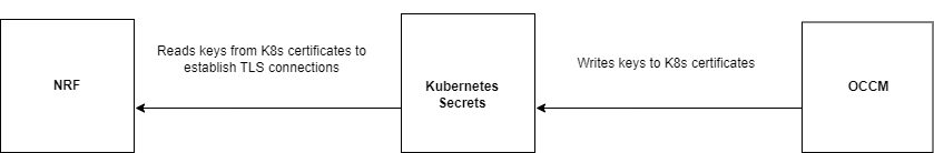

4.9 Support for Automated Certificate Lifecycle Management
In NRF 23.3.x and earlier, X.509 and Transport Layer Security (TLS) certificates were managed manually. When multiple instances of NRF were deployed in a 5G network, certificate management, such as certificate creation, renewal, removal, and so on, became tedious and error-prone.
Starting with NRF 23.4.x, you can integrate NRF with Oracle Communications Cloud Native Core, Certificate Management (OCCM) to support automation of certificate lifecycle management. OCCM manages TLS certificates stored in Kubernetes secrets by integrating with Certificate Authority (CA) using the Certificate Management Protocol Version 2 (CMPv2) protocol in the Kubernetes secret. OCCM obtains and signs TLS certificates within the NRF namespace. For more information about OCCM, see Oracle Communications Cloud Native Core, Certificate Management User Guide.
Figure 4-11 Support for OCCM
OCCM can automatically manage the following TLS certificates:
- 5G Service Based Architecture (SBA) client TLS certificates
- 5G SBA server TLS certificates
- Message Feed TLS certificates
This feature enables NRF to monitor, create, recreate, and renew TLS certificates using OCCM, based on their validity. For information about enabling HTTPS, see "Configuring Secrets for Enabling HTTPS" in Oracle Communications Cloud Native Core, Network Repository Function Installation, Upgrade, and Fault Recovery Guide.
- Upgrade: When NRF is deployed with OCCM, follow the specific upgrade procedure. For information about the upgrade strategy, see "Upgrade Strategy" in Oracle Communications Cloud Native Core, Network Repository Function Installation, Upgrade, and Fault Recovery Guide.
- Rollback: For more information on migrating the secrets from NRF to OCCM and removal of Kubernetes secrets from the yaml file, see "Postupgrade Task" in Oracle Communications Cloud Native Core, Network Repository Function Installation, Upgrade, and Fault Recovery Guide.
There are no additional configuration changes required at NRF.

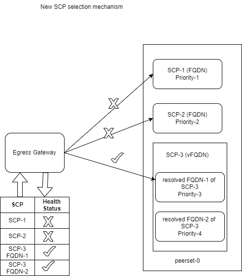

4.10 Egress Gateway Route Configuration for Different Deployments
Table 4-10 Egress Gateway Route Configuration for Static Peers
Egress Traffic | Egress Gateway Configuration | Outgoing Message Details | ||||
Peer under PeerSetConfiguration | RoutesConfiguration.httpsTargetOnly | RoutesConfiguration.httpRuriOnly | 3gpp-Sbi-Target-apiRoot | Scheme | Authority Header | |
HTTPS Outgoing Traffic (TLS) | httpsConfiguration | true | false | Target FQDN
Example: <SLF FQDN>/ <NotificationServer> |
https | Peer FQDN
Example: SCP/SEPP FQDN |
HTTP Outgoing Traffic (non-TLS) | httpsConfiguration | true | true | Target FQDN
http | Peer FQDN
Table 4-11 Egress Gateway Route Configuration for virtualHost Peers
https | Resolved Peer FQDN
Example: Resolved SCP/SEPP FQDN |
HTTP Outgoing Traffic (non-TLS) | httpConfiguration | false | true | Target FQDN
http | Resolved Peer FQDN
- For service-mesh based deployment, NRF Egress Gateway application container sends HTTP outgoing traffic only. The sidecar container is responsible for sending out the traffic as HTTPS traffic. Hence, for service-mesh based deployment, perform the configuration as per HTTP Outgoing Traffic (non-TLS).
- Update the PeerConfiguration as follows:
sample PeerConfiguration.json [ { "id": "peer1", "host": "scp-stub-service01", "port": "8080", "apiPrefix": "/", "healthApiPath":"/{scpApiRoot}/{apiVersion}/status" } ]
- Update the PeerSetConfiguration as
follows:
sample peerset.json [ { "id":"set0", "httpsConfiguration":[ { "priority": 1, "peerIdentifier": "peer1" }] } ]
- Update the RoutesConfiguration as
follows:
sample RoutesConfiguration.json { "id":"egress_scp_proxy2", "uri":"http://localhost:32069/", "order":3, "metadata":{ "httpsTargetOnly":true, "httpRuriOnly":false, "sbiRoutingEnabled":true }, "predicates":[ { "args":{ "pattern":"/nudr-group-id-map/v1/nf-group-ids" }, "name":"Path" } ], "filters":[ { "name":"SbiRouting", "args":{ "peerSetIdentifier":"set0", "customPeerSelectorEnabled":false } } ] }
follows:
sample PeerSetConfiguration.json [ { "id":"set0", "httpsConfiguration":[ { "priority": 1, "peerIdentifier": "peer1" }] } ]
follows:
sample RoutesConfiguration.json { "id":"egress_scp_proxy2", "uri":"http://localhost:32069/", "order":3, "metadata":{ "httpsTargetOnly":true, "httpRuriOnly":true, "sbiRoutingEnabled":true }, "predicates":[ { "args":{ "pattern":"/nudr-group-id-map/v1/nf-group-ids" }, "name":"Path" } ], "filters":[ { "name":"SbiRouting", "args":{ "peerSetIdentifier":"set0", "customPeerSelectorEnabled":false } } ] }

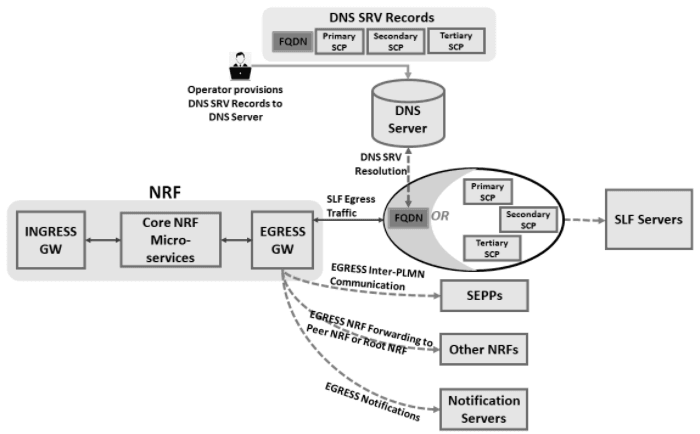

4.11 Routing Egress Messages through SCP
- SLF requests
- Notification requests
- NRF Forwarding requests
- Roaming requests
NRF supports routing of the Egress requests through SCP configured with FQDN and virtual FQDN as peer instances.
Alternate route service is used for the resolution of virtual FQDN using DNS-SRV. Egress Gateway uses the virtual FQDN of peer instances to query the Alternate Route Service to get the list of alternate FQDNs, each of which has a priority assigned to them. The Egress Gateway selects the peer instances based on the priority value.
Figure 4-12 Routing Egress Messages through SCP
- Open the
ocnrf_custom_values_25.1.100.yaml
file. - Set
enableNrfArtisanService
to true to enable Artisan microservice.Note:
This parameter must be enabled when dynamic SLF feature is configured. - Set
alternateRouteServiceEnable
to true to enable alternate route service. For more information on enabling alternate route service, see the "Global Parameters" section in Oracle Communications Cloud Native Core, Network Repository Function Installation, Upgrade, and Fault Recovery Guide.Note:
This parameter must be enabled when alternate route service through DNS-SRV is required. - Save the file.
- Run helm install. For more information about installation procedure, see Oracle Communications Cloud Native Core, Network Repository Function Installation, Upgrade, and Fault Recovery Guide.
- If you are enabling this parameter after NRF deployment, run helm upgrade. For more information about upgrade procedure, see Oracle Communications Cloud Native Core, Network Repository Function Installation, Upgrade, and Fault Recovery Guide.
Configure
Configure using REST API: Perform the following Egress Gateway configuration as described in the "Egress Gateway Configuration" section of the Oracle Communications Cloud Native Core, Network Repository Function REST Specification Guide.
- create or update the
peerconfiguration
with SCP FQDN details. - create or update the
peersetconfiguration
to assign these peers. - create or update the
sbiroutingerrorcriteriasets
sbiroutingerroractionsets
routesconfiguration
to provide the SCP details. For more information about the routes configuration specific to the above-mentioned requests, see the following sections: - If all the requests must be routed through SCP, then create or
update the
routesconfiguration
as follows:[ { "id": "egress_scp_proxy1", "uri": "http://localhost:32068/", "order": 0, "metadata": { "httpsTargetOnly": true, "httpRuriOnly": true, "sbiRoutingEnabled": true }, "predicates": [ { "args": { "pattern": "/**" }, "name": "Path" } ], "filters": [ { "name": "SbiRouting", "args": { "peerSetIdentifier": "set0", "customPeerSelectorEnabled": false, "errorHandling": [ { "errorCriteriaSet": "criteria_1", "actionSet": "action_1", "priority": 1 }, { "errorCriteriaSet": "criteria_0", "actionSet": "action_0", "priority": 2 } ] } } ] }, { "id": "default_route", "uri": "egress://request.uri", "order": 100, "filters": [ { "name": "DefaultRouteRetry" } ], "predicates": [ { "args": { "pattern": "/**" }, "name": "Path" } ] } ]
For more information about the routes configuration on different deployments, see Egress Gateway Route Configuration for Different Deployments.
If you encounter alerts at system or application levels, see the NRF Alerts section for resolution steps.

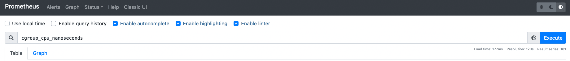

The congestion state is monitored based on CPU usage to determine the congestion level. The CPU usage is monitored using the Kubernetes cgroup (
cpuacct.usage
) and it is measured in nanoseconds.It is monitored periodically and calculated using the following formula and then compared against the configured CPU thresholds to determine the congestion state. For more information about the parameters and the proposed threshold values, see Oracle Communications Cloud Native Core, Network Repository Function REST Specification Guide.

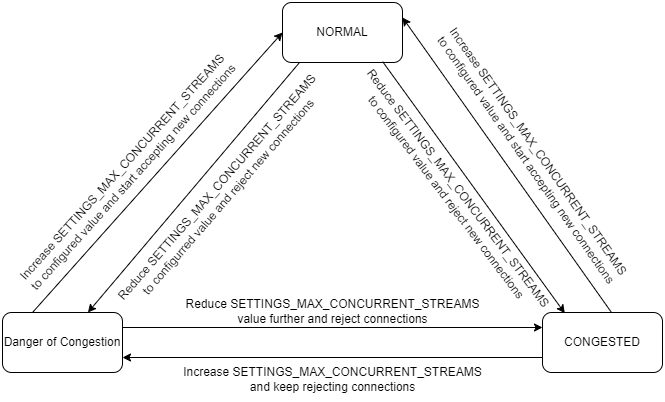

Ingress Gateway Pod States
Following are the various states to detect overload conditions. This will protect and mitigate the pod entering into an unstable condition, and to take necessary actions to recover from this condition.
Figure 4-14 Pod Protection State Transition
The transition can occur between any states. The threshold for these congestion parameters are preconfigured and must not be changed.- Congested State: This is the upper bound state
where the pod is congested. This means one or more
congestion parameters are above the configured thresholds
for the congested state. For more information about the
configuration, see Oracle Communications Cloud Native Core, Network Repository Function REST
Specification Guide. The pod can be transitioned to the
Congested state either from the Normal State or the DoC
state. When the pod reaches this state, the following
actions are performed:
- new incoming HTTP2 connection requests are not accepted.
- the pod gradually decrements the
number of concurrent streams by updating
SETTINGS_MAX_CONCURRENT_STREAMS parameter in a
SETTINGS frame to the configured
maxConcurrentStreamsPerCon
value at a regular interval. The number of concurrent streams are decremented based on the value configured indecrementBy
parameter. And, the regular interval is configured in thedecrementSamplingPeriod
parameter.
Danger of Congestion (DoC) State: This is the intermediate state where the pod is approaching a congested state. This means if one or more congestion parameters are above the configured thresholds for the DoC state. For more information about the configuration, see Oracle Communications Cloud Native Core, Network Repository Function REST Specification Guide.
When the pod reaches this state, the following actions are performed:- any new incoming HTTP2 connection requests are not accepted.
- if the pod is transitioning from
the Normal state to the DoC state, the pod
gradually decrements the number of concurrent
streams by updating
parameter. - if the pod is transitioning from
the Congested state to the DoC state, the pod
gradually increments the number of concurrent
streams by updating
value at a regular interval. The number of concurrent streams are incremented based on the value configured inincrementBy
parameter. And, the regular interval is configured in theincrementSamplingPeriod
parameter.
Normal State: This is the lower bound state where the CPU usage is below the configured thresholds for DoC and Congested states. For more information about the configuration, see Oracle Communications Cloud Native Core, Network Repository Function REST Specification Guide.
When the pod reaches this state, the following actions are performed:- the pod will continue accepting new incoming HTTP2 connection requests.
- in case the pod is transitioning
from the Congested or DoC state to Normal state,
the pod gradually increments the number of
parameter.

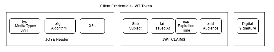

4.14 CCA Header Validation in NRF for Access Token Service Operation
Client Credentials assertion (CCA) is a token signed by the Consumer NF. It enables NRF to authenticate the Consumer NF which includes the signed token in Access Token service request. CCA header contains the Consumer NF's NfInstanceId that gets checked against the certificate by the NRF. The CCA also includes a timestamp as the basis for the restriction of its lifetime.
Consumer NF sends the 3gpp-Sbi-Client-Credentials header containing the CCA in the HTTP request and NRF performs the CCA validation. The CCA header validation is a JWT-based validation at NRF where the Consumer NF sends a JWT token as part of the header to NRF in Access Token request. The JWT token has an X5c certificate and other NF-specific information that is validated against the configuration values defined in NRF. The signature of the JWT token is validated against the CA root certificate configured at NRF.
Figure 4-15 Client Credentials JWT Token
Table 4-12 JOSE header
Attribute name | Data type | P | Cardinality | Description |
typ | String | M | 1 | The "typ" (type) Header Parameter is used to declare the media type of the JWS. Default value: JWT |
alg | String | M | 1 | The "alg" (algorithm) Header Parameter is used to secure the JWS. Supported Algorithm types: RSA/ECDSA. |
X5c | Array | M | 1 | The "X5c" (X.509 certificate) Header Parameter contains the X.509 public key certificate corresponding to the key used to digitally sign the JWT. |
Table 4-13 JWT claims
sub | NfInstanceId | M | 1 | This IE contains the NF instance ID of the NF service consumer, corresponding to the standard "Subject" claim. |
iat | integer | M | 1 | This IE indicates the time at which the JWT was issued, corresponding to the standard "Issued At" claim. This claim may be used to determine the age of the JWT. |
exp | integer | M | 1 | This IE contains the expiration time after which the client credentials assertion is considered to be expired, corresponding to the standard "Expiration Time" claim. |
aud | array(NFType) | M | 1..N | This IE contains the NF type of NRF, for which the claim is applicable, corresponding to the standard "Audience" claim. |
The digitally signed client credentials assertion is further converted to the JWS compact serialization encoding as a string.
If the validation is successful, the Access Token request is processed further.
If CCA header validation fails, the Access Token request is rejected by NRF
with "403 Forbidden
" with the cause attribute set to
"CCA_VERIFICATION_FAILURE

4.15 Monitoring the Availability of SCP Using SCP Health APIs
NRF determines the availability and reachability status of all SCPs irrespective of the configuration types.
This feature is an enhancement to the existing SBI routing functionality. Egress Gateway microservice interacts with SCP on their health API endpoints using HTTP2 OPTIONS method. It monitors the health of configured SCP peers to ensure that the traffic is routed directly to the healthy peers. This enhancement avoids routing or rerouting towards unhealthy peers, thus minimizing the latency time.
Egress Gateway microservice maintains the health status of all available and unavailable SCPs. It maintains the latest health of SCPs by periodically monitoring and uses this data to route egress traffic to the most preferred healthy SCP.
Figure 4-16 SCP Selection Mechanism
peermonitoringconfiguration
is set to false by default. Since, this
feature is an add-on to the existing SBI Routing feature and will be activated if the
sbirouteconfig
feature is enabled. To enable this feature, perform
the following:
- configure
peerconfiguration
withhealthApiPath
as/{scpApiRoot}/{apiVersion}/status
- configure
- configure
routesconfiguration
- configure
- configure
- enable
healthApi
in peerconfiguration
should be attached manually to existing configured
peers. If the operator tries to enable peermonitoringconfiguration
and
the targeted peers do not have the healthApiPath
then an appropriate
error response is sent.
Managing Monitoring the Availability of SCP Using SCP Health APIs

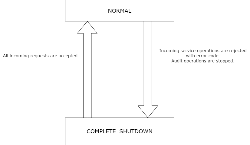

4.16 Controlled Shutdown of NRF
NRF supports controlled shutdown feature to isolate NRF from the current network at a particular site. This isolation helps to perform any maintenance activities or recovery procedures as required without uninstalling the NRF at the particular site. During this time the operations of the Ingress Gateway, Egress Gateway, and NrfAuditor microservices are paused. These services read the operational state from the database periodically. The operational state of NRF can be changed by using REST API or CNC Console at any time.
The two operational states defined for NRF are as follows:
- NORMAL
- COMPLETE_SHUTDOWN
- Ensure that the database is up and the NRF services must be able to connect and communicate with the database to change the operational state.
- In either state, if the database goes down, the back-end pods go to the NOT_READY state, but the Ingress Gateway microservice will continue to be in the last known operational state. When the Controlled Shutdown feature is enabled and the database is not available, all the incoming messages will be rejected with the Service Unavailable messages if the operational state is "NORMAL", or with a configurable error code if the operational state is COMPLETE_SHUTDOWN". However, the operators will not be able to see the operational state in CNC Console due to database unavailability.
If the controlled shutdown operational state is NORMAL, then NRF processes the message as normal.
If the controlled shutdown operational state is COMPLETE_SHUTDOWN, then NRF rejects all incoming requests with a configurable error code.
Figure 4-17 Operational State changes
The following behavior changes occur when the operational state changes:
From NORMAL to COMPLETE_SHUTDOWN
- The Ingress Gateway microservice rejects all new requests towards
the services that have been configured for controlled shutdown with a
configurable error code. In this case, all the inflight transactions will be
gracefully handled. The controlled shutdown applies to the following
services:
- nfregistration
- nfdiscovery
- nfsubscription
- nfaccesstoken
controlledshutdownerrormapping
anderrorcodeprofiles
APIs. - The NrfAuditor microservice pauses all its audit procedures, hence
no notifications are generated.
OcnrfAuditOperationsPaused
alert is raised to indicate that the audit is paused. - The Egress Gateway microservice handles all the inflight requests
gracefully. Since the Ingress Gateway and NrfAuditor microservices are in a
COMPLETE_SHUTDOWN operational state, there would be no requests from the backend
services.
No specific configuration for controlled shutdown needs to be applied on the routes for the Egress Gateway microservice. - The NrfConfiguration microservice continues to process any configuration requests in the COMPLETE_SHUTDOWN state.
OcnrfOperationalStateCompleteShutdown
alert is raised to indicate the operational state of NRF is COMPLETE_SHUTDOWN.- The operational state change is recorded and can be viewed using
the
controlledShutdownOptions
REST API. Additionally, the history of operational state changes can be viewed using theoperationalStateHistory
REST API.
From COMPLETE_SHUTDOWN to NORMAL
- The Ingress Gateway microservice resumes processing all incoming requests.
- The Egress Gateway microservice resumes processing all outgoing requests.
The NrfAuditor pod waits for a preconfigured waiting period before resuming its audit procedures to allow the NFs to move back to this NRF after the NRF has changed to the NORMAL operational state. Once the waiting period has expired, the audit procedures resume, and the
alert is cleared. The waiting period is defined as(defaultHbTimer * nfHeartBeatMissAllowed) + maxReplicationLatency(s) + replicationLatencyThreshold * latencyMultiplier
Where,defaultHbTimer
- defaultHbTimer configured innfManagementOptions.nfHeartBeatTimers
where the nfType is "ALL_NF_TYPE". For more information about the parameter, see "NF Management Options" in Oracle Communications Cloud Native Core, Network Repository Function REST Specification Guide.nfHeartBeatMissAllowed
- nfHeartBeatMissAllowed configured innfManagementOptions.nfHeartBeatTimers
where the nfType is "ALL_NF_TYPE". For more information about the parameter, see "NF Management Options" in Oracle Communications Cloud Native Core, Network Repository Function REST Specification Guide.maxReplicationLatency
- The maximum replication latency detected across all the sites. This parameter supports dynamic value.replicationLatencyThreshold
- The replicationLatencyThreshold configured in geoRedundancyOptions. For more information about the parameter, see "Georedundancy Options" in Oracle Communications Cloud Native Core, Network Repository Function REST Specification Guide.latencyMultiplier
- A preconfigured fixed offset value set as 3.
alert is cleared to indicate that the operational state of NRF is NORMAL.- The operational state change is recorded and can be viewed using the
REST API.

ClusterPreferred | ClusterPreferred | ClusterPreferred | None |
For more information about the parameters, see the "Customizing NRF" section in the Oracle Communications Cloud Native Core, Network Repository Function Installation, Upgrade, and Fault Recovery Guide.
You can customize the IP address allocation to services based on the above Helm parameters. Services route the traffic to the destination endpoints based on this configuration. If the Helm parameter is set to IPv4, then IPv4 is allocated to services, and services use IPv4 pod IPs to send the traffic to endpoints.
IP Family Policy Attribute, IP Families Attribute, Pod IP and Service IP indicates the Ingress Gateway Microservice whereas the Endpoint belongs to backend microservice.
IP address allocation for the edge microservice (Ingress Gateway Microservice) is
configured using the global.edgeDeploymentMode
Helm parameter.
IP address allocation for all the backend microservices are performed based on the value
configured at the global.backEndDeploymentMode
Helm parameter.
IP selection control and connections for the Egress Gateway microservice or the outgoing
traffic is handled by the global.egressRoutingMode
Helm parameter.
For more information about the above parameters, see the "Customizing NRF" section in the Oracle Communications Cloud Native Core, Network Repository Function Installation, Upgrade, and Fault Recovery Guide.
The following table describes how IP address allocation, ipFamilyPolicy, and ipFamilies vary based on the above parameter configuration for services:
Table 4-16 IP Address Allocation
Infrastructure Preference | Backend Deployment Mode Helm Parameter | ipFamilyPolicy Attribute | ipFamilies Attribute | Pod IP | Service IP | Endpoints |
IPv4 Preferred | IPv4 | SingleStack | IPv4 | Ipv4,IPv6 | IPv4 | IPv4 |
IPv6 Preferred | IPv4 | SingleStack | IPv4 | Ipv6,IPv4 | IPv4 | IPv4 |
IPv4 Preferred | IPv6 | SingleStack | IPv6 | Ipv4,IPv6 | IPv6 | IPv6 |
IPv6 Preferred | IPv6 | SingleStack | IPv6 | Ipv6,IPv4 | IPv6 | IPv6 |
IPv4 Preferred | IPv4_IPv6(IPv4 Preferred) | RequiredDualStack | IPv4 Preferred | Ipv4,IPv6 | Ipv4,IPv6 | IPv4 |
IPv6 Preferred | IPv4_IPv6(IPv4 Preferred) | RequiredDualStack | IPv4 Preferred | Ipv6,IPv4 | Ipv4,IPv6 | IPv4 |
IPv4 Preferred | IPv6_IPv4(IPv6 Preferred) | RequiredDualStack | IPv6 Preferred | Ipv4,IPv6 | Ipv6,IPv4 | IPv6 |
IPv6 Preferred | IPv6_IPv4(IPv6 Preferred) | RequiredDualStack | IPv6 Preferred | Ipv6,IPv4 | Ipv6,IPv4 | IPv6 |
NRF defines all theglobal.edgeDeploymentMode
and
as ClusterPreferred by default. This
helps NRF or other microservices to
fallback to the single stack support.
Upgrade Impact
In a dual stack environment, all the NRF backend services are configured as single stack. As per Kubernetes limitation, NRF upgrade is not supported when there is a mismatch in ipFamilies configured between NRF backend microservices and the deployment mode ipFamilies configuration. In this case, NRF recommends a fresh installation to change the preferred ipFamilies. However, this is not applicable for the edge microservice (Ingress Gateway microservice) as they can choose to increase the list of ipFamilies by setting it as dual stack according to the cluster preference.
Managing Dual Stack
Enable
The dual stack support is a core functionality of NRF. You do not need to enable or disable this feature.
Configure
This section lists the configuration details for this feature.
Helm
- Customize the
file. - Set
to clusterPreferred to indicate the edge deployment mode. - Set
to clusterPreferred to indicate the backend deployment mode. - Set
to None to control the IP address selection and connection for the Egress Gateway microservice. For more information about the parameters, see Oracle Communications Cloud Native Core, Network Repository Function Installation, Upgrade, and Fault Recovery Guide. - Save the file.
- Install NRF. For more information about installation procedure, see Oracle Communications Cloud Native Core, Network Repository Function Installation, Upgrade, and Fault Recovery Guide.

is used to determine the congestion level. The CPU usage is monitored using the
Kubernetes cgroup (cpuacct.usage) and it is measured in nanoseconds.
Figure 4-18 CPU Measurement
Where,
CurrentCpuUsage
is the counter reading at current periodic cycle.LastCpuUsage
is the counter reading at previous periodic cycle.CurrentTime
is the current time snapshot.LastSampleTime
is the previous periodic cycle time snapshot.CPUs
is the total number of CPUs for a given pod.

Subscription Microservice Load States
Following are the different overload states to detect overload conditions. This will protect and mitigate the pod entering into an overload condition, and to take necessary actions to recover from overload.
Figure 4-19 Pod Protection State Transition
The transition can occur between any states based on the congestion parameters. These congestion parameters are preconfigured and cannot be changed.- Congested State: This is the upper bound state where the pod is
congested. This means one or more congestion parameters is above the configured
thresholds for the congested state. For more information about the configuration
using CNC Console, see Pod Protection Options. The pod can be transitioned to the Congested State either
from the Normal State or the DoC state.
When pod reaches this state, the following actions are performed:
- the pod gradually decrements the number of concurrent
streams by updating SETTINGS_MAX_CONCURRENT_STREAMS parameter in a
value at a regular interval. The concurrent streams are decremented based on the value configured indecrementBy
parameter.
Alerts are raised when any of the subscription pods go into this state. For more information about alerts, see NRF Alerts.
- Danger of Congestion (DoC) State: This is the intermediate state
where the pod is approaching a congested state. This means one or more
congestion parameters, CPU or Pending Message Count, is above the configured
thresholds for the DoC state. For more information about the configuration using
- When pod reaches this state, the following actions are performed:
- if the pod is transitioning from the Normal State to
the DoC state, the pod gradually decrements the number of
concurrent streams by updating SETTINGS_MAX_CONCURRENT_STREAMS
parameter in a SETTINGS frame to the configured
parameter. - if the pod is transitioning from the Congested
State to the DoC state, the pod gradually increments the number
SETTINGS_MAX_CONCURRENT_STREAMS parameter in a SETTINGS frame to
the configured
value at a regular interval. The concurrent streams are incremented based on the value configured inincrementBy
parameter.
- Normal State: This is the lower bound state where all the congestion
parameters for the pod are below the configured thresholds for DoC and Congested
states. For more information about the configuration using CNC Console, see
- in case the pod is transitioning from the Congested or
DoC state to Normal state, the pod gradually increments the number
of concurrent streams by updating SETTINGS_MAX_CONCURRENT_STREAMS
parameter.
stateChangeSampleCount
monitoringInterval
Formula for calculating the period is: (stateChangeSampleCount *
monitoringInterval)

4.23.4 Rerouting SLF Requests Using Alternate SCP and Alternate SLF
NRF supports routing SLF requests through SCP as per the configuration in the Egress Gateway SBI routing configuration. SLFs are selected based on Static or Dynamic SLF feature configuration.
In case an error response is received from SLF, NRF reroutes the SLF request to an alternate SLF. However, in this case, the same SCP that was used in the previous route is always used. It is possible that SCP had rerouted the SLF request to the alternate SLF in the first attempt and it failed. In the subsequent attempt if the same SCP is used, there is a possibility that this reroute might also fail. Also, NRF doesn't consider the number of SLFs that are already been attempted by SCP.
With the implementation of this feature, NRF allows you to configure maximum number of SLF attempts or an alternate SCP route to enhance the routing strategy and minimize the number of reroutes. When an error response is received, the subsequent reroutes to SLF are through alternate SCP and SLF path, improving resilience and service continuity.
NRF discovery microservice sends the Nudr_GroupIDmap
request
to SLF through SCP based on the Egress Gateway routes configuration.
This feature allows you to configure the maximum number of SLF attempts or an alternate SCP route to process the subsequent attempts.
- Limiting number of SLF attempts: This is performed by
configuring the number of SLF attempts in the
maxSLFattempts
parameter. For more information, see Maximum SLF Attempts. - Choosing an alternate SCP: This is performed by enabling the
useAlternateScp
parameter. For more information, see Use Alternate SCP.
If the Egress Gateway is down, then no reroute is performed and an error response is sent to the producer NF.Maximum SLF Attempts
In a routing using SCP deployment, when the discovery service receives a non-2xx response, NRF extracts the server header to deduce the number of SLFs that have been attempted.
For example:
- If the server header is
Server: UDR-UDR1-Instance-Id UDR-UDR2-Instance-Id

Use Alternate SCP
non-2xx response, NRF checks the useAlternateScp
parameter
value.
If useAlternateScp
parameter is set to true, then
NRF chooses an alternate SCP, if available, to reroute the in a round-robin format
to reroute the request. If there is only one SCP instance, NRF reroutes the request
using the same SCP irrespective of the useAlternateScp
configuration.
If all the available SCPs are tired and attempts are left, then NRF revolves back to the first SCP and repeat the SCP selection based on the round-robin.
- When
useAlternateScp
is set to true, alternate SCP selection will not guaranteed if SCP Health APIs feature is enabled. Hence, it is recommended to disable SCP Health APIs feature whenuseAlternateScp
is set to true. For more information about the SCP Health APIs feature, see the Monitoring the Availability of SCP Using SCP Health APIs section. - When
useAlternateScp
is set to true,customPeerSelectorEnabled
parameter in{apiRoot}/nrf/nf-common-component/v1/egw/routesconfiguration
must also be set to true.

NRF implements Nnrf_AccessToken service (used for OAuth2 authorization), along with the "Client Credentials" authorization grant. It exposes a "Token Endpoint" where the Access Token Request service can be requested by NF service consumers.
- Access Token Request (Nnrf_AccessToken_Get)
This procedure is specific to the NRF Access Token service operation. NRF general configurations, database, and database-specific secret creation are not part of this procedure.Procedure to use NRF Access Token Service Operation
- Create NRF private key and public certificate
This step explains the need to create the NRF private keys and public certificates.
Private keys are used by NRF to sign the Access Token generated. It is available only with NRF.
Public certificates are used by producer NFs to validate the access token generated by NRF. So, public certificates are available with producer network functions. NRF does not need the public certificate while signing the access token.
The expiry time of the certificate is required to set appropriate validity time in the AccessTokenClaim.
For more details about the validity time of AccessTokenClaim, see "oauthTokenExpiryTime
".Two types of signing algorithms are supported by NRF. For both types different keys and certificates required to be generated:Sample keys and certificates:- ES256: ECDSA digital signature with SHA-256 hash algorithm
