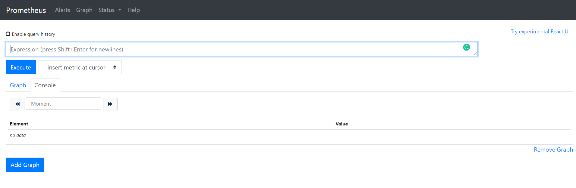

    3. Run the following commands to bring Prometheus up in the Prometheus GUI.

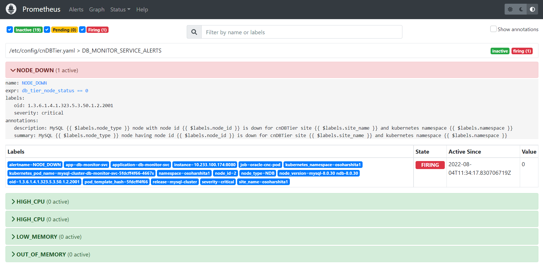

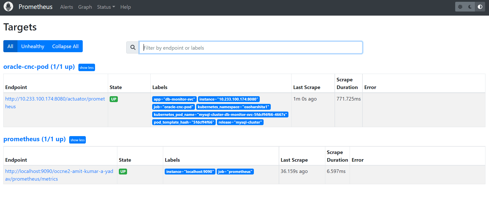

      7. Open Prometheus GUI and verify if the Target is up or not under StatusTargets.

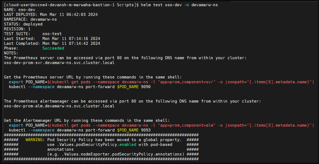

    4. Run the following command to perform a Helm test. Populate the values in the ocoso_csar_25_1_103_0_0_0_prom_custom_values.yaml and ocoso_csar_25_1_103_0_0_0_alm_custom_values.yaml files to run the Helm test.
      $ helm test <release-name> -n <namespace>
      Helm Test can be run for the first time smoothly, but if some issue occurs, and there's a need to re-run the helm test, first you will have to delete the existing test job and repeat the "helm test" command as shown above.
      $ kubectl get jobs.batch -n <namespace>
      $ kubectl delete jobs.batch oso-test -n <namespace>
      Figure 2-1 Helm Test
      Helm Test

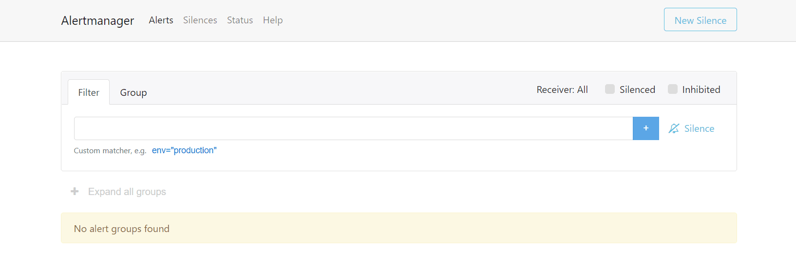

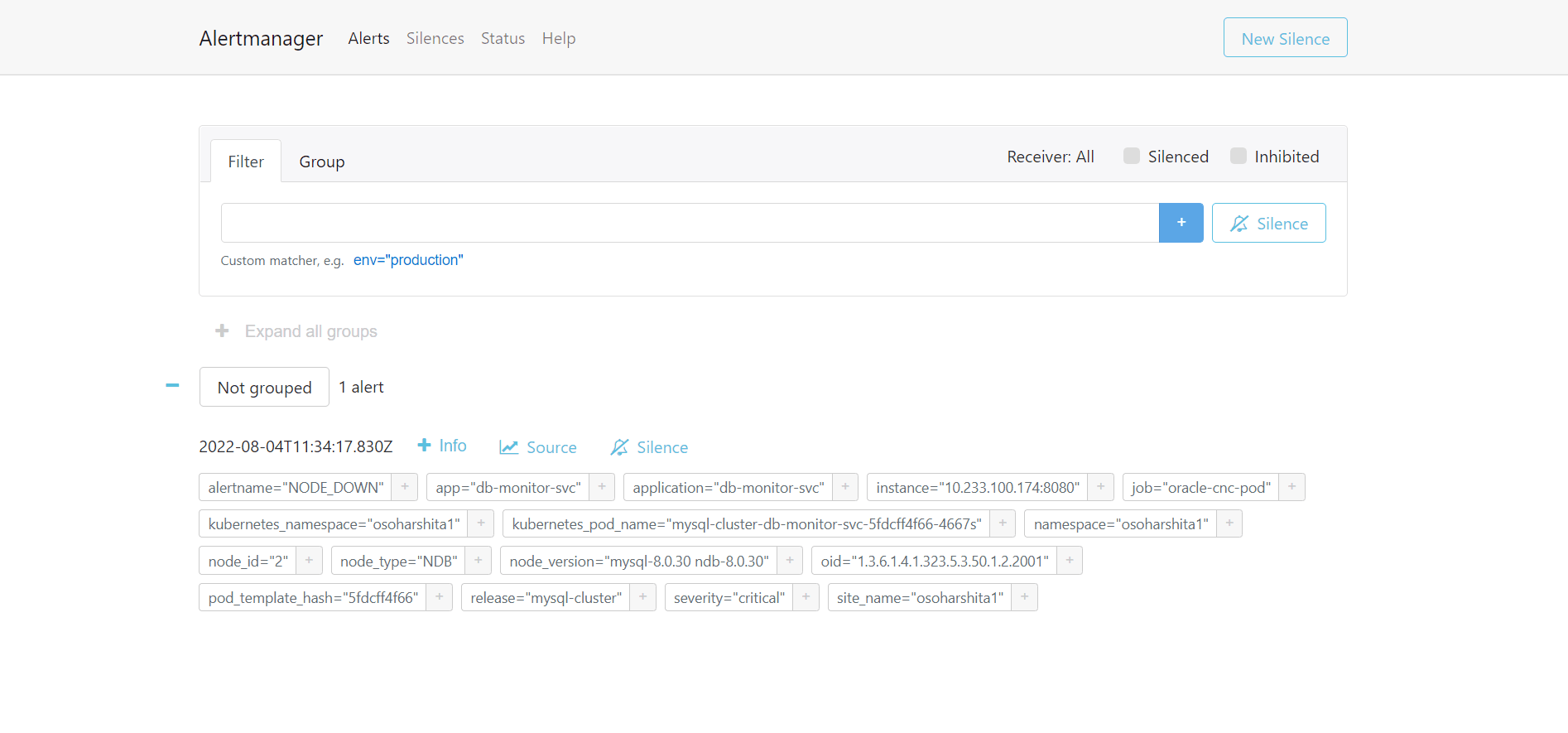

  4. Verify that all the GUIs are accessible.
    Prometheus and Alertmanager GUIs can be accessed only using the CNC Console. For more information about accessing Prometheus and Alertmanager GUIs using CNC Console, see Oracle Communications Cloud Native Configuration Console User Guide.
    If the service is of type LoadBalancer, use EXTERNAL-IP to open the Prometheus GUI. Refer to Step 2 to get the services and their EXTERNAL-IPs.

    Figure 2-2 Prometheus GUI
    Prometheus GUI
    Figure 2-3 Alert Manager GUI
    Alert Manager GUI
  5. On the Prometheus GUI, click Alerts to verify that all the alerts (NF Alerts) are visible.
    OSO Prometheus doesn't have any alerts of its own, therefore the GUI must appear empty initially. You can patch any NF alert rules in this section.

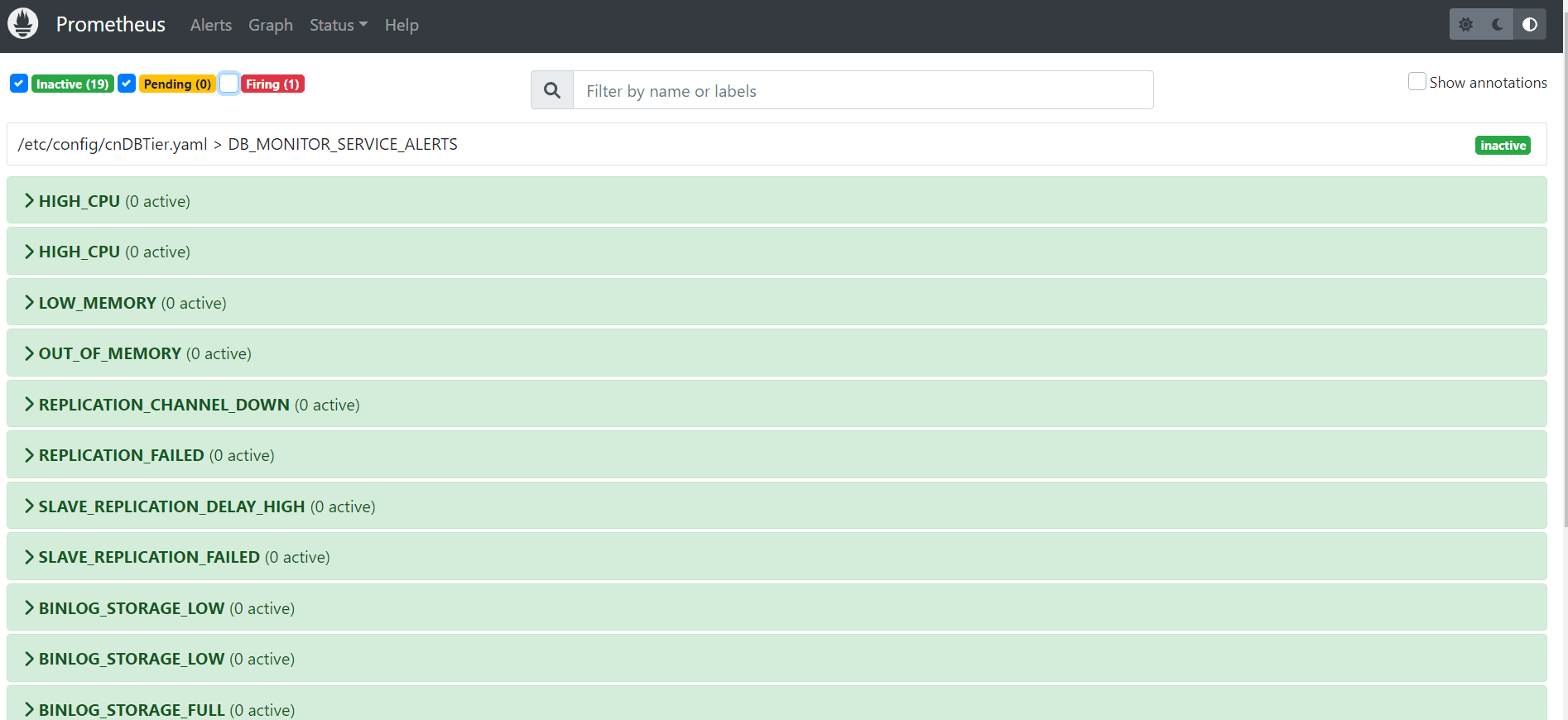

    The following image displays the alerts for cnDBTier:
    Figure 2-4 Prometheus GUI
    Prometheus GUI
    After alerts are raised, the GUI must display the triggered alerts as shown in the following image:
    Figure 2-5 Prometheus GUI - Alerts
  6. Select Alerts tab on the Alertmanager GUI to view the triggered alerts as shown in the following image:
    Figure 2-6 Alertmanager - Alerts

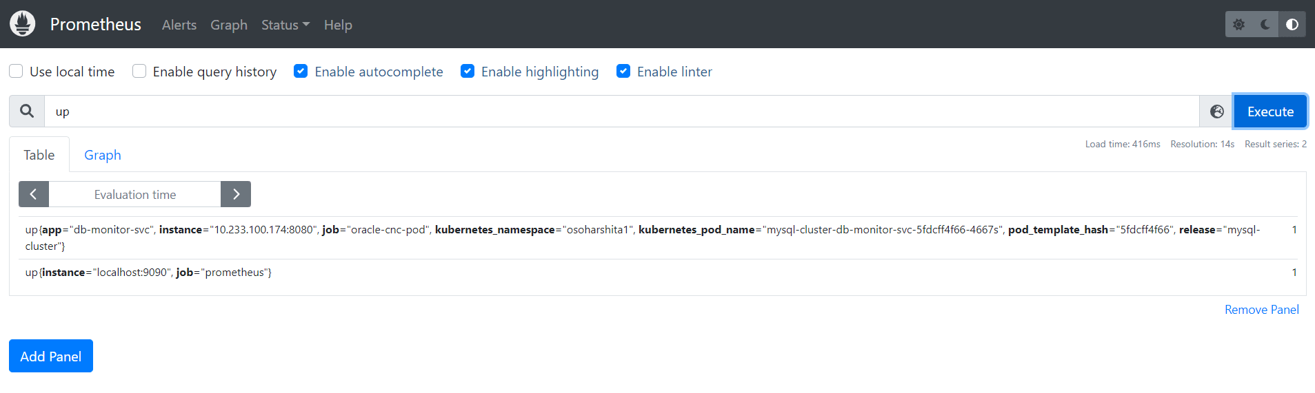

  7. On the Prometheus GUI, click Graph to verify if the expected metrics (example, NF Metrics) are displayed. The following image displays a sample Prometheus Graph with metrics:
    Figure 2-7 Prometheus Graph
    Prometheus Graph
  8. On the Prometheus GUI, navigate to Status and then click Target to verify if the configured targets are displayed.
    The following image shows Prometheus targets that are being extracted:
    Figure 2-8 Prometheus Target
    Prometheus Target
