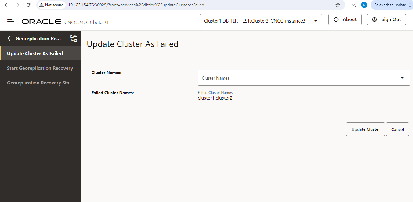

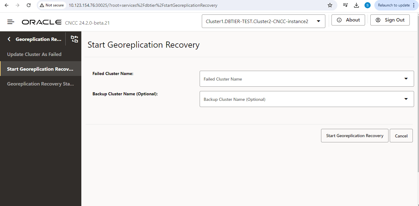

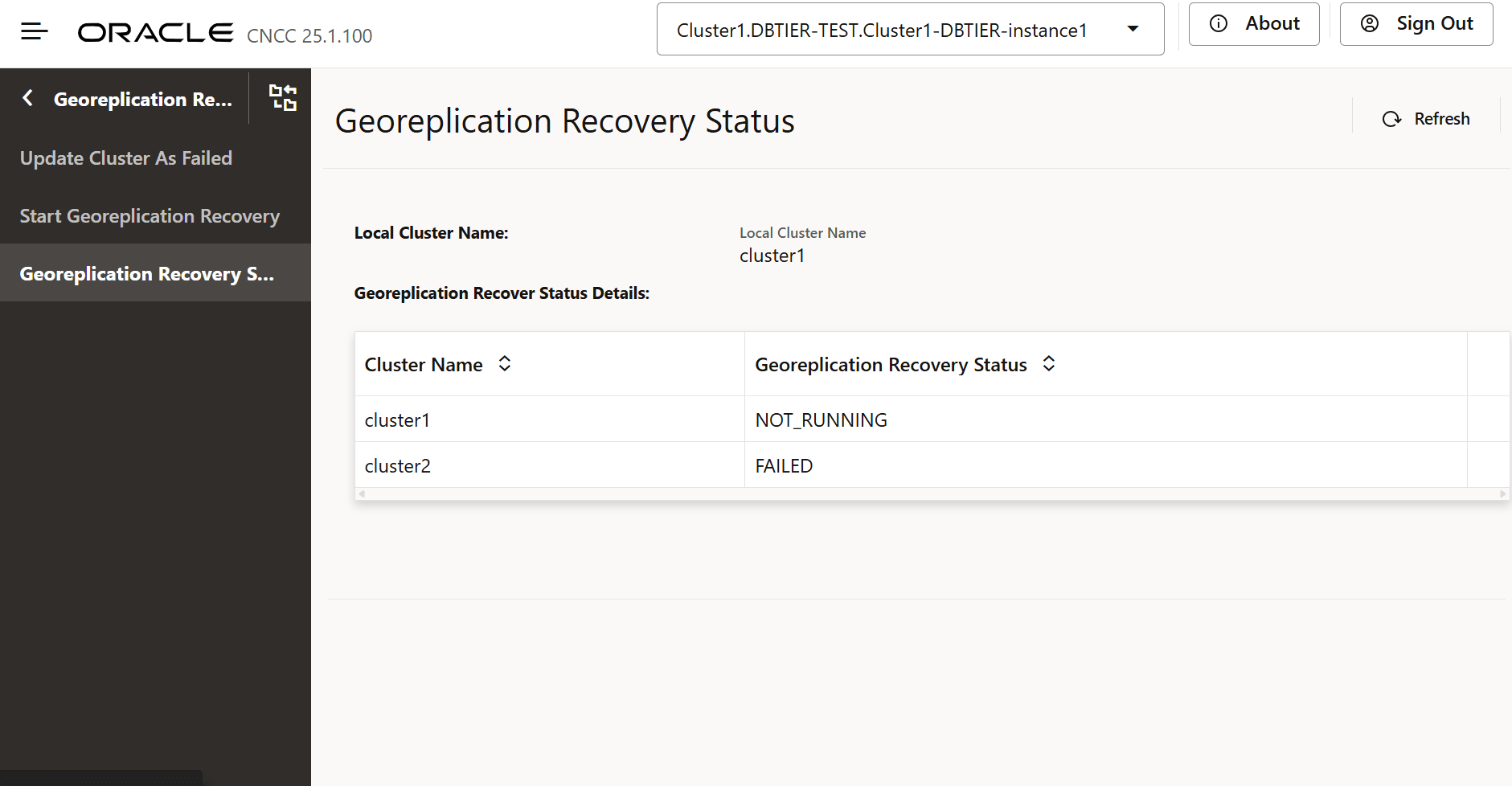

7.4.1 Restoring GR Failures Using cnDBTier GRR APIs
This chapter describes the procedures to restore Georeplication (GR) failures using cnDBTier Georeplication Recovery (GRR) APIs. For more information about the GRR APIs, see Georeplication Recovery APIs.
7.4.1.1 Two-Cluster Georeplication Failure
This section provides the procedures to recover georeplication failure in two-cluster georeplication deployments.
7.4.1.1.1 Resolving GR Failure Between cnDBTier Clusters in a Two-Cluster Replication
This section describes the procedure to resolve a georeplication failure between cnDBTier clusters in a two-cluster replication using cnDBTier georeplication recovery APIs.
Assumptions:
  • The failed cnDBTier cluster has a replication delay impacting the NF functionality, with respect to other cnDBTier cluster or has some fatal errors which require to be reinstalled.
  • All cnDBTier clusters (cnDBTier cluster1 and cnDBTier cluster2) are in a healthy state, that is, all database nodes (including management node, data node, and API node) are in a Running state if their is only a replication delay and no fatal errors exist in the cnDBTier cluster which needs to be restored.

    3. Select Update Cluster As Failed.
    4. From the Cluster Names drop-down, select the cluster that you want to mark as failed and click Update Cluster.
      The Cluster Names drop-down displays all the clusters that are part of the replication setup (cluster1, cluster2, and cluster3). When you select a cluster and click Update Cluster, the selected cluster name gets updated in the Failed Cluster Names field.
      For example, if you want to mark cluster1 and cluster2 as failed, then perform the following steps:
      1. Select cluster1 from the Cluster Names drop-down and click Update Cluster. The system displays cluster1 in the Failed Cluster Names field.
      2. Select cluster2 from the Cluster Names drop-down and click Update Cluster. The system displays both cluster1 and cluster2 in the Failed Cluster Names field.
      You can use the similar steps to update the status in the other combinations of clusters as well. The following image shows a sample Update Cluster As Failed page where cluster1 and cluster2 are marked as failed clusters:
      Figure 7-5 Update Cluster1 and Cluster2 As Failed

        1. On CNC Console, expand cnDBTier under the NF menu and select Georeplication Recovery.
        2. Select Start Georeplication Recovery. The following image shows a sample Start Georeplication Recovery page:
          Figure 7-6 Start Georeplication Recovery
        3. From the Failed Cluster Name drop-down, select the failed cluster that you want to restore.
          For example, if cluster1 is the first failed cluster that needs to be restored, then select cluster1.
        4. [Optional]: From the Backup Cluster Name (Optional) drop-down, select one of the healthy clusters from which the system can use the backup to restore the failed cluster. If this option is not selected, the system uses the backup from the first available healthy cluster.
        5. Click Start Georeplication Recovery.
  6. Wait until database is restored in the first failed cnDBTier cluster and georeplication recovery procedure is completed.
    Check the cluster status using Verifying cnDBTier Cluster Status Using CNC Console procedure after the cnDBTier cluster is UP and continue monitoring the georeplication recovery status.
    Follow Monitoring Georeplication Recovery Status Using CNC Console procedure to monitor the georeplication recovery status.
          Figure 7-7 Start Georeplication Recovery
          For example, if cluster2 is the second failed cluster that needs to be restored, then select cluster2.

  2. Perform the following steps to update the cluster status as FAILED:
    1. Log in to CNC Console GUI of the active cluster.
    2. Expand cnDBTier under the NF menu and select Georeplication Recovery.
      The drop-down displays the clusters that are part of the replication setup (cluster1, cluster2, cluster3, and cluster4). The selected cluster name is updated in the Failed Cluster Names field. For example, if you selected cluster1 to be marked as failed, then on clicking Update Cluster, cluster1 is updated in the Failed Cluster Names field.
      The following image shows a sample Update Cluster As Failed page where cluster1 is marked as a failed cluster:
      Figure 7-8 Update Cluster As Failed
          Figure 7-9 Start Georeplication Recovery
          For example, if cluster1 is the failed cluster that needs to be restored, then select cluster1.
      The Cluster Names drop-down displays all the clusters that are part of the replication setup (cluster1, cluster2, cluster3, and cluster4). When you select a cluster and click Update Cluster, the selected cluster name gets updated in the Failed Cluster Names field.
      Figure 7-10 Update Cluster1 and Cluster2 As Failed
      For example, if you want to mark cluster1, cluster2, and cluster 3 as failed, then perform the following steps:
      2. Select cluster2 from the Cluster Names drop-down and click Update Cluster. The system displays cluster1 and cluster2 in the Failed Cluster Names field.
      3. Select cluster3 from the Cluster Names drop-down and click Update Cluster. The system displays cluster1, cluster2, and cluster3 in the Failed Cluster Names field.
      You can use the similar steps to update the status in the other combinations of clusters as well. The following image shows a sample Update Cluster As Failed page where cluster1, cluster2, and cluster3 are marked as failed clusters:
      Figure 7-11 Update Cluster1, Cluster2, and Cluster3 As Failed
