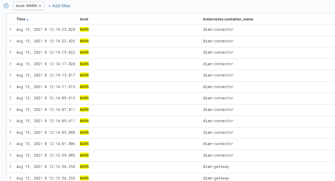

A log level helps in defining the severity level of a log message. Using this information, the logs can be filtered based on the system requirements. For instance, if you want to filter the critical information about your system from the informational log messages, set a filter to view messages with only WARN log level in Kibana.
As shown in the following image, only log messages with level defined as WARN are shown, after adding filter:Filtering logs in Kibana according to log level

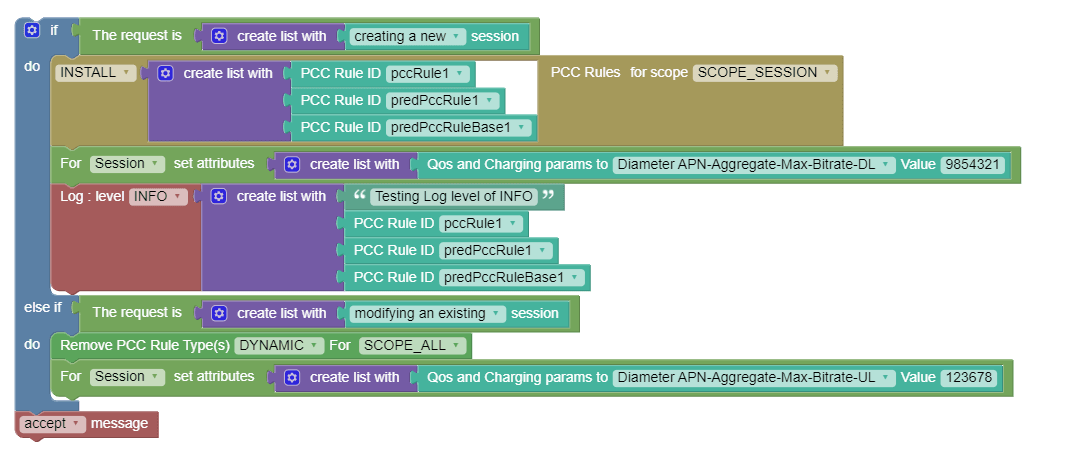

While managing Policy Projects, users can use the Log block to log a message or the value of a policy variable in the logging system.
The logged message can subsequently be viewed in Kibana (or other logging) GUI.
The following is a sample policy and the associated log message added in PRE:Sample Policy including Log Block
