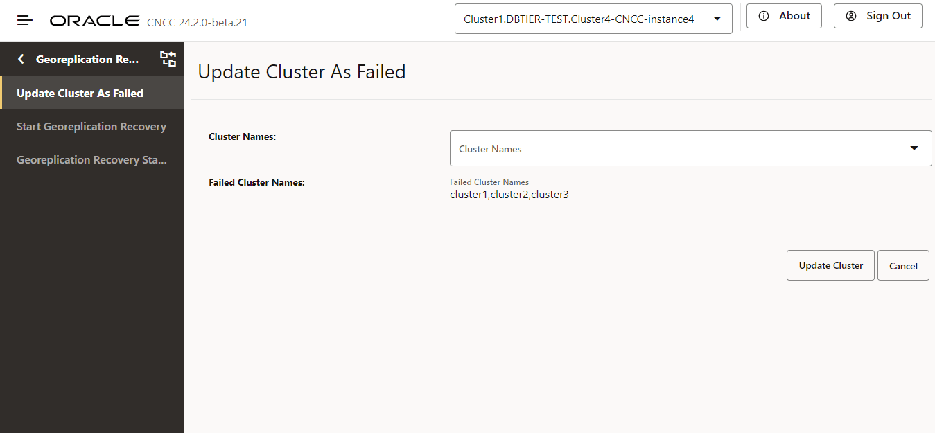

  2. Perform the following steps to update the cluster status as FAILED:
    1. Log in to CNC Console GUI of the active cluster.
    2. Expand cnDBTier under the NF menu and select Georeplication Recovery.
    3. Select Update Cluster As Failed.
    4. From the Cluster Names drop-down, select the cluster that you want to mark as failed and click Update Cluster.
      The drop-down displays the clusters that are part of the replication setup (cluster1 and cluster2). When you select a cluster and click Update Cluster, the selected cluster name is updated in the Failed Cluster Names field.
      For example, if you selected cluster1 to be marked as failed, then on clicking Update Cluster, cluster1 is updated in the Failed Cluster Names field.
      The following image shows a sample Update Cluster As Failed page where cluster1 is marked as a failed cluster:
      Figure 7-1 Update Cluster As Failed
      The drop-down displays the clusters that are part of the replication setup (cluster1, cluster2, cluster3, and cluster4). The selected cluster name is updated in the Failed Cluster Names field. For example, if you selected cluster1 to be marked as failed, then on clicking Update Cluster, cluster1 is updated in the Failed Cluster Names field.
      Figure 7-8 Update Cluster As Failed
      The Cluster Names drop-down displays all the clusters that are part of the replication setup (cluster1, cluster2, cluster3, and cluster4). When you select a cluster and click Update Cluster, the selected cluster name gets updated in the Failed Cluster Names field.
      For example, if you want to mark cluster1, cluster2, and cluster 3 as failed, then perform the following steps:
      1. Select cluster1 from the Cluster Names drop-down and click Update Cluster. The system displays cluster1 in the Failed Cluster Names field.
      2. Select cluster2 from the Cluster Names drop-down and click Update Cluster. The system displays cluster1 and cluster2 in the Failed Cluster Names field.
      3. Select cluster3 from the Cluster Names drop-down and click Update Cluster. The system displays cluster1, cluster2, and cluster3 in the Failed Cluster Names field.
      You can use the similar steps to update the status in the other combinations of clusters as well. The following image shows a sample Update Cluster As Failed page where cluster1, cluster2, and cluster3 are marked as failed clusters:
      Figure 7-11 Update Cluster1, Cluster2, and Cluster3 As Failed
