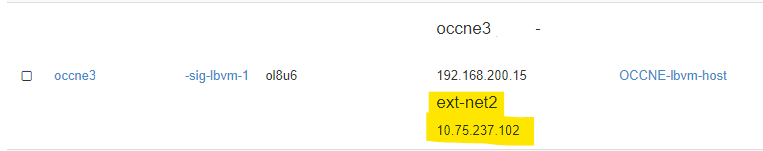

    2. Log in to the OpenStack GUI and validate if the new pool LBVMs are created and the new external egress port is attached to the Active LBVM.
      Verify External Network in OpenStack GUI
