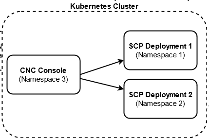

4.1 Support for Multicluster Deployment
The CNC Console supports both single and multiple cluster deployments.
In a single cluster deployment, the CNC Console can manage NFs and Oracle Communications Cloud Native Environment (OCCNE) common services deployed in the local Kubernetes clusters.
In a multicluster deployment, the CNC Console can manage NFs and OCCNE common services deployed in the remote Kubernetes clusters. For more information about single and multiple cluster deployments, see Oracle Communications Cloud Native Configuration Console Installation, Upgrade, and Fault Recovery Guide .
With the support of multicluster deployment, a single instance of the CNC Console can configure two or multiple instances of SCP deployments if both CNC Console and SCP instances are deployed in the same Kubernetes cluster with different namespaces.
The following image represents a Kubernetes cluster with one instance of CNC Console and two instances of SCP. The single instance of the CNC Console is configuring two instances of SCP with different namespaces.
Figure 4-1 Support for Multicluster Deployment

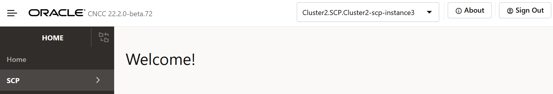

    The CNC Console Home page appears.
    Figure 4-2 CNC Console Welcome Screen
  5. In the upper pane, from the Please Select Instance drop-down list, select the required SCP instance.
    The SCP tab appears in the left navigation pane.
    Figure 4-3 Select NF Instance
    Select NF Instance
    The Please Select Instance drop-down list provides NF instances to configure corresponding NF features. You must select an appropriate SCP instance to configure SCP features. Alternatively, you can click one of the following interface elements on the Welcome screen:

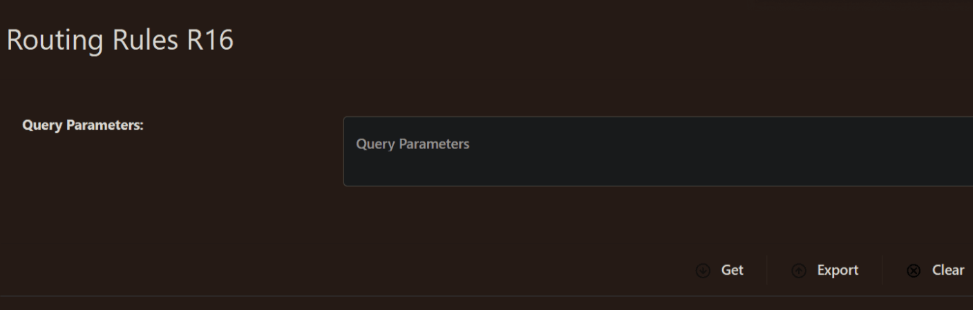

In all the Query Parameters fields, do not enter keys or values in single or double quotes. For example, the "nfType"="UDM" query parameter must be entered as nfType=UDM.

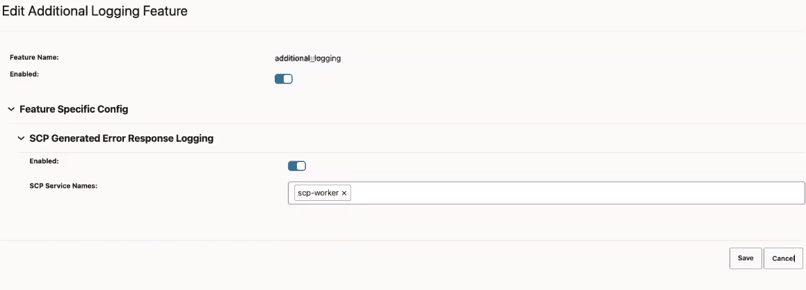

4.2.1.1 Configuring the Log Enhancement Feature
Perform the following procedure to enable additional logging and subscriber ID in error logs.
  1. From the left navigation pane, click the SCP tab, and then click the SCP Features tab.
  2. To enable additional logging, from the SCP Features list, click the Additional Logging tab.
    1. On the Additional Logging Feature page, click the Edit icon.
      Figure 4-4 Additional Logging Feature
    2. To enable additional logging and add additional log attributes to error logs, set the Enabled option to true for additional_logging.
      By default, the Enabled option is set to false.
    3. In the SCP Generated Error Logging section, set the Enabled option to true.
      Additional log attributes are appended to error response logs generated by SCP when the Enabled options of additional_logging and SCP Generated Error Logging are set to true.
    4. Set the SCP Service Name field to one of the following options:
      • scp-worker: Adds additional logging attributes to SCP-Worker logs.
      • ALL: Adds additional logging attributes to all services logs when SCP enhances this feature to support all microservices. In this release, it supports only SCP-Worker.
      • This field value cannot be null.
      • Do not set this field to any other microservice when it is set to ALL.
    5. Click Save.

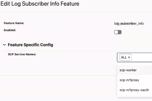

  3. To enable log subscriber information, do the following:
    1. From the SCP Features list, click the Log Subscriber Info tab.
    2. On the Log Subscriber Info Feature page, click the Edit icon.
      Figure 4-5 Log Subscriber Info Feature
    3. To enable log subscriber info and add subscriber ID to error logs, set the Enabled option to true for log_subscriber_info.
    4. Set the SCP Service Name field to ALL or to any one or combinations of the following options:
      • scp-worker: Adds subscriber ID to SCP-Worker logs.
      • scp-nrfproxy: Adds subscriber ID to SCP-nrfProxy logs.
      • scp-nrfproxy-oauth: Adds subscriber ID to SCP-nrfproxy-oauth logs.
  4. Click Save.

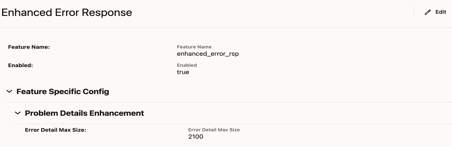

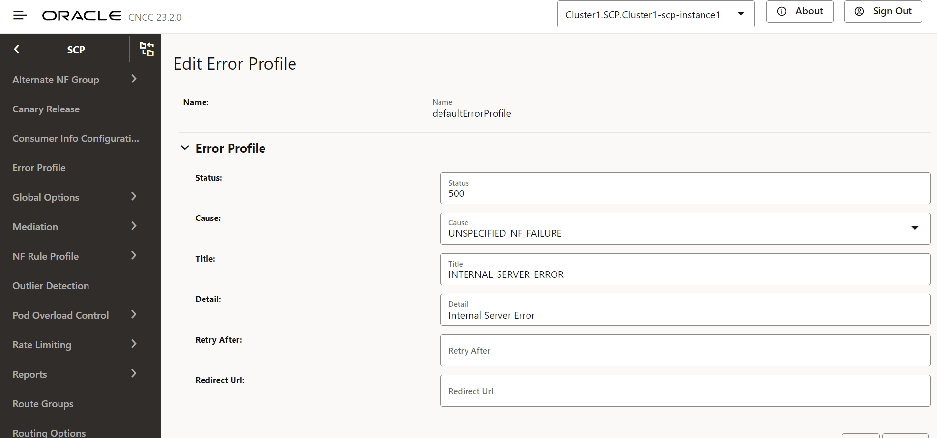

4.2.1.2 Configuring Error Response Enhancement
Perform the following procedure to enable or disable the Error Response Enhancement feature.
  2. From the SCP Features list, click the Enhanced Error Response tab.
  3. On the Enhanced Error Response page, click the Edit icon.
    By default, the Enabled option is set to false for enhanced_error_rsp. If this option is set to true, SCP combines all the error responses from both internal and external sources.
    Figure 4-6 Error Response Enhancement
  4. In the Error Detail Max Size, set the limit of the error string.
    This field manages the maximum length limit of the compiled error string in the detail parameter of problemDetails as described in "Configuring SCP Features" in Oracle Communications Cloud Native Core, Service Communication Proxy REST Specification Guide. SCP truncates the error string from end if the compiled string is greater than the maximum limit. The default value is 2100.
  5. Click Save.

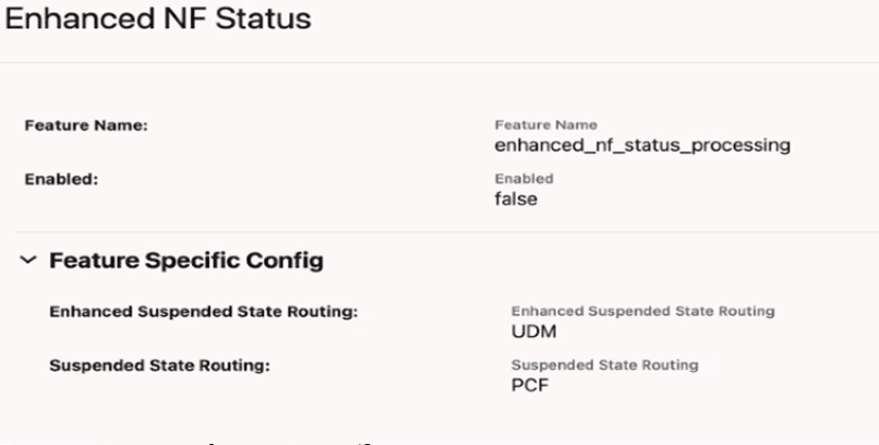

4.2.1.3 Configuring Enhanced NF Status Processing
Perform the following procedure to enable the support for creating or retaining SCP routing rules for NF Profiles with NF Status as SUSPENDED.
The Enhanced NF Status Processing feature is applicable only when nnrf-nfm (NRF Management) service is used as an audit service for SCP.
  1. In the left navigation pane, click the SCP tab, and then click the SCP Features tab.
  2. From the SCP Features list, click Enhanced Nf Status Processing.
  3. In the Enhanced NF Status section, click Edit.
    Figure 4-7 Editing Enhanced Nf Status Processing
  4. Set Enabled to true.
    By default, this option is set to false.
  5. In the Feature Specific Config section, configure the following fields as required:
    • Enhanced Suspended State Routing: Enter the list of valid NF types for Mode 3 routing.
    • Suspended State Routing: Enter the list of valid NF types for Mode 2 routing.
  6. Click Save.

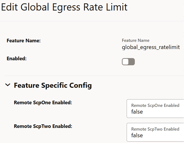

4.2.1.4 Configuring Global Egress Rate Limiting
Perform the following procedure to configure global egress rate limiting.
  1. In the left navigation pane, click the Global Egress Rate Limiting tab.
  2. In the Global Egress Rate Limit section, click Edit.
    The Edit Global Egress Rate Limit screen appears.
    Figure 4-8 Enabling the Global Egress Rate Limiting
  3. Set Enabled to true.
  4. In the Feature Specific Config section, configure the following fields:
    • Remote ScpOne Enabled: Set this field to true if you want to enable egress rate aggregation with the SCP instance as defined in the coherence.federation.remoteScpOne parameter of the ocscp-custom-values.yaml file. By default, this value is set to false.
    • Remote ScpTwo Enabled: Set this field to true if you want to enable egress rate aggregation with the SCP instance as defined in the coherence.federation.remoteScpTwo parameter of the ocscp-custom-values.yaml file. By default, this value is set to false.
  5. Click Save.

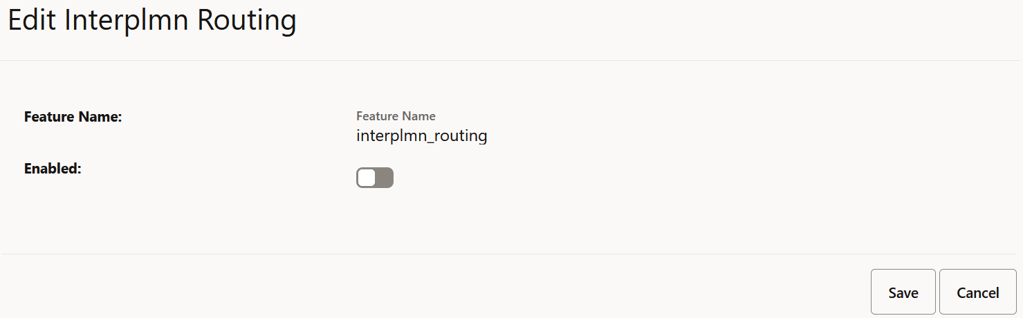

4.2.1.5 Configuring Support for 5G SBI Roaming
Perform the following procedure to configure support for 5G SBI roaming.
Ensure that one local and one remote PLMNs are configured before enabling this feature. To configure a remote PLMN, see Configuring SEPP Inter PLMN Routing. A local PLMN is configured at the time of SCP deployment or by editing the CUSTOM_ORACLE_SCP NF type as described in Configuring NF Rule Profile.
  1. In the left navigation pane, click the Interplmn Routing tab.
  2. In the Interplmn Routing section, click Edit.
    The Edit Interplmn Routing screen appears.
    Figure 4-9 Inter PLMN Routing
    Inter PLMN Routing
  4. Click Save.

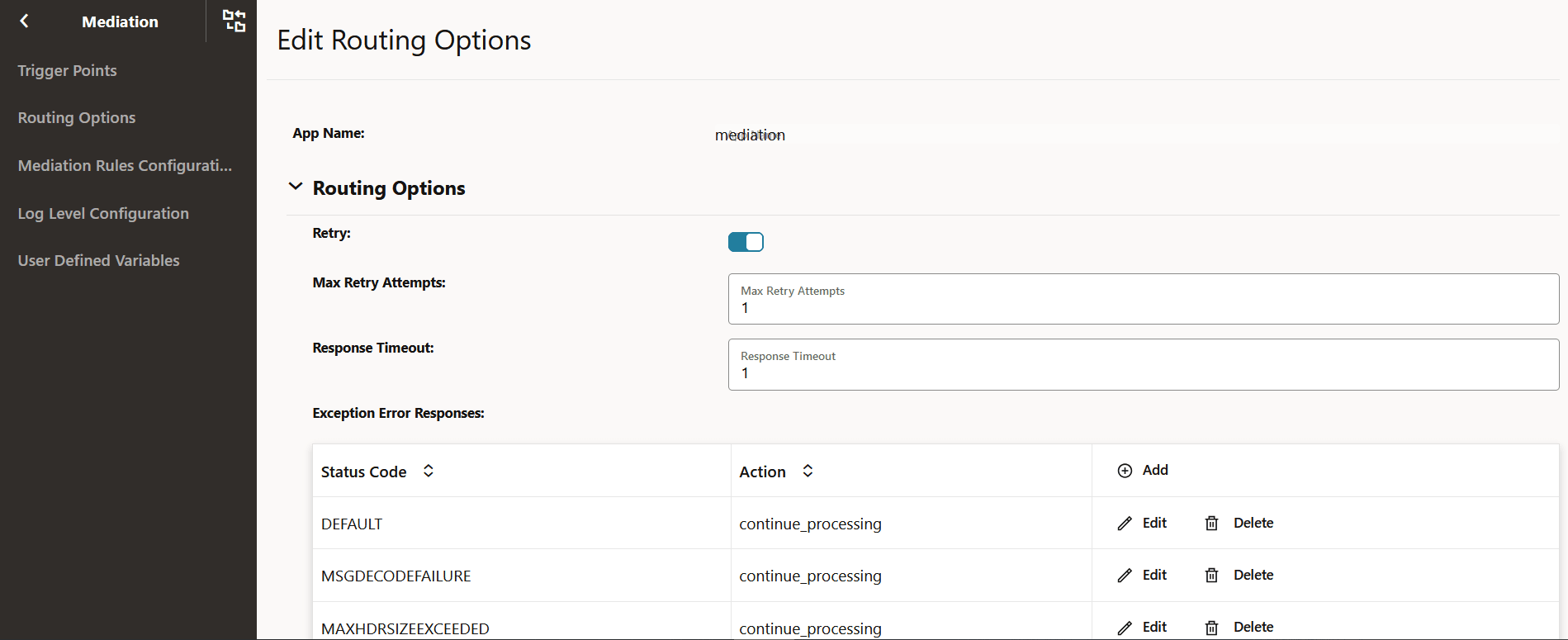

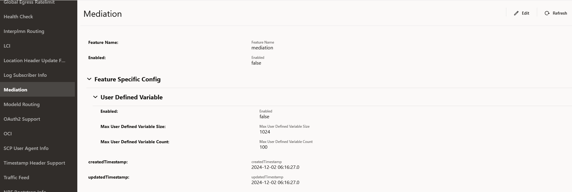

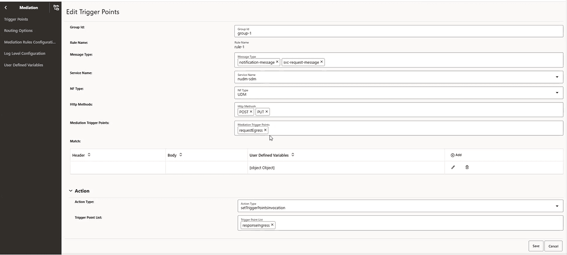

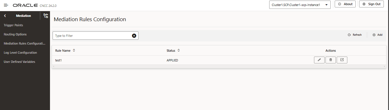

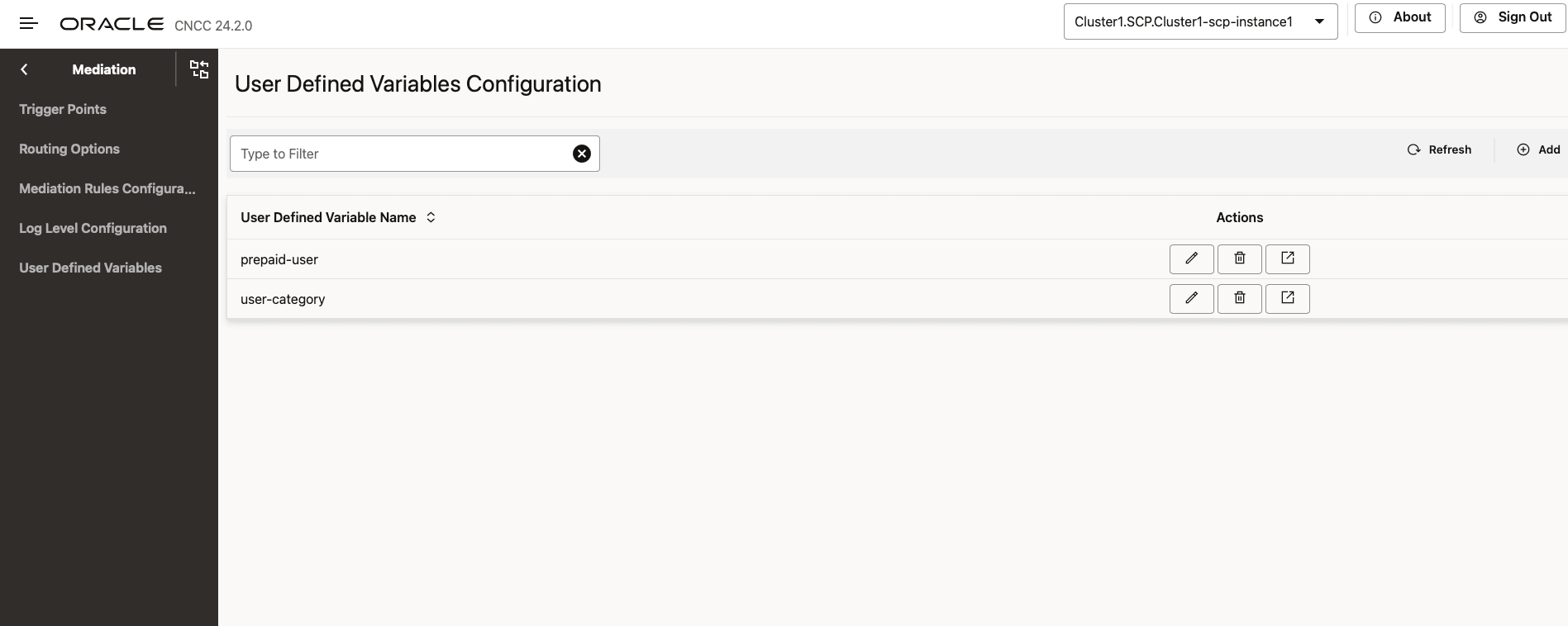

4.2.1.6 Configuring Mediation
Perform the following to configure mediation.
  2. To enable mediation, from the SCP Features list, click the Mediation tab.
  3. In the Mediation section, click Edit.
    The Edit Mediation screen appears.
    Figure 4-10 Enable Mediation
    This screen allows you to enable mediation feature.
  5. In the Feature Specific Config section, configure the following fields:
    • Set the Enabled true for enabling the User Defined Variable feature.
      If the User Defined Variable feature is enabled and any mediation rules are in the Applied state, the enabled field cannot be set back to false until all Applied rules are returned to DRAFT state.
    • Set the maxUserDefinedVariableSize field to define the overall max size of all user defined variables included in the request or response body for mediation.
      • Default Value: 1024
      • Range: 512 - 4096
    • Set the maxUserDefinedVariableCount field to define the total number of user defined variables that can be configured for usage at User Defined Variables API.
      • Default Value: 100
      • Range: 1-250
      If userDefinedVariables are added through the User Defined Variables API, the maxUserDefinedVariableCount cannot be set to a value lower than the number of userDefinedVariables currently stored in the database.
  6. Click Save.

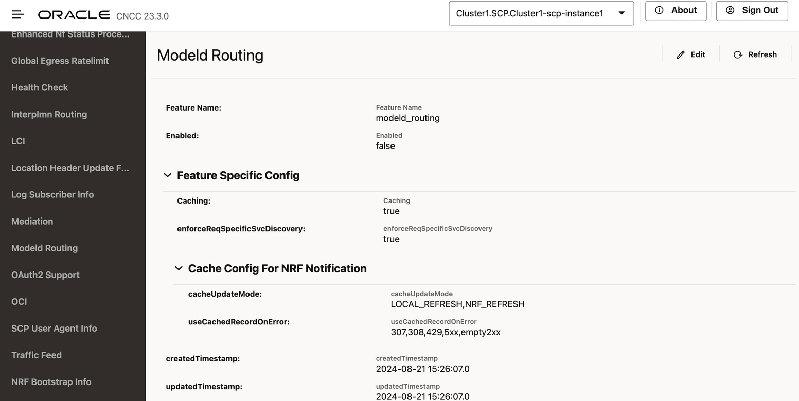

4.2.1.7 Configuring Model D Indirect 5G SBI Communication feature
Perform the following to configure Model D indirect 5G SBI communication feature.
  1. In the left navigation pane, click the Modeld Routing tab.
  2. In the Modeld Routing section, click Edit.
    Figure 4-11 Enabling ModelD Routing
    This screen allows you to enable Model D Routing feature.
    The Edit Modeld Routing screen appears.
  4. Set Caching to true or false to enable or disable caching to store discovery responses. By default, this option is set to true.
  5. Set enforceReqSpecificSvcDiscovery to true or false to to enable or disable NF Service specific Discovery Requests when possible. By default, this option is set to true.
  6. In the Cache Config For NRF Notification section, configure the cacheUpdateMode and useCachedRecordOnError fields accordingly:
    cacheCfgForNrfNotification: Configuration for model-based D cache updates using NRF information.
    It includes two fields: cacheUpdateMode and useCachedRecordOnError.
    • cacheUpdateMode field is a list with three possible values:
      • NONE: No cache update will occur, and the notification will be ignored. Setting the value to "NONE" disables this feature.
      • LOCAL_REFRESH: The cache is updated locally if the NF-profile attribute being modified belongs to the local cache update category. If cacheUpdateMode is set to LOCAL_REFRESH only and the modified attribute requires an NRF discovery update, the notification is ignored.
      • NRF_REFRESH: The cache is refreshed through a new discovery request to NRF if the NF-profile attribute being modified requires an NRF discovery update. If cacheUpdateMode is set to NRF_REFRESH only and the modified attribute requires a local update, the notification is ignored.
    • useCachedRecordOnError field indicates that SCP uses the existing invalid cached response for the defined error codes if it receives an error response from NRF, if the request times out, or if it receives a 2xx response with no profiles.
      • Allowed values: NONE, 5xx, empty2xx, and any valid reroutable error codes defined in the Routing Options section. These include:301, 302, 303, 304, 307, 308, 400, 401, 403, 404, 405, 406, 407, 408, 409, 410, 411, 412, 413, 414, 415, 416, 417, 421, 422, 425, 426, 428, 429, 431, 451, 500, 501, 502, 503, 504, 505, 506, 507, 508, 510, 511.
      • Default values: "307", "308", "429", "5xx", "empty2xx".
      • NONE: This value indicates that no error codes are configured. No other error codes can be used when "NONE" is set.
      • 5xx: Indicates all supported error codes starting with 5.
      • empty2xx: This custom string is defined to handle cases where the NRF discovery response returns a 200 OK status with an empty list of profiles. If this value is configured, SCP will use the old invalid cached response.

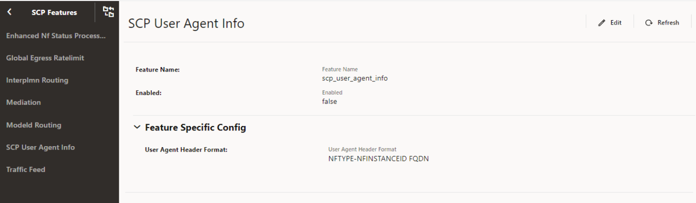

4.2.1.8 Configuring SCP User Agent Info
Perform the following to configure SCP User Agent Info.
  1. In the left navigation pane, click the SCP User Agent Info tab.
  2. In the SCP User Agent Info section, click Edit.
    The SCP User Agent Info screen appears.
    Figure 4-12 SCP User Agent Info
    SCP User Agent Info
  4. Expand the Feature Specific Config option, in the User Agent Header Format field, select the required format to set the "User-Agent" header format.
    For more information about the "User-Agent" header formats, see "Configuring SCP Features" in Oracle Communications Cloud Native Core, Service Communication Proxy REST Specification Guide.
  5. Click Save.

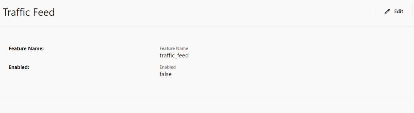

4.2.1.9 Configuring Message Feed
Perform the following to configure message feed.
  1. In the left navigation pane, click the Traffic Feed tab.
  2. In the Traffic Feed section, click Edit.
    The Traffic Feed screen appears.
    Figure 4-13 Message Feed
    Message Feed
  4. Click Save.

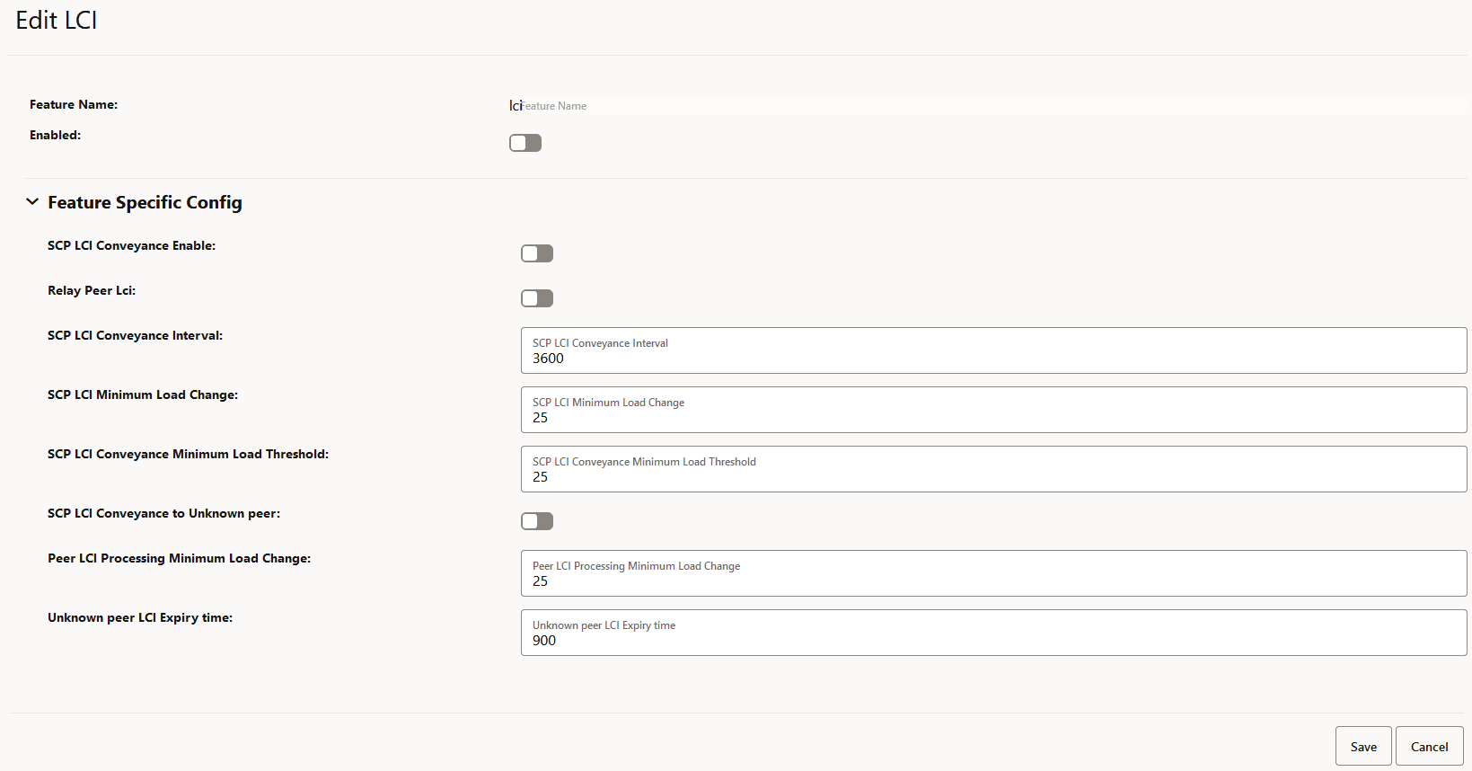

4.2.1.10 Configuring Load Control Information (LCI)
Perform the following procedure to enable configuring load control information (LCI).
  1. In the left navigation pane, click the LCI tab.
  2. In the LCI section, click Edit.
    Figure 4-14 Editing LCI
    Editing LCI
  4. In the Feature Specific Config section, complete the following configurations:
    All the parameters are mandatory to configure the LCI feature.
    • SCP LCI Conveyance Enable: Set to true to enable SCP to add its LCI in request and response.
    • Relay Peer Lci: Set to true to allow SCP to forward the received LCI header from producer NF.
    • SCP LCI Conveyance Interval: Enter a value from 100 milliseconds to 3600000 milliseconds to report the SCP LCI update interval.
    • SCP LCI Minimum Load Change: Enter a value from 0 to 25 to report the minimum delta value when reporting LCI based on load change.
    • SCP LCI Conveyance Minimum Load Threshold: Enter a value from 0 to 60 to set a minimum load change threshold to trigger the generation of an LCI header and its reporting to peers if allowed.
      If the SCP load value is less than the configured SCP LCI Conveyance Minimum Load Threshold value, SCP sends its load value as 0%.
    • SCP LCI Conveyance to Unknown peer: Set to true to allow SCP to send its LCI to an unknown peer NF, a peer NF that is not registered with SCP.
      • SCP sends its LCI in all the messages that go to peer NFs that are not registered with SCP.
      • If the SCP load value is less than the configured SCP LCI Conveyance Minimum Load Threshold value, SCP sends its load value as 0%.
    • Peer LCI Processing Minimum Load Change: Enter a value from 0 to 25 to define a minimum load change threshold in peer NF's load as indicated in LCI, which can trigger a re-evaluation of routing rules.
    • Unknown peer LCI Expiry time: Enter a value between 30 seconds to 900 second to set the minimum number of seconds required to remove an unknown peer's LCI from cache.
  5. Click Save.

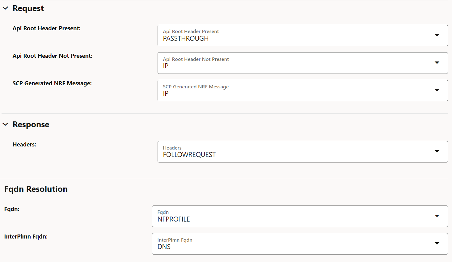

4.2.1.11 Configuring Host Preference for Egress Message Requests
Perform the following procedure to configure host preference for egress message requests.
  1. In the left navigation pane, click the Egress Host Preference tab.
  2. In the Egress Host Preference section, click Edit.
    Figure 4-15 Editing Egress Host Preference
  4. In the Feature Specific Config section, to configure the host preference, set the following fields as described in the following table:
    Table 4-1 Host Preference
    Field Name Description
    Api Root Header Present This parameter indicates the host preference (":authority" header) for egress message requests if the 3gpp-Sbi-Target-apiRoot header is present in the ingress message request.
    You can set this field to PASSTHROUGH to use the same type of host in egress message requests as received through ingress message requests.
    Default value: PASSTHROUGH
    Range: IP, FQDN, or PASSTHROUGH
    Api Root Header Not Present This parameter indicates the host preference (":authority" header) for egress message requests if the 3gpp-Sbi-Target-apiRoot header is absent in ingress message requests.
    Default value: IP
    Range: IP or FQDN
    SCP Generated NRF Message This parameter indicates the host preference (":authority" header) for SCP generated NRF messages.
    Default value: IP
    Range: IP or FQDN
    Fqdn This parameter indicates the resolution preference of egress message requests host FQDN if present.
    Default value: NFPROFILE
    Range: DNS or NFPROFILE
    InterPlmn Fqdn This parameter indicates the resolution preference of egress message requests inter-plmn FQDN if present.
    Default value: DNS
  5. Click Save.

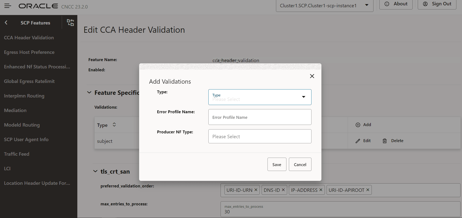

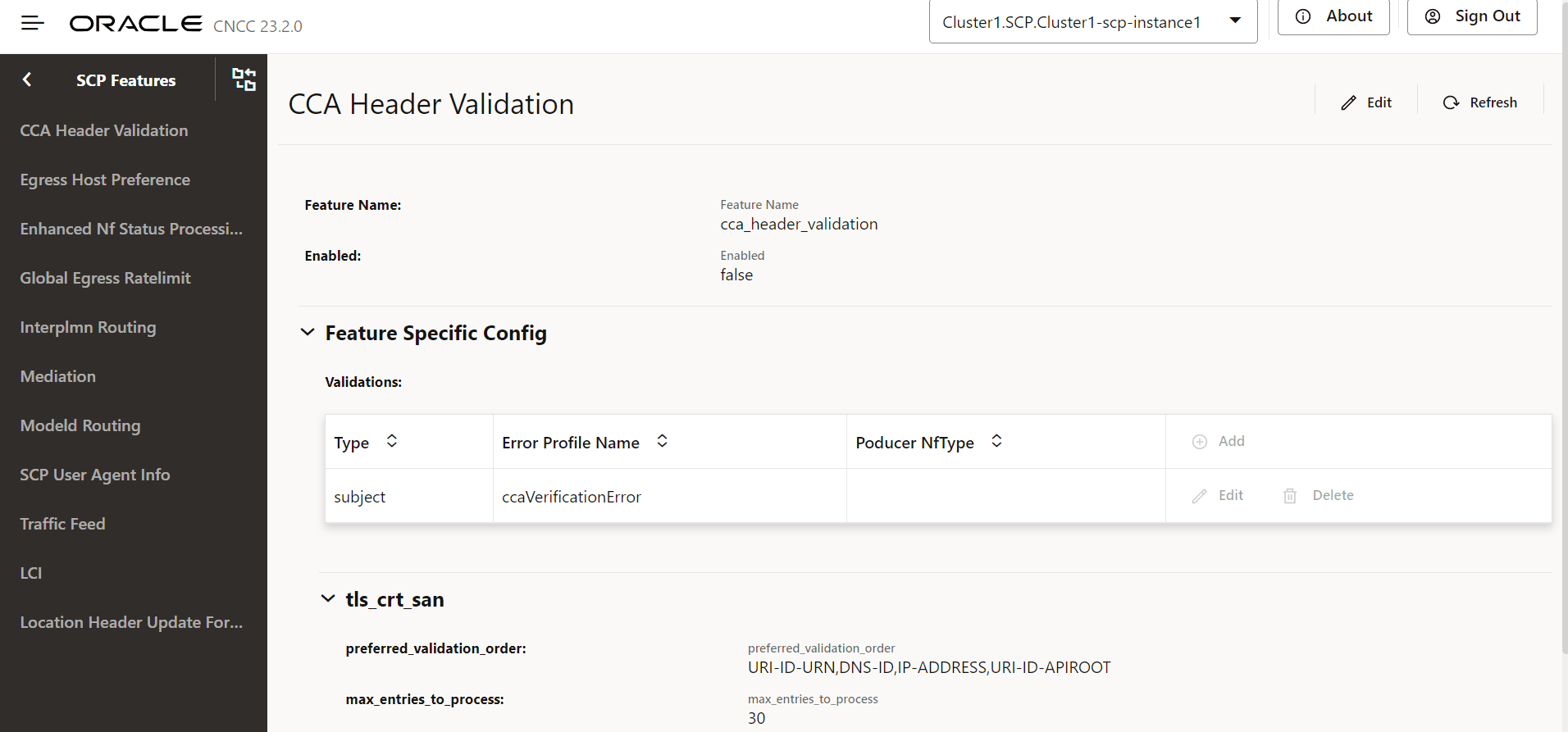

4.2.1.12 Configuring CCA Header Validation
Perform the following option to configure CCA Header validation.
  1. In the left navigation pane, click the CCA Header Validation tab.
  2. In the CCA Header Validation section, click Edit.
    Figure 4-16 Edit CCA Header Validation
    SCP supports the 3gpp-Sbi-Client-Credentials header with x5c - X.509 URL, not x5u - X.509 URL.
  4. In the Feature Specific Config section, to configure the validations, set the following fields as described in the following table:
    Table 4-2 Validations
    Type Type of validation:
    • headerPresence: SCP checks the presence of the 3gpp-Sbi-Client-Credentials header in the ingress request.
      • Validation will pass if the header is present.
      • Validation will fail if the header is not present.
    • subject: SCP checks the NF instance ID from the "sub" parameter in the 3gpp-Sbi-Client-Credentials header with the NF instance ID from the list of SANs in the client's TLS certificate. SANs directly have the NF Instance Id or the client's other identity, like the FQDN or IP address, which will be used to get the NF Instance Id. If the 3gpp-Sbi-Client-Credentials header is not present, then this validation will not be performed.
      • Validation will pass if the NF instance ID from the "sub" parameter matches the NF instance ID from the SAN.
      • Validation will fail if the NF instance ID from the "sub" parameter doesn't match the NF instance ID from the SAN.
    Error Profile Name The error profile name is used to generate an error response if the corresponding validation fails. Error profiles can be configured using the REST API: /ocscp/scpc-configuration/{version}/errorProfileConfig.
    Product NF Type Default Value: Null
    preferred_validation_order An order format-wise from which the SCP picks SAN from the client's TLS certificate for verification of the "subject" type of validation.
    Note: Applicable only when validation type "subject" is selected.
    max_entries_to_process Maximum number of SANs from the client's TLS certificate that SCP picks for validation.
  5. Click Add to add validations:
    Figure 4-17 Add Validations
    Add Validations
  6. Click Save.

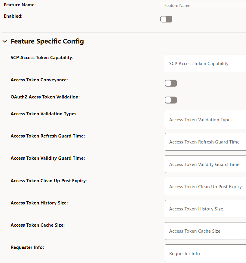

4.2.1.14 Configuring Support for OAuth2.0
Perform the following the procedure to configure support for OAuth2.0.
  1. In the left navigation pane, click the OAuth2 Support tab.
  2. In the OAuth2 Support section, click Edit.
    Figure 4-19 OAuth2 Support
    OAuth2 Support
    Table 4-3 Configure Access Token
    SCP Access Token Capability This field indicates Access token support for the listed indirect communication modes at SCP. (ENUM).
    Possible values: [INDIRECT_COM_WITH_DELEG_DISC, INDIRECT_COM_WITHOUT_DELEG_DISC]
    • INDIRECT_COM_WITH_DELEG_DISC: SCP initiates access token request toward NRF in delegated discovery service request.
    • INDIRECT_COM_WITHOUT_DELEG_DISC: SCP is expected to forward the service request with or without access token as per configuration at SCP. SCP is not expected to initiate access token request toward NRF.
    Access Token Conveyance
    This field conveys acquired access token in the "3gpp-Sbi-Access-Token" header in service response to consumer NFs.
    • Default value: true
    • Range: true or false
    OAuth2 Access Token Validation This field enables or disables validation of OAuth2 access token from consumer NFs.
    • Default value: Disabled
    • Range: Disabled or Enabled
    Access Token Validation Types This field configures the list of required validation types in the network.
    • Default value: empty as default
    Access Token Refresh Guard Time This field initiates proactive refresh of cached access token when the configured time expires. The proactive refresh occurs if the relevant SBI messages are in exchange.
    • Default value: 60000ms
    • Range: 100ms - 300000ms
    Access Token Validity Guard Time This field indicates the time before the access token expiry when SCP considers not to use the existing access token and obtains new access token in the service request forwarded to producer NFs.
    • Default value: 30000ms
    Access Token Clean Up Post Expiry This field indicates the duration to purge the token from cache.
    • Default value: 900000ms
    • Range: 0ms - 3600000ms
    Access Token History Size This field indicates the number of access tokens signature history to identify whether the access token initiated by SCP or not.
    • Default value: 10 records
    • Range: 0 - 20 records
    Access Token Cache Size This field indicates the number of access tokens that can be cached in SCP.
    • Default value: 50000 records
    • Range: 5000 - 100000 records
    Requester Info This field indicates access token requester (consumer NF) Info to generate the access token request.
    • Prioritized list of default values:
      1. DISCOVERY-HEADERS
      2. CCA-HEADER
      3. USER-AGENT-HEADER
    Cache Enabled This option enables or disables caching of access tokens.
  5. Click Save.

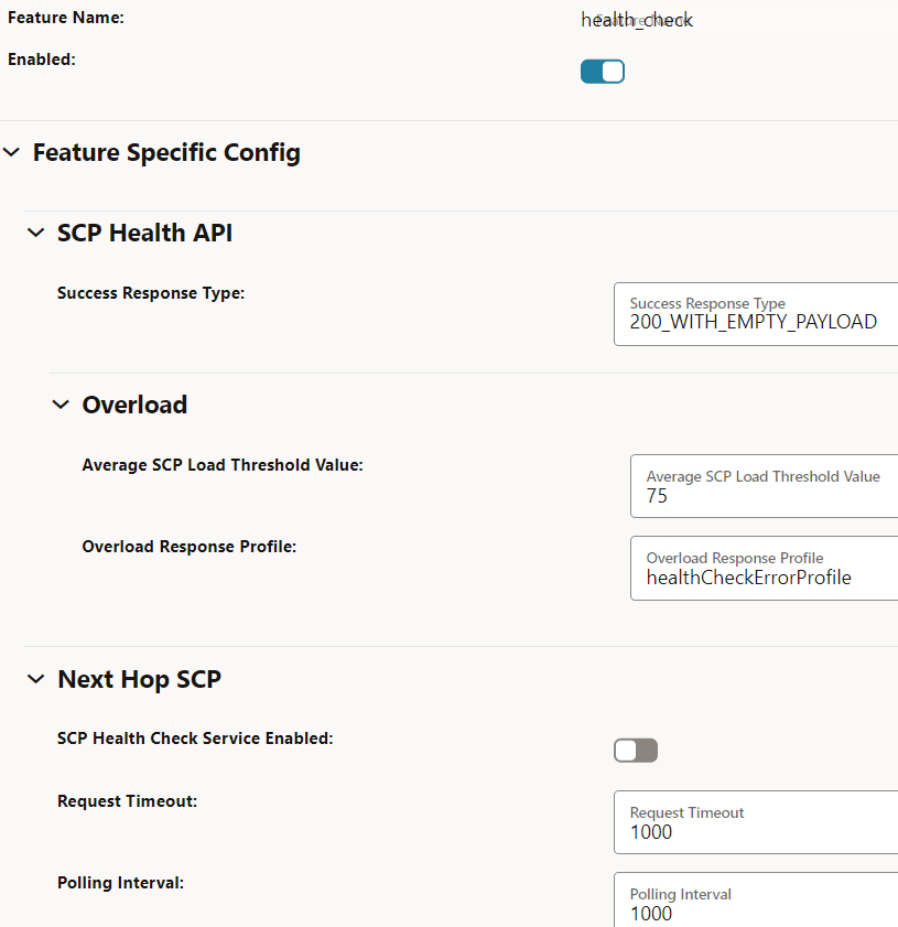

4.2.1.15 Configuring SCP Health Check API
Perform the following the procedure to configure SCP health check API.
  1. In the left navigation pane, click the Health Check tab.
  2. In the Health Check section, click Edit.
    Figure 4-20 Health Check
    Health Check
  3. Ensure that Enabled is set to true.
    This is the default configuration.
  4. In the Feature Specific Config section, you can modify the following configurations:
    Table 4-4 Configure Health Check API
    Success Response Type This field indicates successful responses for a healthy SCP.
    • Default value: 200StatusCodeAndEmptyPayload
    • Range: 200WithPayLoad, 200WithEmptyPayload, and 204WithNoContent
    Average SCP Load Threshold Value This field provides the overall average SCP load threshold value.
    • Default value: 75%
    • Range: 75% - 90%
    Overload Response Profile This field indicates the error profile configuration for the health query response in the exception conditions.
    • Default value: healthCheckErrorProfile. For more information about this option, see "Configuring Error Profiles" in Oracle Communications Cloud Native Core, Service Communication Proxy REST Specification Guide.
    SCP Health Check Service Enabled This option enables or disables the SCP health check API feature in inter-scp scenarios.
    • Default value: false
    Request Timeout This field indicates the timer to monitor the waiting time for health check response in inter-scp scenarios.
    • Default value: 1000ms
    • Range: 300ms -60000ms
    Polling Interval This field indicates the duration to control the periodicity of health check requests in inter-scp scenarios.
    Consecutive Error Response This field indicates the total number of consecutive failure responses that leads to failover in inter-scp scenarios.
    • Default value: 3
    • Range: 1 - 20
    Consecutive Success Response This field indicates the total number of consecutive successful responses that leads to fallback in inter-scp scenarios.
    • Default value: 3
    • Range: 1 - 20
  5. Click Save.

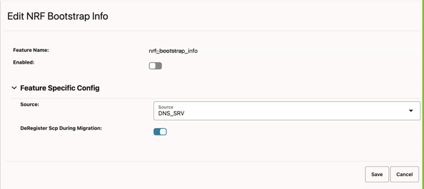

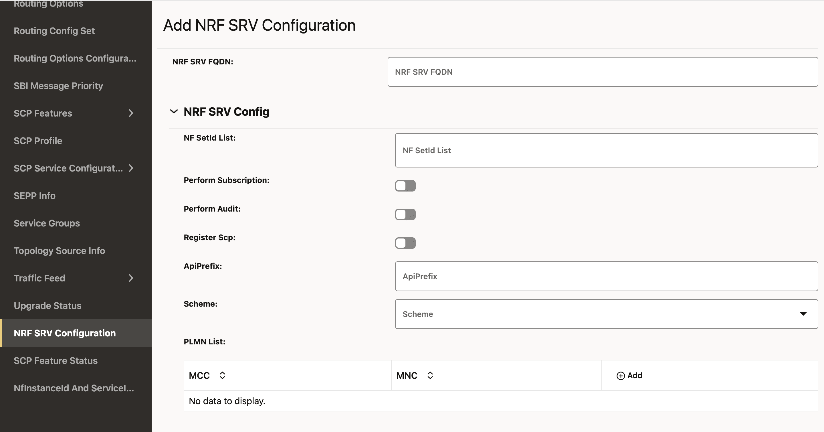

4.2.1.16 NRF Configuration using DNS SRV Resolution
Perform the following procedure to NRF configuration using DNS SRV resolution.
  1. In the left navigation pane, click the NRF Bootstrap Info tab.
  2. In the NRF Bootstrap Info section, click Edit.
    Figure 4-21 Edit NRF Bootstrap Info
  4. In the Feature Specific Config section, enter the following input for the following configurations:
    Table 4-5 Configure NRF Source Configuration
    Source This field is used to select whether the NRF Configuration Using DNS SRV Resolution feature should be enabled or disabled. SCP will enable the feature if the source is DNS_SRV.
    The default value is DNS_SRV.
    deRegisterScpDuringMigration
    In the migration from static to DNS SRV task, if static and DNS SRV NRF configurations are the same, then this parameter will be used to deregister SCP with the old or static NRFset.
  5. Click Save.

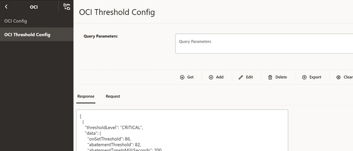

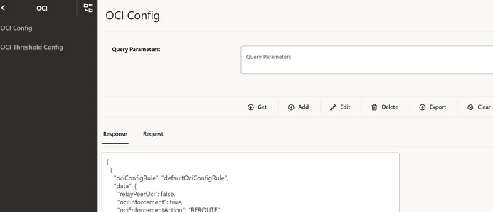

4.2.1.17 Configuring Overload Control Based on the Overload Control Information Header
Perform the following procedure to configure overload control based on the overload control information header.
  1. From the SCP Features list, click the OCI tab.
  2. On the OCI page, click the Edit icon.
    Figure 4-22 Edit OCI
    Edit OCI
  3. In the Edit OCI section, set Enabled to true.
    Figure 4-23 Enabling OCI
    Enabling OCI
  4. To configure OCI, in the Feature Specific Config section, set the following fields:
    Table 4-6 Configure OCI
    olcHSupportInd This option indicates that SCP supports the Overload Control Information (OCI) feature based on the 3gpp-Sbi-Oci header.
    By default, this option is enabled.
    SCP OCI Conveyance Interval This field indicates the interval for reporting SCP OCI to peer NFs. For every interval until the validity period, the last sent OCI is reported to peer NF irrespective of any change to SCP OCI. Sending SCP OCI periodically ensures that the peer NF has not missed an earlier reported SCP OCI. The same OCI header as sent on the last OCI threshold change or validity period expiry is sent.
    • Default value: 2000 milliseconds
    • Range: 2000 to 3600000 milliseconds
    Note: OCI is sent to peer NFs only if there is a message for that NF.
    SCP OCI Recovery Validity Period This field indicates the validity period to send OCI headers to peers when SCP recovers from an overloaded state. SCP sends OCI to peers with reduction metric as 0.
    • Default value: 3600 seconds
    • Range: 5 to 3600 seconds
    Next Hop SCP OCI Enabled This option enables or disables the OCI feature between SCP instances and SCP scope OCI.
    Next Hop SCP OCI Rule Name If the Next Hop SCP OCI Enabled option is enabled, the OCI feature enforcement is done based on the ociConfigRule REST API configuration with the name provided as the value for this option.
    By default, this value is NextHopScpOciRuleName.
    Next Hop SEPP OCI Enabled This option enables or disables OCI enforcement between SCP and SEPP interfaces and SEPP scope OCI.
    Next Hop SEPP OCI Rule Name If the Next Hop SEPP OCI Rule Name option is enabled, the OCI feature enforcement is done based on the ociConfigRule REST API configuration with the name provided as the value for this option.
    By default, this value is NextHopSeppOciRuleName.
    scpOciConveyance If this option is set to true, SCP starts conveying the 3gpp-Sbi-Oci header based on self-overload information.

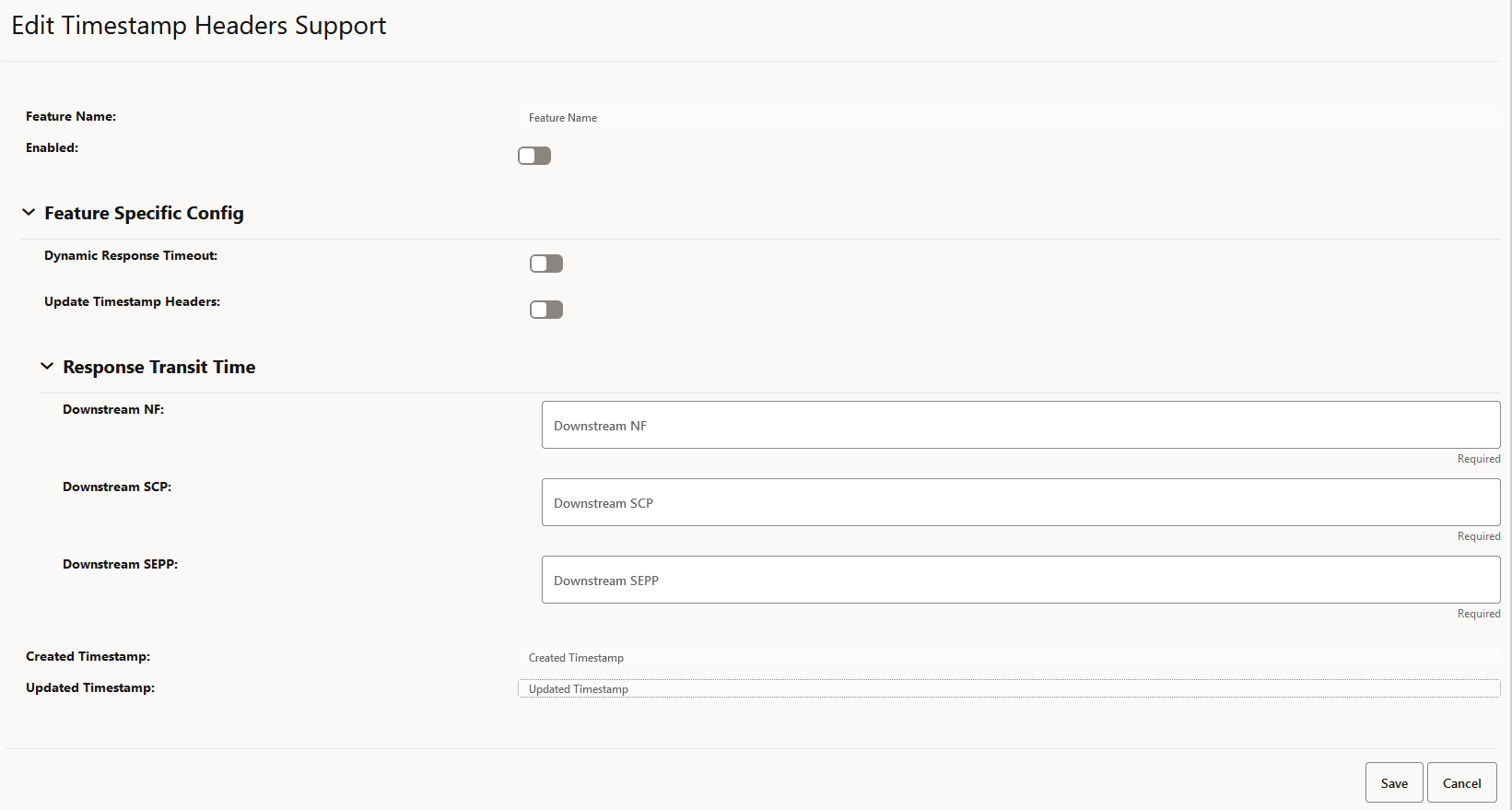

4.2.1.19 Configuring 3GPP Timestamp Headers Support
Perform the following procedure to enable or disable the 3GPP Timestamp Related Headers Support feature and configure its settings.
  2. From the SCP Features list, click Timestamp Header Support.
  3. In the Timestamp Header Support section, click Edit.
    Figure 4-25 Edit Timestamp Headers Support
    This screen allows to configure the feature specifications.
    • Dynamic Response Timeout: This field, when set to true, enables SCP to perform dynamic response time calculations based on the received timestamp headers. It updates or adds the 3gpp-Sbi-Sender-Timestamp and 3gpp-Sbi-Max-Rsp-Time headers in the egress SBI request.
      • Date Type: Boolean
      • Default Value: true
    • Update Timestamp Headers: This field, when set to true and dynamicResponseTimeout is false, allows SCP to add or update the 3gpp-Sbi-Sender-Timestamp and 3gpp-Sbi-Max-Rsp-Time headers in the egress SBI request. The 3gpp-Sbi-Sender-Timestamp is set to reflect the current timestamp at scp-worker, while the 3gpp-Sbi-Max-Rsp-Time will be set to the configured responseTimeout value for the specific service.
      When dynamicResponseTimeout is true, the value of updateTimestampHeaders will not have any impact and should be set to true. In this case, SCP will always add or update the 3gpp-Sbi-Sender-Timestamp and 3gpp-Sbi-Max-Rsp-Time headers in the egress SBI request.
    • Response Transit Time: This field specifies the minimum estimated transit time required (in milliseconds) for the response to reach back from SCP to the original sender, whether it's the Consumer NF, SCP, or SEPP.
      • Default Value:
        "responseTransitTime": {
            "downstreamNF": 50,
            "downstreamSCP": 100,
            "downstreamSEPP": 300
      • Range: NA
    • Downstream NF: This field specifies the minimum estimated transit time required (in milliseconds) for the response to return to the original requester NF.
      • Date Type: Integer
      • Default Value: 50
      • Range: 0 - 10000
    • Downstream SCP: This field specifies the minimum estimated transit time required (in milliseconds) for the response to return to the original requester SCP.
      • Range: 0 - 10000
    • Downstream SEPP: This field specifies the minimum estimated transit time required (in milliseconds) for the response to return to the original requester SEPP.
      • Default Value: 300
      • Range: 0 - 10000
  6. Click Save.
    For optimal functionality, this feature requires NTP (Network Time Protocol) synchronization across all nodes communicating with the SCP, including the SCP itself.

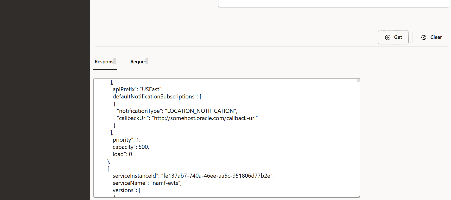

4.2.2 Configuring OCI
Perform the following procedure to retrieve, modify, and remove OCI configuration data.
  1. From the left navigation pane, click the SCP tab, and then click the OCI tab.
  2. From the left navigation pane, click the OCI Config tab.
  3. In the OCI Config section, click Get to retrieve OCI configuration data based on the query parameters.
    Figure 4-26 OCI Config
    OCI Config
  4. To add a new request, click Add and enter the request body information in the Request field.
  5. Click Submit.
    The request body message appears in the Response field.
    To edit, export, delete, or clear the data, click the required buttons as described in the following table:
    Table 4-7 Button and Field Descriptions of OCI
    Button and Field Names Description
    Query Parameters Allows to enter parameters to retrieve, add, and update OCI configuration data based on the query parameters.
    Get Retrieves OCI configuration data. You can modify this data using the Edit button.
    Add Adds new message requests in the Request field.
    Edit Modifies any existing data by updating mandatory query parameters in the Query Parameters field.
    Delete Removes any message request.
    Export Exports existing records in the JSON format.
    Clear Refreshes the existing screen by removing the data.
4.2.3 Configuring OCI Threshold Levels
Perform the following procedure to retrieve, modify, and remove OCI threshold configuration data.
  2. From the left navigation pane, click the OCI Threshold Config tab.
  3. In the OCI Threshold Config section, click Get to retrieve OCI threshold configuration data based on the query parameters.
    Figure 4-27 OCI Threshold Config
  5. Click Submit.
    Table 4-8 Button and Field Descriptions of OCI Threshold Configuration
    Query Parameters Allows to enter parameters to retrieve, add, and update OCI threshold configuration data based on the query parameters.
    Get Retrieves OCI threshold configuration data. You can modify this data using the Edit button.

4.2.5 Configuring NRF SRV
Perform the following procedure to configure NRF using DNS SRV Resolution.
  1. From the left navigation pane, navigate to SCP and click the NRF SRV Configuration tab.
  2. In the NRF SRV FQDN section, click the Add button to create the new NRF SRV configuration for the given NRF SRV FQDN.
    You can configure the NRF configurations at run time, and this NRF SRV FQDN shall be mapped to target NRF FQDNs. SCP uses this NRF SRV FQDN to query the DNS SRV server to get the actual target NRF FQDNs. NRF SRV FQDN
    Figure 4-28 Add NRF SRV Configuration
  3. To configure the NRF SRV, enter the input for the following fields:
    Table 4-28 NRF SRV Configuration
    NF SetId List This is the SetId list for this NRF SRV configuration.
    You can configure multiple nfSetIds, but the NRF profile and rule creation will only take into account the nfSetId from the 0th index.
    This setId must be unique for each NRF SRV configuration; that is, this setId must not be present in any other NRF SRV configuration.
    Perform Subscription This field allows to decide whether NRF from this NRF SRV should be used for a subscription or not.
    The possible values are true or false.
    Perform Audit This field allows to decide whether NRF from this NRF SRV should be used for a audit or not.
    Register SCP This field allows to decide whether to register SCP with the NRF from the NRF Set.
    Scheme This field is used for the URI Scheme. The supported value is http/https.

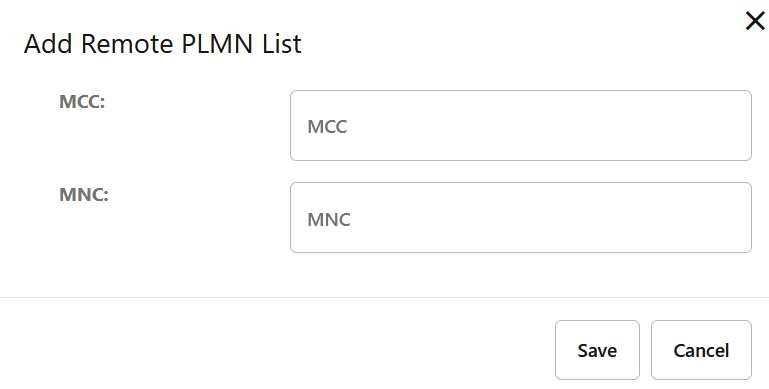

    PLMN List This field indicates the list of NRFs serving Public Land Mobile Network (PLMN).
    A PLMN has a unique PLMN code, which consists of a MCC (Mobile Country Code) and an MNC (Mobile Network Code).
    Click the Add button to add MCC and MNC, respectively.
    Versions This field lists the NFServiceVersion.
    Configuring multiple API versions is permissible, but at least one entry in the version list must have its apiVersionInUri set to "v1." This is because SCP currently utilizes "v1" for its self-generated requests towards NRF.
    • Click the Add button to add NFServiceVersion.
    • The supported value of apiVersionInUri is v1/v2.
    • The apiFullVersion should be in format x.y.z., for example, 1.0.0.
    apiPrefix This field is used in the URI while communicating with NRF.
    serviceNames
    Indicates the service name of the NRF SRV configuration.
    The nnrf-nfm and nnrf-disc are mandatory for NRF SRV configurations.
    The supported value is nnrf-nfm/nnrf-disc/nnrf-oauth2.
    isInterPlmnFqdn When isInterPLMNfqdn is true, it enables InterPLMN request routing. This means requests coming from foreign PLMNs to the SCP can be routed. SCP will perform intra-PLMN routing to local NRFs based on the interplmnFQDN.
  4. In the NRF SRV FQDN section, click the Edit icon to update the existing NRF SRV configuration.
  5. Click Save.

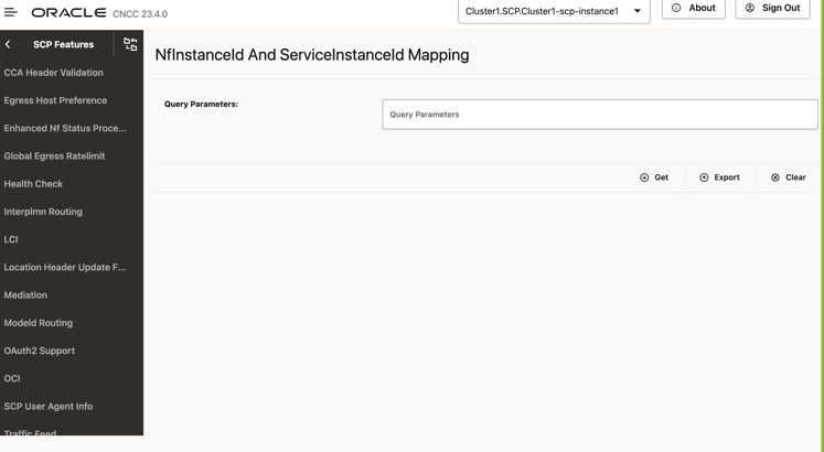

  2. From the SCP Features list, click NFInstanceId And ServiceInstanceId Mapping.
  3. In the NFInstanceId And ServiceInstanceId Mapping section, click Get to retrieve the NRF FQDN and corresponding instanceId mapping details.
    Figure 4-29 NFInstanceId And ServiceInstanceId Mapping
  4. To retrieve, export, or clear the data, click the required buttons as described in the following table:
    Table 4-29 Buttons and Descriptions of Mapping NRF FQDN InstanceId
    Query Parameters Allows to enter parameters to retrieve and update data required for mapping NRF FQDN InstanceId.
    Get Retrieves the NRF FQDN and corresponding instanceId mapping details. You can modify this data using the Edit button.

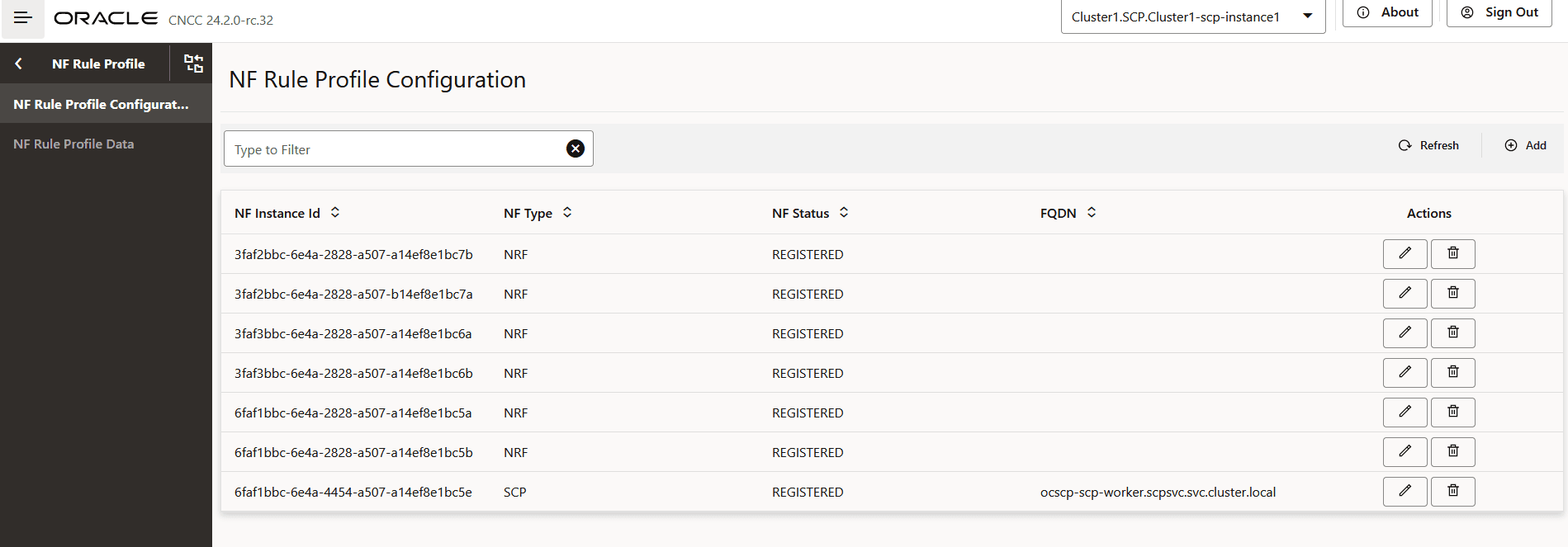

4.2.6 Configuring NRF

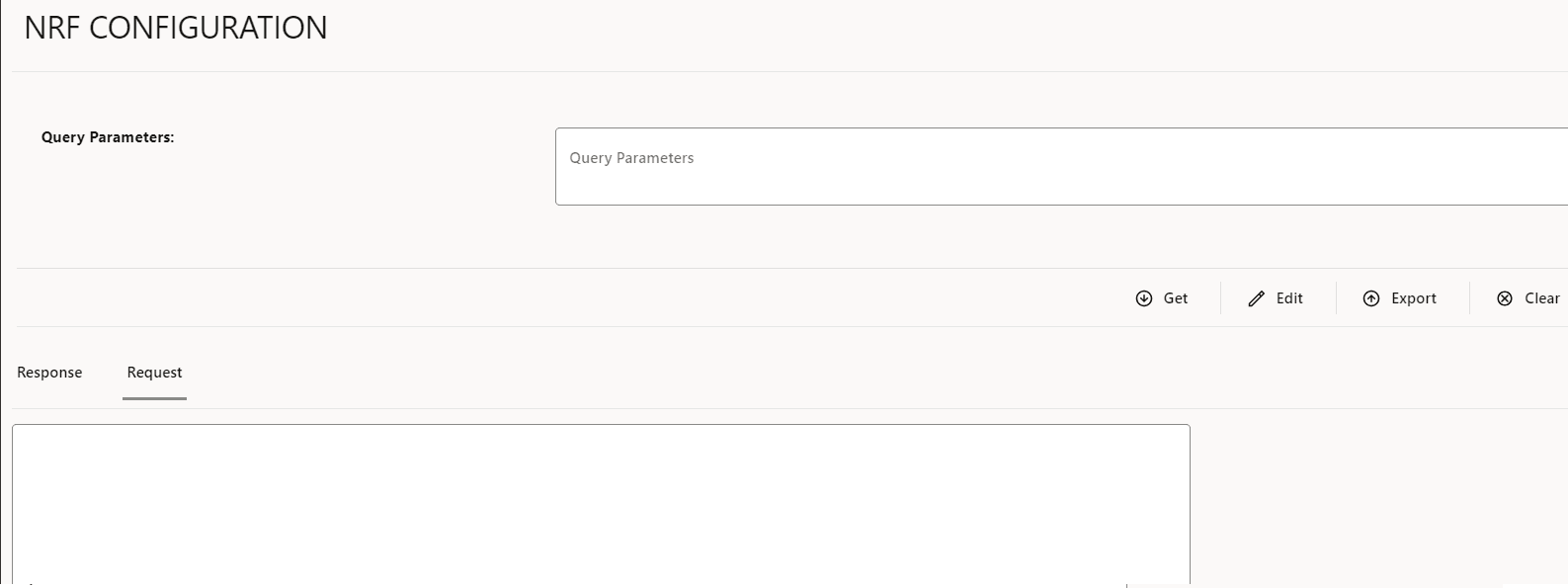

Perform the following procedure to configure NRF preferred by SCP for access token requests.
  1. From the left navigation pane, click the SCP tab, and then click the NRF Configuration tab.
  2. In the NRF CONFIGURATION section, click Get to retrieve NRF configuration information.
    Figure 4-30 NRF Configuration
    NRF Configuration
  3. To edit, export, or clear the data, click the required buttons as described in the following table:
    Table 4-30 Button and Field Descriptions of NRF Configuration
    Query Parameters Allows to enter parameters to retrieve, add, and update NRF configuration data.
    Get Retrieves NRF configurations. You can modify this data using the Edit button.

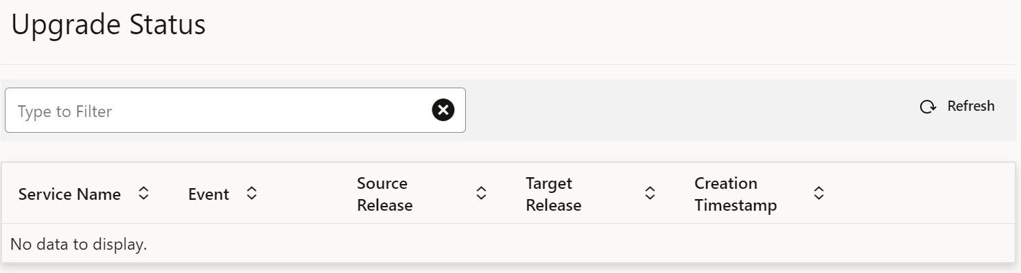

4.2.7 Configuring Upgrade and Rollback Event
Perform the following procedure to fetch upgrade and rollback event information.
  1. From the left navigation pane, click the SCP tab, and then click the Upgrade Status tab.
  2. On the Upgrade Status page, the following columns display upgrade and rollback events:
    Figure 4-31 Upgrade and Rollback Events
    Table 4-31 Upgrade and Rollback Events
    Column Name Description
    Service Name Displays the names of the services, such as SCPC-Audit, SCPC-Configuration, SCPC-Notification, and so on.
    Event Displays the names of the upgrade and rollback events, such as Pre_Upgrade_Started, Pre_Upgrade_Completed, Pre_Upgrade_Failed, and so on.
    Source Release Displays the source release version for performing upgrade and rollback.
    The convention to identify a release is as follows:
    • 1.12.0 is identified as 101200
    • 1.14.0 is identified as 101400
    Target Release Displays the target release version for performing upgrade and rollback.
    • 1.15.0 is identified as 101500
    • 22.1.0 is identified as 221000
    Creation Timestamp Displays the time of creation of the event, for example, creationTimestamp": "2021-05-26T01:17:15.000+00:00

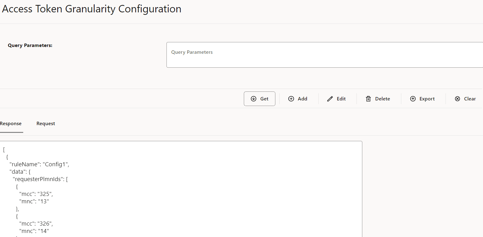

4.2.8.1 Configuring Access Token Granularity
Perform the following procedure to configure access token granularity and access token requests for NFType, specific NF, or NF instance ID.
  1. From the left navigation pane, click the SCP tab, and then click the OAuth Services tab.
  2. From the left navigation pane, click the Access Token Granularity Configurationtab.
  3. In the Access Token Granularity Configuration section, click Get to retrieve access token granularity configurations data based on the query parameters.
    Figure 4-32 Access Token Granularity
  5. Click Submit.
  6. To edit, export, delete, or clear the data, click the required buttons as described in the following table:
    Table 4-32 Button and Field Descriptions of Access Token Granularity
    Query Parameters Allows to enter parameters to retrieve, add, and update access token granularity configuration data based on the query parameters.
    Get Retrieves access token granularity configuration data. You can modify this data using the Edit button.

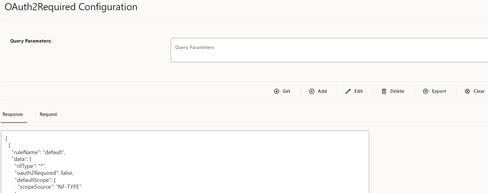

4.2.8.2 Configuring OAuth2.0 Local PLMN Required
Perform the following procedure to configure local PLMN OAuth2.0.
  2. From the left navigation pane, click the OAuth2Required Configuration tab.
  3. In the OAuth2Required Configuration section, click Get to retrieve OAuth2Required configurations data based on the query parameters.
    Figure 4-33 OAuth2Required Configuration
  5. Click Submit.
    Table 4-33 Button and Field Descriptions of OAuth2Required Configuration
    Query Parameters Allows to enter parameters to retrieve, add, and update OAuth2Required configuration data based on the query parameters.
    Get Retrieves OAuth2Required configuration data. You can modify this data using the Edit button.

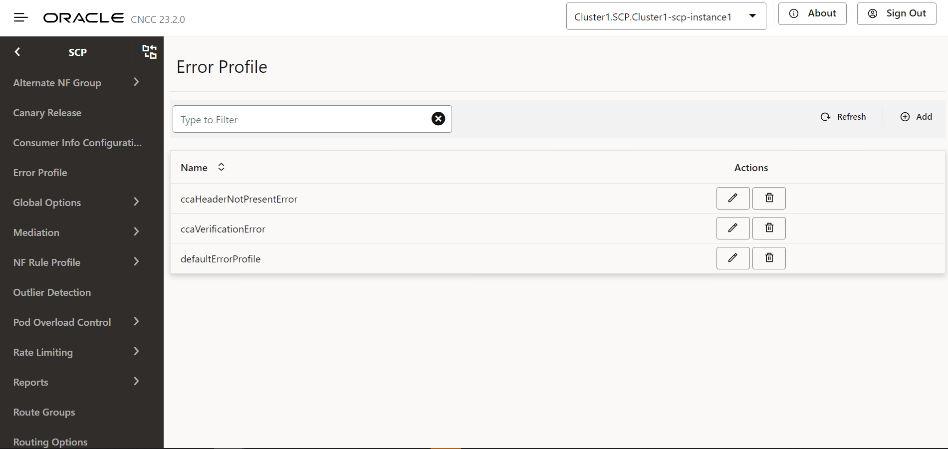

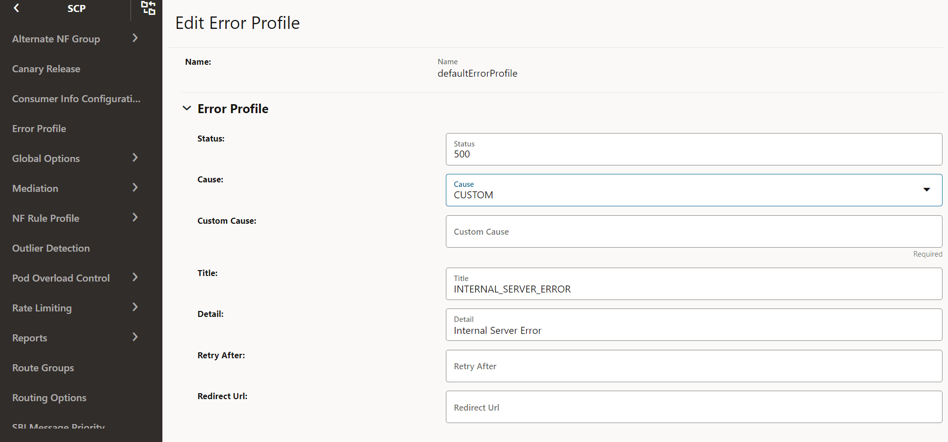

4.2.9 Configuring Error Profile
Perform the following procedure to configure different error profiles, which can be used to build "ProblemDetails" sent in the response body to the consumer.
  1. From the left navigation pane, click the SCP tab, and then click the Error Profile tab.
    Figure 4-34 Error Profile
    Edit Profile
  2. Click Edit icon from the Actions column for the error profiles that must be modified. The Edit Error Profile screen appears.
    Figure 4-35 Edit Error Profile
    Edit Error Profile
  3. If the required cause is not available in the Cause drop-down list, select CUSTOM to customize the cause:
    Figure 4-36 Customize the Cause
    Customize the Cause
  4. Make the required modifications for the following parameters:
    Table 4-34 Edit Error Profile
    Field Description
    Status HTTP Status Code
    Cause The list of error causes that are specific to the occurrence of the problem.
    Custom Cause User defined custom cause. This field will be used only if cause field value is set to "CUSTOM".
    Title If this field is null, a standard HTTP status code description is added.
    Detail If present, the same data is used; otherwise, the application can add it optionally.
    Retry After Indicates the number of seconds after client should retry.
    Redirect URL Indicates the AbsoluteURL of the resource to which the message is redirected to.
    For information about configuring error profiles, see "Configuring Error Profile" in Oracle Communications Cloud Native Core, Service Communication Proxy REST Specification Guide.
  5. Click Save.

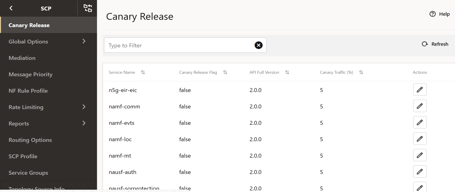

4.2.10 Configuring Canary Release
Following is the procedure to configure Canary Release parameters:
  1. From the left navigation menu, navigate to SCP and then select Canary Release.
  2. Click Edit from the Actions column for the required service that must be modified. The Edit Canary Release Screen appears.
    Figure 4-37 Canary Release
    Canary Release
  3. Make the required modifications for the following parameters:
    1. Canary Release Flag: Enable/Disable the flag using toggle.
    2. API Release Version: Provide the release version of the API.
    3. Canary Traffic: Set the value for the traffic that should be distributed to Canary Release.
    Figure 4-38 Edit Canary Release
    Edit Canary Release
    For more information about the configuration parameters, see Oracle Communications Cloud Native Core, Service Communication Proxy REST Specification Guide.
  4. Click Save.
  5. Click Refresh to view the updated values on the screen.

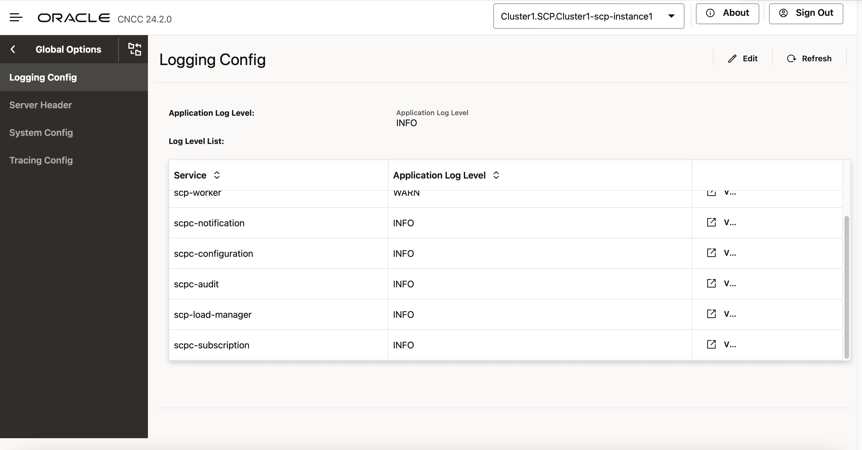

Logging Config
  1. From the left navigation menu, navigate to SCP and select Global Options.
  2. Select Logging Config.
  3. Click Edit from the top right side to edit or update Logging Config parameters.
    Figure 4-39 Logging Config
    This screen displays log level list of scp microservices.
  4. Select Service Type from the drop-down list to select any one of the following service type:
    • scpc-audit
    • scpc-alternate-resolution
    • scpc-subscription
    • scpc-configuration
    • scpc-notification
    • scp-worker
    • scp-cache
    • scp-nrfproxy
    • scp-loadmanager
  5. Select the Application Log Level from the drop-down list to set the constraints of the log.
    The description of each logging level is as follows:
    Table 4-35 Logging Level
    Logging Level Description
    DEBUG A log level used for events considered to be useful during software debugging when more granular information is required.
    INFO The standard log level indicating that something happened, the application entered a certain state, and so on.
    WARN Indicates that something unexpected happened in the application, a problem, or a situation that might disturb one of the processes. But that doesn’t mean that the application has failed. The WARN level should be used in situations that are unexpected, but the code can continue the work.
    ERROR The log level that should be used when the application reaches an issue preventing one or more functionalities from properly functioning.
    TRACE The TRACE log level captures all the details about the behavior of the application. It is mostly diagnostic and is more granular and finer than DEBUG log level.

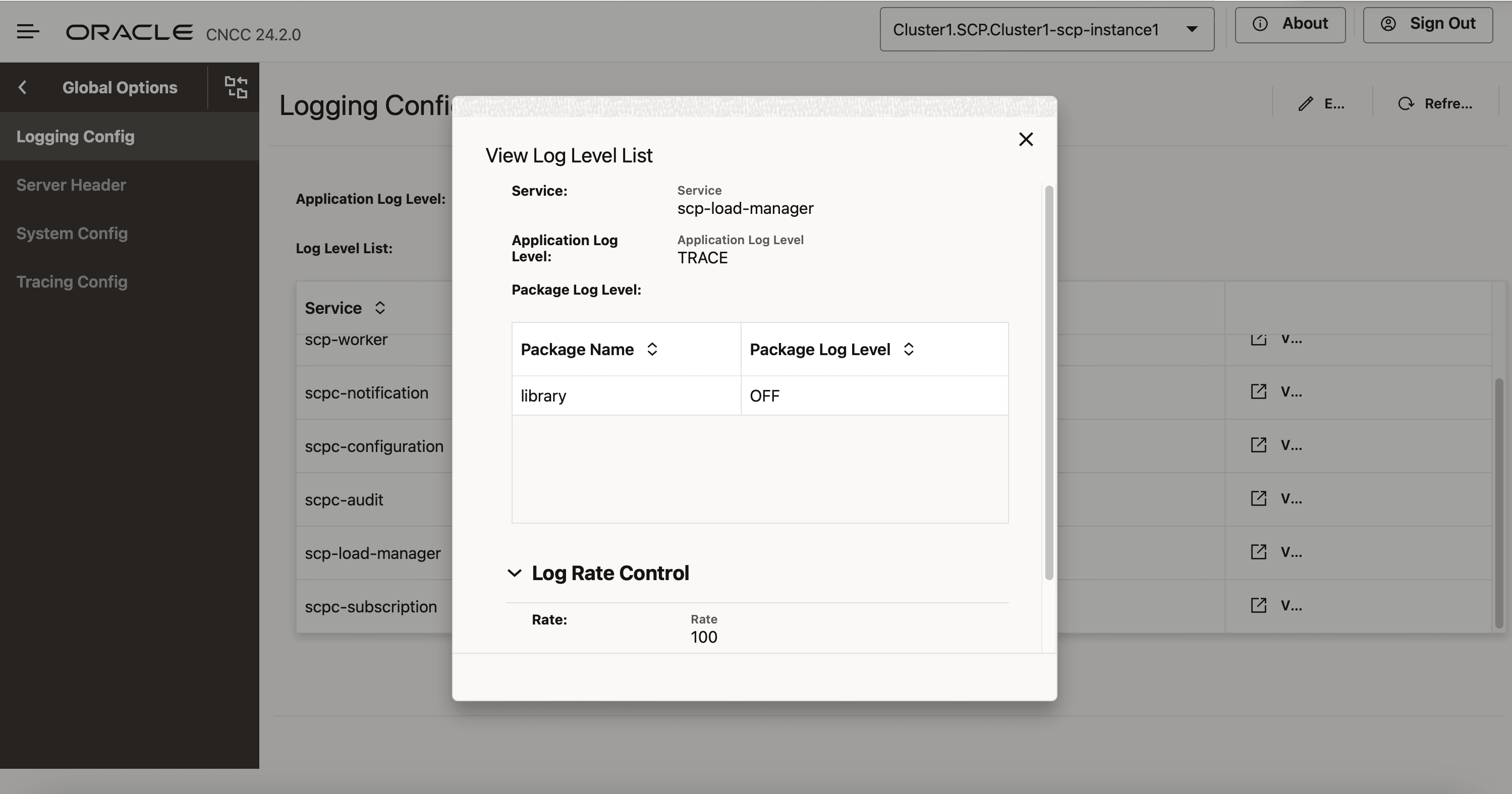

    Note: The scpc-notification, scpc-audit, and scpc-loadmanager microservices supports the TRACE log level.
    For instance, when you select "scpc-notification" as the service type from the Service drop-down list, the Application Log Level drop-down list will display the "TRACE" log level.
    Figure 4-40 TRACE Log Level
    This screen displays the application log level for scp-load-manager microservice.
  6. Click Add provided under Package Log Level section to specify the name of the package and its log level.
  7. Click Save.
    You can also Edit and Delete the packages under Package Log Level.

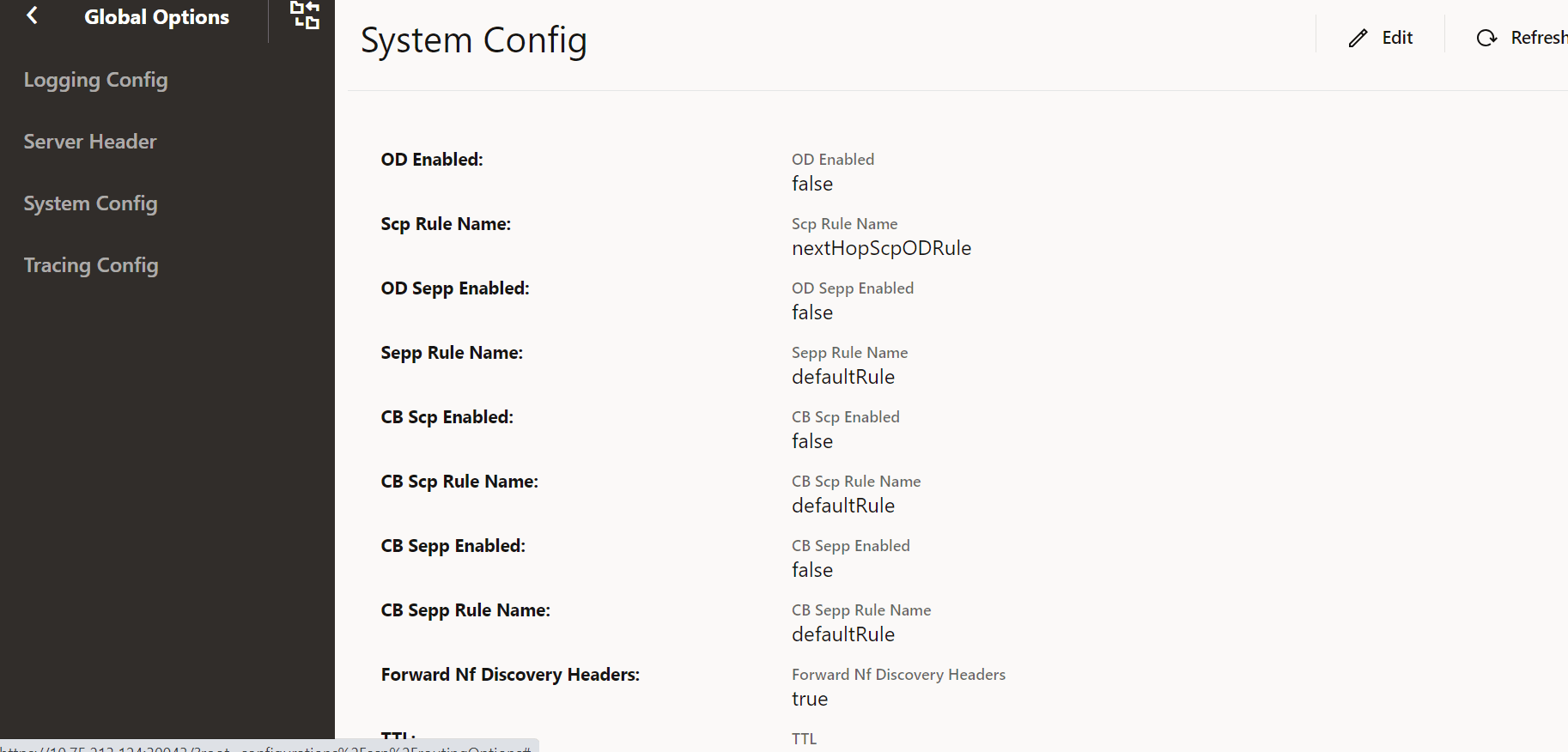

Perform the following procedure to edit the system config parameters.
  2. Select System Config.
  3. Click Edit from the top right side to edit or update System Config parameters.
    Figure 4-41 System Config
    System Config

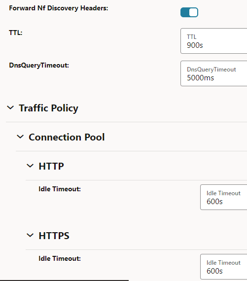

  4. Update the attributes as described in "Configuring System Options" in Oracle Communications Cloud Native Core, Service Communication Proxy REST Specification Guide.
    Ensure that Forward Nf Discovery Headers is set to true to forward discovery headers to Nexthop SCP as part of the Model D Indirect 5G SBI Communication feature.
    The default value is true.
  5. Click Save after performing the modifications.

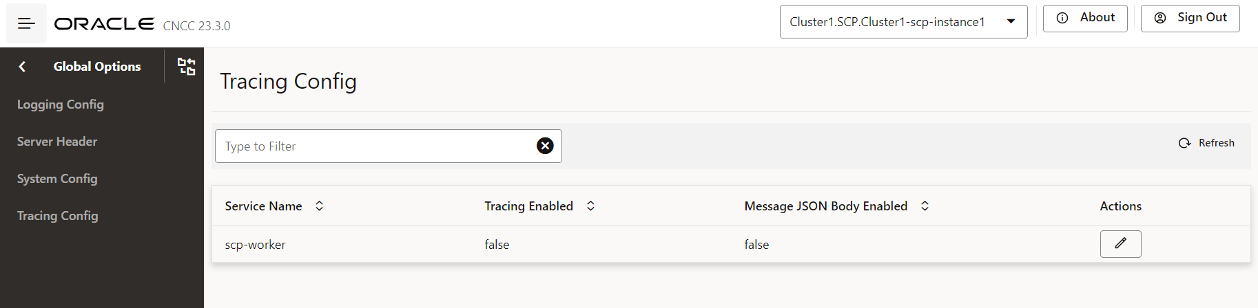

Perform the following procedure to edit tracing config options.
  2. Select Tracing Config.
  3. Click Edit from the top right side to edit or update Tracing Config options.
    Figure 4-42 Tracing Config
    Tracing Config
  4. Set the following switches as required:
    • Tracing Enabled
    • Message JSON Body Enabled
    For information about tracing parameters, see "Updating HELM Configurable Parameters with REST APIs" in Oracle Communications Cloud Native Core, Service Communication Proxy REST Specification Guide.
4.2.12 Mediation Configuration
This section outlines procedures for setting up trigger points to define filter criteria, configuring routing options, creating mediation rules, adjusting log levels, and defining user variables.
4.2.12.1 Configuring Mediation Trigger Point
Perform the following procedure to configure trigger points for defining the filter criteria for a message to decide whether to invoke mediation or not.
For each trigger point configuration, the combination of NfType, serviceName, httpMethods, messageType and triggerPoints methods must be unique. No new records can be added with the same combination.
  1. From the left navigation pane, click the SCP tab, and then click the Mediation tab.
  2. To configure trigger points for defining the filter criteria for a message, in the left navigation pane, click the Trigger Points tab.
  3. In the Trigger Points section, click Add.
  4. In the Add Trigger Points section and add the fields as described in the following table:
    Table 4-36 Trigger Points Field Description
    Field Description
    Group Id Enter the group ID for which the mediation configuration is required.
    The Mediation configuration for a specific group is applicable to the mediation requests or responses received only from the same group. The HTTP Mediation service consumer NFs, which requires the same mediation rules, can be grouped together using this group ID.
    Rule Name Enter a unique rule name for each mediation configuration, which will serve as the primary key.
    Message Type Select whether the message is a notification or a service request.
    The allowed message types are svc-request-message, notification-message, or both notification-message, svc-request-message.
    Service Name Select the service of NFType for which mediation configuration is required.
    NF Type Select the NFType for which mediation configuration is required.
    Http Methods Select the HTTP methods, such as GET, POST, PUT, PATCH, DELETE, and OPTIONS.
    Mediation Trigger Points Select trigger points to be enabled based on matches with one or more of the following: requestIngress, requestEgress, responseIngress, and responseEgress.
    Match Indicates the list of match blocks to be satisfied for the rule to be activated.
    Minimum number of blocks = 1
    Maximum number of blocks = 20
    Add Option to add HTTP headers, JSON body, and User Defined Variables criteria.
    Match Parameter Semantics
    • Match Blocks using OR Semantics:
      The match wrapper consists of multiple match blocks, which are evaluated using OR semantics. This means that for the overall match wrapper to evaluate to true, it is sufficient for any one match block to satisfy the conditions.
      For example, if the match wrapper contains three match blocks, the entire wrapper will be considered a match as long as at least one of the blocks matches the conditions.
    • Internal Components of a Match Block (AND Semantics)
      Each match block contains three components:
      • Body: A list of match conditions for body fields.
      • Headers: A list of match conditions for headers.
      • userDefinedVariables (UDVs): A list of match conditions for user-defined variables.
      These components are evaluated using AND semantics:
      • All conditions within each component (for example, all body conditions, all header conditions, and all UDV conditions) must be satisfied.
      • Furthermore, all three components (body, headers, and userDefinedVariables) must match in order for the block to be considered a match.
  5. In the Match section, click Add.
    The Add Match dialog box appears.
  6. In the Header section, click Add to set the header details as follows:
    • Name: Enter a name for the header.
    • Value: Enter a value of the header.
    • Match Type: Select a range type from the Match Type drop-down.
  7. In the Body section, click Add to set the JSON body details as follows:
    • Name: Enter a name for the body.
    • Value: Enter a value for the header.
  8. In the User Defined Variables section, click Add to set the user defined variable details as follows:
    • Name: Select the user-defined variable names from the Name drop-down.
    • In the Range section, if the header type has a numeric value, enter the range of that value in Start and End fields.
    • Click Remove to discard the changes made to the Range section.
  9. In the Action section, select the action type from the Action Type drop-down.
    This field allows you to select the action for the trigger point rules that match the configured trigger point rules setup. The allowed values are forwardToMediationService and setTriggerPointsInvocation.
    The significance of setTriggerPointInvocation is to avoid extra SCP-Worker to mediation service hop at requestIngress or requestEgress trigger points for the scenarios where response message mediation is required based on request message content.
    For more information, see the "Configuring Mediation Trigger Point" in Oracle Communications Cloud Native Core, Service Communication Proxy REST Specification Guide.
  10. In the Trigger Point List, select the list of trigger points to be invoked for matching the configured trigger point rule.
    For more information about the order of invocation, see the "Configuring Mediation Trigger Point" in Oracle Communications Cloud Native Core, Service Communication Proxy REST Specification Guide.
    This is only applicable for Action Type = setTriggerPointsInvocation. Additionally, the first value in the triggerPointList should not precede the first value in the parent triggerPoints.
    Example (not allowed)triggerPoints: ["requestEgress"], "action": { "actionType": "setTriggerPointsInvocation", "triggerPointList": [ "requestIngress" ] }
    In this example, "requestIngress" is listed after "requestEgress", which violates the rule that the first trigger point in the triggerPointList should not occur before the first trigger point in the parent triggerPoints.
  11. In the Trigger Points section, click Edit and configure the fields as required.
    Figure 4-43 Edit Mediation Trigger Points
  12. Click Save to save the changes.
  13. Click Cancel to reset all the fields.

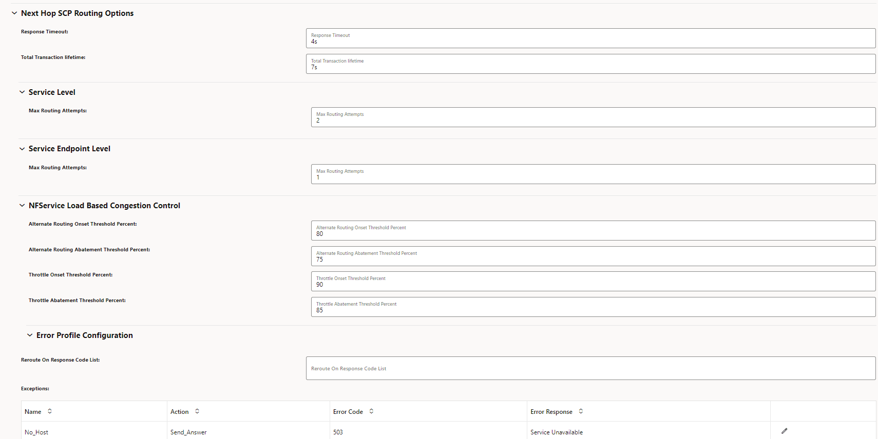

4.2.12.2 Configuring Routing Options for Mediation
Perform this procedure to configure routing options with Mediation.
  2. On Mediation tab, click the Routing Options subtab.
  3. In the Routing Options section, click Edit.
    The Edit Routing Options screen appears.
    Figure 4-44 Editing Routing Options
    This screen enables you to enable routing option for mediation.
  4. In the Edit Routing Options section, set Retry to true to enable retry attempt.
  5. In the Max Retry Attempts field, enter a value to set the number of retry attempts. Minimum value is 1, Maximum value is 10.
  6. In the Response Timeout field, enter a time interval to respond to a message request. This value must be in seconds.
  7. In the Exception Error Responses section, click Add to add exception error responses.
    This option enables you to send an error message to the consumer NF or process the message request to the producer NF when the Mediation service is unavailable.
    This option specifies how exceptions should be handled. In the Exception Error Responses of Routing Options, three exception configurations will be created by default during deployment. These configurations will include the status codes DEFAULT, MSGDECODEFAILURE, and MAXHDRSIZEEXCEEDED, with the action set to continue_processing. This means that if an exception occurs during mediation invocation, the process will continue. To change this behavior, the user must create their own exception configuration by specifying actions for specific status codes.
  8. In the Add Exception Error Responses dialog box, configure the fields as described in the following table:
    Table 4-37 Add Exception Error Responses
    Field Description
    Status Code Indicates the list of status codes that matches with the status code received from the application, the required action specified by action field is taken.
    This value can be any HTTP Status Codes, HTTP Status with other defined custom status (RESPONSE_TIMEOUT and CONNECTION_FAILURE)
    Action Indicates the action to be taken when the above mentioned status code is received.
    It can have the following values:
    • send_error_response: Sends the error code to the consumer NF.
    • continue_processing: Continues processing the message in case of errors.
    Error Code Indicates configurable error codes to be sent by SCP to consumer NFs.
    It is a valid HTTP status code or allowed custom code.
    Error Cause Indicates the error cause that is specific to the occurrence of the problem.
    Error Title Indicates the title of the error.
    Error Description Indicates an explanation specific to the occurrence of the problem.
    Retry After Indicates the retry interval.
    Redirect Url Indicates the AbsoluteURL of the resource to which the message is redirected to.
  9. Click Save.
4.2.12.3 Configuring Mediation Rules
Perform this procedure to configure mediation rules.
  2. On Mediation tab, click the Mediation Rules Configuration subtab.
    The Mediation Rules Configuration screen with a list of rules saved in database appears.
    Figure 4-45 Mediation Rules Configuration
  3. Click the View icon to view the mediation rules.
  4. Click the Add to create a mediation rule.
    The Add Mediation Rule screen allows you to configure the fields to create new rules as described in the following table:
    Table 4-38 Add Mediation Rules
    Field Description
    Rule Name Indicates the name of the rule.
    This value should be unique.
    Format Indicates the Format in which the rules are defined, such as DRL.
    Status Indicates the status of the rule.
    • DRAFT
    • APPLIED
    The status must always be in DRAFT to create a new rule.
    Mediation Mode
    Indicated whether the rule applies to mediation active or mediation test.
    • Mediation Active allows actual messages to be manipulated according to configured mediation rules.
    • Mediation Test executes the mediation rule on message copy instead of the actual message and verifies the behavior of the mediation rule.
    Code Indicates the configurable drool expression that matches the request/response headers and body sent by SCP.
    For example,
    package com.oracle.cgbu.ocmediation.nfmediation;
    import com.oracle.cgbu.ocmediation.factdetails.Request;
    dialect "mvel"
    rule "newRuleTest"
    when
     req : Request(headers.has("header") == true)
    then
     req.headers.add("NewHeader","132465")
    end
    State Indicates the state. The value of State must be SAVE to create a new rule. For more information, see Table 3-35
    Special characters are not supported and can lead to an compilation error.
  5. Click the Edit icon to edit the existing rule.
    Add a Mediation Rule with user-defined variables that have not been configured.
    User-defined variables must be configured before they can be used in a mediation rule.
    The Edit Mediation Rule screen allows you to configure the fields as described in the following table:
    Table 4-39 Edit Mediation Rules
    Field Description
    • DRAFT
    • APPLIED
    The following fields are allowed to be modified in DRAFT status: Mediation Mode, Code, and State. The valid values for state are SAVE, CLONE, COMPILE, and APPLY.
    The Mediation Mode can only be modified in APPLIED status. The valid values for state are SAVE, CLONE, or DRAFT.
    Mediation Mode
    State Indicates the action to be applied to the rule.
    The default value is SAVE
    Note: The DRAFT state is an invalid transition that could lead to an error.
    New Rule Name Indicates the new name of the rule.
    This field appears when a CLONE state is selected.
    If the User Defined Variables field is not enabled, rules using userDefinedVariables can only be saved in a DRAFT state and cannot be moved to the COMPILE or APPLY state.
  6. Click the Delete icon to delete the existing rule.
    The status of the rule must always be in DRAFT to delete an existing rule.
  7. Click Save.
4.2.12.4 Configuring Mediation Log Levels
Perform this procedure to configure the log levels of mediation.
  2. On Mediation tab, click the Log Level Configuration subtab.
    The Log Level Configuration screen with a list of default log level type of mediation and mediation-test service assigned during deployment appears.
  3. Click the View icon to view the log level of mediation or mediation test service.
  4. Click the Edit icon to edit or update the log level of mediation or mediation test service.
    The Edit Log Level Configuration screen allows you to configure the fields as described in the following table:
    Table 4-40 Edit Log Level Configuration
    Field Description
    Service Type Indicates the name of the type of service. For examples, mediation and mediation-test
    Application Log Level Indicates the type of log level.
    The following are the supported log levels:
    • WARN: Designates potentially harmful situations.
    • INFO: Designates informational messages that highlight the progress of the application at coarse-grained level.
    • ERROR: Designates error events that might still allow the application to continue running.
    • DEBUG: Designates fine-grained informational events that are most useful to debug an application.
      The default value is WARN.
    Package Log Level
    Indicates the package level log information.
    Log Rate Control Indicates the log rate control information.
  5. Select the application log level from the Application Log Level drop-down list to collect the logs as per the requirement.
  6. Click Save to update the log level of service.
Package Log level Configuration
To update the package level information, perform the following:
  1. On the Package Log level section, click the EDIT icon next to the package name.
    The Edit Package Log Level screen allows you to configure the fields as described in the following table:
    Table 4-41 Edit Package Log Level
    Field Description
    Package Name Indicates the name of the package. It should be a valid library name.
    • The valid package names are org, io, springfox, com.zaxxer, reactor, validator, and library.
    • The default package name is library.
    Package Log Level Indicates the type of package log level.
    • INFO: Designates informational messages that highlight the progress of the application at a coarse-grained level.
    • OFF: Disables the log rate.
      The default value is OFF
  2. Edit the package name and Package Log Level from the drop-down menu and click Save.
Log Rate Control Configuration
To configure the average number of logs allowed per second, perform the following:
  1. The Log Rate Control section allows you to configure the fields as described in the following table:
    Table 4-42 Log Rate Control
    Field Description
    Rate Indicates the average number of logs allowed per second.
    • The default rate is 1.
    • The range is in between 1 and 10000
    Log Level Indicates the type of log level where rate control is applied.
    • OFF: Designates to turn off logging.
  2. Select the log level from the Log Level drop-down to change the log level type, and click Save.
4.2.12.5 Configuring Mediation Support for User Defined Variables
Perform this procedure to configure the user defined variables of mediation.
  2. On Mediation tab, click the User Defined Variables subtab.
    The User Defined Variables screen displays a list of user-defined variables saved in the database. A user-defined variable can be edited, deleted, or viewed.
    Figure 4-46 User Defined Variables Configuration
  3. Click the View icon to view the configured user-defined variable.
  4. Click the Add to create a user-defined variable.
    The Add User Defined Variable screen allows you to configure the fields to create user defined variables to configure rules as described in the following table:
    Table 4-43 Add User Defined Variable
    Field Description
    User Defined Variable Name This field is used to specify the name of the user-defined variable. Ensure the name is unique.
    Data This section allows to define and configure user-defined variable data-related settings.
    Type This field is used to specify the data type (for example, STRING, LONG, JSON, BOOLEAN).
    Size This field is used to define the size limit for the user-defined variable data. This field is conditional and required only when the type is STRING or JSON.
    The allowed size range is between 1 and 1024 bytes only.
    Description This field is used to provide a brief explanation for the data being defined.
    Ensure that no special characters are used.
  5. Click the Edit icon to edit the configured user-defined variable.
    The Edit User Defined Variable screen allows you to configure the fields as described in the following table:
    Table 4-44 Edit User Defined Variable
    Field Description
    User Defined Variable Name This field specifies the name of the user-defined variable.
    Note: The name of the user-defined variable cannot be edited.
    Data This section allows users to define and configure user-defined variable data-related settings.
    Type This field specifies the data type (for example, STRING, LONG, JSON, BOOLEAN).
    Size This field is used to define the size limit for the data. This field is conditional and required only when the type is STRING or JSON.
    Description This field provides a brief explanation for the data being defined.
    If a user-defined variable is APPLIED in any rules or configured at trigger points, it cannot be deleted. In this case, the only editable field is the size, which can only be incremented.
  6. Click Save to update changes.
    Users can use these user-defined variables in SCP trigger points and mediation rules.

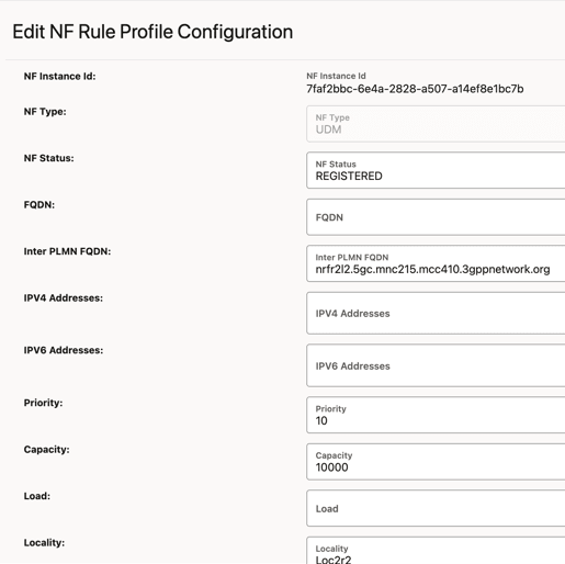

4.2.13 Configuring NF Rule Profile
Perform the following procedure to configure NF Rule Profile parameters.
When the learning source is set to "Local", users can modify the 5G NF profile regardless of whether it was learned from NRF (source='NRF') or configured statically (source='Local'). By setting the source to Local, the system does not delete already determined profiles.

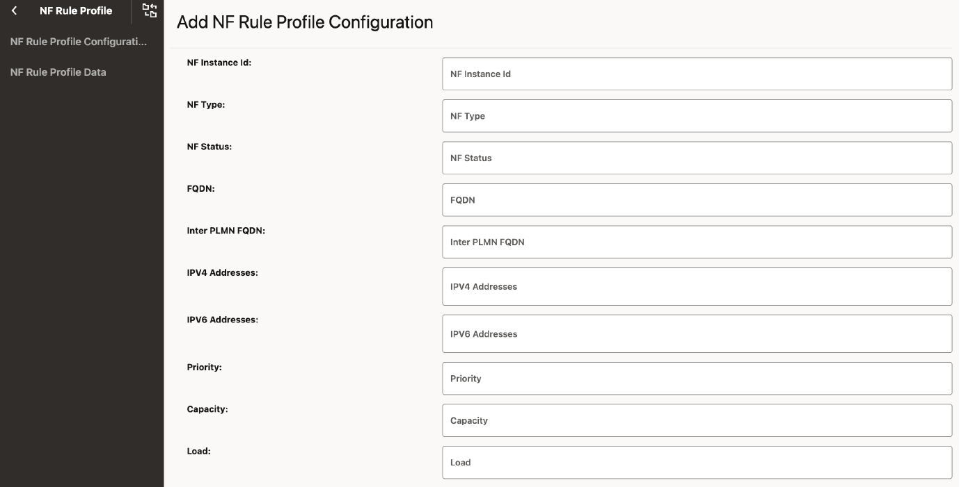

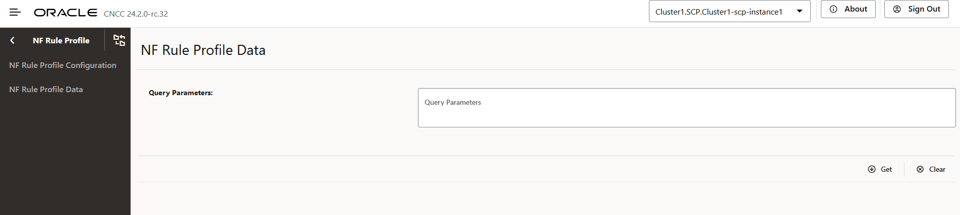

  1. From the left navigation, navigate to SCP, and then click NF Rule Profile.
  2. To add or configure an NF rule profile, click the NF Rule Profile Configuration tab in the left navigation pane.
    Figure 4-47 NF Rule Profile Configuration
  3. Click Add to add NF rule profile.
    Figure 4-48 Add NF Rule Profile
    Add NF Rule Profile
  4. Add the following parameters for all the NF Info:
    • Group Id: Identity of the NF info.
    • Routing Indicators: List of Routing Indicator information.
    • Click Add to add the SUPI Ranges.
    • Click Save to save the SUPI Ranges.
    • Click Remove if you want to remove the NF Info.
    • Click Add to add the NF info details.
  5. Click Save to save the NF Rule Info.
  6. Click Refresh to view the updated values on the screen.
  7. To configure a local PLMN, in the PLMN List section, click Add and enter the required Mobile Country Code (MCC) and Mobile Network Code (MNC) values in the displayed fields.
Modifying IP Addresses

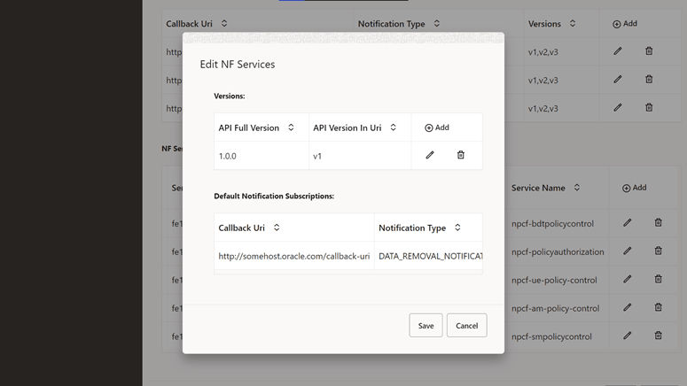

Perform the following procedure to edit the IP addresses which are present under NF service level:
  1. In the NF Service section, to modify any NF service, click the corresponding Edit icon.

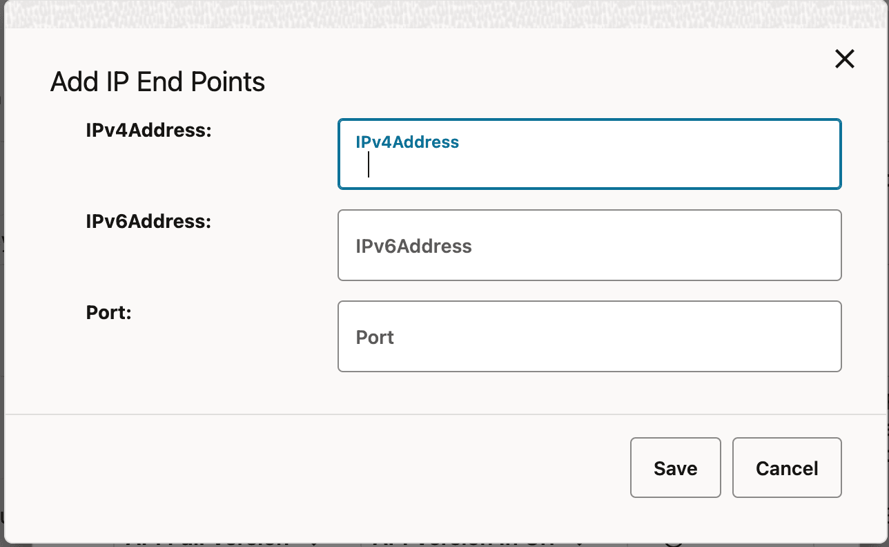

  2. In the IP End Points section, click Add to add IP end points.
    Figure 4-49 Adding IP End Points
  3. Enter IP address in one of the following fields:
    • IPv4Address
    • IPv6Address
      The system displays an error message if you enter IP address in both the above mentioned fields.
      For more information about IPv4Address and IPv6Address configurations, see "Configuring Route Groups" in Oracle Communications Cloud Native Core, Service Communication Proxy REST Specification Guide.
  4. In the Port field, enter the port number.
  5. Click the Edit icon to edit or add the API full versions.
    Figure 4-50 Edit NF Services
    Edit NF Services
  6. Click Save to save the NF Rule Info.

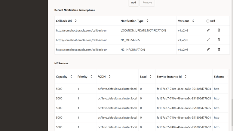

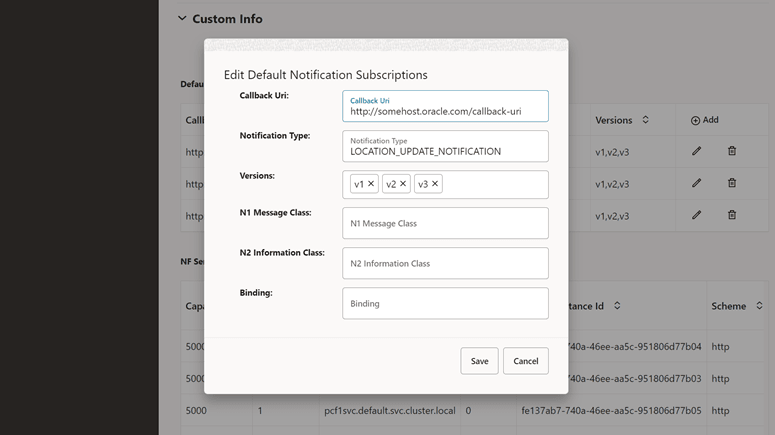

Viewing or Editing the Default Notification Subscriptions
Perform the following procedure to view or edit the default notification subscription which are present under NF service level or NF profile level:
Users cannot modify values for profiles in Default Notification Subscription if the learning source is set to NRF. They can only view it. Editing is only possible when the learning source is set to "Local".
  1. In the NF Rule Profile Configuration section, click Edit from Actions. The Edit NF Rule Profile Configuration screen appears.
    Figure 4-51 Edit NF Rule Profile Configuration
  2. In the Default Notification Subscription section, click the Edit icon for the required callback URI that must be modified. The Edit Default Notification Subscription screen appears.
    Figure 4-52 Default Notification Subscription
  3. Make the required modifications for the following fields:

    Figure 4-53 Edit Default Notification Subscriptions
  4. Click Save to save the NF Rule Info.
4.2.13.1 Fetching NF Rule Profile Data
Following is the procedure to retrieve a collection of NF rule profile data configured at SCP:
  1. From the left navigation menu, navigate to SCP and then click NF Rule Profile.
  2. To retrieve the default notification subscription data for a specific NF rule profile, click on the NF Rule Profile Data tab in the left navigation pane.
  3. The NF Rule Profile Data screen is displayed as follows:
    Figure 4-54 NF Rule Profile Data
  4. Enter the Query Parameters in the field. These parameters may include NFType, ServiceName, NF instance ID, Maximum number of NF profiles (limit), or max-payload-size. For more information, see the "Configuring NF Topology Groups" section in Oracle Communications Cloud Native Core, Service Communication Proxy REST Specification Guide.
  5. Click Get to fetch the response data. The data is displayed in the Response pane.
    Figure 4-55 Response data
    Response data
  6. Click Clear to clear the response data.

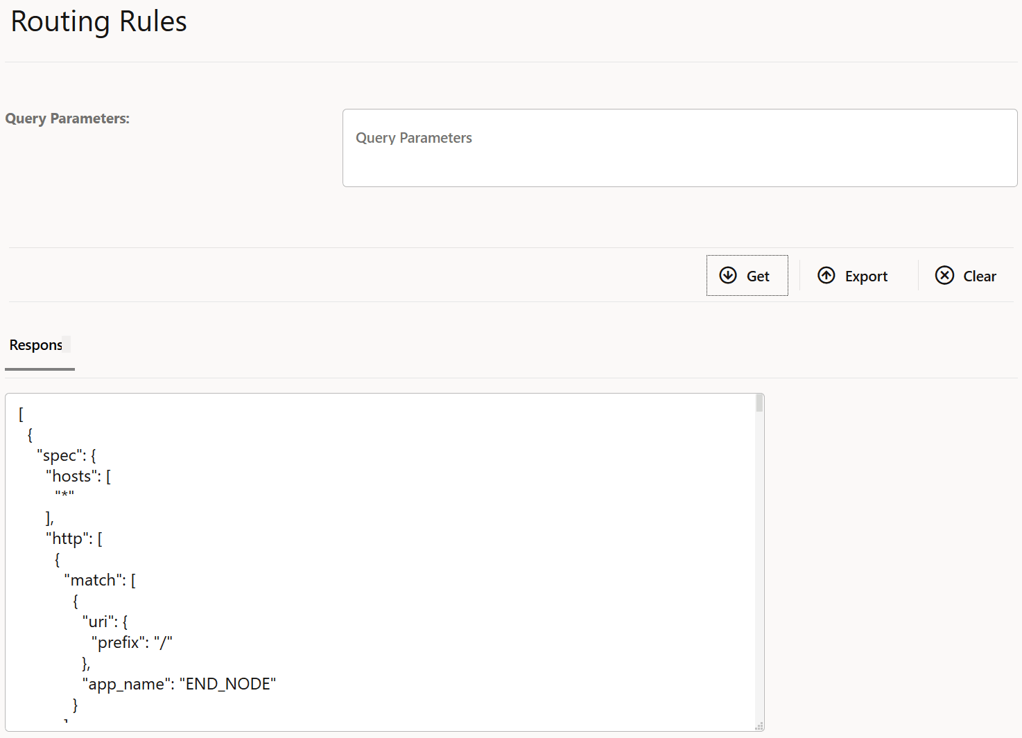

4.2.16 Fetching Routing Rules
Following is the procedure to retrieve a collection of routing rules configured at SCP:
  1. From the left navigation menu, navigate to SCP and then select Reports.
  2. Select Routing Rules R16. The Routing Rules R16 screen is displayed as follows:
    Figure 4-59 Routing Rules R16
    Routing Rules R16
  3. Enter the Query Parameters in the field.
  4. Click Get to fetch the response data. The data is displayed in the Response pane.
    Figure 4-60 Response data
    Response data
    In case the response data is above the configured display limit, a message is displayed stating "Response data has crossed the configured display limit (5 MB), please click on Export to download it as a file.". Currently, the display limit cannot be modified, it is set to 5 MB.
  5. Click Export to download of the response data file.

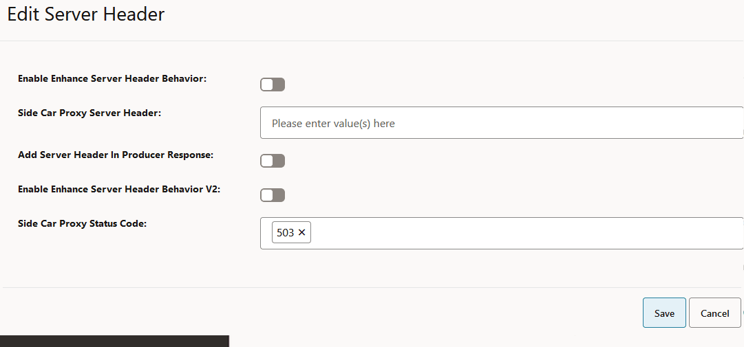

4.2.19 Configuring Server Header
Perform the following procedure to configure server header parameters to include server header in the producer NF error responses.
  1. From the left navigation pane, click the SCP tab, and then click the Global Options tab.
  2. Click the Server Header tab.
  3. In the Server Header section, click Edit.
    The Edit Server Header screen appears.
    Figure 4-63 Edit Server Header
    Edit Server Header
  4. To enable the enhanced server header behavior introduced in SCP 1.15.0, set Enable Enhance Server Header Behavior to true.
    By default, this option is disabled. For information about server header configurations, see "Configuring Server Header" in Oracle Communications Cloud Native Core, Service Communication Proxy REST Specification Guide.
  5. In the Side Car Proxy Server Header field, enter the strings to identify server header values if error response is generated by side car proxy.
    A sample value is envoy.
  6. To enable addition of server header in producer NF generated error responses, set Enable Enhance Server Header Behavior to true.
  7. To enable the enhanced server header behavior introduced in SCP 23.1.0, set Enable Enhance Server Header Behavior V2 to true.
  8. Enter status codes in the Side Car Proxy Server Header Status Code field.
  9. Click Save.

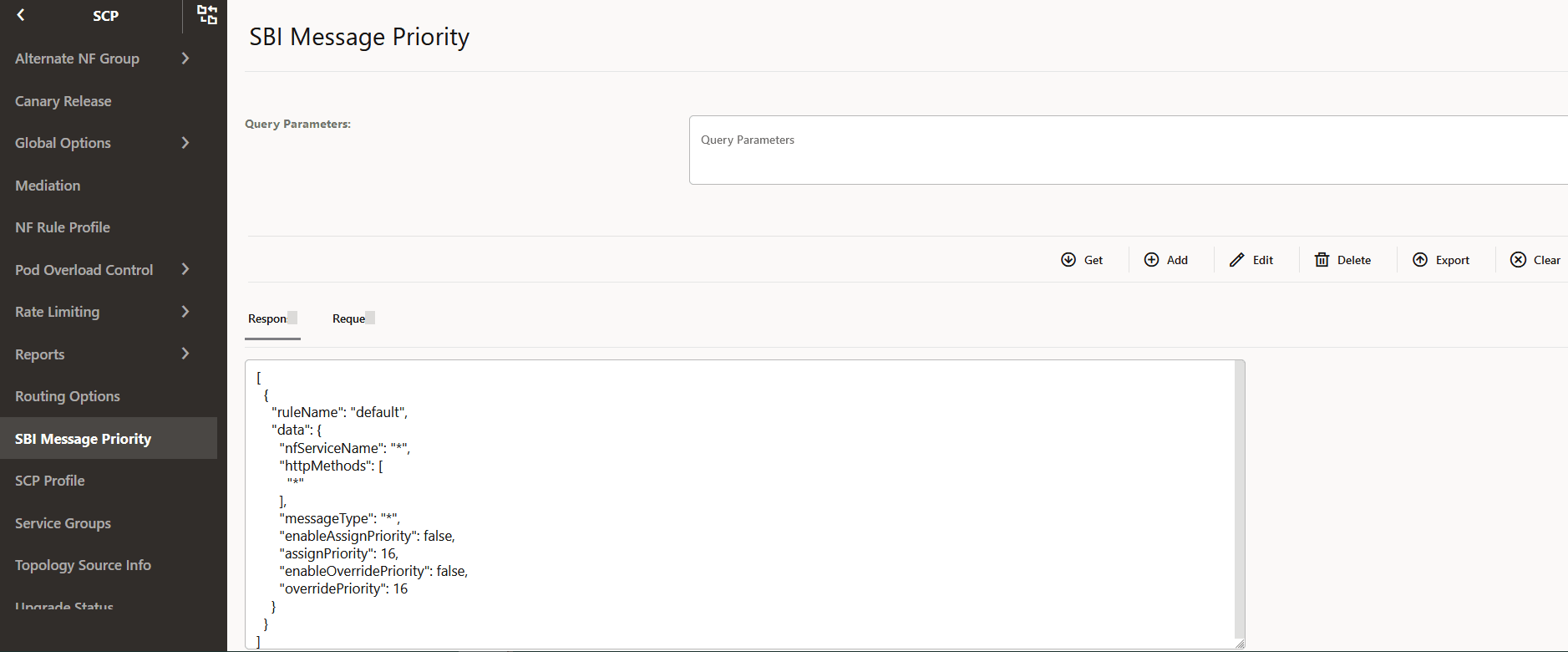

4.2.21 Configuring SBI Message Priority
Perform the following procedure to configure Service Based Interface (SBI) Message Priority parameters supported by the Pod Overload Control feature. You can retrieve SCP_SBI Message Priority configured in SCP and modify the data. Also, add a new SBI message request.
For more information about SBI Message Priority parameters, see Oracle Communications Cloud Native Core, Service Communication Proxy REST Specification Guide.
  1. From the left navigation pane, navigate to SCP and click the SBI Message Priority tab.
  2. In the SBI Message Priority section, click Get to retrieve the SCP_SBI Message Priority configured in SCP.
    Figure 4-65 SBI Message Priority
  3. To add a new SBI message request, click Add and enter the request body information in the Request field.
  4. Click Submit.
  5. To edit, export, delete, or clear the data, click the required buttons as described in the following table:
    Table 4-47 Buttons and Field Descriptions of SBI Message Priority
    Query Parameters Allows to enter parameters to retrieve, add, and update SBI message priority information.
    Get Retrieves the SCP_SBI Message Priority configured in SCP. You can modify this data using the Edit button.

4.2.22.2 Configuring the Default TTL Value
Perform the following procedure to configure the default Time To Live (TTL) value.
  1. From the left navigation pane, navigate to SCP and click the Global Options tab.
  2. To configure the TTL value, click the System Config tab.
  3. In the System Config section, click the Edit icon and set the TTL value as required.
    By default, this value is set to 900s. The range is from 30s to 86400s.
    Figure 4-67 Setting TTL Value
    Setting TTL Value
  4. Click Submit.

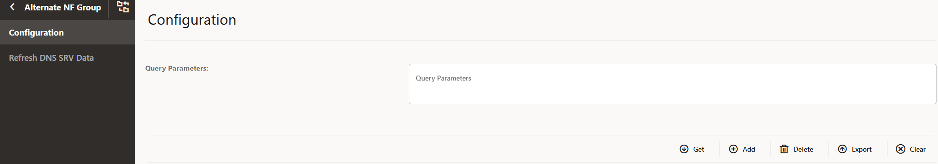

4.2.22.3 Configuring Alternate NF Group
Perform the following procedure to add and fetch DNS SRV records from DB.
  1. From the left navigation pane, navigate to SCP and click the Alternate NF Group tab.
  2. To configure DNS records using query parameters, click the Configuration tab.
  3. In the Configuration section, click Add to add query parameters in the Request field.
    Figure 4-68 Alternate NF Group Options
  4. Click Submit.
    Query parameters automatically appear in the Response field.
  5. Click Get to view all the records of the query parameter in the Response field.
  6. To export, delete, or clear the data, click the required buttons as described in the following table:
    Table 4-48 Configuration Query Parameters
    Query Parameters FQDN of an NF profile.
    Example:
    serviceProtoName=_http._tcp.pcf4svc.scpsvc.svc.cluster.local&apiPrefix=USEast
    Get Fetches DNS SRV records from DB.
    Add Adds DNS SRV records to DB by querying the DNS server with the combination of apiPrefix and Service Proto Name.
    Example:
    {  "apiPrefix": "USEast",  "serviceProtoName": "_http._tcp.pcf2svc.scpsvc.svc.cluster.local" }
    Delete Removes a particular record from DB based on Service Proto Name (SPN).
    Example:
    serviceProtoName=_http._tcp.udm1svc.scpsvc.svc.cluster.local
    Export Exports DNS SRV records in the JSON format.
    Clear Resets all the fields in the Configuration section.
    Response Displays the required DNS SRV records.
    Request Allows you to add a query parameter when you click the Add button.
  7. Click Submit.
4.2.22.4 Configuring Refresh DNS SRV Data
Perform the following procedure to refresh the DNS SRV records in DB.
  2. To refresh DB records, click the Refresh DNS SRV Data tab in the left navigation pane.
