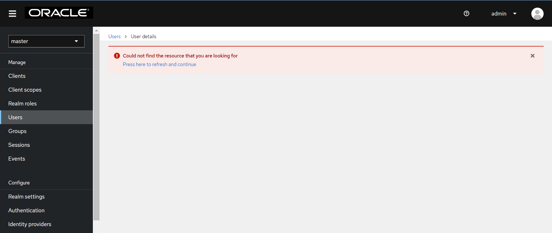

4.27 CNC Console IAM GUI gives an error while accessing some resources under master realm
CNC Console IAM GUI gives an error while accessing some resources under master realm.
Problem:
CNC Console IAM GUI throws the following error when some resources are accessed under the master realm:
"Error: Could not find the resource that you are looking for. Press here to refresh and continue."
Solution:
Some resources (APIs) are blocked under the "master realm" or "cncc realm" because of security reasons. This restricts the user from making any configuration changes. These resources are not applicable for Console. So, whenever the user tries to access blocked resources(APIs), the admin user always gets the error message asking the user to refresh and continue. It is expected behavior. Also note that CNC Console IAM is enabled with a single admin user. All admin operations must be carried out by the same admin user.
Figure 4-1 Unable to Find Resource Error
Parent topic: CNC Console Troubleshooting in Non OCI Deployment

4.39 Tracing Deleted Usernames in CNC Console When Only UUIDs Are Logged
Problem:
When a user is deleted through the M-CNCC IAM UI, the IAM system logs (kc-0 and iam-ingressgateway pods) record only the user’s UUID, not the username. This makes it difficult to determine which user account was deleted.
Solution:
Extract the Deleted User’s UUID
In the IAM deletion log entry generated by the M-CNCC IAM pod logs:
- The
userIdfield shows the UUID of the user who performed the delete action. - The
resourcePathfield contains the UUID of the user who was deleted.
Copy the UUID from the resourcePath field and use in one of these
options:
Option 1 — Search Core UI Logs for Earlier Activity
- Search the M-CNCC or A-CNCC Core Ingress Gateway logs for the extracted UUID.
- The Core Ingress Gateway logs record both the username and the UUID, allowing you to match the UUID to the corresponding username.
Option 2 — Query Prometheus Metrics
- Use the extracted UUID to query Prometheus metrics collected by the M-CNCC Core Ingress Gateway pod or A-CNCC Core Ingress Gateway pod.
- Run the following query on the
log:
Replaceoc_ingressgateway_http_requests_total{namespace="<namespace>", UserId="<user-uuid>"}<namespace>with the target namespace (for example, cncc) and<user-uuid>with the UUID found in the deletion log. - Review the metrics results, which include mappings of usernames to UUIDs from previous activity.
If you use historical logs or metric data where both the username and UUID were previously recorded, you can find the username associated with a deleted UUID.
