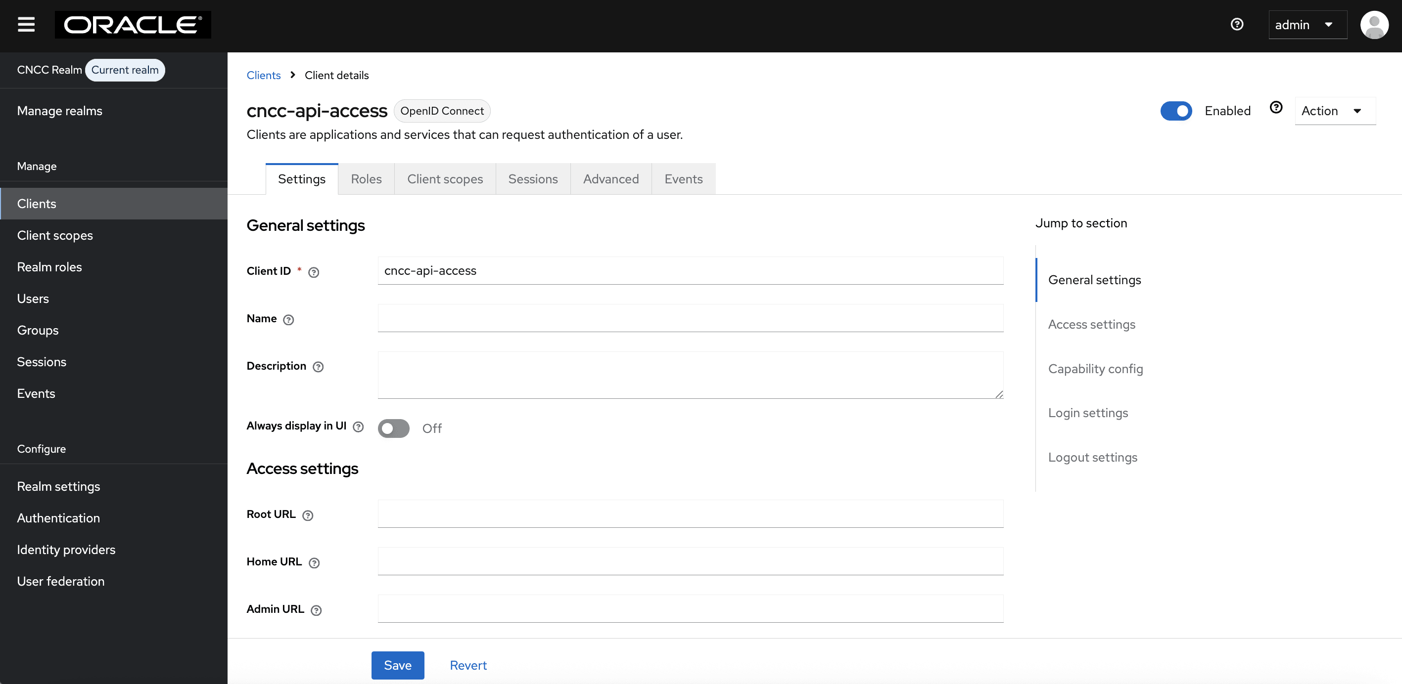

  4. Click cncc-api-access. The following screen appears:
    Figure 6-2 cncc-api-access
    cncc-api-access
  5. Navigate to the Capability config section in the Settings tab and select the Direct Access Grants checkbox. Click Save.
    Figure 6-3 Direct Access Grants
