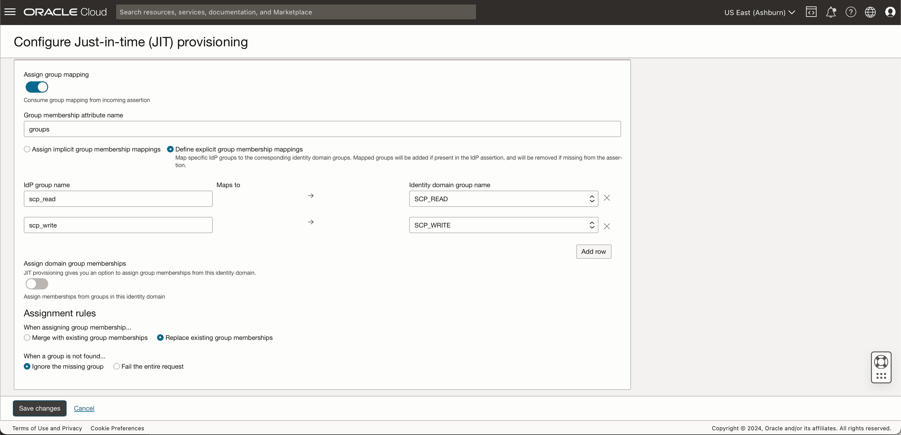

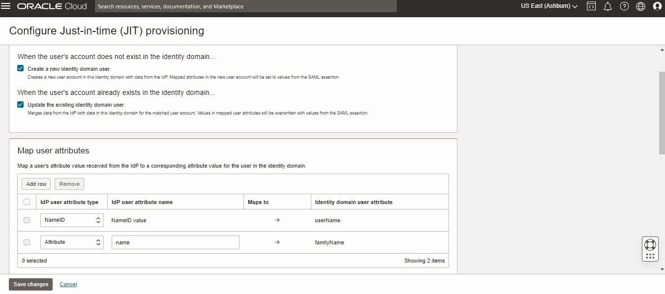

JIT (Just-In-Time) Configuration in OCI IAM
OCI IAM allows setting up a SAML identity provider (IdP) that uses Just-In-Time (JIT) provisioning for an identity domain.
For information on assigning identity providers to policy, see the "Adding a SAML Just-in-Time Identity Provider" section in Oracle Cloud Infrastructure Documentation.
Figure 5-1 JIT Provisioning
Configuration Example:
The NameID value to userName is the default mapping, and the name to familyName mapping is configured by the user.

}'<saml:AttributeStatement>
<saml:Attribute FriendlyName="name"
Name="name"
NameFormat="urn:oasis:names:tc:SAML:2.0:attrname-format:basic">
<saml:AttributeValue xmlns:xs="http://www.w3.org/2001/XMLSchema"
xmlns:xsi="http://www.w3.org/2001/XMLSchema-instance"
xsi:type="xs:string">SamlUser</saml:AttributeValue>
</saml:Attribute>Note:
The user must ensure that the SAML IdP is populating these attributes in the assertions; otherwise, JIT configuration will not work, and SAML SSO authentication will fail.
In role mapping, since OCI IAM reads roles as groups, we have assigned 'Group membership attribute name' as groups.
Figure 5-2 Sample Role Mapping

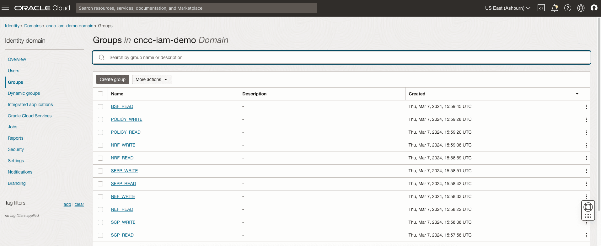

5.3.4 View Groups
To view groups:
- Log in to OCI Console.
- Open the navigation menu, and click Identity & Security.
Under Identity, click Groups. A list of the groups in your tenancy
appears.
Figure 5-3 View Groups
Parent topic: OCI Groups

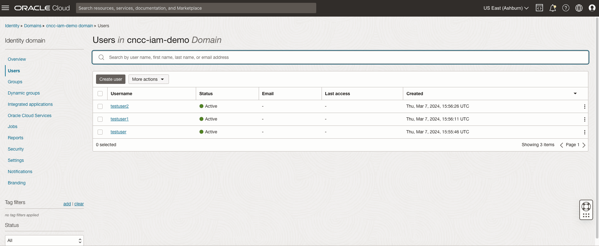

5.4.4 View Users in OCI IAM
- Open the navigation menu and click Identity & Security. Under Identity, click Users. A list of users in your tenancy appears.
Figure 5-4 View Users
Parent topic: OCI Users

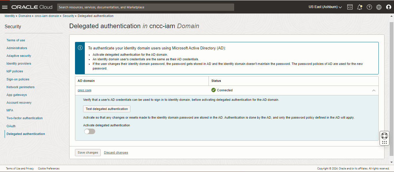

5.5 OCI Active Directory Integration
Overview
Active Directory (AD) stores information about objects on the network and makes this information easy for administrators and users to find and use. Active Directory uses a structured data store as the basis for a logical and hierarchical organization of directory information.
Prerequisites
- Running Active Directory.
- Groups must be created in Active Directory following the CNC Console group name format, and users must be assigned to the groups.
To create CNC Console groups, see OCI Groups.- Setting Up a Microsoft Active Directory Bridge
- Setting Up A Microsoft Active Directory Bridge With SSL Enabled
- Importing Users and Groups From Active Directory
- Setting up Delegated Authentication

5.5.4 Setting up Delegated Authentication
- Open the navigation menu and click Identity & Security. Under Identity, click Domains.
- Click Security.
- Click Delegated Authentication.
- Click Test Delegated Authentication.
- Provide active directory user credentials.
- Enable Activate Delegated Authentication.
Figure 5-6 Delegated Authentication in CNC Console IAM Domain
