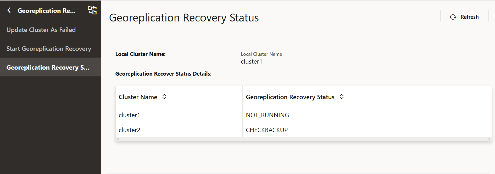

7.4 Restoring Geo-replication (GR) Failure
This section provides the procedures to restore georeplication failures in cnDBTier clusters using cnDBTier fault recovery APIs or CNC Console.
Geo-Replication Recovery (GRR)
When geo-replication between two cnDBTier sites is interrupted, Geo-Replication Recovery (GRR) is required to re-establish replication.
When re-installing or recovering a site, if a remote site has failed or is not yet installed, do not leave the remoteSiteIp field blank. Instead, configure a placeholder (dummy) IP address for that remote site. If remoteSiteIp is left blank, GRR may remain in the STARTDRRESTORE state and continue waiting for the remote site IP to be configured.
The recovery process involves:
  1. Selecting one cnDBTier site as the good site (typically the site handling the most recent traffic).
  2. Taking a backup from the good site.
  3. Recovering the failed site using this backup.
  4. Once the restore is complete, re-establishing replication from the restore point.
  5. After recovery, both cnDBTier sites return to a replication state.
Types of GRR
DBTier supports two types of GRR actions which are Manually Initiated GRR and Automatically Initiated GRR.
Manual GRR is used in scenarios where:
  • Both cnDBTier clusters are up, running, and accessible.
  • Replication is broken due to an error or experiencing significant lag.
To re-synchronize replication, Manual GRR is performed.
Key characteristics:
  • The GRR process must be explicitly triggered by the user.
  • The user selects the good site from which the backup is taken.
  • The failed or lagging site is recovered using the backup from the chosen good site.
Auto GRR is triggered in scenarios where:
  • The cnDBTier cluster is not running, or the site needs to be abandoned.
  • The affected site must be uninstalled and reinstalled after resolving underlying issues.
Recovery flow:
  1. The failed cnDBTier site is uninstalled or abandoned.
  2. The site is reinstalled with the same internal and external IP configuration.
  3. Upon startup, the site discovers its configuration from existing healthy sites.
  4. The site determines that recovery is required and automatically triggers GRR.
  • The user does not select the good site; the system selects the healthy site with the lowest site_id as the backup source.
  • Backup and restore operations are executed automatically to recover the failed site.
  • Reinstallation of a cnDBTier site, while other mate sites with the original configuration are available, will automatically trigger GRR from the reinstalled site.
  • During Auto GRR, the reinstalled site automatically selects the available remote site with the lowest site ID as the good site for backup.
  • Auto GRR progress can be monitored using the following command, which must be executed on the good site with the lowest site ID:
dbtrecover --start-from-monitoring

  4. Wait until the georeplication recovery is complete. You can check the cluster status using Verifying Cluster Status Using cnDBTier procedure. When the cnDBTier cluster is UP, continue monitoring the georeplication recovery status by following the Monitoring Georeplication Recovery Status Using cnDBTier APIs procedure.
    The backup-manager-service pod may restart a couple of times during the georeplication recovery. You can ignore these restarts, however, ensure that the backup-manager-service pod is up at the end of the georeplication recovery.

    You can verify and monitor the cluster status by performing the following steps:
    1. Perform the Verifying cnDBTier Cluster Status Using CNC Console procedure to check the cluster status.
    2. When the cnDBTier cluster is UP, continue monitoring the georeplication recovery status by performing the Monitoring Georeplication Recovery Status Using CNC Console procedure.

  6. Wait until database is restored in the first failed cnDBTier cluster and georeplication recovery procedure is completed.
    Check the cluster status using Verifying cnDBTier Cluster Status Using CNC Console procedure after the cnDBTier cluster is UP and continue monitoring the georeplication recovery status.
    Follow Monitoring Georeplication Recovery Status Using CNC Console procedure to monitor the georeplication recovery status.

  8. Wait until the georeplication recovery is complete. Verify and monitor the cluster status by performing the following steps:

    2026-02-05T08:31:19Z INFO - Recovering name20...
    2026-02-05T08:31:20Z INFO - Recovering name20 (mysql)...
    2026-02-05T08:31:20Z INFO - Setting dr_state to STARTDRRESTORE using 10.233.15.125...
    2026-02-05T08:31:21Z INFO - dr_state set to STARTDRRESTORE using 10.233.15.125
    2026-02-05T08:31:21Z INFO - GRR started for name20 monitoring on 2000
    2026-02-05T08:31:21Z INFO - Must use --start-from-monitoring if dbtrecover is interrupted
    2026-02-05T08:31:21Z INFO - ANSWERS: "no" "yes" "no" "yes" "yes"
    2026-02-05T08:31:21Z INFO - ****************************************************************************************************
    2026-02-05T08:31:21Z INFO - END PHASE 5: GRR start
    2026-02-05T08:31:21Z INFO - Ended timer PHASE 5: 1770280281
    2026-02-05T08:31:21Z INFO - PHASE 5 took: 00 hr. 00 min. 02 sec.
    2026-02-05T08:31:21Z INFO - Started timer PHASE 6: 1770280281
    2026-02-05T08:31:21Z INFO - BEGIN PHASE 6: monitoring GRR
    2026-02-05T08:31:21Z INFO - Monitoring status in 10.233.15.125 from ndbmysqld-0...
    2026-02-05T08:31:22Z INFO - STATE = STARTDRRESTORE
    2026-02-05T08:31:23Z INFO -
    site_name  site_id  dr_state        dr_backup_site_name  backup_id  stop_replication_mysqlds  cluster_disconnect_count  cluster_monitor_ts
    name10    1        NONE            NULL                 NULL       0                         0                         2026-02-05          08:29:44.518
    name20    2        STARTDRRESTORE  NULL                 NULL       0                         0                         2026-02-05          08:29:29.533
    2026-02-05T08:31:28Z INFO - STATE = REINSTALLED
    2026-02-05T08:31:29Z INFO -
    name20    2        REINSTALLED  NULL                 NULL       0                         0                         2026-02-05          08:29:29.533
    2026-02-05T08:31:34Z INFO - STATE = VALIDATERESOURCES
    2026-02-05T08:31:35Z INFO -
    name20    2        VALIDATERESOURCES  NULL                 NULL       0                         0                         2026-02-05          08:29:29.533
    2026-02-05T08:31:40Z INFO - STATE = LOCK_NF_USERS
    2026-02-05T08:31:41Z INFO -
    name20    2        LOCK_NF_USERS  NULL                 NULL       0                         0                         2026-02-05          08:29:29.533
    2026-02-05T08:31:45Z INFO - STATE = INITIATEBACKUP
    2026-02-05T08:31:47Z INFO -
    name20    2        INITIATEBACKUP  NULL                 NULL       0                         0                         2026-02-05          08:29:29.533
    2026-02-05T08:31:51Z INFO - STATE = CHECKBACKUP
    2026-02-05T08:31:52Z INFO -
    name20    2        CHECKBACKUP  name10              205260832  0                         0                         2026-02-05          08:29:29.533
