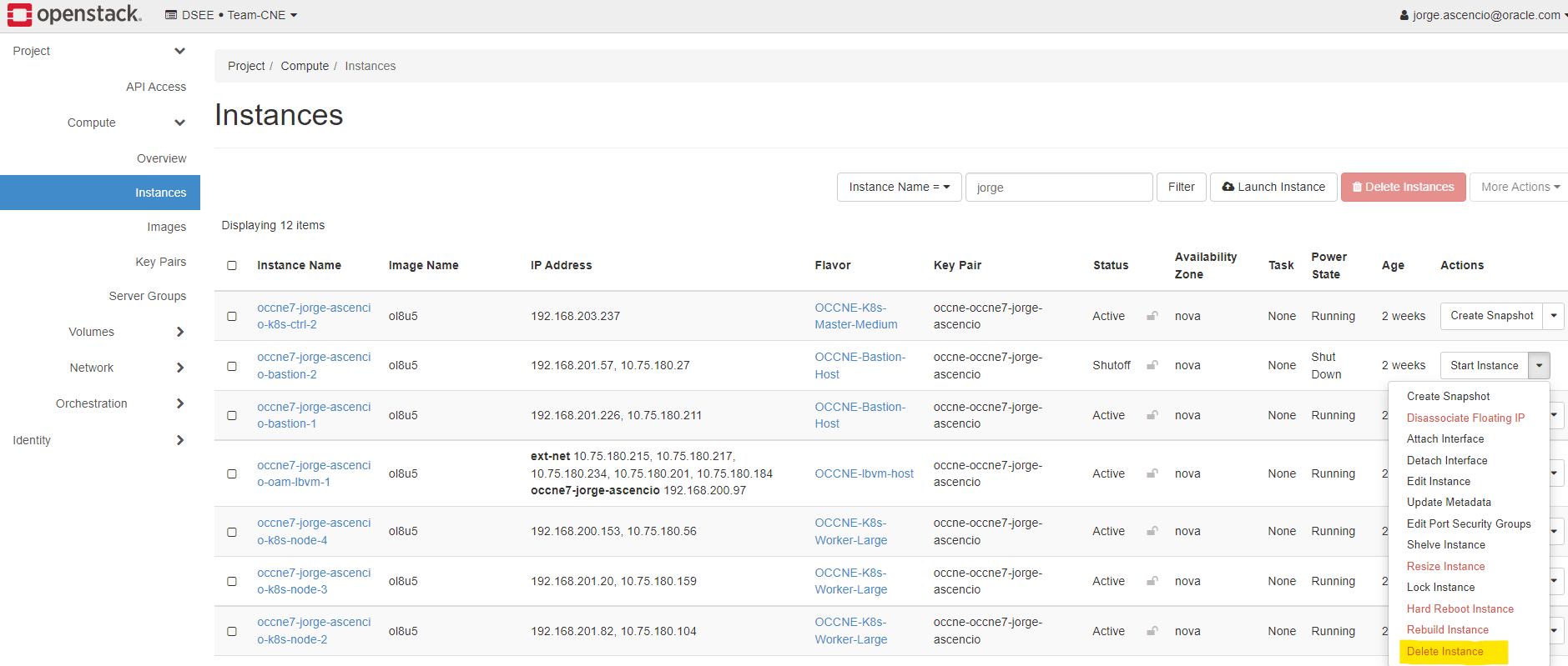

Replacing a Failed Bastion Host in OpenStack
  1. Log in to OpenStack cloud using your credentials.
  2. From the Compute menu, select Instances, and locate the failed Bastion's instance that you want to replace.
  3. Click the drop-down list from the Actions column, and select Delete Instance to delete the failed Bastion host:
    Delete_Failed_BastionHost_OpenStack

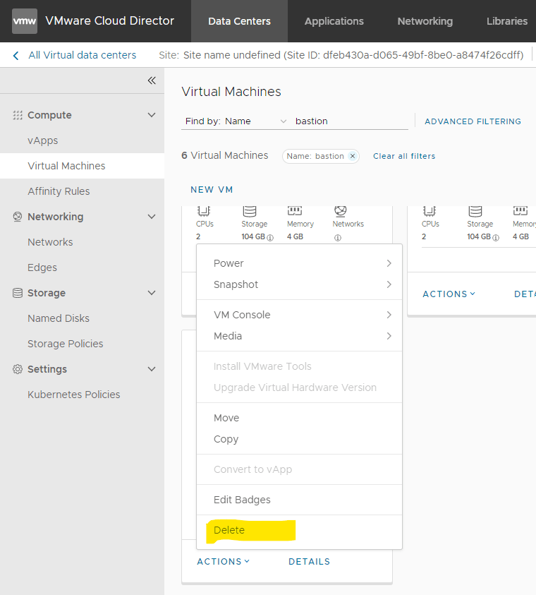

Replacing a Failed Bastion Host in VMware
  1. Log in to VMware cloud using your credentials.
  2. From the Compute menu, select Virtual Machines, and locate the failed Bastion's VM that you want to replace.
  3. From the Actions menu, select Power → Power Off.
  4. From the Actions menu, select Delete to delete the failed Bastion Host:
    Delete_Failed_Bastion_Host_in_VMWare

  1. Use SSH to log in to Bastion Host and remove the failed Kubernetes controller node by following the procedure described in the Removing a Controller Node in OpenStack Deployment section.

  6. Log in to OpenStack GUI using your credentials and note the replaced node's internal IP address and hostname. In most of the cases, the new IP address and hostname remains the same as the ones before deletion. The new IP address and hostname are referred to as replaced_node_ip and replaced_node_hostname in the remaining procedure.

  2. Delete the failed node from OpenStack GUI:
    1. Log in to the Openstack GUI console by using your credentials.
    2. From the list of nodes displayed, locate and select the failed worker node.
    3. From the Actions menu in the last column of the record, select Delete Instance.
      Delete Worker Node from OpenStack GUI
    4. Reconfirm your action by clicking Delete Instance and wait for the node to be deleted.
