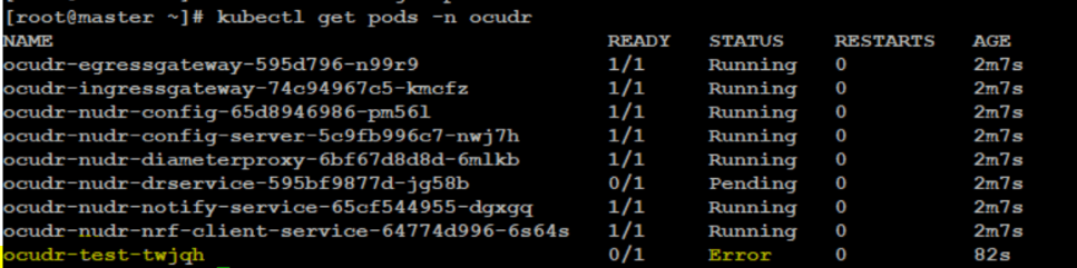

  • Run the following command to check the installation of UDR.
    $ kubectl get pods -n <ocudr-namespace>
    Figure 4-1 Sample Output: UDR Pods Status
    The STATUS of all the pods is 'Running'.

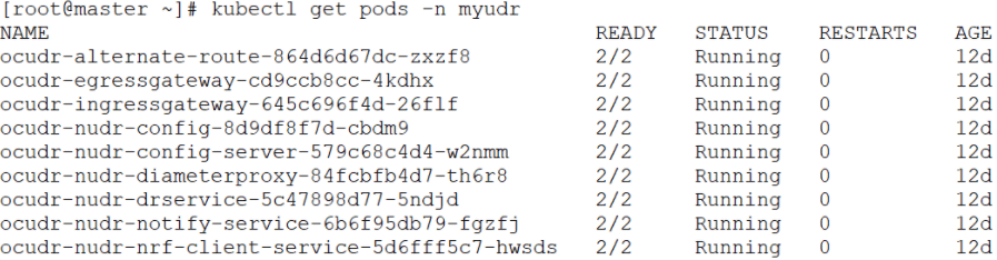

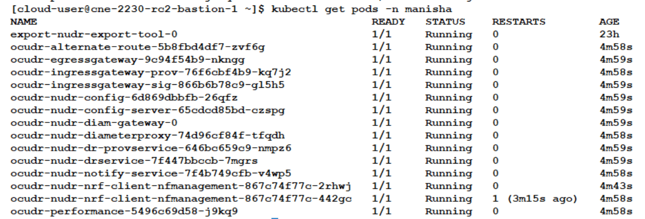

  • Run the following command to verify whether UDR specific pods are working as expected:
    Figure 4-2 Sample Output: UDR Pods Status
    Sample Output UDR Pods Status
    Result: In the figure given above, you can see that the status of all the pods is 'Running'.
    The number of pods for each service depends on Helm configuration. In addition, all pods must be in a ready state and you need to ensure that there are no continuous restarts.

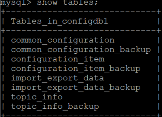

  • Log in to the NDB cluster and verify the creation of UDR database with all the tables. To check the entries in the database tables, run the following command:
    select count(*) from RESOURCE_MAP
    It ensures that the connection is fine and the database is created successfully. This count differs based on the udrServices option selected under the global section of the custom-values.yaml file. But this table cannot be empty.

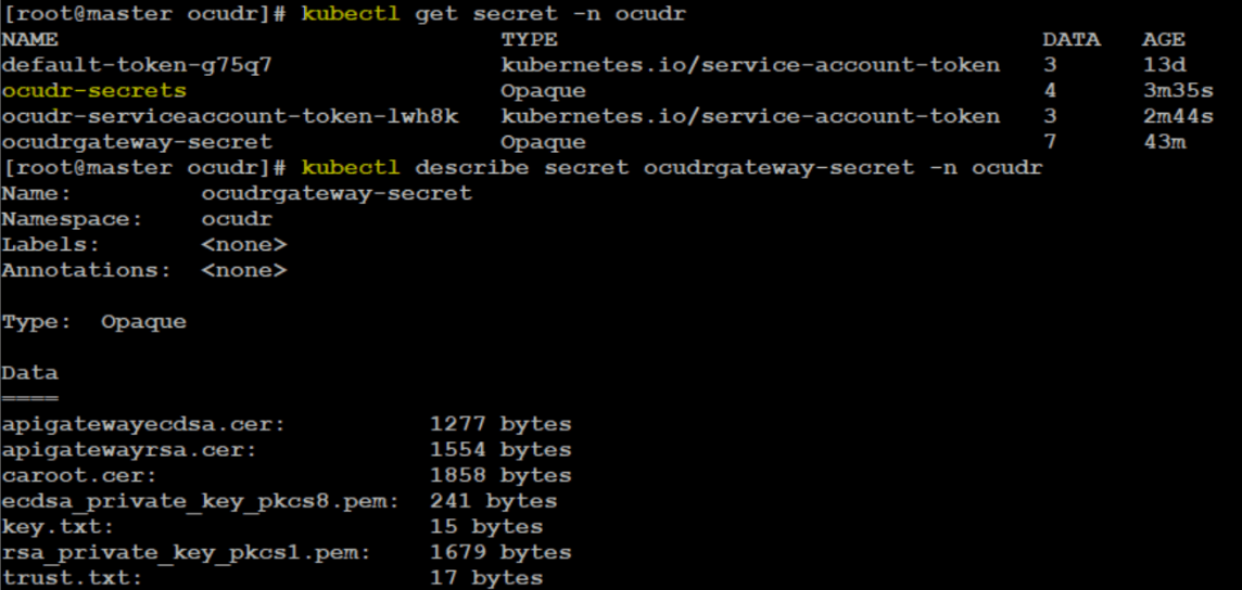

  • Check whether Kubernetes secrets are present. If secrets exist, then check their encrypted details like username, password, and DB name. If these details do not exist, then update the secrets.

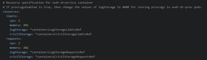

Verifying Resource Allocation Failure
To verify any resource allocation failure:
  • Run the following command to verify whether any pod is in the Pending state.
    kubectl describe <nudr-drservice pod id> --n <ocudr-namespace>
  • Verify whether any warning on insufficient CPU exists in the describe output of the respective pod. If it exists, it means there are insufficient CPUs for the pods to start. Address this hardware issue.
  • If any preinstall hooks are in pending state, then check the resources allocated for hooks. Do not allocate higher values for hooks. If hooks with lower CPU or memory are going to pending state, then there is an issue with available resources on cluster. Check the resources and reduce the number of CPUs alloted to the pod in the values.yaml file.

    resources
    nudr-drservice:
      resources:
        limits:
          cpu: 2
          memory: 2Gi
        requests:
          cpu: 2
          memory: 2Gi

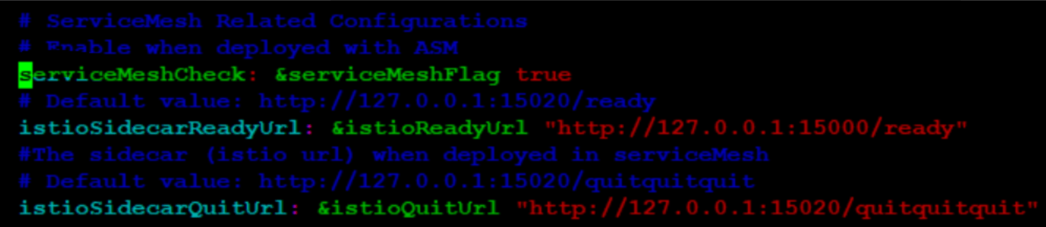

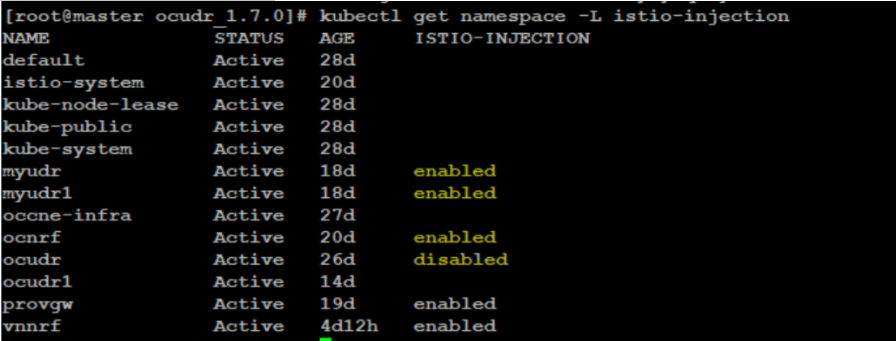

4.3.2.3 Debugging UDR with Service Mesh Failure
There are some known failure scenarios that you can encounter while installing UDR with service mesh. The scenarios along with their solutions are as follows:
  • Istio-Proxy side car container not attached to Pod: This particular failure arises when istio injection is not enabled on the NF installed namespace. Run the following command to verify the same:
    kubectl get namespace -L istio-injection
    Figure 4-6 Verifying Istio-Proxy
    To enable the istio injection, run the following command:
    kubectl label --overwrite namespace <nf-namespace> istio-injection=enabled
  • If any of the hook pods is not responding in the 'NotReady' state and is not cleared after completion, check if the following configuration is set to 'true' under global section. Also, ensure that the URL configured for istioSidecarQuitUrl is correct.
    Figure 4-7 When Hook Pod is NotReady

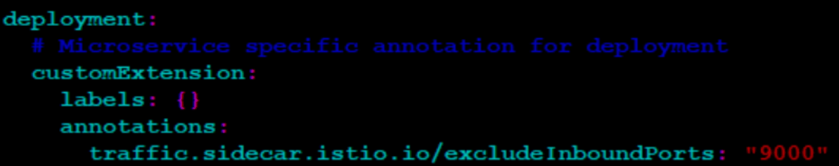

  • When vDBTier is used as backend and there are connectivity issues, and when nudr-preinstall communicates with DB, which can be seen from error logs on preinstall hook pod, then make the destination rule and service entry for mysql-connectivity-service on occne-infra namespace.
  • When installed on ASM, if ingressgateway, egressgateway, or alternate-route services go into CrashLoopBackOff, you must check if the coherence ports is excluded for inbound and outbound on the istio-proxy.
  • On the latest F5 versions, if the default istio-proxy resources assigned is less, make sure that you assign minimum one CPU and one GB RAM for all UDR services. The traffic handling services must be same as mentioned in the resource profile. If the pods crash due to less memory, you must check the configuration. You can refer the following annotations in the custom values file.

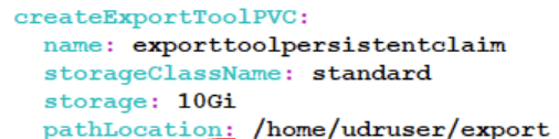

    Figure 4-12 Export tool Presistent Claim

4.3.3.1 Debugging Helm Test Issues
To debug the Helm Test issues:
  • Run the following command to get the Helm Test pod name.
    kubectl get pods -n <deployment-namespace>
  • Check for the Helm Test pod that is in error state.
    Figure 4-15 Helm Test Pod
    Helm Test Pod
  • Run the following command to check the Helm Test pod:
    kubectl logs <helm_test_pod_name> -n <deployment_namespace>
    In the logs, concentrate on ERROR and WARN level logs. There can be multiple reasons for failure. Some of them are shown below:

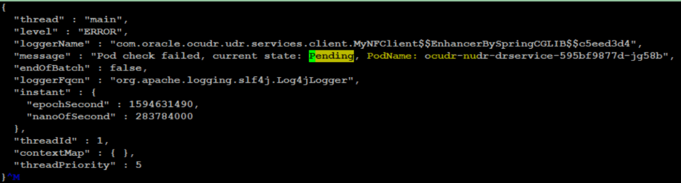

    • Figure 4-16 Helm Test in Pending State
      In this case, check for CPU and Memory availability in the Kubernetes cluster.

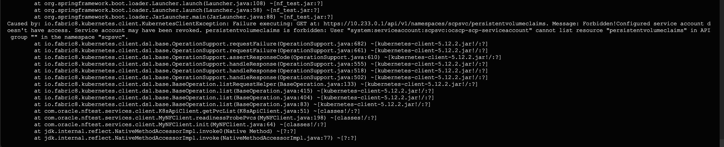

The Helm test logs generate the following error:
Figure 4-18 Helm Test Log Error
Helm Test Log Error
  • Check whether the required permission for te resource of the group is missing in the deployment-rbac.yaml file. The above sample shows that the permissions are missing for the persistent volume claims.
  • Give the appropriate permissions and redeploy.

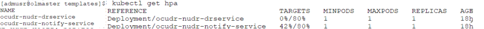

4.3.3.2 Debugging Horizontal Pod Autoscaler Issues
There can be scenarios where Horizontal Pod Autoscaler (HPA) running on nudr-drservice deployment and nudr_notify_service might not get the CPU metrics successfully from the pods. Run the following command to view the HPA details:
kubectl get hpa
In this scenario, you need to check the following:
  • Check whether the metrics server is running on the Kubernetes cluster. If the server is running and the CPU usage pod is still not accessible, check the metrics-server values.yaml file for the arguments passed shown as follows:
    Figure 4-19 metrics-server yaml file
  • If any changes are required, make them, restart the metrics server pod, and check for correctness. Wait a couple of minutes after the metrics server starts to see the CPU usage update on running kubectl get hpa command.
    Figure 4-20 Debugging HPA Issues

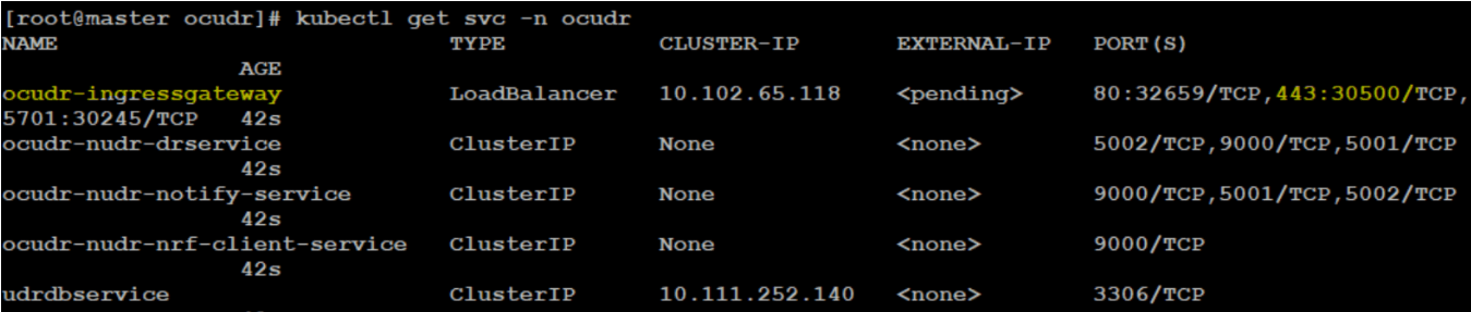

4.3.3.3 Debugging HTTPS Support Related Issues
UDR supports HTTPS and its validations at the UDR Ingress Gateway. You may encounter issues related to HTTPS when:
  • HTTPS port is not exposed: Run the following command to verify if the HTTPS port is exposed:
    kubectl get svc --n <ocudr-namespace>
    Figure 4-21 HTTPS Port Exposed
    HTTPS Port Exposed
    In the above figure, the secure port is 443.
    If the HTTPS port is not exposed, then enable the configuration information highlighted in the following figure under the ingressgateway section of the values.yaml file.

    • If config initssl is enabled, then check whether secrets are created with all required certificates. The following figure shows the commands that you need to run to check whether secrets are present and have all the required data.
      Figure 4-24 Commands to Check Secrets

    • The public key certificate stored in secret is not in proper format: The public key format is {nrfInstanceId}_RS256.crt (6faf1bbc-6e4a-4454-a507-a14ef8e1bc5c_RS256.crt).
      If the public key is not stored in this format, then check the logs of pod that states "Malformed entry in NRF PublicKey Secret with key ecdsa.crt". Here, ecdsa.crt is the public key certificate in oauthsecret.
    By using public key certificate in required format, you can resolve these issues. You need to correct the fields with the proper secret name and namespace.

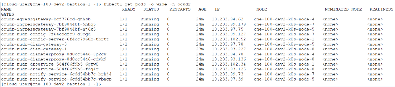

  1. Run the following command to check the pods running on different nodes:
    kubectl get pods -o wide -n ocudr
    Figure 4-28 Pods Running on Different Nodes

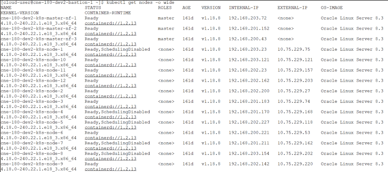

  2. Run the following set of commands to unschedule the node:
    kubectl cordon cne-180-dev2-k8s-node-4
    kubectl cordon cne-180-dev2-k8s-node-7
    kubectl cordon cne-180-dev2-k8s-node-5
    kubectl cordon cne-180-dev2-k8s-node-8
    kubectl cordon cne-180-dev2-k8s-node-1
    After unscheduling the nodes, the state of the nodes changes to 'Ready,SchedulingDisabled' as follows:
    Figure 4-29 After Nodes are Unscheduled

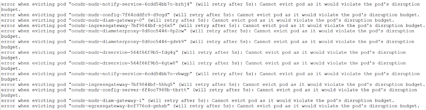

  4. If you are required to drain the nodes or evict the pods, then ensure the minimum number of pods are in ready state to serve the application request. To configure the minimum number of pods value, set the minAvailable parameter in the Helm charts for individual microservices. This ensures the availability of a minimum number of pods and they are not evicted. You can check logs while draining the nodes as follows:
    Figure 4-30 Logs When Trying to Evict Pod

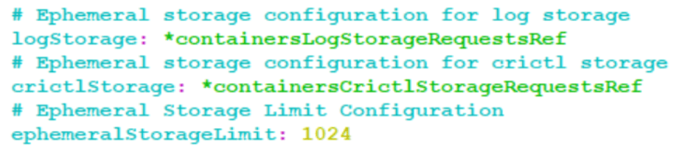

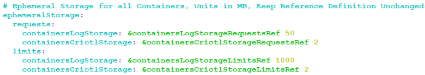

4.3.3.5 Debugging Pod Eviction Issues
During heavy traffic, there can be a situation where any UDR or Provisioning Gateway pod can run into evicted state. To handle the eviction issues, increase the Ephemeral storage allocation of pods under global section. Update the containerLogStorage configuration under global.ephemeralStorage.limits section to '5000'.
Figure 4-31 Configuring Container Log Storage
After making the above changes, perform helm upgrade. If the Ingress Gateway or Egress Gateway pods are running into Evicted state, then update the ephemeralStorageLimit configuration to '5120' and perform a helm upgrade.
Figure 4-32 Ingress Gateway or Egress Gateway - Evicted State

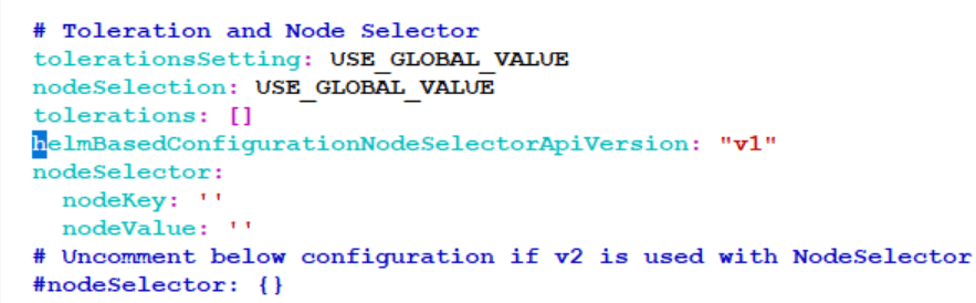

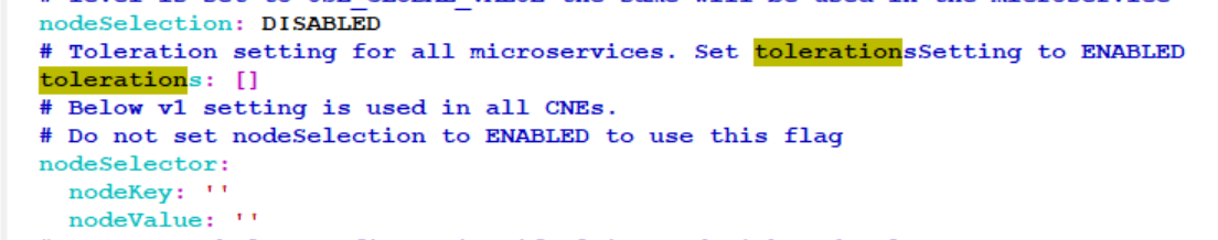

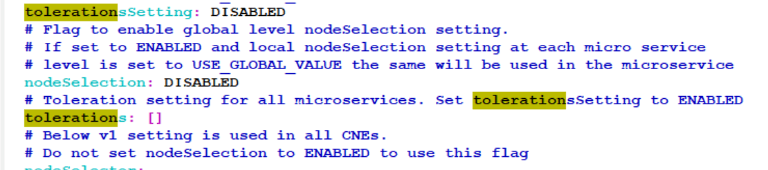

4.3.3.6 Debugging Taints or Tolerations Misconfigurations
The following points should be considered when the Node Selector and Taints or Toleration feature is used on UDR or Provisioning Gateway:
  • If any of the pods are going to the Pending state, ensure that the node selector used is pointing to the correct slave node name, and it has enough space to place the pod.
    Figure 4-33 Global Configuration
  • Use the following configuration to configure toleration settings for the tainted nodes.Update the Global section configurations for the settings to be applicable for all the services.
    Figure 4-34 Global Configuration
  • For Node Selector and Tolerations, configuration at the microservice level takes priority over configuration at the global level.
    Figure 4-35 Toleration and Node Selector

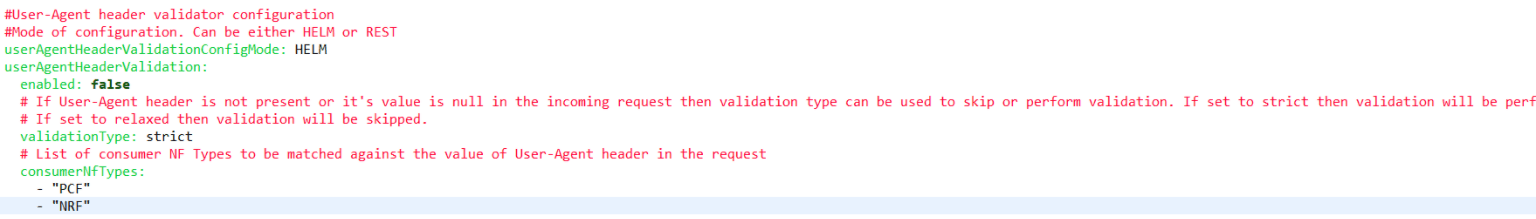

4.3.3.8 Debugging User Agent Header Related Issues
If there are issues related to user agent header, then perform the following steps:
  • Under Ingressgateway section, enable the user-agent flag to true.
  • If there are issues in the consumer NFTypes validations for NF's, then check the NF types in the configurations present under ingressgateway section.
    Figure 4-36 Enabling User Agent Header
  • If the userAgentHeaderValidationConfgMode set to REST, the custom-values.yaml configurations are ignored. The configuration is loaded based on userAgentHeaderValidationConfgMode is set.
From UDR 24.1.0 release onwards this feature is supported using REST API mode. If the feature does not work, make sure the feature is enabled and configured post UDR is upgraded, see Postupgrade Tasks section in Oracle Communications Cloud Native Core, Unified Data Repository Installation, Upgrade, and Fault Recovery Guide

  • If provLogsEnabled flag is set to true, then it is recommended to change the values of logStorage to 4000 MB (apporx. equal to 4GB) for nudr-dr-prov pods to store provision logging files. If the values are not updated, then nudr-dr-prov pods will crash when ephemeral storage is full.
    Troubleshooting for Provisioning Logging

If requests for ocudr-nudr-config fail, try to find the root cause from configdb using following guidelines:

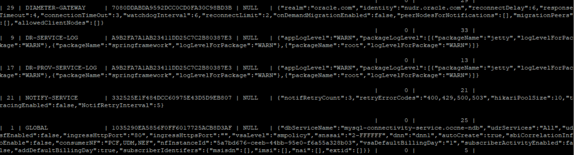

  • If you get a BAD REQUEST for GET API, then make sure all the tables shown below is present in configdb table.
    Figure 4-37 Configdb Table
    Configdb table
  • If all the table are present and you are getting a BAD REQUEST for GET API, then you must verify the configuration item table shown below.

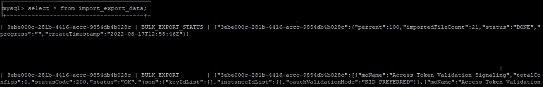

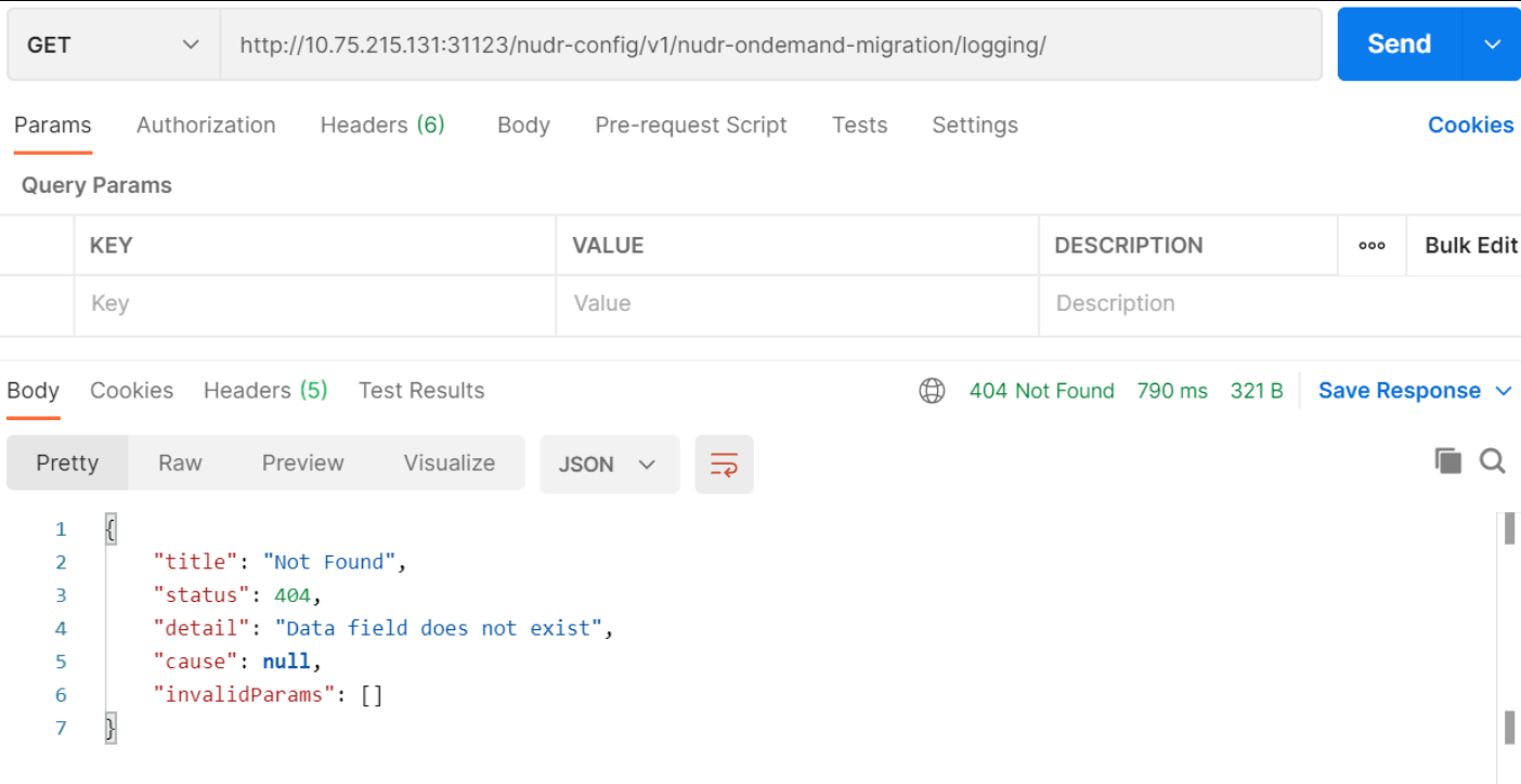

  • If you get a BAD REQUEST and NOT FOUND for Import and Export API, then you must verify the import and export data table shown below.
    Figure 4-39 Import and Export Data

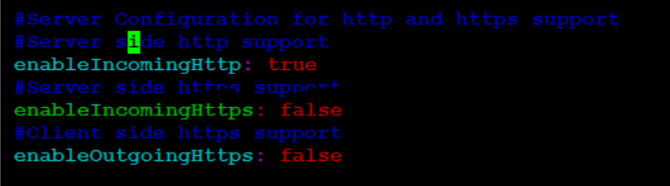

  • To enable the outgoing traffic using HTTPS, set the enableOutgoingHttps parameter as 'true'.
  • Create unique certificates and keys for all Egress and respective Ingress NF's. It is the same as Ingress debugging .

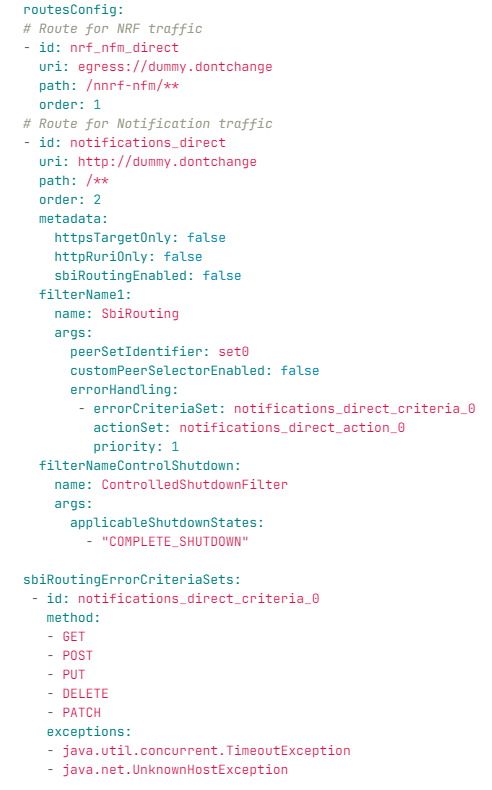

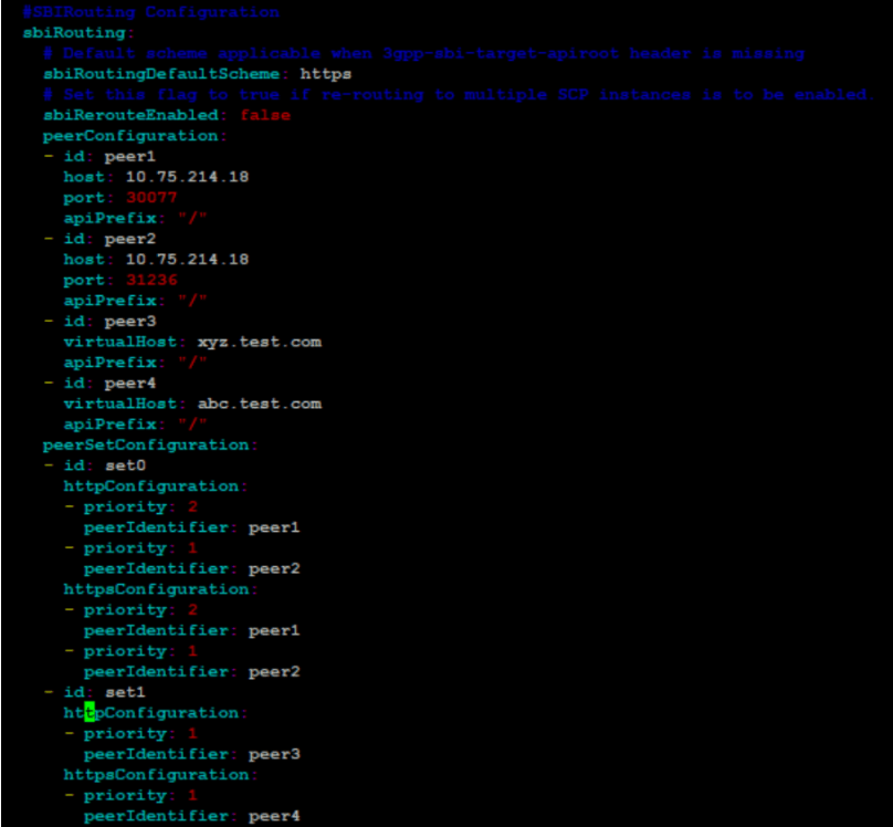

Debugging Errors When SCP Integration is Enabled
UDR Egress Gateway route configurations are performed to route all the notifications through SCP, and the NRF traffic is sent directly to the NRF host. If the routing does not work, then configure the routes as follows:
Figure 4-40 Routes Config
Routes Config
The above configuration is present as part of default values.

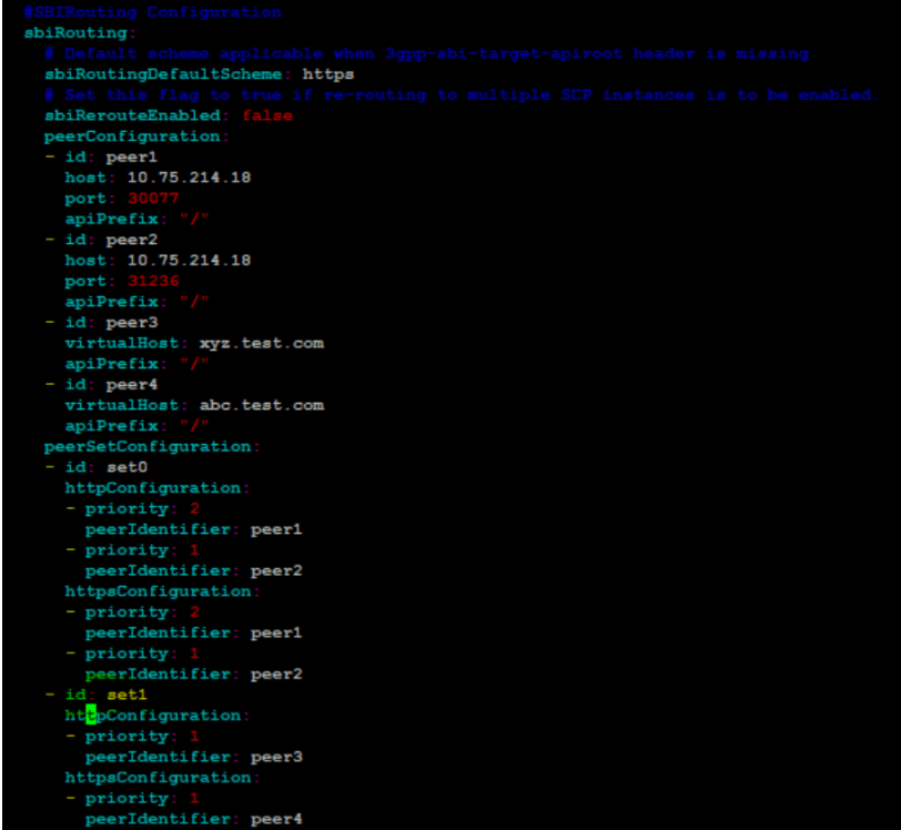

If you want to send notifications through SCP, configure Egress Gateway as shown in the following image. If setId 0 is used, configure both httpConfigs and httpsConfigs as shown in the image. For setId having static host configuration for httpsConfigs (even if its not used), it is mandatory to configure this parameter using dummy values as shown in the image. If it is not configured, then the Egress Gateway log shows NullPointerException.
Figure 4-41 Sending Notification Through SCP

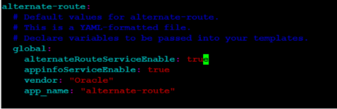

If it uses setId 1 or 2, enable Alternate Route service and configure proper host details for Egress Gateway to communicate with alternate route service. If configurations are not done as expected, then it gives 425 error, which is the default error configured for virtual FQDN lookup failure. If you see 503 or other 4xx errors, then it is because the actual endpoint or SCP is not reachable.
Figure 4-42 Using setId 1 or 2
Using setId 1 or 2
Figure 4-43 Using setId
Routes Configuration
Figure 4-44 Using setId 1 or 2 (cont..)
Figure 4-45 Using setId 1 or 2 (cont..)

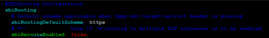

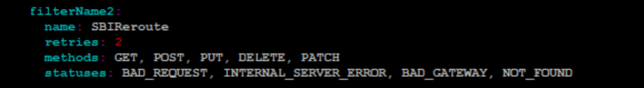

Retry to multiple SCPs in case of failure depends on the failure code and operation performed. If it is not in the configured list, then it does not attempt a retry. The number of retries depends on retries configuration as follows:
Figure 4-46 SCP Retry
SCP Retry
Also, ensure that scpRerouteEnabled is set to true.
Figure 4-47 scpRerouteEnabled set to true

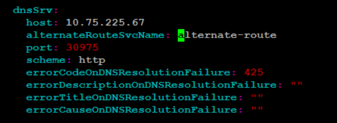

If DNS resolution from core-dns service does not happen, check whether the following configuration is enabled on alternate-route service.
Figure 4-48 DNS Srv Configuration

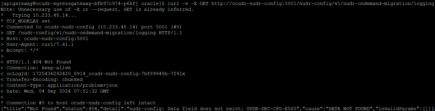

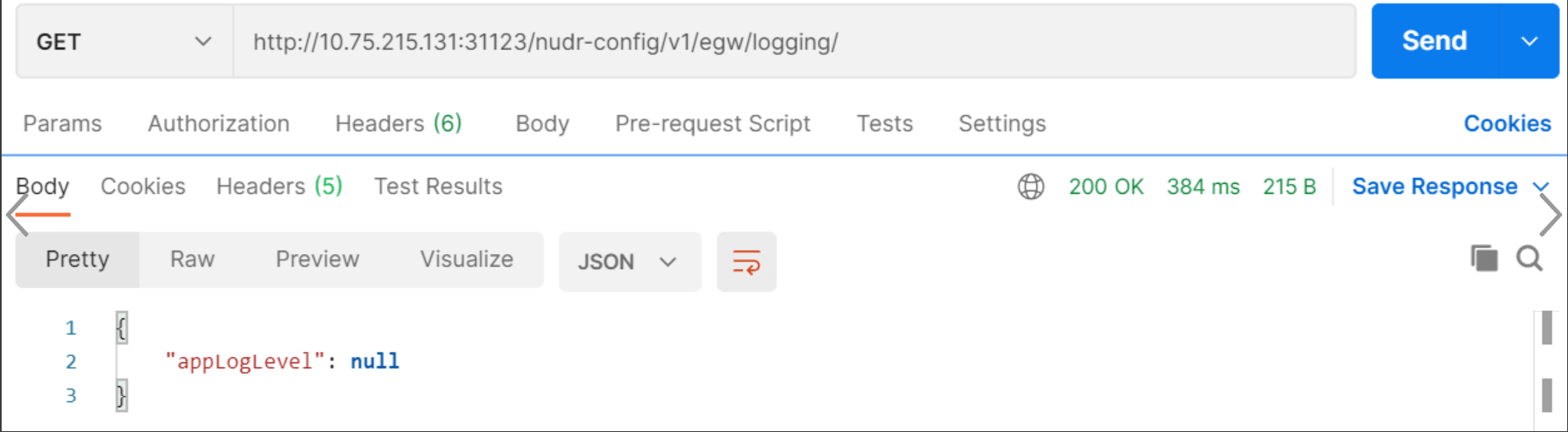

4.4.4 Debugging Errors from nudr-config
The Cloud Native Core (CNC) Console GUI uses the debugging errors received from nudr_config to update or view the configuration items. The debugging error details from nudr-config are as follows:
  • Check for 400 Error: If the following request fails with 400 status code with "404 Not Found", it indicates that the logging level information is not present in the database or the microservice is not enabled.
    Figure 4-49 Checking for 400 Error
    If common_config_hook is unable to create configuration item for the common services like ingress-gateway, egress-gateway, or alternate-route, then the GET request for the logging gives the following response:
    Figure 4-50 Response of Get Request for Logging
