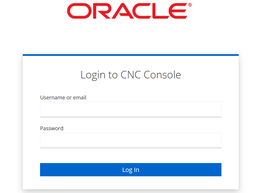

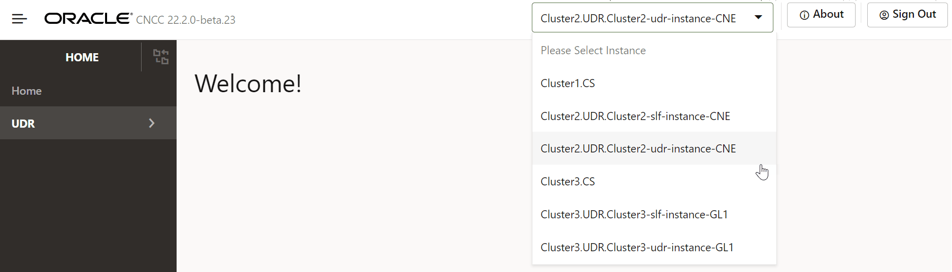

To log in to CNC Console:
  1. Type http://cncc-core-ingress-gateway.cncc.svc.cluster.local:<PortNumber>/ in the web browser and press Enter. The login page appears:
    Figure 3-1 CNC Console Login Page
  2. Enter the Username and Password and click Log In. The CNC Console Home page appears from where a user can select different instances in the drop down, for example, the EIR, SLF, or the UDR instance.
    Figure 3-2 CNC Console Home Page

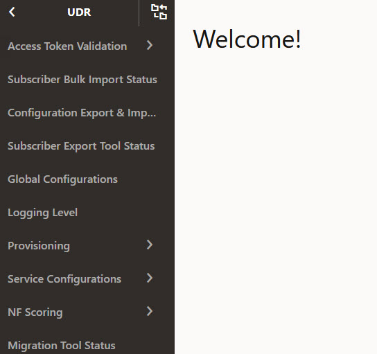

    The following NF services appear in the left navigation pane for the selected instance:
    • Access Token Validation
    • Bulk Import Status
    • Configuration Export & Import
    • Global Configurations
    • Logging Level
    • Provisioning
    • Service Configurations
    • NF Scoring
    • Migration Tool Status
  3. Select the service to be used from the left navigation pane:
    Figure 3-3 CNC Console Home Page with Services
    The NF services appear in the left navigation pane for the EIR and SLF instance.

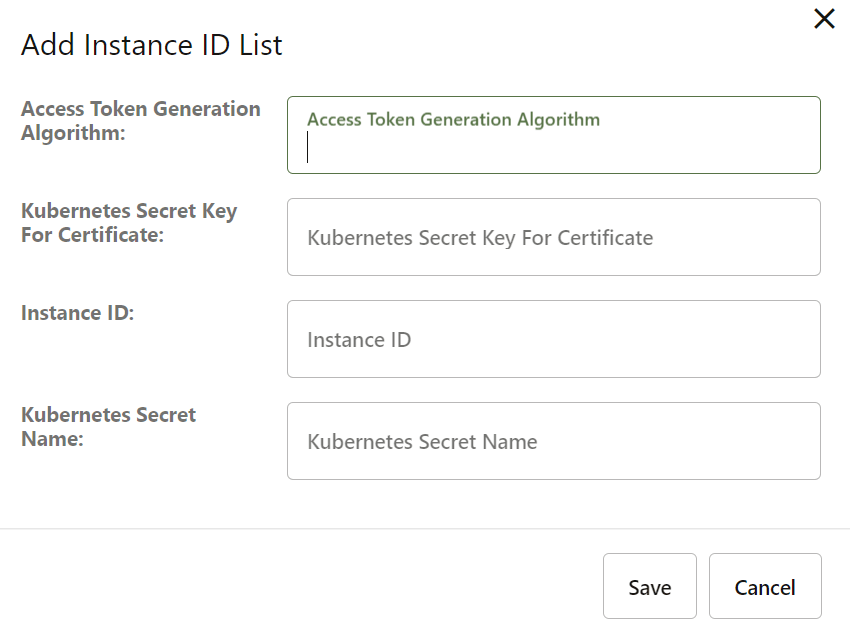

3.3.5 OAuth2 Configurations
This REST API configuration is required for enabling access token validation using NRF Instance ID and key-ID (K-ID).
Before this configuration, perform the prerequisite steps and helm configuration explained in Oauth2.0.
After Helm configuration, send the REST requests to use configured public key certificates. Using REST-based configuration, you can distinguish between the certificates configured on different NRFs and can use these certificates to validate the token received from a specific NRF.
Perform the following configurations:
  1. From the left navigation menu, navigate to UDR and click the Ingress Gatewayoption.
  2. For Ingress Gateway, from the left navigation menu, navigate to Ingress Gateway Signaling or Ingress Gateway Provisioning option to configure the Ingress Gateway Signaling or Provisioning APIs.
  3. Click the OAuth2 Configurations option.
    The OAuth2 Configurations page is displayed.
  4. Click Edit to add the OAuth2 Configurations.
    The Edit OAuth Signaling page or Edit OAuth Provisioning is displayed.
    for Ingress Gateway Signaling and Ingress Gateway Provisioning respectively.
  5. Configure the following fields in the Edit OAuth Signaling page or Edit OAuth Provisioning page:
    1. Key ID List: Click Add in the Key ID List section and configure the following fields in Add Key ID List window:
      • Key ID: Enter the Key-ID.
      • Kubernetes Secret Name: Enter Kubernetes Secret Name.
      • Kubernetes Secret Key For Certificate: Enter Kubernetes Secret Key for the certificate.
      • Access Token Generation Algorithm: Enter the Access Token Generation Algorithm.
    2. Click Save on the Add Key ID List page to save the details. Click Cancel to discard your progress, close the window, and go back to Edit OAuth Signaling or Provisioning page.
    3. Instance ID List: Click Add in the Instance ID List section and configure the following fields in Add Instance ID List window:
      • Instance ID: Enter the NRF Instance ID.
      • Kubernetes Secret Name: Enter the Kubernetes Secret Name.
  6. Click Save on the Add Instance ID List page to save the details. Click Cancel to discard your progress, close the window, and go back to Edit OAuth Signaling or Provisioning page.

  2. To add the instance ID, click Add.
    1. The Add Instance ID List dialog box appears.
      Figure 3-4 Add Instance ID List
    2. Fill in the required details and click Save to add the instance ID.
    3. Click Cancel to exit the Add Instance ID List dialog box.
    Similarly, you can add the Key ID List details.

3.6 Subscriber Bulk Import Status
The Subscriber Bulk Import Status page is a monitoring page, which is read-only. This page allows the operator to monitor the Subscriber Bulk Import status, which initiates on running the Subscriber Bulk Import tool. For more information, see bulk import tool.
To access the Subscriber Bulk Import Status page, click UDR and then, Subscriber Bulk Import Status in the left navigation pane of the CNC Console application. The following page appears:
Figure 3-5 Subscriber Bulk Import Status Page

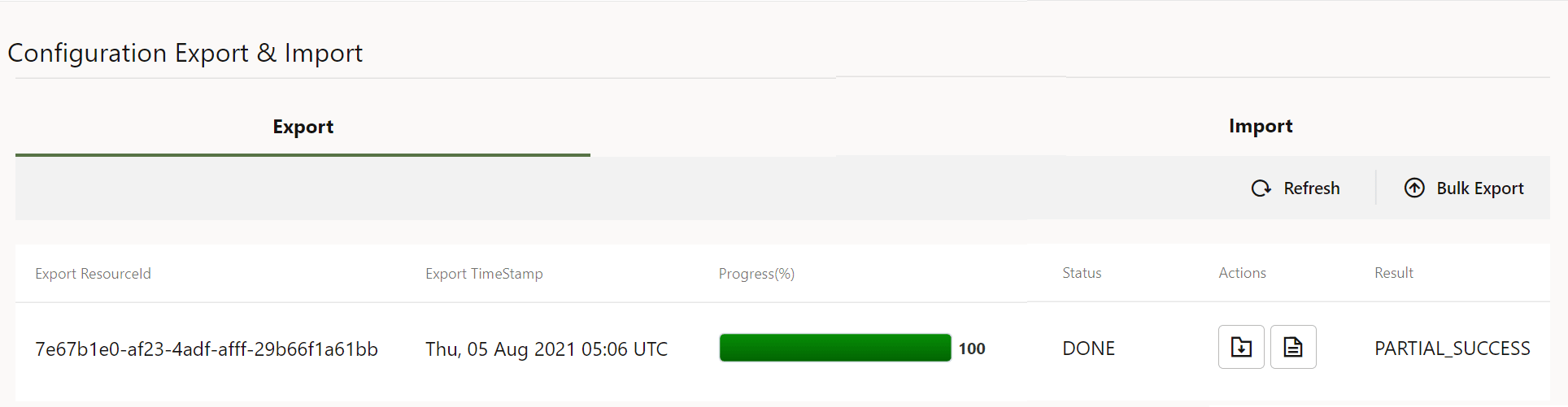

Exporting Configuration Data
To export the configuration data:

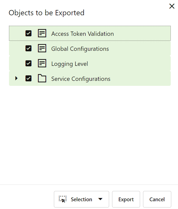

  1. Click the Bulk Export button in the Export tab. The Objects to be Exported dialog box appears.
    Figure 3-7 Objects to be Exported Dialog Box
  2. Select the objects that you want to export. Click the Selection button to either 'Select All' or 'Deselect All' the objects.
  3. Click Export to export the selected objects data. The data in the Configuration Export & Import page is updated.
  4. Click Cancel to exit the dialog box.
Downloading Exported Configuration Data
To download the exported configuration data:
  1. Click the Export Configuration Download icon available under the Actions column of the Export tab.
  2. The "Export Data downloaded Successfully" message appears and the zip file of the exported data is saved to your system. For example: exportedFiles_1.12.41_20210807133529.zip
Downloading Exported Configuration Data Report
To download the exported configuration data report:
  1. Click the Export Report Download icon available under the Actions column of the Export tab.
  2. The "Export status report downloaded successfully" message appears and the export report in the .txt file format is saved to your system. For example: exportReport_1.12.41_20210807134056.txt

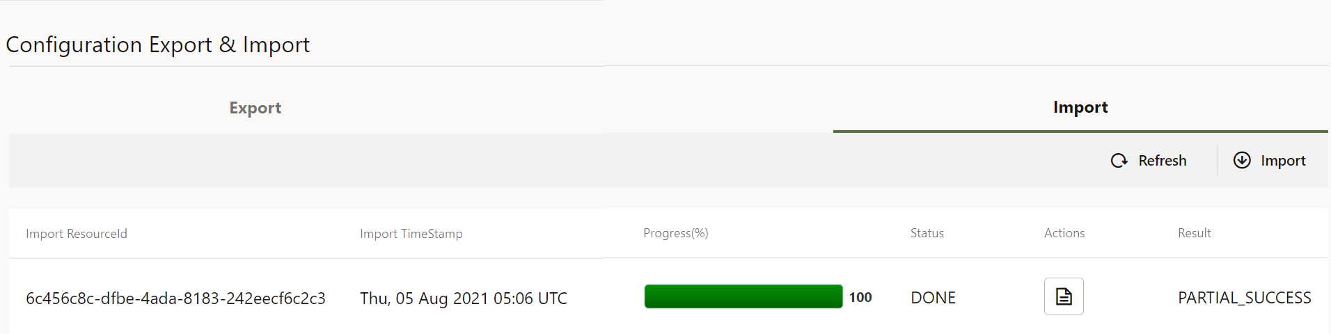

Importing Configuration Data
To import the configuration data:
  1. Navigate to the Import tab. The Configuration Export & Import page appears as follows:
    Figure 3-8 Importing Configuration Data
  2. Click the Import button. The Import Data dialog box appears.
    Figure 3-9 Import Data Dialog Box
  3. Select the file that has configuration data and click Import.
    You can only import the configuration data that you had exported earlier.
  4. The data in the Configuration Export & Import page is updated.
  5. Click Cancel to exit the dialog box.
Downloading Imported Configuration Data Report
To download the imported configuration data report:
  1. Click the Import Report Download icon available under Actions column of the Import tab.
  2. The "Import status report downloaded successfully" message appears and the import report in the .txt file format is saved to your system. For example: importReport_1.12.41_20210807134056.txt

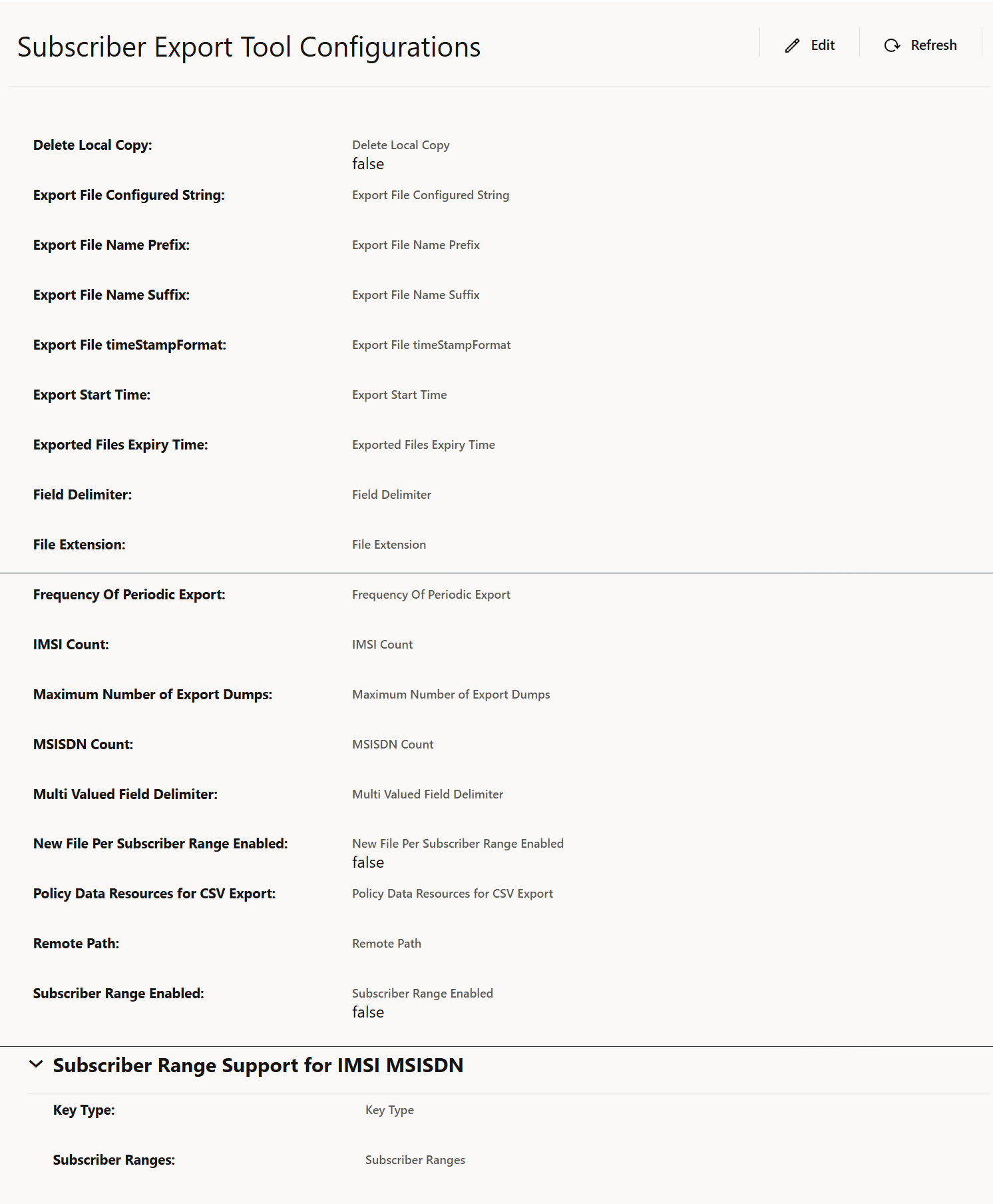

3.8 Subscriber Export Tool Status
The Subscriber Export Tool Status page is a monitoring page, which is read-only. This page allows the operator to monitor the Subscriber Export Tool Status, which initiates on running the Subscriber Export tool. For more information, see Subscriber Export Tool.
To access the Subscriber Export Tool Status page, click UDR and then, Subscriber Export Tool Status in the left navigation pane of the CNC Console application. The following page appears:
Figure 3-10 Subscriber Export Tool Status
The Subscriber Export Tool Status page shows following export tool transaction details:
  • Job Id: Generates unique ID for export.
  • Subscriber Count: Total subscriber count present in the database
  • Exported Subscriber Count: Total subscriber count exported from the database.
  • Job Progress: Shows the progress of dump in percentage.
  • Status: Shows the overall status of the export transaction. For example, RUNNING, COMPLETED, SKIPPED, or FAILED.
  • Export State: This field indicates number of completed stages. For example, export from database is successful (1/1) and transfer of data from path to remote is successful (2/2).
Using Filter option, you can filter the records you are interested in and using Refresh option, you can refresh the Subscriber Export Tool Status page.

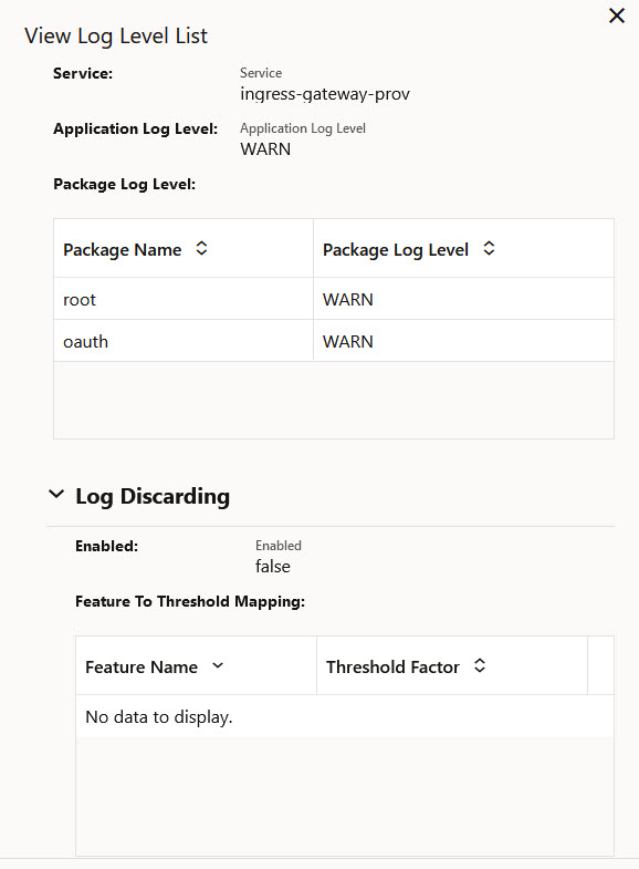

  • View: Click View corresponding to each microservice. The View Log Level List page appears.
    Figure 3-11 Sample: View Log Level List

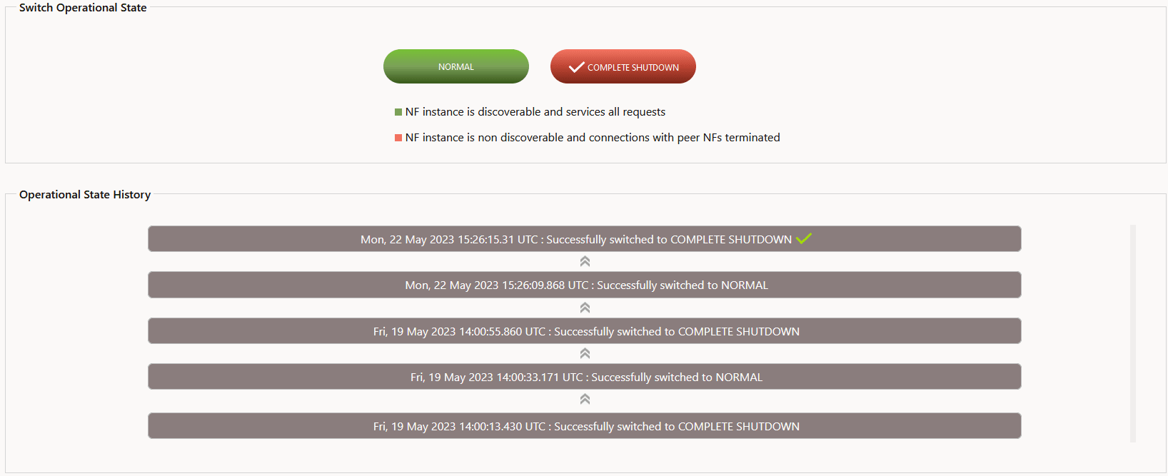

3.11 Controlled Shutdown Configurations
This section describes how to perform Controlled Shutdown configurations.
3.11.1 Operational State
Perform the following steps to change the Operational State of a site:
  • In the CNC Console application, under UDR, click Controlled Shutdown, and then select Operational State.
    This opens the page displaying the two groups, Switch Operational State and Operational State History:
    Figure 3-13 Operational State
    Operational State
    • Switch Operational State displays the following operational states:
      • NORMAL: NF instance is discoverable and services all requests.
      • COMPLETE SHUTDOWN: NF instance is non discoverable and no new session creation requests accepted.
      The current state of any site can be identified with a tick mark.
      You can switch to a different operational state by clicking the NORMAL or COMPLETE SHUTDOWN button.
    • Operational State History: It displays the history of the operational states along with the timestamp.

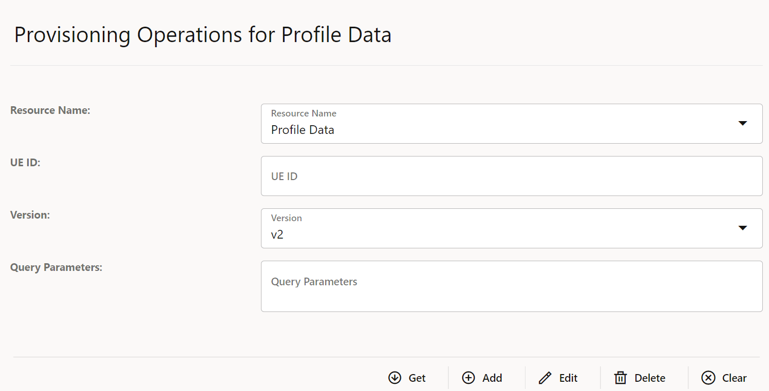

3.12.2 Provisioning - Profile Data
This section describes how to operate provisioning operations for Profile Data.
In the CNC Console application, click UDR and then Provisioning. From the Provisioning menu, select Profile Data in the left navigation pane. The Provisioning Operations for Profile Data page appears:
Figure 3-16 Provisioning Operations for Profile Data
In the Provisioning Operations for Profile Data page, user can:
  • Extract profile data from UDR database on the basis of UE ID entered
  • Add new profile data to the UDR database
  • Modify an existing profile data on the basis of UE ID
  • Delete an existing profile data that is no more needed in the UDR database

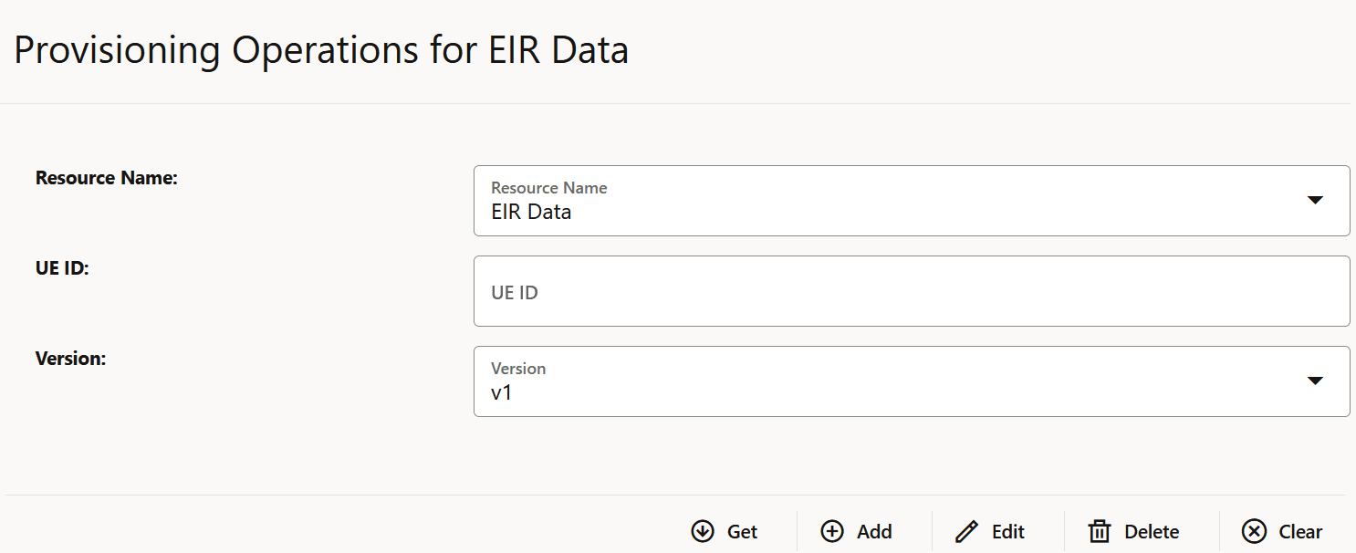

3.12.3 Provisioning - EIR Data
This section describes provisioning operations for EIR Data.
In the CNC Console application, click UDR and then Provisioning. From the Provisioning menu, select EIR Data in the left navigation pane. The Provisioning Operations for EIR Data page appears:
Figure 3-18 Provisioning GUI for EIR Data
In the Provisioning Operations for EIR Data page, users can:
  • Extract EIR data from UDR database based on the UE ID entered
  • Add new EIR data to the UDR database
  • Modify an existing EIR data on the based on a UE ID
  • Delete existing EIR data that is not needed in the UDR database

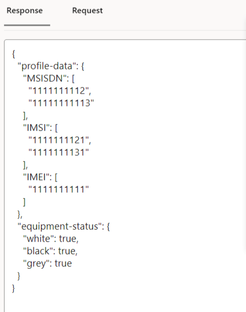

Extracting Profile Data
To extract profile data:
  1. Ensure Resource Name is set to 'EIR Data'
  2. Type an appropriate UE ID. For example: UE ID - imei-1111111111
  3. Click Get. A confirmation message, 'Fetched Successfully' appears for a second, and the result appears in the Response text area as follows:
    Figure 3-19 Sample Page: Get - EIR Data - Response
    GET-EIR Data
  4. An Error message summary appears in case of incorrect UE ID entered.

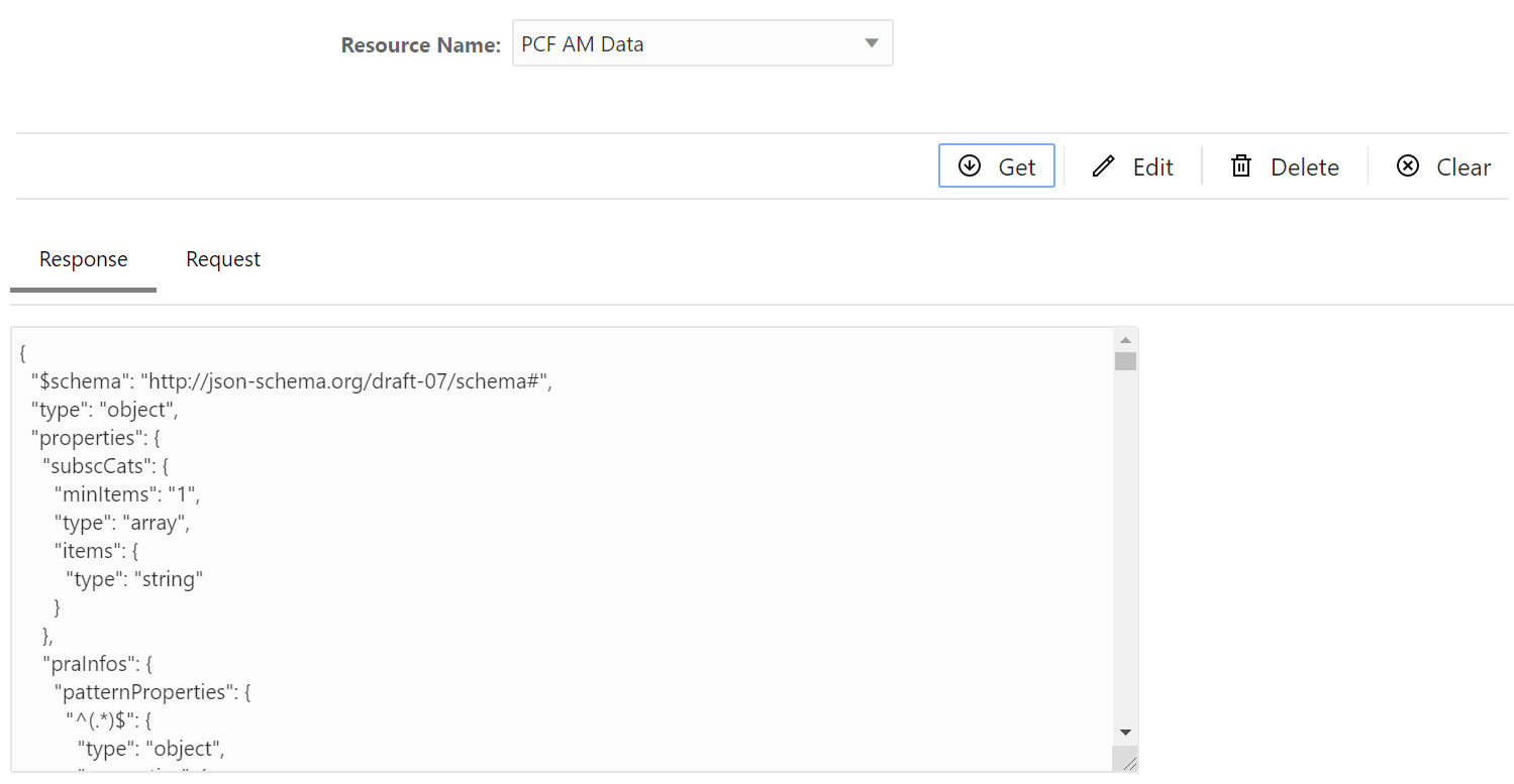

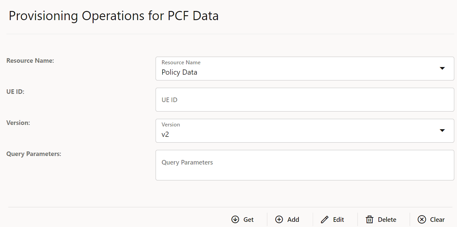

3.12.4 Provisioning - PCF Data
This section describes how to operate provisioning operations for PCF (Policy Control Function) Data.
In the CNC Console application, click UDR and then Provisioning. From the Provisioning menu, select PCF Data in the left navigation pane. The Provisioning Operations for PCF Data page appears:
Figure 3-20 Provisioning Operations for PCF Data
In the Provisioning Operations for PCF Data page, a user can:
  • Select the Resource Name from the drop-down list.
  • Extract PCF data from UDR database on the basis of UE ID entered.
  • Add PCF Data on the basis of payload.
  • Modify the existing PCF data on the basis of UE ID.
  • Delete the existing PCF data that is no more needed in the UDR database.
Extracting PCF Data
To extract the PCF data:
  1. Select the Resource Name from the drop-down list.
  2. Type an appropriate UE ID. For example: msisdn-9111111112.
  3. Click Get. A confirmation message, 'Fetched Successfully.' appears and the result appears in the Response text area as follows:
    Figure 3-21 Provisioning PCF Get Response

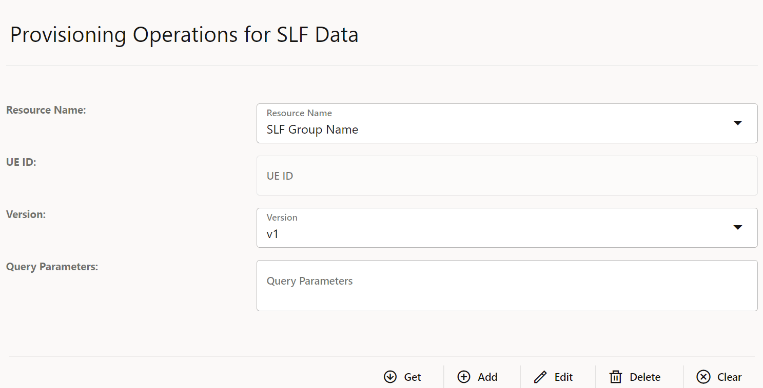

3.12.5 Provisioning - SLF Data
In this section, you will learn to operate provisioning operations for SLF (Subscriber Location Function) Data.
In the CNC Console application, click UDR and then Provisioning. From the Provisioning menu, select SLF Data in the left navigation pane. The Provisioning Operations for SLF Data page appears:
Figure 3-22 Provisioning Operations for SLF Data
SLF Group Name must be provisioned before SLF Subscriber is provisioned.
In the Provisioning Operations for SLF Data page, user can:
  • Extract SLF data from UDR database on the basis SLF Group Name (Query Parameter) or SLF Subscriber (UEID).
  • Add or edit an existing SLF data on basis of SLF Group Name (Query Parameter) or SLF Subscriber (UEID).
  • Delete an existing SLF data that is no more needed in the UDR database.

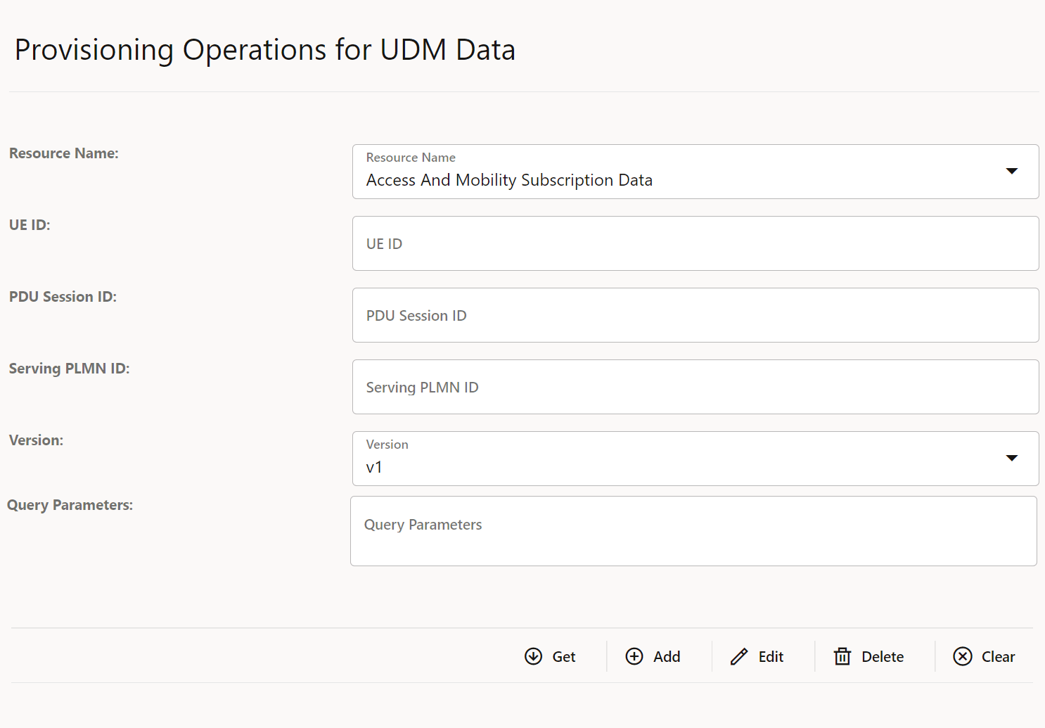

3.12.6 Provisioning - UDM Data
This section describes how to operate provisioning operations for UDM (Unified Data Management) Data.
In the CNC Console application, click UDR and then Provisioning. From the Provisioning menu, select UDM Data in the left navigation pane. The Provisioning Operations for UDM Data page appears:
Figure 3-25 Provisioning Operations for UDM Data
In the Provisioning Operations for UDM Data page, user can extract, modify and delete UDM data on the basis of Resource Name, UE ID, PDU Session ID, Serving PLMN ID, Version, and Query Parameters entered.
Extracting UDM Data
To extract the UDM data:
  2. Type an appropriate UE ID, PDU Session ID and Serving PLMN ID in their respective fields.
  3. Select an appropriate Version and enter Query Parameters.
  4. Click Get. A confirmation message, 'Fetched Successfully.' appears and the result appears in the Response text area.
  5. An Error message summary appears in case of incorrect UE ID entered.
Adding a UDM Data
To add a UDM data:
  1. Select the Resource Name.
  4. Click Edit. The Request text area appears.
  5. Enter details and click Submit. The 'Saved Successfully.' message appears.
    If a user enters any incorrect input, an Error message summary appears.
Editing a UDM Data
To edit a UDM data:
  2. Type an appropriate UE ID, PDU Session ID, and Serving PLMN ID in their respective fields.
  4. Click Edit. The Request text area displays an existing UDM data.
  5. Edit as required and click Submit. The 'Saved Successfully.' message appears.
Deleting a UDM Data
To delete a UDM Data:
  1. Enter the Resource Name.
  4. Click Delete.
  5. The 'Deleted Successfully.' message appears.
Clearing a UDM Data
Click the Clear option to clear the text fields and text areas of the Provisioning Operations for UDM Data page.

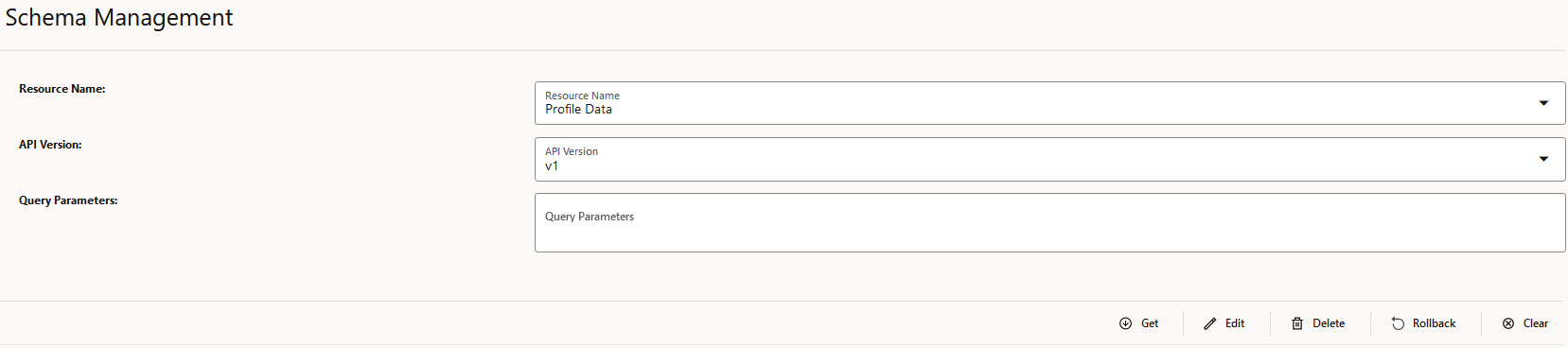

3.12.7 Provisioning - Schema Management Data
This section describes how to operate provisioning operations for schema.
In the CNC Console application, click UDR and then Provisioning. From the Provisioning menu, select Schema Management Data in the left navigation pane. The Schema Management page appears:
Figure 3-26 Schema Management
Schema Management
In the Schema Management page, user can extract, modify, and delete a schema on the basis of Resource Name and Query Parameters.
Extracting a Schema
To extract a schema:
  2. Enter the Query Parameters.
    Figure 3-27 Schema - Get - PCF AM Data
    Schema Management - Get Response
Adding or Editing a Schema
To add or edit a schema:
  3. Click Edit. The Request text area displays the selected schema.
  4. Edit as required and click Submit. The 'Saved Successfully.' message appears.
    If a user edits the schema inappropriately, an Error message summary appears.
Deleting a Schema
To delete a schema:
  3. Click Delete.
  4. The 'Deleted Successfully.' message appears.
    If a user selects a schema that does not exists, an Error message summary appears.
Clearing a Schema Management Data
Click the Clear option to clear the text fields and text areas of the Schema Management page.

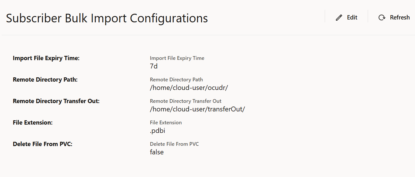

3.13.1 Subscriber Bulk Import Configurations
Click UDR and then Service Configurations. From the Service Configurations menu, select Subscriber Bulk Import Configurations. The Subscriber Bulk Import Configurations page appears:
Figure 3-28 Subscriber Bulk Import Configurations
The following table explains the parameters in the Subscriber Bulk Import Configurations page in detail:
Table 3-42 Subscriber Bulk Import Configurations Parameters
Field Name Default Value Attribute Description
Import File Expiry Time 7d Editable Expiry time for all the PDBI files including the result log files.
Remote Directory Path /home/cloud-user/ocudr/ Editable Remote host path
Remote Directory Transfer Out /home/cloud-user/transferOut/ Editable The log files are transferred to this remote host server path when the bulk-import processing is completed.
File Extension .pdbi Editable Shows the file type
Delete File From PVC false Editable Flag to enable or disable the delete file from PVC feature
Editing Subscriber Bulk Import Configurations
To update or modify configuration information related to data repository:
  1. Click Edit. The Edit Subscriber Bulk Import Configurations page appears.
  2. Update the configuration details as required and click Save. A confirmation message, "Save successfully." appears.
  3. If you do not want to modify any configuration, click Cancel. You can navigate back to the Bulk Import Configurations page.
  4. Click Refresh to reload the Subscriber Bulk Import Configurations page.

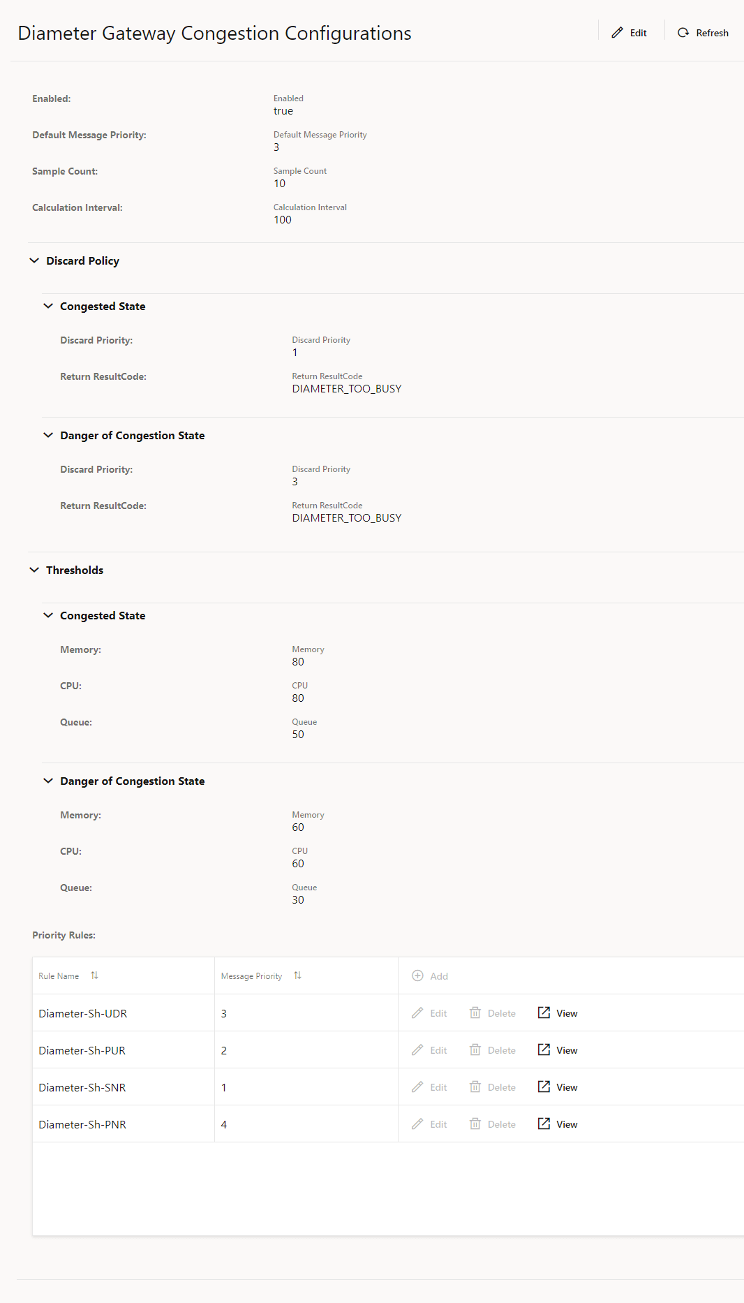

3.13.4 Diameter Gateway Congestion
Click UDR and then Service Configurations. From the Service Configurations menu, select Diameter Gateway Congestion. The Diameter Gateway Congestion Configurations page appears:
Figure 3-29 Diameter Gateway Congestion
Diameter Gateway Congestion configurations
The following table explains the parameters in the Diameter Gateway Congestion Configurations page in detail:
Table 3-45 Diameter Gateway Congestion Configurable Parameters
enabled true Editable Flag to enable or disable the Diameter Gateway Pod Congestion feature
defaultMessagePriority 2 Editable Default diameter message priority which is not specifically assigned any priority
sampleCount 10 Editable Sample request count for deciding pod state
calculationInterval 100 Editable Congestion state calculation every configured time (in ms)
loadSheddingRulesMap NA
            "CONGESTED": {
               "state": "CONGESTED",
               "discardPriority": 3,
               "ansWithResultCode": "DIAMETER_TOO_BUSY"
            "DOC": {
               "state": "DOC",
               "discardPriority": 6,
Editable
Indicates the decision for the pod in a particular state
loadSheddingRulesMap.<CONGESTED/DOC> NA Editable Indicates the pod congestion state.
loadSheddingRulesMap.<CONGESTED/DOC>.state NA Editable Indicates the name of the state.
loadSheddingRulesMap.<CONGESTED/DOC>.discardPriority NA Editable Indicates the diameter message discard priority.
loadSheddingRulesMap.<CONGESTED/DOC>.ansWithResultCode NA Editable Indicates the diameter return string result code when the message get discarded.
priorityRules NA
            "ruleName": "SH-UDR",
            "messagePriority": 5,
            "conditions": {
               "requestType": "UDR",
               "application": "Sh"
Editable NA
Priority Rules.Rule Name NA Editable Specifies the unique name of the message priority rule.
Priority Rules.Message Priority NA Editable Specifies the priority assigned to the message. It can be a number from 0 to 15.
PriorityRules.Conditions.Request Type NA enum Specifies the type of message for the selected application. The supported request values for the application type are as follow:
  • CER
  • SNR
  • UDR
  • PUR
  • PNR
  • UDR_MIGRATION
Priority Rules.Conditions.Application NA enum
Specifies the type of application. Users can select any of the following values from the drop-down list:
  • Sh
Thresholds NA
            "CONGESTED": {
               "memory": 80,
               "cpu": 80,
               "queue": 50
            "DOC": {
               "memory": 60,
               "cpu": 60,
               "queue": 30
Editable NA
Thresholds.Congested State.Memory NA Editable Memory percentage of pod state
Thresholds.Congested State.CPU NA Editable CPU percentage of pod state
Thresholds.Congested State.Queue NA Editable Queue percentage of pod state
Thresholds.Danger of Congested State.Memory NA Editable Memory percentage of pod state
Thresholds.Danger of Congested State.CPU NA Editable CPU percentage of pod state
Thresholds.Danger of Congested State.Queue NA Editable Queue percentage of pod state
Discard Policy.Congested State.Discard Priority NA Editable Specifies the discard priority for the load shedding rule. The discard priority value can be a number from 0 to 15. Any request message with equal or lower priority is rejected.
Discard Policy.Congested State.Return ResultCode NA enum Specifies the result code, returned in the answer response, when request message is rejected as part of congestion control. Users can select any of the following values from the drop-down list: DIAMETER_UNABLE_TO_COMPLY, DIAMETER_TOO_BUSY
Discard Policy.Danger of Congested State.Discard Priority NA Editable Specifies the discard priority for the load shedding rule. The discard priority value can be a number from 0 to 15. Any request message with equal or lower priority is rejected.
Discard Policy.Danger of Congested State.Return ResultCode NA enum Specifies the result code, returned in the answer response, when request message is rejected as part of congestion control. Users can select any of the following values from the drop-down list: DIAMETER_UNABLE_TO_COMPLY, DIAMETER_TOO_BUSY
Editing Diameter Gateway Congestion Configurations
To update or modify any configuration information related to diameter gateway congestion:
  1. Click Edit. The Edit Diameter Gateway Congestion Configurations page appears:
  3. If you do not want to modify any configuration, click Cancel. The Diameter Gateway Congestion Configurations page appears.
  4. Click Refresh to reload the Diameter Gateway Congestion Configurations page.

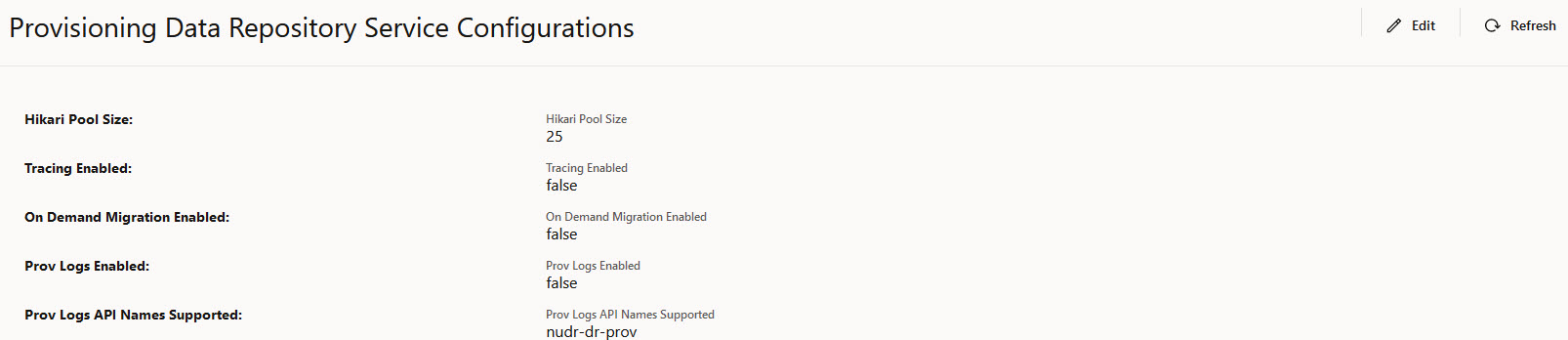

3.13.5 Provisioning Data Repository Service
Click UDR and then Service Configurations. From the Service Configurations menu, select Provisioning Data Repository Service. The Provisioning Data Repository Service Configurations page appears:
Figure 3-30 Provisioning Data Repository Service Configurations
The following table explains the Provisioning Data Repository Service Configurations page in detail:
Table 3-46 Provisioning Data Repository Service Configurations Parameters
Hikari Pool Size 25 Read-only The Hikari pool connection size to be created at start up.
Tracing Enabled False Read-only By default, tracing is not enabled.
On Demand Migration Enabled False Editable By default, on demand migration is not enabled.
Prov Logs Enabled False Editable Flag to enable or disable the provisioning logs.
Prov Logs API Names Supported nudr-dr-prov Editable Supported API for provisioning logs. The supported provisioning APIs are as follows:
  • nudr-dr-prov

Editing Provisioning Data Repository Service Configurations
To update or modify any configuration information related to Provisioning Data Repository Service:
  1. Click Edit. The Edit Provisioning Data Repository Service Configurations page appears.
  3. If you do not want to modify any configuration, click Cancel. The Provisioning Data Repository Service Configurations page appears.
  4. Click Refresh to reload the Provisioning Data Repository Service Configurations page.

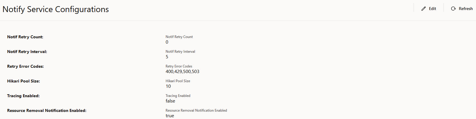

3.13.6 Notify Service
Click UDR and then Service Configurations. From the Service Configurations menu, select Notify Service. The Notify Service Configurations page appears:
Figure 3-31 Notify Service Configurations
The following table explains the Notify Service Configurations page in detail:
Table 3-47 Notify Service Configurations Parameters
Notify Retry Count 3 Editable Number of notification attempts to be done in case of notification failures.
Retries are based on notification.retryerrorcodes configuration.
Notif Retry Interval 5 Editable The retry interval for notifications in case of failure. It is measured in seconds.
Retry Error Codes 400,429,500,503 Editable This field displays comma separated error codes. These error codes are eligible for retry notifications in case of failures.
Tracing Enabled false Read-only This enables tracing on jaeger. By default, tracing is not enabled.
Resource Removal Notification Enabled true Editable It is the PCF notifications for delete subscriber and deletion of policy data. When enabled, the "delResources" attribute/key is included in the notification payload.
Editing Notify Service Configurations
To update or modify any configuration information related to notify service:
  1. Click Edit. The Edit Notify Service Configurations page appears.
  3. If you do not want to modify any configuration, click Cancel. The Notify Service Configurations page appears.
  4. Click Refresh to reload the Notify Service Configurations page.
3.13.7 Subscriber Export Tool Configurations
Click UDR and then Service Configurations. From the Service Configurations menu, select Subscriber Export Tool Configurations. The Subscriber Export Tool Configurations page appears:
Figure 3-32 Subscriber Export Tool Configurations
The following table explains the parameters in the Subscriber Export Tool Configurations page in detail:
Table 3-48 Subscriber Export Tool Configurations Parameters
Frequency Of Periodic Export DAILY Editable It is the frequency of periodic export of subscriber data. This is configurable as ONE_TIME/DAILY/WEEKLY/MONTHLY
Export Start Time 14/09/2022 17:32:10 Editable Time at which periodic export starts. 24 hours format is used.
Maximum Number of Export Dumps 5 Editable Maximum number of export.
Export File Name Suffix SLFTestSegment Editable The suffix name of the exported file.
Export File Name Prefix empty string Editable The prefix name of the exported file.
Export File Configured String snapshot Editable It sets a configured string for export files.
Export File timeStampFormat YYYYMMDDHHMMSS Editable It sets the timestamp format for the export file name, header, and footer.
Multi Valued Field Delimiter | Editable This separator is used to differentiate multiple values for a single key type.
Field Delimiter , Editable Delimiter for fields
File Extension .csv Editable Extension for file. This can be .csv/.txt
IMSI Count 5 Editable Number of IMSI for EIR export.
If 5 IMSIs are not provisioned for a given IMEI, then 0 value is supplied for remaining IMSI .
MSISDN Count 5 Editable Number of MSISDN for EIR export.
If 5 MSISDNs are not provisioned for a given IMEI, then 0 value is supplied for remaining MSISDN.
Remote Path /home/cloud-user/ Editable Path in remote server where the exported files is stored.
Delete Local Copy true Editable Flag to enable or disable deletion of files from SFTP.
Subscriber Range Enabled false Editable Flag to enable or disable the range based subscriber export. Default is set to false for full range of 4G policy subscriber data export.
New File Per Subscriber Range Enabled False Editable When enabled creates a separate EXML file for each range. Default is set to false.
Exported Files Expiry Time 7d Editable The exported file expiry time, after which the file is deleted.
Key Type IMSI Editable To export the range based subscriber data with keys. The two key type are IMSI and MSISDN.
Subscriber Ranges NA Editable Configures the start and end ranges that is given to export the data. This works only if subscriberRangeEnabled parameter is enabled.
Policy Data Resource for CSV Export It is the type of data that needs to be exported for the policy data. By default, profile data is included. Editable sm-data,am-data,ue-policy-set
Editing Subscriber Export Tool Configurations
  1. Click Edit. The Edit Subscriber Export Tool Configurations page appears.
  2. Update the configuration details as required and click Save. A confirmation message, "Save successfully" appears.
  3. If you do not want to modify any configuration, click Cancel. You can navigate back to the Subscriber Export Tool Configurations page.
  4. Click Refresh to reload the Subscriber Export Tool Configurations page.

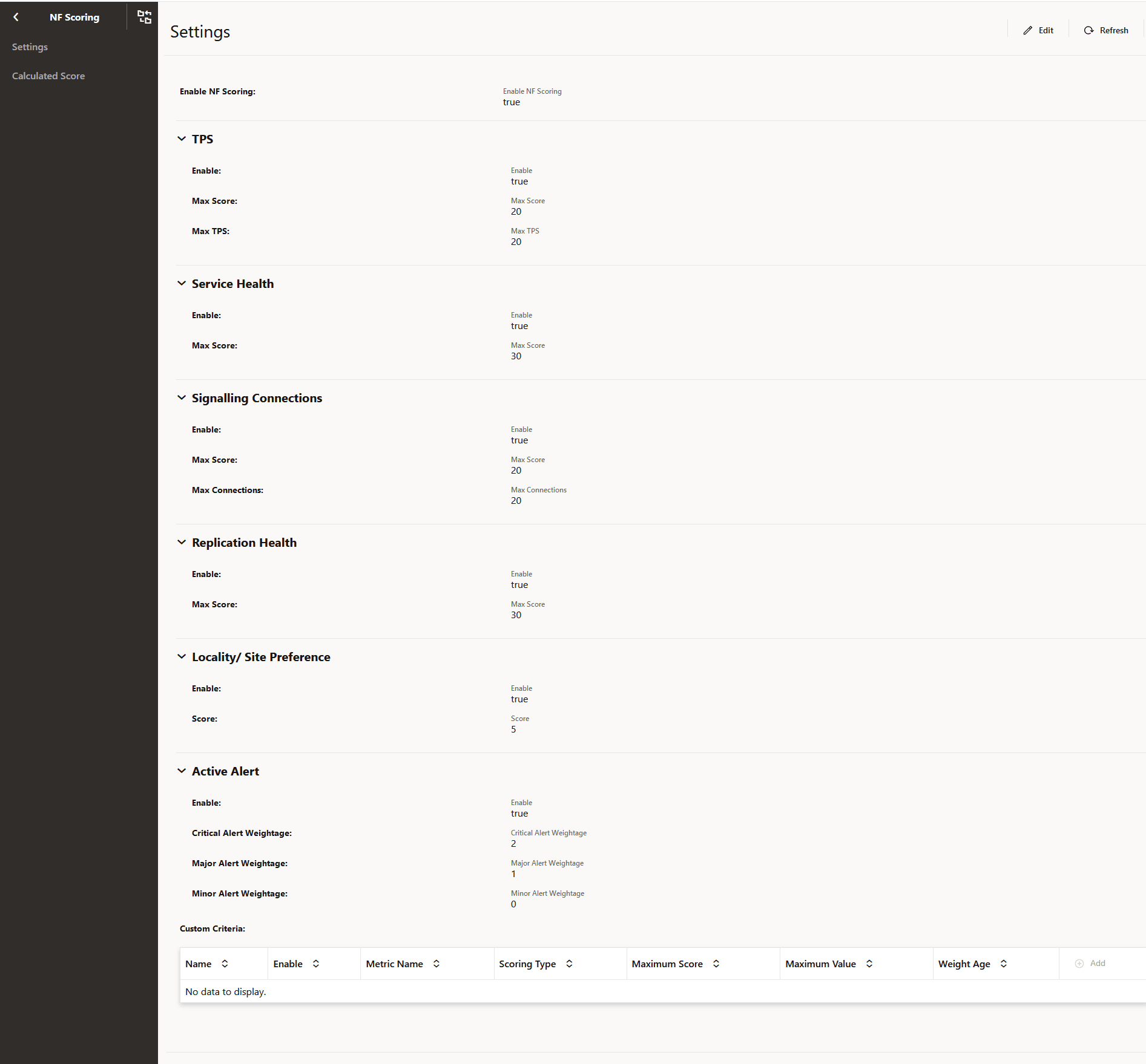

3.14 NF Scoring Configurations
You can configure the NF Scoring feature using the CNC Console. To navigate to NF Scoring, click UDR and then NF Scoring in the left navigation pane of the CNC Console application. Using NF Scoring, SLF users can configure following services:
  • Settings
  • Calculated Score
Settings:
From the NF Scoring menu, select Settings. The Settings page appears:
Settings
The following table explains the parameters in the Settings page in detail:
Table 3-49 NF Scoring Settings for SLF
Field Name Description
Enable NF Scoring Specifies whether to enable or disable the NF Scoring. This is a mandatory parameter.
Data Type: Boolean
Default Value: false
Range: true or false
TPS Specifies the Transaction Per Second.
Enable Enables the TPS.
Data Type: Boolean
Max Score Specifies the maximum score of the TPS. If enable is set to true then this is a mandatory parameter.
Data Type: Integer
Default Value: 20
Range: 1 to 100.
Max TPS Specifies the maximum TPS. If enable is set to true then this is a mandatory parameter.
Data Type: Integer
Range: 1 to 1000000
Service Health Specifies the Service Health of a site.
Enable Enables the Service Health. This is a mandatory parameter.
Data Type: Boolean
Max Score Specifies the maximum score of the Service Health. If enable is set to true then this is a mandatory parameter.
Data Type: Integer
Default Value: 30
Range: 1 to 100
Signaling Connections Specifies the Signaling Connections of a site.
Enable Enables the Signaling Connections. This is a mandatory parameter.
Data Type: Boolean
Max Score Specifies the maximum score of the Signaling Connections. If enable is set to true then this is a mandatory parameter.
Data Type: Integer
Default Value: 20
Range: 1 to 100
Max Connections Specifies the maximum connections. If enable is set to true then this is a mandatory parameter.
Data Type: Integer
Range: 1 to 10000
Replication Health Specifies the Replication Health of a site.
Enable Enables the Replication Health.
Data Type: Boolean
Max Score Specifies the maximum score of the Replication Health. If enable is set to true then this is a mandatory parameter.
Data Type: Integer
Default Value: 30
Range: 1 to 100
Locality or Site preference Specifies the Locality or Site Preference.
Enable Enables the Locality or Site Preference.
Data Type: Boolean
Score Specifies the score of the Locality or Site Preference. If enable is set to true then this is a mandatory parameter.
Data Type: Integer
Default Value: 5
Range: 1 to 100
Active Alert Specifies the Active Alerts of a site.
Enable Enables the Active Alert.
Data Type: Boolean
Critical Alert Weightage The site with more critical alerts is unhealthy. If enable is set to true then this is a mandatory parameter.
Data Type: Integer
Default Value: 2
Range: 0 to 100
Major Alert Weightage The site with more major alerts is unhealthy. If enable is set to true then this is a mandatory parameter.
Data Type: Integer
Default Value: 1
Range: 0 to 100
Minor Alert Weightage The site with more minor alerts is unhealthy. If enable is set to true then this is a mandatory parameter.
Data Type: Integer
Default Value: 0
Range: 0 to 100
Custom Criteria Specifies the Custom Criteria of a site.
Enable Specifies whether to enable or disable the Custom Criteria.
Data Type: Boolean
Name Name of the Custom Criteria. The two applicable criteria are Subscriber Bulk Import tool and Subscriber Export tool.
Data Type: String
Metric Name Specifies the name of the Metric.
Data Type: String
Scoring Type Specifies the scoring type. The two scoring types are ratio and weightage.
Data Type: String
Max Score Specifies the maximum score.
Data Type: Integer
Default Value: 30
Range: 1 to 100
Max Value Specifies the maximum value.
Data Type: Integer
Range: 0 to 10000
Weightage Specifies the weightage of the alert.
Data Type: Integer
Default Value: 1
Range: 1 to 100

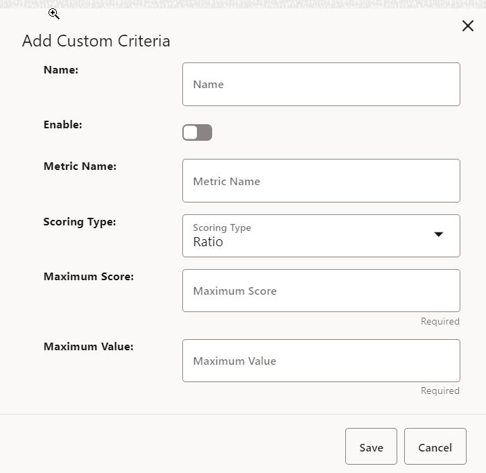

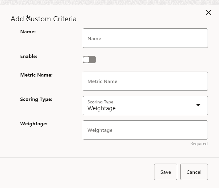

To update or modify the configuration information related to Settings:
  1. Click Edit. The Edit Settings page appears.
  2. To add the Custom Criteria, click Add.
    1. The Add Custom Criteria dialog box appears.
      Add Custom Criteria
      Add Custom Criteria
    2. Note:
      If the scoring type is selected as weightage then maximum score and minimum score fields are disabled.
      Fill in the required details and click Save to add the custom criteria.
    3. Click Cancel to exit the Add Custom Criteria dialog box.
  3. Update the configuration details as required in the settings page and click Save. A confirmation message, "Save successfully." appears.
  4. If you do not want to modify any configuration, click Cancel.
  5. Click Refresh to reload the Settings page.

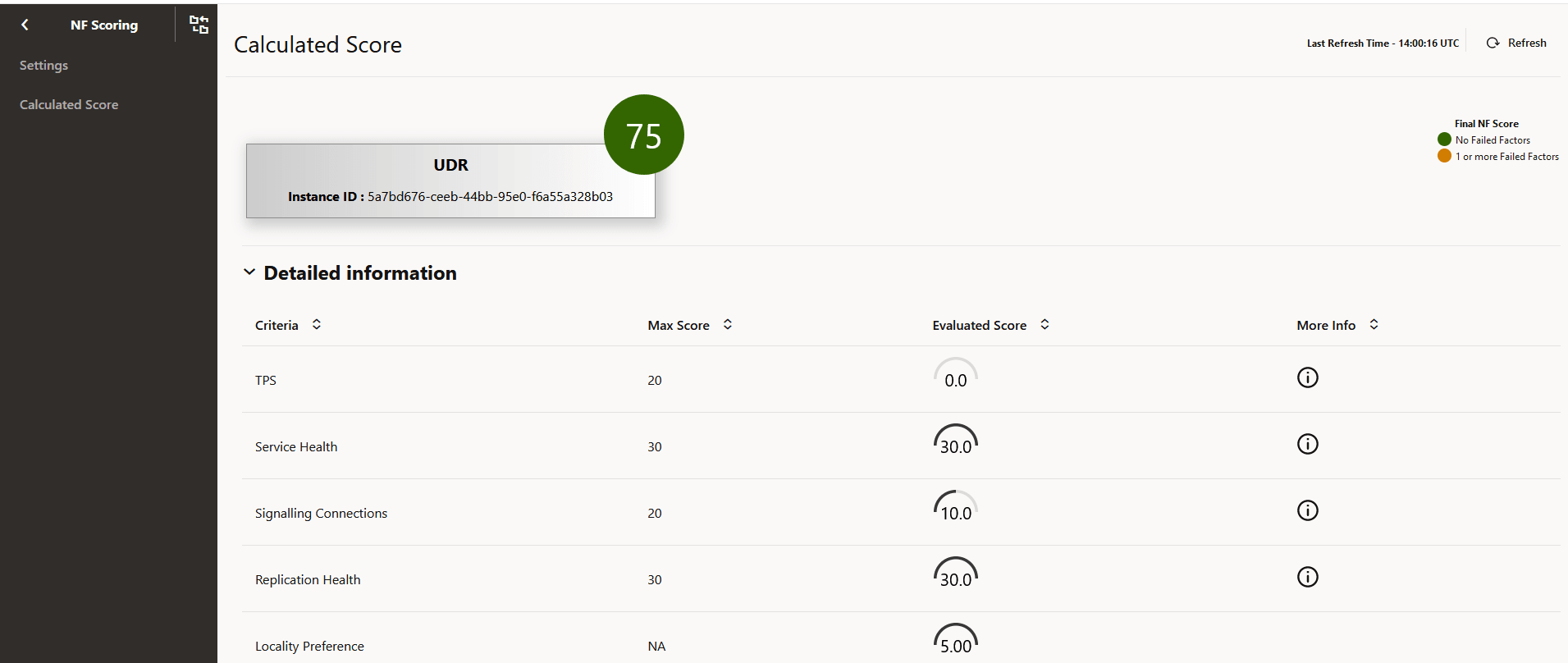

Calculated Score:
From the NF Scoring menu, select Calculated Score. If the NF Scoring feature is enabled. The Calculated Score page appears as below:
Figure 3-33 Calculated Score
Calculated Score
If app-info pod is down, you will not be getting the NF Score. You will get an error message that "Data can't be fetched due to internal server error".
Calculated Score shows the total score along with the Instance ID. The total score is shown in either Green or Orange color. If the NF Score is shown in green color then there are no failed factors. And, if the NF Score is shown in Orange color there are one or more failed factors.
You can click on Detailed information to view different criteria and their Max Score, Evaluated Score, and More Info. The criteria in the detailed information tab show the evaluated score. The failed factors are shown with a warning symbol under the evaluated score. On the top-right of the screen, the Last Refresh Time information is available and a Refresh button is given to refresh the NF Score of a site.
