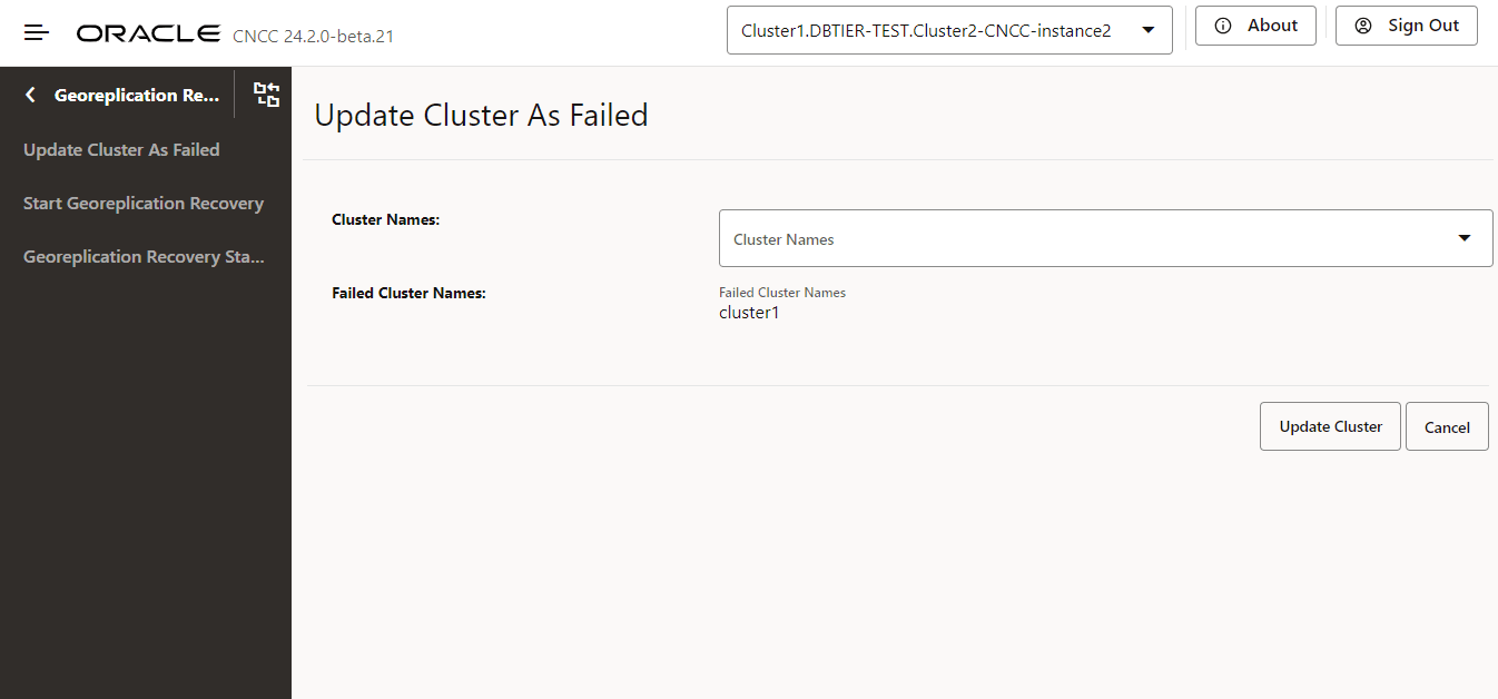

  2. Perform the following steps to update the cluster status as FAILED:
    1. Log in to CNC Console GUI of the active cluster.
    2. Expand cnDBTier under the NF menu and select Georeplication Recovery.
    3. Select Update Cluster As Failed.
    4. From the Cluster Names drop-down, select the cluster that you want to mark as failed and click Update Cluster.
      The drop-down displays the clusters that are part of the replication setup (cluster1 and cluster2). When you select a cluster and click Update Cluster, the selected cluster name is updated in the Failed Cluster Names field.
      For example, if you selected cluster1 to be marked as failed, then on clicking Update Cluster, cluster1 is updated in the Failed Cluster Names field.
      The following image shows a sample Update Cluster As Failed page where cluster1 is marked as a failed cluster:
      Figure 7-1 Update Cluster As Failed

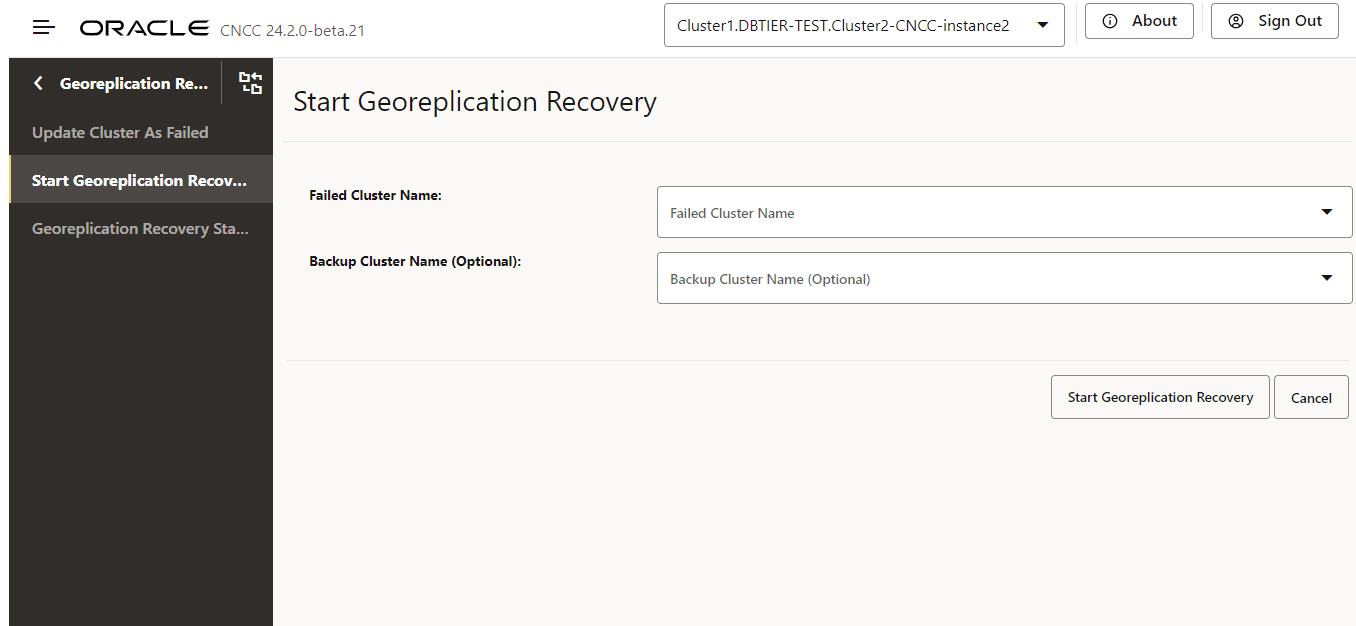

      2. Select Start Georeplication Recovery. The following image shows a sample Start Georeplication Recovery page:
        Figure 7-2 Start Georeplication Recovery
      3. From the Failed Cluster Name drop-down, select the failed cluster that you want to restore.
      4. [Optional]: From the Backup Cluster Name (Optional) drop-down, select one of the healthy clusters from which the system can use the backup to restore the failed cluster. If this option is not selected, the system uses the backup from the first available healthy cluster.
        For example, if cluster1 failed and needs to be restored, then the system displays the other healthy cluster (cluster2) to pick the backup. If no option is selected, the system uses the available healthy cluster by default.
      5. Click Start Georeplication Recovery.

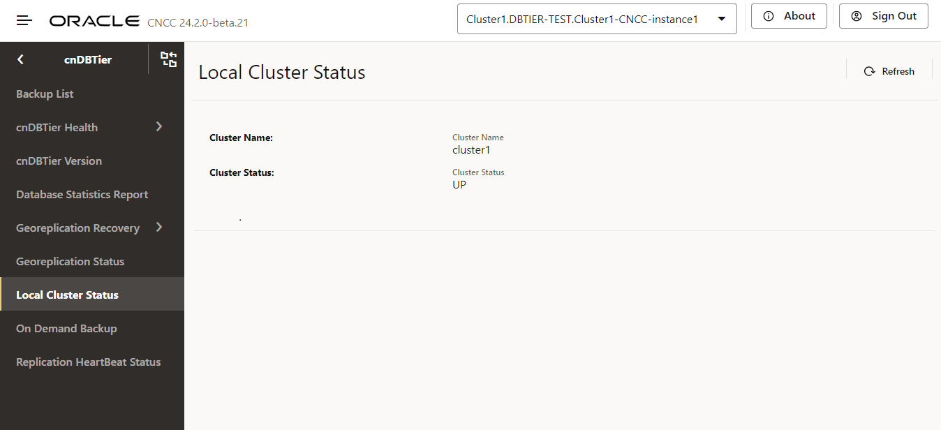

  1. Check the status of all the three cnDBTier clusters. Follow Verifying cnDBTier Cluster Status Using CNC Console to check the status of cnDBTier cluster1, cnDBTier cluster2, and cnDBTier cluster3.
      The drop-down displays the clusters that are part of the replication setup (cluster1, cluster2, and cluster3). When you select a cluster and click Update Cluster, the selected cluster name is updated in the Failed Cluster Names field.
      Figure 7-3 Update Cluster As Failed

      1. On CNC Console, expand cnDBTier under the NF menu and select Georeplication Recovery.
        Figure 7-4 Start Georeplication Recovery
        For example, if you want to restore cluster1, then select cluster1.
        For example, if cluster1 failed and needs to be restored, then the system displays the other two healthy clusters (cluster2 and cluster3) to pick the backup. Select one cluster from the available healthy clusters to use the backup. Otherwise, the system uses the backup from the first available healthy cluster by default.

    1. Perform the Verifying cnDBTier Cluster Status Using CNC Console procedure to check the cluster status.

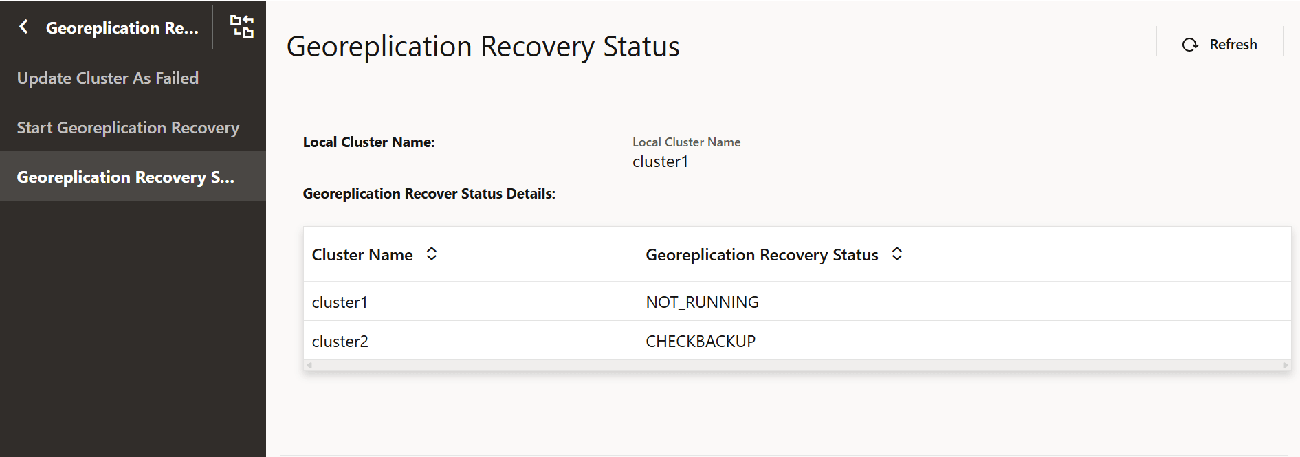

    2. When the cnDBTier cluster is UP, continue monitoring the georeplication recovery status by performing the Monitoring Georeplication Recovery Status Using CNC Console procedure.
      The Cluster Names drop-down displays all the clusters that are part of the replication setup (cluster1, cluster2, and cluster3). When you select a cluster and click Update Cluster, the selected cluster name gets updated in the Failed Cluster Names field.
      For example, if you want to mark cluster1 and cluster2 as failed, then perform the following steps:
      1. Select cluster1 from the Cluster Names drop-down and click Update Cluster. The system displays cluster1 in the Failed Cluster Names field.
      2. Select cluster2 from the Cluster Names drop-down and click Update Cluster. The system displays both cluster1 and cluster2 in the Failed Cluster Names field.
      You can use the similar steps to update the status in the other combinations of clusters as well. The following image shows a sample Update Cluster As Failed page where cluster1 and cluster2 are marked as failed clusters:
      Figure 7-5 Update Cluster1 and Cluster2 As Failed
          Figure 7-6 Start Georeplication Recovery
          For example, if cluster1 is the first failed cluster that needs to be restored, then select cluster1.

    Follow Monitoring Georeplication Recovery Status Using CNC Console procedure to monitor the georeplication recovery status.
          Figure 7-9 Start Georeplication Recovery
          For example, if cluster1 is the failed cluster that needs to be restored, then select cluster1.
      The Cluster Names drop-down displays all the clusters that are part of the replication setup (cluster1, cluster2, cluster3, and cluster4). When you select a cluster and click Update Cluster, the selected cluster name gets updated in the Failed Cluster Names field.
      Figure 7-10 Update Cluster1 and Cluster2 As Failed
