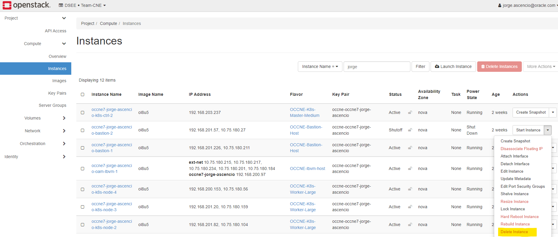

Replacing a Failed Bastion Host in OpenStack
  1. Log in to OpenStack cloud using your credentials.
  2. From the Compute menu, select Instances, and locate the failed Bastion's instance that you want to replace.
  3. Click the drop-down list from the Actions column, and select Delete Instance to delete the failed Bastion host:
    Delete_Failed_BastionHost_OpenStack

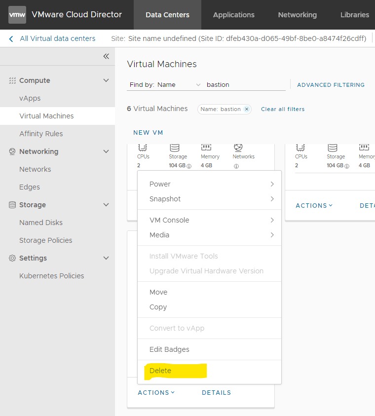

Replacing a Failed Bastion Host in VMware
  1. Log in to VMware cloud using your credentials.
  2. From the Compute menu, select Virtual Machines, and locate the failed Bastion's VM that you want to replace.
  3. From the Actions menu, select Power → Power Off.
  4. From the Actions menu, select Delete to delete the failed Bastion Host:
    Delete_Failed_Bastion_Host_in_VMWare

    8. Log in to the OpenStack GUI, and manually power off (if needed) and delete the node. At this stage, the node must be already removed from the cluster.

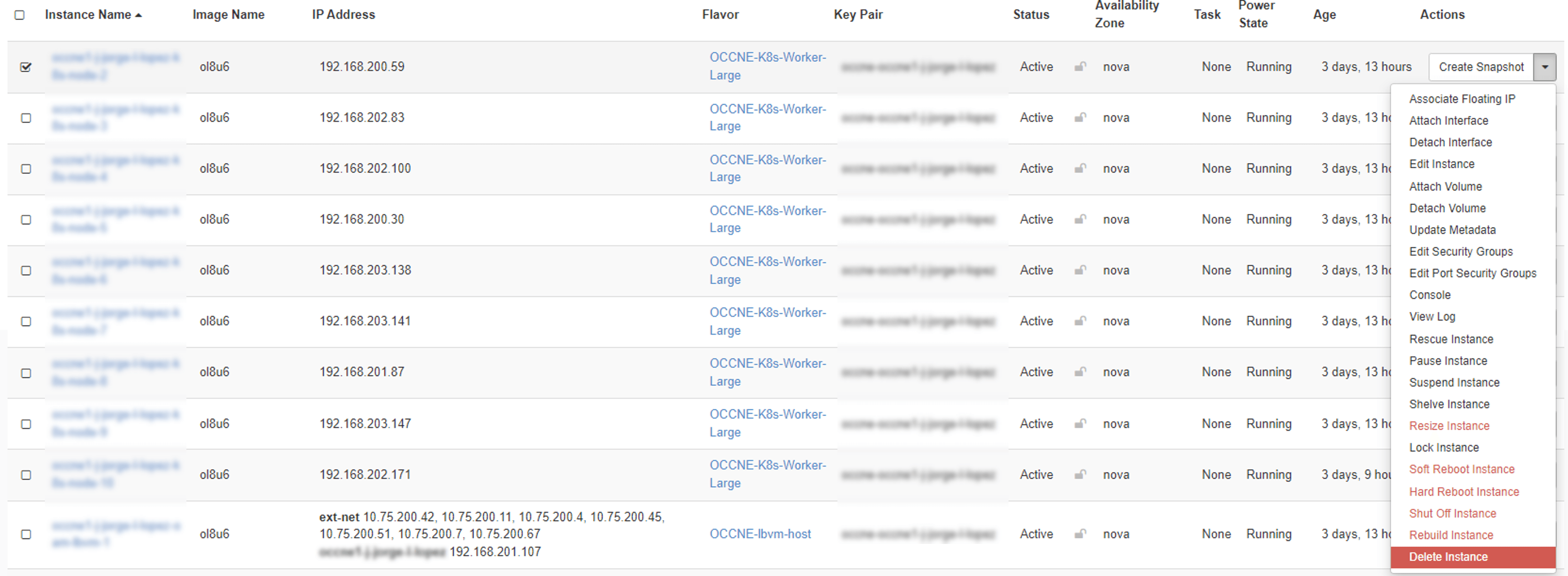

  2. Delete the failed node from OpenStack GUI:
    1. Log in to the Openstack GUI console by using your credentials.
    2. From the list of nodes displayed, locate and select the failed worker node.
    3. From the Actions menu in the last column of the record, select Delete Instance.
      Delete Worker Node from OpenStack GUI
    4. Reconfirm your action by clicking Delete Instance and wait for the node to be deleted.

  2. Log in to the VCD or VMWare console. Manually power off (if needed) and delete the failed node from VMware. At this stage, the node must be already removed from VCD consoler.
