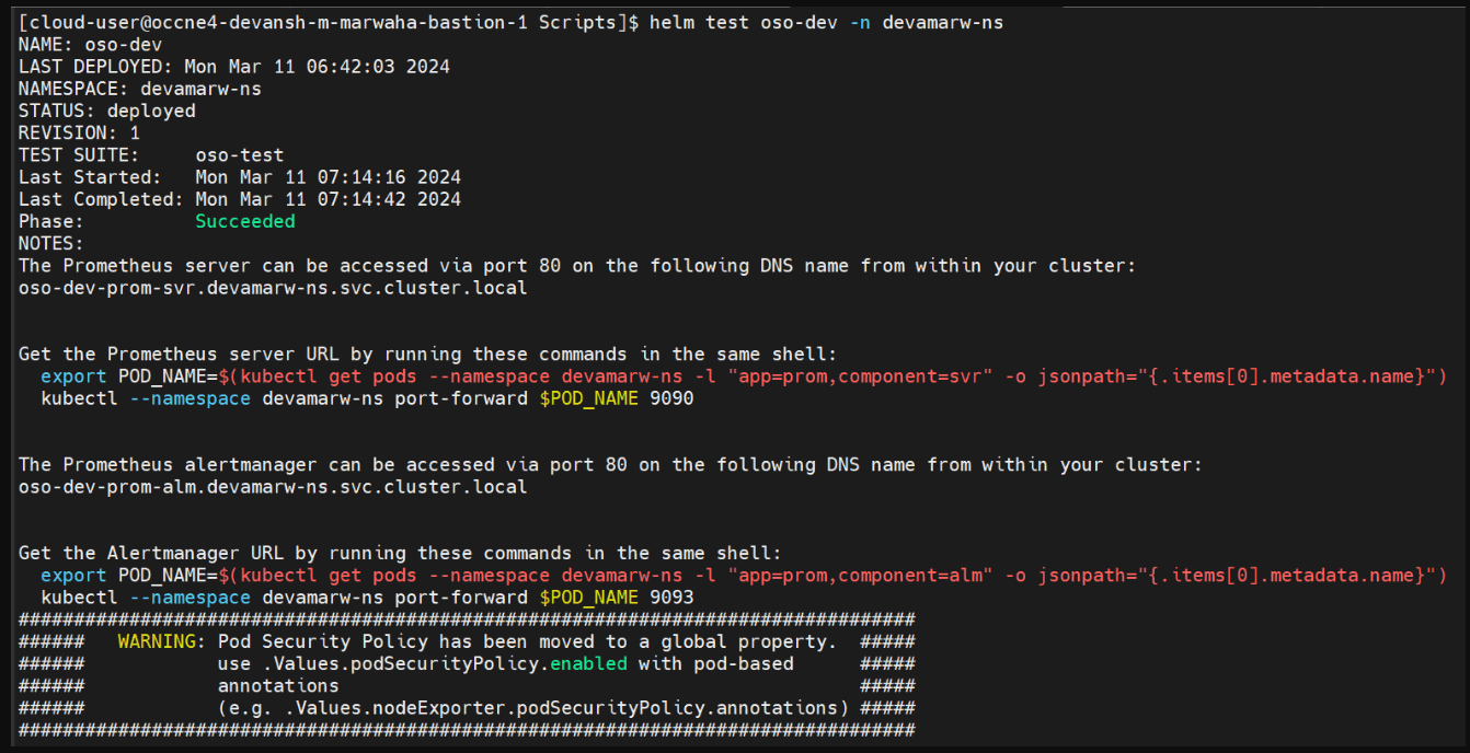

    3. Run the following command to perform a Helm test. Populate the values in the ocoso_csar_26_1_200_0_0_prom_custom_values.yaml and ocoso_csar_26_1_200_0_0_alm_custom_values.yaml files to run the Helm test. Run the Helm test separately for each Alertmanager and Prometheus.
      $ helm test <release-name> -n <oso-namespace>
      Helm Test can be run for the first time smoothly, but if some issue occurs, and there's a need to re-run the helm test, first you will have to delete the existing test job and repeat the "helm test" command as shown above.
      $ kubectl get jobs.batch -n <namespace>
      $ kubectl delete jobs.batch oso-test -n <namespace>
      Figure 2-1 Helm Test
      Helm Test

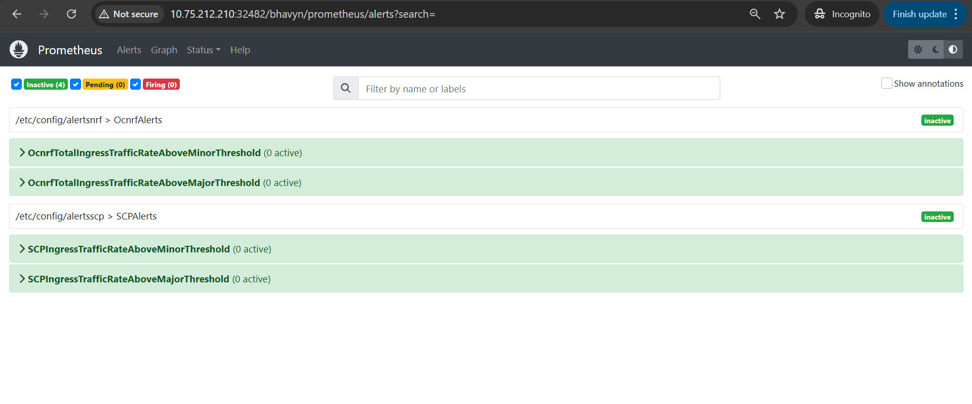

      4. Verify if the alerts are successfully loaded in the Prometheus GUI. For more information, see Verifying Installation section to understand how to access OSO Prometheus GUI and how to verify alerts.

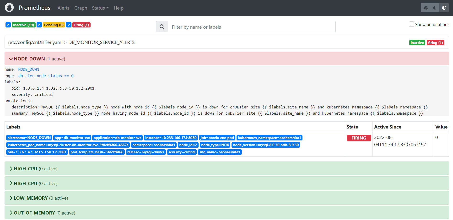

        Screenshot of Prometheus GUI without CNC Console alerts:
        Figure 2-2 Prometheus GUI with No CNC Console Alert Files

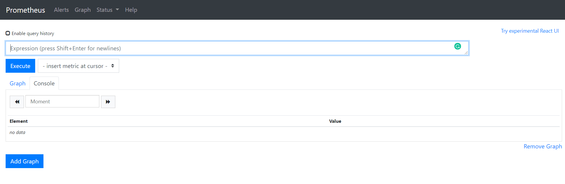

  4. Verify that all the GUIs are accessible.
    Prometheus and Alertmanager GUIs can be accessed only using the CNC Console. For more information about accessing Prometheus and Alertmanager GUIs using CNC Console, see Oracle Communications Cloud Native Configuration Console User Guide.
    If the service is of type LoadBalancer, use EXTERNAL-IP to open the Prometheus GUI. Refer to Step 2 to get the services and their EXTERNAL-IPs.
    Example to access service IP address with output:
    # kubectl get nodes -o wide
    NAME     STATUS   ROLES    AGE   VERSION   INTERNAL-IP     EXTERNAL-IP   OS-IMAGE                  KERNEL-VERSION                  CONTAINER-RUNTIME
    master   Ready    master   87d   v1.17.1   10.75.226.13    &lt;none&gt;        Oracle Linux Server 7.5   4.1.12-112.16.4.el7uek.x86_64   docker://19.3.11
    slave1   Ready    &lt;none&gt;   87d   v1.17.1   10.75.225.177   &lt;none&gt;        Oracle Linux Server 7.5   4.1.12-112.16.4.el7uek.x86_64   docker://19.3.11
    slave2   Ready    &lt;none&gt;   87d   v1.17.1   10.75.225.47    &lt;none&gt;        Oracle Linux Server 7.5   4.1.12-112.16.4.el7uek.x86_64   docker://19.3.11
    # kubectl get service -n ocnrf
    NAME                                  TYPE           CLUSTER-IP      EXTERNAL-IP     PORT(S)           AGE
    oso-prom-alm                          ClusterIP      10.103.63.10     &lt;none&gt;         80/TCP            35m
    oso-prom-alm-headless                 ClusterIP      None             &lt;none&gt;         80/TCP            35m
    oso-prom-svr                          ClusterIP      10.101.91.81     &lt;none&gt;         80/TCP            35m
    In case Dualstack with IPv6 is enabled, change the service type to LoadBalancer in the custom values file. You can see both IPs when calling the kubectl get service command, and the output is as follows:
    [root@master Scripts]# kubectl get service -n ocnrf
    oso-prom-alm                 LoadBalancer   10.103.63.10    10.75.202.205,2606:b400:605:b809::2  80/TCP            35m
    oso-prom-alm-headless        ClusterIP      None            <none>                               80/TCP            35m
    oso-prom-svr                 LoadBalancer   10.101.91.81    10.75.202.204,2606:b400:605:b809::1  80/TCP            35m
    Figure 2-3 Prometheus GUI
    Prometheus GUI

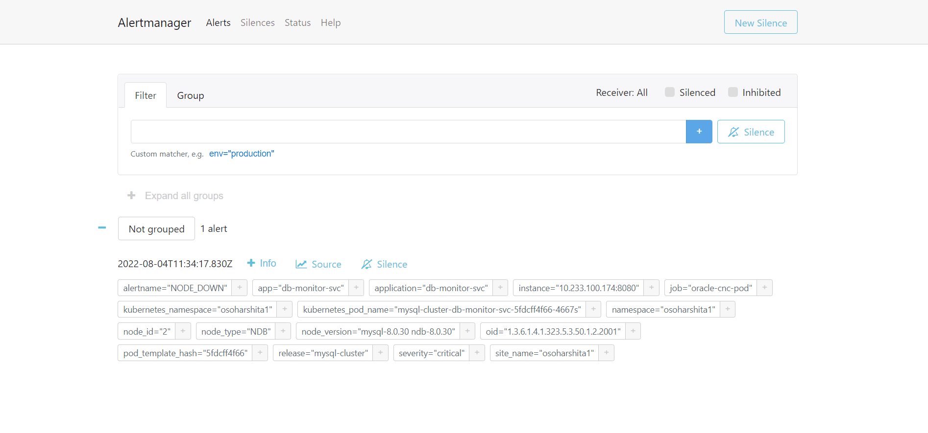

    Figure 2-4 Alert Manager GUI
    Alert Manager GUI

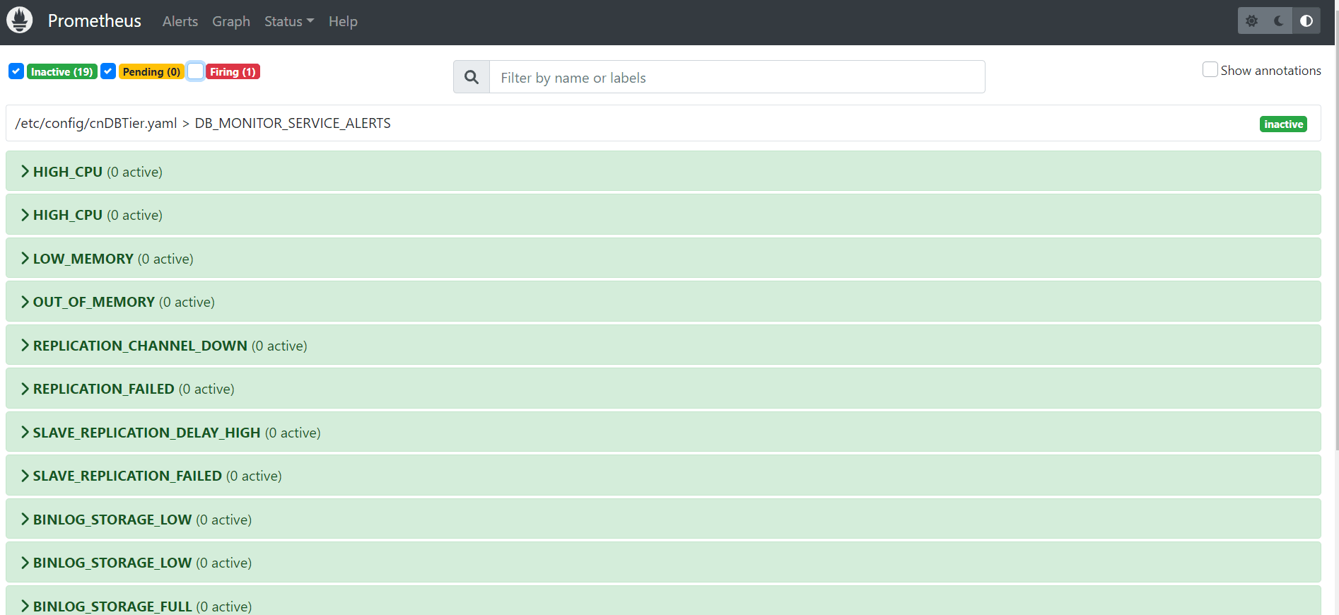

  5. On the Prometheus GUI, click Alerts to verify that all the alerts (NF Alerts) are visible.
    OSO Prometheus doesn't have any alerts of its own, therefore the GUI must appear empty initially. You can patch any NF alert rules in this section.
    The following image displays the alerts for cnDBTier:
    Figure 2-5 Prometheus GUI
    Prometheus GUI
    After alerts are raised, the GUI must display the triggered alerts as shown in the following image:
    Figure 2-6 Prometheus GUI - Alerts

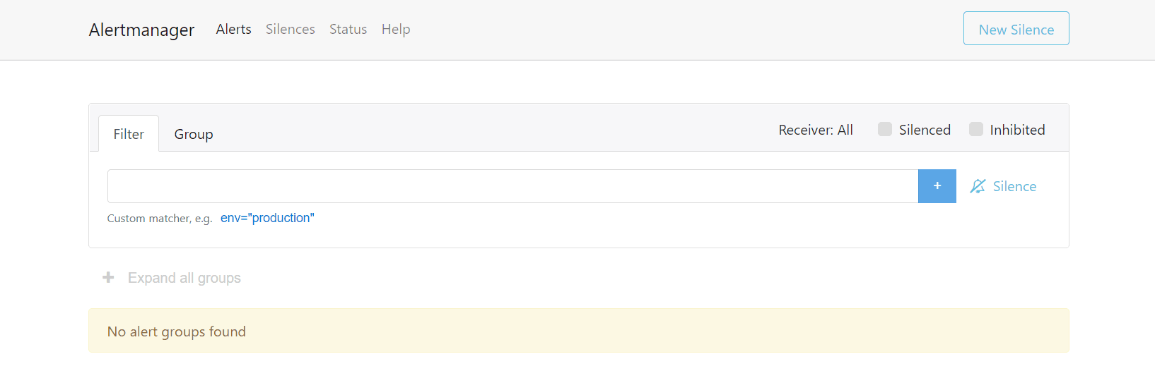

  6. Select Alerts tab on the Alertmanager GUI to view the triggered alerts as shown in the following image:
    Figure 2-7 Alertmanager - Alerts

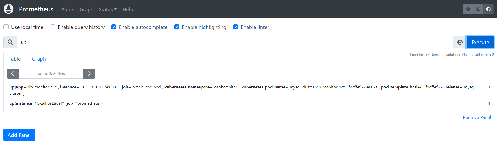

  7. On the Prometheus GUI, click Graph to verify if the expected metrics (example, NF Metrics) are displayed. The following image displays a sample Prometheus Graph with metrics:
    Figure 2-8 Prometheus Graph
    Prometheus Graph

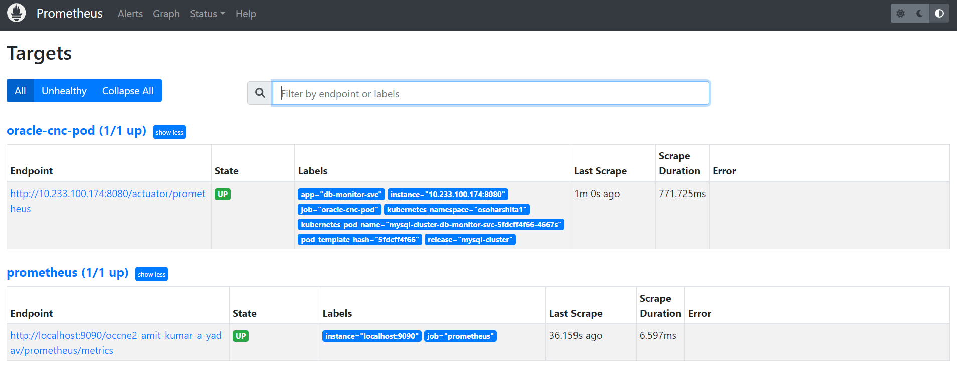

  8. On the Prometheus GUI, navigate to Status and then click Target to verify if the configured targets are displayed.
    The following image shows Prometheus targets that are being extracted:
    Figure 2-9 Prometheus Target
    Prometheus Target
