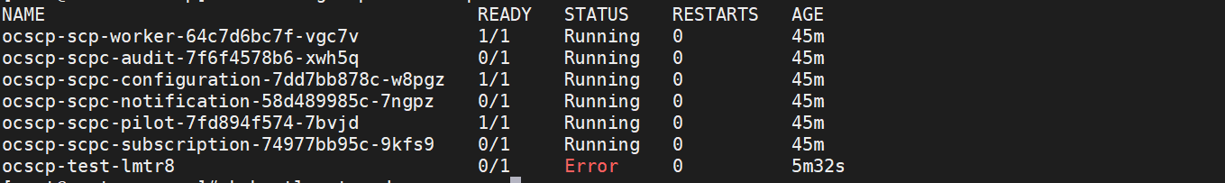

  1. Run the following command to retrieve the Helm Test pod name:
    kubectl get pods -n <deployment-namespace>
  2. Check for the Helm Test pod that is in the error state:
    Figure 2-1 Helm test pod
    Helm test pod

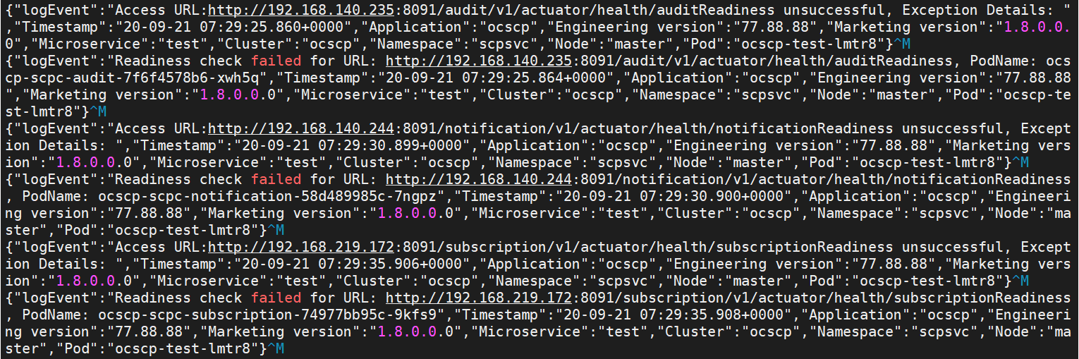

Readiness Probe Failure
Helm install might fail due to the readiness probe URL failure.
In case the following error appears, check for readiness probe URL correctness in the particular microservice helm charts under charts folder:
Figure 2-2 Readiness Probe Failure
Readiness probe failure
