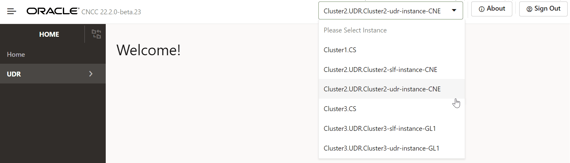

To log in to CNC Console:
  1. Type http://cncc-core-ingress-gateway.cncc.svc.cluster.local:<PortNumber>/ in the web browser and press Enter. The login page appears:
    Figure 3-1 CNC Console Login Page
  2. Enter the Username and Password and click Log In. The CNC Console Home page appears from where a user can select different instances in the drop down, for example, the EIR, SLF, or the UDR instance.
    Figure 3-2 CNC Console Home Page

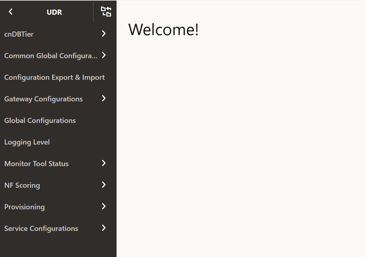

    The following NF services appear in the left navigation pane for the selected instance:
    • Bulk Import Status
    • Configuration Export & Import
    • Global Configurations
    • Logging Level
    • Provisioning
    • Service Configurations
    • NF Scoring
    • Migration Tool Status
  3. Select the service to be used from the left navigation pane:
    Figure 3-3 CNC Console Home Page with Services
    The NF services appear in the left navigation pane for the EIR and SLF instance.

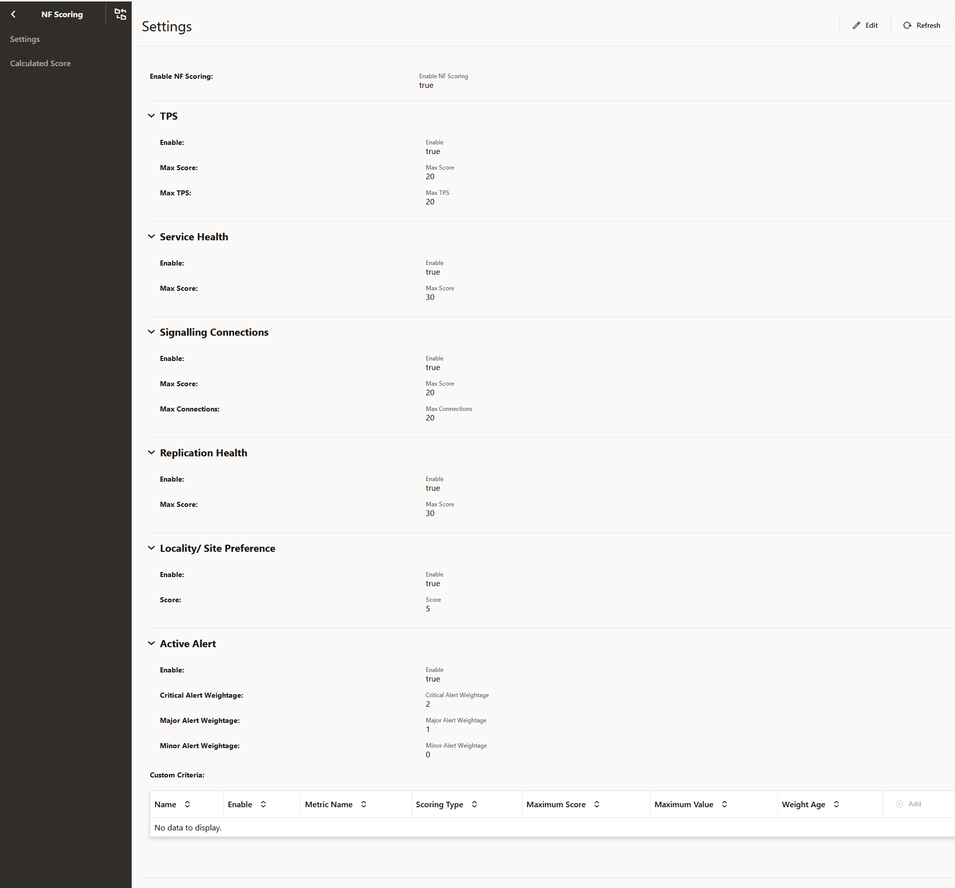

3.3.15 Congestion Level Configuration
Perform the following procedure to configure the congestion level of the pods.
  1. In the CNC Console, click UDR and then Ingress Gateway
  2. From the left navigation menu, navigate to Ingress Gateway Signaling.
  3. Click the Congestion Level Configuration option under Ingress Gateway Signaling.
    The Congestion Level Configuration page is displayed.
  4. Click Edit to edit the configuration.
    The Edit Congestion Level Configuration page is displayed.
  5. Configure the fields in the Edit Congestion Level Configuration page as follows:
    Table 3-14 Congestion Level Configuration
    Field Name Description Details
    Refresh Interval (seconds) This attribute indicates the refresh interval for the scheduler to calculate congestion level in milliseconds.
    CPU levels are stable when tested with values more than 500 ms as a refresh interval. Any value less than this, the CPU spikes are observed for a shorter period of time, and denied requests are processed based on the action defined for that congestion level.
    Data Type: Integer
    Constraints: NA
    Default Value: 500
    Levels This attribute indicates an array of different levels of congestion.
    Data Type: Object
    Constraints: NA
    Default Value: NA
  6. Click Add to add the configuration levels.
  7. Configure the fields in the Add Levels page as follows:
    Table 3-15 Congestion Levels
    Attribute Name Description Details
    Level Name
    Indicates the name of the congestion level.
    The possible values are Normal, Danger of Congestion, and Congested.
    Data Type: String
    Constraints: Normal, Danger of Congestion, Congested
    Default Value: NA
    Level Value Indicates numerical values for each congestion level.
    The value ranges from 1-10.
    The values should be defined from 1 to 10 in increasing order. The default level of the system is 0. This is the state of the system when the CPU is less than the onset of L1 defined in the configuration.
    Data Type: Integer
    Constraints: 1 -10
    Default Value: 0
    Resources Indicates the list of resources.
    Data Type: Object
    Constraints: NA
    Default Value: NA
  8. Click Add to add the resource details.
  9. Configure the fields in the Add Resources page as mentioned in the below table.
    Table 3-16 Resources
    Resource Name Indicates the resource names. The possible value is CPU.
    Data Type: String
    Constraints: NA
    Default Value: CPU
    Onset Threshold
    Indicates the onset threshold.
    Note: Onset must be more than the level of abatement. It is denoted by percentage.
    Data Type: Integer
    Constraints: NA
    Default Value: NA
    Abatement Threshold
    Indicates the abatement threshold. It is denoted by percentage.
    • Abatement must be less than the onset of the same level.
    • Abatement must be more than the onset of the previous level.
    Data Type: Integer
    Constraints: NA
    Default Value: NA
  10. Click Save on the Add Resources page to save the details. Click Cancel to discard your progress and go back to the Add Levels page.
  11. Click Save on the Add Levels page to save the details. Click Cancel to discard your progress and go back to Edit Congestion Level Configuration page.
  12. Click Save on the Congestion Level Configuration page to save the details.

3.5 cnDBTier
Perform the following procedure to view the cnDBTier version, the status of cnDBTier clusters, georeplication status, and georeplication recovery status on the CNC Console.
The following cnDBTier APIs, except On Demand Migration, are read only.

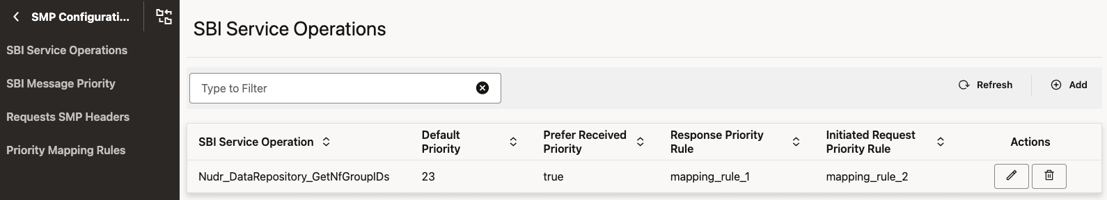

Add or modify SBI Service operations from the SBI Service Operations page:
Figure 3-5 SBI Service Operations

To configure SMP request-header names, go to the Request SMP Headers page:
Figure 3-7 Requests SMP Headers
Request SMP Headers

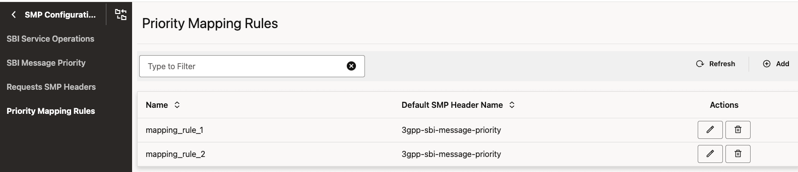

To add or modify existing priority mapping rules, go to the Priority Mapping Rules page:
Figure 3-8 Priority Mapping Rules

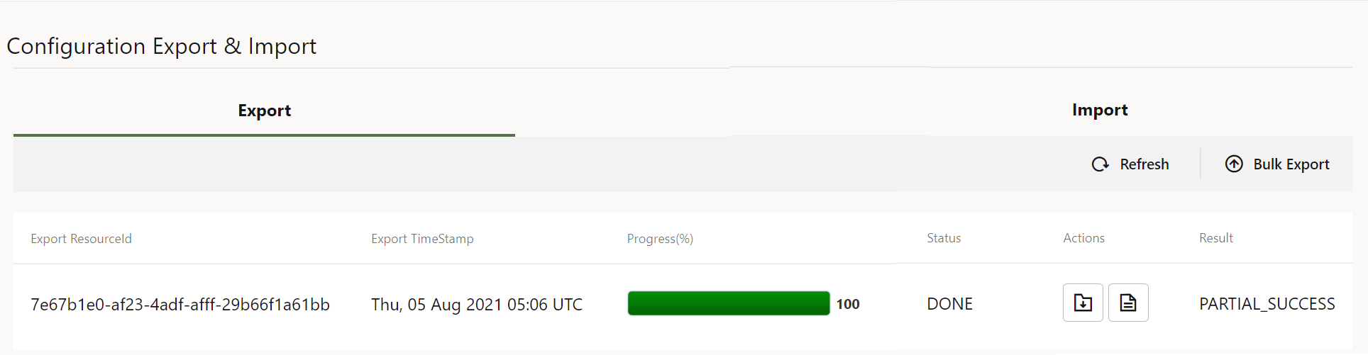

In the CNC Console application, click UDR and then Export & Import. The Configuration Export & Import page appears.
Figure 3-10 Configuration Export & Import
The Configuration Export & Import page has two tabs: Export (default) and Import. This page allows you to:
  • Export the configuration data.
  • Download the exported data.
  • Import the data (zip file) that you have exported earlier.
  • Generate report to view details of successful and failed configurations.

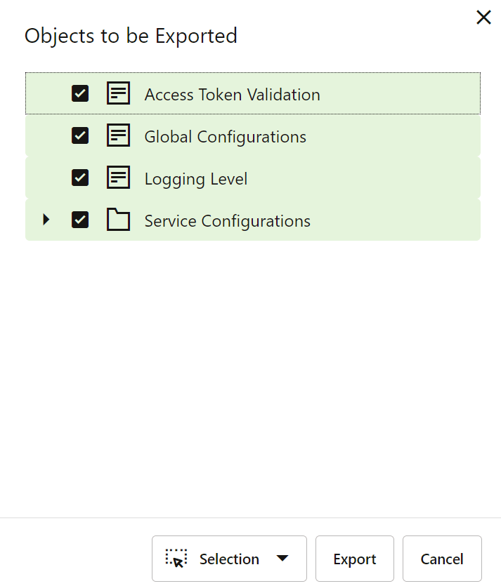

  1. Click the Bulk Export button in the Export tab. The Objects to be Exported dialog box appears.
    Figure 3-11 Objects to be Exported Dialog Box
  2. Select the objects that you want to export. Click the Selection button to either 'Select All' or 'Deselect All' the objects.
  3. Click Export to export the selected objects data. The data in the Configuration Export & Import page is updated.
  4. Click Cancel to exit the dialog box.
Downloading Exported Configuration Data
To download the exported configuration data:
  1. Click the Export Configuration Download icon available under the Actions column of the Export tab.
  2. The "Export Data downloaded Successfully" message appears and the zip file of the exported data is saved to your system. For example: exportedFiles_1.12.41_20210807133529.zip
Downloading Exported Configuration Data Report
To download the exported configuration data report:
  1. Click the Export Report Download icon available under the Actions column of the Export tab.
  2. The "Export status report downloaded successfully" message appears and the export report in the .txt file format is saved to your system. For example: exportReport_1.12.41_20210807134056.txt

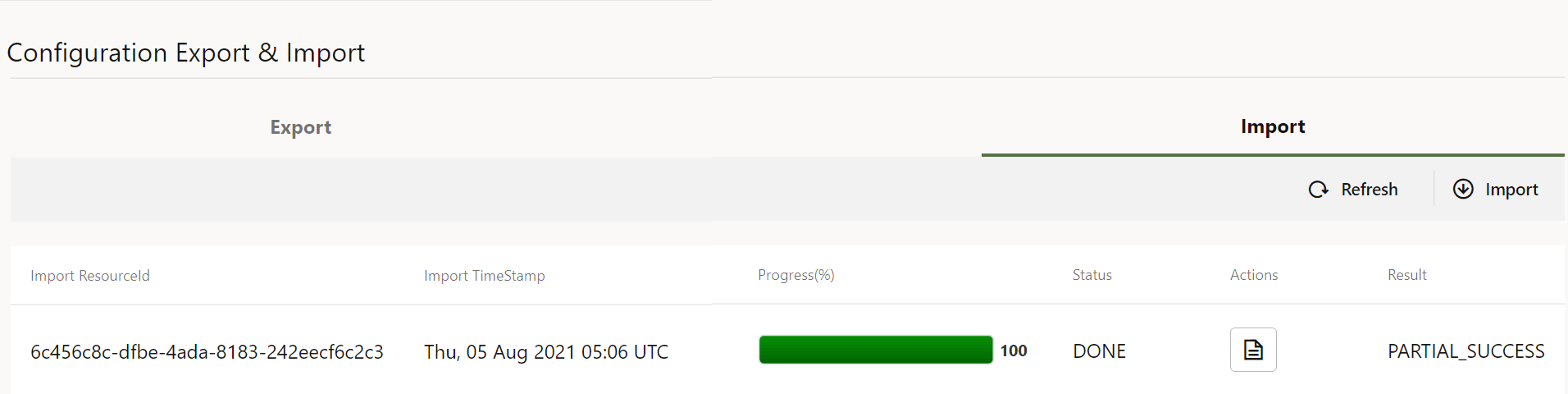

Importing Configuration Data
To import the configuration data:
  1. Navigate to the Import tab. The Configuration Export & Import page appears as follows:
    Figure 3-12 Importing Configuration Data
  2. Click the Import button. The Import Data dialog box appears.
    Figure 3-13 Import Data Dialog Box
  3. Select the file that has configuration data and click Import.
    You can only import the configuration data that you had exported earlier.
  4. The data in the Configuration Export & Import page is updated.
  5. Click Cancel to exit the dialog box.
Downloading Imported Configuration Data Report
To download the imported configuration data report:
  1. Click the Import Report Download icon available under Actions column of the Import tab.
  2. The "Import status report downloaded successfully" message appears and the import report in the .txt file format is saved to your system. For example: importReport_1.12.41_20210807134056.txt

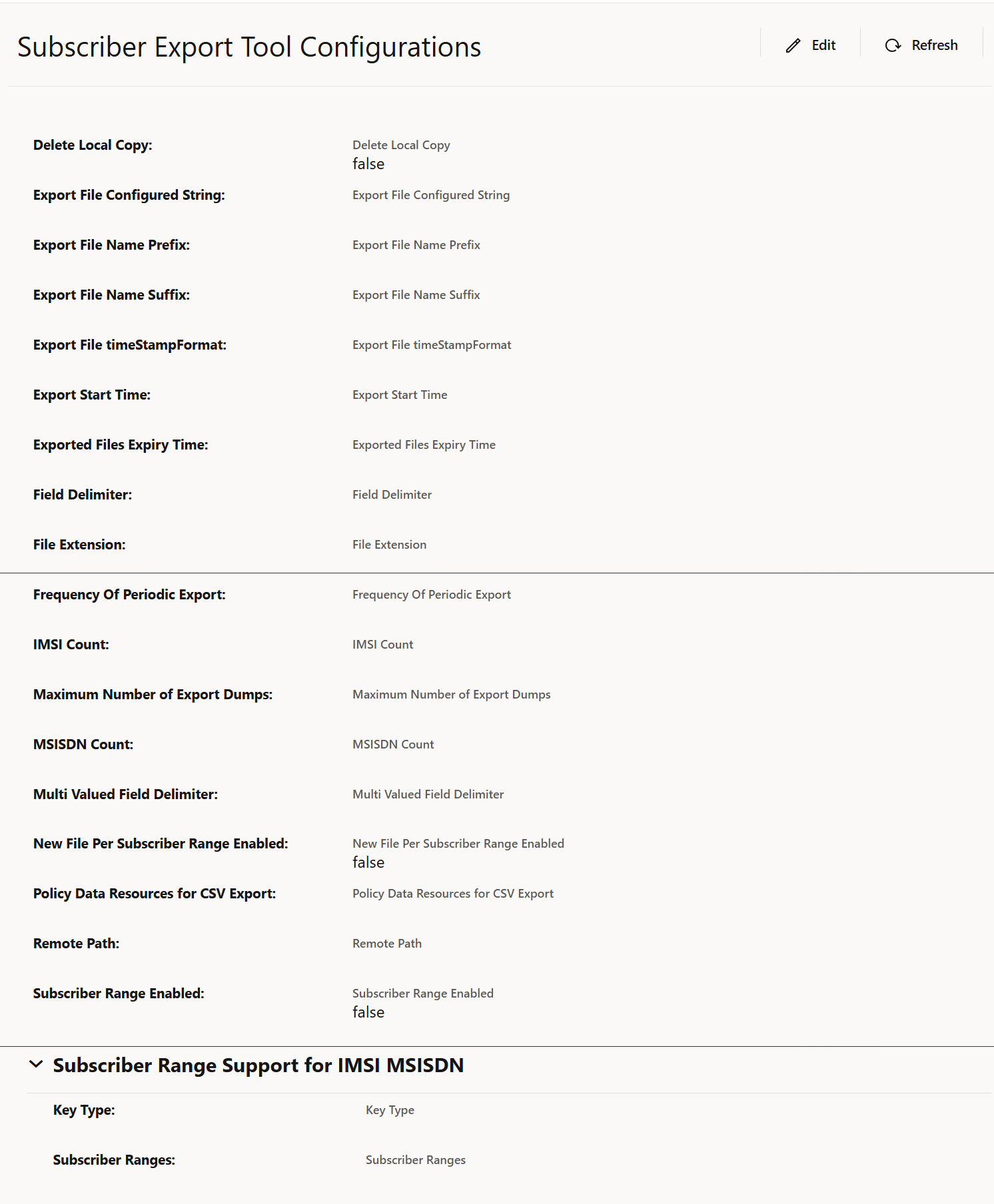

3.9 Subscriber Export Tool Status
The Subscriber Export Tool Status page is a monitoring page, which is read-only. This page allows the operator to monitor the Subscriber Export Tool Status, which initiates on running the Subscriber Export tool. For more information, see Subscriber Export Tool.
To access the Subscriber Export Tool Status page, click UDR and then, Subscriber Export Tool Status in the left navigation pane of the CNC Console application. The following page appears:
Figure 3-14 Subscriber Export Tool Status
The Subscriber Export Tool Status page shows following export tool transaction details:
  • Job Id: Generates unique ID for export.
  • Subscriber Count: Total subscriber count present in the database
  • Exported Subscriber Count: Total subscriber count exported from the database.
  • Job Progress: Shows the progress of dump in percentage.
  • Status: Shows the overall status of the export transaction. For example, RUNNING, COMPLETED, SKIPPED, or FAILED.
  • Export State: This field indicates number of completed stages. For example, export from database is successful (1/1) and transfer of data from path to remote is successful (2/2).
Using Filter option, you can filter the records you are interested in and using Refresh option, you can refresh the Subscriber Export Tool Status page.

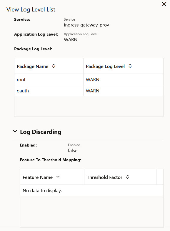

  • View: Click View corresponding to each microservice. The View Log Level List page appears.
    Figure 3-15 Sample: View Log Level List

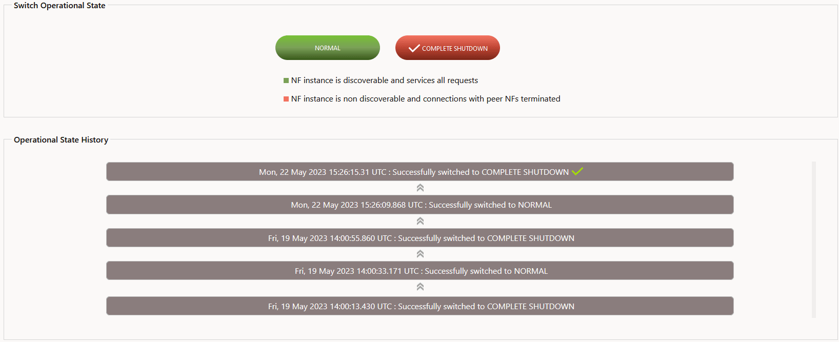

3.12 Controlled Shutdown Configurations
This section describes how to perform Controlled Shutdown configurations.
3.12.1 Operational State
Perform the following steps to change the Operational State of a site:
  • In the CNC Console application, under UDR, click Controlled Shutdown, and then select Operational State.
    This opens the page displaying the two groups, Switch Operational State and Operational State History:
    Figure 3-17 Operational State
    Operational State
    • Switch Operational State displays the following operational states:
      • NORMAL: NF instance is discoverable and services all requests.
      • COMPLETE SHUTDOWN: NF instance is non discoverable and no new session creation requests accepted.
      The current state of any site can be identified with a tick mark.
      You can switch to a different operational state by clicking the NORMAL or COMPLETE SHUTDOWN button.
    • Operational State History: It displays the history of the operational states along with the timestamp.
3.13 Provisioning
To configure UDR services using CNC Console, you can use Provisioning. In the left navigation pane of the CNC Console application, click UDR and then Provisioning.
Using Provisioning, SLF users can configure following services:
Using Provisioning, EIR users can configure following services:

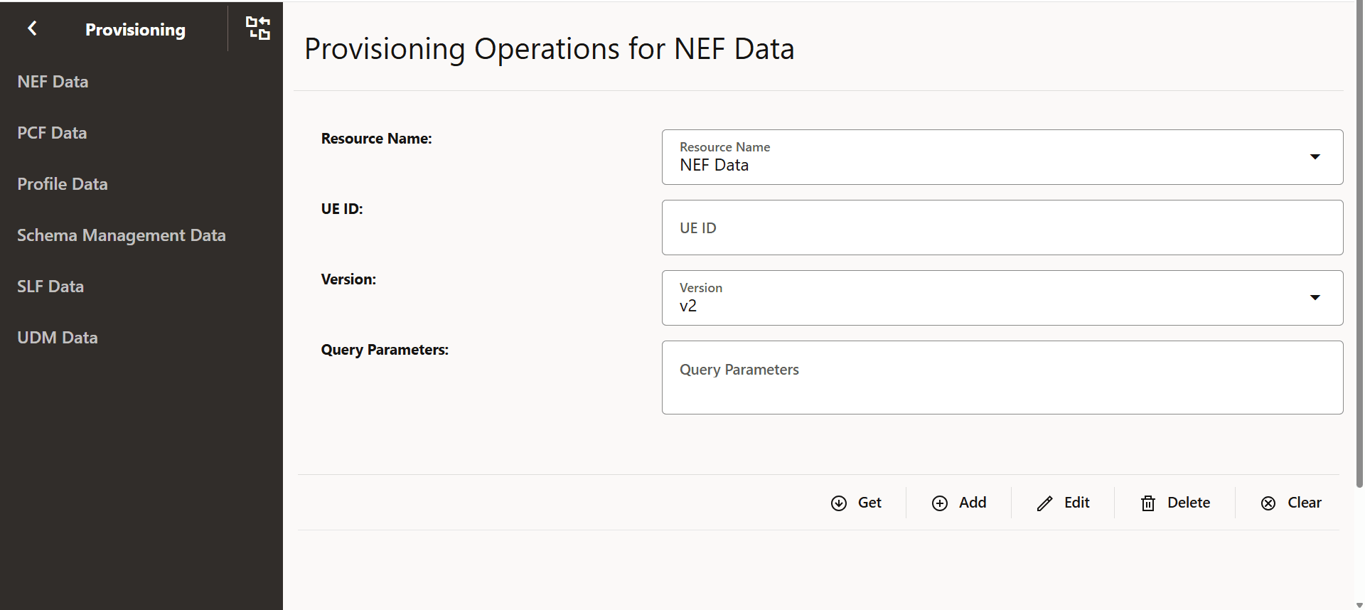

3.13.1 Provisioning - NEF Data
This section describes how to provision operations for NEF Data.
In the CNC Console application, click UDR and then Provisioning. From the Provisioning menu, select NEF Data in the left navigation pane. The Provisioning Operations for NEF Data page appears:
Figure 3-18 Provisioning Operations for NEF Data
Provisioning GUI for NEF Data
In the Provisioning Operations for NEF Data page, users can:
  • Extract NEF data from UDR database based on the UE ID entered
  • Add new NEF data to the UDR database
  • Modify an existing NEF data on the based on a UE ID
  • Delete existing NEF data that is not needed in the UDR database
Extracting Profile Data
To extract profile data:
  1. Ensure Resource Name is set to 'NEF Data'
  2. Type an appropriate UE ID. For example: msisdn-1111111114
  3. Click Get. A confirmation message, 'Fetched Successfully' appears for a second, and the result appears in the Response text area as follows:
    Figure 3-19 Sample Page: Get - NEF Data - Response
    GET-NEF Data
  4. An Error message summary appears in case of incorrect UE ID entered.
Adding NEF Data
To add NEF data:
  1. Ensure Resource Name is set to 'NEF Data'.
  3. Click Add. The Request text area appears.
  4. Enter the NEF data that you want to add to the UDR database.
  5. Click Submit. The 'Saved Successfully.' message appears.
    If you enter an incorrect input, an Error message summary appears.
Editing Profile Data
To edit profile data:
  3. Click Edit. The Request text area displays existing NEF data.
  4. Enter the updated NEF data.
Deleting NEF Data
To delete NEF data:
  3. Click Delete.
  4. The 'Deleted Successfully' message appears.
Clearing NEF Data
Click the Clear option to clear all the text fields and text areas of the Provisioning Operations for NEF Data.

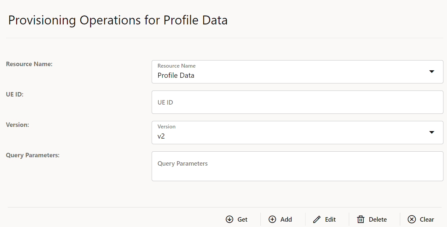

3.13.2 Provisioning - Profile Data
This section describes how to operate provisioning operations for Profile Data.
In the CNC Console application, click UDR and then Provisioning. From the Provisioning menu, select Profile Data in the left navigation pane. The Provisioning Operations for Profile Data page appears:
Figure 3-20 Provisioning Operations for Profile Data
In the Provisioning Operations for Profile Data page, user can:
  • Extract profile data from UDR database on the basis of UE ID entered
  • Add new profile data to the UDR database
  • Modify an existing profile data on the basis of UE ID
  • Delete an existing profile data that is no more needed in the UDR database

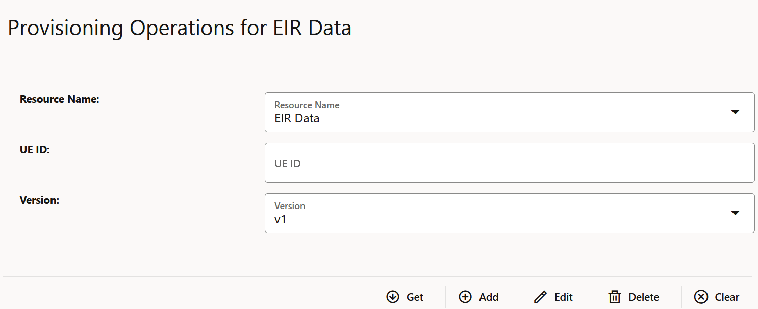

3.13.3 Provisioning - EIR Data
This section describes provisioning operations for EIR Data.
In the CNC Console application, click UDR and then Provisioning. From the Provisioning menu, select EIR Data in the left navigation pane. The Provisioning Operations for EIR Data page appears:
Figure 3-22 Provisioning GUI for EIR Data
In the Provisioning Operations for EIR Data page, users can:
  • Extract EIR data from UDR database based on the UE ID entered
  • Add new EIR data to the UDR database
  • Modify an existing EIR data on the based on a UE ID
  • Delete existing EIR data that is not needed in the UDR database

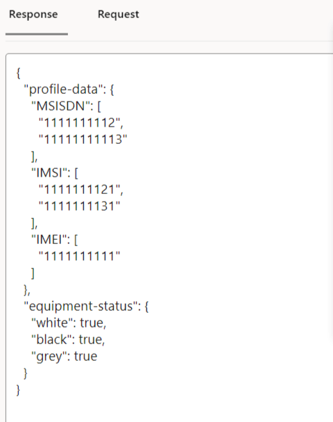

  1. Ensure Resource Name is set to 'EIR Data'
  2. Type an appropriate UE ID. For example: UE ID - imei-1111111111
    Figure 3-23 Sample Page: Get - EIR Data - Response
    GET-EIR Data
Adding EIR Data
To add EIR data:
  1. Ensure Resource Name is set to 'EIR Data'.
  2. Type an appropriate UE ID. For example: msisdn-1111111112
  4. Enter the EIR data that you want to add to the UDR database.
  4. Enter the updated EIR data.
Deleting EIR Data
To delete EIR data:
  3. Click Delete.
Clearing EIR Data
Click the Clear option to clear all the text fields and text areas of the Provisioning Operations for EIR Data.

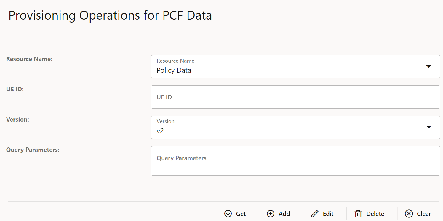

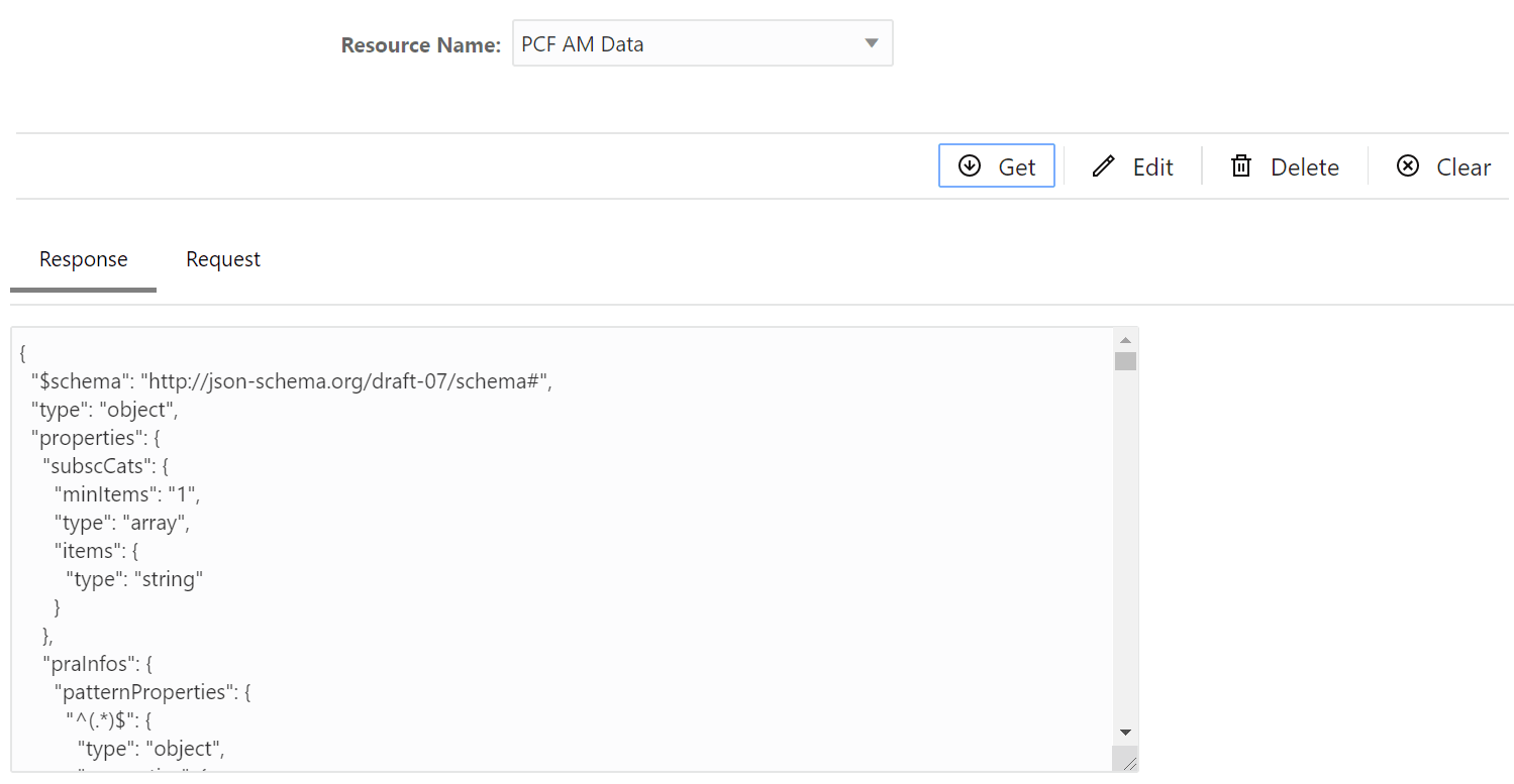

3.13.4 Provisioning - PCF Data
This section describes how to operate provisioning operations for PCF (Policy Control Function) Data.
In the CNC Console application, click UDR and then Provisioning. From the Provisioning menu, select PCF Data in the left navigation pane. The Provisioning Operations for PCF Data page appears:
Figure 3-24 Provisioning Operations for PCF Data
In the Provisioning Operations for PCF Data page, a user can:
  • Select the Resource Name from the drop-down list.
  • Extract PCF data from UDR database on the basis of UE ID entered.
  • Add PCF Data on the basis of payload.
  • Modify the existing PCF data on the basis of UE ID.
  • Delete the existing PCF data that is no more needed in the UDR database.
Extracting PCF Data
To extract the PCF data:
  1. Select the Resource Name from the drop-down list.
  2. Type an appropriate UE ID. For example: msisdn-9111111112.
  3. Click Get. A confirmation message, 'Fetched Successfully.' appears and the result appears in the Response text area as follows:
    Figure 3-25 Provisioning PCF Get Response
Adding a PCF Data
To add a PCF data:
  3. Click Add. The Request text area displays an existing PCF data.
  4. Type-in the updated profile data.
    If a user enters any incorrect input, an Error message summary appears.
Editing a PCF Data
To edit a PCF data:
  3. Click Edit. The Request text area displays an existing PCF data.
Deleting a PCF Data
To delete a PCF Data:
  1. Select the Resource Name.
  3. Click Delete.
  4. The 'Deleted Successfully.' message appears.
Clearing a PCF Data
Click the Clear option to clear the text fields and text areas of the Provisioning Operations for PCF Data page.

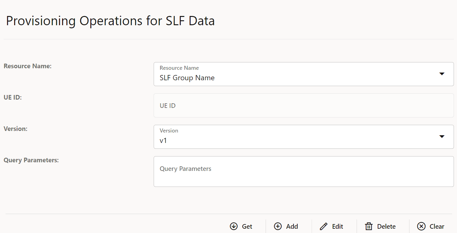

3.13.5 Provisioning - SLF Data
In this section, you will learn to operate provisioning operations for SLF (Subscriber Location Function) Data.
In the CNC Console application, click UDR and then Provisioning. From the Provisioning menu, select SLF Data in the left navigation pane. The Provisioning Operations for SLF Data page appears:
Figure 3-26 Provisioning Operations for SLF Data
SLF Group Name must be provisioned before SLF Subscriber is provisioned.
In the Provisioning Operations for SLF Data page, user can:
  • Extract SLF data from UDR database on the basis SLF Group Name (Query Parameter) or SLF Subscriber (UEID).
  • Add or edit an existing SLF data on basis of SLF Group Name (Query Parameter) or SLF Subscriber (UEID).
  • Delete an existing SLF data that is no more needed in the UDR database.
Extracting SLF Data on the basis of SLF Group Name
To extract the SLF data on the basis of SLF Group Name:
  1. Select the Resource Name as SLF Group Name.
  2. Enter the Query Parameters.

Adding SLF Data on the basis of SLF Group Name or SLF Subscriber
To add the SLF data:
  1. Select the Resource Name as either SLF Group Name or SLF Subscriber.
  2. If you have selected the Resource Name as SLF Group Name then,
    1. Enter the Query Parameters.
    2. Click Add. The Request text area appears.
    3. Type the SLF data.
    4. Click Submit. The 'Saved Successfully.' message appears.

Editing SLF Data
To edit a SLF data:
    1. Type in the Query Parameters and click Get. The result appears in the Response text area.
    2. Click Edit. The Request text area displays an existing SLF data. Modify the relevant details.
    3. Click Submit. The 'Saved Successfully.' message appears.

Deleting a SLF Data
To delete a SLF Data:
  2. If you have selected the Resource Name as SLF Group Name then enter the 'Query Parameters' and if you have selected the Resource Name as SLF Subscriber then enter the 'UE ID'. For example: msisdn-1111111112
  3. Click Delete.

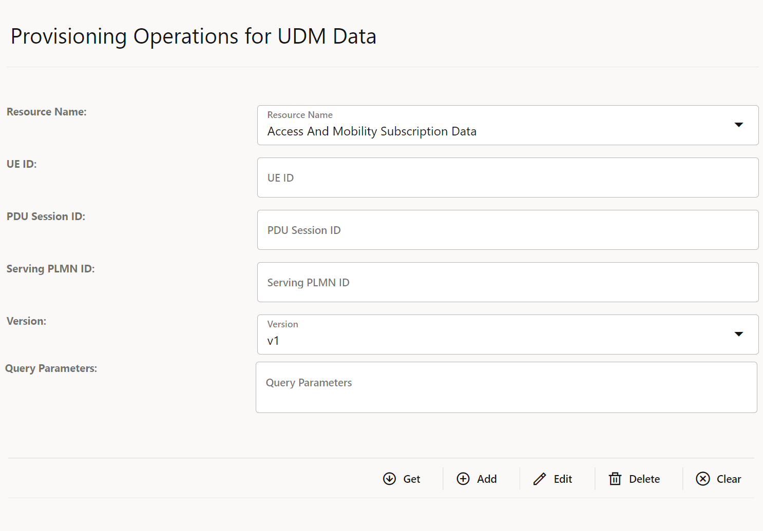

3.13.6 Provisioning - UDM Data
This section describes how to operate provisioning operations for UDM (Unified Data Management) Data.
In the CNC Console application, click UDR and then Provisioning. From the Provisioning menu, select UDM Data in the left navigation pane. The Provisioning Operations for UDM Data page appears:
Figure 3-29 Provisioning Operations for UDM Data
In the Provisioning Operations for UDM Data page, user can extract, modify and delete UDM data on the basis of Resource Name, UE ID, PDU Session ID, Serving PLMN ID, Version, and Query Parameters entered.
Extracting UDM Data
To extract the UDM data:
  2. Type an appropriate UE ID, PDU Session ID and Serving PLMN ID in their respective fields.
  3. Select an appropriate Version and enter Query Parameters.
  4. Click Get. A confirmation message, 'Fetched Successfully.' appears and the result appears in the Response text area.
  5. An Error message summary appears in case of incorrect UE ID entered.
Adding a UDM Data
To add a UDM data:
  4. Click Edit. The Request text area appears.
  5. Enter details and click Submit. The 'Saved Successfully.' message appears.
Editing a UDM Data
To edit a UDM data:
  2. Type an appropriate UE ID, PDU Session ID, and Serving PLMN ID in their respective fields.
  4. Click Edit. The Request text area displays an existing UDM data.
  5. Edit as required and click Submit. The 'Saved Successfully.' message appears.
Deleting a UDM Data
To delete a UDM Data:
  1. Enter the Resource Name.
  4. Click Delete.
  5. The 'Deleted Successfully.' message appears.
Clearing a UDM Data
Click the Clear option to clear the text fields and text areas of the Provisioning Operations for UDM Data page.

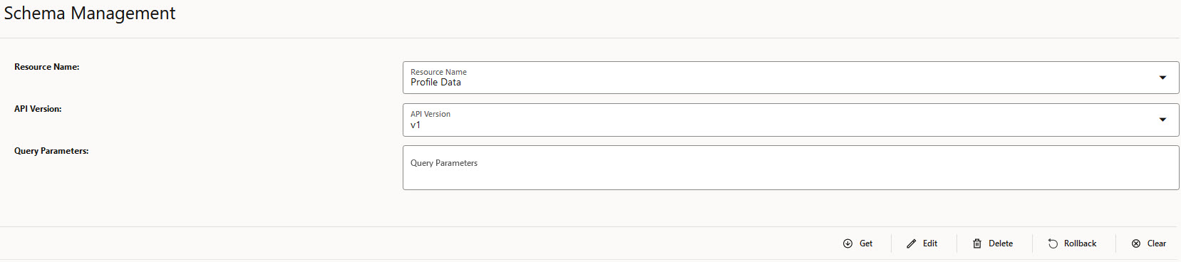

3.13.7 Provisioning - Schema Management Data
This section describes how to operate provisioning operations for schema.
In the CNC Console application, click UDR and then Provisioning. From the Provisioning menu, select Schema Management Data in the left navigation pane. The Schema Management page appears:
Figure 3-30 Schema Management
Schema Management
In the Schema Management page, user can extract, modify, and delete a schema on the basis of Resource Name and Query Parameters.
Extracting a Schema
To extract a schema:
    Figure 3-31 Schema - Get - PCF AM Data
    Schema Management - Get Response
Adding or Editing a Schema
To add or edit a schema:
  3. Click Edit. The Request text area displays the selected schema.
  4. Edit as required and click Submit. The 'Saved Successfully.' message appears.
    If a user edits the schema inappropriately, an Error message summary appears.
Deleting a Schema
To delete a schema:
  3. Click Delete.
    If a user selects a schema that does not exists, an Error message summary appears.
Clearing a Schema Management Data
Click the Clear option to clear the text fields and text areas of the Schema Management page.

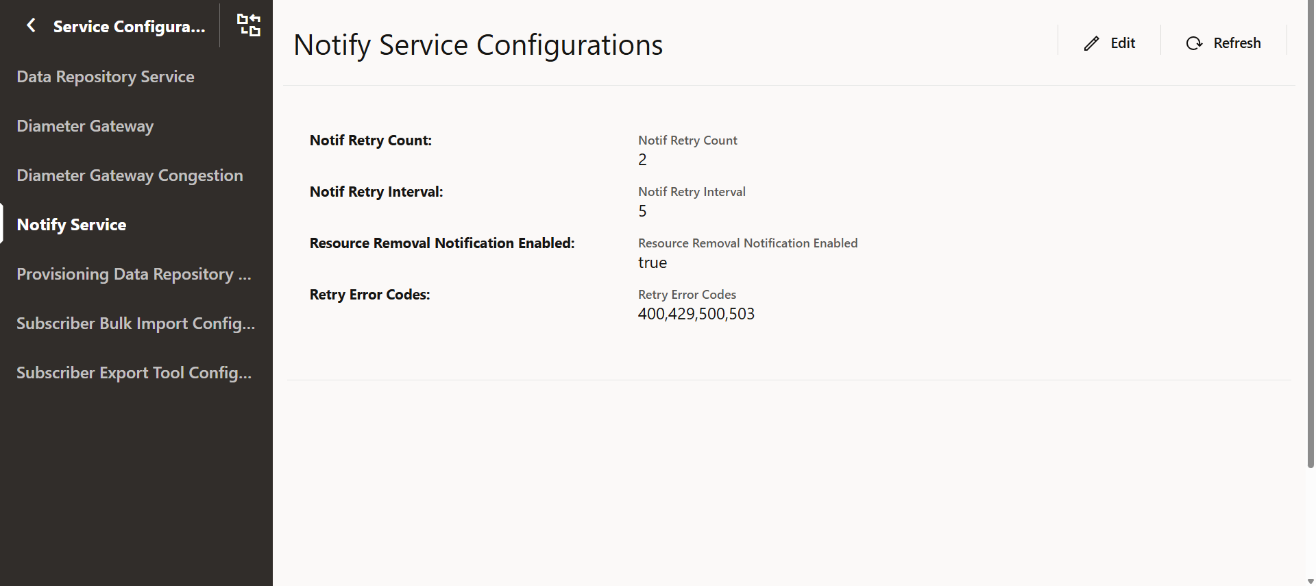

Figure 3-34 Notify Service Configurations
The following table explains the Notify Service Configurations page in detail:
Table 3-44 Notify Service Configurations Parameters
Field Name Default Value Attribute Description
Notify Retry Count 3 Editable Number of notification attempts to be done in case of notification failures.
Retries are based on notification.retryerrorcodes configuration.
Notif Retry Interval 5 Editable The retry interval for notifications in case of failure. It is measured in seconds.
Retry Error Codes 400,429,500,503 Editable This field displays comma separated error codes. These error codes are eligible for retry notifications in case of failures.
Hikari Pool Size 25 Read-only The Hikari pool connection size to be created at start up.
Tracing Enabled false Read-only This enables tracing on jaeger. By default, tracing is not enabled.
Resource Removal Notification Enabled true Editable It is the PCF notifications for delete subscriber and deletion of policy data. When enabled, the "delResources" attribute/key is included in the notification payload.
Editing Notify Service Configurations
To update or modify any configuration information related to notify service:
  1. Click Edit. The Edit Notify Service Configurations page appears.
  2. Update the configuration details as required and click Save. A confirmation message, "Save successfully." appears.
  3. If you do not want to modify any configuration, click Cancel. The Notify Service Configurations page appears.
  4. Click Refresh to reload the Notify Service Configurations page.
3.14.7 Subscriber Export Tool Configurations
Click UDR and then Service Configurations. From the Service Configurations menu, select Subscriber Export Tool Configurations. The Subscriber Export Tool Configurations page appears:
Figure 3-35 Subscriber Export Tool Configurations
The following table explains the parameters in the Subscriber Export Tool Configurations page in detail:
Table 3-45 Subscriber Export Tool Configurations Parameters
Frequency Of Periodic Export DAILY Editable It is the frequency of periodic export of subscriber data. This is configurable as ONE_TIME/DAILY/WEEKLY/MONTHLY
Export Start Time 14/09/2022 17:32:10 Editable Time at which periodic export starts. 24 hours format is used.
Maximum Number of Export Dumps 5 Editable Maximum number of export.
Export File Name Suffix SLFTestSegment Editable The suffix name of the exported file.
Export File Name Prefix empty string Editable The prefix name of the exported file.
Export File Configured String snapshot Editable It sets a configured string for export files.
Export File timeStampFormat YYYYMMDDHHMMSS Editable It sets the timestamp format for the export file name, header, and footer.
Multi Valued Field Delimiter | Editable This separator is used to differentiate multiple values for a single key type.
Field Delimiter , Editable Delimiter for fields
File Extension .csv Editable Extension for file. This can be .csv/.txt
IMSI Count 5 Editable Number of IMSI for EIR export.
If 5 IMSIs are not provisioned for a given IMEI, then 0 value is supplied for remaining IMSI .
MSISDN Count 5 Editable Number of MSISDN for EIR export.
If 5 MSISDNs are not provisioned for a given IMEI, then 0 value is supplied for remaining MSISDN.
Remote Path /home/cloud-user/ Editable Path in remote server where the exported files is stored.
Delete Local Copy true Editable Flag to enable or disable deletion of files from SFTP.
Subscriber Range Enabled false Editable Flag to enable or disable the range based subscriber export. Default is set to false for full range of 4G policy subscriber data export.
New File Per Subscriber Range Enabled False Editable When enabled creates a separate EXML file for each range. Default is set to false.
Exported Files Expiry Time 7d Editable The exported file expiry time, after which the file is deleted.
Key Type IMSI Editable To export the range based subscriber data with keys. The two key type are IMSI and MSISDN.
Subscriber Ranges NA Editable Configures the start and end ranges that is given to export the data. This works only if subscriberRangeEnabled parameter is enabled.
Policy Data Resource for CSV Export It is the type of data that needs to be exported for the policy data. By default, profile data is included. Editable sm-data,am-data,ue-policy-set
Editing Subscriber Export Tool Configurations
To update or modify configuration information related to data repository:
  1. Click Edit. The Edit Subscriber Export Tool Configurations page appears.
  2. Update the configuration details as required and click Save. A confirmation message, "Save successfully" appears.
  3. If you do not want to modify any configuration, click Cancel. You can navigate back to the Subscriber Export Tool Configurations page.
  4. Click Refresh to reload the Subscriber Export Tool Configurations page.
3.15 NF Scoring Configurations
You can configure the NF Scoring feature using the CNC Console. To navigate to NF Scoring, click UDR and then NF Scoring in the left navigation pane of the CNC Console application. Using NF Scoring, SLF users can configure following services:
  • Settings
  • Calculated Score
Settings:
From the NF Scoring menu, select Settings. The Settings page appears:
Figure 3-36 NF Scoring Configurations
Settings
The following table explains the parameters in the Settings page in detail:
Table 3-46 NF Scoring Settings for SLF
Enable NF Scoring Specifies whether to enable or disable the NF Scoring. This is a mandatory parameter.
Data Type: Boolean
Default Value: false
Range: true or false
TPS Specifies the Transaction Per Second.
Enable Enables the TPS.
Data Type: Boolean
Max Score Specifies the maximum score of the TPS. If enable is set to true then this is a mandatory parameter.
Data Type: Integer
Default Value: 20
Range: 1 to 100.
Max TPS Specifies the maximum TPS. If enable is set to true then this is a mandatory parameter.
Data Type: Integer
Range: 1 to 1000000
Service Health Specifies the Service Health of a site.
Enable Enables the Service Health. This is a mandatory parameter.
Data Type: Boolean
Max Score Specifies the maximum score of the Service Health. If enable is set to true then this is a mandatory parameter.
Data Type: Integer
Default Value: 30
Range: 1 to 100
Signaling Connections Specifies the Signaling Connections of a site.
Enable Enables the Signaling Connections. This is a mandatory parameter.
Data Type: Boolean
Max Score Specifies the maximum score of the Signaling Connections. If enable is set to true then this is a mandatory parameter.
Data Type: Integer
Default Value: 20
Range: 1 to 100
Max Connections Specifies the maximum connections. If enable is set to true then this is a mandatory parameter.
Data Type: Integer
Range: 1 to 10000
Replication Health Specifies the Replication Health of a site.
Enable Enables the Replication Health.
Data Type: Boolean
Max Score Specifies the maximum score of the Replication Health. If enable is set to true then this is a mandatory parameter.
Data Type: Integer
Default Value: 30
Range: 1 to 100
Locality or Site preference Specifies the Locality or Site Preference.
Enable Enables the Locality or Site Preference.
Data Type: Boolean
Score Specifies the score of the Locality or Site Preference. If enable is set to true then this is a mandatory parameter.
Data Type: Integer
Default Value: 5
Range: 1 to 100
Active Alert Specifies the Active Alerts of a site.
Enable Enables the Active Alert.
Data Type: Boolean
Critical Alert Weightage The site with more critical alerts is unhealthy. If enable is set to true then this is a mandatory parameter.
Data Type: Integer
Default Value: 2
Range: 0 to 100
Major Alert Weightage The site with more major alerts is unhealthy. If enable is set to true then this is a mandatory parameter.
Data Type: Integer
Default Value: 1
Range: 0 to 100
Minor Alert Weightage The site with more minor alerts is unhealthy. If enable is set to true then this is a mandatory parameter.
Data Type: Integer
Default Value: 0
Range: 0 to 100
Custom Criteria Specifies the Custom Criteria of a site.
Enable Specifies whether to enable or disable the Custom Criteria.
Data Type: Boolean
Name Name of the Custom Criteria. The two applicable criteria are Subscriber Bulk Import tool and Subscriber Export tool.
Data Type: String
Metric Name Specifies the name of the Metric.
Data Type: String
Scoring Type Specifies the scoring type. The two scoring types are ratio and weightage.
Data Type: String
Max Score Specifies the maximum score.
Data Type: Integer
Default Value: 30
Range: 1 to 100
Max Value Specifies the maximum value.
Data Type: Integer
Range: 0 to 10000
Weightage Specifies the weightage of the alert.
Data Type: Integer
Default Value: 1
Range: 1 to 100

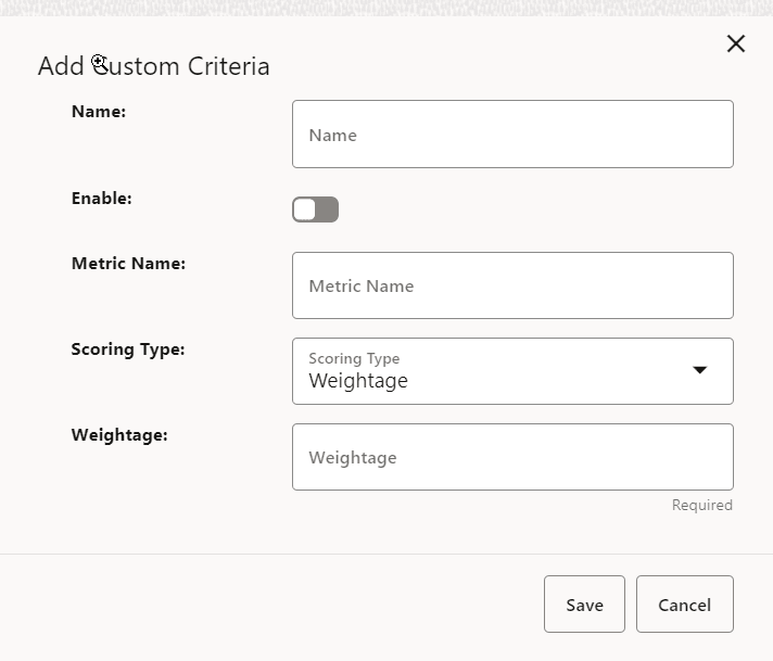

To update or modify the configuration information related to Settings:
  1. Click Edit. The Edit Settings page appears.

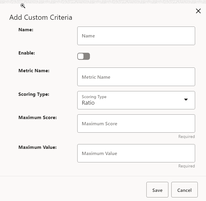

  2. To add the Custom Criteria, click Add.
    1. The Add Custom Criteria dialog box appears.
      Add Custom Criteria
      Add Custom Criteria
    2. Note:
      If the scoring type is selected as weightage then maximum score and minimum score fields are disabled.
      Fill in the required details and click Save to add the custom criteria.
    3. Click Cancel to exit the Add Custom Criteria dialog box.
  3. Update the configuration details as required in the settings page and click Save. A confirmation message, "Save successfully." appears.
  4. If you do not want to modify any configuration, click Cancel.
  5. Click Refresh to reload the Settings page.

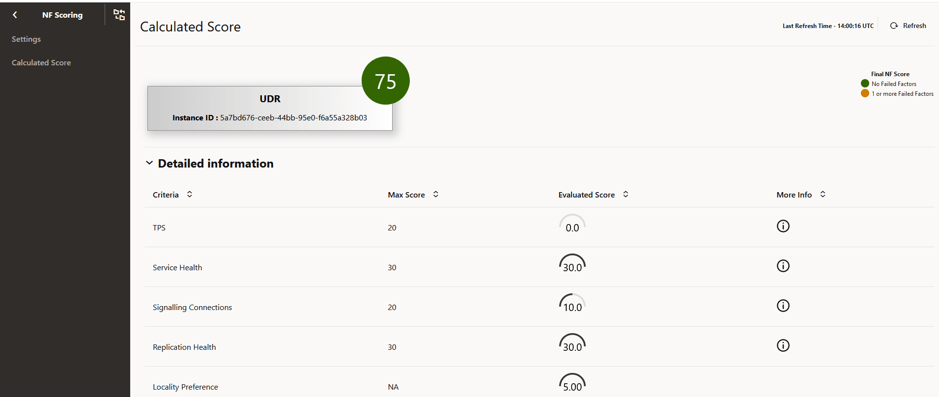

Calculated Score:
From the NF Scoring menu, select Calculated Score. If the NF Scoring feature is enabled. The Calculated Score page appears as below:
Figure 3-37 Calculated Score
Calculated Score
If app-info pod is down, you will not be getting the NF Score. You will get an error message that "Data can't be fetched due to internal server error".
Calculated Score shows the total score along with the Instance ID. The total score is shown in either Green or Orange color. If the NF Score is shown in green color then there are no failed factors. And, if the NF Score is shown in Orange color there are one or more failed factors.
You can click on Detailed information to view different criteria and their Max Score, Evaluated Score, and More Info. The criteria in the detailed information tab show the evaluated score. The failed factors are shown with a warning symbol under the evaluated score. On the top-right of the screen, the Last Refresh Time information is available and a Refresh button is given to refresh the NF Score of a site.
