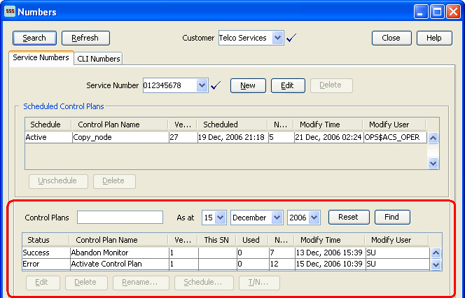

The Control Plans frame of the ACS Numbers screen enables you to perform the following control plan functions for a service number or CLI number.
Control Plans
Edit an existing control plan by launching the CPE
Rename an existing control plan
Schedule a control plan
Edit termination numbers for a control plan that contains only one termination node
Delete an existing control plan

In the Control Plans frame on the Numbers screen perform one of the following actions:
Select an existing control plan from the table
Enter the control plan name in the Control Plans field and click Find
Notes:
The As atdate fields are available to aid you in your search for the 'most recent' version(s) of a control plan.
Click Reset to restore the date default and clear your search results from the Control Plans field.
Press Enter to restore the full control plan list in the table, after performing a search which displays only a selection of control plans.
Description of the illustration acsacsnumberscontrolplanshighlevel_2-4-2.jpgTip: When you select a control plan, the control plan's template is also highlighted in the Templates table below.
The following functions are now available to you on the Control Plans frame of the screen, as shown on the example screen above:
Edit – See Editing a Control Plan.
Delete – See Deleting a Control Plan.
Rename – See Renaming a Control Plan.
Schedule – See Scheduling a Control Plan.
T/N – See Editing Termination Numbers.
Tip: See Using Templates on the Numbers Screen for more ACS Numbers screen information.
To create a new control plan from this screen, you click New Control Plan in the Templates frame. See Creating a Control Plan.
