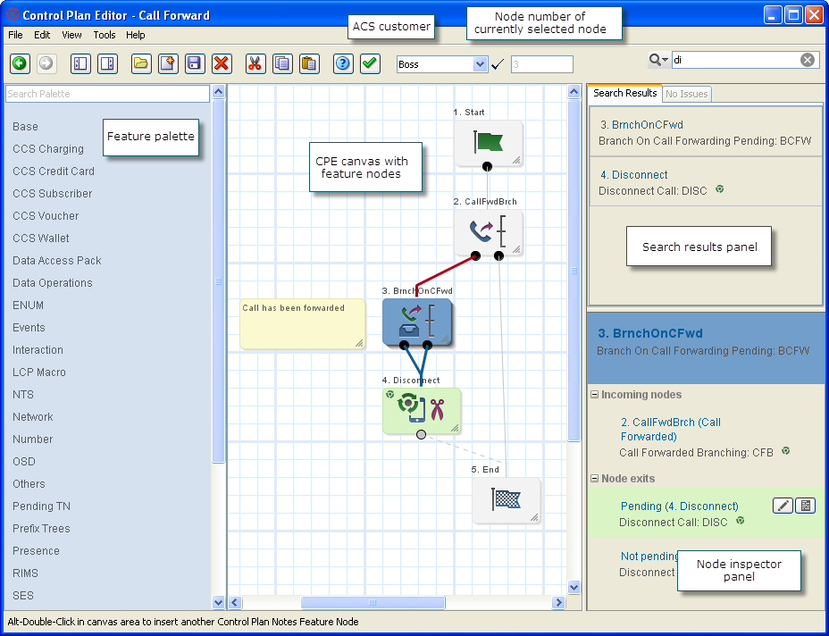

The following figure shows the Control Plan Editor (CPE) user interface (UI):
The following sections describe the main areas of the CPE UI.
ACS Customer List and Node Field
To the right of the toolbar buttons is the Customer list. This list is accessible to ACS administrators with privilege levels 6 or 7, and to all users who access ACS from the SMS UI. This list displays the user name at the top and the names of the other ACS customer accounts you have permission to access. Select another customer in the list and the feature palette will display the feature nodes that have been set up for that customer.
Note: The CPE closes the control plan currently displayed in the canvas when you select another customer.
The Node field displays the number of the feature node that is currently selected in the control plan canvas. Each feature node is assigned a sequential number when you add it to the canvas. This number is useful for searching and troubleshooting. To select a different feature node in the canvas, type the number or name of the feature node in the Node field and click Enter.
When saving a control plan, a report is generated that highlights any errors in the control plan and specifies the number of the feature node in which the error occurred.
Note: The feature node number may not necessarily indicate how many feature nodes have been used in the control plan. When you delete a feature node from a control plan, that node's number is not reassigned. However, if you delete the feature node with the highest node number, that number will be reassigned to the next feature node that you add.
Feature Palette
On the left of the UI is the feature palette, which contains the names of feature groups. A feature group is a set of feature nodes that are related to a common function.
To display the feature palette if it is not visible, or to hide the feature
palette from view, click the Palette button on the toolbar: ![]()
Note: If you open an existing control plan as read-only, the feature palette is not displayed.
Float your cursor over the feature group name to display the feature nodes in the group. You can filter which feature nodes are displayed by using the Search Palette box at the top of the feature palette panel. See Finding Feature Nodes in the Feature Palette.
You can display a short description of a feature node in the feature group by floating your cursor over the feature node. The description appears at the bottom of the feature group.
Note: The feature groups and feature nodes you see in the CPE are those that the CPE system administrator has previously set up for you. If you do not see a feature node or feature group that supplies the functionality that you need, contact your CPE system administrator.
Canvas
In the center is the CPE canvas where you build your control plans. You drag feature nodes from the feature groups to the control plan canvas. All control plans begin with a Start feature node. Each path in a control plan must end with an End feature node.
To add feature nodes to a control plan and connect them, see Working with Feature Nodes.
Search Results
The search results lists the feature nodes found in the canvas when you perform a search. You enter the search criteria in the search field above the search results panel. See Searching for Feature Nodes in the CPE Canvas for more information about searching for feature nodes.
Tips:
- To locate a feature node on the canvas that is listed in the search results, pass the mouse pointer over the feature node name in the search results panel. The CPE highlights the feature node in green in the search results panel and in your control plan on the canvas.
- Select a feature node in the search results tab to select it in the canvas and display information about the feature node's connections in the node inspector panel.
Search Results Panel
On the right of the UI is the search results panel. It contains the following tabs:
- Search Results
- Issues
To display or hide the search results panel, click the Inspector button on
the toolbar:
. Note: This also updates the CPE view preferences for your user. For
more information, see About Setting and Resetting View Preferences.

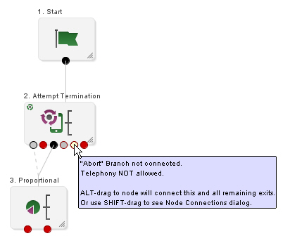

- The feature node has no incoming connections.
- The feature node has one or more unconnected exits.

Node Inspector
Below the search results panel is the node inspector panel. When you select a feature node or a connector line in the canvas, the node inspector displays the following information about the selected feature node or the feature nodes connected to the connector line:
- The feature node number and name; for example, 5. Set WalType for the Set Wallet Type feature node.
- Node type and node fast key; for example, Set Wallet Type: swt,
where Set Wallet Type is the feature node type and swtis the feature
node fast key.
Fast keys are abbreviations for the feature nodes that you can use as search criteria when tracing control plans in the canvas. For more information about control plan tracing, see Troubleshooting Control Plans Using Control Plan Tracing.
- Any comments configured for the listed feature nodes. For more information about adding feature node comments, see Adding Feature Node Comments.
- A list of incoming nodes and the names of their exit branches. Incoming nodes are the feature nodes connected to the selected node and that come just before the selected feature node in the control plan.
- A list of node exits. Node exits are the selected feature node's exit branches that lead to other feature nodes in the control plan. If an exit is connected to a feature node, that feature node is listed in the node inspector. If an exit is not connected to another feature node, the node exit in the node inspector will be red.
Tips:
To browse the feature node selection history and display information in the node inspector about a previously selected node, click the arrow keys on the toolbar.
- To locate a feature node on the canvas that is listed in the node inspector, pass the mouse pointer over the feature node name in the node inspector. The CPE highlights the feature node in green in the node inspector panel and in your control plan on the canvas.
- To display information about a connected feature node, select the feature node in the node inspector. The CPE also selects and centers the feature node in the canvas.
To display or hide the inspector panel, click the Inspector button on the toolbar:
Note: This also updates the CPE view preferences for your user. For more information, see About Setting and Resetting View Preferences.

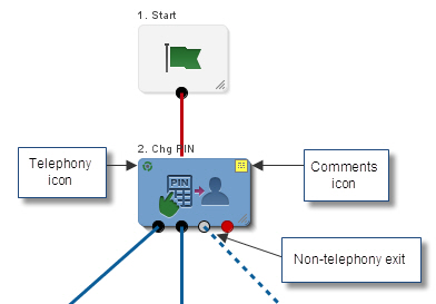

About Viewing Feature Node Properties
The feature node icons on the CPE canvas display the following properties by default:
The feature node title above each feature node. By default the title includes the feature node number and node name.
A representative icon image for the feature node.
The connector lines that connect feature nodes. Connector lines are solid if telephony is active for that branch or dotted if telephony is not active. When the feature node is selected:
Red lines indicate input paths.
Blue lines indicate exit paths.
The telephony icon on feature nodes that use telephony capabilities.
For feature nodes that contain comments, a yellow comment box at the top right corner of the feature node.
The feature node exits. Each feature node exit has a name. Feature node exits are:
Solid if telephony is allowed
Hollow if telephony is not allowed
Colored red if the exit is unconnected
Except for feature node exits, you can specify which of these properties is displayed. See Modifying Viewable Properties for Feature Nodes.
This figure shows the viewable properties for the Change Pin feature node.

Viewing Node Exit Bubble Help
The feature nodes in the CPE canvas incorporate bubble help boxes for each feature node exit. Exits are the dots at the bottom of the feature node icons. The bubble help includes information about the exit branch.
To specify whether to display exit bubble help, select or deselect the Display Node Exit Info option from the Tools menu.
To view exit bubble help, pass the mouse pointer over an exit. Information about the exit connection appears. The text in quotes is the name of the exit. If the feature node has two or more unconnected exits, then the bubble help includes help about connecting all the exits for the feature node.

Connecting Feature Nodes
You connect two feature nodes by dragging a line from an exit on the source feature node to the target feature node.
You can also:
Simultaneously connect all unconnected exits
Select the exits to connect
Simultaneously Connecting All Unconnected Exits
To simultaneously connect all the unconnected exits in the source feature node to a target feature node, press the Alt key while clicking on an unconnected exit and dragging a line to the target feature node.
Note: If the target feature node uses telephony, only those exits from the source feature node that allow telephony will be connected to the target feature node.
Selecting the Exits to Connect
To select multiple exits in the source feature node and connect them to a target feature node:
Press the Shift key and click and drag a line from an unconnected exit in the source feature node to the target feature node.
The Manage Node Exits dialog box appears.
Select one of the following options to enable the feature node exit check boxes:
Unfilled exits only to enable the check boxes for all remaining feature node exits.
Any valid exit to enable the check boxes for all valid feature node exits.
Tip: Invalid connections are connections from a non-telephony exit to a telephony node.
Do one of the following:
To quickly connect the enabled exits to the target feature node, click one of the following buttons in the Mass connect section:
All to connect all the available exits
Telephony to connect exits that support telephony
Non-Telephony to connect exits that do not support telephony
To connect only some of the enabled exits to the target feature node, check the boxes for the exits you want to connect in the Connect these exits section.
Click Done.
You can search the CPE canvas for feature nodes that are unconfigured or for feature nodes that match you search criteria. An unconfigured feature node is a feature node that meets any of the following conditions:
It has no incoming connections
It has one or more exit ports that are not connected to another feature node
It contains invalid configuration data
It has not been saved (the feature node is red)
Note: Unconfigured feature nodes are automatically listed in the Issues tab.
Tip: To locate a feature node on the canvas that is listed in the search results, pass the mouse pointer over the feature node name in the search results. The CPE highlights the node in green in the search results and in your control plan on the canvas.
Searching for Unconfigured Feature Nodes
To search for feature nodes that are unconfigured, select Unconfigured Nodes from the list next to the Search Canvas field. The CPE displays a list of the unconfigured nodes in the search results panel.
Tip: The CPE automatically updates the search results by removing nodes from the list as you configure them.
Searching for Feature Nodes Based on Search Criteria
The CPE searches on all feature node properties by default.
To search for feature nodes in the CPE canvas that match your search criteria:
(Optional) From the list next to the Search Canvas field, select one of the following options:
A feature node property, such as Name or Type, to search for feature nodes with that specific property.
Parameters to search for feature nodes that have certain configuration parameters.
Geo Routing to search for feature nodes that route a specified number or number prefix through a non-default exit branch of the Geographical Routing feature node.
Note: You configure the default exit branch when you configure the Geographical Routing feature node.
In the Search Canvas field, enter the search criteria. To search:
Feature node properties, enter the property details.
Parameters, enter the parameter name.
Geo-routing, enter the geo-routing number prefix and press Enter.
The CPE lists the matching feature nodes in the search results panel.
Tips:
To clear your search criteria and the search results, click the
icon in the Search Canvas field.
Select a feature node in the search results panel to display information about the feature node in the node inspector panel.
