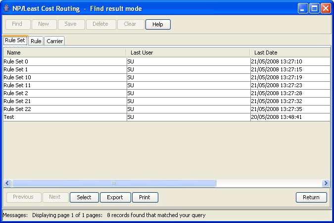

Finding a rule set
Follow these steps to search the database for a specific rule set.
Ensure you are in Find mode on the Rule Set tab.
Enter the selection criteria in one or more query fields and click Find.
If a field is left empty, the search retrieves all instances of that field.
Result: This triggers an Oracle Like% query that returns the first 100 records that begin with the selection criteria. For example, if you enter 123 in a query field, the system returns records such as 123, 1234, 12345.
The results appear in the table on the Find result mode screen for the type of record you are querying.
Note: The first 100 records entered in the database are displayed in no particular order. If you do not find the record you are searching for, conduct a more specific search.
Description of the illustration np-rulesetfindresult_2-5-0.jpg -
To view a record in Update mode, highlight the record line and click Select.
To delete a record, highlight the record line and click Delete.

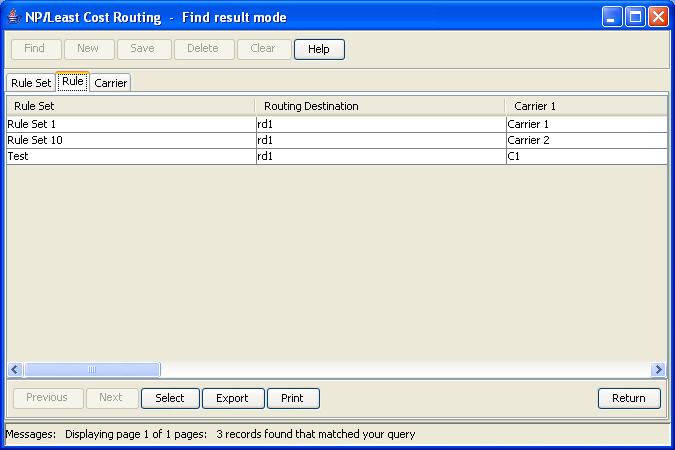

Rule
You use the Rule tab to specify the rules associated with each rule set. You can specify more than one rule per rule set. Each rule consists of:
Rule set itself
List of carriers and the order in which they should be tried
Routing destination

Finding a rule
Follow these steps to search the database for a specific rule.
Ensure you are in Find mode on the Rule tab.
If a field is left empty, then the search will retrieve all instances of that field.
Result: This triggers an Oracle Like% query that returns the first 100 records that begin with the selection criteria. For example, if you enter 123 in a query field, the system will return records such as 123, 1234, 12345, ...
The results appear in the table on the Rule tab in Find result mode.
Note: These are the first 100 records entered in the database, and they display in no particular order. If you do not find the record you are searching for, you need to conduct a more specific search.

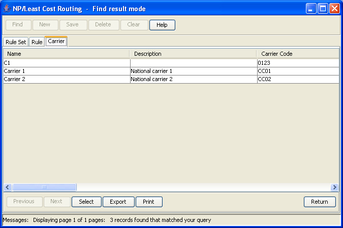

Finding a carrier
Follow these steps to search the database for a specific carrier.
Ensure you are on the Carrier tab in Find mode.
The results appear in the table on Carrier tab in Find result mode.
Description of the illustration np-carrierfindresult_2-5-0.jpg -
