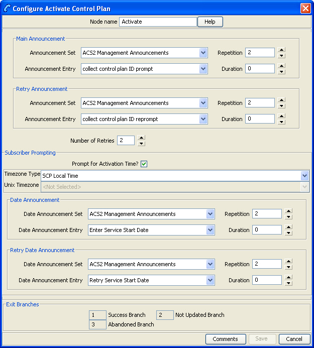

Configuring the node – Activate Control Plan
Follow these steps to configure the Activate Control Plan node.
From the Main Announcement area, select the Announcement Set which contains the main announcement you want to play to the caller. The main announcement will be played to prompt for a Control Plan ID (MF identifier).
Result: The Announcement Entry field becomes available.
From the Announcement Entry drop-down list, select the main announcement you want to play to the caller.
Set the Repetition field to the number of times to repeat the main announcement while the system waits for the caller to take an action. If set to zero, the announcement will be repeated for the length of the duration set.
Set the Duration field to the length of time, in seconds, that the announcement is to be played. If set to zero, the announcement will be played for its full length.
The retry announcement contains the announcement you want to play to the caller if an invalid ID is entered after the main announcement.
In the Retry Announcement area, select one of the following as described in steps 1 - 4:-
Announcement Set which contains the retry announcement
Announcement Entry for the retry announcement you want to play, and set the
Repetition to the number of times to repeat the retry announcement
Duration to the length of time, in seconds, that the retry announcement is to be played
Set the Number of Retries field to the number of times that the node will attempt to collect the correct ID from the caller, before routing the call to the Not Updated branch. This value may be between 0 and 10.
If you:
want to prompt the caller to set an activation date, tick the Prompt for Activation Time? check box.
do not want to prompt the caller to set an activation date, go to step 11.
From the Timezone Type drop-down list, select the timezone you want to use.
If you select the Explicit Unix TZ option, you need to select a specific region from the Unix Timezone field.
For more Time zone information, see Time Zones.
The Date Announcement area contains the announcement you want to play to the caller. Select one of the following as described in steps 1 - 4:
Date Announcement Set which contains the main announcement
Date Announcement Entry for the main announcement you want to play, and set the
Repetition to the number of times to repeat the announcement
Duration to the length of time, in seconds, that the announcement is to be played.
The Retry Date Announcement area contains the announcement you want to be repeat while the system waits for the caller to take an action. Select one of the following as described in steps 1 - 4:
Date Announcement Set which contains the retry announcement
Date Announcement Entry for the retry announcement you want to play, and set the
Click Save.
Note: Save is not available until all the required information has been selected or entered.
Note: The announcement set and announcement entry lists are populated with data that is specified using the Announcements tab of the ACS Configuration screen.
For more information about configuring announcement sets and announcement entries, see the Announcements tab of the ACS Configuration screen.

Here is an example of a Configure Activate Control Plan screen in ACS management control plan that does this. See the ACS Management Control Plan example in ACS User's Guide to see the entire control plan.
In this example, the caller is prompted to enter the:
Control Plan ID (MF Identifier) and the
Date to activate the Control Plan.

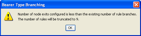

Notes:
After configuration, you may add or remove exits for the node using Edit Node Exits, then edit the node branches again.
If you remove exits, when you open the Configure Branch on Bearer screen again you will see a warning, such as this example.
Click OK to continue, then edit the node.

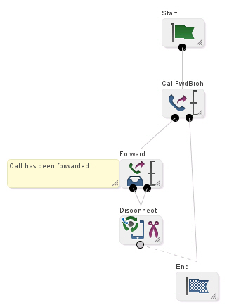

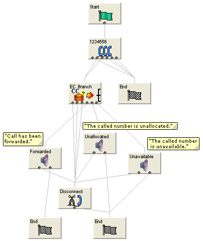

Example of the use of the Branch on Event Report Request BCSM Code node
For a terminating call, suppose you want to select the following outcomes, depending on the values of cause numbers.
If ACS was notified of call-forwarding, you want to play an announcement about call-forwarding.
For cause number 1, you want to play an announcement about the telephone number being unallocated.
For cause numbers 17 through 20, you want to play an announcement about the telephone number being either busy, unresponsive, unanswered or unanswerable because the telephone is switched off.
For all other cause numbers, you want to simply disconnect the call.
To implement this scenario, you could set up the control plan shown below.
Description of the illustration cpecontrolplaneditorexamplecontrolplanerrbrouting_2-4-2.jpg
You would set up the configurable exits of the branch on ERRB Cause Code node as shown below.
The non-configurable exit branches would remain as shown below.
Description of the illustration cpeconfigurebranchonerrbcausecodecropexits1-4_2-4-2.jpg

Example of the use of the Call Forwarded Branching node
For a terminating call, you may want to play an announcement if the call has been call-forwarded and simply terminate the call if it has not been call-forwarded.
Description of the illustration cpecontrolplaneditorexamplecallforwardcp_5-0-0.jpg

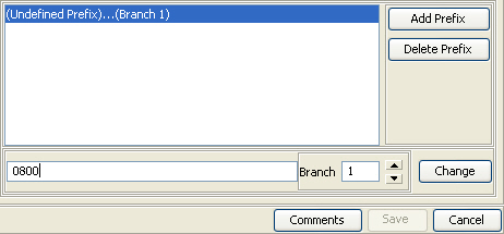

Configuring the node – Calling Party
Follow these steps to configure the node.
Edit the node exits to add up to another eighteen exits as required. See Editing node exits for details.
Click Add Prefix.
Result: A highlighted entry appears in the display grid. This creates the new Prefix entry, and is edited in the following steps.
Type the prefix in the entry field to the left of the Branch box.
Calls made from numbers with this prefix are routed to the exit specified in this step.
Use the Branch box to select the exit these calls should be routed to.
Click Change.
Result: The Prefix appears in the display grid, with the exit displayed in brackets.
Repeat Steps 1 – 4 for as many prefix additions as required.
Set the default branch for all calls which do not match a specified prefix.
Click Save.

Control Plan Notes
Allows you to place notes on the CPE canvas. The note box can be expanded or contracted by clicking and dragging the resizing handle in the bottom right hand corner of the feature node.
Note: There is no feature node icon for this, just a yellow box for entering notes.
Control plan notes are simply notes you can place anywhere on the canvas to add understanding to the control plan, including behind feature node icons to add comments to a group of feature nodes. They add no functionality to the control plan.
Once a note has been placed on the canvas, it may be moved around, duplicated, or deleted as required. Control plan notes will 'stick' where they are placed when the control plan is saved and reloaded.
Node exits – Control Plan Notes
This node has no entries or exits, as it is not connected to other nodes within a control plan.
Editing Control Plan Notes
Follow these steps to add a note to a control plan.
Drag the node on to the canvas and drop into place.
The Control Plan Notes feature node icon appears in the canvas.
Double click the Control Plan Notes feature node icon.
The Edit Comments window displays.
Click inside the editable area and type the text that is to appear in the control plan note.
Note: All text appears in the note exactly as it is entered. To ensure that text does not appear in a long line, break it up with manual line breaks.
Click Ok.
The text appears in the note box.

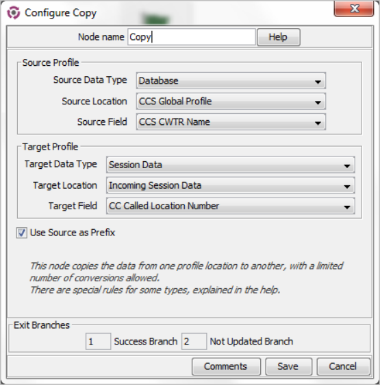

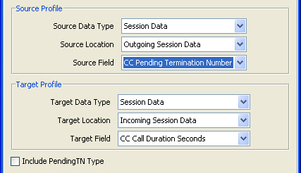

Copy
The Copy feature node allows you to copy data (for example - digits) from one profile field to another. You can always copy a profile field to another profile field of the same type. In addition, you can use the Copy feature node to convert between the following profile field types:
Boolean
Byte
Short
Integer
Unsigned Integer
Unsigned 64-bit Integer
String
Numeric String
Limited Numeric String
Bounded Integer
Price (from Integer or String)
The Copy feature node first converts the source field to a character string (except when it is already a string or a numeric string field) and then converts the character string to the target type, according to a set of predefined Profile Field Conversion Rules.
If the source profile field type is OPREFIX or LOPREFIX, then the Copy feature node copies the source field content directly into a corresponding prefix tree without any conversion.
Profile Field Conversion Rules – Copy
This table lists the types of conversions and the corresponding conversion rules used by the Copy feature node to convert profile field data to and from character strings.
| Type of Conversion | Conversion Rule |
| Boolean to character string |
Interprets the stored bytes as a signed four byte integer that is represented in base 10, and:
| Character string to boolean |
Converts the following values to true:
Converts all other values, including an empty string, and zero (0) to false. |
| Byte to character string | Converts bytes (assumed to be unsigned) to a value in the range of "0" to "255". |
| Short to character string | Converts shorts (assumed to be unsigned) to a value in the range of "0" to "65535". |
| Integer to character string |
Converts integers (represented in base 10) to a value in the range of "-9223372036854775808" to "9223372036854775807". Note: Integers are either four bytes or eight bytes long. |
| Unsigned 64-bit integer to character string | Converts unsigned integers (represented in base 10) to a value in the range of "0" to "18446744073709551615". |
Character string to one of:
Converts the string to the required number type. If the character string starts with "0x", then the Copy feature node discards the "0x" and interprets the string as a base 16 number. Otherwise the Copy feature node interprets the string as a base 10 number. |
| Unsigned integer to character string | Converts unsigned integers (represented in base 10) to a value in the range of "0" to "4294967295". |
String, limited numeric string, or numeric string to character string. Character string to string, limited numeric string, or numeric string. |
No conversion needed. The Copy feature node copies these types of profile fields to another profile field of the same type. |
| Bounded integer to character string | The Copy feature node cannot copy a bounded integer to a character string. |
| Character string to bounded integer |
Converts the character string to a four byte integer and puts it in bytes 9, 10, 11 and 12 of the bounded integer. Note: Bytes one to four hold the lower bound, and bytes five to eight hold the upper bound. To successfully copy an integer to a bounded integer, the source integer must be between the two bounds. |

Include Pending TN Type (Copy)
The Include PendingTN Type check box appears when the Source
Field selection is CC Pending Termination Number, as shown in
this example of part of the screen.
Treat Target as Prefix (Copy)
The Use Source as Prefix check box appears when the Source Field and Target Field selections are of type string or number string, as shown in this example of part of the screen.
Use Stored Sub-Tag (Copy)
The Use Stored Sub-Tag check box appears when the Target Field selection contains sub-tags (for example, the Speed Dial Block contains the sub-tag list of speed dial numbers. For more information, see Sub-tags), as shown in this example of part of the screen.
In this example, earlier in the control plan, the sub-tag (e.g. the speed dial number, let's say 50) has been specified using the Collect Digits to Sub-tag node. The telephone number, e.g. 08001234567, to associate with it has then been stored in the CC Pending TN buffer using the Collect Digits to Pending TN node. Using the Copy node, that number is copied into the Speed Dial block, so that the speed dial number 50 is set to call 08001234567.
Configuring the node – Copy
Follow these steps to configure the Copy node.
From the drop down lists in the Source Profile area, select the source stored data location.
Notes: If you set a customer-specific profile, the profile set in this field must belong to the customer who will be running the Control Plan.
If the Control Plan is owned by the Boss user:
the profile must be set to Control Plan, or
a customer id must be specified at an earlier point in the Control Plan.
From the drop down lists in the Target Profile area, select the target that the data is to be copied to.
If the Include Pending TN Type check box is displayed, then either:
tick: the node will save the Pending TN to the profile with the Pending TN Type prefixed.
Clear: the node will save just the Pending TN to the profile.
If the Use Source as Prefix check box is displayed, then either:
tick: the node will prefix the target value with the source value.
Clear: the node will copy the source value to the target value.
If the Use Stored Sub-Tag check box is displayed, select the required target field format from the Target sub-tag Storage Format drop down list. The node will save the sub-tag value with the required format in the target field.
Click Save.

Click Add Prefix.
Result: You see an undefined prefix displayed in the list box to the left of the button.
Enter the prefix into the field to the left of the Branch field, as shown below.
Description of the illustration cpeconfigurediallednumbernodeprefixfield_2-4-2.jpgTo determine the routing, prefixes (or the entire number) must be entered into the node data. The routing will be based on the best match between the dialed number and the prefixes that are in the node data. The dialed number list takes up to 1500 characters in total, which limits the number of entries in the list. It is recommended that a maximum of 50 entries be made in the list.

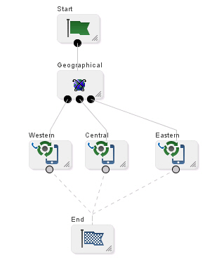

Example control plan – Geographical Routing
Here is an example control plan containing a Geographical Routing feature node.
This control plan will route calls to different service centers based on where the call originates from (for example, routes to the nearest Pizza shop).
This control plan is triggered when the caller dials a certain termination number (for example 0800 PIZZA).
Description of the illustration cpecontrolplaneditorexamplegeoroutecp_5-0-0.jpg

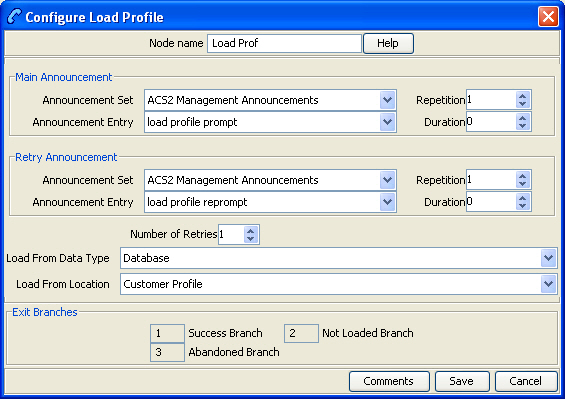

Load Profile
This node will load the specified profile.
This allows you to read the profile in the database and makes it available to be updated by other nodes that can write back to the profile.
Node exits – Load Profile
This node has one entry and three exits. The number of exits cannot be changed.
| Exit | Cause | Description |
| 1 | Success Branch | The profile was loaded successfully. |
| 2 | Not Loaded Branch | The profile was not loaded. |
| 3 | Abandoned Branch | The caller abandoned the call. |
Configuring the node – Load Profile
Follow these steps to configure the Load Profile node.
From the Main Announcement area, select the Announcement Set that contains the main announcement you want to play to the caller.
Result: The Announcement Entry drop-down box will become available.
For more information about configuring announcement sets and announcement entries, see Announcements.
Set the Duration field to the length of time in seconds that the announcement is to be played. If set to zero, the announcement will be played for its full length.
The retry announcement contains the announcement you want to play to the caller if the number of digits collected is not within the range specified.
Duration to the length of time, in seconds, that the retry announcement is to be played.
In the Number of Retries field, set the number of times that the node will attempt to collect data from the caller, before routing the call to the Not Updated branch. This value may be between 0 and 10.
Using the drop down lists in the Load From Data Type and Load From Location fields, select the Profile block from which information is to be loaded onto the node.
Note: This lists only the profiles that can be updated. For more information about profile blocks, see Profile Blocks and Tags.
Click Save.
Note: The list of data types is fixed at installation time for each feature node or screen.
Further reference:
For information about profile blocks (data type, location, and field) and how to use them, see Profile Blocks and Tags.
The primary tag lists are configured in the SMS > Services > ACS Service > Configuration > Profile Tag Details and Profile Tag Mapping tabs (see ACS User's Guide, Profile Tag Details for more information).
Example use of Load Profile node
Here is an example of using the Load Profile node to load the customer profile, in order to access the dial-up self management options.
For detailed information on the ACS Management control plan, see the chapter - Dial-up Control Plan Management in ACS.
A customer is set up with an 0800 number and the self management screens.
The customer phones a number attached to the ACS management control plan.
Here is an example of a Configure Load Profile screen in ACS Management control plan that prompts the caller for a Customer Profile. See the ACS Management Control Plan example in ACS User's Guide to see the entire control plan.
Description of the illustration cpeconfigureloadprofile-customerprofile_2-4-3.jpg
In this example, the caller is prompted to enter their management ID.

From the drop down lists in the Presence Entity panel, select the Data Type, Location and Field where the presence entity name or number is held.
Note: The selected Field must be of type STRING.
If required, set the Domain Name field to the name of the domain to append to the presence entity name or number.
Note: The domain will not be appended to the presence entity if it is already present in the Field selected in the Presence Entity panel.
