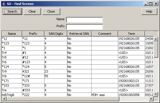

Trigger Prefix
The Trigger Prefix configuration tab allows you to name Trigger Prefixes and set up the length of the SAN digit.
As part of the installation of USSD GW, a Trigger Prefix is created that represents “all triggers”. It is used for the barring function. This entry has a trigger prefix of “##########”.
Fields - Trigger Prefix tab
Here is a description of the fields.
| Field | Description |
| Name |
Unique name of this Trigger Prefix. Required. Allowed values: Alphanumeric string up to 30 characters in length. |
| Prefix |
The Prefix that prefixes the IMSI that can trigger a particular service interface. This prefix is used in the Service Configuration screen. Required. Allowed values: Alphanumeric string up to 10 characters in length. |
| SAN Digits |
The number of digits that should be sent to the Service Interface as the Service Access Number for this session. Optional. Allowed values: 0 to 99. |
| Cdr Flag |
Selecting this check box will enable EDR generation for this Trigger Prefix. Note: The global CDR Flag on the Gateway Configuration tab must also be checked before the USSD GW application on the SLC can begin to generate EDRs. |
| Performance Report Period |
The interval (in seconds) after which the USSD GW application on the SLC will generate performance reports. Allowed values: An integer value that is a factor of 60 or 3600. Note: A value of zero means that no performance reports will be generated. |
| Comment | This field is used to add any comments required for this Trigger Prefix. |
| Last Change Data |
Shows the following details of when this record was last modified:
Note: For example text for each field, refer to the Find screen in this topic.
Data entry - Trigger Prefix tab
Follow the steps below to enter a new Trigger Prefix configuration.
Click Clear to clear the screen of previous data.
Enter new data and click Save.
Buttons and other fields
For information about the buttons and fields at the bottom of the screen, see Common Buttons and Fields.
Clicking Find displays the Find screen.
Find Screen - Trigger Prefix tab
Here is an example Find Screen for the Trigger Prefix tab.
Related topic
Using the find screen - Trigger Prefix tab
You can search on:
Name
Prefix
For more information about searching and editing records, see Using the Find Screens.

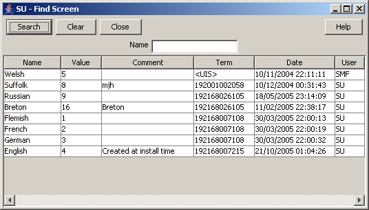

Language
The Language configuration tab allows you to set up languages and give them specific values. The language value needs to correspond to the language values in the portal.
Fields - Language
| Name | The language, such as English or French. Alphanumeric field up to 20 characters in length. This field is mandatory. |
| Value | A unique value that is viewed externally and sent to the gateway interface. Numeric field, valid values 0 – 19. This field is mandatory. |
| Date Format |
The format for date variables when put into a message. This field is mandatory. Valid format tokens are shown below. You can separate tokens with spaces, commas, dashes, slashes, or backslashes.
For example, to specify a date format like 04 September 2015, set Date Format to %d %B %Y, or to specify a date format like 04-09-15, set Date Format to %d-%m-%y. |
Notes:
If ACS is being used as a service interface, the language ID fields must match the SRF ID in the ACS configuration. This means that if the SRF ID of 1 corresponds to English in the ACS configuration, the language entry on this tab must match.
For example:
ACS configuration
English, MSG=2, SRF=1
USSD configuration
Name: English Value: 1 Date Format=%d %B %Y
Data entry - Language
Follow these steps to enter a new Language configuration.
Find Screen - Language tab
Here is an example Find Screen for the Language tab.
Related topic
Using the find screen - Language tab
You can search on:
Name

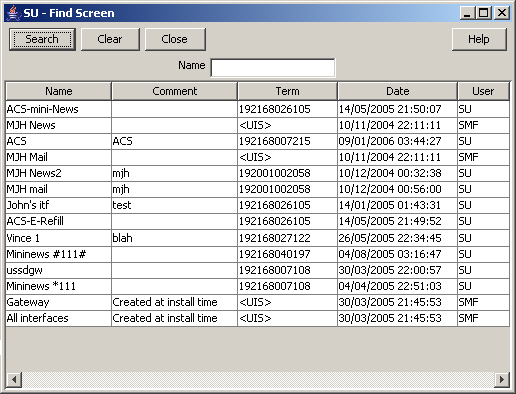

Service Interface
The Service IF tab allows you to name the different service interfaces.
Service interfaces can define their own set of menus and status displays using the same menu ids or status cause values as other service interfaces. For example: menu id 1 could result in the display “enter birthday” when sent by service interface 1 and could result in the display “password?” when sent by service interface 2.
You can partition your menus to a finer resolution (for example: “ACS-mini-News”, “ACS-Weather” and so on). These are entered in the Service Interface tab. You must also configure an associated trigger prefix to uniquely identify the service (not just a service group) and both these entries must be referenced in the Service Triggers.
Two Service Interfaces are configured when USSD GW is installed:
Gateway - used by the gateway to retrieve displays for error or/and service ending conditions that are generated within the gateway itself and not a service interface
All interfaces - enables service interfaces to share their menus
Fields - Service IF tab
| Name |
Unique name for this Service Interface. Required. Allowed values: Alphanumeric string, up to 20 characters in length. |
Data entry - Service IF tab
Follow these steps to enter a new Service Interface configuration.
Find Screen - Service IF tab
Here is an example Find Screen for the Service IF tab.
Related topic
Using the find screen - Service IF tab
You can search on:
Name

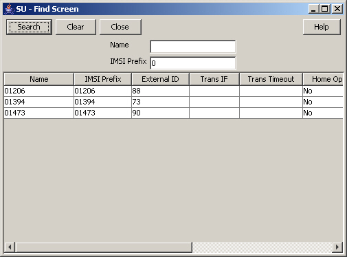

Operator
The Operator tab allows you to set up different operators against different IMSI prefixes and using different IMSI to MSISDN mapping interfaces.
Fields - Operator tab
| Name |
Unique name of the operator. Required. Allowed values: Alphanumeric string, up to 20 characters in length. |
| IMSI Prefix |
Unique IMSI Prefix. Must be 5 digits.
| External ID |
Unique External ID. Required. If a service is located on an external system this ID is used when internal TCAP messages are sent to the external system. |
| Trans IF |
The SLEE ID of the interface which does the IMSI-MSISDN translation. Optional. For information about SLEE IDs, see SLEE Technical Guide. |
| Trans Timeout |
Milliseconds ussdgw process will wait for a response to the IMSI to MSISDN translation request. Required if a Trans IF value is provided. Allowed values: 0 – 99 |
| Home Op | If ticked, this operator is the home operator. |
Data entry - Operator tab
Follow these steps to enter a new Operator configuration.
Find Screen - Operator tab
Here is an example Find Screen for the Operator tab.
Related topic
Using the find screen - Operator tab
You can search on:
Name
IMSI Prefix
