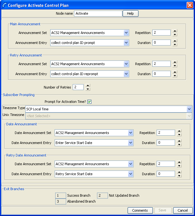

Configuring the node – Activate Control Plan
Follow these steps to configure the Activate Control Plan node.
                           From the Main Announcement area, select the Announcement Set which contains the main announcement you want to play to the caller. The main announcement will be played to prompt for a Control Plan ID (MF identifier). Result: The Announcement Entry field becomes available.
                           From the Announcement Entry drop-down list, select the main announcement you want to play to the caller.
                           Set the Repetition field to the number of times to repeat the main announcement while the system waits for the caller to take an action. If set to zero, the announcement will be repeated for the length of the duration set.
                           Set the Duration field to the length of time, in seconds, that the announcement is to be played. If set to zero, the announcement will be played for its full length.
                           The retry announcement contains the announcement you want to play to the caller if an invalid ID is entered after the main announcement. In the Retry Announcement area, select one of the following as described in steps 1 - 4:-
                                    Announcement Set which contains the retry announcement
                                    Announcement Entry for the retry announcement you want to play, and set the
                                    Repetition to the number of times to repeat the retry announcement
                                    Duration to the length of time, in seconds, that the retry announcement is to be played
                           Set the Number of Retries field to the number of times that the node will attempt to collect the correct ID from the caller, before routing the call to the Not Updated branch. This value may be between 0 and 10.
                           If you: -
                                 want to prompt the caller to set an activation date, tick the Prompt for Activation Time? check box.
                                 do not want to prompt the caller to set an activation date, go to step 11.
                           From the Timezone Type drop-down list, select the timezone you want to use. If you select the Explicit Unix TZ option, you need to select a specific region from the Unix Timezone field. For more Time zone information, see Time Zones.
                           The Date Announcement area contains the announcement you want to play to the caller. Select one of the following as described in steps 1 - 4: -
                                 Date Announcement Set which contains the main announcement
                                 Date Announcement Entry for the main announcement you want to play, and set the
                                 Repetition to the number of times to repeat the announcement
                                 Duration to the length of time, in seconds, that the announcement is to be played.
                           The Retry Date Announcement area contains the announcement you want to be repeat while the system waits for the caller to take an action. Select one of the following as described in steps 1 - 4: -
                                 Date Announcement Set which contains the retry announcement
                                 Date Announcement Entry for the retry announcement you want to play, and set the
                           Click Save. Note: Save is not available until all the required information has been selected or entered.
Note: The announcement set and announcement entry lists are populated with data that is specified using the Announcements tab of the ACS Configuration screen.
For more information about configuring announcement sets and announcement entries, see the Announcements tab of the ACS Configuration screen.

Here is an example of a Configure Activate Control Plan screen in ACS management control plan that does this. See the ACS Management Control Plan example in ACS User's Guide to see the entire control plan.
In this example, the caller is prompted to enter the:
                           Control Plan ID (MF Identifier) and the
                           Date to activate the Control Plan.

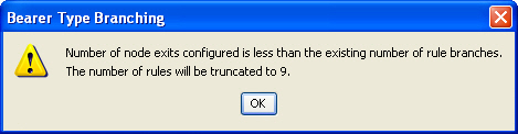

                           After configuration, you may add or remove exits for the node using Edit Node Exits, then edit the node branches again.
                           If you remove exits, when you open the Configure Branch on Bearer screen again you will see a warning, such as this example. Click OK to continue, then edit the node.

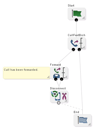

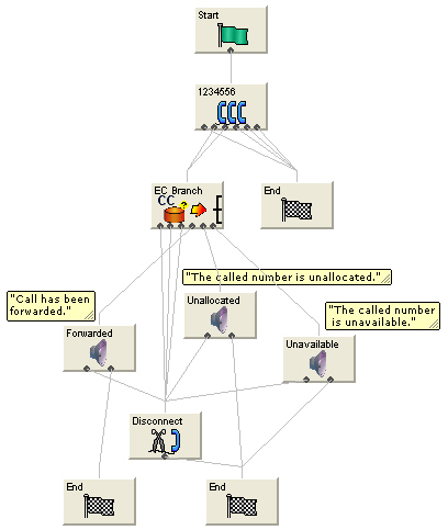

Example of the use of the Branch on Event Report Request BCSM Code node
For a terminating call, suppose you want to select the following outcomes, depending on the values of cause numbers.
                           If ACS was notified of call-forwarding, you want to play an announcement about call-forwarding.
                           For cause number 1, you want to play an announcement about the telephone number being unallocated.
                           For cause numbers 17 through 20, you want to play an announcement about the telephone number being either busy, unresponsive, unanswered or unanswerable because the telephone is switched off.
                           For all other cause numbers, you want to simply disconnect the call.
To implement this scenario, you could set up the control plan shown below.
Description of the illustration cpecontrolplaneditorexamplecontrolplanerrbrouting_2-4-2.jpg
You would set up the configurable exits of the branch on ERRB Cause Code node as shown below.
The non-configurable exit branches would remain as shown below.
Description of the illustration cpeconfigurebranchonerrbcausecodecropexits1-4_2-4-2.jpg

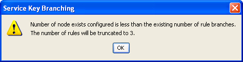

Note: You can configure additional exits for, or remove exits from the feature node, at any time. If you remove an exit then the next time you open the Configure Branch on Service Key window, a warning message displays:

Example of the use of the Call Forwarded Branching node
For a terminating call, you may want to play an announcement if the call has been call-forwarded and simply terminate the call if it has not been call-forwarded.
Description of the illustration cpecontrolplaneditorexamplecallforwardcp_5-0-0.jpg

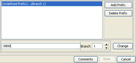

Configuring the node – Calling Party
Follow these steps to configure the node.
                           Edit the node exits to add up to another eighteen exits as required. See Editing node exits for details.
                           Click Add Prefix. Result: A highlighted entry appears in the display grid. This creates the new Prefix entry, and is edited in the following steps.
                           Type the prefix in the entry field to the left of the Branch box. Calls made from numbers with this prefix are routed to the exit specified in this step.
                           Use the Branch box to select the exit these calls should be routed to.
                           Click Change. Result: The Prefix appears in the display grid, with the exit displayed in brackets.
                           Repeat Steps 1 – 4 for as many prefix additions as required.
                           Set the default branch for all calls which do not match a specified prefix.

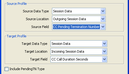

Include Pending TN Type (Copy)
The Include PendingTN Type check box appears when the Source
                Field selection is CC Pending Termination Number, as shown in
            this example of part of the screen.
Treat Target as Prefix (Copy)

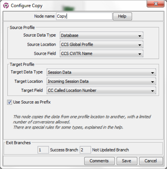

The Use Source as Prefix check box appears when the Source Field and Target Field selections are of type string or number string, as shown in this example of part of the screen.

Configuring the node – Copy
Follow these steps to configure the Copy node.
                           From the drop down lists in the Source Profile area, select the source stored data location. Notes: If you set a customer-specific profile, the profile set in this field must belong to the customer who will be running the Control Plan. If the Control Plan is owned by the Boss user: -
                                 the profile must be set to Control Plan, or
                                 a customer id must be specified at an earlier point in the Control Plan.
                           From the drop down lists in the Target Profile area, select the target that the data is to be copied to.
                           If the Include Pending TN Type check box is displayed, then either: -
                                 tick: the node will save the Pending TN to the profile with the Pending TN Type prefixed.
                                 Clear: the node will save just the Pending TN to the profile.
                           If the Use Source as Prefix check box is displayed, then either: -
                                 tick: the node will prefix the target value with the source value.
                                 Clear: the node will copy the source value to the target value.

Follow these steps to add a prefix to the node data, using the Configure Dialled Number screen.
                           Edit the node exits to add up to another eighteen exits as required to accommodate the numbers you are planning to configure. See Editing node exits for details.
                           Click Add Prefix. Result: You see an undefined prefix displayed in the list box to the left of the button.
                           Enter the prefix into the field to the left of the Branch field, as shown below.
 Description of the illustration cpeconfigurediallednumbernodeprefixfield_2-4-2.jpgTo determine the routing, prefixes (or the entire number) must be entered into the node data. The routing will be based on the best match between the dialed number and the prefixes that are in the node data. The dialed number list takes up to 1500 characters in total, which limits the number of entries in the list. It is recommended that a maximum of 50 entries be made in the list. Example: If 0800447732 is dialed and the prefixes entered into the node data are 0800, 0900, 0800447 and 080044, the call will be routed down the branch associated with 0800447 because this is the best match found for the number dialed.
                           In the Branch field, select the branch down which calls whose dialed number best matches this prefix are to route. When the entry is correct, click Change.
                           Repeat steps 1-4 until you have specified the dialed number ranges required.
                           From the Default box, select the branch that dialed numbers that do not match any prefix entered into the node will route down.
                           Click Save.

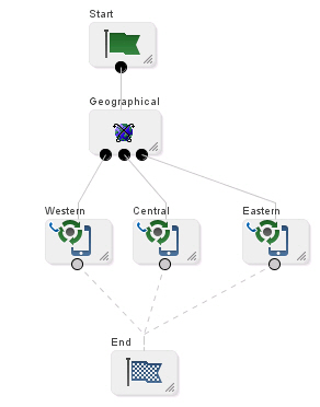

Geographical Routing
This node allows a control plan to branch based on the geographic location of the calling party. This node may be used to offer different service to calls from certain locations. For example, routing to a local office.
A control plan may contain as many Geographic Routing nodes as required.
Shortcut keys – Geographical Routing
The shortcut keys to add a Geographical Routing node are Alt+Shift+G.
Node exits – Geographical Routing
This node has one entry and may have two through 20 exits. Although this node accepts up to 20 exits, it is recommended that this number is restricted to a maximum of 10. You can configure the number of exits within this range as required, using the Edit Node Exits option on the shortcut menu. See Editing Feature Node Exits.
Geographic routing
A geography set is made up of multiple nested geography entries. Each entry is mapped to a unique prefix, and may also be connected to a (or several) region. A region is a group of geography entries. The entries contained in a single region may come from different branches and different nested levels, or may contain whole branches.
Routing may be based on either region or geography entry prefix. A geography entry may only appear once on a branch. That is, it may not appear on two branches.
The routing will be based on the best match between the calling party number (or other selected buffer) and the number prefix that has been set for the region in the Geography tab of the configuration screens.
Nested subtrees
If an entire nested subtree within a geography set is allocated to a branch then the root of the subtree should be allocated to the branch.
Example: If the number prefix entered for a region used in this node was 0447 and the number prefix for another region used in this node was 04477, a caller from 044773384 will be routed down the branch associated with 04477 because this is the best match found for the calling party number.
Allocating individual prefixes vs allocating folders
It can be visually clearer to allocate every individual prefix to a branch in the All Geo Areas frame but this is not necessary. When allocating a folder to a branch all prefixes (and sub-folder prefixes) will route down that branch even though the Branch Geo Area (right side) does not list each prefix. However if any prefixes or sub-folders in the root folder are allocated to another branch then calls to those prefixes will route down the new branch instead. You will notice that the prefixes or sub-folders will not be highlighted in the All Geo Areas (left side) of the root folder when allocated to other branches.
Example:
The geography set has a folder called Eastern Province which contains 3 prefixes, 2 of which are in a sub-folder called Northern District.
If the Eastern Province folder is allocated to a branch then all matched prefixes will go down that branch (even though the Branch Geo Areas frame will only display the Eastern Province folder name).
If the sub-folder, Northern District, is now allocated to another branch then all calls that best match the prefixes in this sub-folder will go down the new branch.
While the third prefix, Southern District (Prefix 12), will still go down the branch allocated to the root folder Eastern Province.
The Northern District folder will not be highlighted in the All Geo Areas frame indicating it is allocated on another branch instead.
Add a geographic entry or Region to an exit branch – Geographical Routing

Example control plan – Geographical Routing
Here is an example control plan containing a Geographical Routing feature node.
This control plan will route calls to different service centers based on where the call originates from (for example, routes to the nearest Pizza shop).
This control plan is triggered when the caller dials a certain termination number (for example 0800 PIZZA).
Description of the illustration cpecontrolplaneditorexamplegeoroutecp_5-0-0.jpg

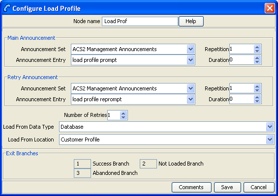

Configuring the node – Load Profile
Follow these steps to configure the Load Profile node.
                           From the Main Announcement area, select the Announcement Set that contains the main announcement you want to play to the caller. Result: The Announcement Entry drop-down box will become available.
                           From the Announcement Entry drop-down list, select the main announcement you want to play to the caller. Note: The announcement set and announcement entry lists are populated with data that is specified using the Announcements tab of the ACS Configuration screen. For more information about configuring announcement sets and announcement entries, see Announcements.
                           Set the Duration field to the length of time in seconds that the announcement is to be played. If set to zero, the announcement will be played for its full length.
                           The retry announcement contains the announcement you want to play to the caller if the number of digits collected is not within the range specified. In the Retry Announcement area, select one of the following as described in steps 1 - 4: -
                                 Duration to the length of time, in seconds, that the retry announcement is to be played.
                           In the Number of Retries field, set the number of times that the node will attempt to collect data from the caller, before routing the call to the Not Updated branch. This value may be between 0 and 10.
                           Using the drop down lists in the Load From Data Type and Load From Location fields, select the Profile block from which information is to be loaded onto the node. Note: This lists only the profiles that can be updated. For more information about profile blocks, see Profile Blocks and Tags.

Here is an example of using the Load Profile node to load the customer profile, in order to access the dial-up self management options.
For detailed information on the ACS Management control plan, see the chapter - Dial-up Control Plan Management in ACS.
                           A customer is set up with an 0800 number and the self management screens.
                           The customer phones a number attached to the ACS management control plan.
Here is an example of a Configure Load Profile screen in ACS Management control plan that prompts the caller for a Customer Profile. See the ACS Management Control Plan example in ACS User's Guide to see the entire control plan.
Description of the illustration cpeconfigureloadprofile-customerprofile_2-4-3.jpg
In this example, the caller is prompted to enter their management ID.

Prefix Branching
The Prefix Branching node allows you to compare the contents of an ACS number buffer against the specified profile field, and will branch according to whether the profile field content is a prefix of the ACS number buffer value.
Node exits – Prefix Branching
This node has one entry and two exits. The number of exits cannot be changed.
| Exit | Cause | Description |
| 1 | Matched | The specified profile field’s value was a prefix of the number buffer’s value. |
| 2 | Not Matched | The specified profile field’s value was not a prefix of the number buffer’s value. |
Editing the node – Prefix Branching
Follow these steps to edit the node configuration.
                           Using the drop down lists in the Number String area, select the source prefix tree.
                           Using the drop down lists in the Number Source area, select the ACS number buffer containing the number to compare with the prefix tree.
                           Click Save.
