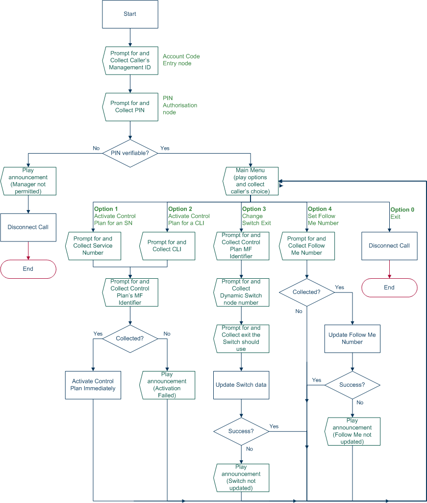

Dial-up Logic Flow Diagram
This diagram illustrates the flow of the dial-up feature of the ACS management control plan.

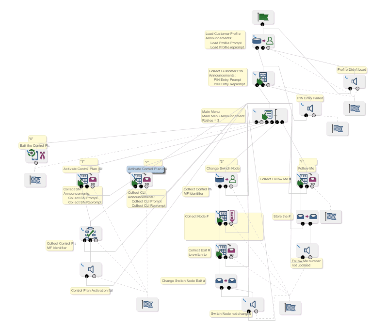

ACS Management Control Plan Example
The following figure shows the ACS management control plan, and the feature nodes used in the control plan for dial-up management.
This is image alt text.

  4. Listen to the announcement which lists the options which you can change.
    The options are:
    1. Activate a control plan attached to a service number (SN)
    2. Activate a control plan attached to a caller line identifier (CLI)
    3. Change the exit that is used in a switch node
    4. Set the follow me number
    5. End the call
  5. Press the digit which corresponds to the required option.
    Tip:
    A selection may be made at any time; it is not necessary to wait until the message is finished. Once a selection is made, the call will proceed to the menu for the option you selected.
The detailed interaction for each option is listed below.
Activating a Control Plan for a Service Number
Follow these steps to activate a control plan for a service number.
To access this functionality you must have entered 1 at the main menu.
  1. At the prompt, enter the service number for the active control plan you want to change.
  2. At the prompt, enter the MF Identifier that is to be made active for the supplied service number.
    Results:
    • If everything is correct, the system will update the service number and attach the specified control plan to it with an effective date and time of now (the time and date at which the call to the ACS Dial-up Manager is made).
    • If for any reason, the service number is not changed, you return to the main menu to try again.
Activating a Control Plan for a CLI
Follow these steps to activate a control plan for a CLI.
To initiate this functionality you must have entered 2 at the main menu.
  1. At the prompt, enter the CLI for the active control plan you want to change.
  2. At the prompt, enter the MF identifier that is to be made active for the supplied CLI.
    Results:
    • If everything is correct, the system will update the CLI and attach the specified control plan to it with an effective date and time of now (the time and date at which the call to the ACS Dial-up Manager is made).
    • If for any reason, the CLI is not changed, you return to the main menu to try again.
Changing the Switch Node Exit
Follow these steps to update the exit a Dynamic Switch feature node will route to.
To initiate this functionality you must have entered 3 at the main menu.
  1. At the prompt, enter the MF Identifier for the control plan that the switch node is in.
  2. At the prompt, enter the node number for the Dynamic Switch node you want to change.
  3. At the prompt, enter the exit number the Dynamic Switch node should now exit to.
    Results:
    • If everything is correct, the system will update the control plan.
    • If for any reason, the switch node exit is not changed (that is, you entered the incorrect node number and the number entered was not for a switch node, or the exit specified does not exist), you return to the main menu to try again.
Setting the Follow Me Number
Follow this procedure to set your follow me number.
To initiate this functionality you must have entered 4 at the main menu.
  1. At the prompt, enter the new follow me number.
    Results:
    • If everything is correct, the system will update the follow me number and return to the main menu.
    • If for any reason, the follow me number is not updated successfully, you will be informed and returned to the main menu to try again.
