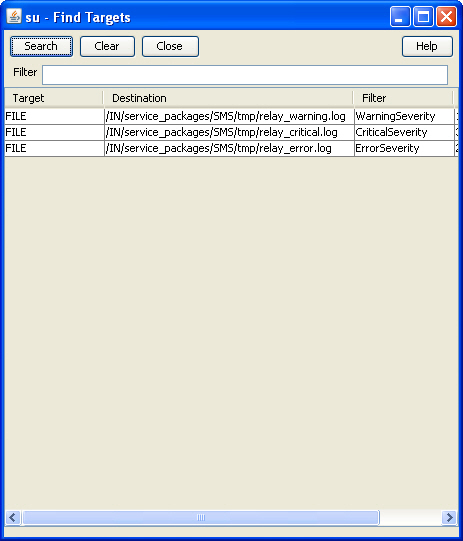

Find Targets screen
Here is an example of the Find Targets screen, which is used to find alarm notification rules.
Description of smsfindtargets-3-1-0-xp.jpg follows
For instructions on using the screen, see Using the Find Screens.

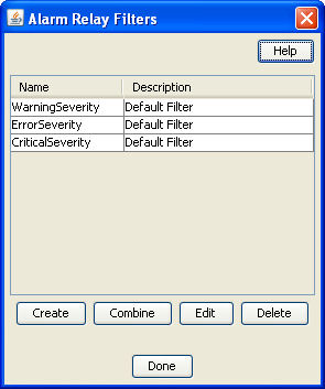

Alarm Relay Filters screen
Here is the Alarm Relay Filters screen, which is used to filter alarms to ensure that only the required alarms are sent.
Description of smsalarmrelayfiltersex-3-1-0-xp.jpg follows
Note: This screen is accessed through the Edit Filters button on the alarm Notification tab.
Related topic
Configuring Alarm Notifications
Alarm Relay Filters fields
This table describes the function of each field.
Field Description
Name Name given to the filter
Description Textual description of the filter

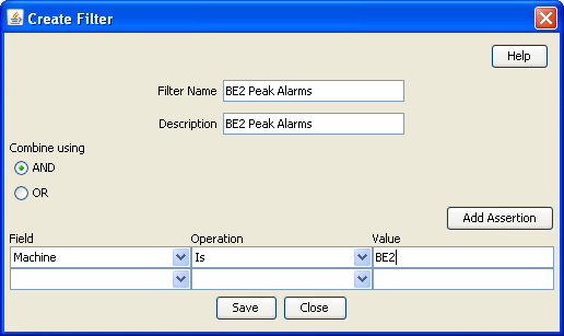

Creating a filter
Follow these steps to create a filter to display only alarms that match the filter criteria.
  1. On the Alarm Relay Filters screen, click Create.
    Result: The Create Filter screen appears.
  2. Enter a name for the filter.
    Note: This name may be up to 20 characters in length and must be unique for the user.
  3. If required, enter a description for the filter. This is optional.
  4. Select the combine value that is required. For a single assertion filter the combine value selected is not relevant, but for multiple assertion filters the combine selection determines how the assertions are related.
    Note: All assertions in the filter are combined using the selected value. A combination of 'and' assertions and 'or' assertions cannot be created in a single filter. This may be achieved using combinations of filters.
  5. Select the Field that alarms are to be filtered on. The drop down list displays all the options that may be filtered against.
  6. Select the operation that is required. The operations that are supported are below:
    • Is
    • Is not
    • Contains
    • Doesn't contain
    • Begins with
    • Ends with
    • Greater than
    • Less than
  7. Note: The operations that are available differ depending on the field that is selected. Only valid operations for each field are displayed.
  8. Enter the value that the selected field is to be matched against.
  9. To create a multiple assertion filter, click Add Assertion.
    Result: Another assertion line is added below the first.
    Note: A maximum of ten assertions are allowed per filter.
  10. Repeat steps 5 through 8 as required.
  11. Click Save
  12. Click Close to close the screen
    Note: Filters created using this method are the basis for creating more complex filters. Where you wish to create complex filters a combination or basic filters and Combining filters will be required.
