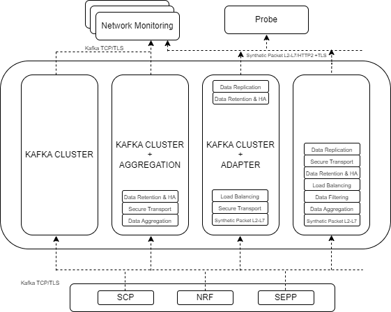

3.1 OCNADD Deployment Models
- Model 1: All Data Director Services (Default)
- Model 2: Kafka, Common Services, and Aggregation Services
- Model 3: Kafka, Common Services, and Egress Adapter Services
The Data Director supports egress adapters for outbound connections. The egress adapters add value to the message feed by filtering and synthesizing the packets before sending the messages out on the egress connection type "HTTP/2" or "Synthetic Feed". If the customer selects a deployment model that does not include the Egress adapter, additional features such as filtering and synthetic packet generation are unavailable.The following diagram depicts the various Data Director deployment models:
Figure 3-1 Deployment Models
Table 3-1 Resource Saving
| Deployment Model | Model 1 (All Services) | Model 2 (Kafka +Aggregation) | Model 3 (Kafka +Adapter) |
| Common Services | Available | Available | Available |
| Aggregation Service | Available | Available | Not available |
| Adapter Service | Available | Not available | Available |
| Kafka | Available | Available | Available |
| Resource Saving (approx. %) | 0 | 60 | 20 |
| Supported Egress Interfaces | HTTP/2
TCP |
Kafka | HTTP/2
TCP |
