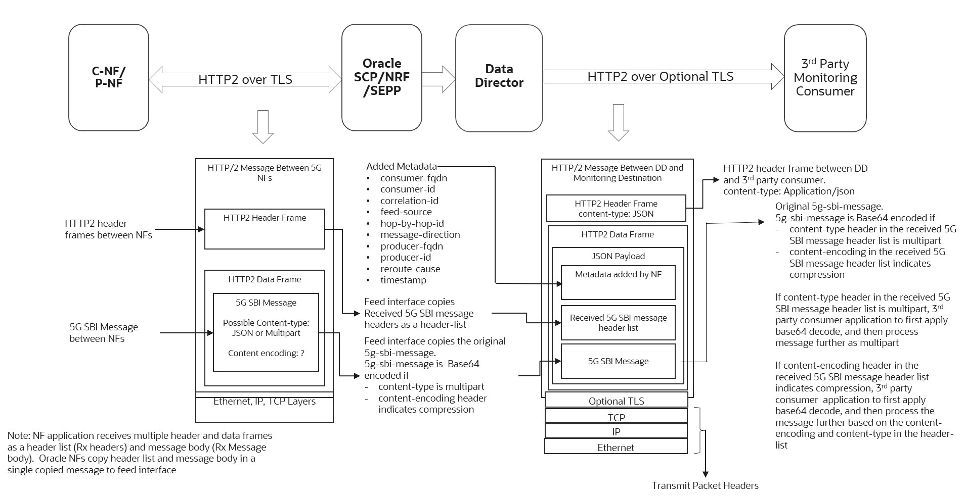

HTTP2 Message Format
Data Director supports HTTP2 feed for forwarding from Data Director to third-party monitoring consumer applications. 5G monitoring data is forwarded to third-party monitoring consumer using HTTP2 POST requests. The following components are delivered as JSON payload in the HTTP2 data frames:
  • Original received 5G SBI message headers as a header-list.
  • Original received 5g sbi data as 5g-sbi-message
  • Metadata-list added by NF
The 5g-sbi-message forwarded to third-party consumer application is Base64 encoded if:
  • The content-type header in the received 5G SBI message header list is multipart
Or
  • The content-encoding in the received 5G SBI message header list indicates compression
If the "content-type" header in the received 5G SBI message header list is labeled as "multipart," the third-party consumer application performs an initial base64 decode. Subsequently, the application proceeds to process the message as multipart content.
When the "content-encoding" header in the received 5G SBI message header list shows compression, the third-party consumer application first applies base64 decode. Then, it processes the message further based on the content-encoding and content-type in the header list.

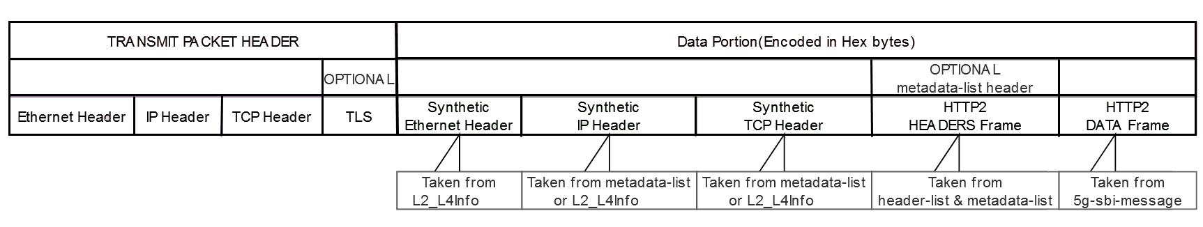

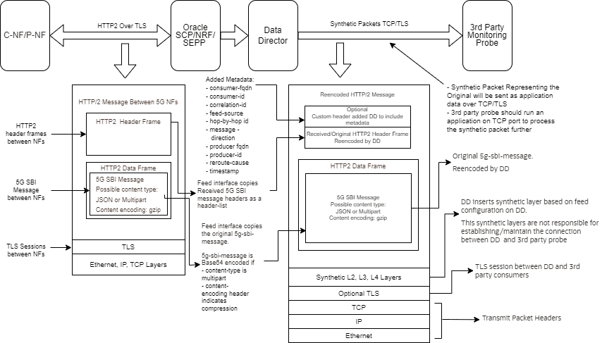

Synthetic Packet Message Format
OCNADD converts incoming JSON data into network transfer wire format and sends the converted packets to the third-party monitoring applications in a secure manner. The third-party probe feeds the synthetic packets to the internal monitoring applications. The feature helps third-party vendors to eliminate the need of creating additional applications to receive JSON data and converting the data into probe compatible format, thereby saving critical compute resources and associated costs.

Third-Party HTTP2 Feed Format
A third-party HTTP2 feed contains the following components:
Figure 3-1 Third-Party HTTP2 Feed Format
Following TLS options are supported:
  • TLSv1.2 (minimum) with oracle approved TLS Ciphers
  • TLSv1.2 with Static Key Cipher support (TLS_RSA_WITH_AES_128_GCM_SHA256)
  • No TLS (H2C)
Third-Party Synthetic Feed Format
A third-party synthetic feed contains the following components:
