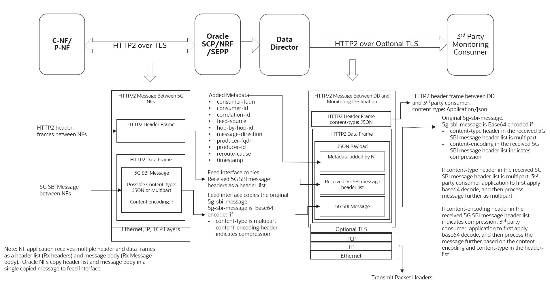

HTTP2 Message Format
Data Director supports HTTP2 feed for forwarding from Data Director to third-party monitoring consumer applications. 5G monitoring data is forwarded to third-party monitoring consumer using HTTP2 POST requests. The following components are delivered as JSON payload in the HTTP2 data frames:
  • Original received 5G SBI message headers as a header-list.
  • Original received 5g sbi data as 5g-sbi-message
  • Metadata-list added by NF
The 5g-sbi-message forwarded to third-party consumer application is Base64 encoded if:
  • The content-type header in the received 5G SBI message header list is multipart
Or
  • The content-encoding in the received 5G SBI message header list indicates compression
If the "content-type" header in the received 5G SBI message header list is labeled as "multipart," the third-party consumer application performs an initial base64 decode. Subsequently, the application proceeds to process the message as multipart content.
When the "content-encoding" header in the received 5G SBI message header list shows compression, the third-party consumer application first applies base64 decode. Then, it processes the message further based on the content-encoding and content-type in the header list.

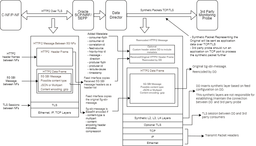

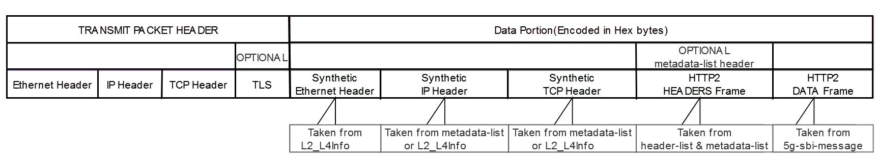

Synthetic Packet Message Format
OCNADD converts incoming JSON data into network transfer wire format and sends the converted packets to the third-party monitoring applications in a secure manner. The third-party probe feeds the synthetic packets to the internal monitoring applications. The feature helps third-party vendors to eliminate the need of creating additional applications to receive JSON data and converting the data into probe compatible format, thereby saving critical compute resources and associated costs.

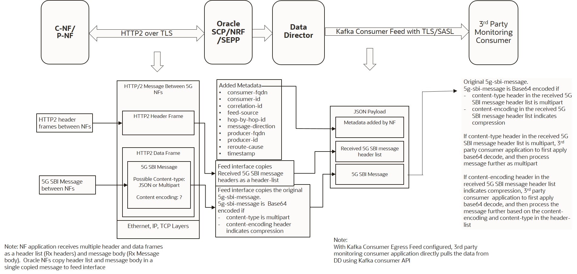

Kafka Consumer Egress Feed Message Format
OCNADD supports the external Kafka consumer applications using the external Kafka Feeds. This enables third-party consumer applications to directly consume data from the Data Director Kafka topic, eliminating the need for any egress adapter.
Clients need to be authenticated through either SASL or SSL (mTLS) for authorization by Kafka. As a result, enabling external Kafka feed support requires specific settings to be activated within the Kafka broker. This ensures mandatory authentication of Kafka clients by the Kafka service.
OCNADD only allows authorized and authenticated third-party applications to use the Data Director Kafka service. Application authorization is handled using the KAFKA ACL (Access Control List) functionality. Access control for the external feed is established during Kafka feed creation. Presently, third-party applications are exclusively allowed to READ from a specific topic using a designated consumer group.
3.2.2.2 Third-Party Feed Format
Third-Party HTTP2 Feed Format
A third-party HTTP2 feed contains the following components:
Figure 3-1 Third-Party HTTP2 Feed Format

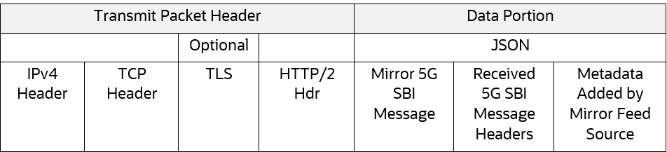

Third-Party Synthetic Feed Format
A third-party synthetic feed contains the following components:

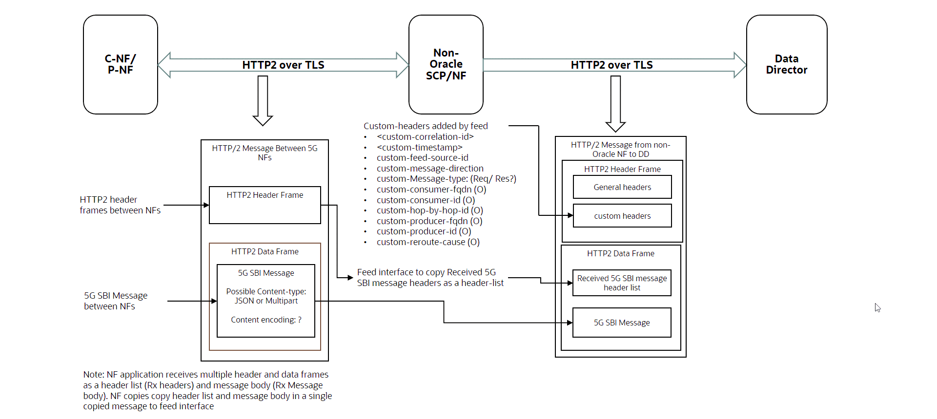

3.3 Inbound Protocols for Non-Oracle NFs
Data Director currently supports HTTP2 Ingress Feed type, over which it received the 5GSBI messages and metadata added by the Non-Oracle NFs.
Non-Oracle NFs should be sending mirrored copy of actual HTTP2 request or response message (HTTP Header + Body) in the body of HTTP2 messages using POST method. The metadata fields from Non-Oracle NFs can be present either in "MESSAGE_HEADER" or "MESSAGE_BODY".

3.3.2 Ingress Message Format for Non-Oracle NFs
The following diagram explains the format of the Ingress messages for non-Oracle network functions (NFs).
HTTP2 Ingress feed for non-Oracle NFs – Ingress Message Format
