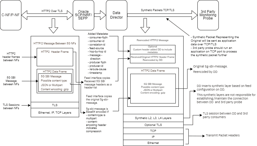

Synthetic Packet Message Format

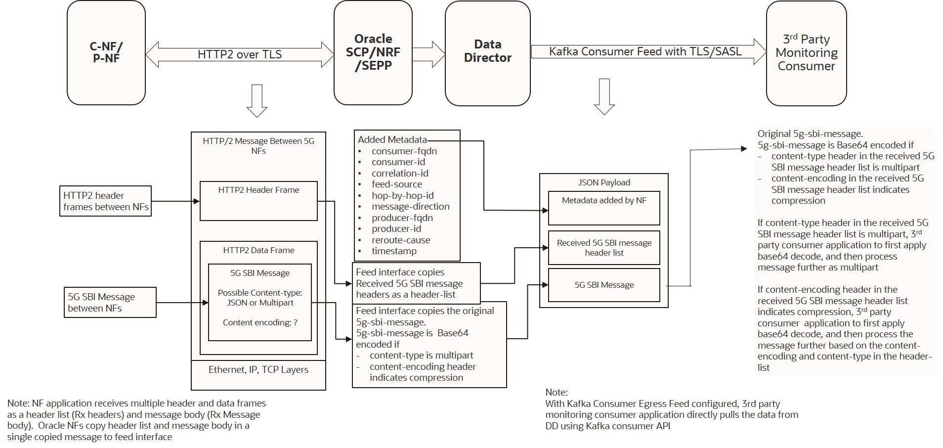

OCNADD converts incoming JSON data into network transfer wire format and sends the converted packets to the third-party monitoring applications in a secure manner. The third-party probe feeds the synthetic packets to the internal monitoring applications. The feature helps third-party vendors to eliminate the need of creating additional applications to receive JSON data and converting the data into probe compatible format, thereby saving critical compute resources and associated costs.
Kafka Consumer Egress Feed Message Format
OCNADD supports the external Kafka consumer applications using the external Kafka Feeds. This enables third-party consumer applications to directly consume data from the Data Director Kafka topic, eliminating the need for any egress adapter.
Clients need to be authenticated through either SASL or SSL (mTLS) for authorization by Kafka. As a result, enabling external Kafka feed support requires specific settings to be activated within the Kafka broker. This ensures mandatory authentication of Kafka clients by the Kafka service.
OCNADD only allows authorized and authenticated third-party applications to use the Data Director Kafka service. Application authorization is handled using the KAFKA ACL (Access Control List) functionality. Access control for the external feed is established during Kafka feed creation. Presently, third-party applications are exclusively allowed to READ from a specific topic using a designated consumer group.

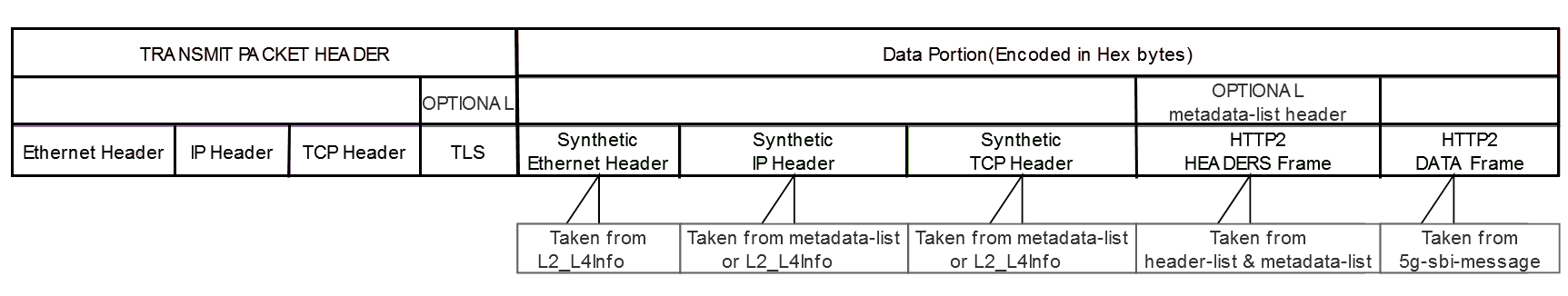

Third-Party Synthetic Feed Format
A third-party synthetic feed contains the following components:

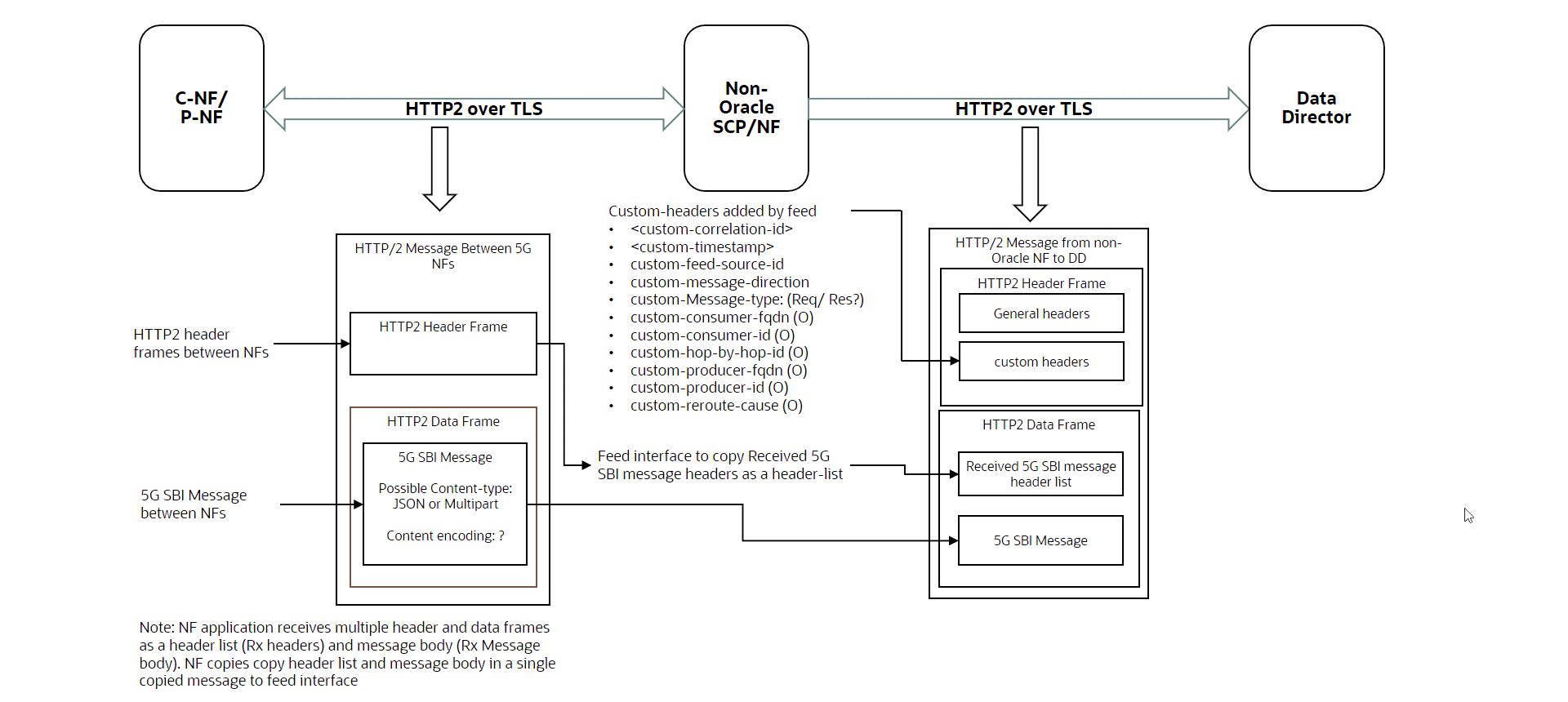

}3.3 Inbound Protocols for Non-Oracle NFs
Data Director currently supports HTTP2 Ingress Feed type, over which it received the 5GSBI messages and metadata added by the Non-Oracle NFs.
Non-Oracle NFs should be sending mirrored copy of actual HTTP2 request or response message (HTTP Header + Body) in the body of HTTP2 messages using POST method. The metadata fields from Non-Oracle NFs can be present either in "MESSAGE_HEADER" or "MESSAGE_BODY".
3.3.1 Data Transformation & Metadata Mapping
The message transformation functionality will allow data conversion and mapping from Non-Oracle NF to Oracle NF data which will be consumed by DD internal services for data processing. The conversion framework will provide capabilities to map the following metadata fields with OCNADD for processing.
The metadata fields from Non-Oracle NFs can be present either in "MESSAGE_HEADER" (as custom headers) or "MESSAGE_BODY". Based on the value of the parameter "metadataLocation" while creating configuration, the ingress adapter will take the attributes and perform the transformation of these fields to the Oracle Data Director format. If metadata is present in message body, then additional fields are required to be configured.
