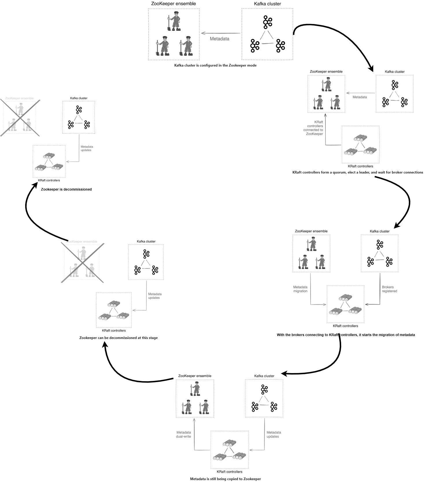

Kafka cluster management using Zookeeper has already been deprecated and will be removed in an upcoming Kafka release. It is recommended to use the Kafka KRaft controller for cluster management and to migrate Zookeeper-based Kafka cluster deployments to KRaft-controlled deployments.
This section provides an overview of the migration flow and outlines the procedure to facilitate the migration of a Zookeeper-based Kafka cluster to a KRaft-controlled Kafka cluster in Data Director.
7.1 Migration of Kafka Cluster to Kraft mode
This procedure is required to migrate a Kafka cluster running in Zookeeper mode to KRaft mode. Follow the steps below to complete the migration.

- Provision the KRaft Controller Quorum
- Modify the
ocnadd-custom-values-<wg-group>.yamlfile created for the worker group (or default worker group) under the relevant chart folder, and update it as shown below:global.kafka.spawnKraftController: false ## ---> Update it to 'true' - Perform a Helm upgrade for the default Worker Group or the Worker Group in a
separate namespace, and wait for the
kraft-controllerreplicas to come up in a running state:helm upgrade <worker-group-release-name> -f ocnadd-custom-values-<wg-group>.yaml --namespace <worker-group-namespace> <helm_chart>Example:helm upgrade ocnadd-wg -f ocnadd-custom-values-wg-group.yaml --namespace dd-worker-group ocnadd_wg - Verify that the KRaft controller pods are successfully spawned and the
kraft-controllerservice is created:pod/kraft-controller-0 1/1 Running 0 2m18s pod/kraft-controller-1 1/1 Running 0 2m03s pod/kraft-controller-2 1/1 Running 0 109s service/kraft-controller ClusterIP None <none> 9085/TCP 3m26s service/kraft-controller-cs ClusterIP 10.233.23.86 <none> 9080/TCP 3m26s

- Put the Kafka Brokers in Migration Mode
- Modify the
ocnadd-custom-values-<wg-group>.yamlfile and update the following parameter:global.kafka.migrationBroker: false ## ---> Update it to 'true' - Perform a Helm upgrade for the Worker Group, and wait for the
kafka-brokerreplicas to restart:helm upgrade <worker-group-release-name> -f ocnadd-custom-values-<wg-group>.yaml --namespace <worker-group-namespace> <helm_chart>Example:helm upgrade ocnadd-wg -f ocnadd-custom-values-wg-group.yaml --namespace dd-worker-group ocnadd_wg - Verify that all Kafka broker pods are restarted and are in the running state.

- Migrate the Kafka Brokers to Use KRaft Mode
- a. Modify the
ocnadd-custom-values-<wg-group>.yamlfile and update the following parameter:global.kafka.kraftBroker: false ## ---> Update it to 'true' - Perform a Helm upgrade for the Worker Group, and wait for the
kafka-brokerreplicas to restart:helm upgrade <worker-group-release-name> -f ocnadd-custom-values-<wg-group>.yaml --namespace <worker-group-namespace> <helm_chart>Example:helm upgrade ocnadd-wg -f ocnadd-custom-values-wg-group.yaml --namespace dd-worker-group ocnadd_wg - Verify that all Kafka broker and KRaft controller pods are restarted and are in the running state.

- Finalize the Migration
Caution:
- Some users prefer to wait for a week or two before finalizing the migration. While this requires you to keep the Zookeeper cluster running for a while longer, it may be helpful in validating Kraft mode in your cluster.
- After completing this procedure, reverting to Zookeeper mode is no longer possible. If any error is encountered during the previous steps, rollback should be performed following the section Rolling Back to Zookeeper Mode During The Migration.
- Once the migration is finalized, rollback of the Data Director deployment to a previous release is not supported.
- Modify the
ocnadd-custom-values-<wg-group>.yamlfile and update the following parameter:global.kafka.finalizeMigration: false ## ---> Update it to 'true' - Perform a Helm upgrade for the Worker Group, and wait for the
- Deprovision Zookeeper
- Modify the
ocnadd-custom-values-<wg-group>.yamlfile and update the following parameter to deprovision the Zookeeper cluster:global.kafka.removeZookeeper: false ## ---> Update it to 'true'Note: The following parameters must also be updated if OCCM was used to generate the certificates for Zookeeper:global.kafka.occmZookeeperClientUUID: 0969e413-7aa4-48cd-9300-1932de778272 ## UUID of ZOOKEEPER-SECRET-CLIENT-<namespace> from OCCM global.kafka.occmZookeeperServerUUID: 8352fabe-8da4-4bf5-8123-c12e5a78965b ## UUID of ZOOKEEPER-SECRET-SERVER-<namespace> from OCCMUUIDscan be obtained by logging into the OCCM UI and searching for the certificatesZOOKEEPER-SECRET-CLIENT-<namespace>andZOOKEEPER-SECRET-SERVER-<namespace> - Perform a Helm upgrade for the Worker Group and wait for the Zookeeper pods
to
terminate:
helm upgrade ocnadd-wg -f ocnadd-custom-values-wg-group.yaml --namespace dd-worker-group ocnadd_wg - Verify that Zookeeper secrets have been
deleted:
kubectl get secret -n <worker-group-namespace> No secrets for the Zookeeper should be listed for the provided worker group namespaced. Verify that Zookeeper PVCs have been deleted:
kubectl get pvc -n <worker-group-namespace> No PVCs for the Zookeeper should be listed for the provided worker group namespace
