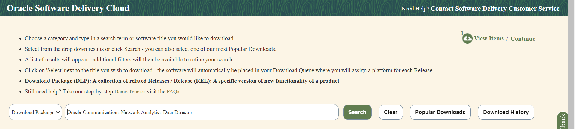

2.2.1.1 Downloading OCNADD Package
To download the Oracle Communications Network Analytics Data Director (OCNADD) package from MOS, perform the following steps:
  1. Log in to My Oracle Support with your credentials.
  2. Select the Patches and Updates tab to locate the patch.
  3. In the Patch Search window, click Product or Family (Advanced).
  4. Enter "Oracle Communications Network Analytics Data Director" in the Product field, select "Oracle Communications Network Analytics Data Director 25.2.100.0.0 from Release drop-down list.
  5. Click Search. The Patch Advanced Search Results displays a list of releases.
  6. Select the required patch from the search results. The Patch Details window opens.

To download the Oracle Communications Network Analytics Data Director package from the edelivery portal, perform the following steps:
  1. Login to the edelivery portal with your credentials. The following screen appears:
    Figure 2-1 edelivery portal
    edelivery portal
  2. Select the Download Package option, from All Categories drop down list.
  3. Enter Oracle Communications Network Analytics Data Director in the search bar.
    Figure 2-2 Search
    Search
  4. List of release packages available for download are displayed on the screen. Select the release package you want to download, the package automatically gets downloaded.
